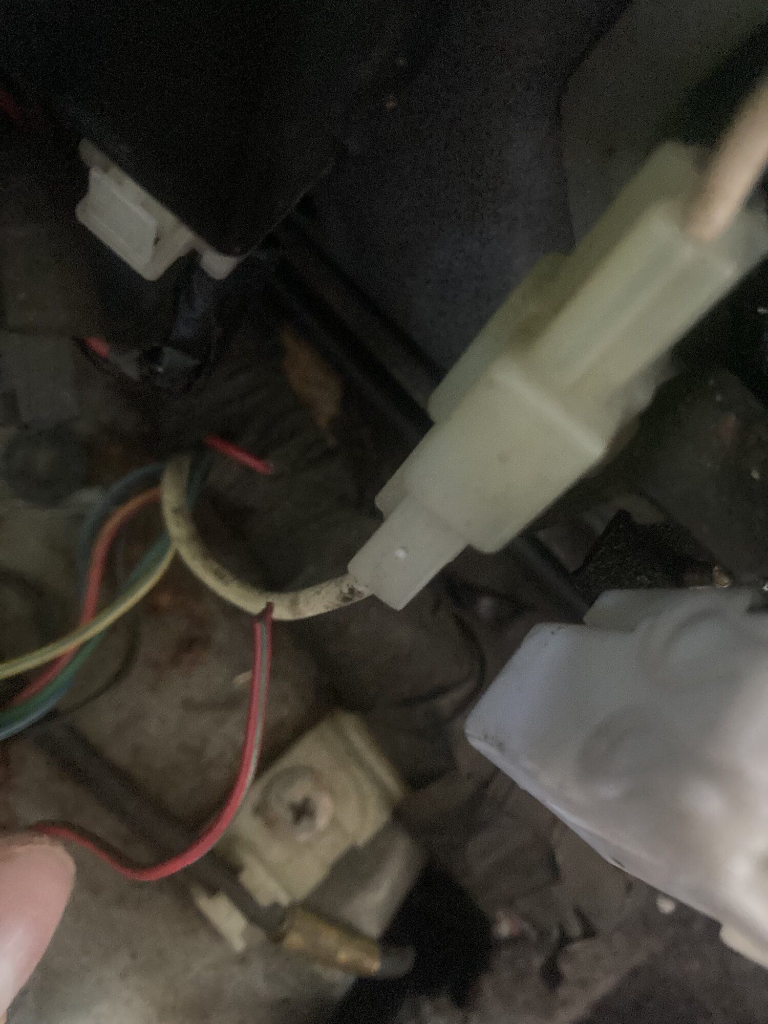

I was on the receiving end of a lesson about the small flat rate boxes, too. Always tape the ends/corners if you’re using them. I received a completely empty box and had a pretty similar customer service experience with the seller where I don’t think they believed me. I just handled the claim with usps on my own.
I took pictures thankfully and used eBay’s website exclusively to communicate. He tried getting me to call him instead but I refused. I wanted a record of it.
He caved and is sending me a pigtail and stuff now. Claims that his been having trouble with USPS opening his stuff. Like, if that was the case why wouldn’t you start taping it more securely or just outright avoiding them?
Either way I’m happy he’s sending me a new one. Also as a bonus I found the little joke of a SD pipe that was originally on the car so if the other SD pipe is lost I can at least have something.

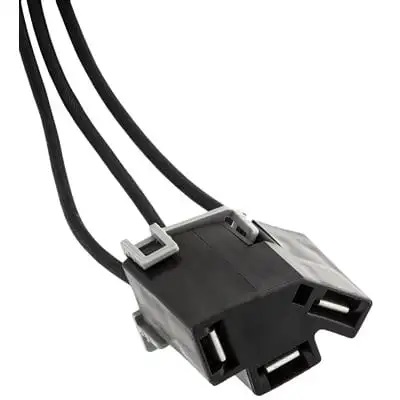

Alright, ended up ordering two of these bad boys from some random website. It was the legit only place I could find the OEM 1GA headlight connectors, and I didn't feel like fighting with people on FB to finally find someone on DSMtuners that had the harness two weeks after I needed them.
These are the connectors.
After they get here, I'm gonna just put in some Sylvania OE replacement H4666 lights that I just bought, and be done with it. If the light output sucks royally, or I can't see, then I'll just get some replacement housings(either H4 Halogen housings, or LEDs) with adapter harnesses and go from there. But for now I'm happy with it. Fixing this piece of shi harness one plug at a time!
Pretty excited though. All the reviews I could find says people love these, and honestly...anything is better than one semi-functional HID that puts out legitimately 10-15 watts of blue light. I think a pen light would be brighter.

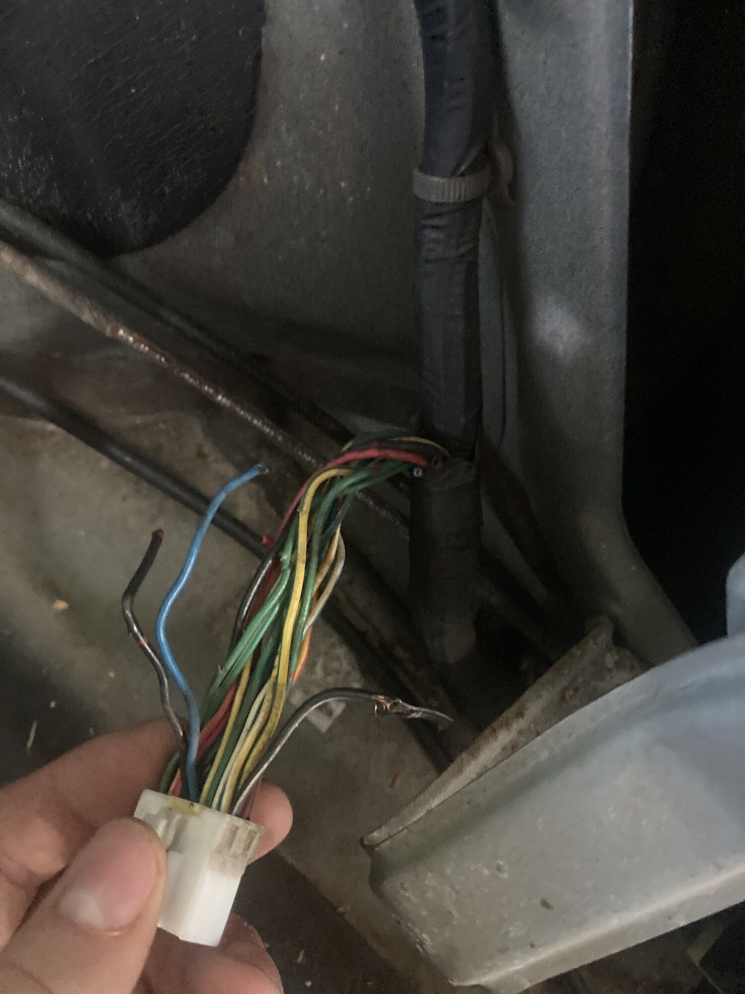

Well, I think I found the problem as to why the seatbelts don’t work.
This is the plug to the seatbelt ECU, and the power/ground plug to the motor. Grief. Looks like I’ve got more soldering and wiring to do.
