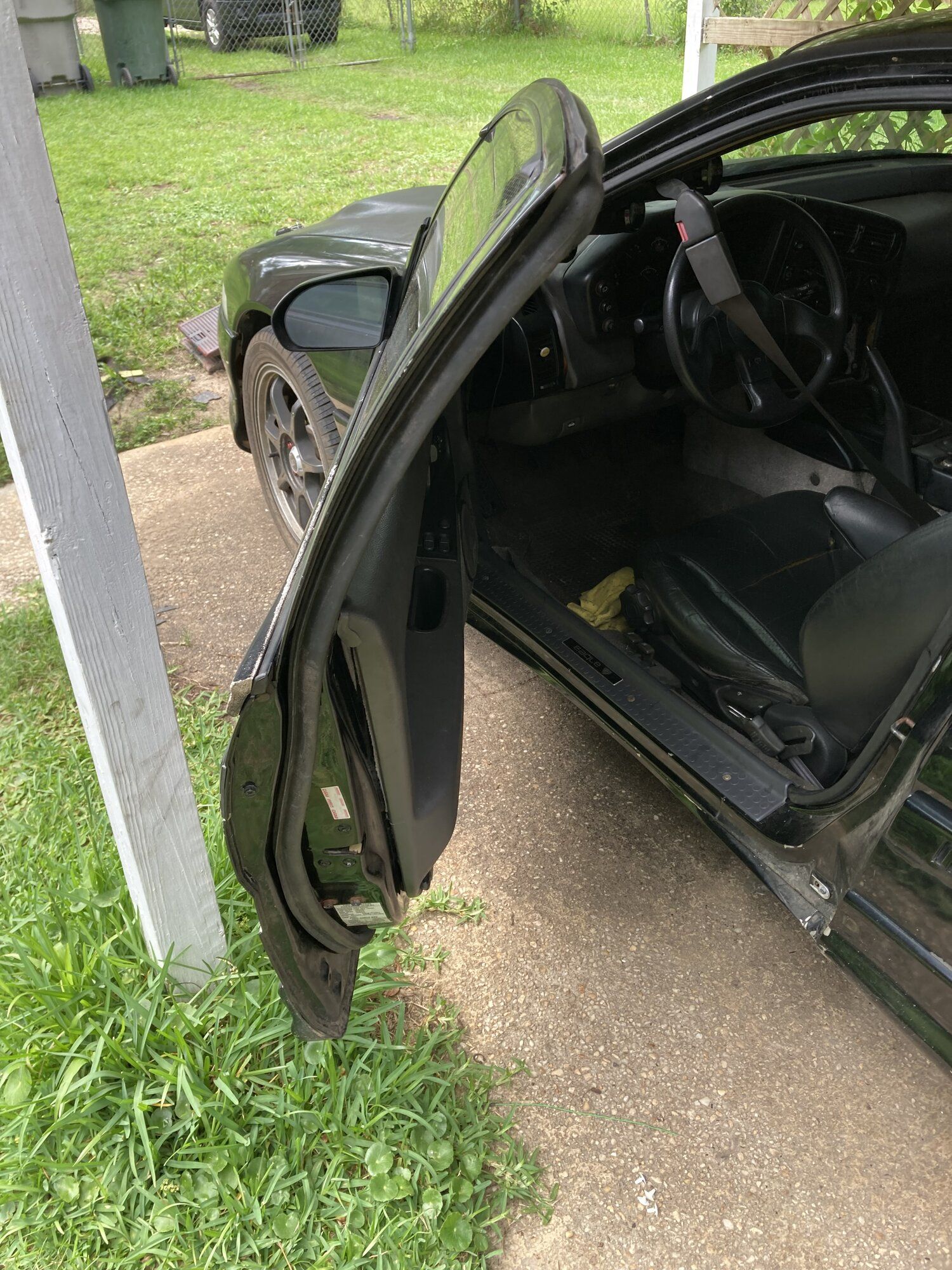

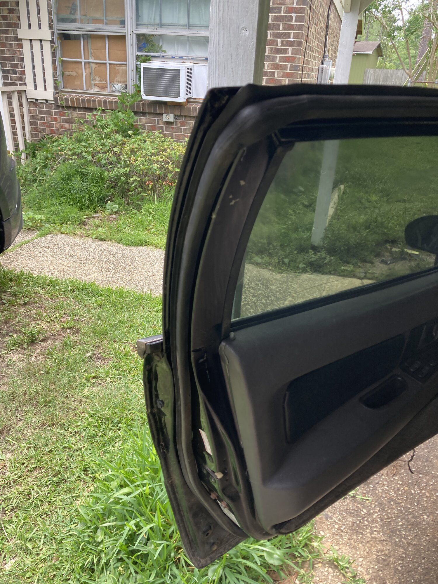

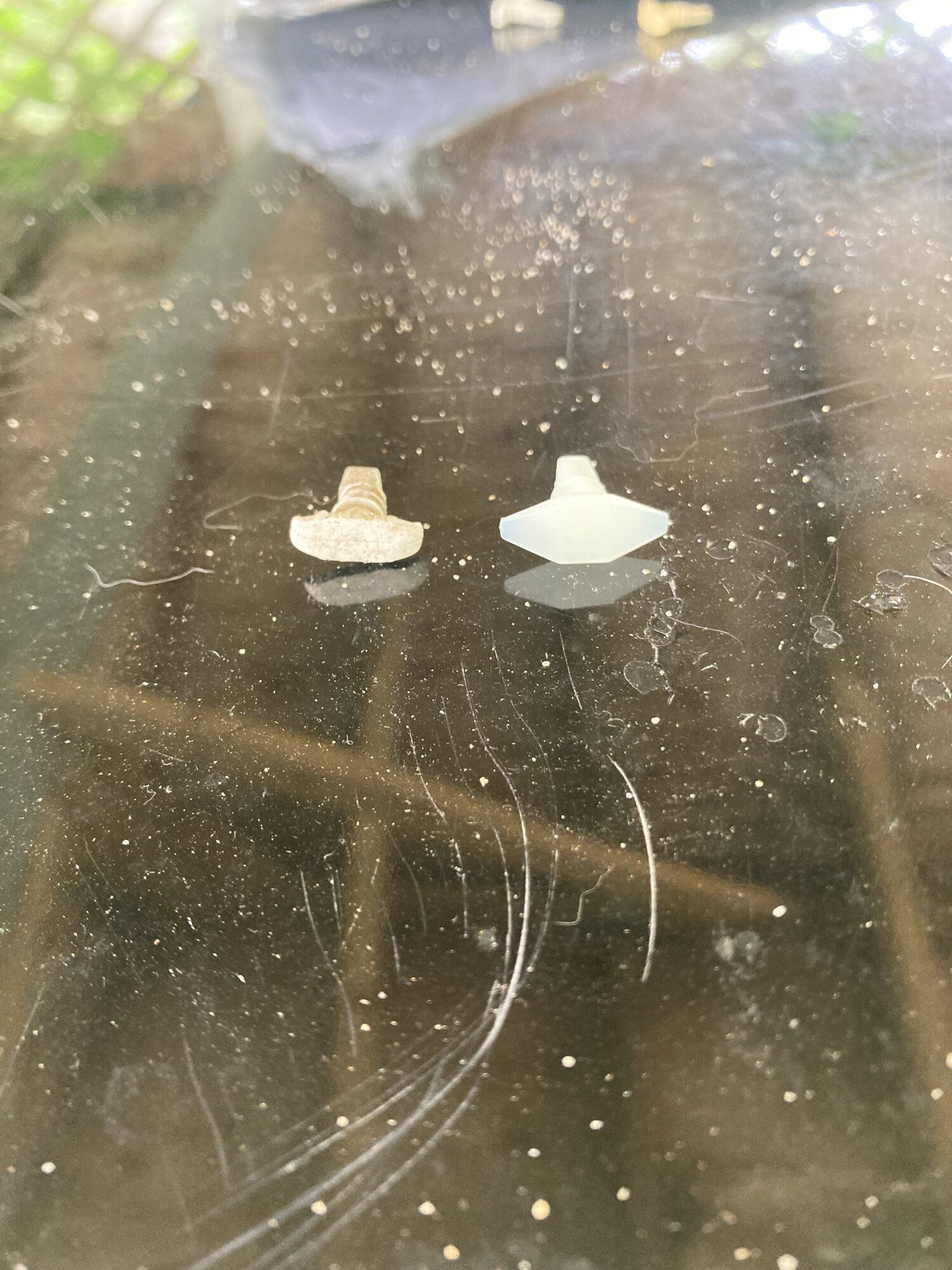

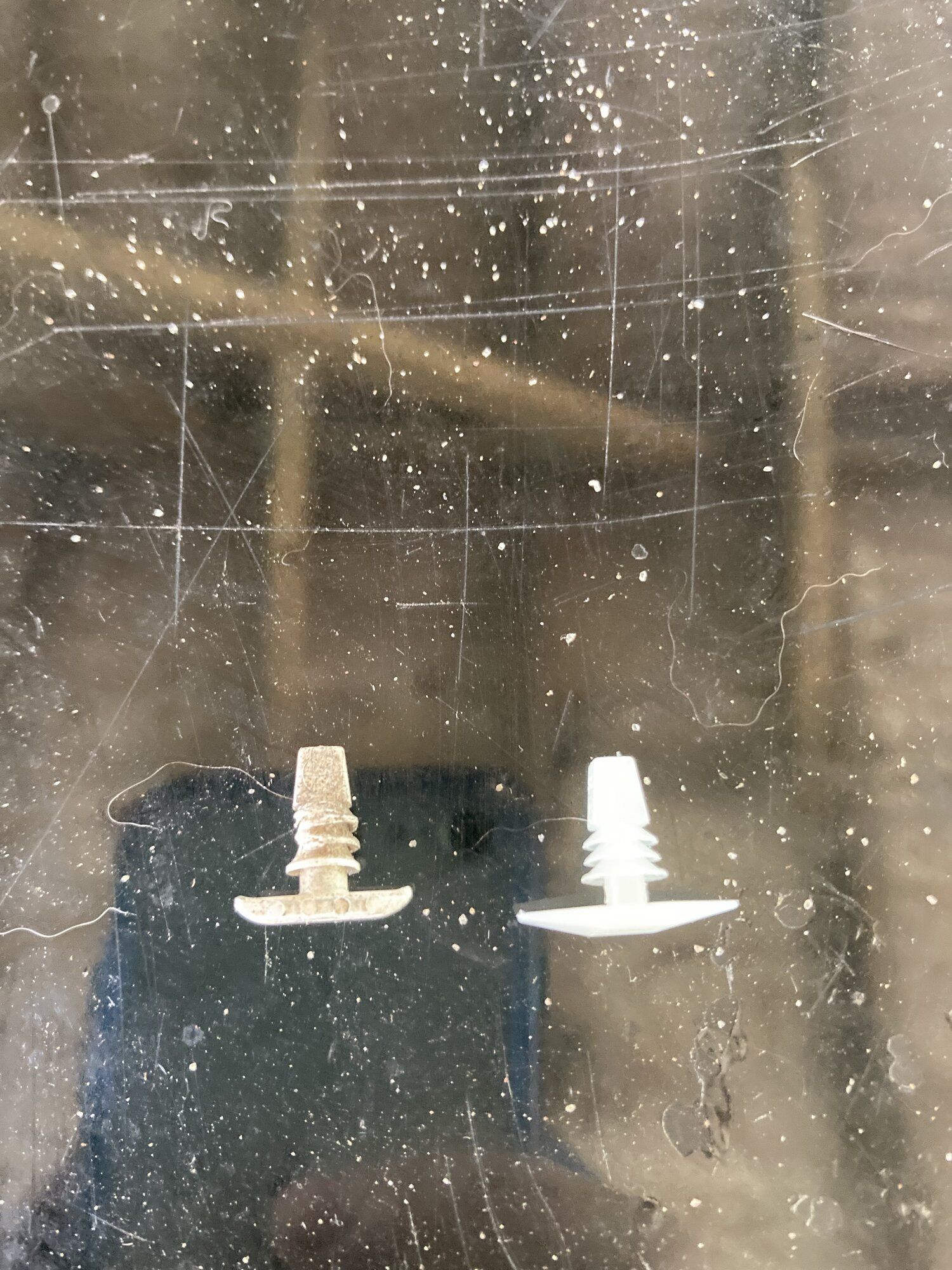

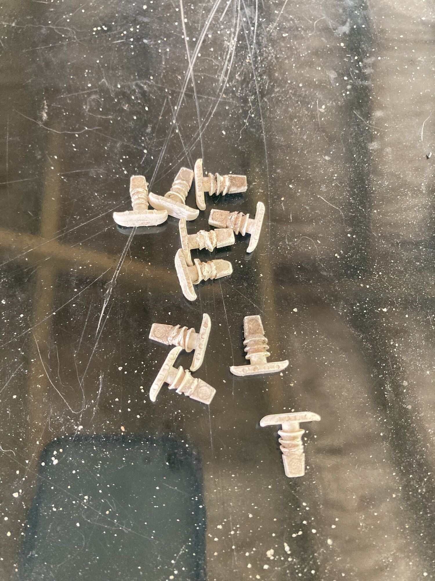

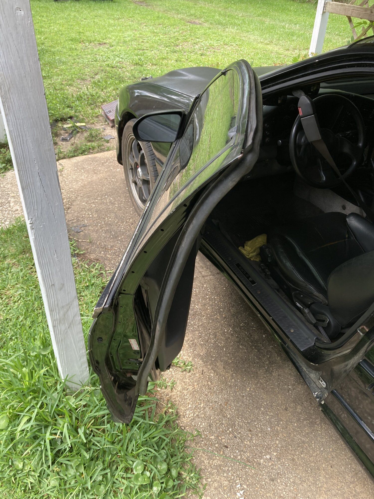

Did a little quick fix today that I'm actually fairly excited about. I'm sure you 1G guys know the struggle with the weather stripping on the doors. Mine were hanging down and apparently the old OEM clips were just too worn/too broken so it would sag.
Like so.
Bleh. Looks ugly, and always gets caught when you close the door. But I was researching and found someone recommended some honda weatherstrip clips on ebay, so I found 25 pcs for $10, and bought them.

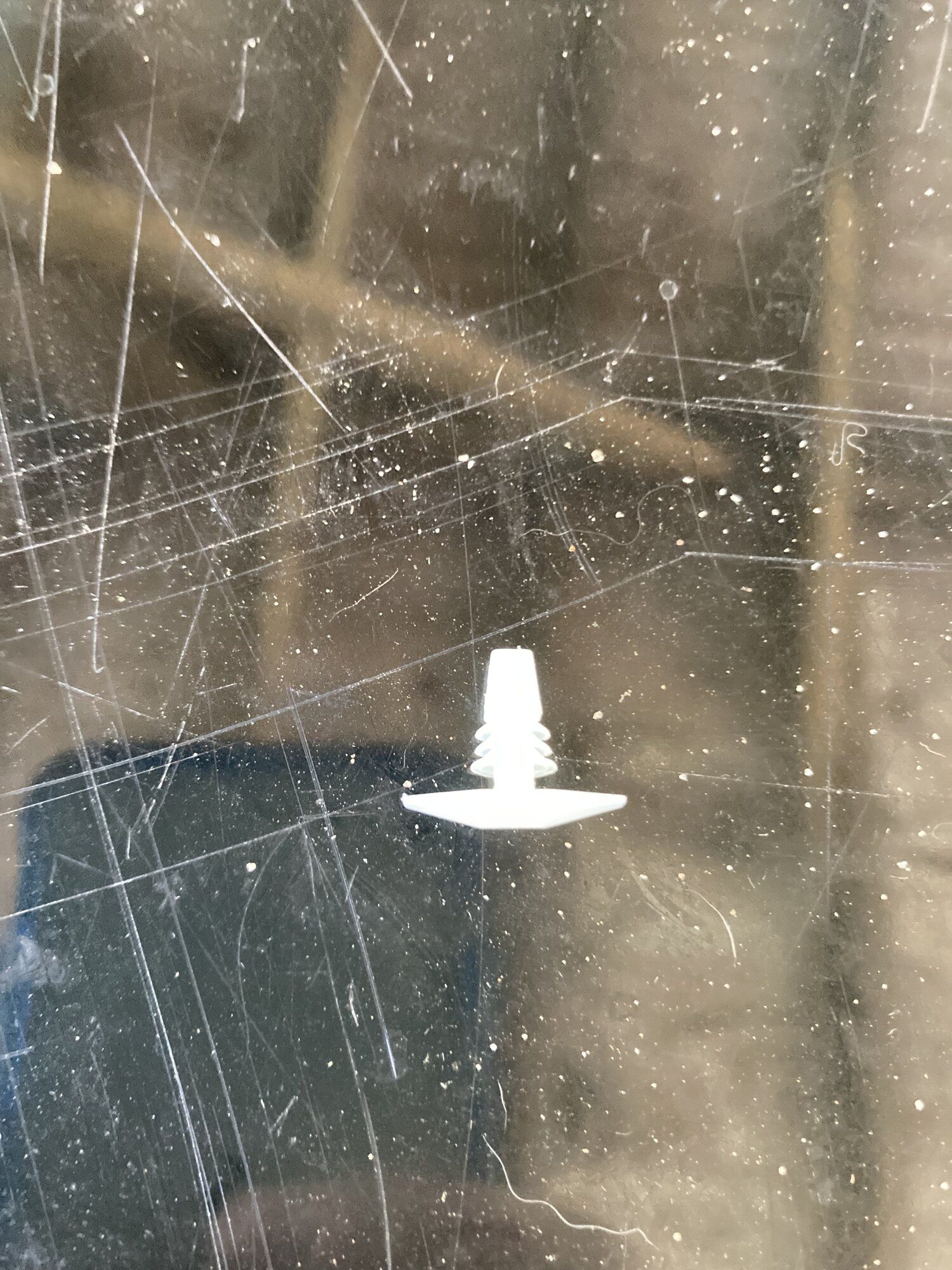

Here's the old clips.
Here's the new hotness.
The head is slightly bigger, but the shank itself(part that goes into the door) is the same thickness as a new OEM unit. There's a satisfying "click" when you push it in. Here's a couple more comparison pics.
Word of warning though, these things HURT your finger by how you have to grab them to push them in the weatherstrip by the time you get to the 12/13th one. Lol. But, once they're in there, they are held in nice and securely. Push them into the door with a nice solid click and bam! You're left with this.
It's the little things man. I'm loving how this car is coming together.

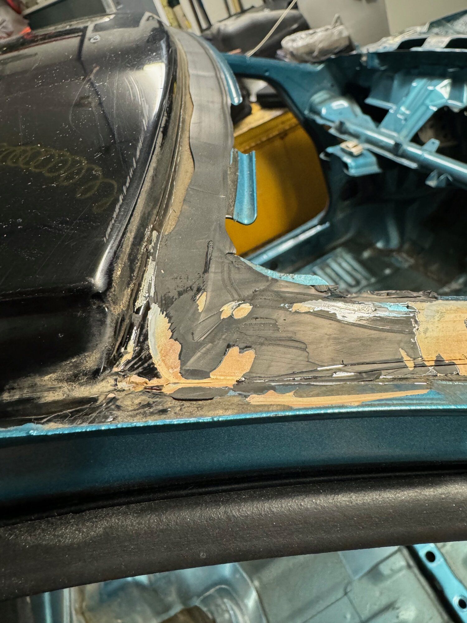

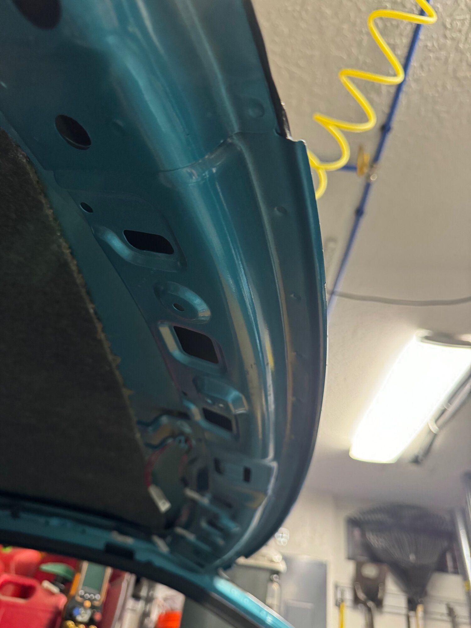

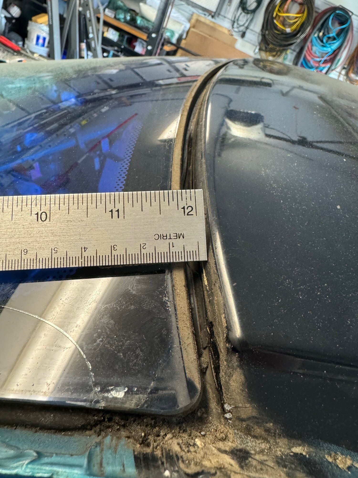

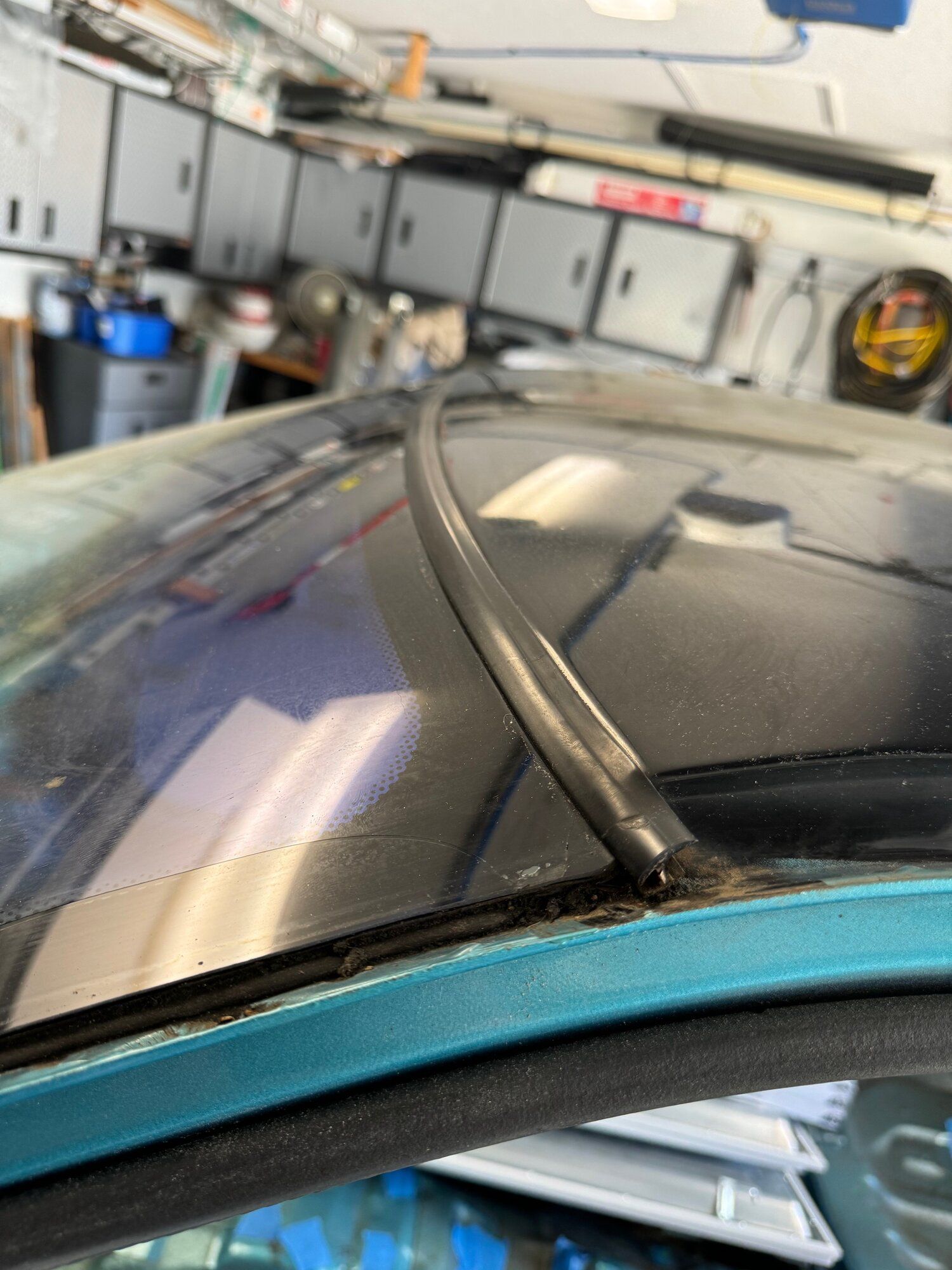

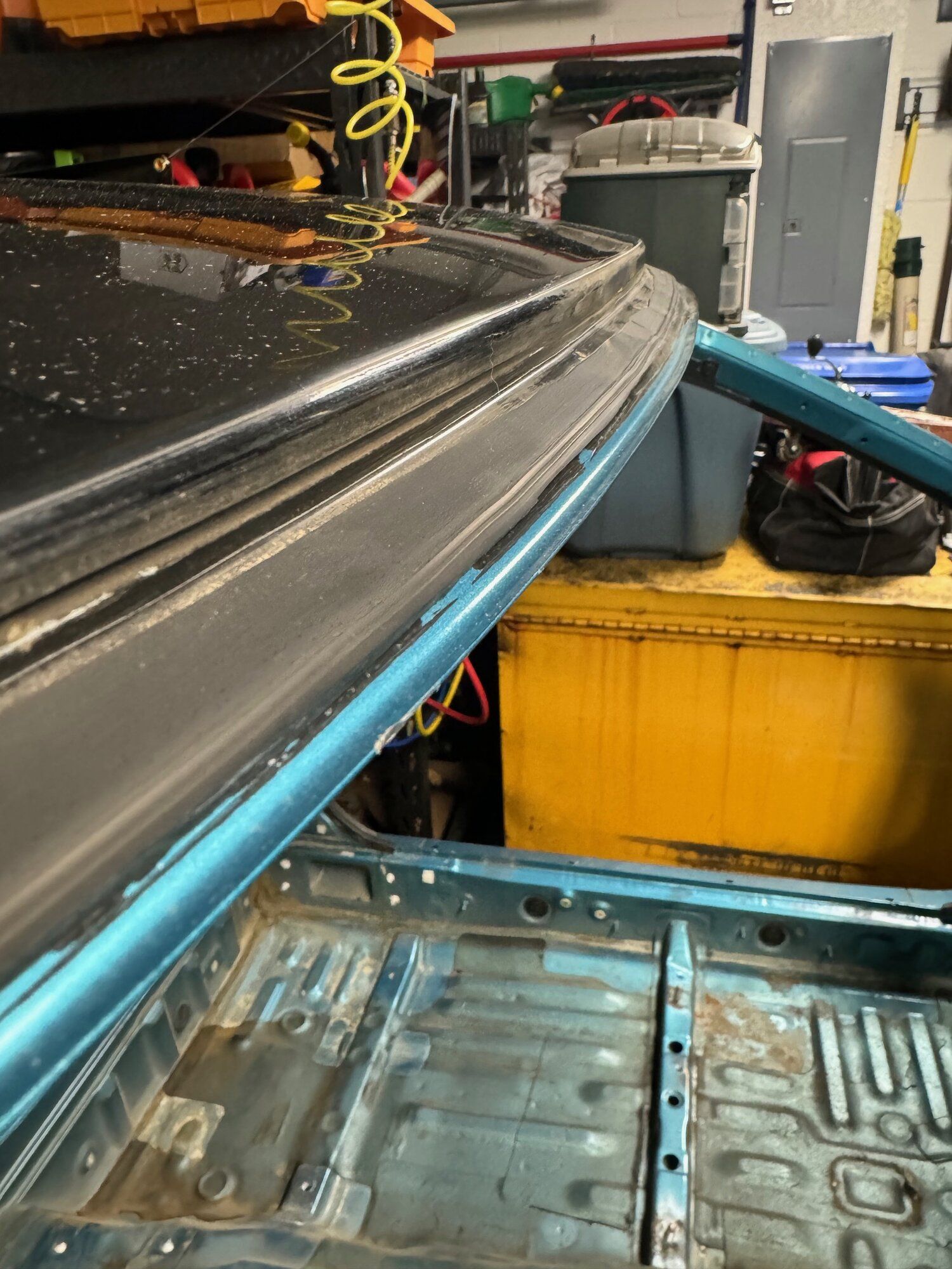

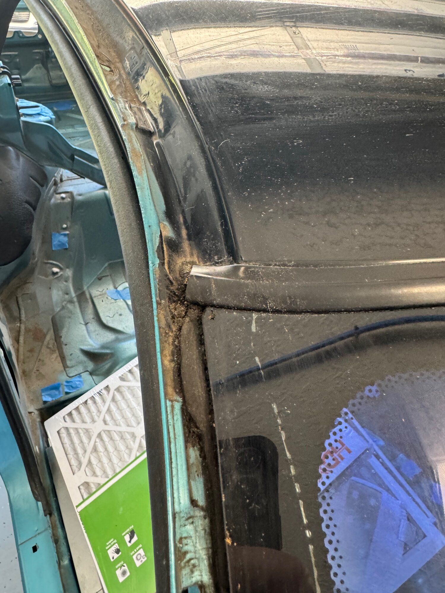

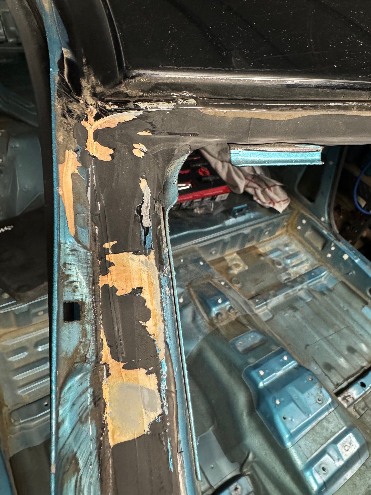

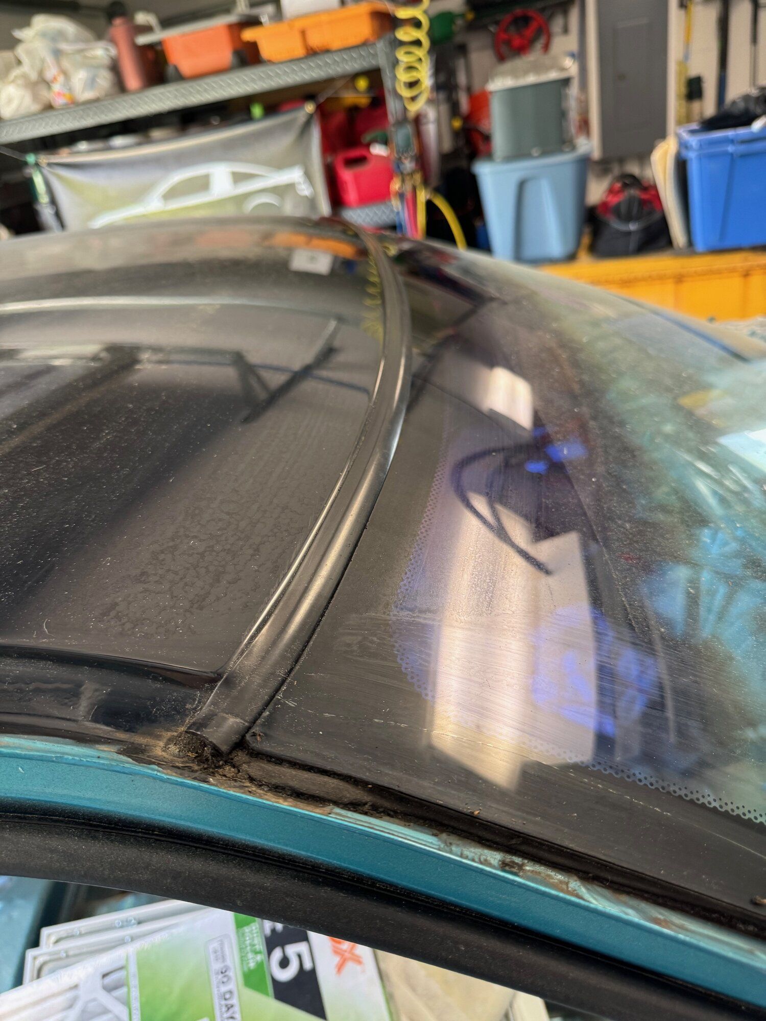

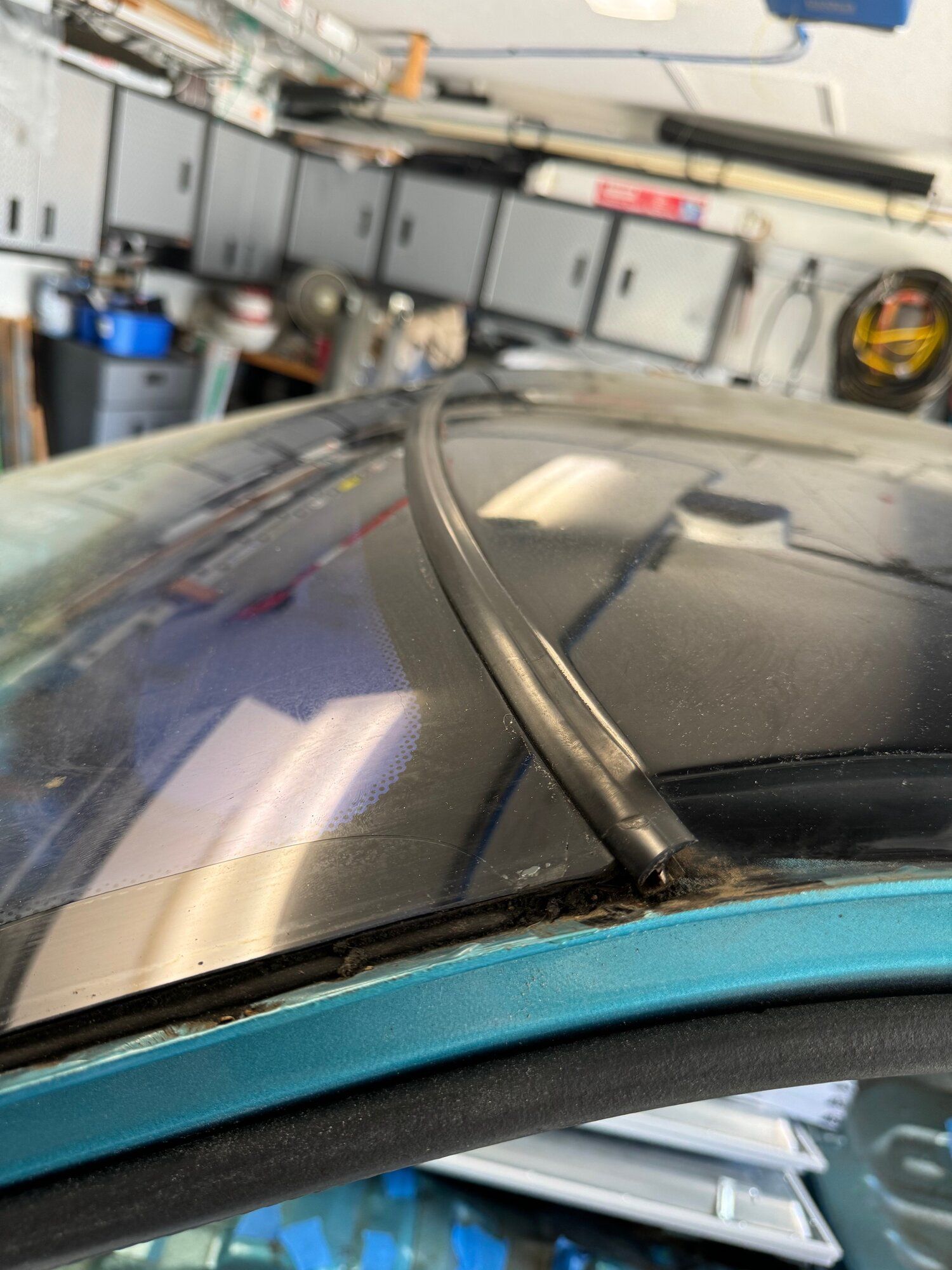

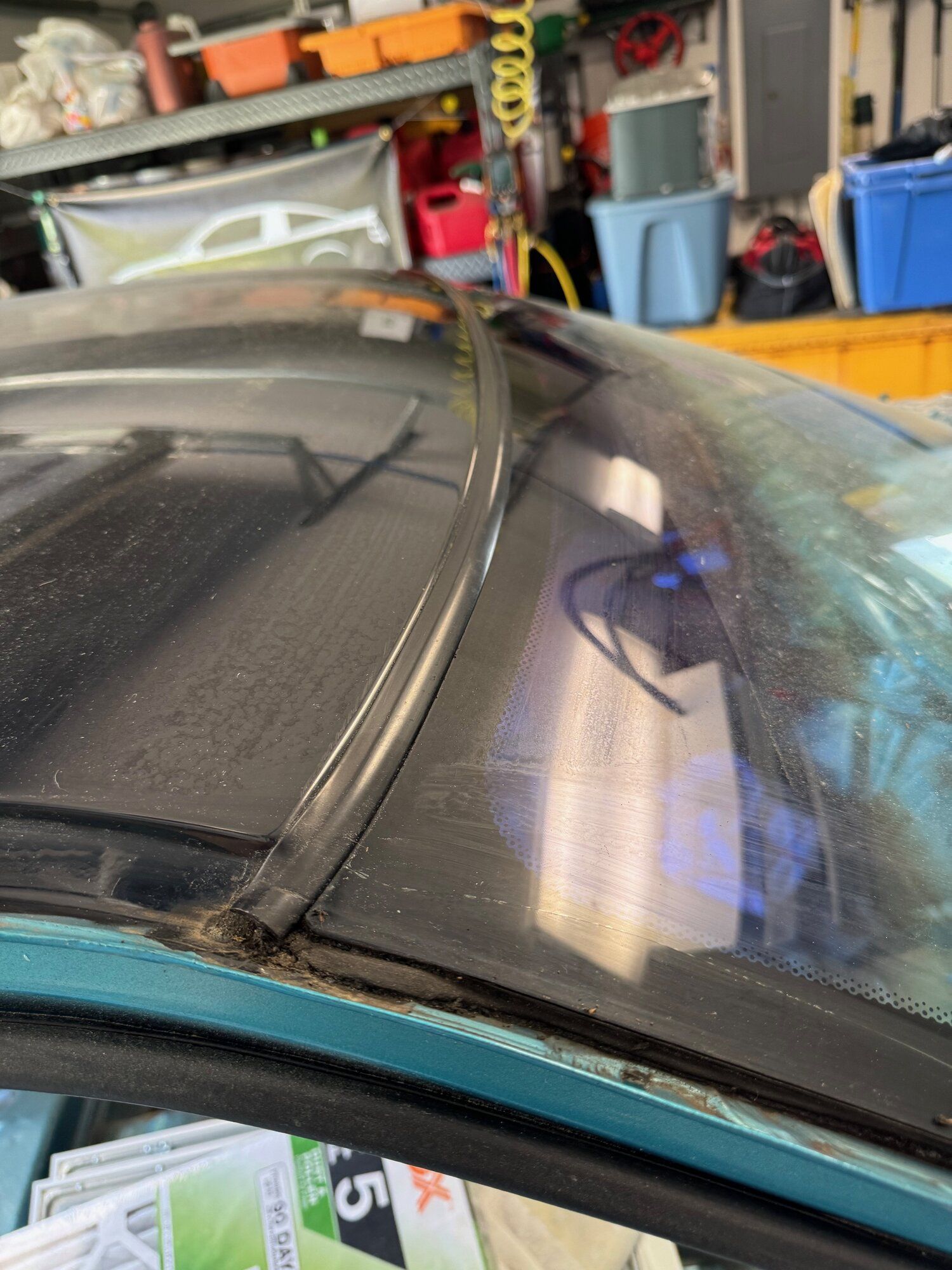

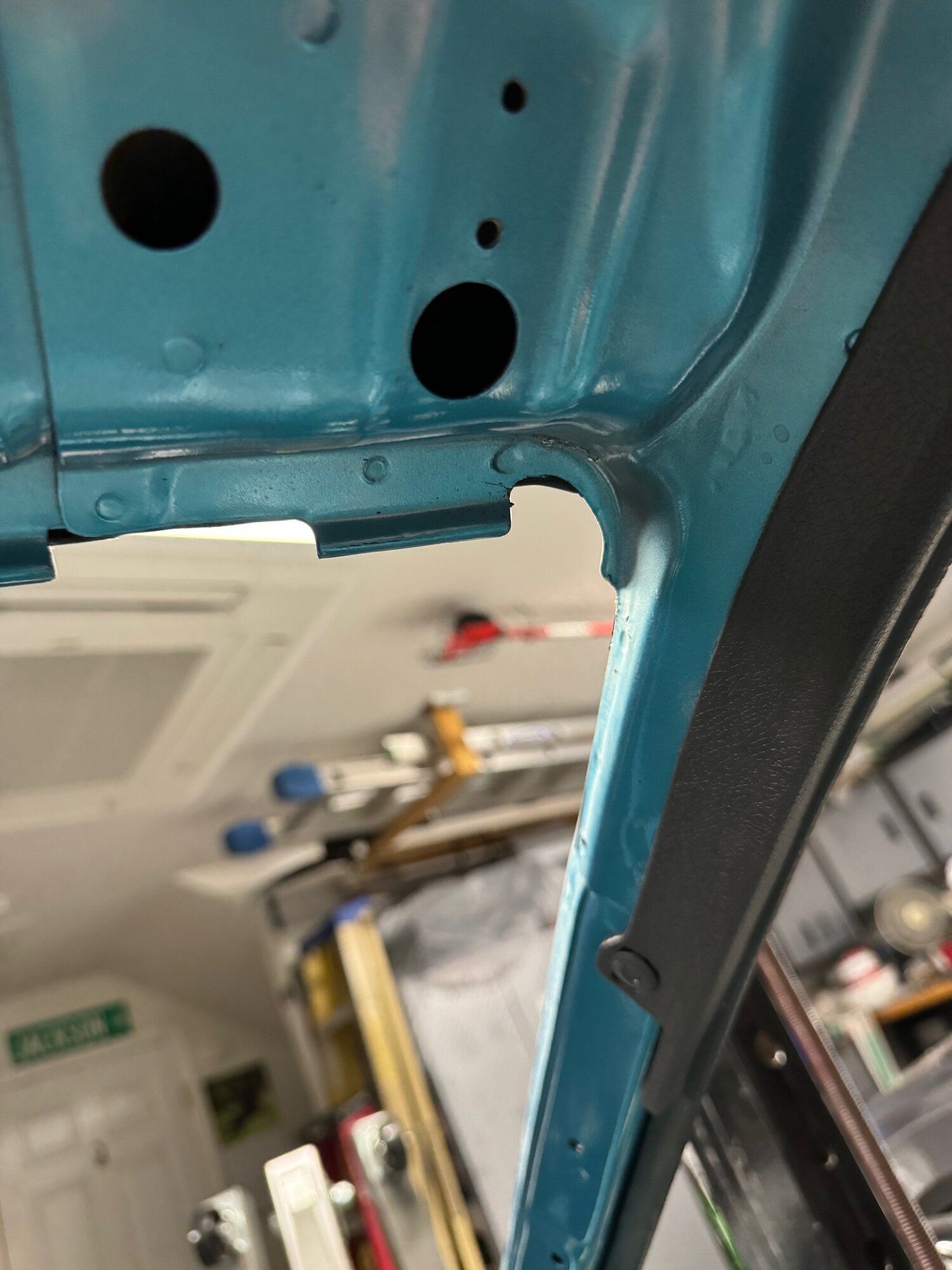

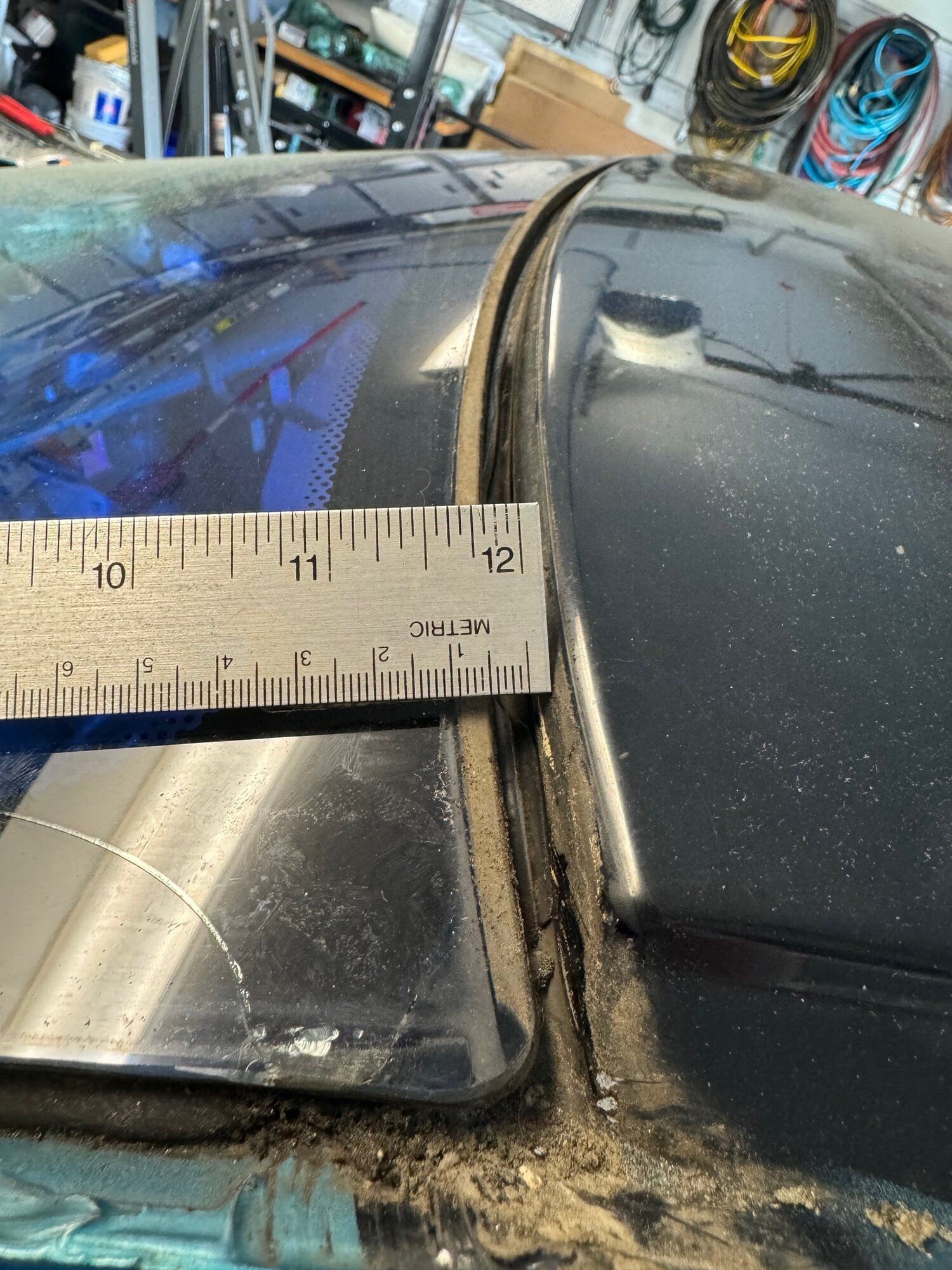

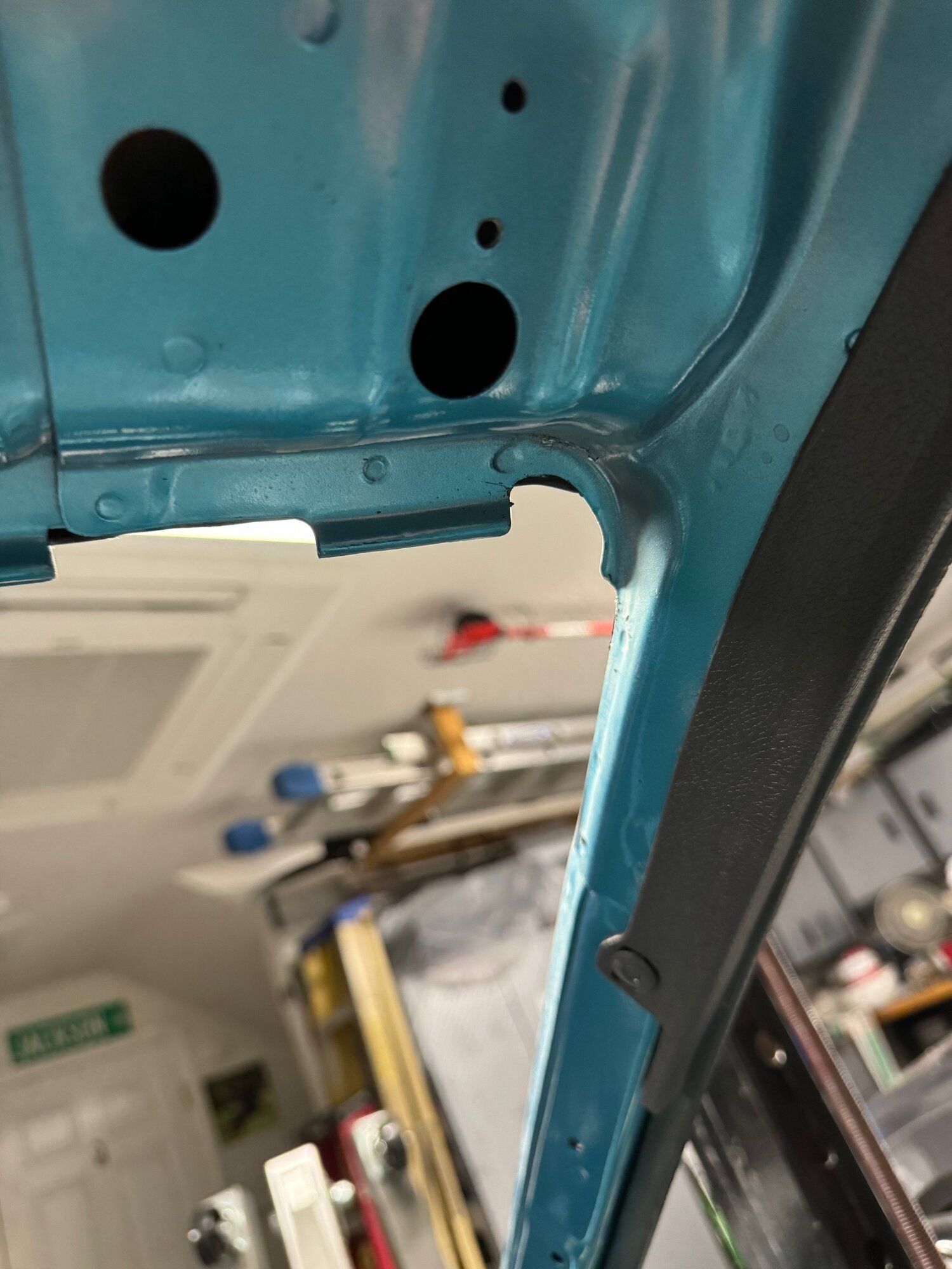

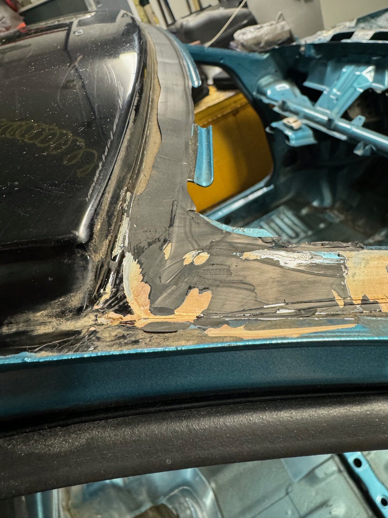

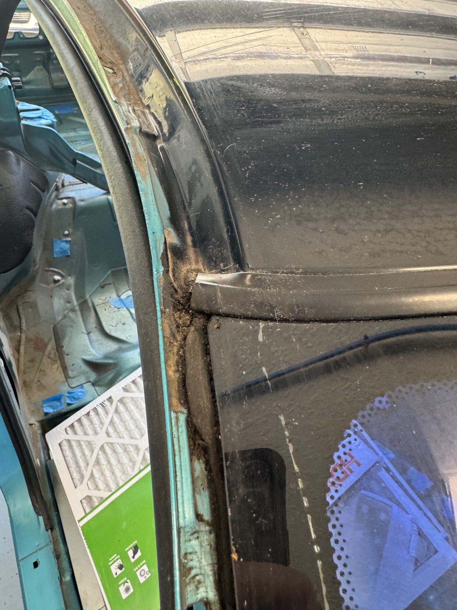

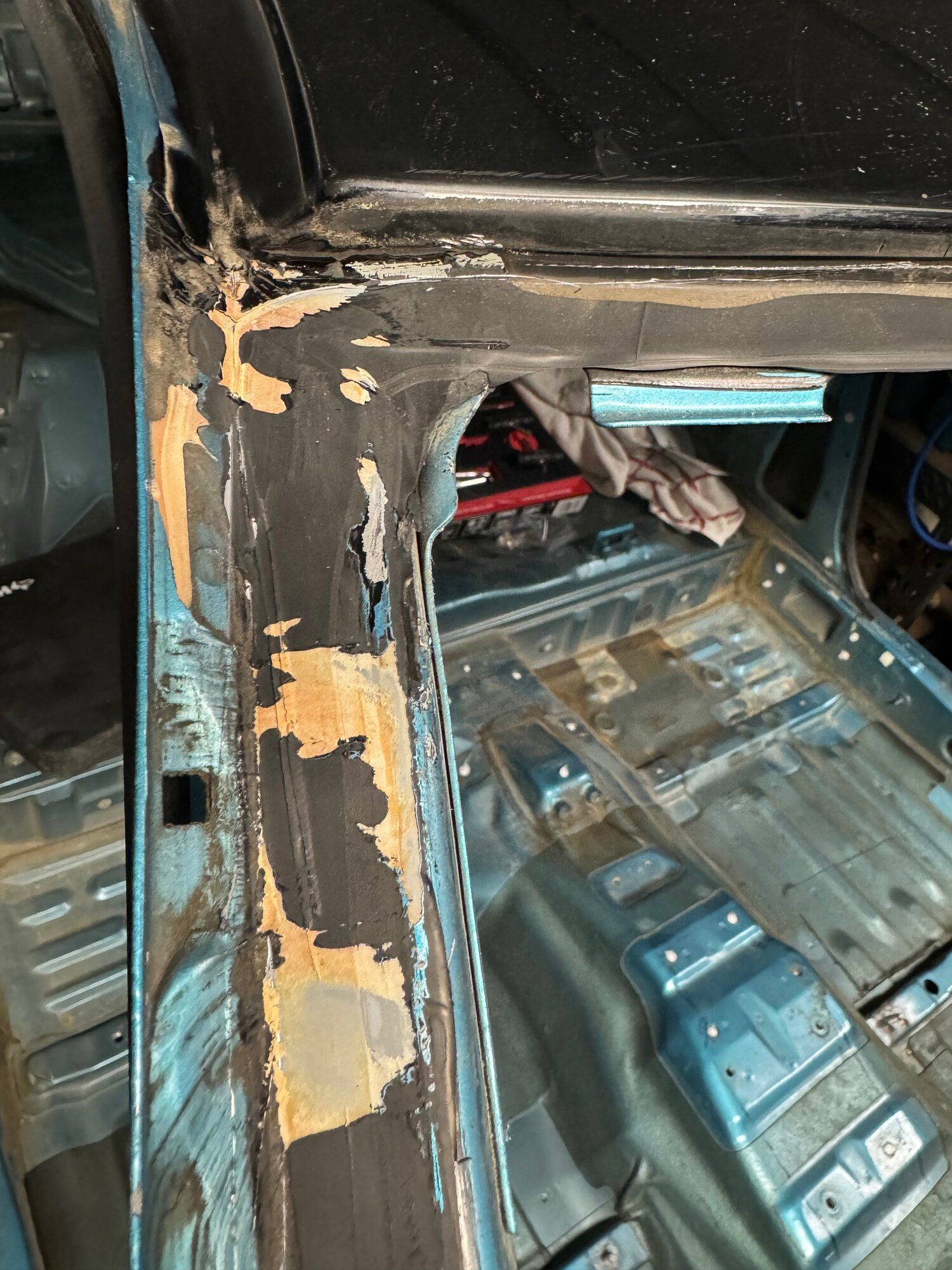

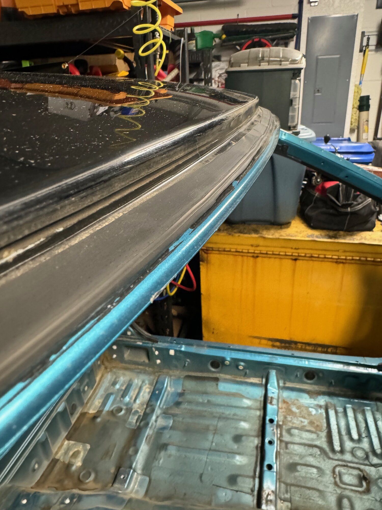

Gonna try to tackle the interior leak next week when I'm off. Maybe today. I need to dig further back in the build thread here and check pictures posted of what the interior looks like with no headliner.
Don't suppose anyone has a stripped 1G right now that you can take pictures for me? Preferably around the top of the windshield where it meets the roof, and of the whole roof itself. Non-sunroof. I'm fairly sure it's the windshield somehow, because I covered the windshield with a tarp and no leaks were present. But I don't like to depend on one result, I like repeatable results.
Cannot express to you guys how exceedingly little I want to remove the headliner. It requires removing the pillar trim, which would require pulling off the super tight fitting a-pillar pod and...ugh. Lol. But I can't have a car in Florida that I can't drive in the rain.
Any of these help?
This is exactly what I needed. Thank you a bunch!

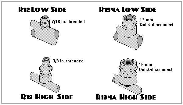

Anyone got any experience converting their 1G from R12 to R134a? You can’t find R12 anymore for less than ridiculous prices.
Just curious how you went about it and how it’s still working today.
I’m not expecting any answers so this will probably be another example of getting no help and figuring it out as I go. Lol.
But: officially got the drier, orings, and belt ordered and on the way. Got the r12->R134a conversion fittings on the way too. This is happening!
I've done it on many older Hondas and GM vehicles. It's usually as simple as flushing the system, installing appropriate fittings, and filling with PAG oil + R134. I don't think the DSM has anything special. Your new compressor might be pre filled with mineral oil, so make sure to flush that out and add PAG oil before installation.
I did it. My broke ass just bought a conversion kit, an oring kit, some 134a and a cheap gauge. I think I even added an ester charge :ohdamn: Worked but not great.
If I did it over I'd convert it, flush, new dryer, add pag oil, vacuum and charge.
