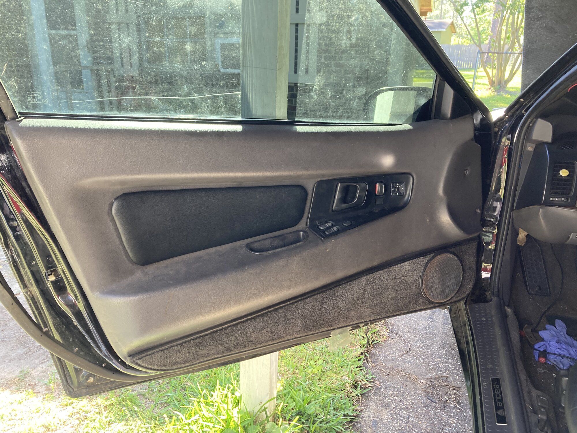

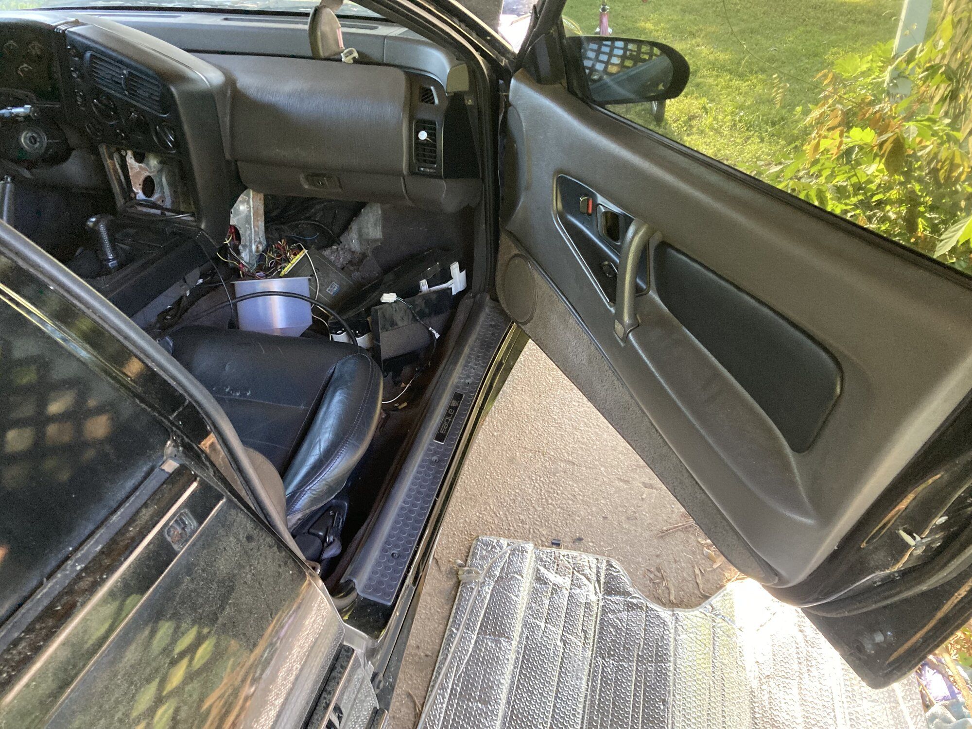

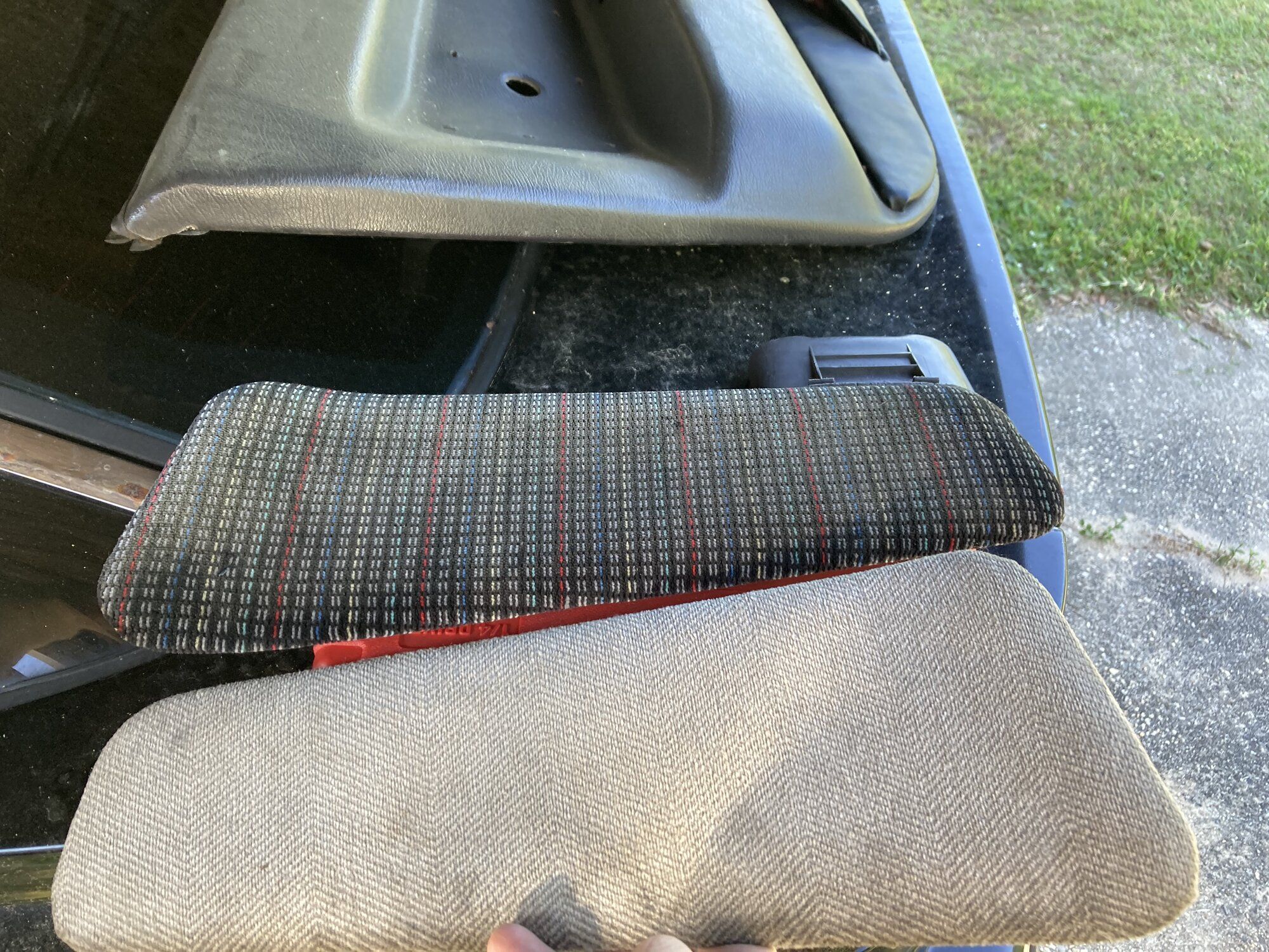

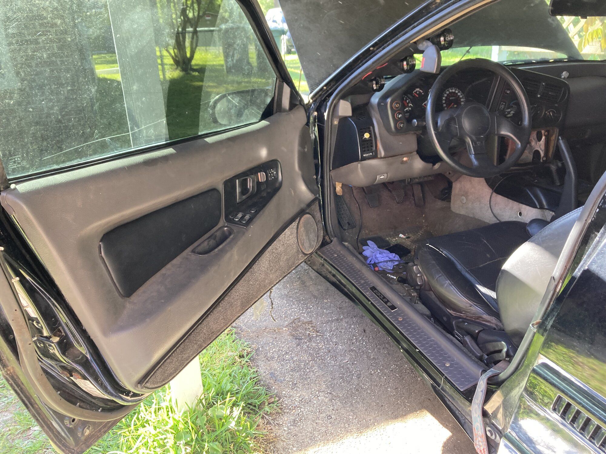

After I got it jacked up, I got sick of the mismatched door cards for the door panels. So I popped them off(and used the missing bracket I got for free from an awesome member here so I could properly tighten the door panel screws), and replaced the little door card with the black leather ones I have laying around.
It's not perfect...but it looks so much better than before, and the door panel is nice and tight. Now the other side.
Pardon the mess on the floor, but this side was a huge improvement. The handle part of the door panel was loose and not bolted in, so I took care of that after I swapped the door cards. Now it's super tight and firm, no rattles. Love it!
Here's the little door cards I removed.
Bleh. They're not in bad shape, they're just mismatched and it always bugged me. So much better now.

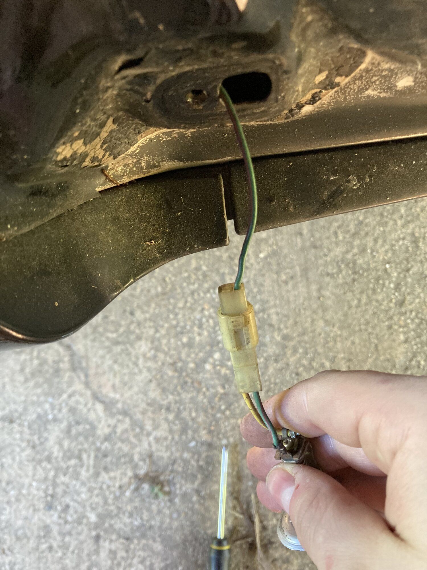

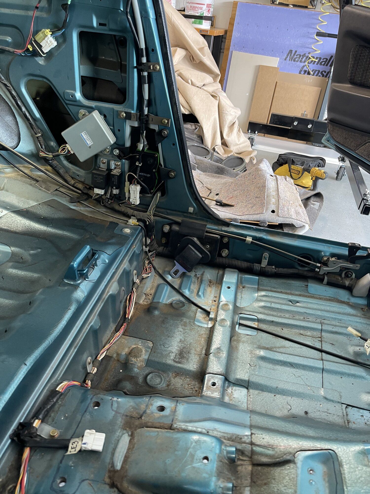

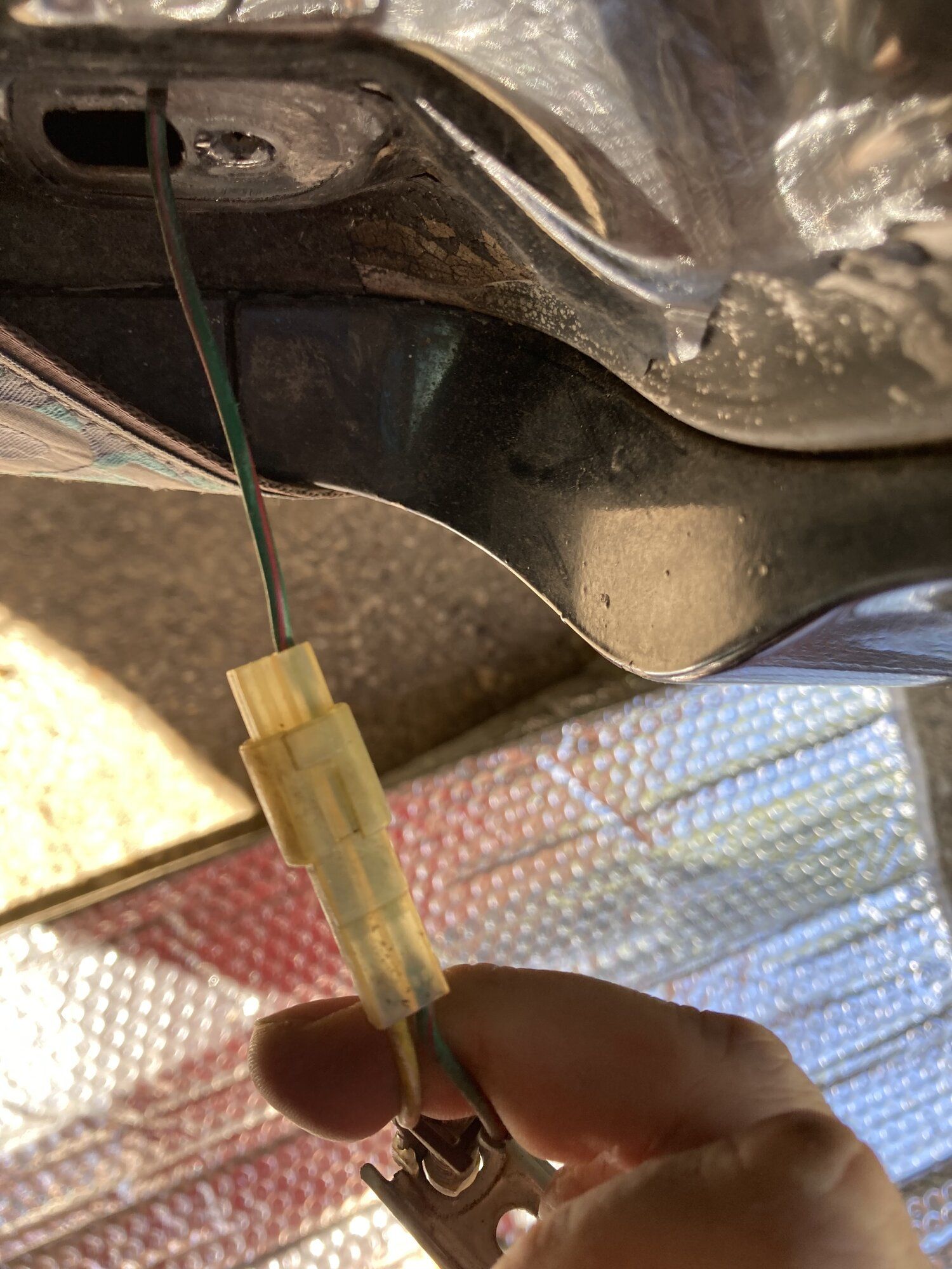

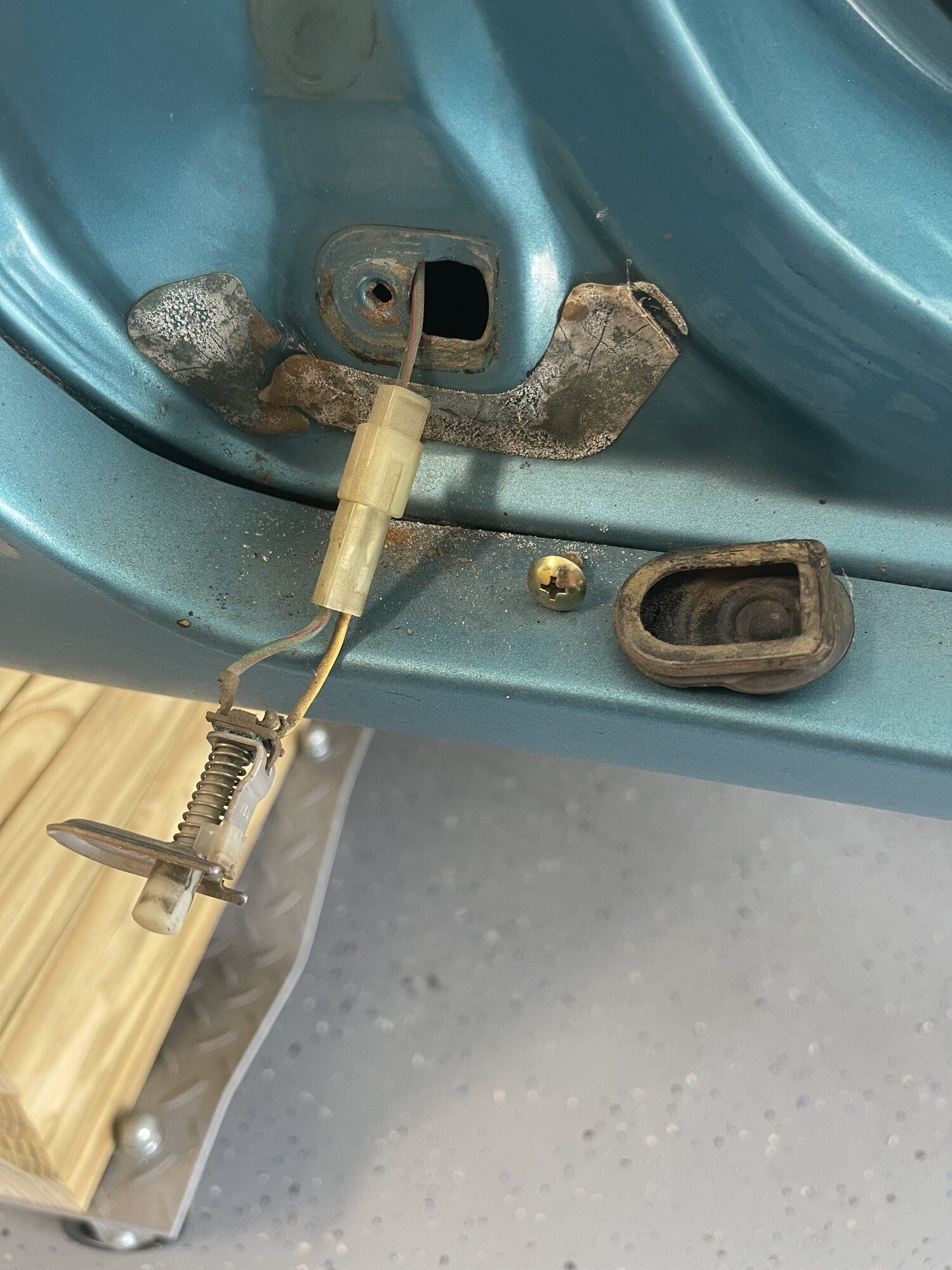

Also, the last thing I did was pulled the little door switch on the bottom of the door frame, to see if the harness was still connected. When I did, I found this on both sides.
Is there only supposed to be one wire or am I missing something? It really seems like everything is plugged in but the automatic seatbelts still don't work. I also don't get a seatbelt warning light with no seatbelts clicked in, or any kind of buzzer. Anyone got any ideas? I really want these things to work.
But yeah, now that it's jacked up and ready I can attack it piecemeal little by little. Super nice!
That's the dome light switch and exactly how mine is wired too. Needs a good chassis ground.
Auto seatbelt is in the door latch.

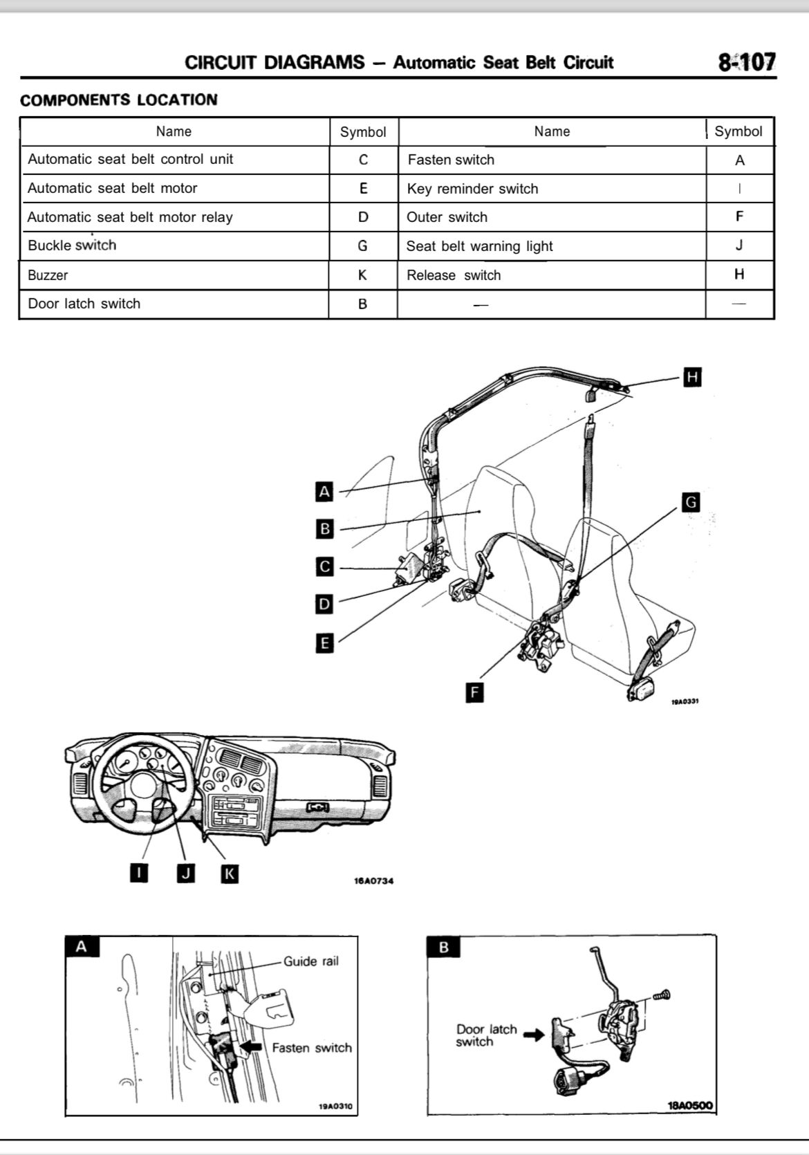

I know it's asking a lot...but does anyone have pictures?
There's a couple pics of the door latch switch at the bottom of this thread:
At first he thought it was the dome light switch too.
I distinctly remember those plugs in the door, and they were plugged in. I’ll dig further.

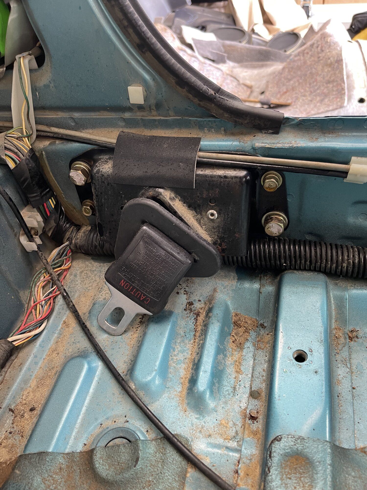

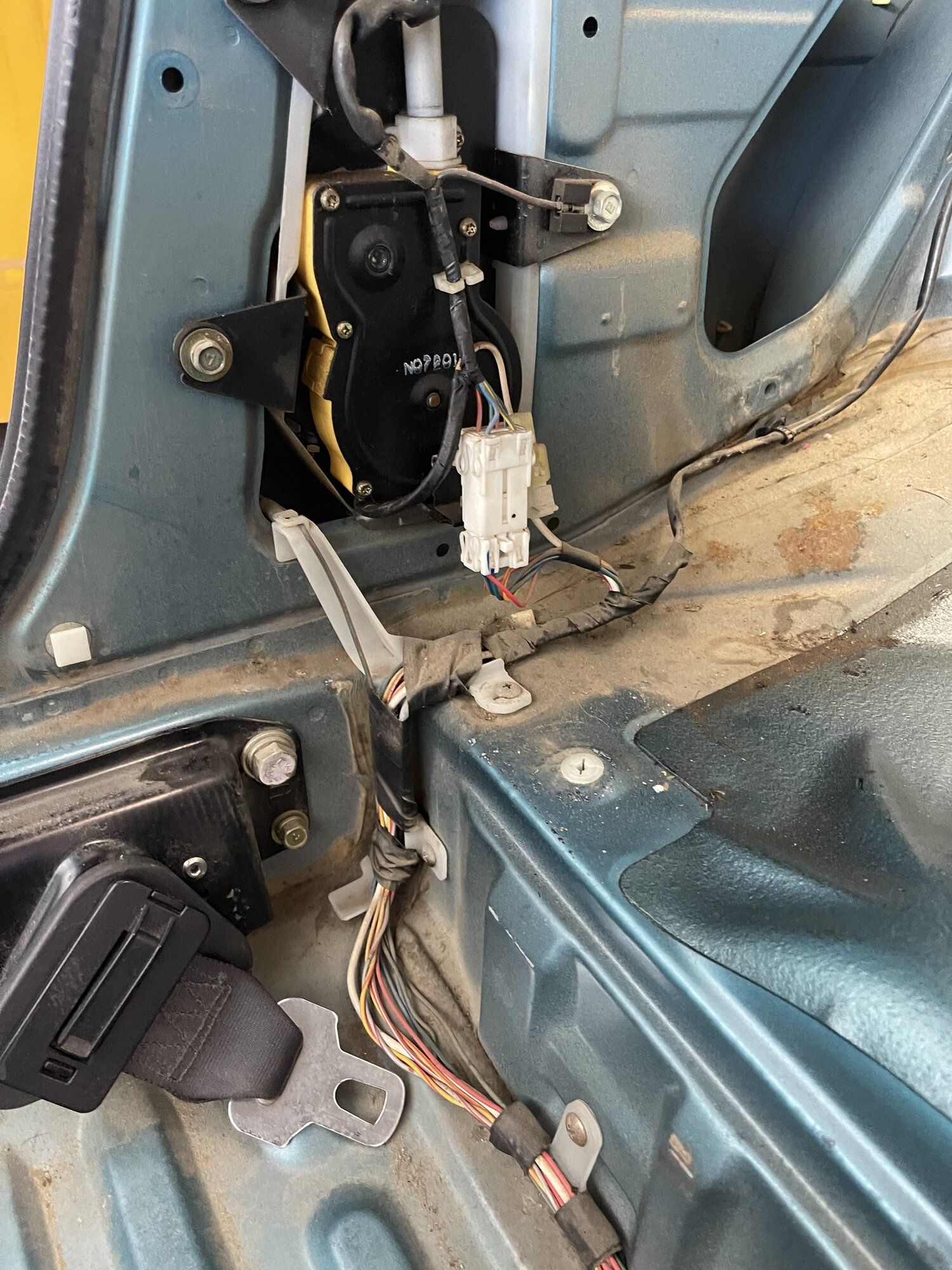

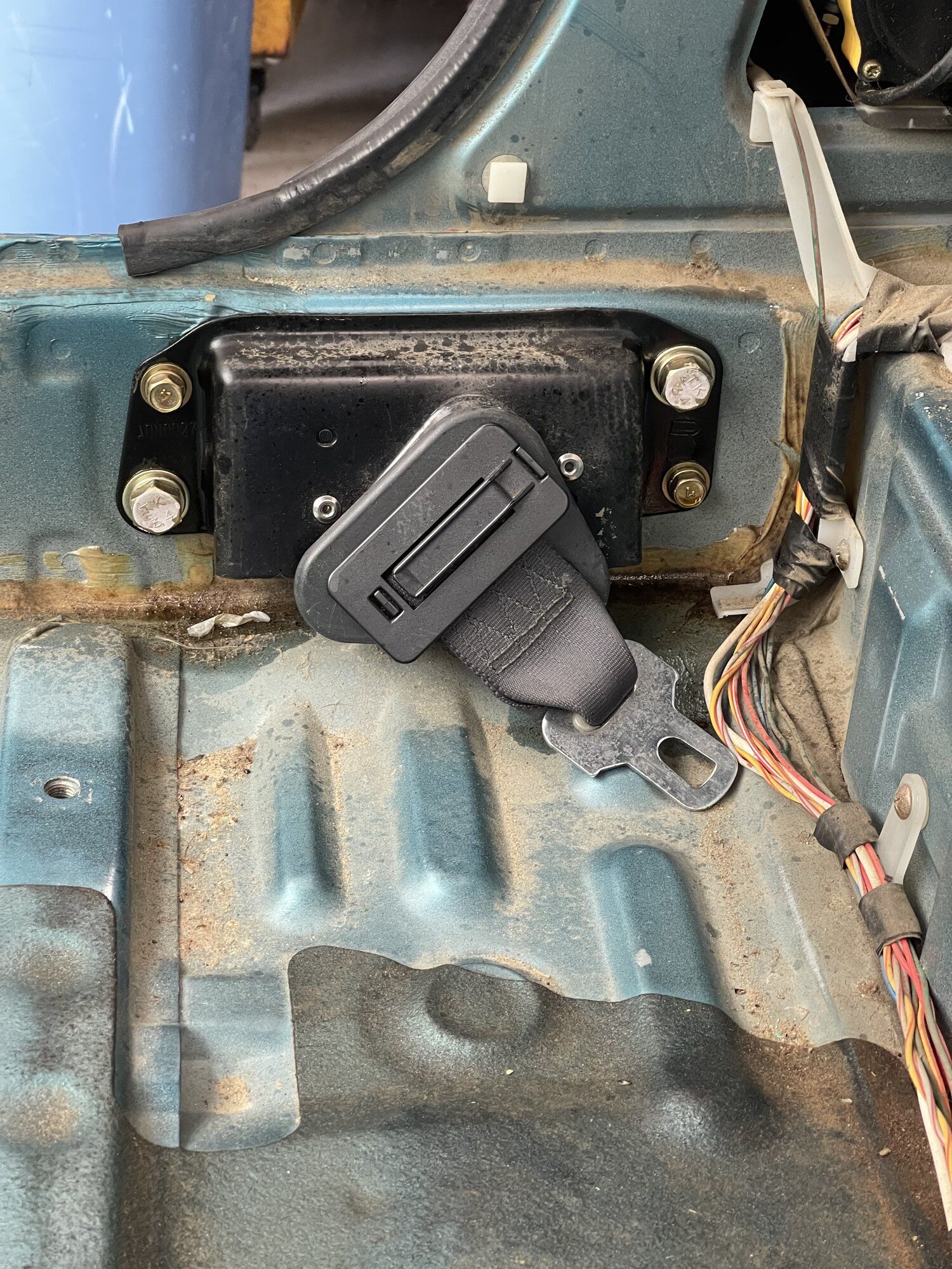

What’s weird is when I opened the passenger door for the first time with the battery installed, the auto seatbelt retracted/opened. So it sensed the door opening. It just has never sensed it closed.
Idk what it could be if the door sensors are fine. I really don’t wanna trace all the wires all the way LOL.

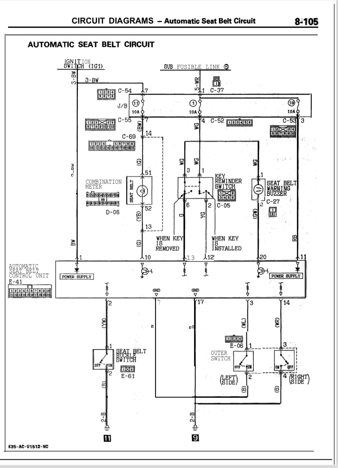

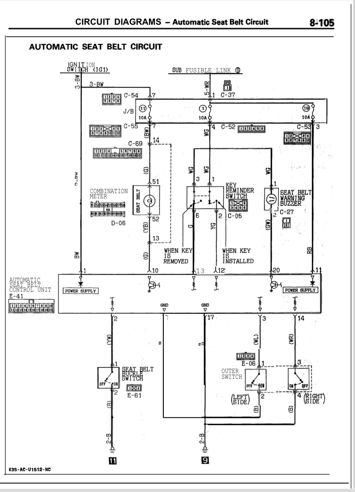

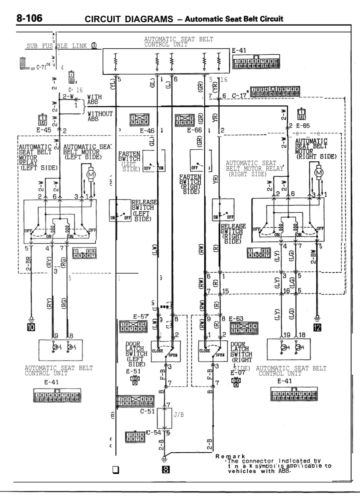

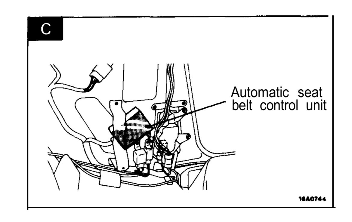

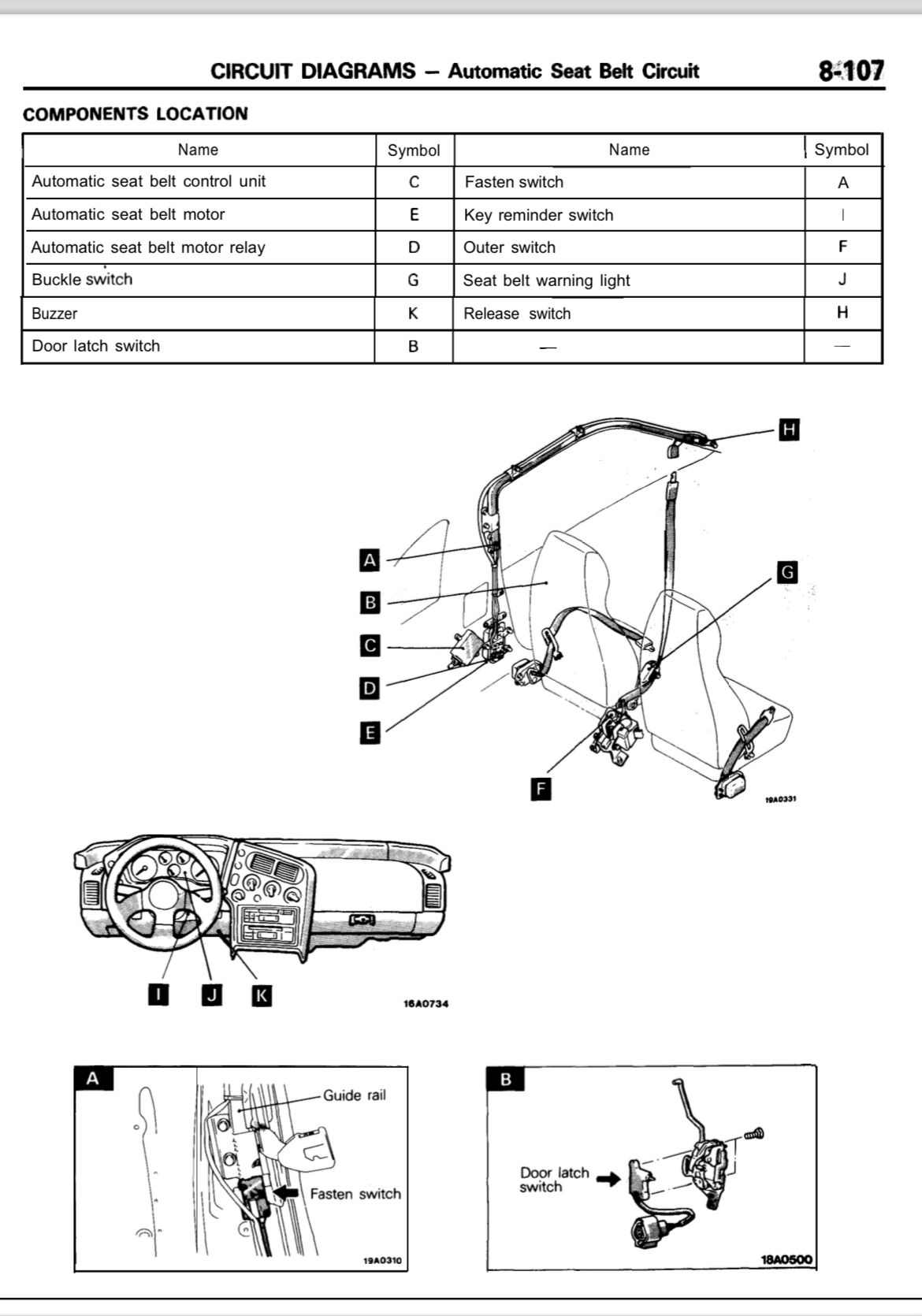

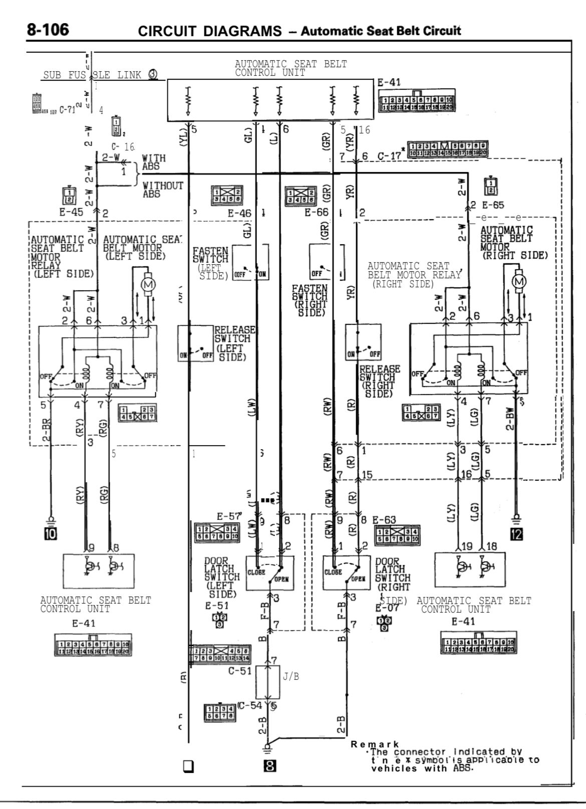

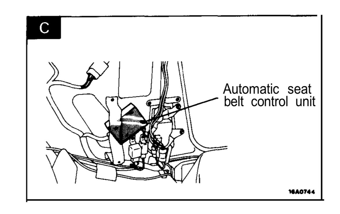

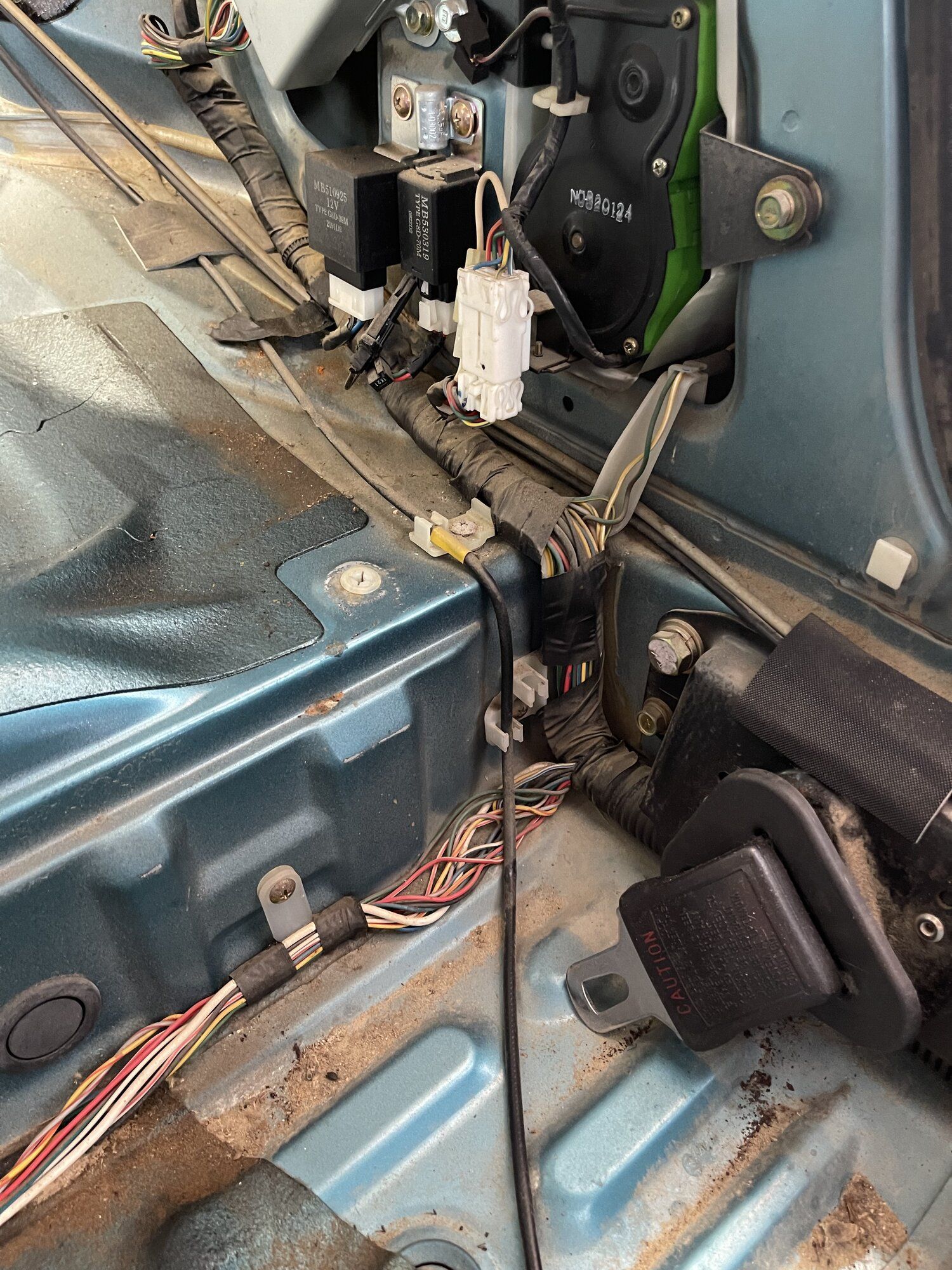

Does anyone know if there’s a relay or something that controls the functions of the auto belts? Or if I can jump a wire to test the actual motors functionality? Because it’s both sides.
Both seatbelts need to have the key in the ON position and sense that the corresponding door is closed for it to fasten. The driver side will retract with removing the key or opening the door, where as the passenger side will only retract with door open.

Is there anything else that’s not working that would be indicative of a blown fuse or bad seatbelt control module, such as the key reminder or seat belt buzzer?

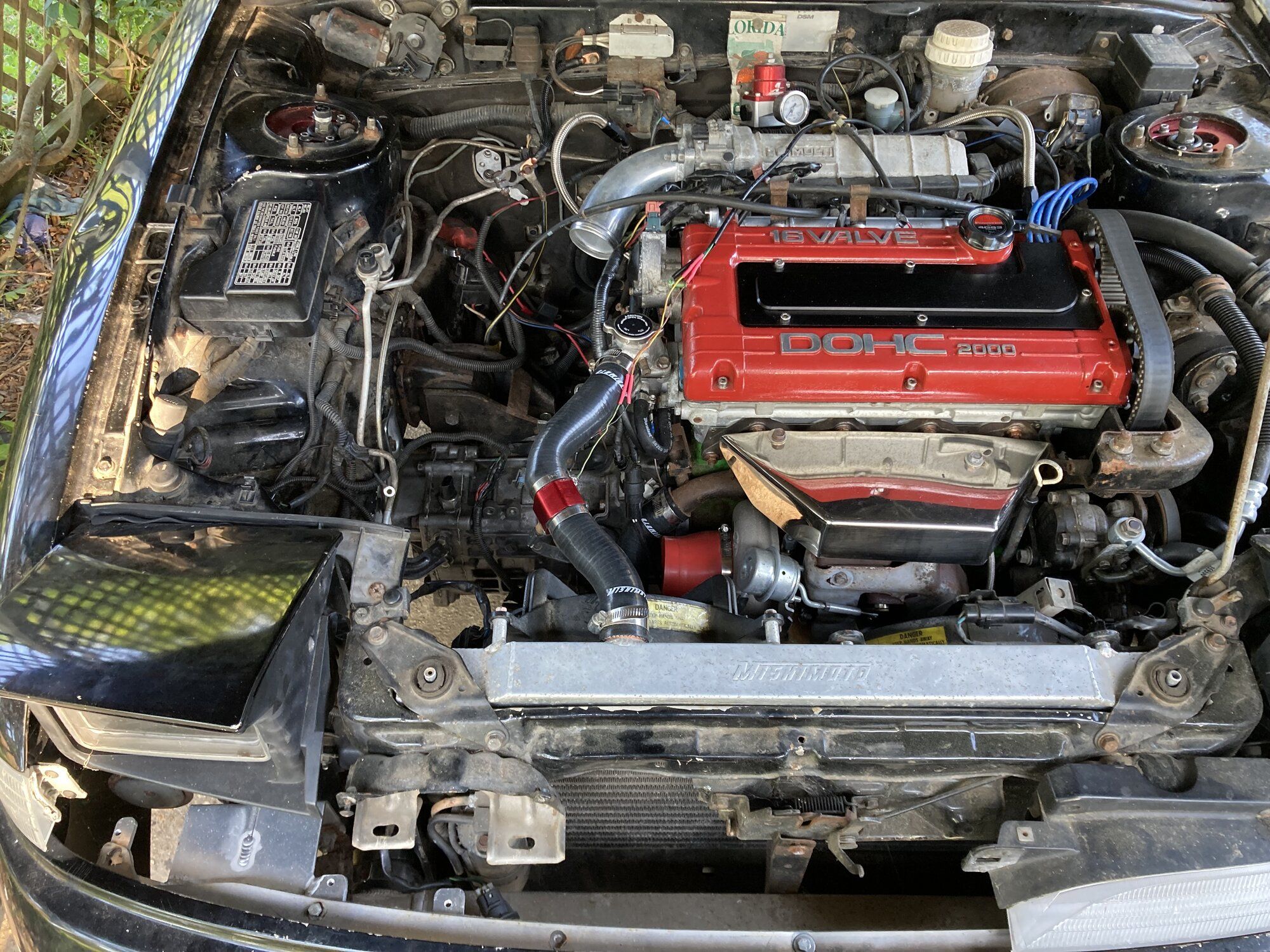

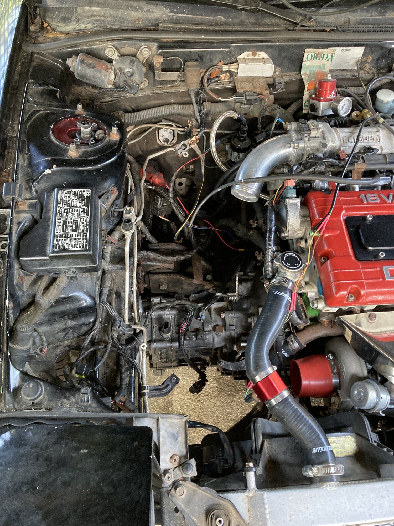

Operation Slow and Steady is going swimmingly.
Removed the battery, battery tray, intake, UICP, starter, and shift cables.
Woot. Gonna chill for the rest of the day, take my time and pull the trans at my own pace. So far so good. Tomorrow I might do more, might not. We’ll see.

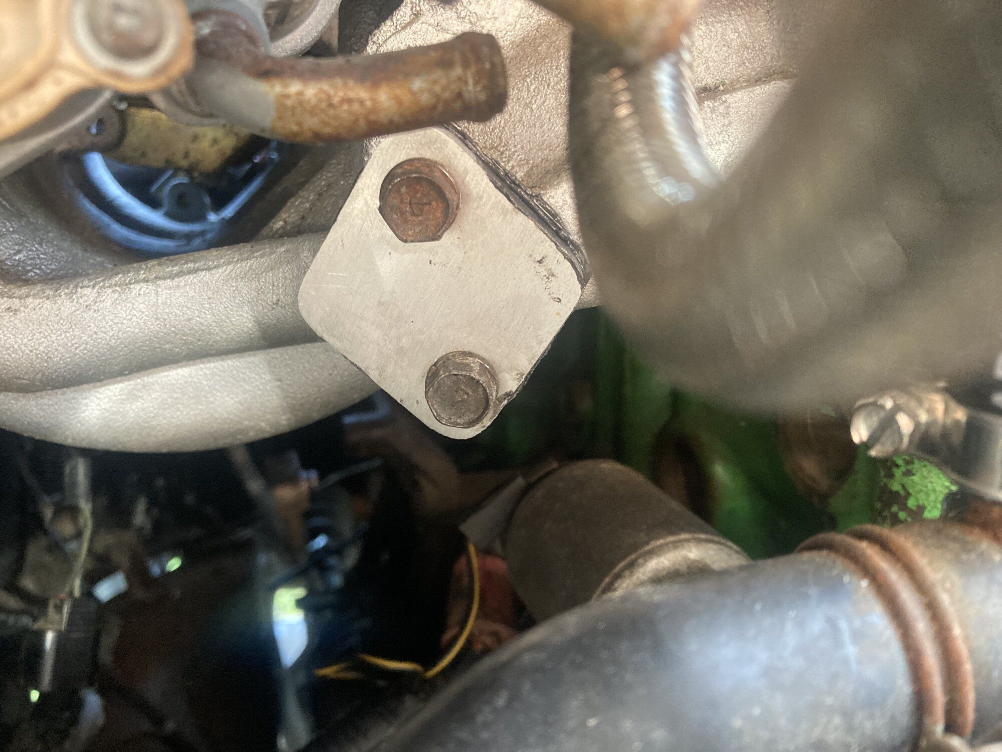

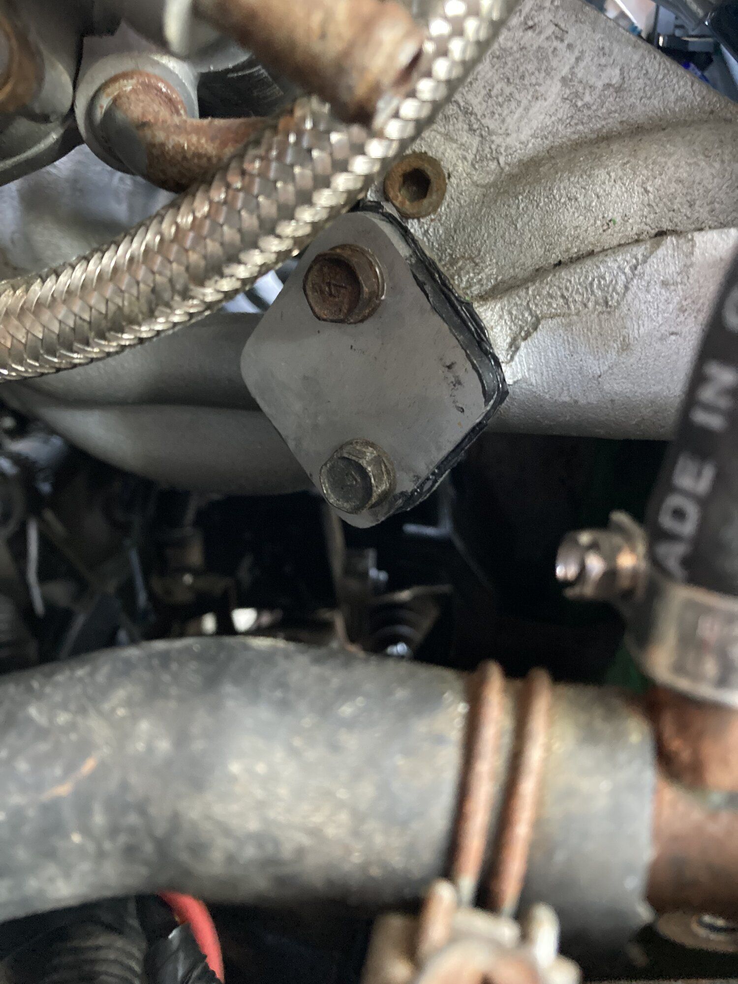

While I was here though, I decided to install my EGR block off plate I got from performance partout. Glad I did this because there was no gasket there, so that had to be a leak.
Yeah I high temp RTV’d over a cut up Coke can gasket, and no I’m not a little bit ashamed. bi*** should hold 65lbs of boost. (Sarcasm)
But yeah. Pretty happy with my progress. Nice easy day.
