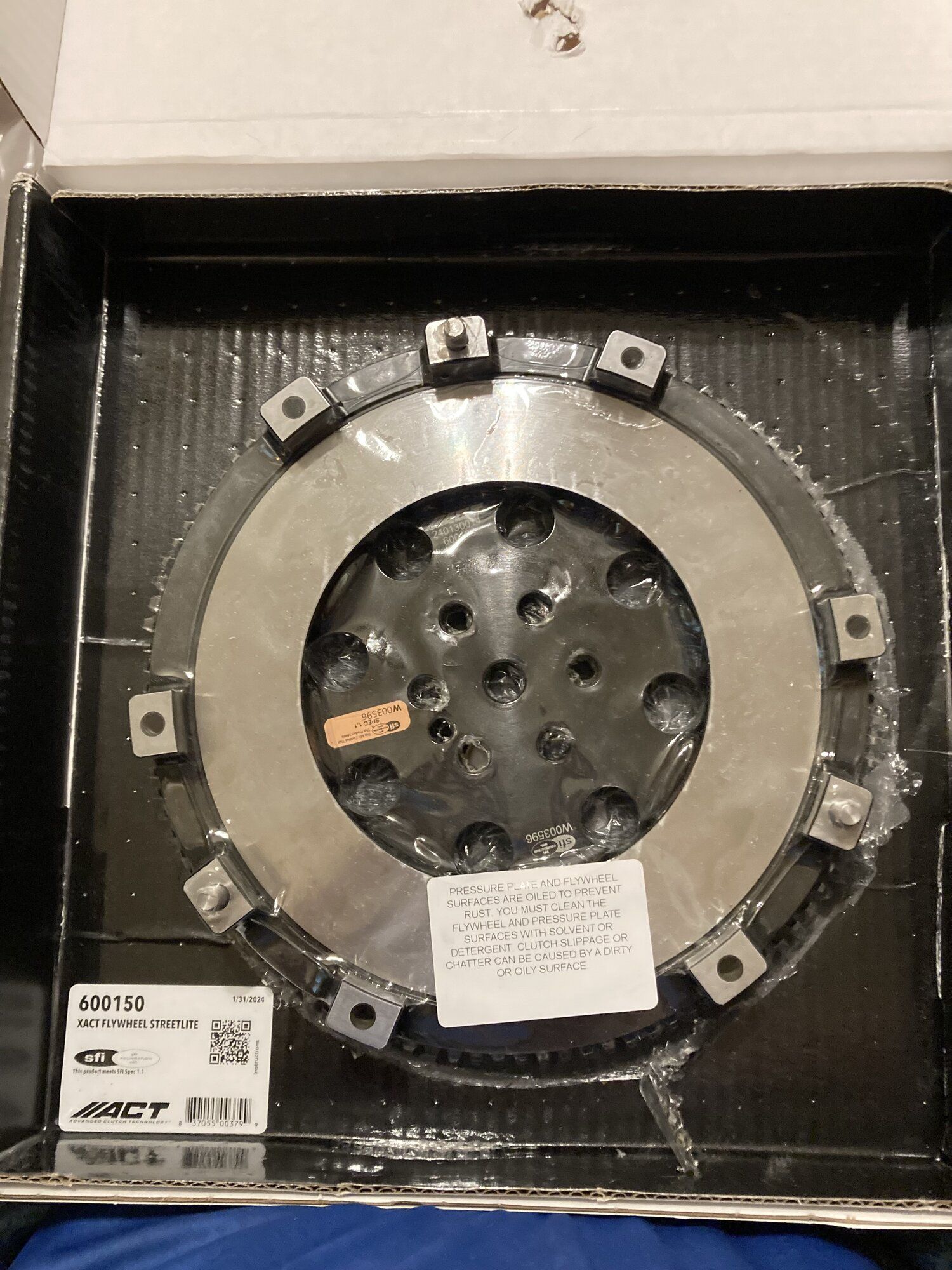

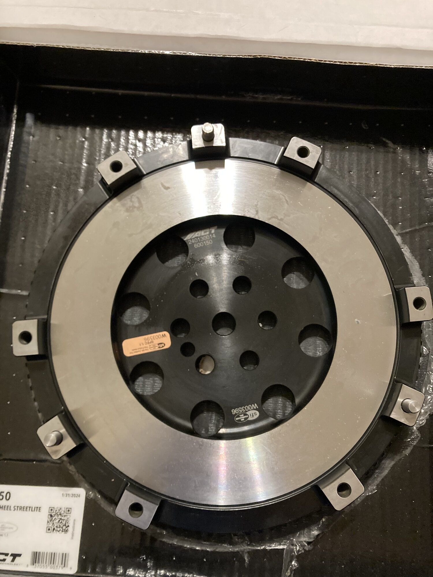

I gotta say I’m not hating on South Bend at all, I love the clutch, smooth engagement, holds torque, and I admit the fault is probably on my end, but after the headache of pulling the pedal assembly and rebuilding it and fixing the slop, several bleeding sessions and still fighting clutch drag it IS a drag LOL, but I’m gonna try one more time with this next oem master, bleed like always with it adjusted all the way OUT (away from firewall) then thread it in for more pressure/engagement and bleed it some more, if that doesn’t do it then I’ll either try the extended slave or a bigger master cylinder :)
Woohoo. It’s so new and purdy.
Not sure if I’m gonna install it this weekend or not. I hate dropping this f*cking transmission. Lol. But it’s nice I have it.

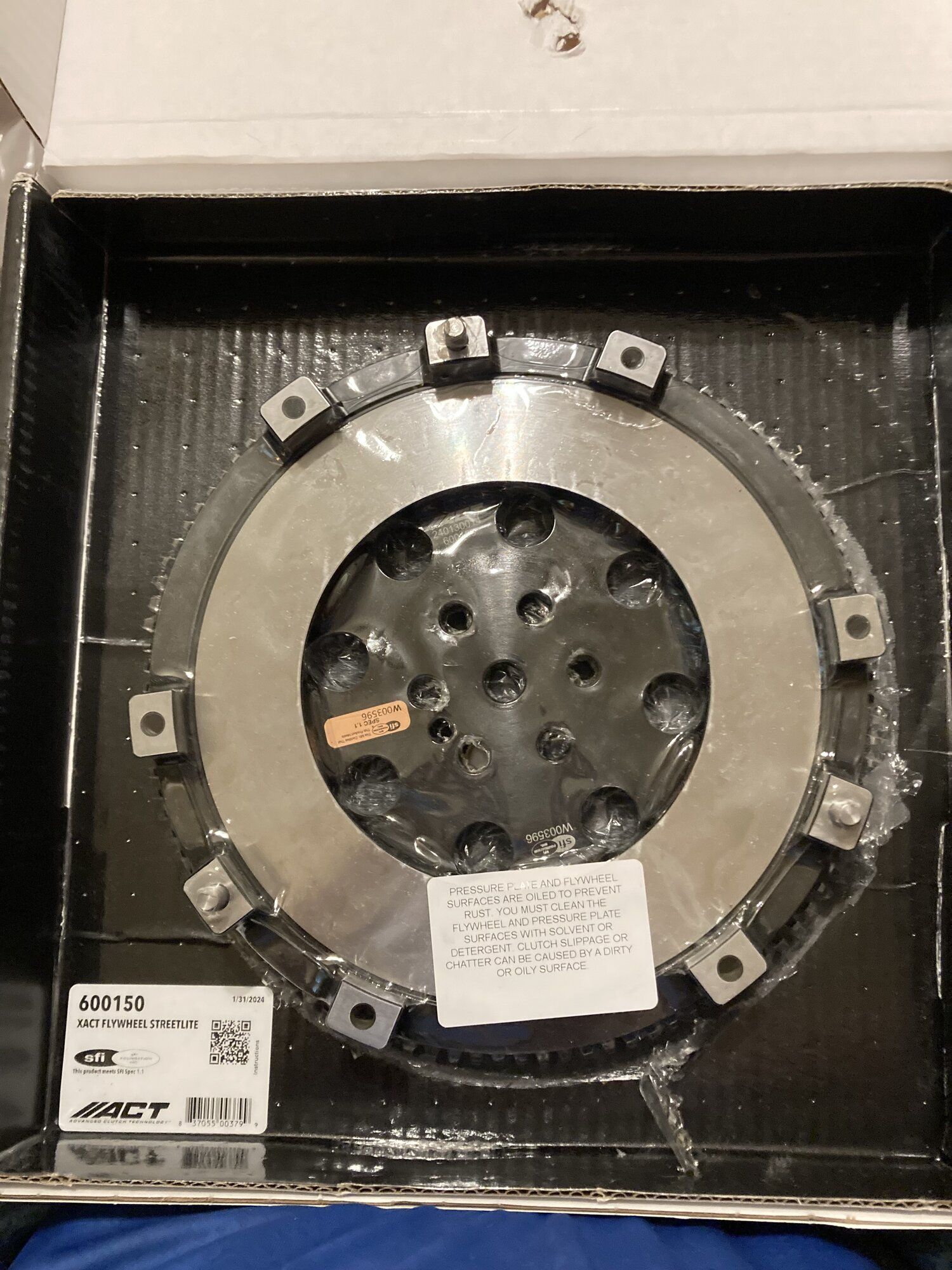

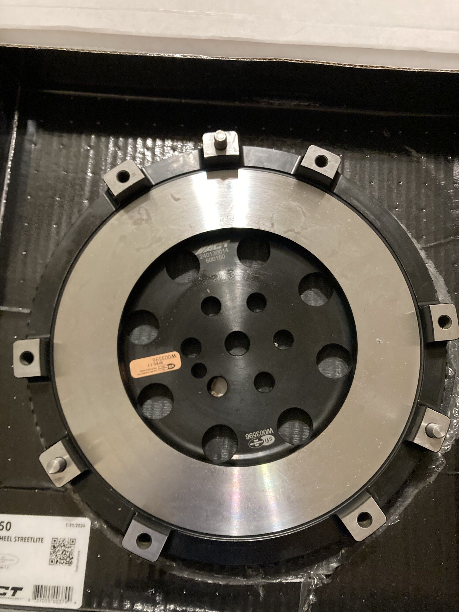

Measure it. Whether you change it or not measure it so you know what it is.
That’s why I had it shipped to Tim Zimmer. He measured every single bit. It’s .608” everywhere.

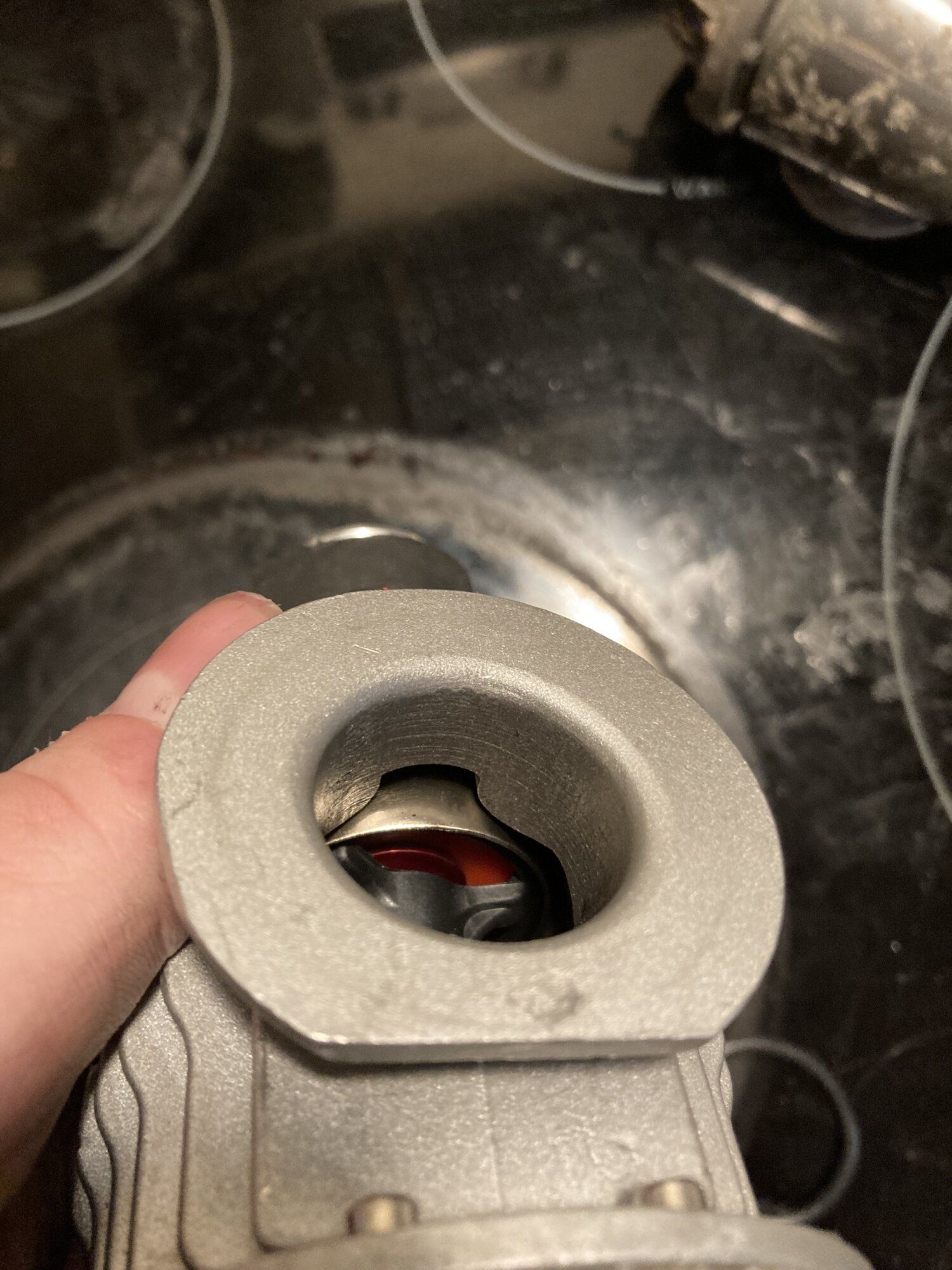

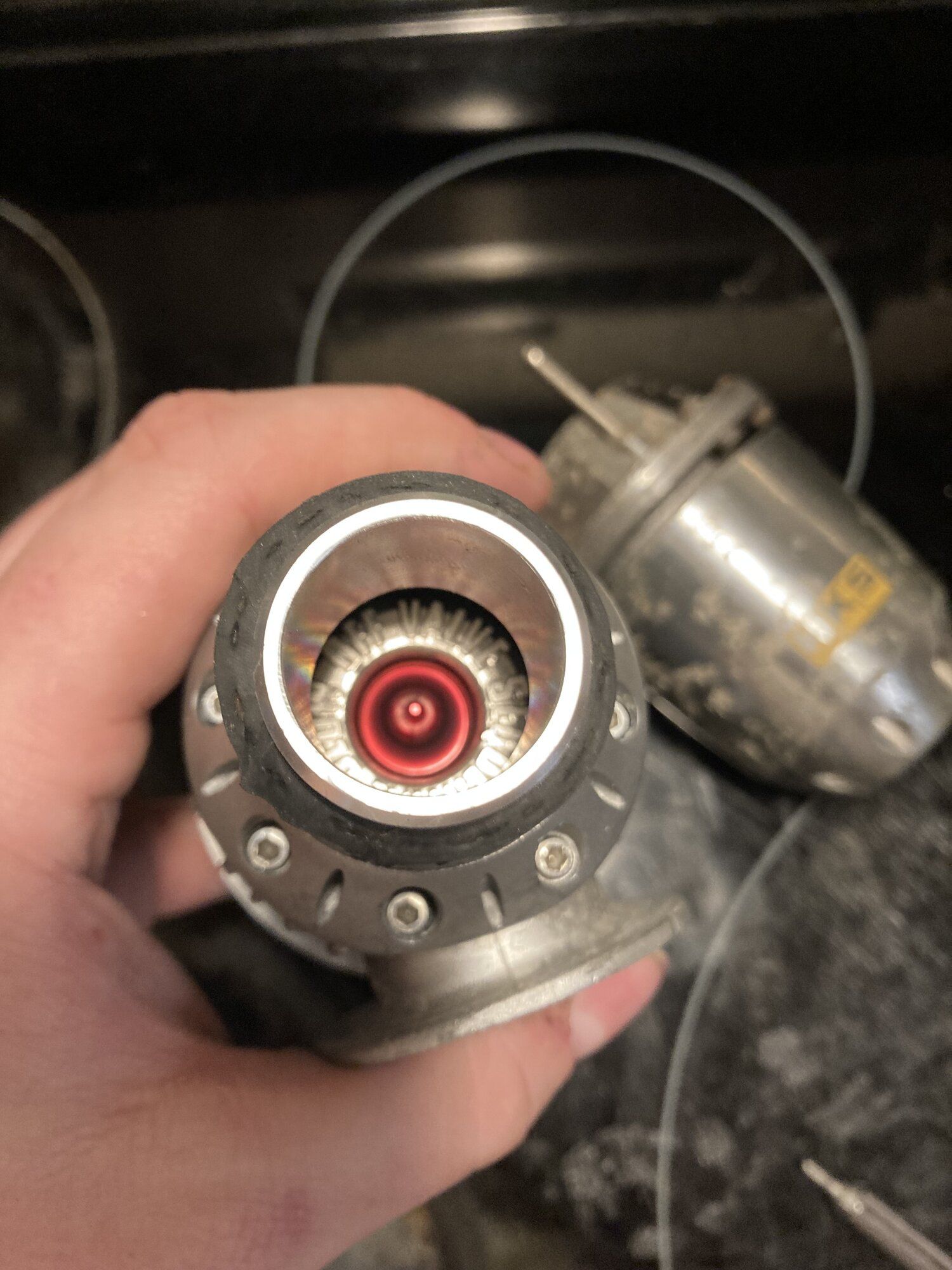

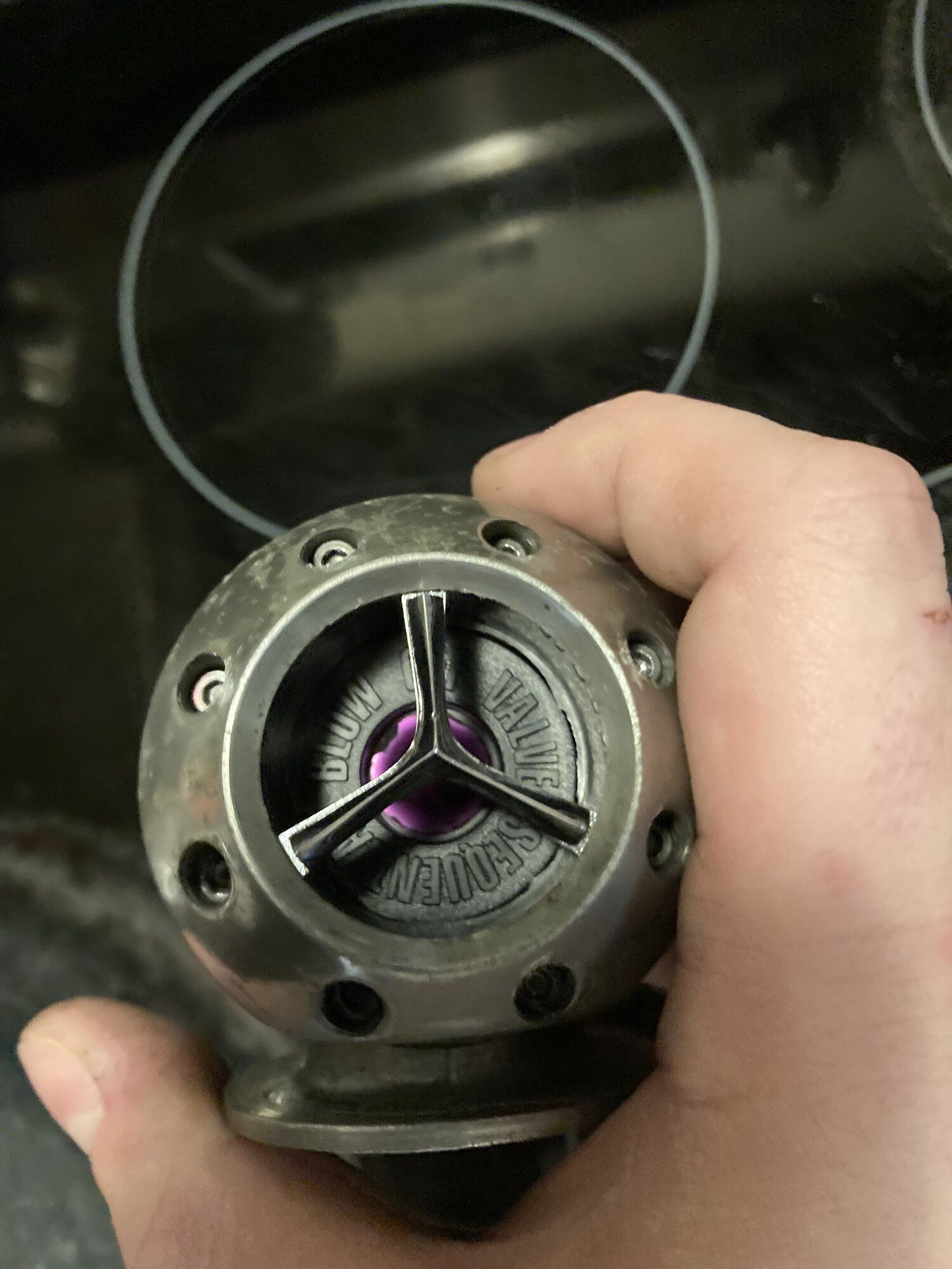

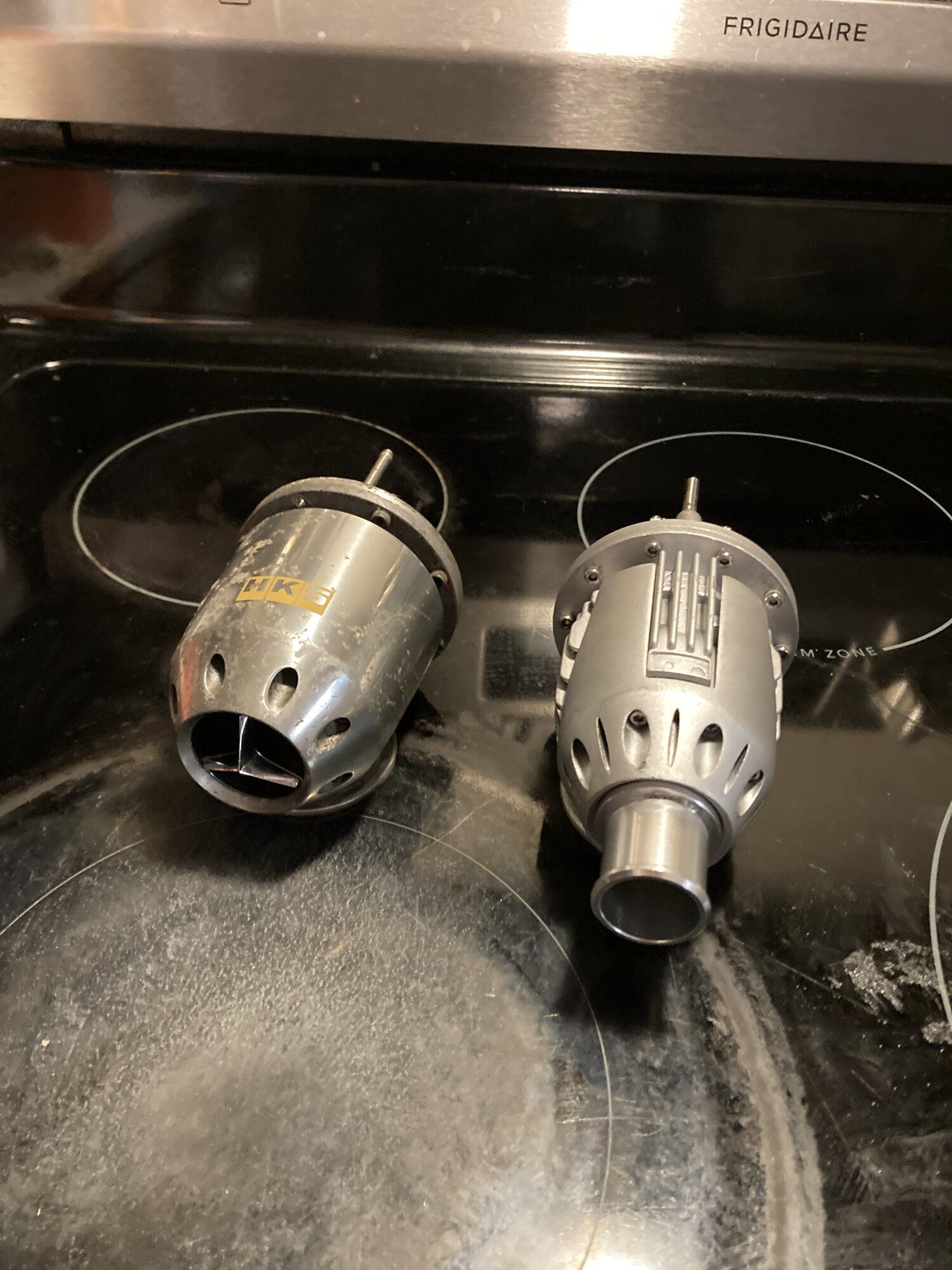

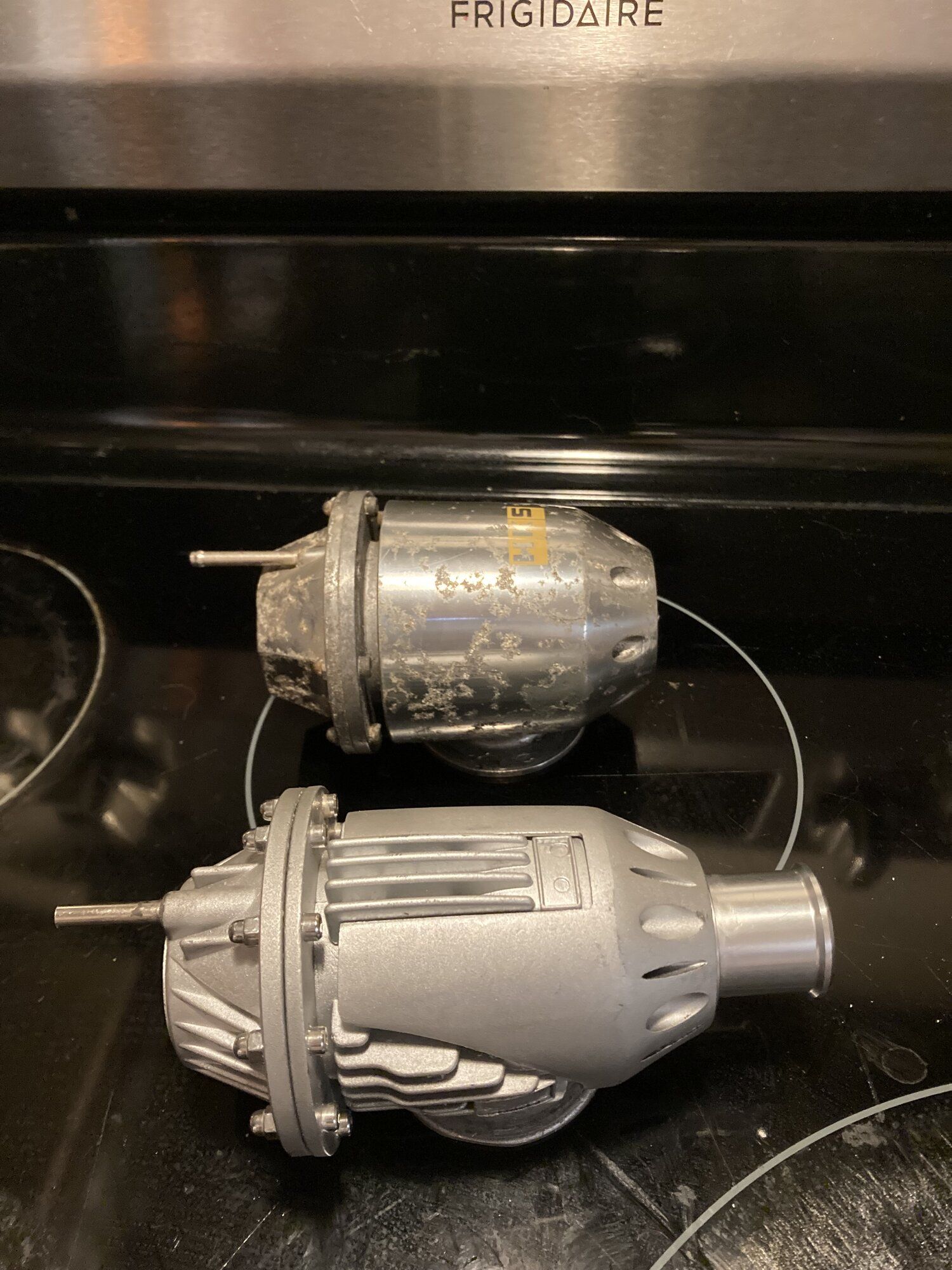

But in the meantime, I scored an SSQV IV for $35 locally. I bought it thinking it was fake so I could rob it of it’s oem fin, but did quick research when I got home after he included what appeared to be real HKS instructions, found out it’s real! Legitimately was stoked. It's got a tighter piston/spring, and it's way cleaner in appearance. So I quickly swapped the fin for my recirc fitting, and popped it on.
Comparison of old SSQV(that I honestly think is a knock-off), to new SSQV.
Old
New
Old
New
And here it is in the bay. Honestly think it looks so much better than the corroded old half-eaten away polished one. But can I just say, getting that c-clip in there properly and tight is a B*TCH. Using a long, thiccc flat-blade screwdriver to press down on the back while you press on the front with c-clip pliers is how I got it in there nice and tight like.
Kinda cool man. It also came with two flanges, both of them look like they could be used on a 2G DSM to bolt on an HKS Valve. One is 34mm and the other is like 28mm. Gonna keep them, just incase I need them or whatever. But for $35 it was a steal IMO.
