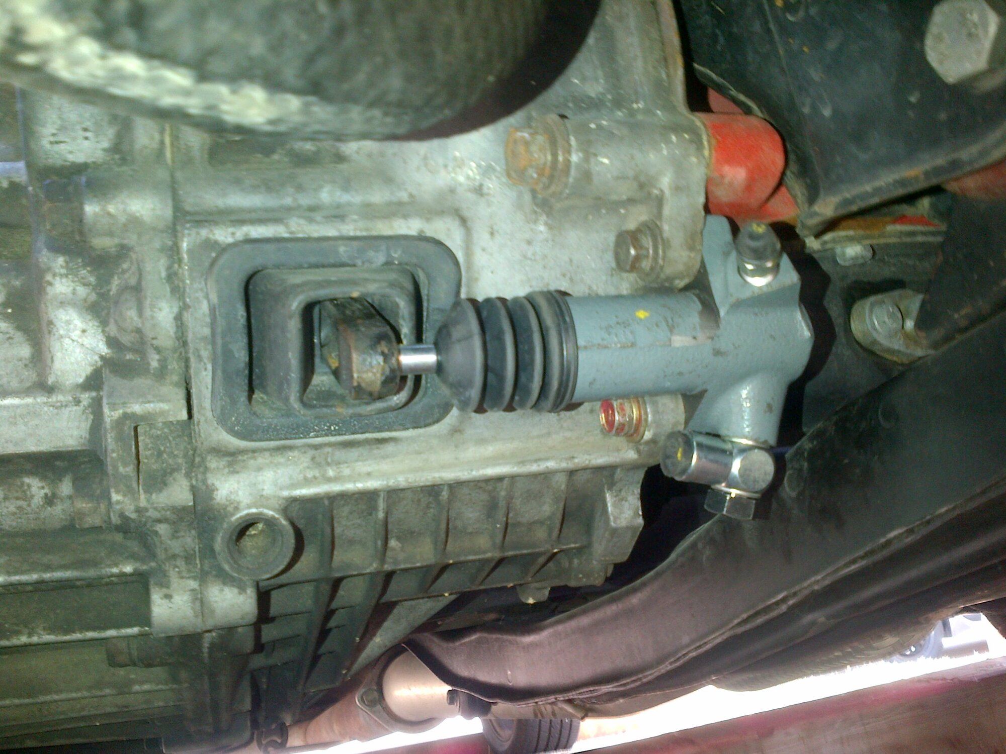

Damn this is a good idea. I’ll try that tomorrow. I may go get a smaller set of prybars because these screwdrivers I have are as sturdy as a limp noodle.
This has been my only method for 25+ years. Haven't had one stuck yet.
Honestly it’s just weird. All the times I did it before it was minimal to no effort. I have no clue what changed between then and now. Only guessing that it’s fluid related but now this trans had fluid in it from day one.

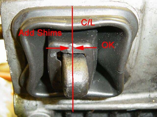

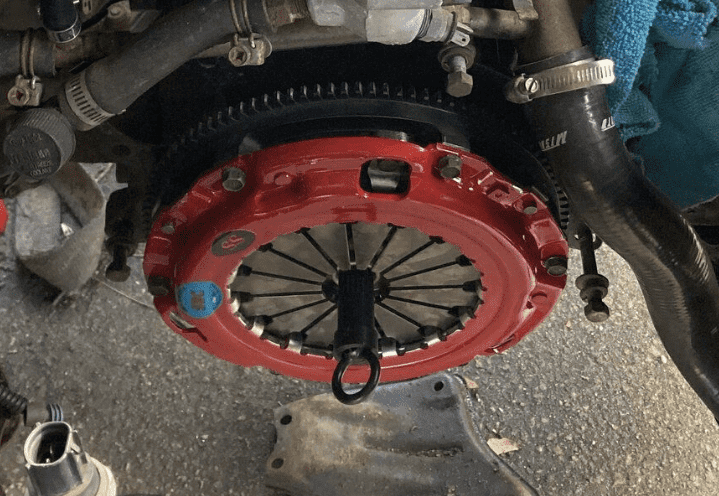

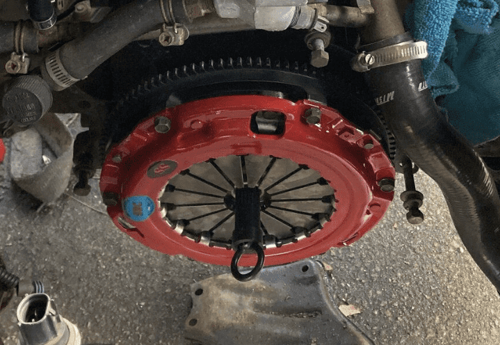

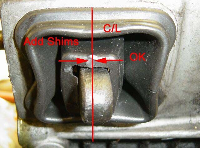

This isn't a pivot ball shim problem. It's either a step height or clutch disc issue. Most likely the step. Notice how the PP fingers are nearly flat or even concave? They should sit a little convex (pointing outward). It will never release in this state, no matter how much you shim it.
i agree, as flat as they are, good chance fingers hit the disc before it gets fully released. There is also as good of chance that the disc is junk too since trans was put in on a jack.
It's an interesting issue. Everyone gets all bent out of shape if the step height is off 0.005" or something, and most can't even measure that precise to begin with. Next up how much does it even matter when most of these places ship the same PP with discs that vary 0.030" or more in thickness. Or even better when the pp is warped 0.060" after a few launches.
Step height is not a set it and forget it thing. It varies depending on the clutch, and every clutch should be checked, adjusted, and setup independently. It's really the only way - it's not hard, it just takes a little time, but so does pulling and installing the trans for the 80th time and keeping guessing at why it won't work right. I set them up so that with a new disc they are just past peak clamp load, and will wear into peak. Usually results in the fingers being just slightly up. Remember it's a system and everything effects everything. If you want to toss it in with minimal care and have it work, best be finding an NOS pressure plate/disc/flywheel.
Another point to add. Clutch guys should specify a finger position, not a step height. My tilton carbon comes with a check gauge. sets across the face of the pp. If the fingers don't touch one side, too low - install thinner pp (deeper step height basically). If they touch the other side too high - worn install thicker pp ( less step height.)
I’ll give it one more try and if it still doesn’t fully release I’ll just throw either a stock flywheel in it or find someone to check the step height on this one.

Transmission has been dropped, and put back in with new shim on the ball. In person there is a slight concavity outwards of the fingers. They’re not super flat like the picture shows. But time will tell if this is fixed or not. If not then I’ll just buy a new flywheel from Tim Z that he’s checked and verified step height for me.
But I just want to take a moment and thank you kurt/ @bastarddsm for your input and help. It is appreciated, as well as everyone else who has offered advice and tips.
Also the transmission will drop out with the passenger axle still in the trans. Once it was out, it popped out easily with a flick of the wrist motion. Go figure.
Alright, trans was dropped, pivot ball was shimmed, and trans reinstalled. Axles reinstalled, shift cables hooked up, trans filled back with same fluid again, t-case is on and bolted, etc. The only things left are install UICP, install battery, and install intake/filter. The pivot ball is perfectly where it should be, so if this doesn't work I'll just buy a proper flywheel that's been checked already before purchasing, and do it all again. Lol.
But I'm getting pretty good at this "dropping and reinstalling" transmission business.
Shimming the ball did not fix it as some of you knew it wouldn’t. Flywheel is improperly stepped, again as a lot of you knew.
I’m fu*king bummed to say the least. But time to order another flywheel that’s guaranteed the correct step height. I was gonna buy one anyway when I bought the clutch but decided against it. FTL.
You called it brother. Even after shimming the ball perfectly it still isn’t enough to fully disengage the clutch. Flywheel is 100% to blame.

Sooooo. If someone was to theoretically use a red scotch-brite disk on his milwaukee drill on the flywheel to remove the surface rust on his theoretical flywheel...would that theoretically have removed too much material and caused the step height to now be screwed?
Theoretically speaking of course. Totally not that I did that and am now wondering why my step height is off on my flywheel.
The step needs to be cut deeper in relation to the PP mount surface.
So theoretically the supposed "scotch-brite disc on Milwaukee drill" could have slightly helped if only used on the friction surface.
Would it have hurt is what I'm asking. Lol. Like, as in "probably caused the current issue".
Not likely unless you were shooting sparks with the Milwaukee
Thankfully it’s not that powerful. Was just really trying to assign blame to myself but I’ll just stick with the “should’ve checked step height somehow” Road.
I have to ask though, if a guaranteed properly stepped flywheel goes in and it still doesn’t fix it…what else could it be? Non-OEM master cylinder?
A leaky slave or master
Incorrect Flywheel hub thickness (too thin) which allows the tob to rest too close to the block
Too fat of a clutch disc (or too shallow of step) causes pp surface to bias to the left, pp fingers to bias to the right/flatten, tob moves towards the block, fork end to the left side of the window.
If you took off material from the flywheel friction surface, you would have increased step. That moves the pp surface towards the block and the fingers go convex and open up away from the block. That moves the tob away from the block and the fork end towards the block/right of the window. Only if you could remove material uniformly enough across the entire surface.
So your efforts didn't contribute to the clutch fork alignment, but it did potentially create a lot of high/low spots that will reduce overall friction and holding capability. Exact amount? Hard to say, maybe negligible.

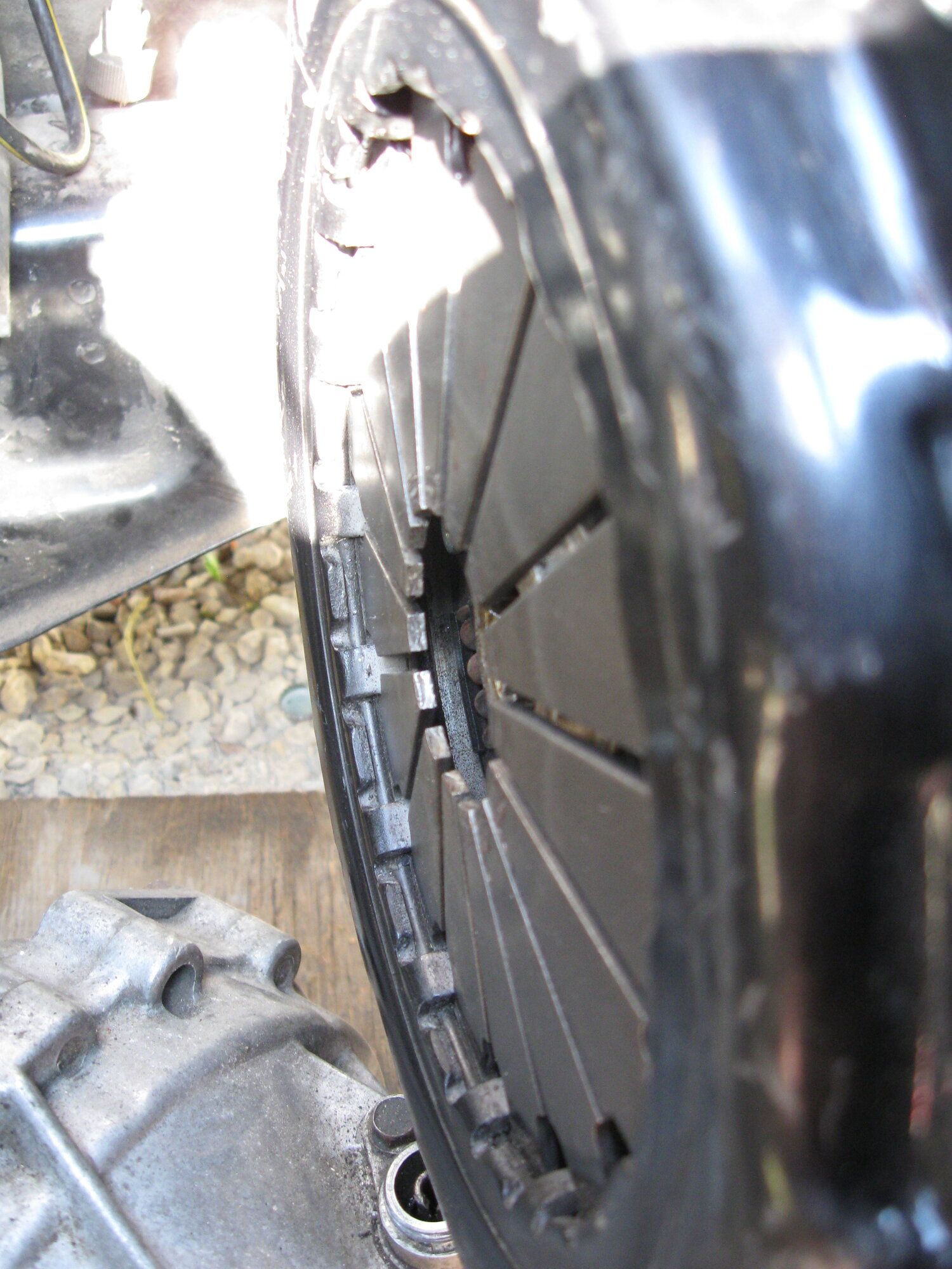

View attachment 728006So it’s NOT supposed to look like this?
That's better than the other direction the fork end could be, yes. That's also why a taller step is better than a shallower step. If it was shallower, the fork end would be to the left as the pp fingers would be flatter.
Think of it this way: as the pp, clutch disc, and the friction surfaces all wear, the fork end will continually angle towards the block. If it was the other way around, the clutch would become less capable of being in a fully released state over time. But we're talking fractions of a millimeter anyway as the components are never staying exactly 100% in the same physical condition.
