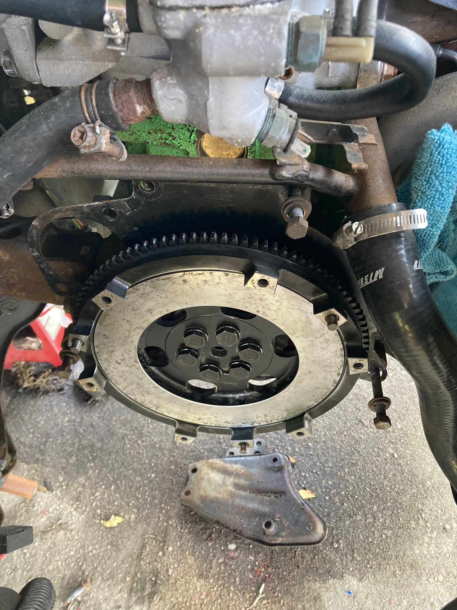

I have to go get my flywheel from the shop before they balance everything so that I can check if mine is also right as well...
Yeah I read that. It's part of what influenced my decision. Lol. The local machine shops around me have a terrible track record with basic stuff, so honestly even if I gave them a how to they'd either just still outright refuse, or screw it up somehow.
But man, the amount of people having issues with ACT Flywheels(including paul volk very recently) makes me worry. I never hear about the Comp Flywheels having these issues even though they're supposedly the same.

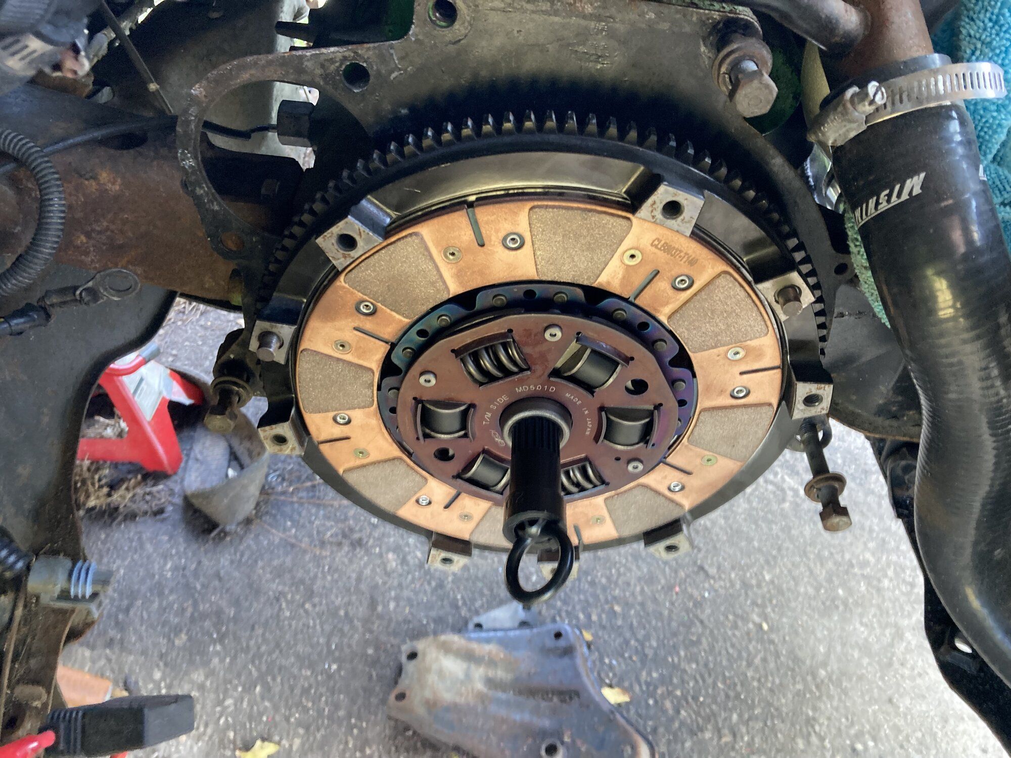

Shoot I wouldn’t hesitate to run that flywheel! I see some staining from rust but no heat marks or anything, I’m willing to bet it’s a fresh surface and just rusted before it got used, however you know my bad habits of throwing junk together just works out in my favor by some miracle.
It legit feels brand new. The PO said it was new, including the clutch kit which was OEM exedy. If you drag your fingernail down it, it feels like a brand new surface. Hard to describe but you know what I mean.
I’m gonna run the hell out of it!
Well, I was determined to get something done today because my thread chaser/tap kit came in, and honestly...I should've bought one of these years ago. WD-40 soaked for a couple days and a good chaser makes short work of old red loctite. Like it was never there. Bolts thread in and out like butter by hand.

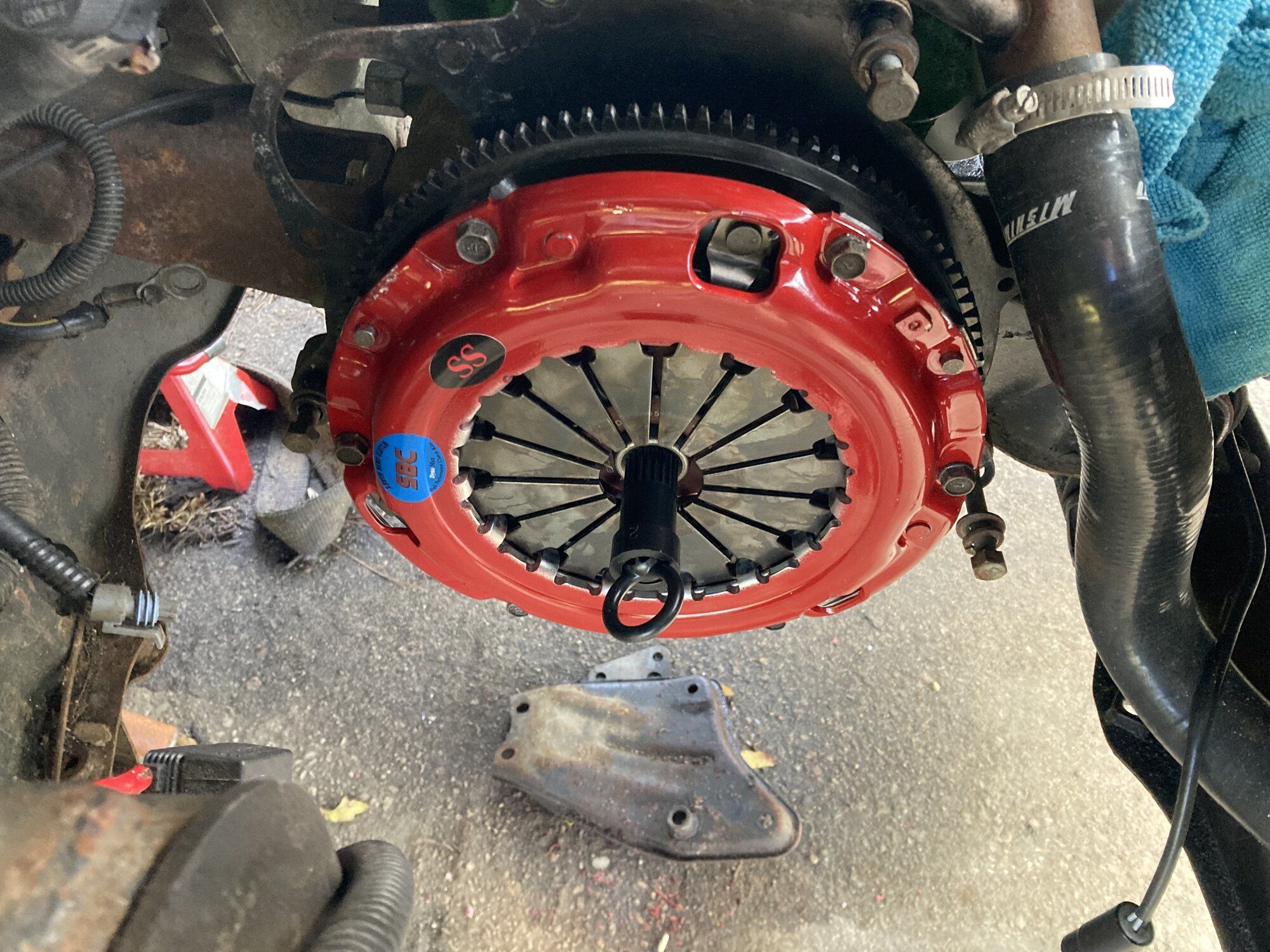

All torqued up and pretty. Little dab of red loctite as it should be and 100 ft/lbs.
Kinda sad this is the last time I'll see this(hopefully) in this condition.

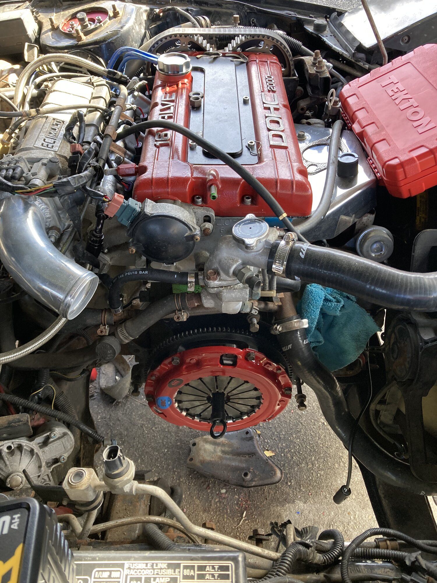

I am so in love with how the pressure plate color matches the valvecover. Like it's meant to be!

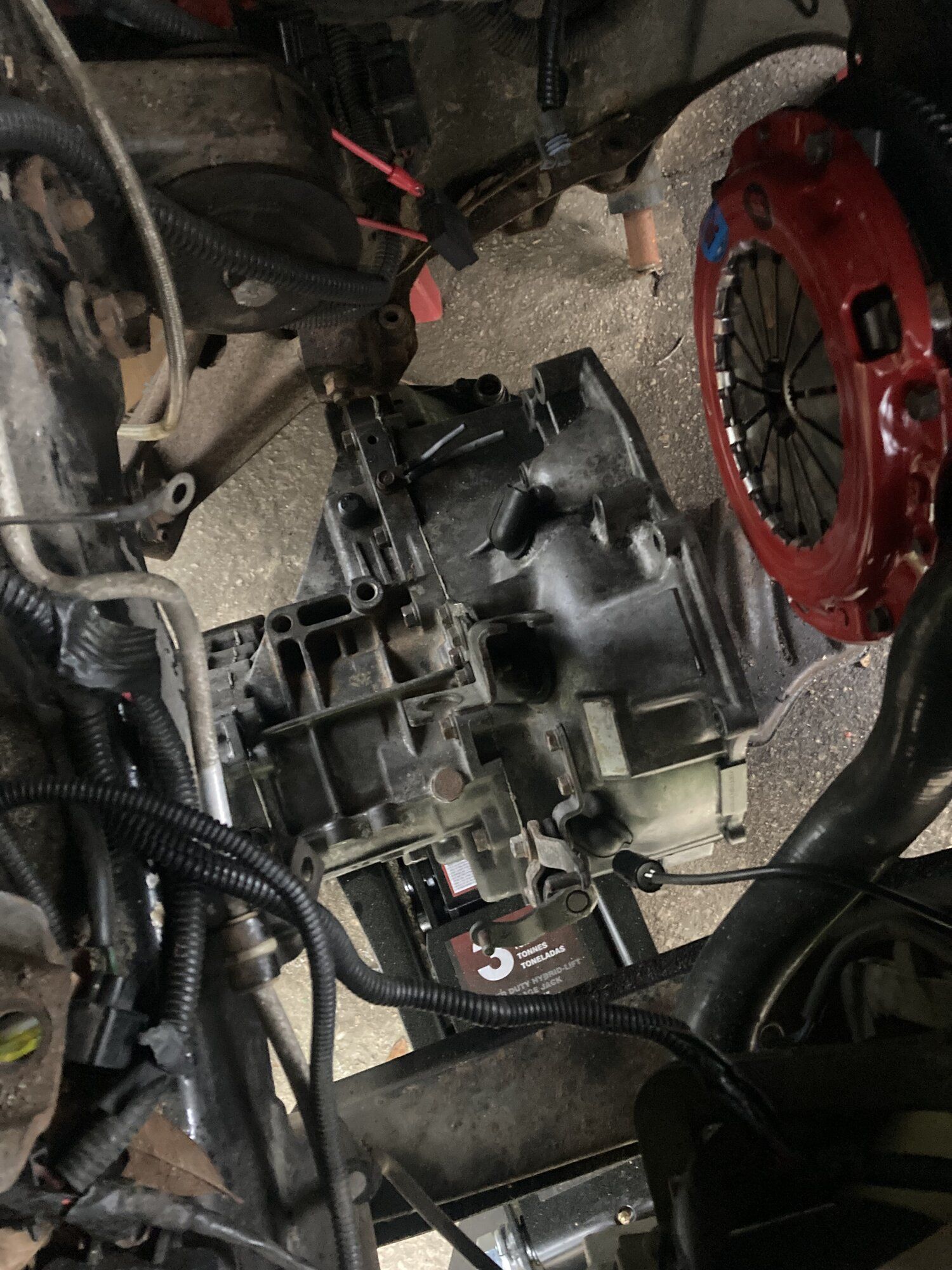

All torqued down to 14 ft/lbs and looking pretty. I'm still waiting on shifter parts, but next day off I have I'm gonna stab the transmission in, and get literally everything torqued and bolted down, filled with fluids, and ready to go. I can still bleed the slave and test it out even without a shifter. So excited and motivated, man.
Looks good! I thought pressure plate bolts were like 22-24ft/lbs? Maybe not it’s been a minute :)
I don't think 22-24 would hurt, all I could find is the service manual says 14 though. I was curious if I should red loctite those bolts too, but decided against it.
If a wiseman has otherwise to say, lemme know. With the clutch still easily accessible I can fix it asap.

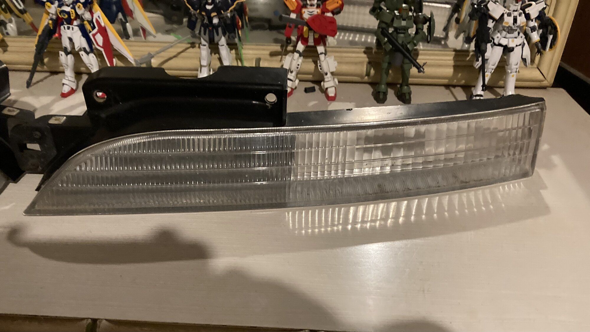

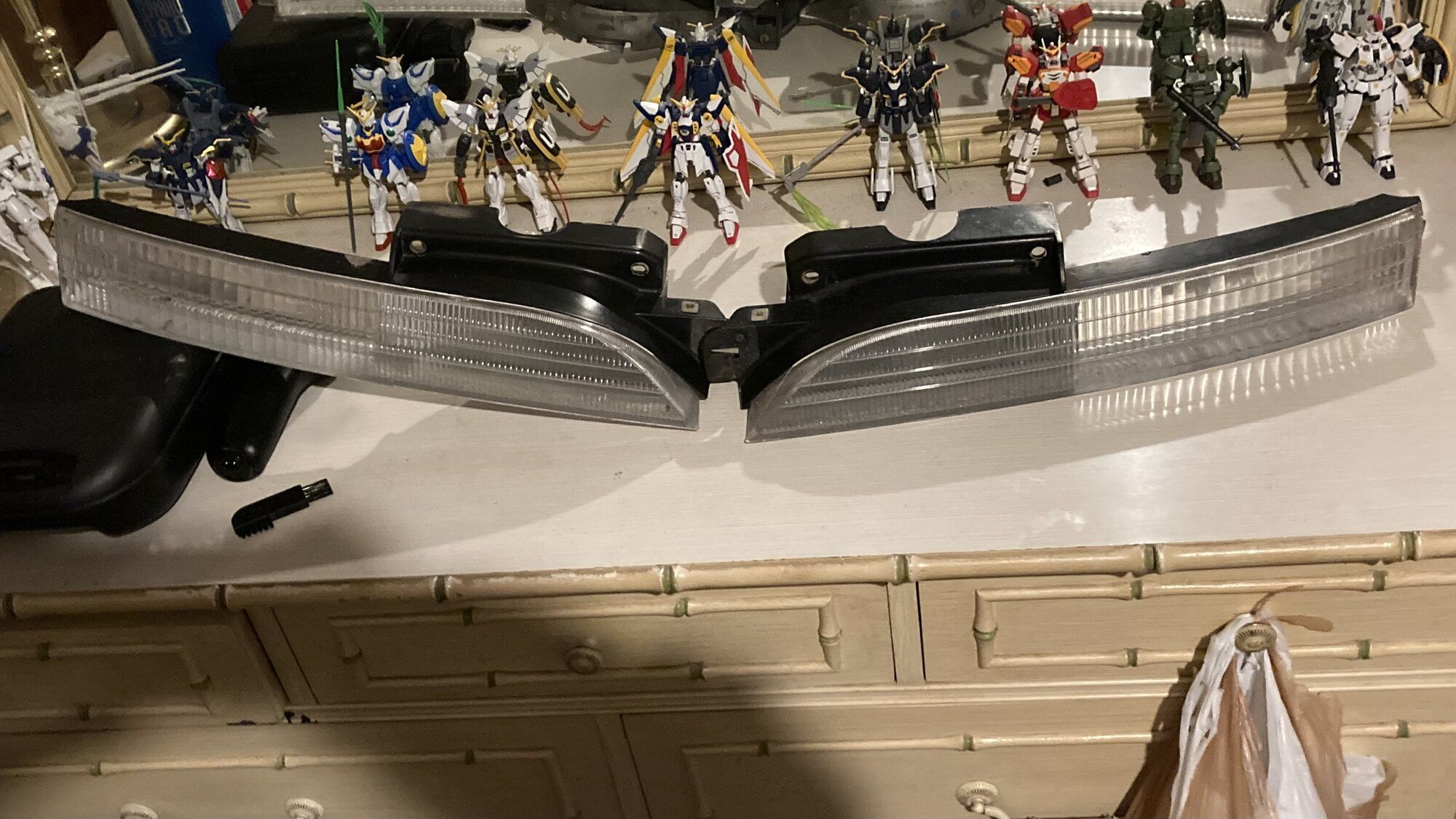

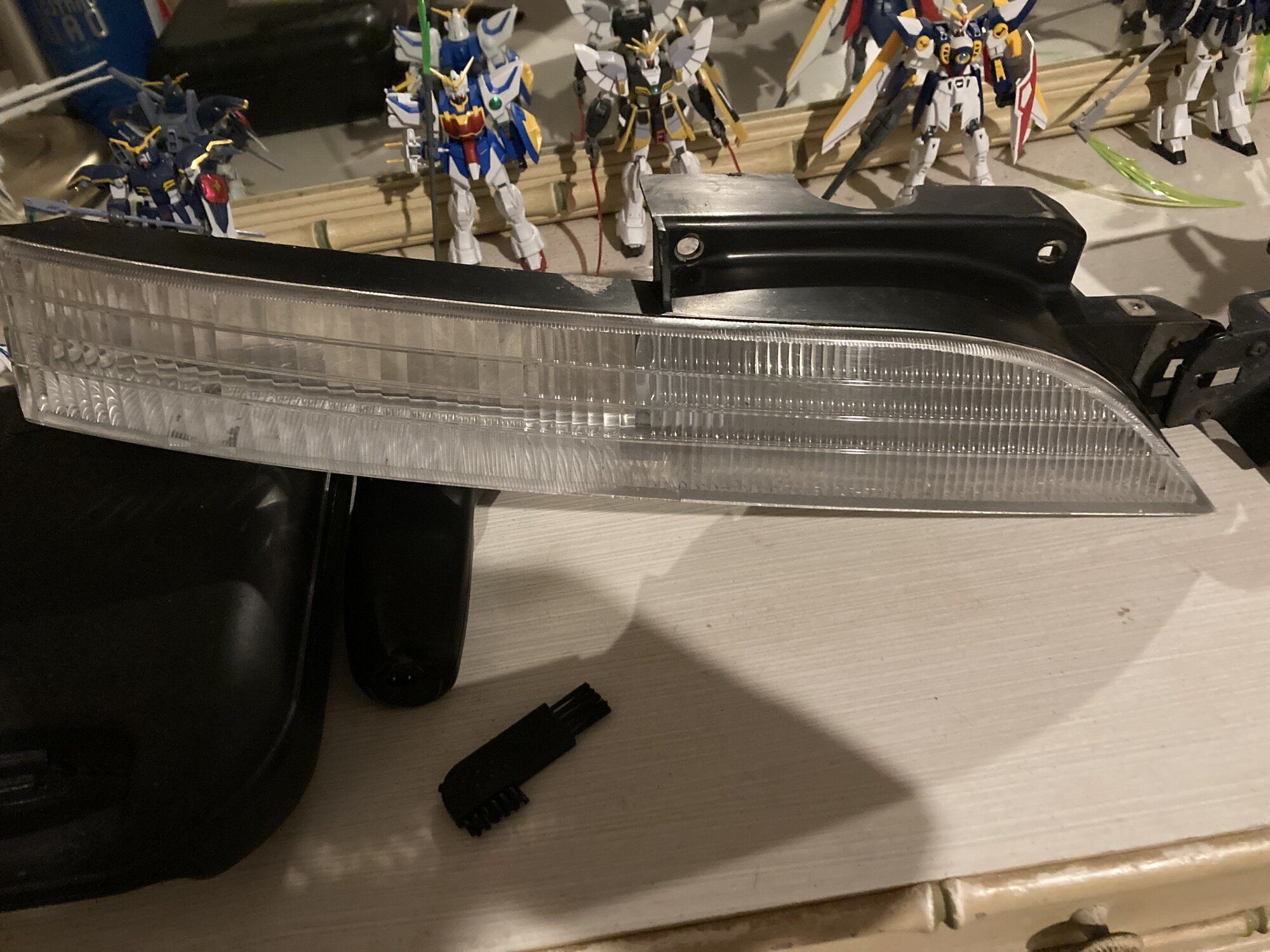

Front turn signal housing/parking lights. None of the screw holes are cracked(no cracks anywhere actually), and the lenses themselves are almost crystal clear. Just need to be cleaned/wiped off. But as you can see..these things look so nice. My current set are okay, but the mounting tabs on the top for the screws are cracked and flexible, and the drivers side lense is missing the mount entirely for the grille/centerpiece. So, very happy.

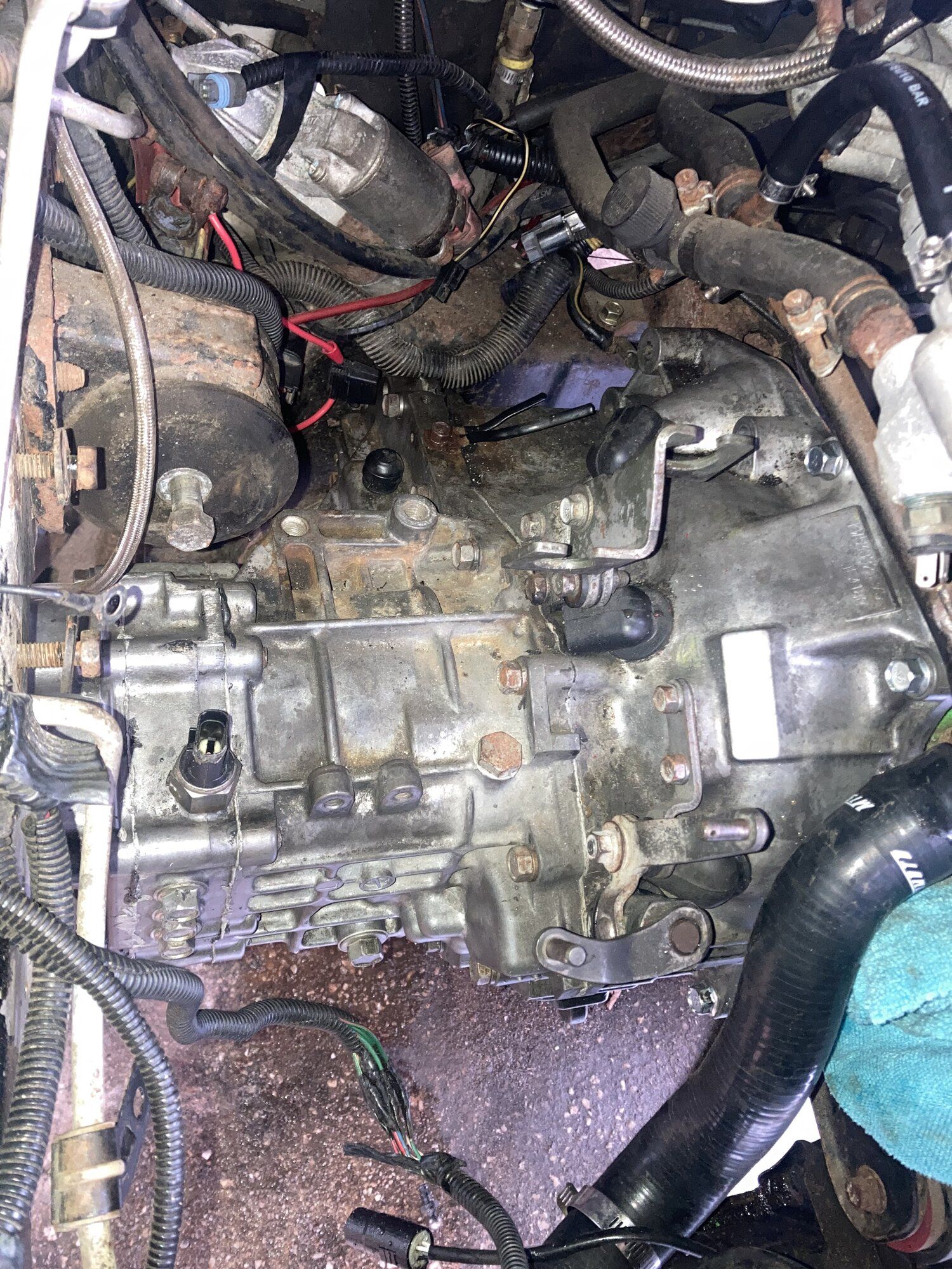

Hmmmm. What do we have here?
Well shit. How'd that get there.

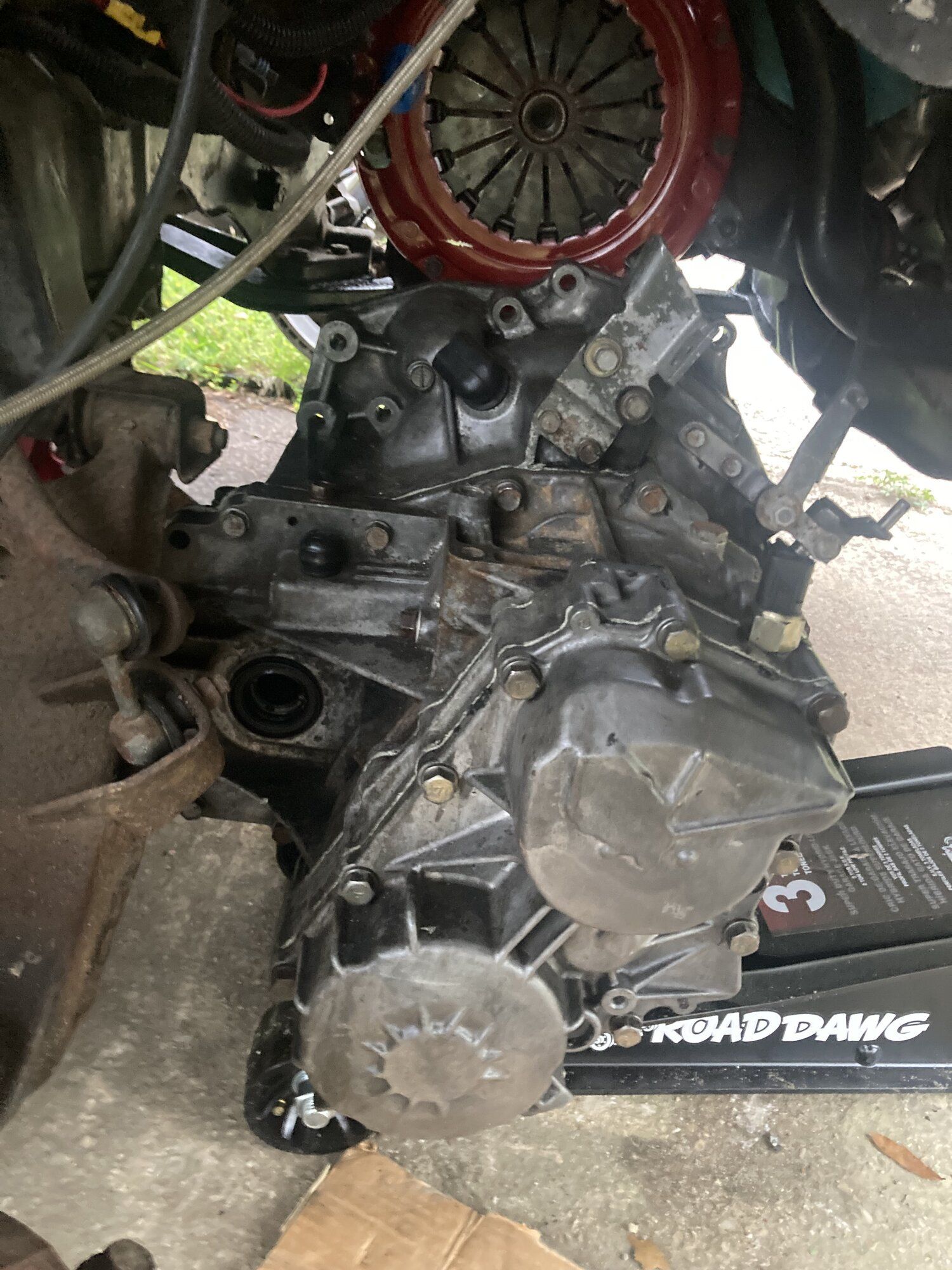

Well, since it's there why don't we just go ahead and stab it in? Hey wife, GTF over here and work that handle, yeah you know how.
Hell yeah, that's right. Get on in there.

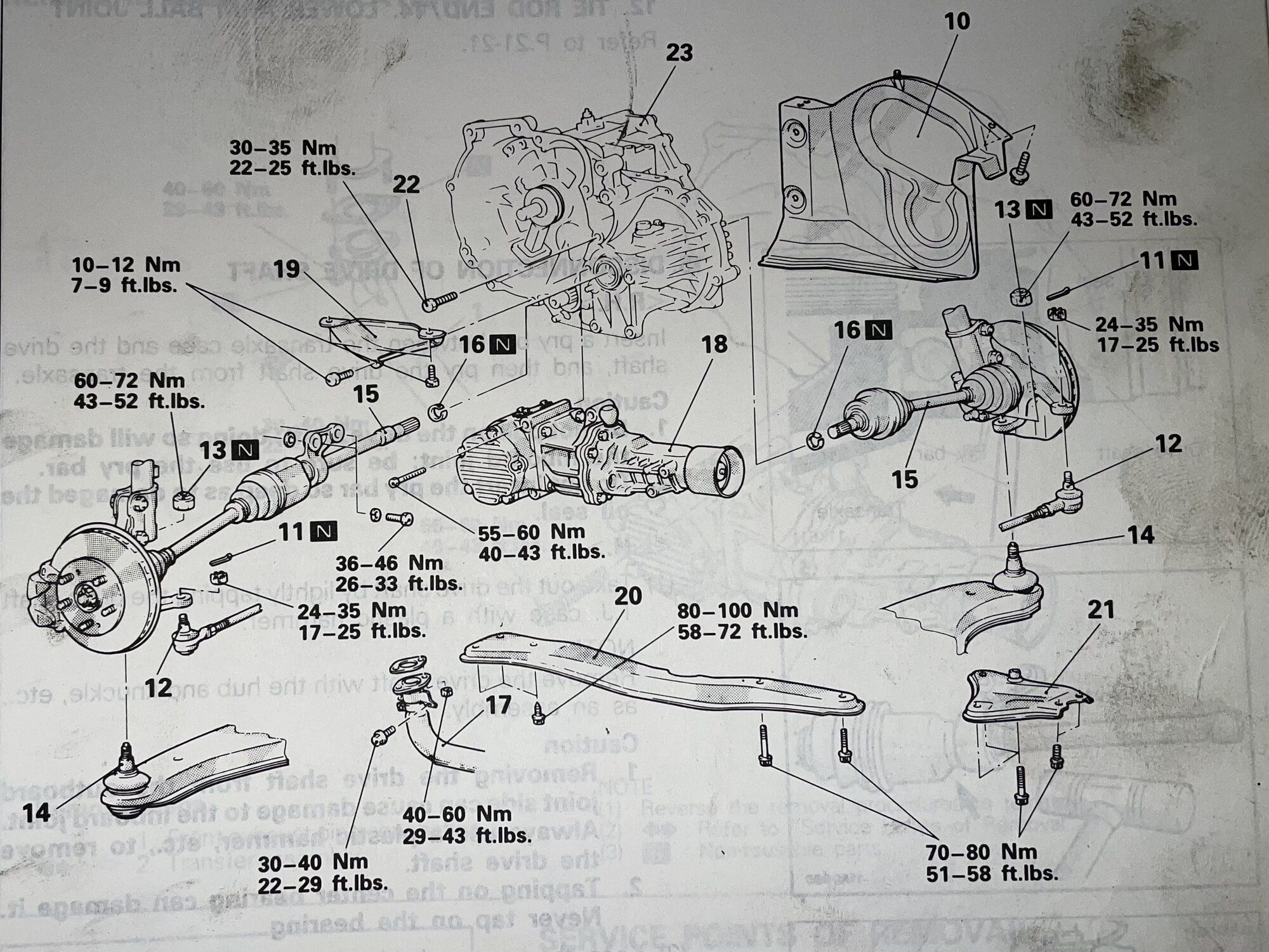

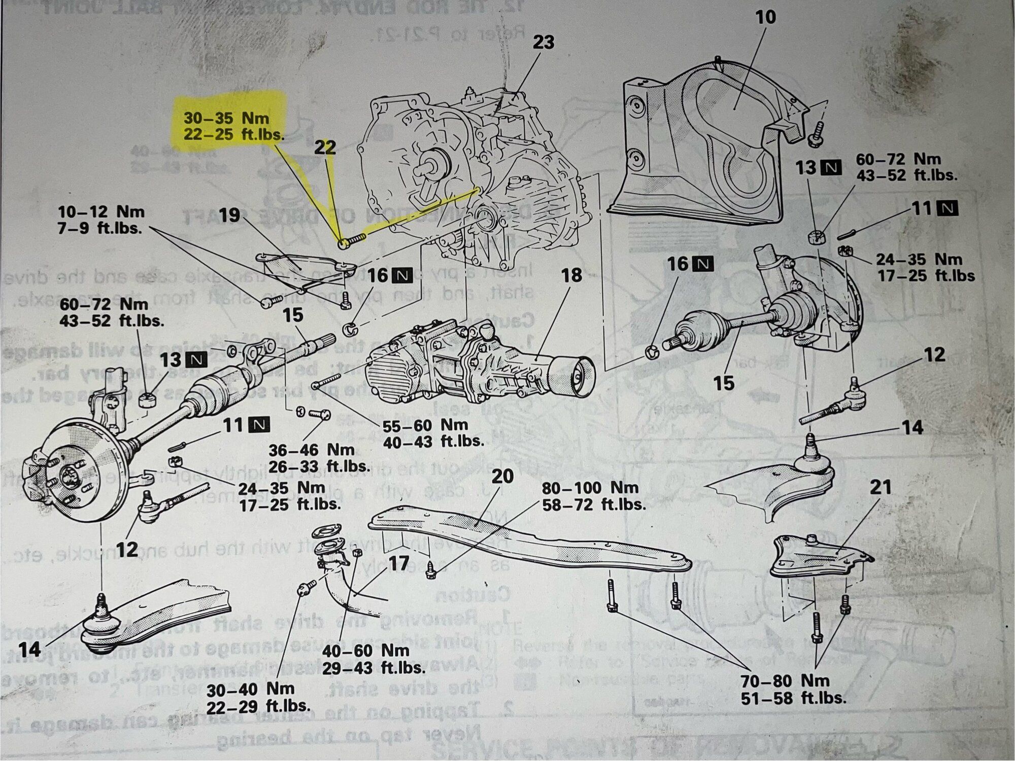

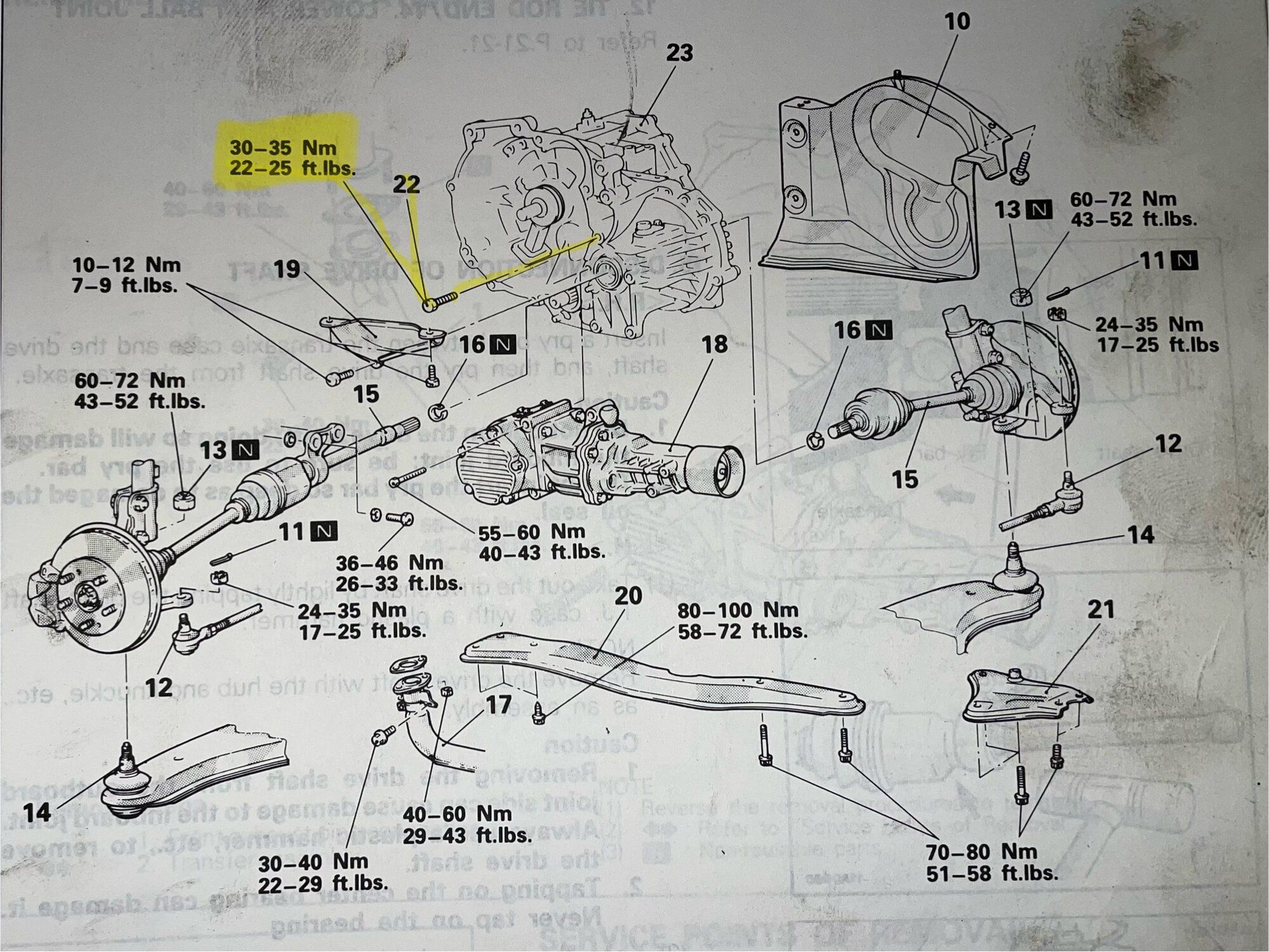

Mmmmmmh. Brand new OEM bolts, torqued to the ridiculously low 22-25 ft/lbs that it calls for(7-9 on the bolt that threads into the trans! Crazy!). She's in there and sitting pretty.

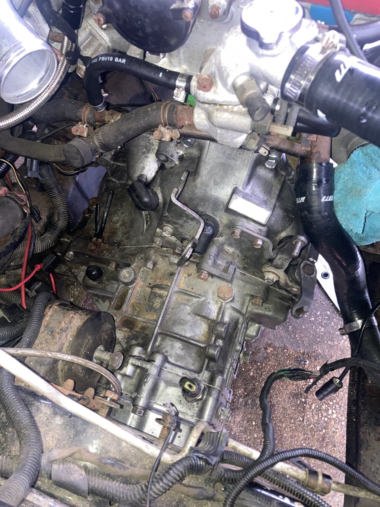

I went ahead and stabbed the transfer case in there too, since I was already dirty and underneath the car anyway. And that's where more bad news has happened.
One of the two short t-case bolts(the one on bottom) stripped completely out upon tightening. I didn't even torque it, it was snugging down and POP! it was done. Pulled the bolt out with the threads completely wrapped around it that came right off like it was a brand new heli-coil insert. Kinda heartbroken, but honestly...f*** it. This thing is just gonna have to survive on 4 t-case bolts until I can get my other transmission repaired/built. But seriously people...stop ugga-dugga'ing bolts that thread into aluminum, because they always tend to give up the ghost on ME specifically.
Also, went to pre-loosen the fill plug on this t-case, and legitimately damn-near snapped the bolt in half it was so tight. The first clue was the head was kinda rounded. I used a really good grabber socket, and had to put a pry-bar(half of my jack handle actually. It's like 2.5 feet long!) and a TON of strength just to loosen it. Seriously, what are you people doing? Putting a 1600ft/lb 1/2" impact on your bolts and just sending them?

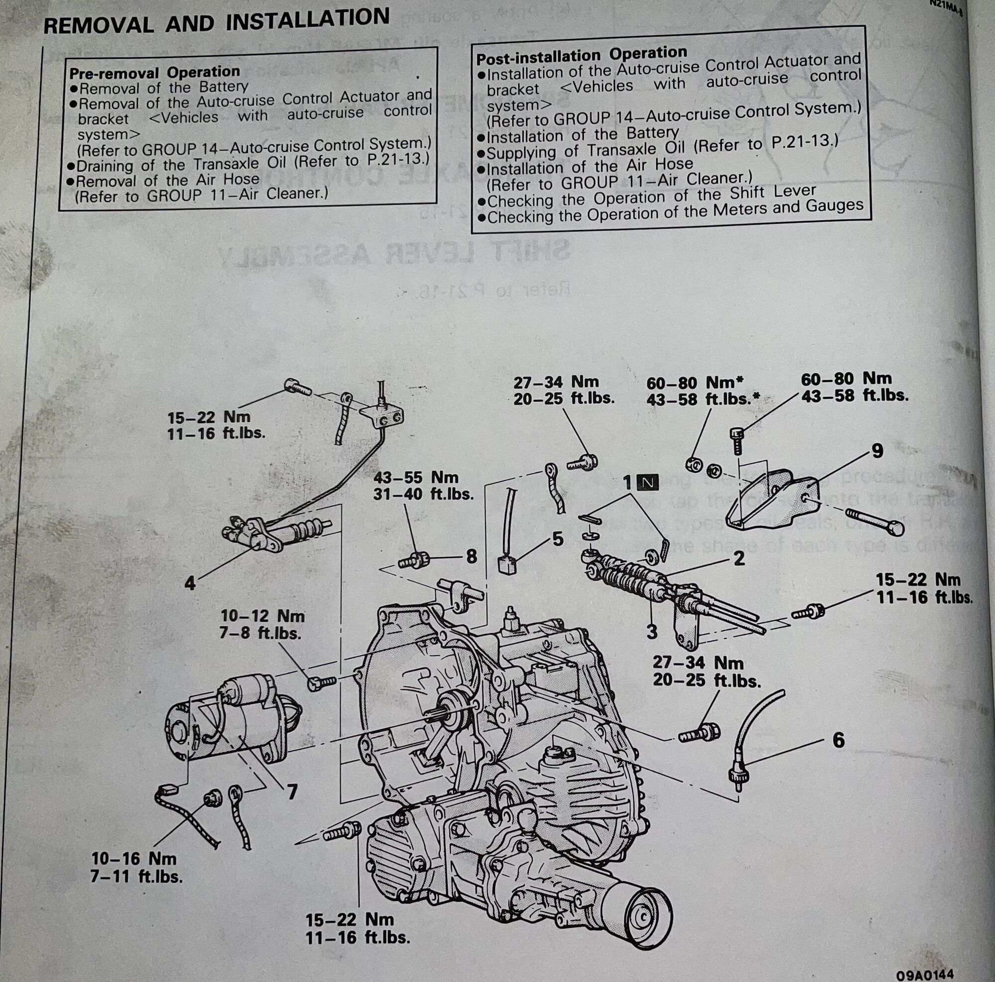

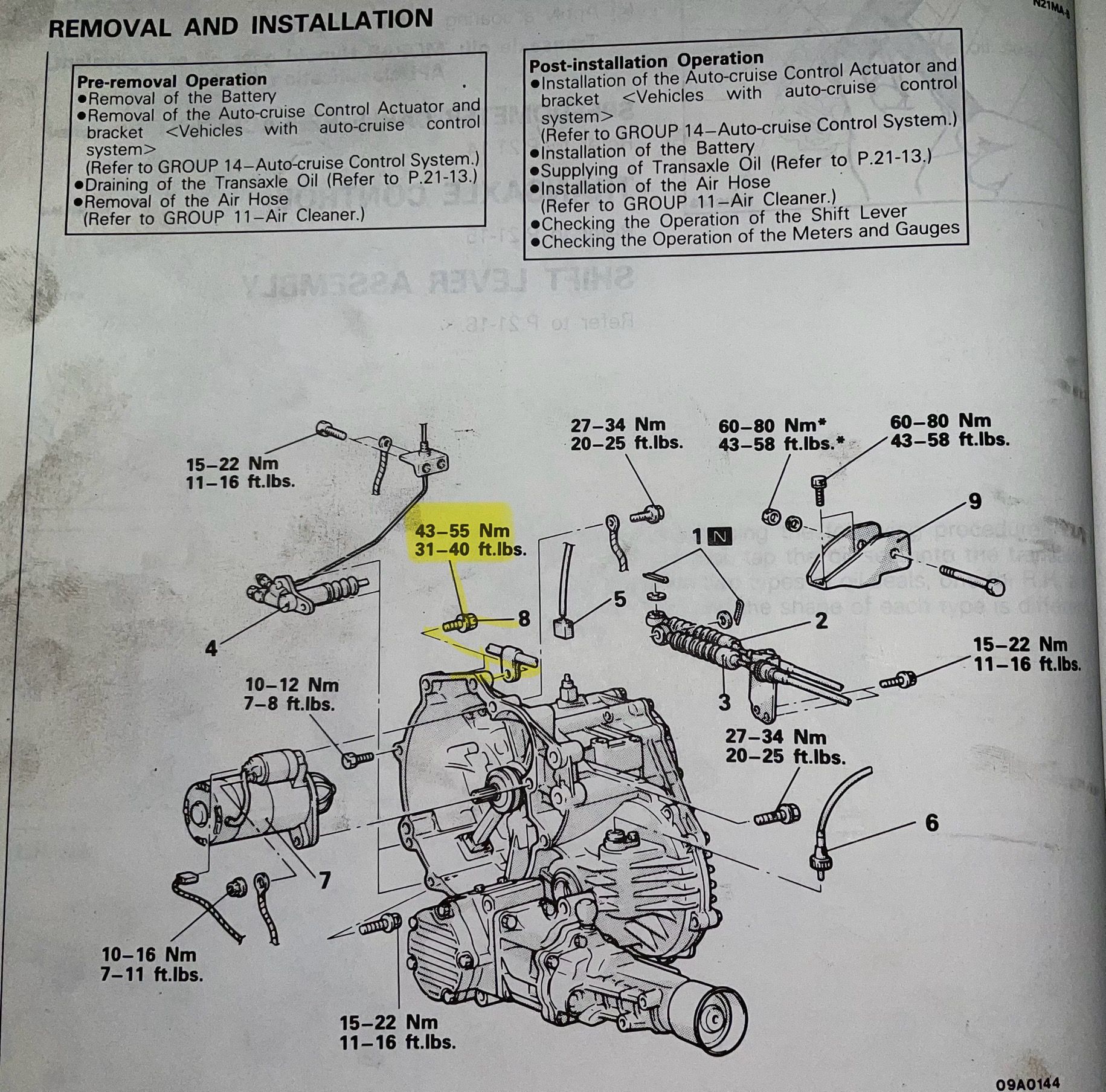

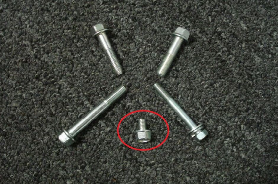

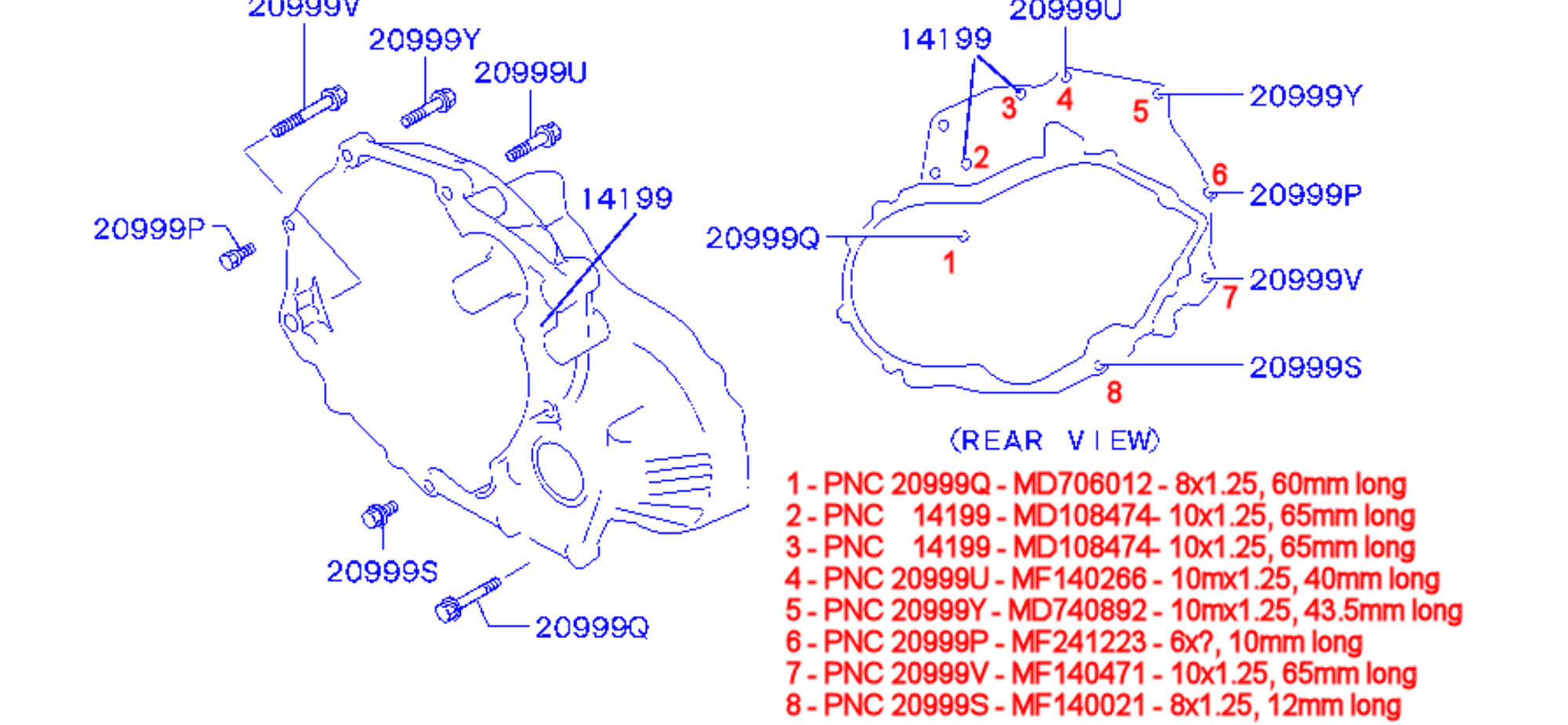

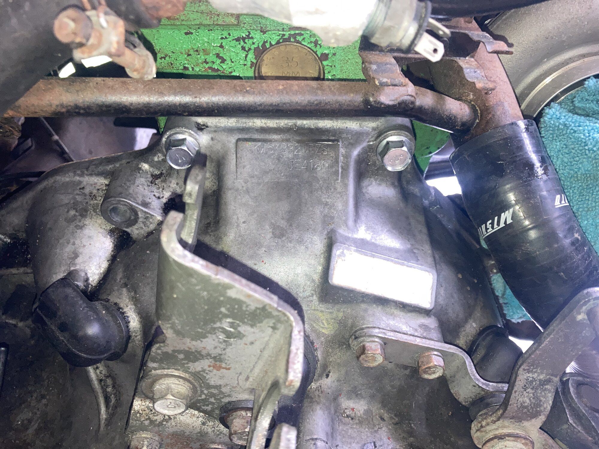

I hate to keep bumping up this, but does anyone know what this bolt circled in red is supposed to go to? It came with my JNZTuning trans bolt kit, but I have no clue where it goes. Lol. Is it for the inspection cover or something?

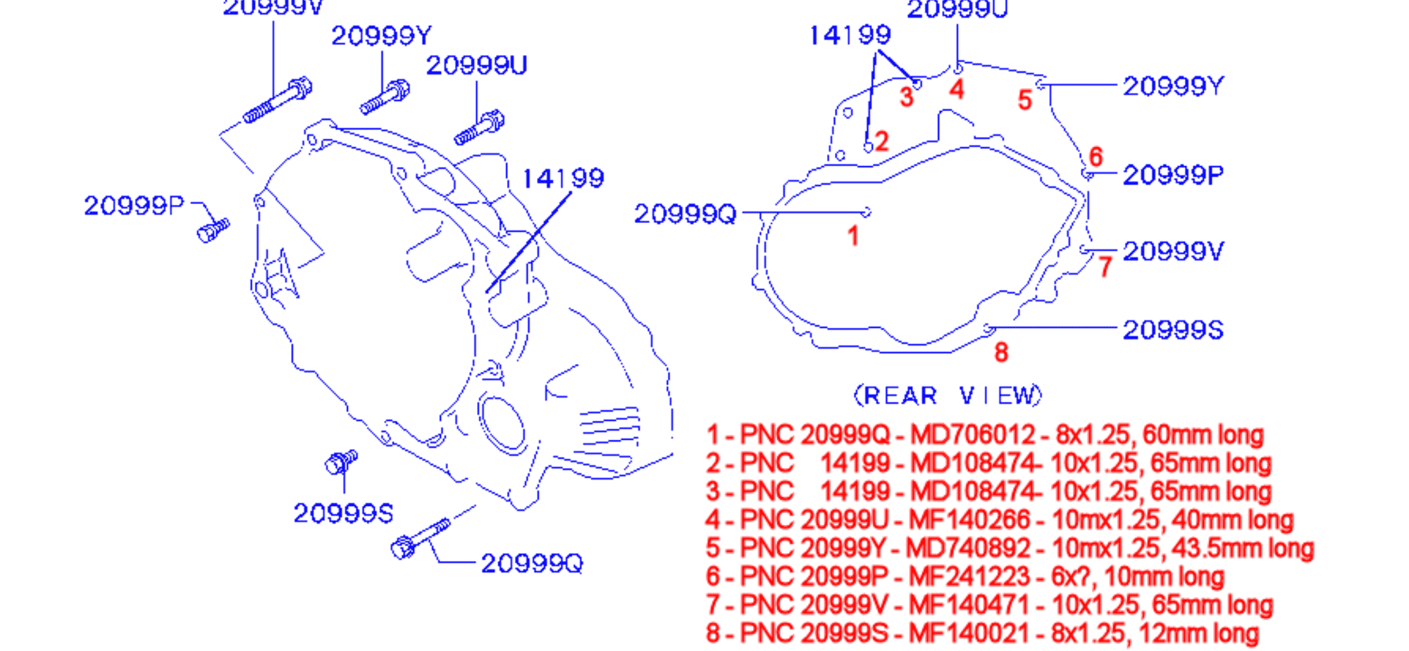

I’d actually vote bolt # 8, as shown on VFAQ, for that one. Looks too large relative to the others to be bolt # 6. But a quick measure to determine whether it is a M8 (coincidentally, # 8 bolt) or M6 (again, coincidentally, # 6 bolt) would sort that out.
#6 is for the starter plate, but bolts the plate to the transmission. #8 is a bolt for the lower inspection cover to transmission. This one:

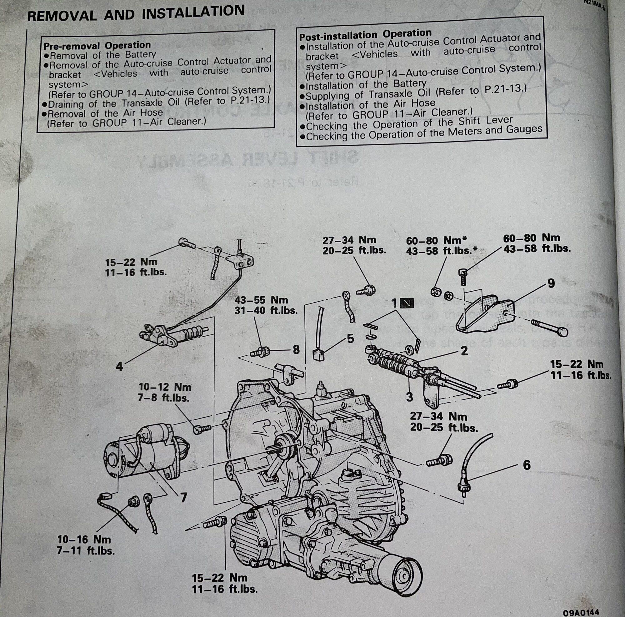

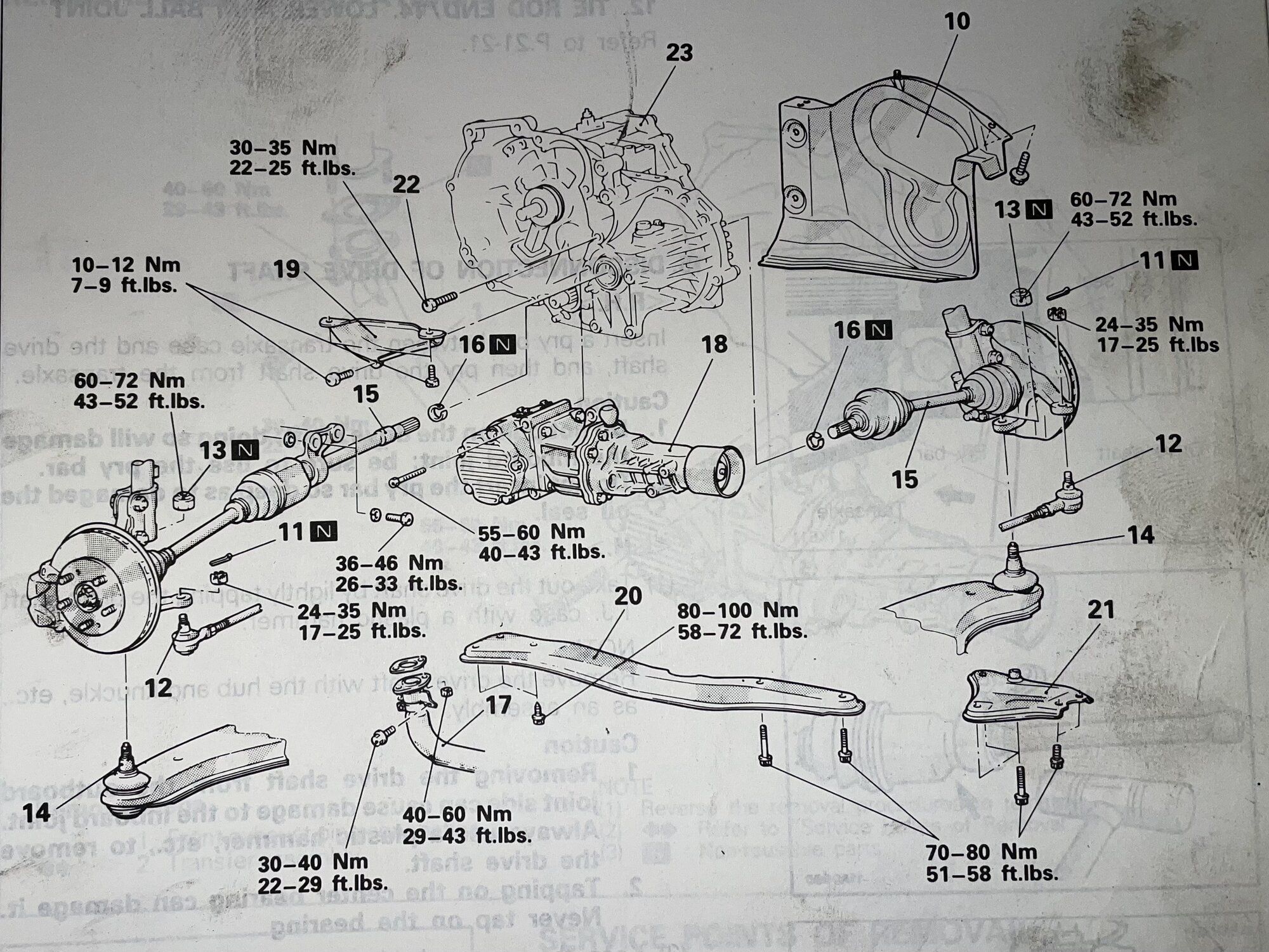

Also, might double check your transmission mounting bolt torque specs.
There is so much going on in this picture. I can't really tell what the torque specs are supposed to be. Glad to see I got the t-case torque spec right at least.
