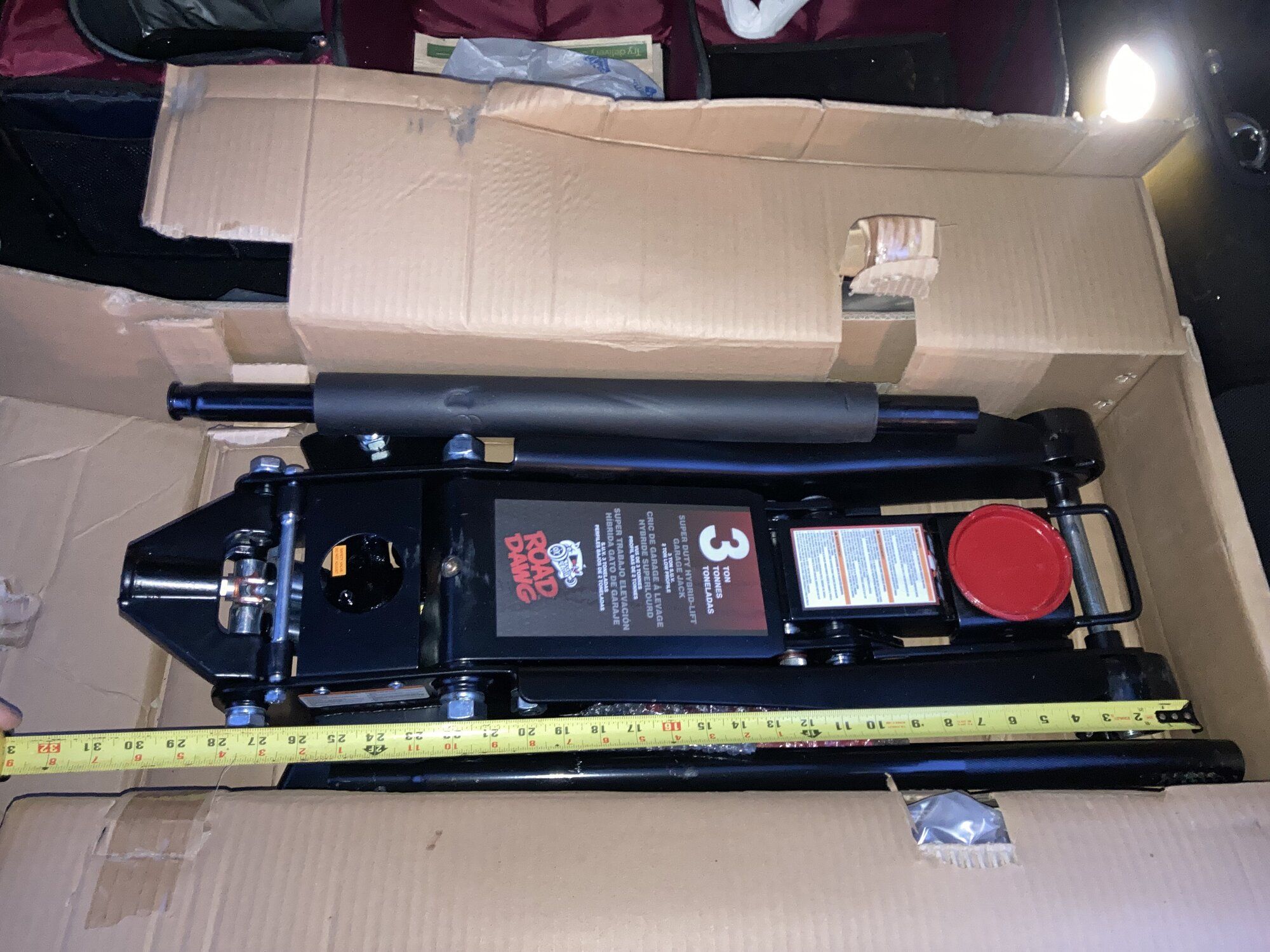

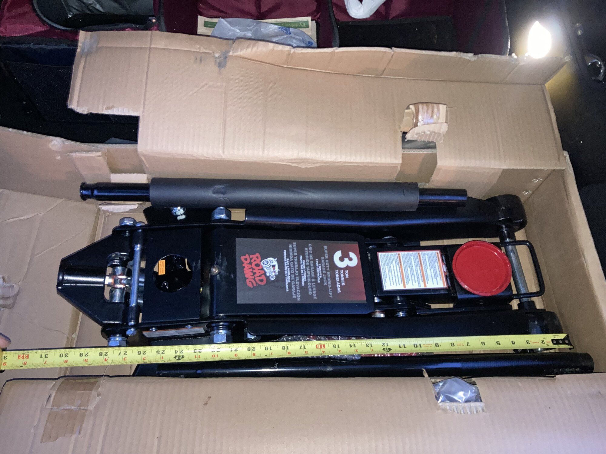

This one is an amazon ching-chong special. I did a bunch of research though, and it's actually pretty good. Just gotta bleed the shit out of it first. But I had no idea it was the size of a small country. When I'm not enjoying my only day off, I'll take a picture of it by the car for comparison. Shit is hilarious. It's still low-profile though, so that's good.
Hilariously big aside, its nice to have something that will lift my CUV, the Talon, and a truck I may/may not get (when they're not absolutely idiotically priced) in the future. Plus if the foundation starts crumbling on my house, I can hold the house up with it. :p

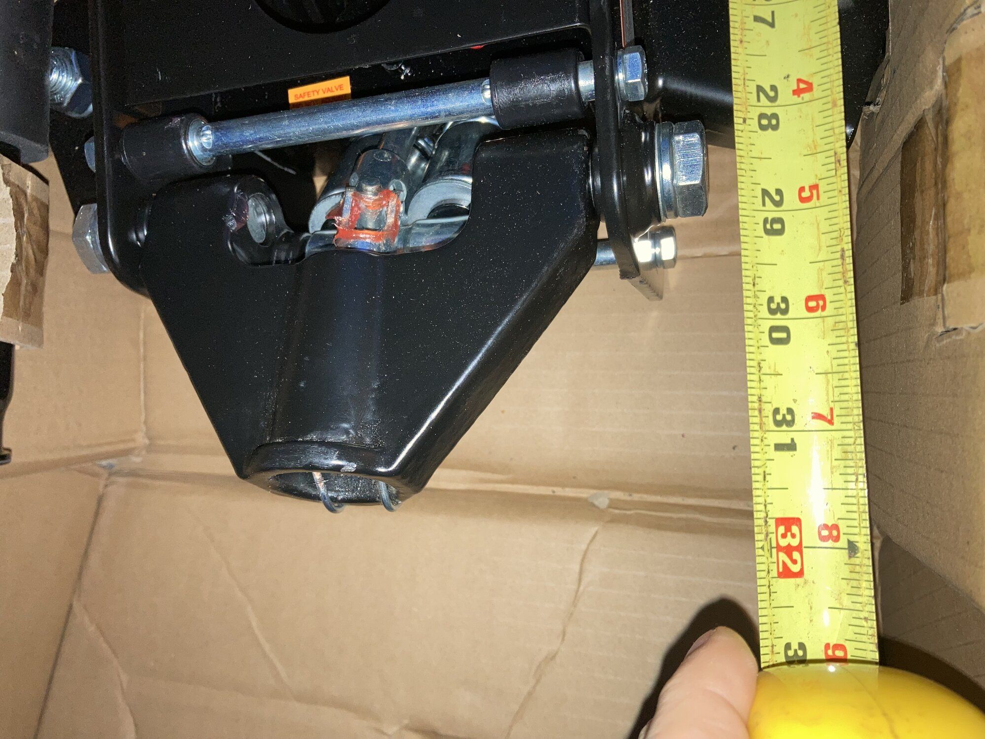

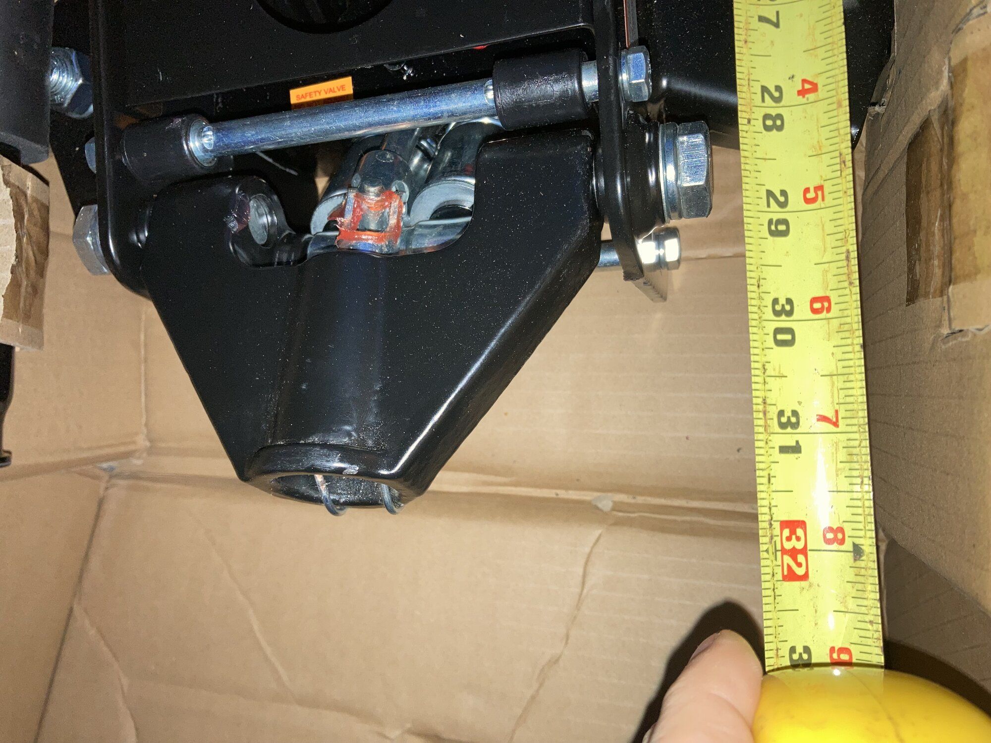

Just look at this girthy boi.
It's almost 3 feet long. LOL But it feels solid AF, and has a total lift height of I think like 32". Crazy.

How much was the orange chicken special?? That thing seems like something I need right now!!
I think like $200 including shipping and fees and etc. Not bad considering it's for low profile vehicles and SUVs both, with a lifetime warranty and 2 year service-related warranty and it's a "quick pump" so like two pumps brings it up halfway to it's 32" lift height. This thing seriously feels so solid. (It's 106 f*ckin' pounds for crying out loud!)

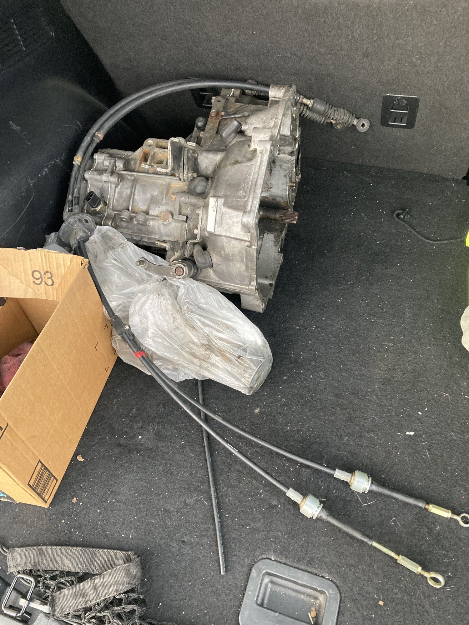

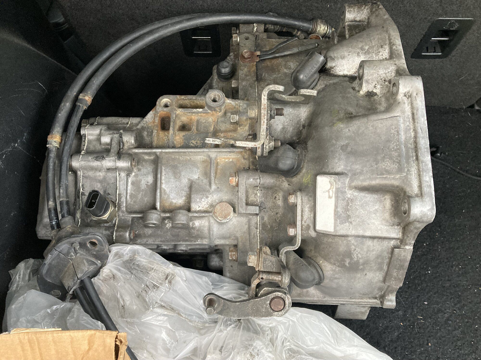

Package secured, repeat, package is secured.
This thing looks great and the cables look like brand new. That’s awesome. Came with a good transfer case and cables/shifter base too.
Gonna degrease it and paint it so it looks new. So excited man.

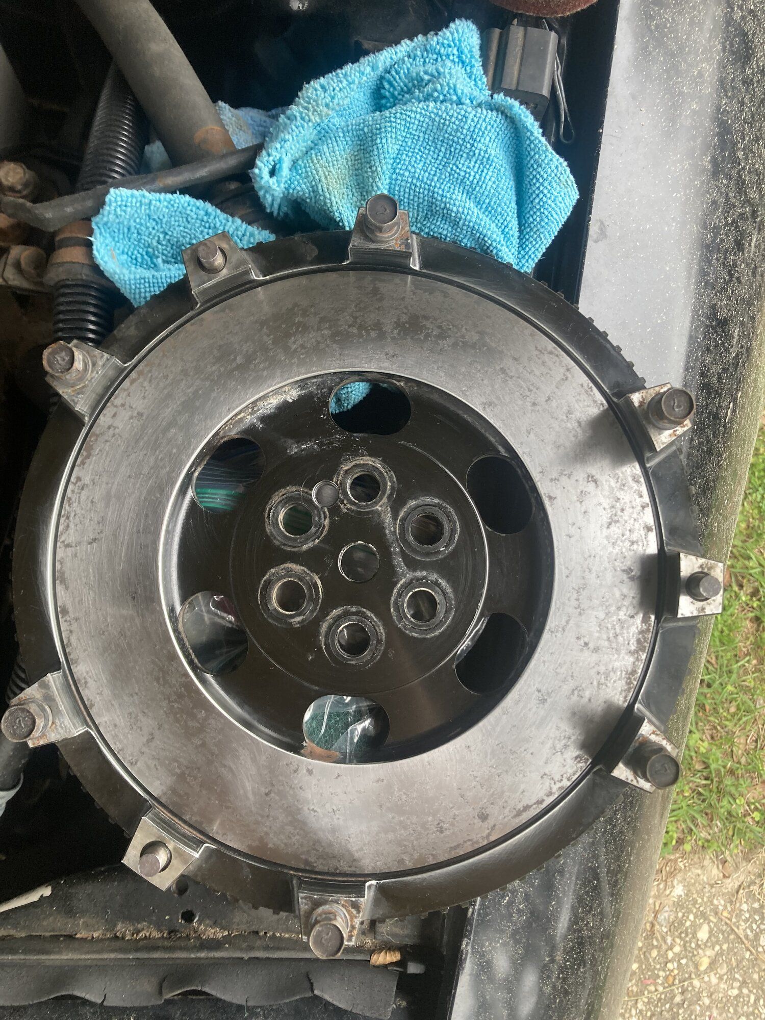

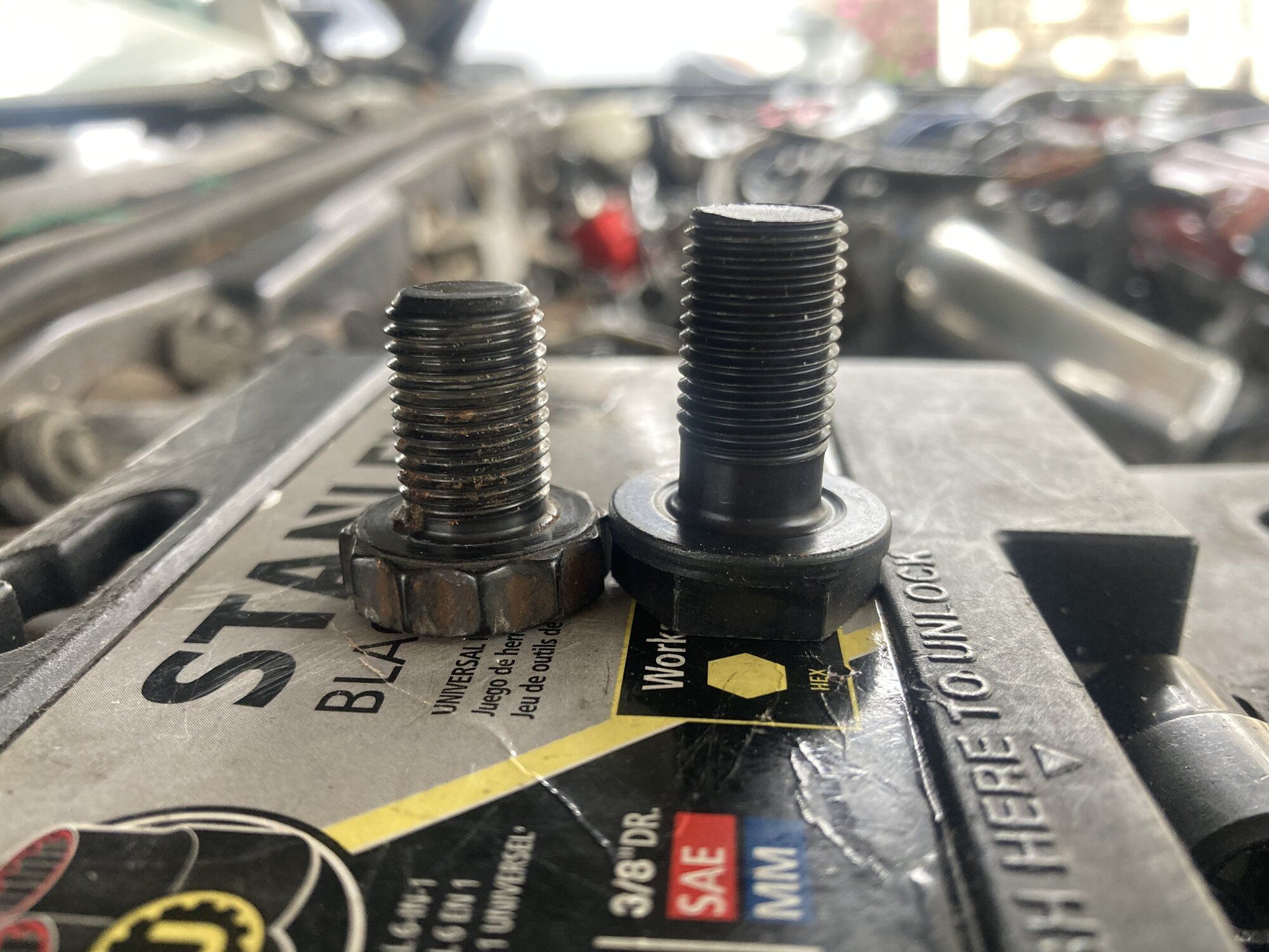

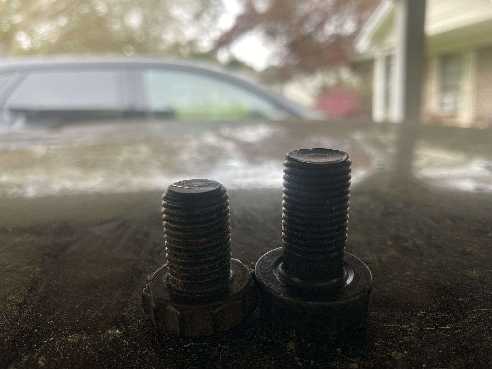

Well, was determined to do some work on the Talon today. I got impatient and decided to try to remove the crank bolts with my current measly 350 ft/lbs impact, and to my surprise...it worked. It didn't even struggle, it tapped a couple times per bolt then just backed them right off. They had red loctite on them too, which makes me wonder if they were torqued/tightened properly. When getting the bolts off though, I noticed they were really short. Here is a comparison between the ARP bolts, and the OEM brand new ones from TMZ.

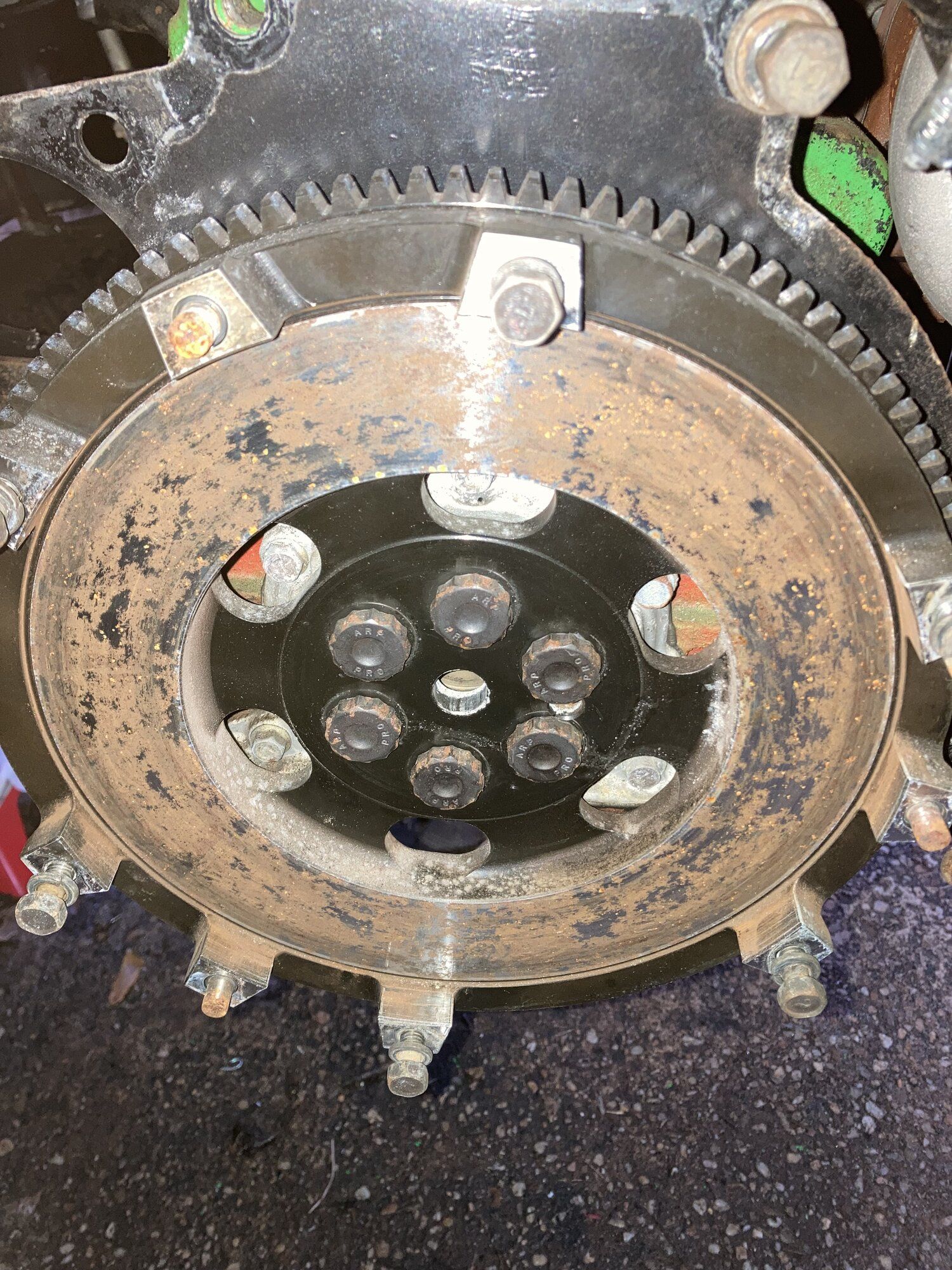

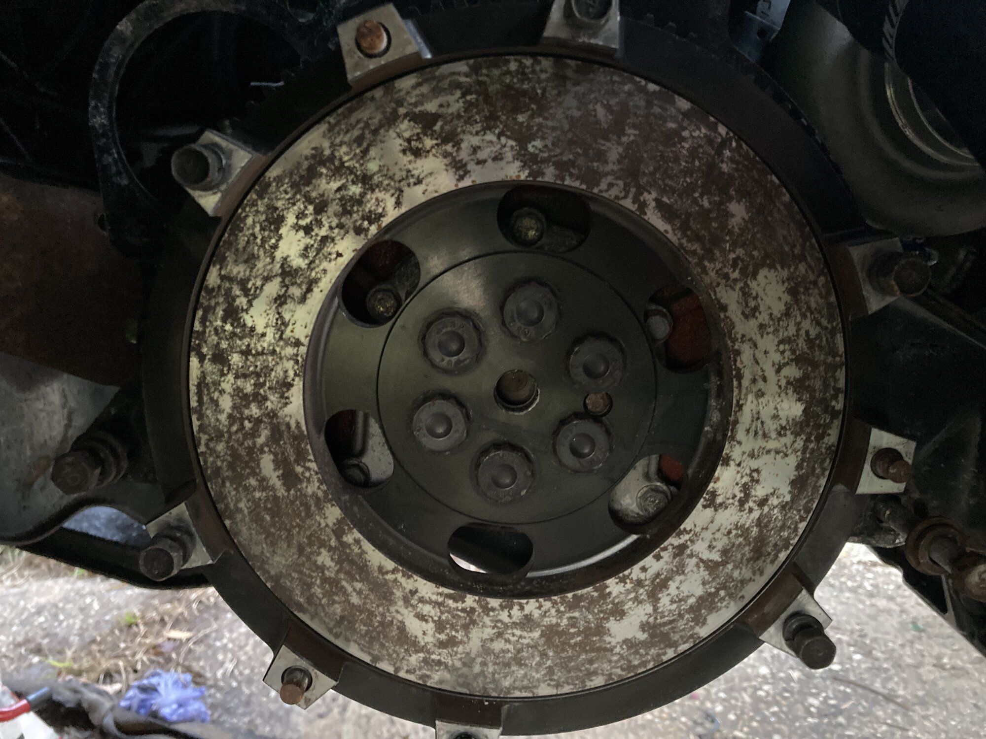

Pretty significant difference really. But once I zipped them all off, before I pulled the flywheel off I decided to use my red scotchbrite pads and drill with some WD-40 to clean the surface rust. It turned out awesome I think, here's the before and after.
eesh. aaaaand after!
It's smooth to the touch, despite still having some appearance of rust. Nothing catches your nail, and it feels like the surface of a brand new flywheel. Very pleased.
However, when I pulled it off I noticed the previous owner actually put loctite all around the back of the flywheel too, I guess to "glue it" onto the crank. Not sure if that's what others do, but when I cleaned the bolt holes out, I cleaned all the loctite off the back of the flywheel and head of the crank too. It was weird how only moderately tight the bolts were and how short they are.
I'm stopping for now because I'm tempted AF to just stab the transmission in, but I'm still waiting for a few parts. But overall, very pleasant time today. Can't wait. Only reason I didn't reinstall the flywheel and clutch assembly, is I don't want it sitting outside just to re-rust.
