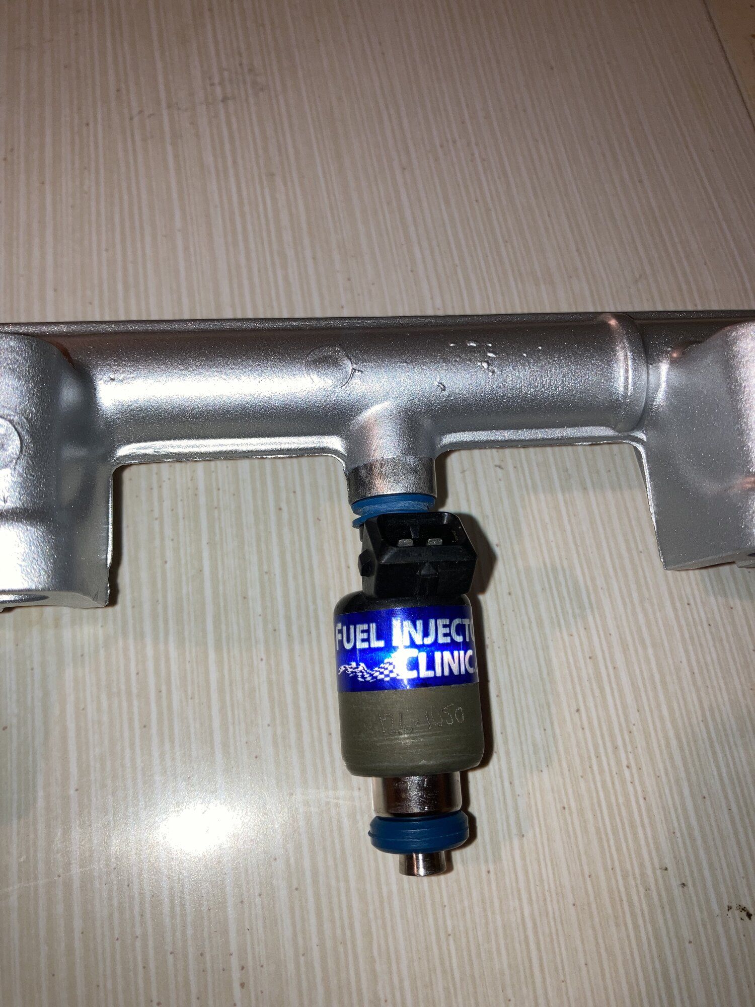

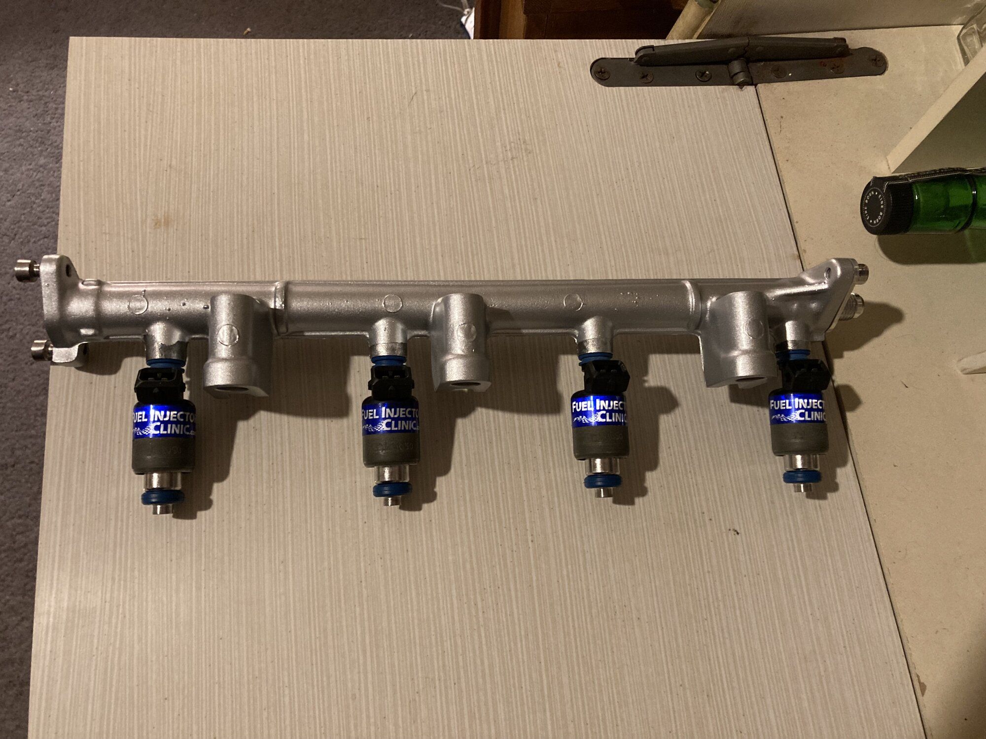

Finally getting around to painting/reconditioning the fuel rail. It's turned out awesome, man. I'm letting it dry/cure now, and when it's done I'll post up the obligatory pictures. Really happy with it though.

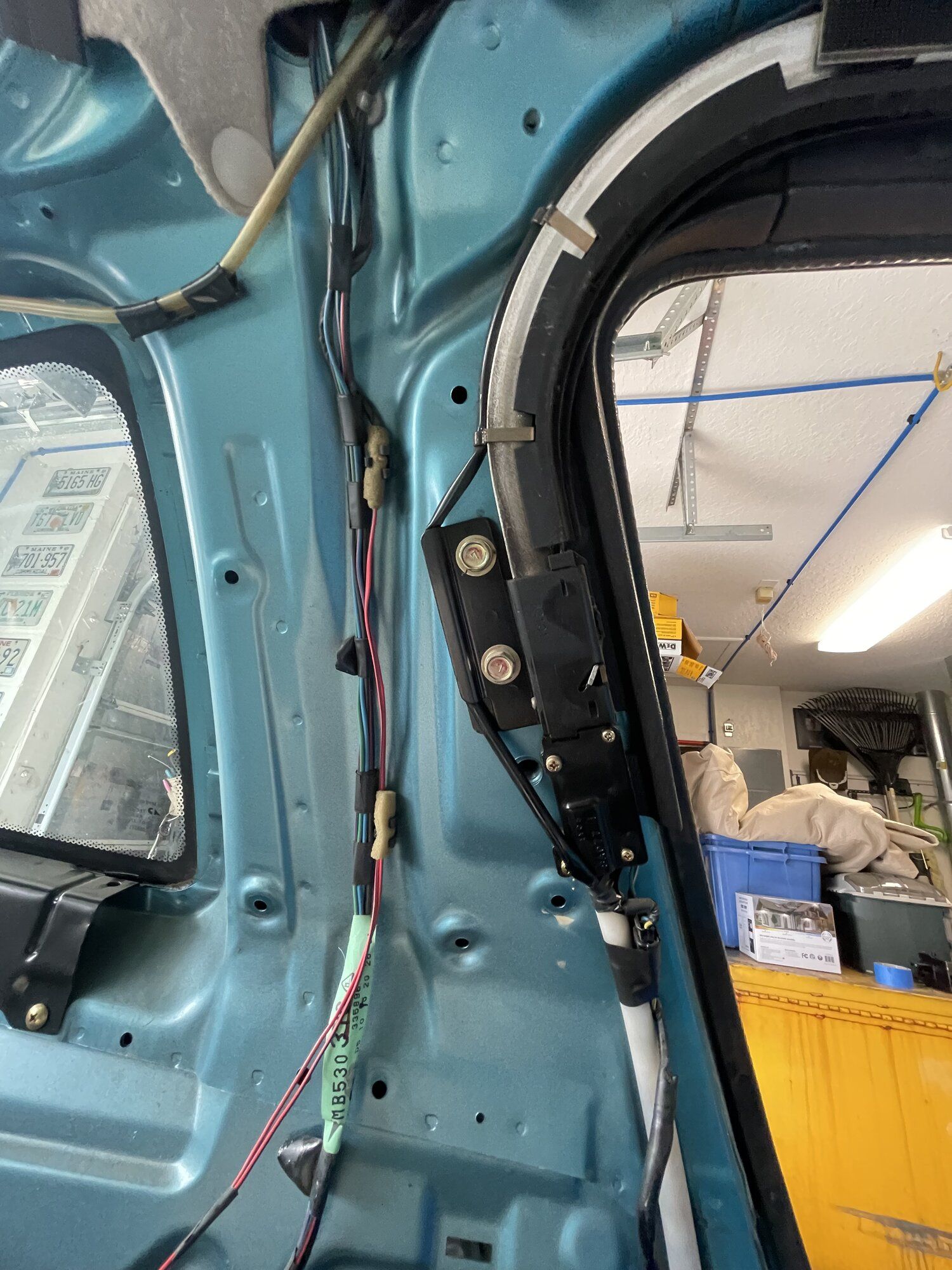

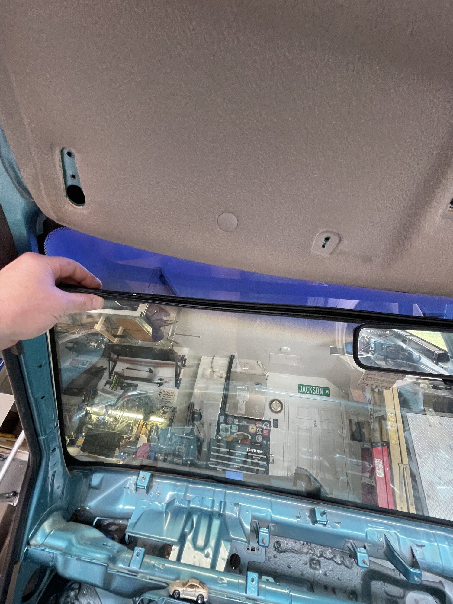

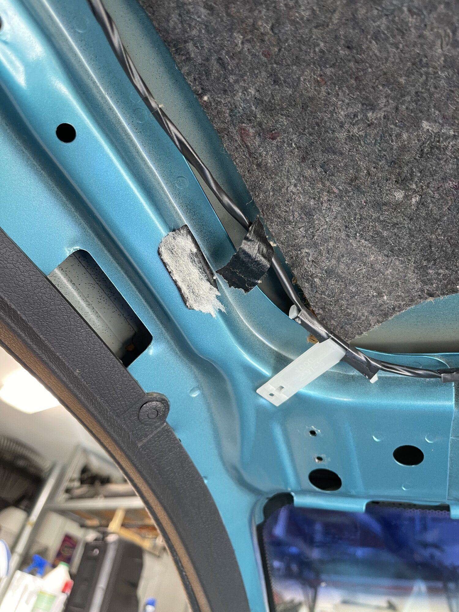

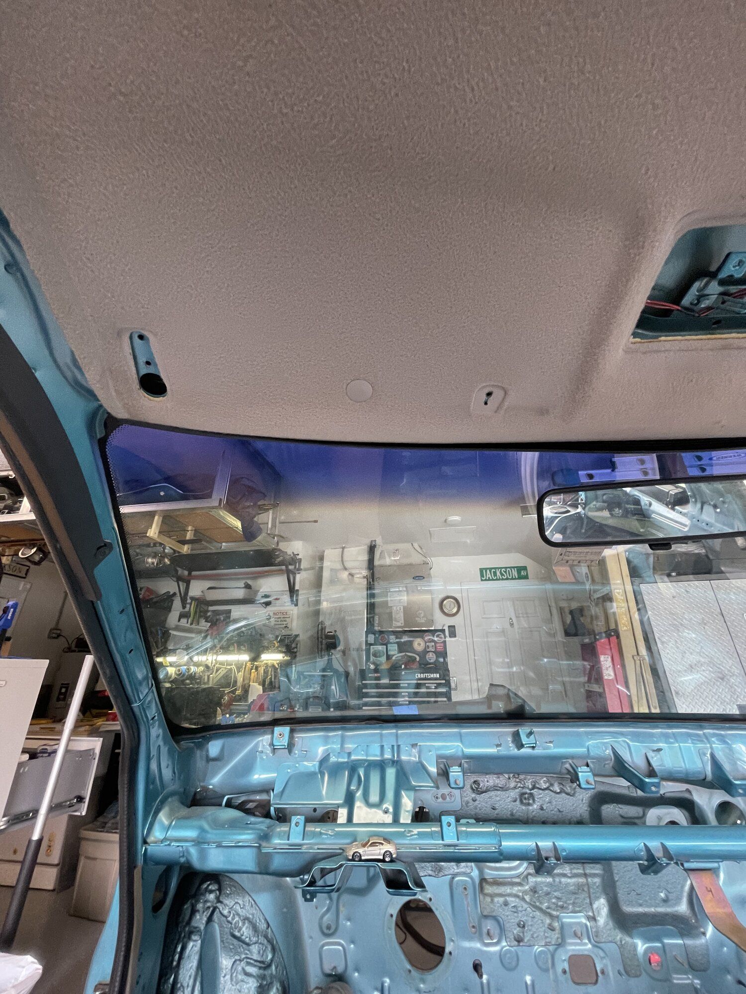

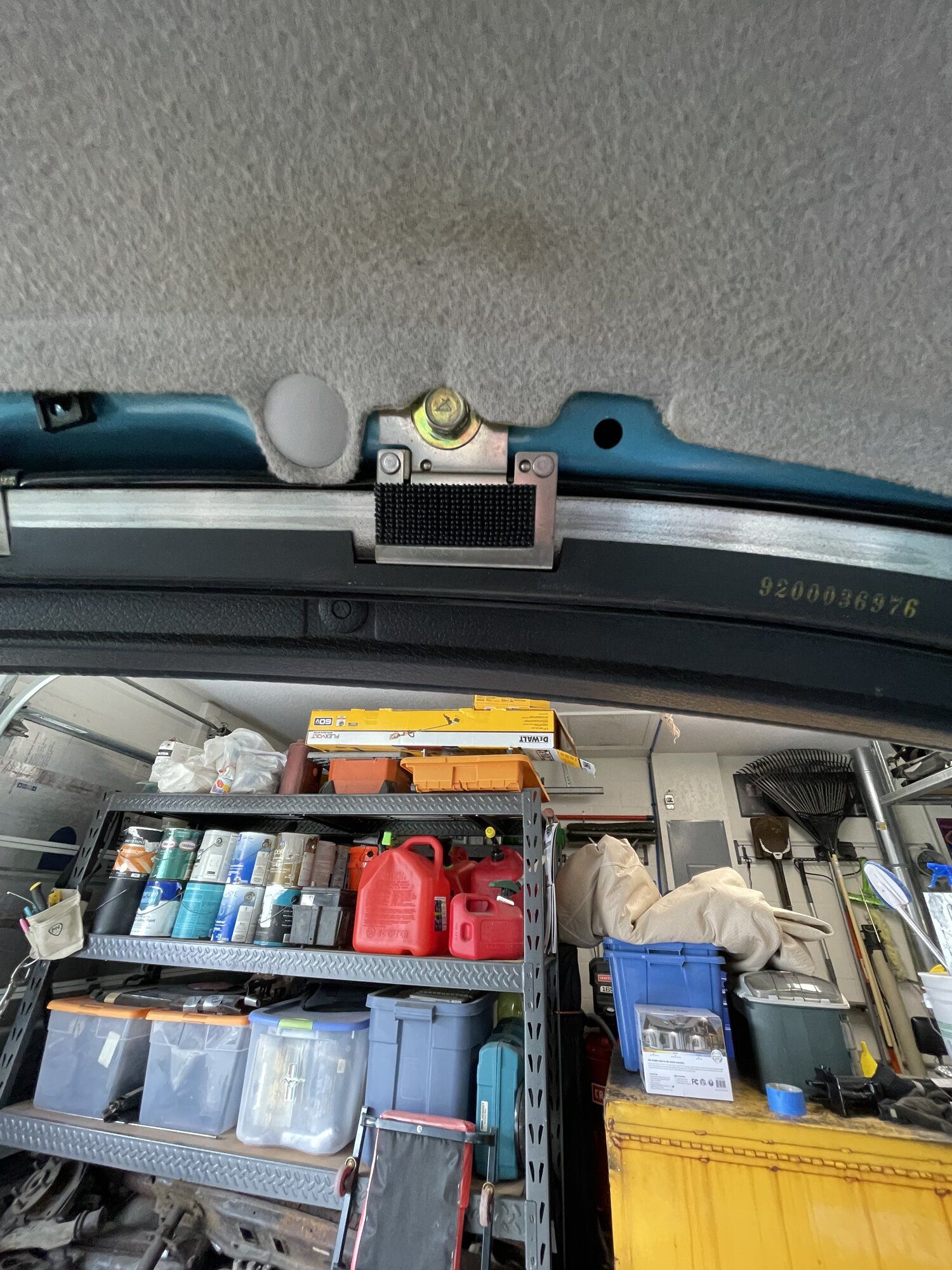

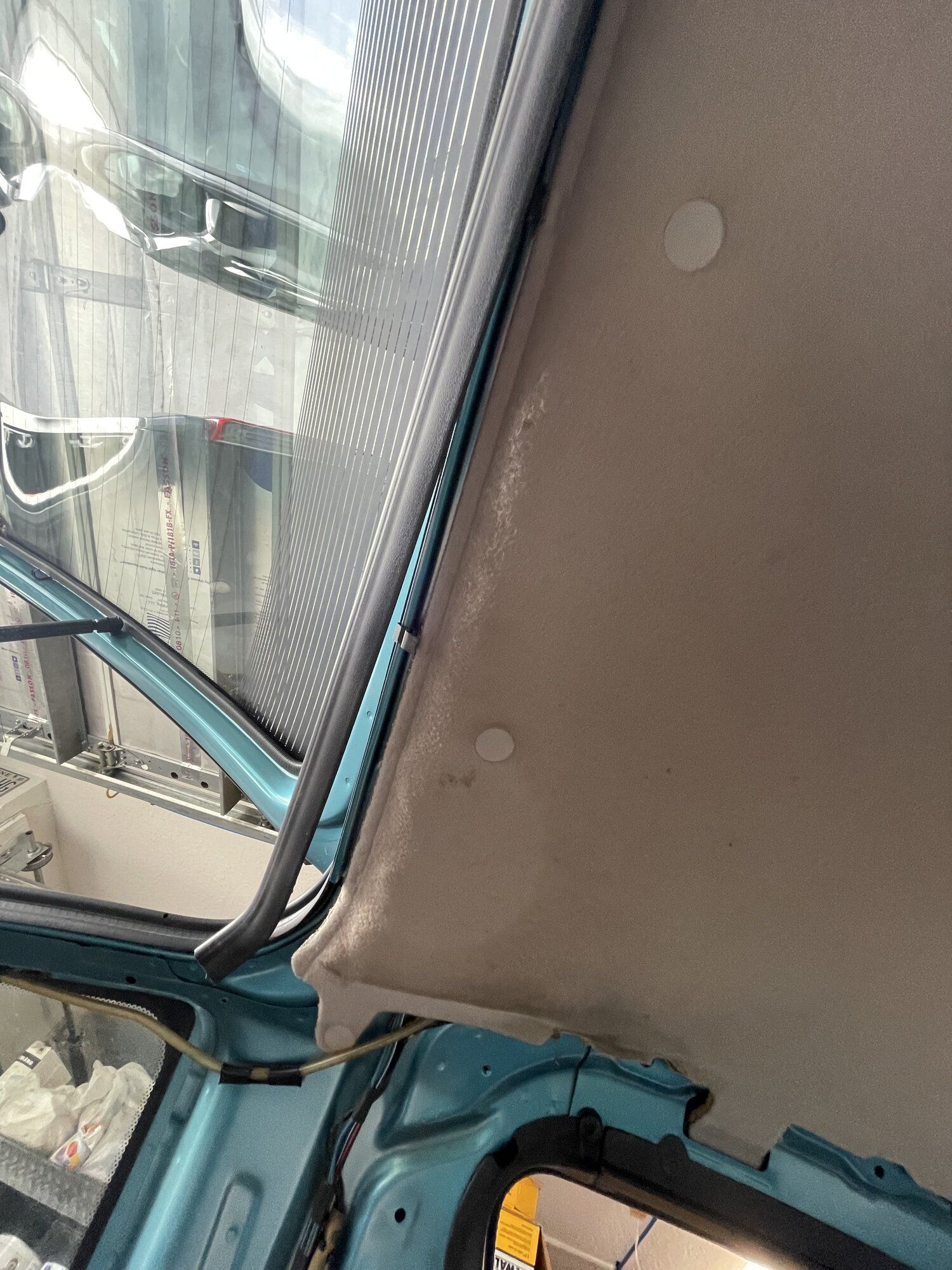

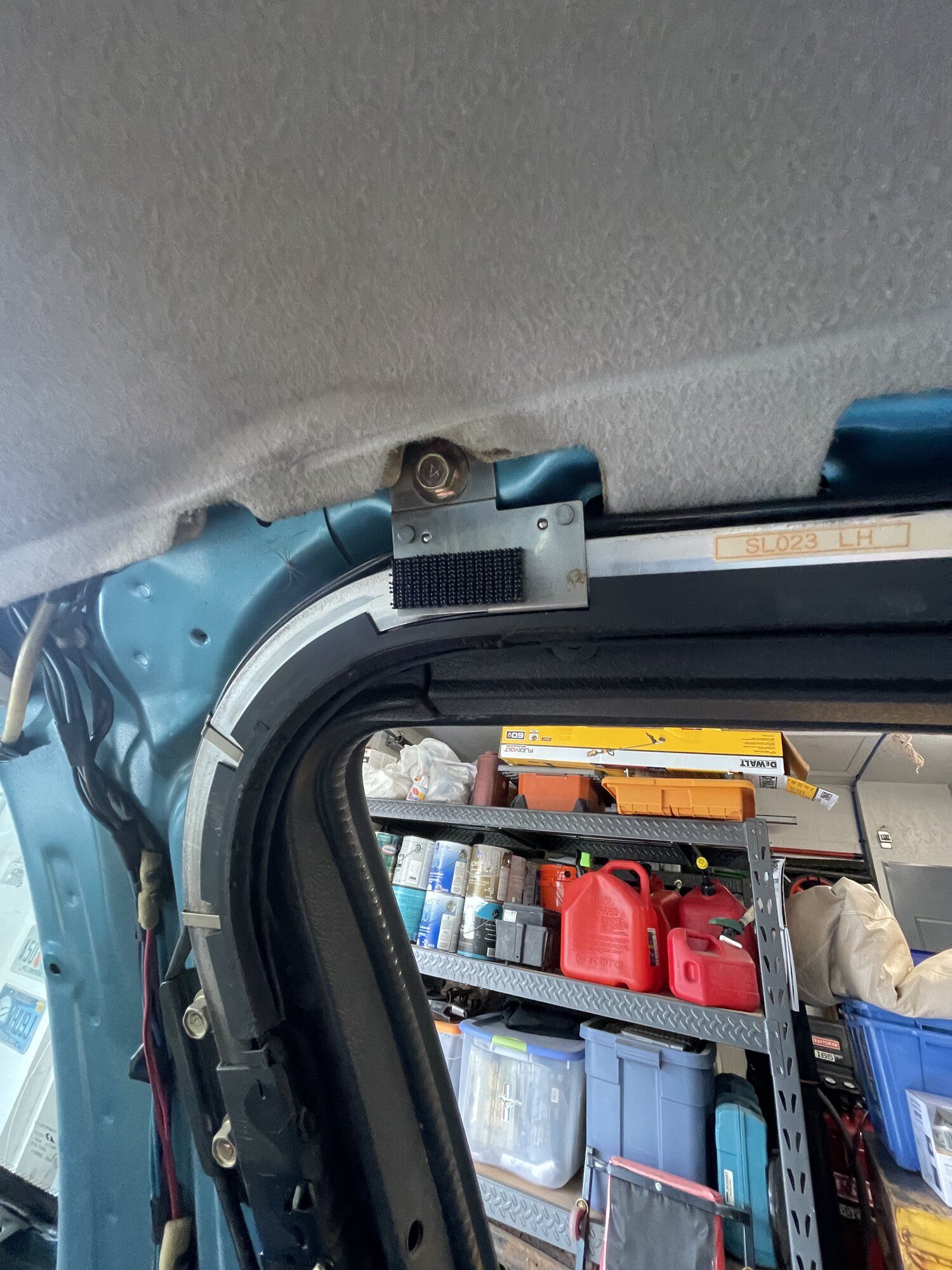

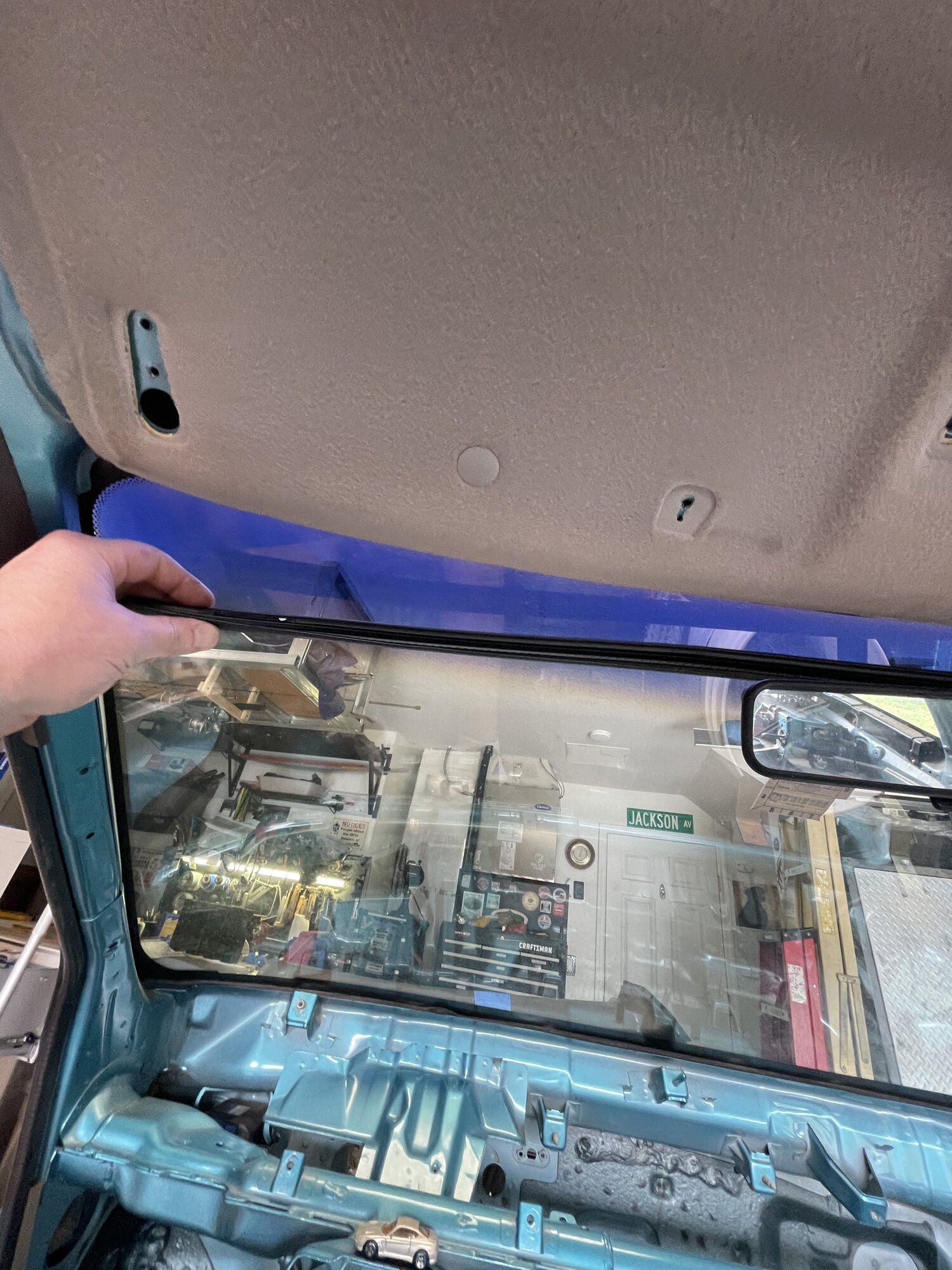

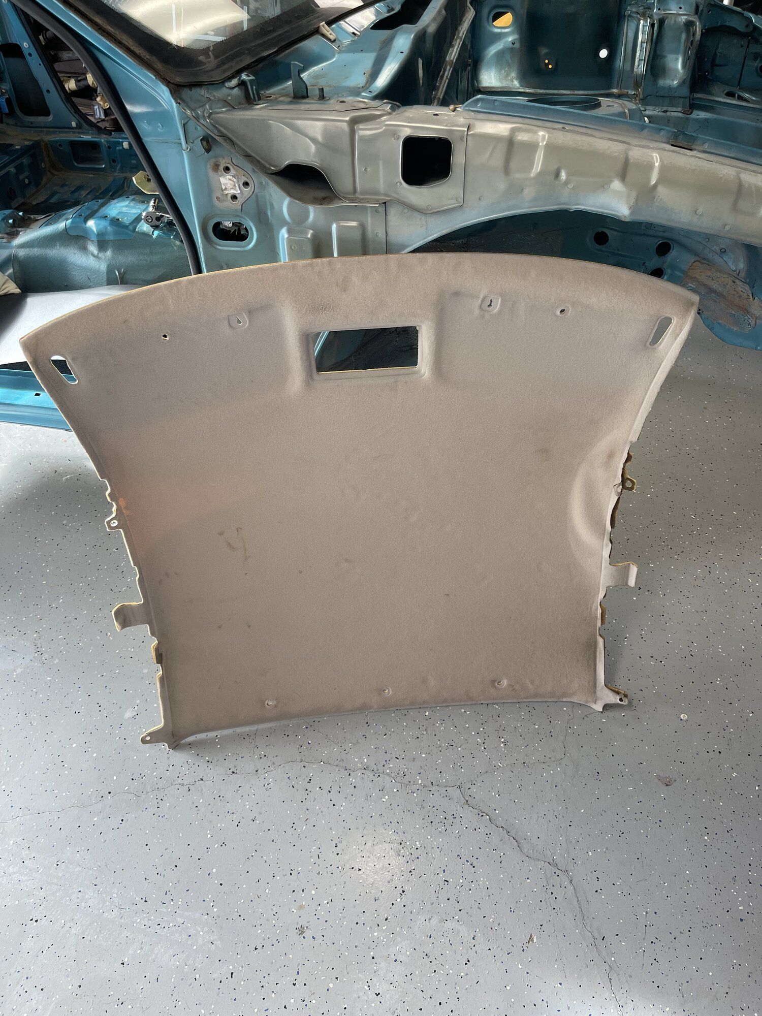

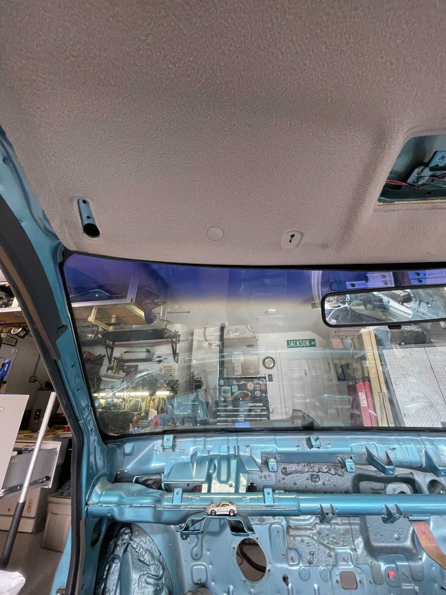

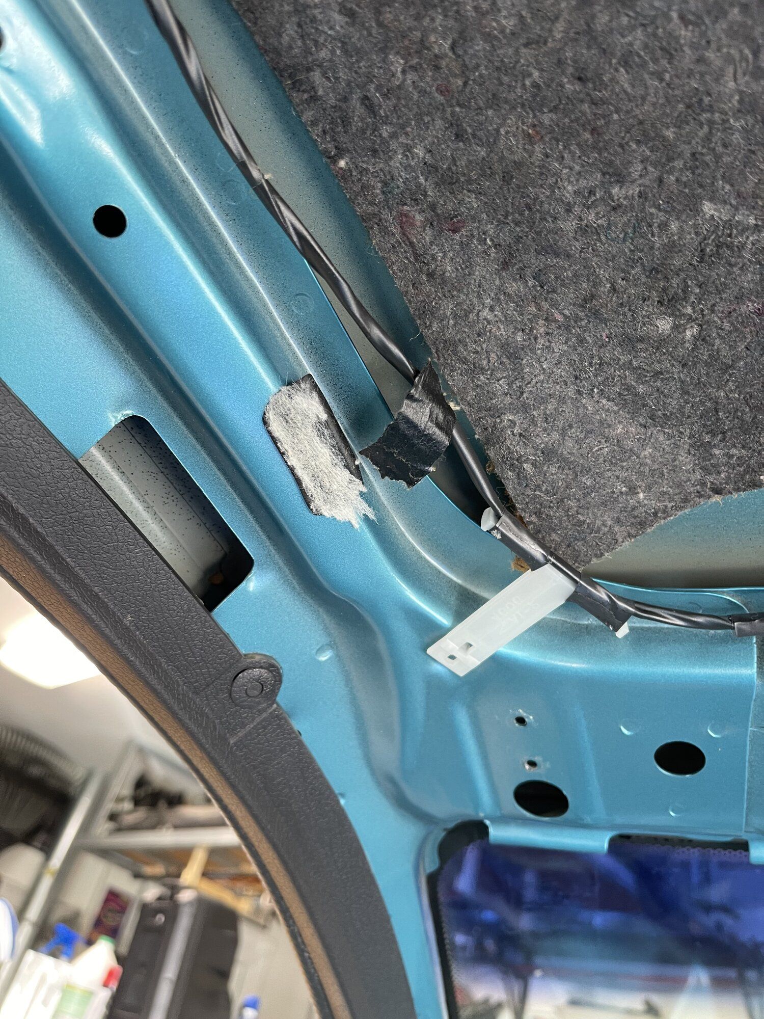

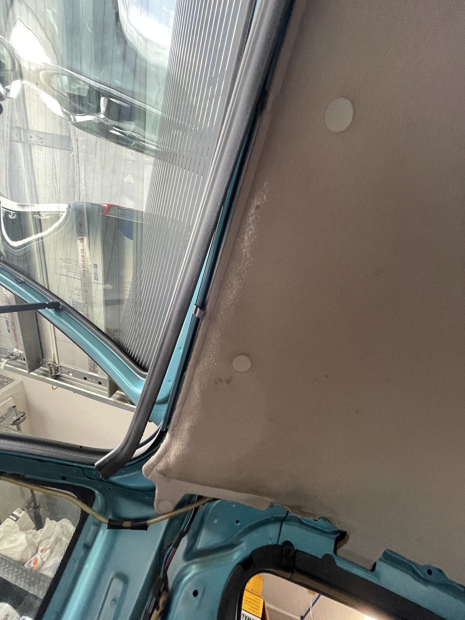

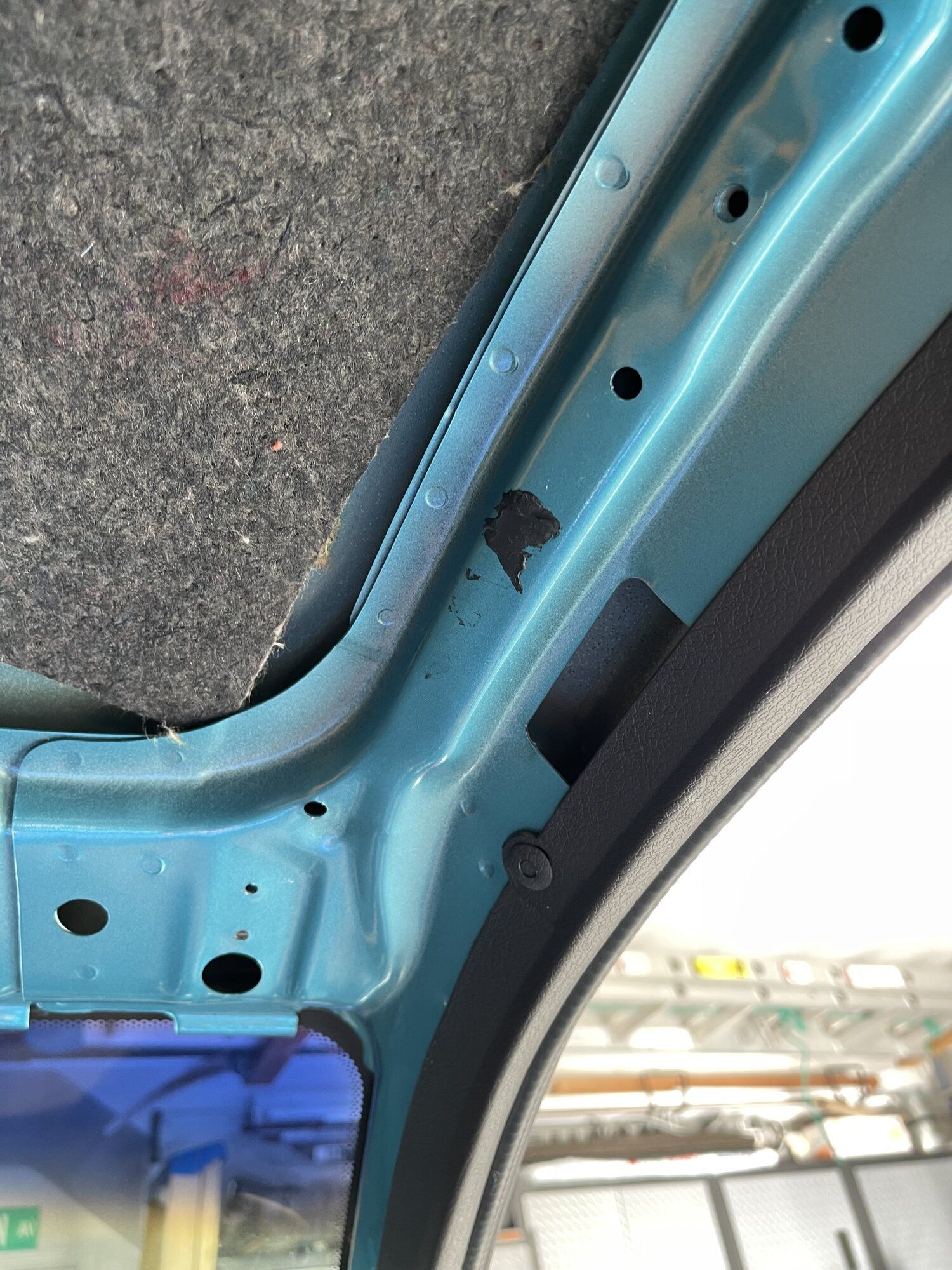

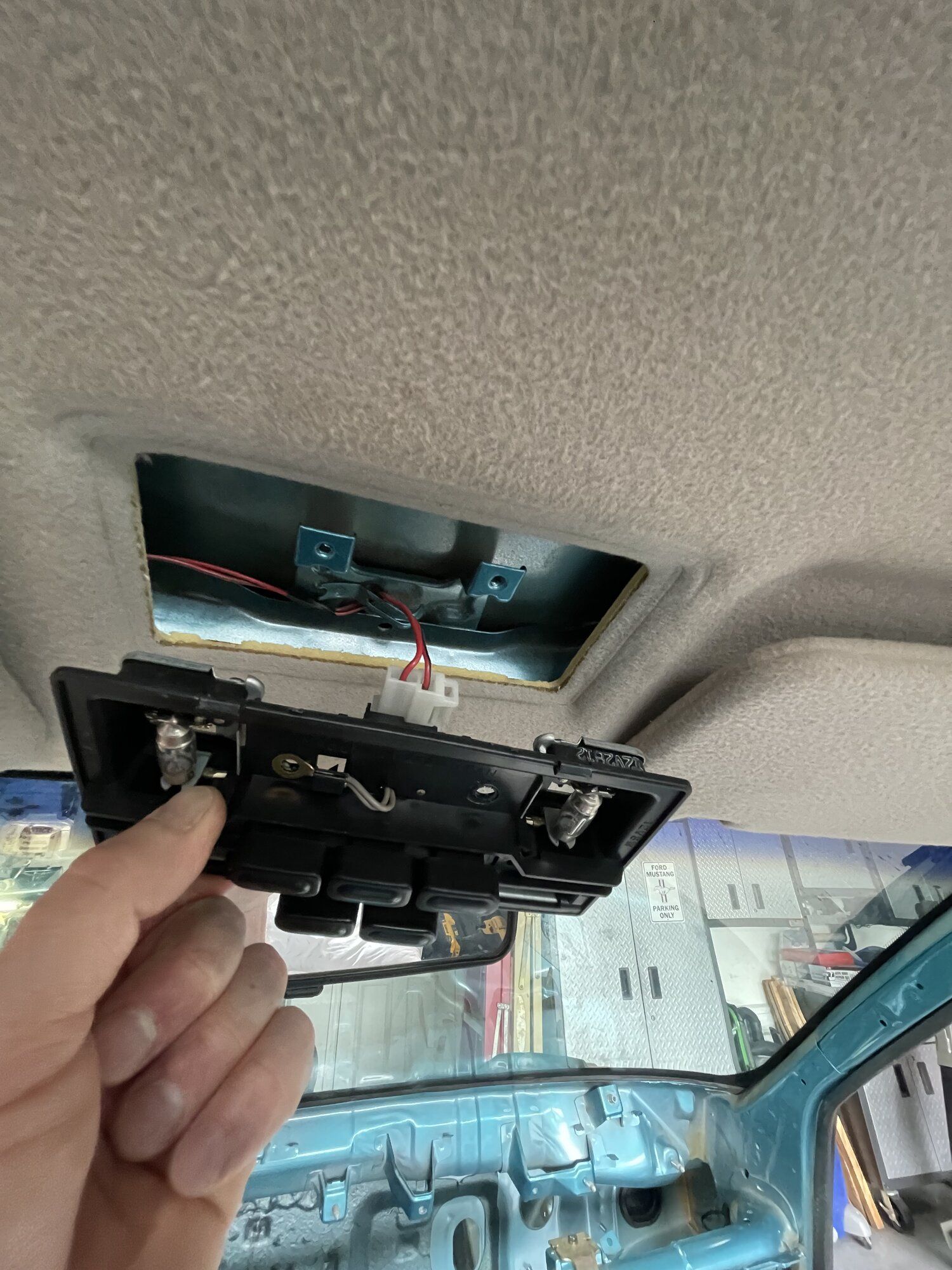

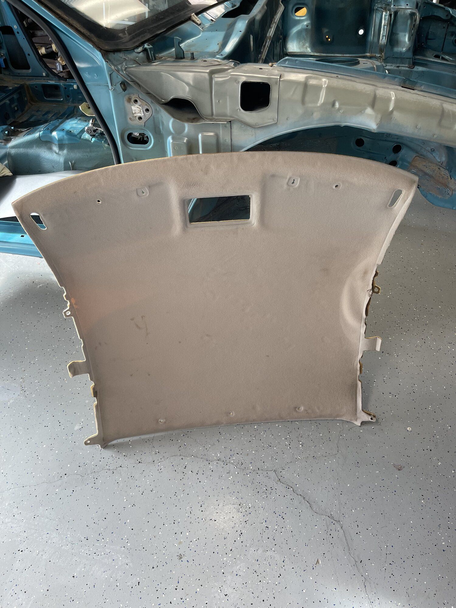

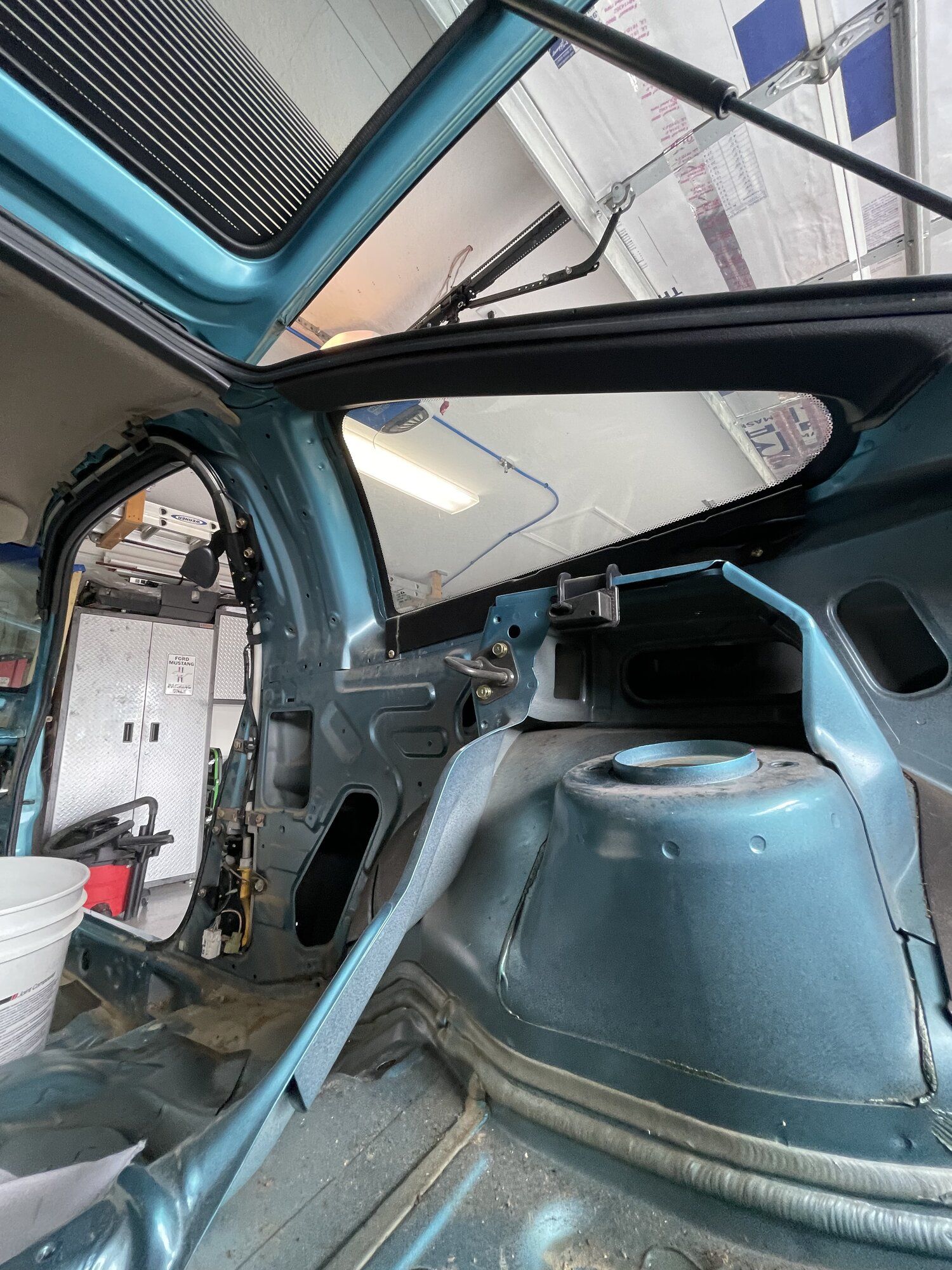

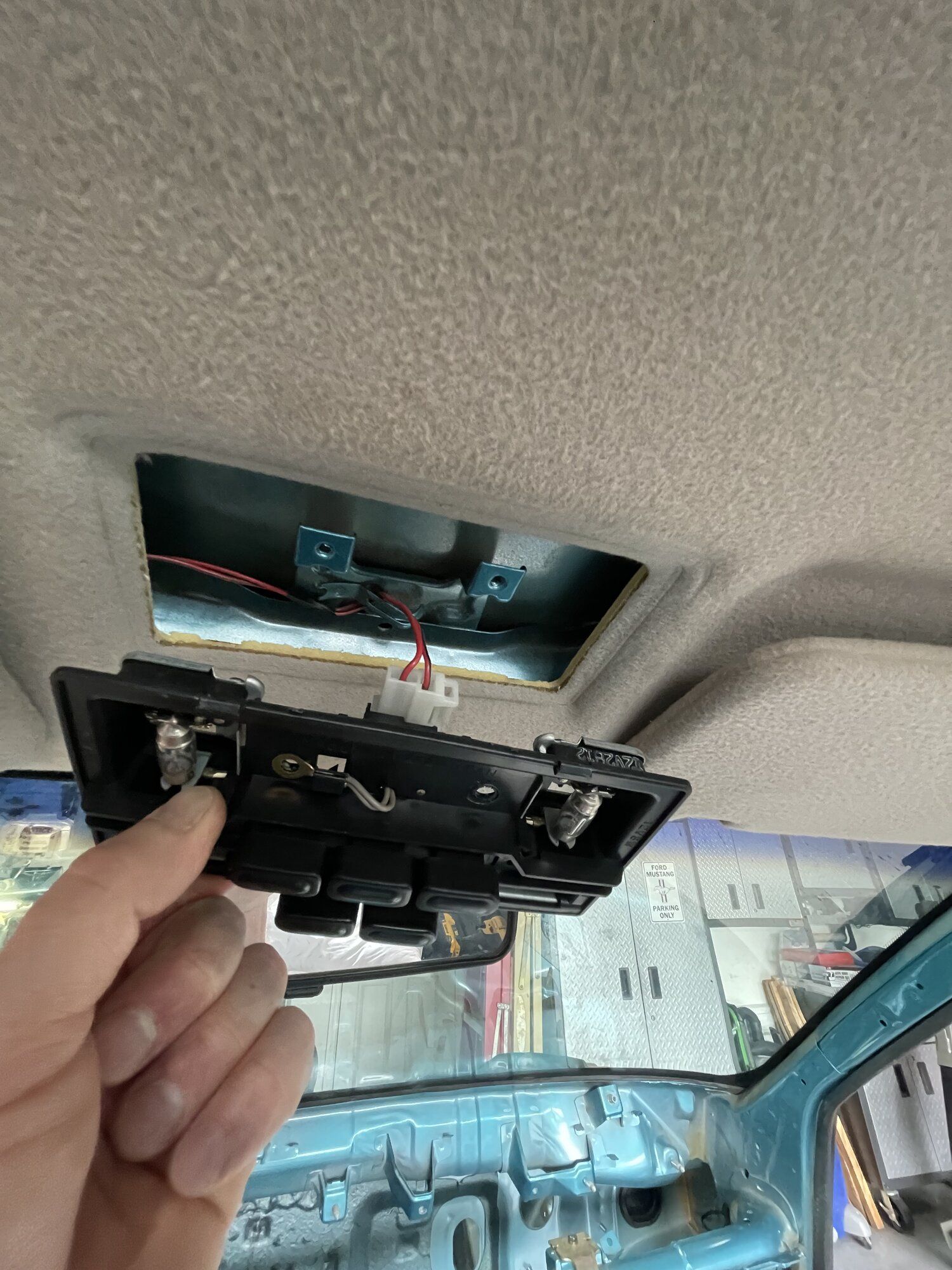

It’s not that bad. Remove all the trim pieces around it, be gentle with the plastic plugs with a panel removal tool like at the rear, and watch out for the gooey spots on the sides, I got a panel removal tool in behind to wiggle it loose from the “tar” I think.
Life-saver stuff. So it looks like I'm gonna have to unbolt the automatic seatbelt tracks, is that true or can I leave them in? Also, it looks like there's several spots it could leak from...greeeeaaat. Lol.

I think you can leave it, memory not 100% on that though as I pulled mine first anyways.
Might be easier with them removed. :idontknow:
Thanks a million fellas! Makes me feel way better about doing it. Had to replace the window unit in the living room, so that ate up all my stamina, and now it's 100* outside again. Lol. So, I'll pull the headliner and do more work on my upcoming short week.

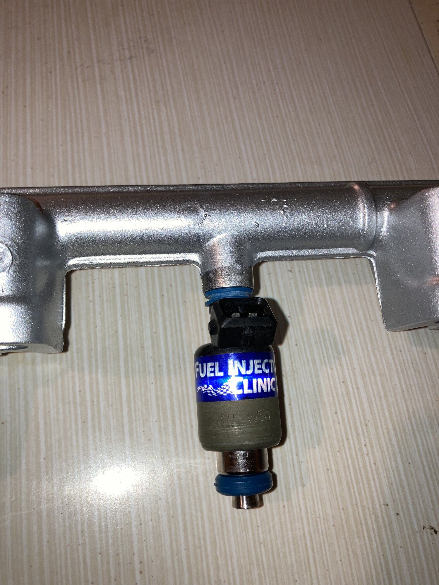

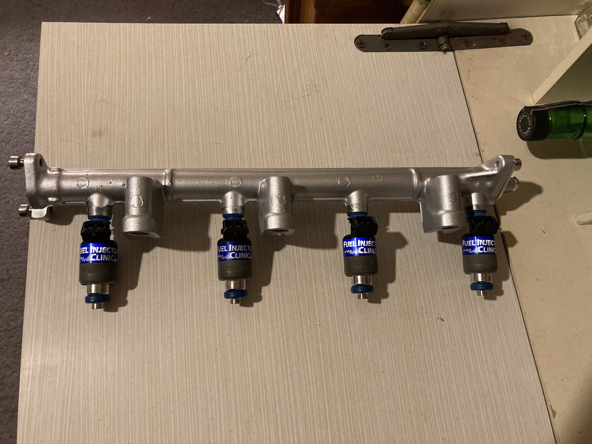

I finally ordered the right seal kit for my injectors. Nothing crazy or super duper exciting, just popped 'em on and enjoyed the view.
Looks so much better. The old spacers in between the injector and the rail were corroded/dry-rotted into oblivion and they actually started to be sucked into the rail. The bottom seals that actually go into the head were okay, but one of them was pinched pretty hard and would've been a gnarly boost/fuel leak. So now they're all supple, soft, and new! Also: loving the fuel rails new lease on life.

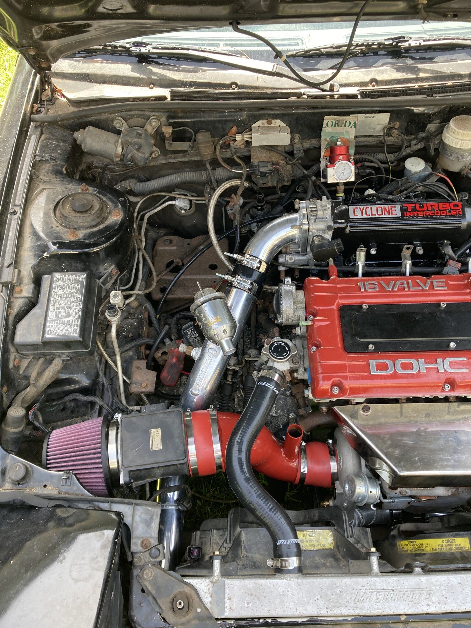

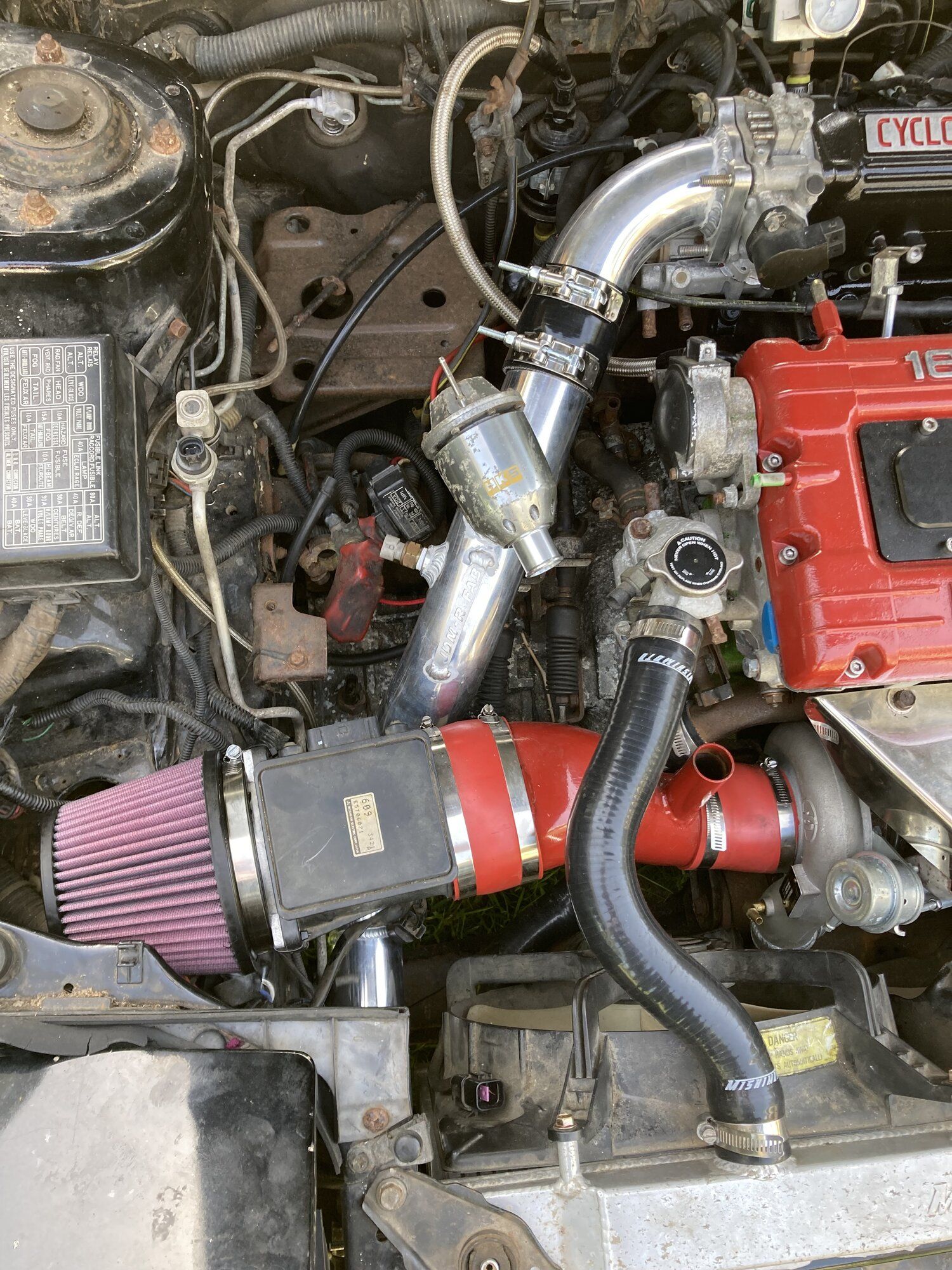

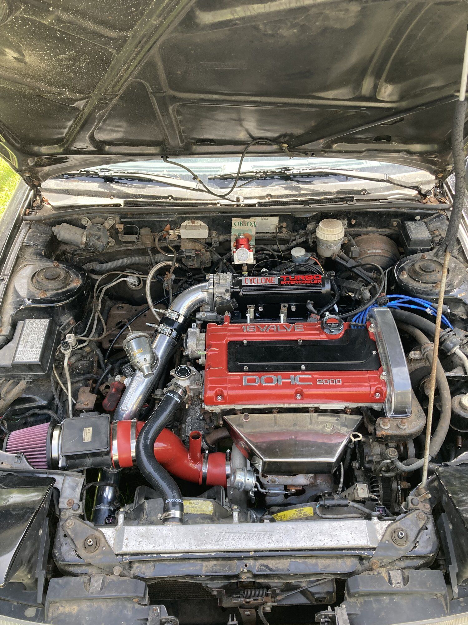

Did a little poking around today, mainly just coming up with a game plan. I am exceedingly tempted to put stock 450’s and a stock ecu in this thing just to start it, but gotta be patient.
I did a couple niggling things. Attached the k&n filter and MAF adapter, and turned the intake pipe slightly so the coupler isn’t all bent and bowed. Reinstalled the good radiator bracket, and I turned the BOV so it’ll be a straight shot from BOV to recirc tube on the intake.
I am in love with these intercooler pipes. They fit so perfect.
I was gonna drill and tap the holes for the maf adapter, but they’ve been reamed out so they’re oblong. Honestly it’s janky but fine. It won’t last long anyway, as I’m gonna only be on MAF long enough to build a SD map and iron the kinks out that pop up. But man it looks good. Gonna pressure wash the bay, and touch up some spots so the rest will match the cleanliness of the engine and pipes. Until then, I can see the diamond in the rough.

What else do you need to do before you roll that thing over and light it off?
Off the top of my head
Install rear motor mount
Install catback portion of exhaust(tempted admittedly just to run open downpipe for first start)
Install front Coilovers
Replace o2 sensor in o2 housing
Buy and Install a/c compressor
Grind cyclone to fit compressor
Install cyclone and final tightening of everything intake wise
Drain/fill oil with Break in oil
Bleed clutch
Fix 5 wires at ECU for ECMLink
Buy/install link
Load startup map for injectors/setup
Recirculate BOV to intake w/ hose
Final check of all lines and bolts
Final check of all gauge and wideband wires
Buy/Install battery
Fill with fuel
Start :D :cool:

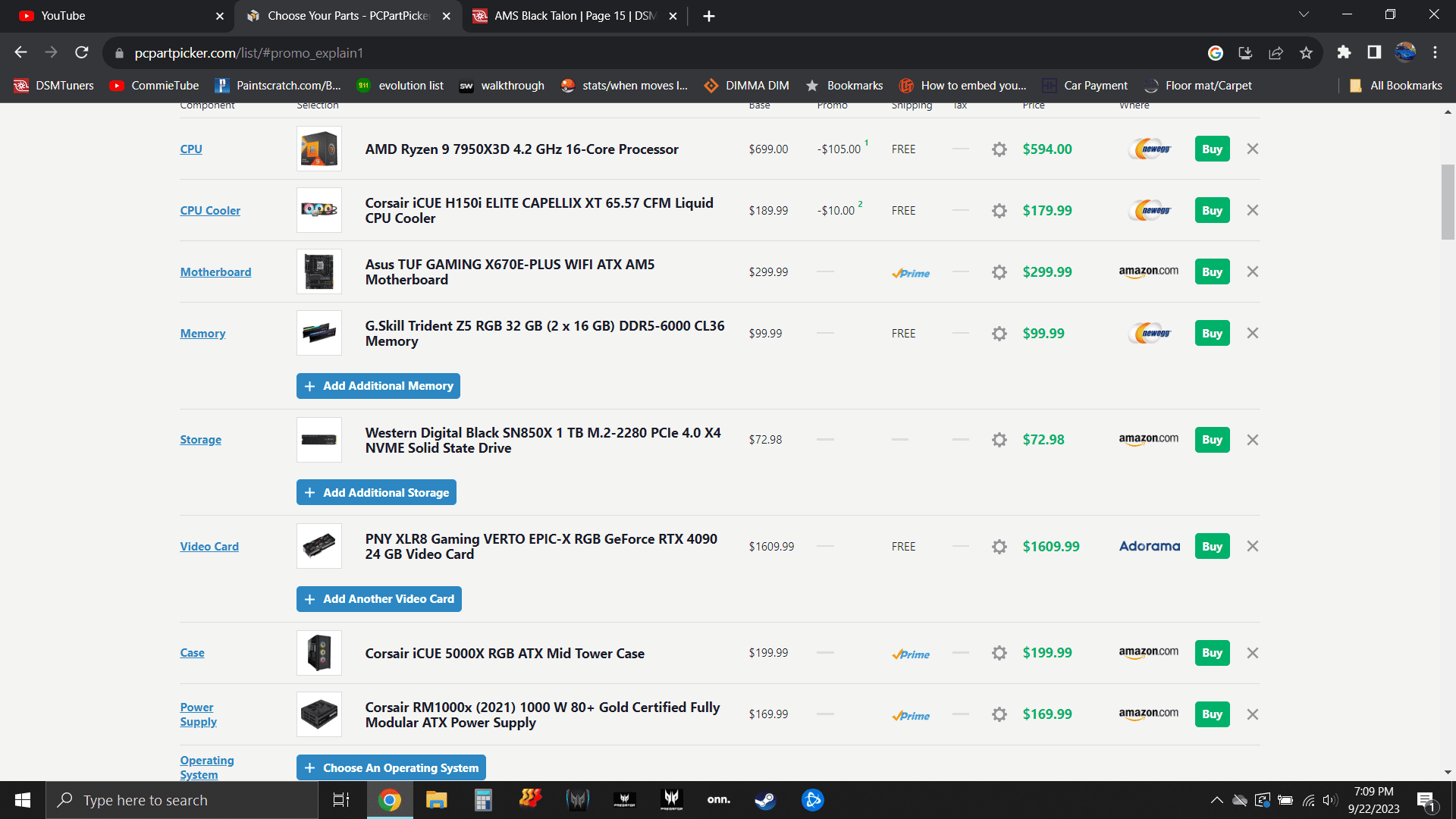

Unrelated, but nowhere else to put it, I've decided on a build list for my gaming PC. Gonna post the screen shot of the PCpartspicker list, and any tech savvy/solid PC builder guys can critique my build and are welcome to give me tips. I've decided against intel for the CPU because if I have to hold my nose and give Nvidia my money, I'm not giving team blue my money too. :p
So yeah. Probably gonna go straight for the most expensive stuff first on the list as that's the hardest to obtain. From there, the rest I can bulk order once the expensive stuff is crossed off.

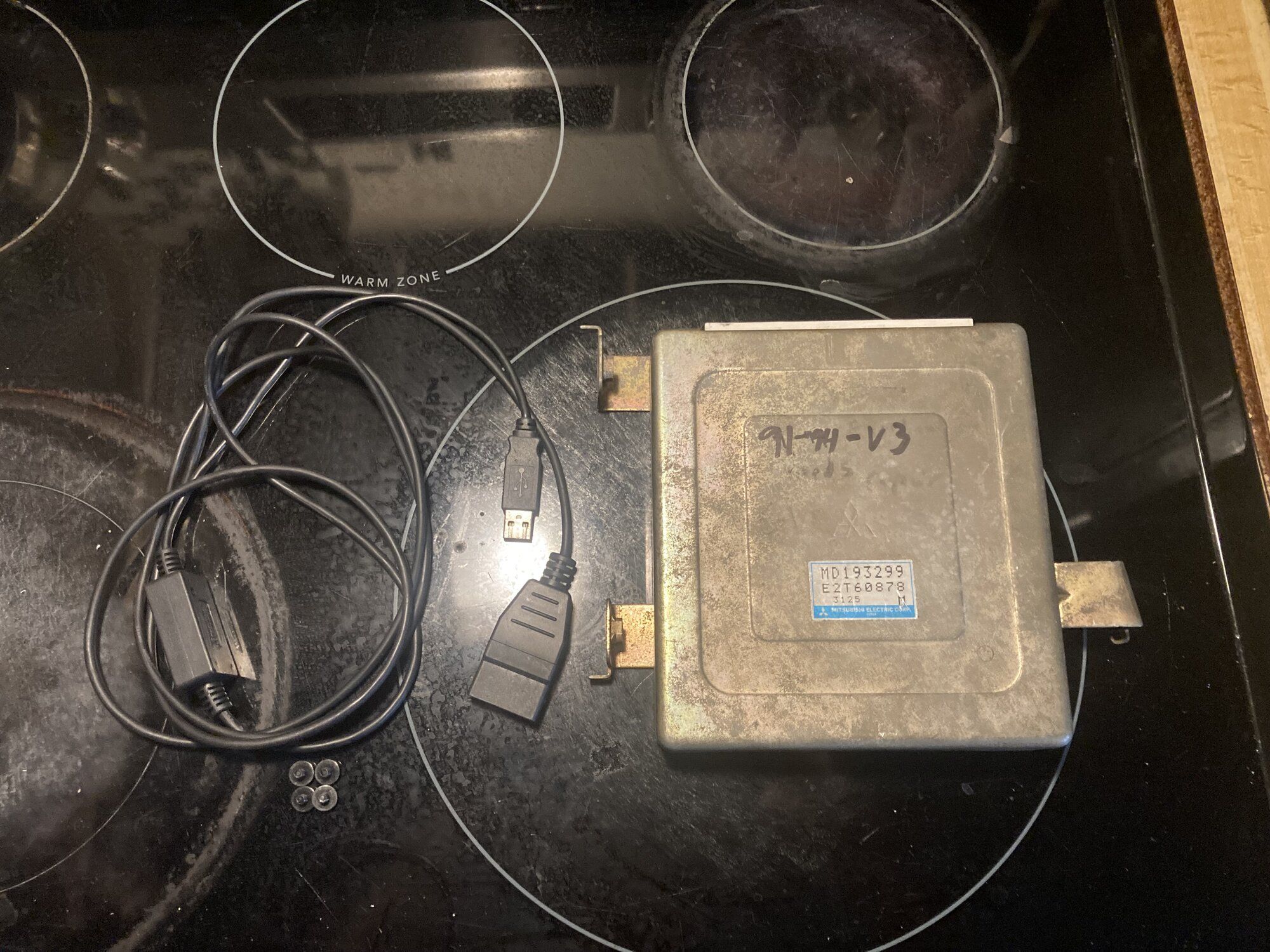

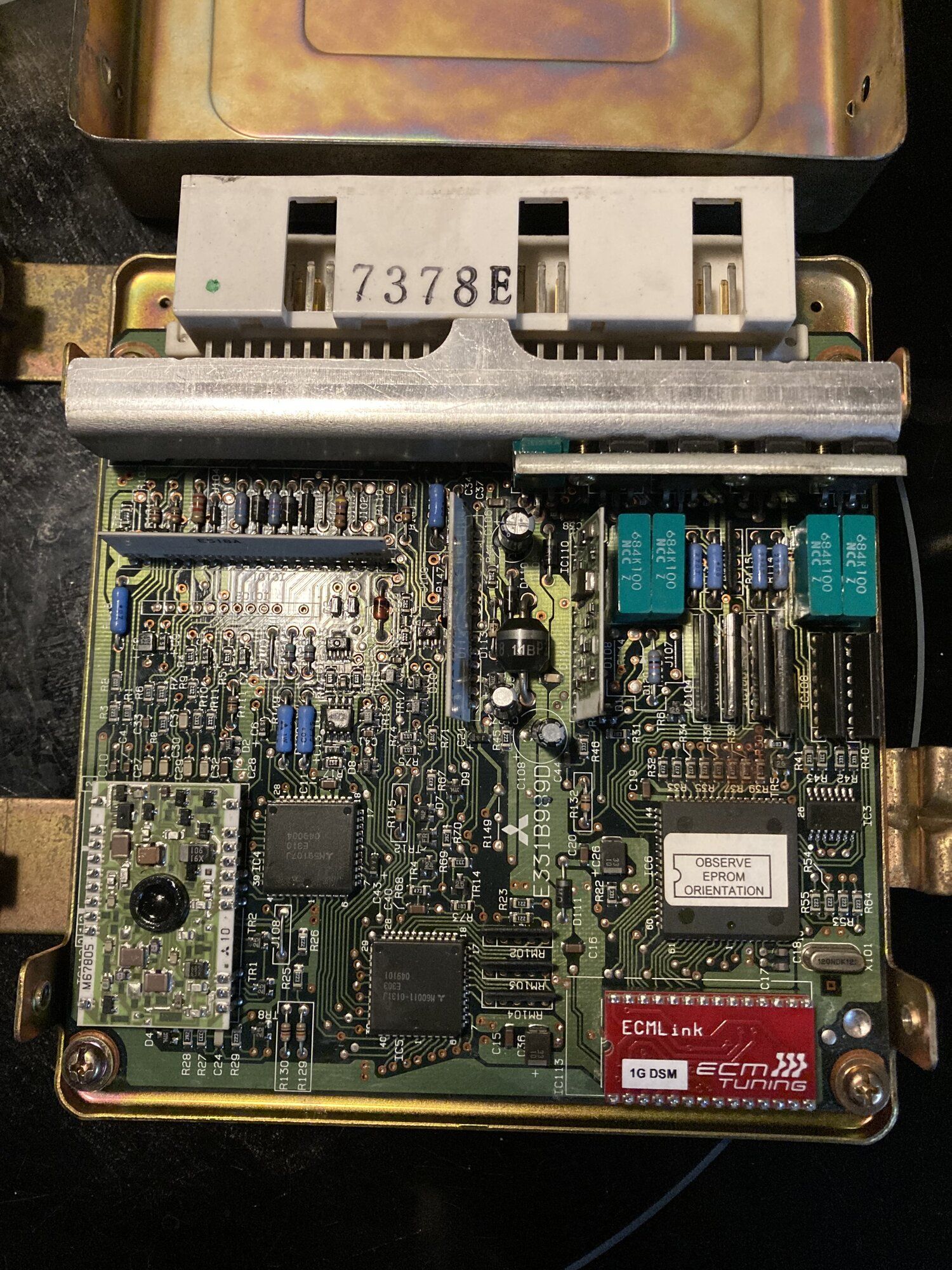

Pulled the trigger on an ECMLink package from @dacowgod. This is the THIRD TIME I've bought ECMLink, Lol, so maybe this time I'll get to use it. I'm determined. I put the PC build on hold because my wife is correct, that I need to prioritize what I want. And I want to drive this damn DSM again. Damn it. :p
But from here I'm just missing a battery, an A/C compressor(and an a/c o-ring kit), and some elbow grease. Really gonna try to start this bad boy ASAP, soon as I have the ECU here.

For the third time, Lol, this has come in the mail. From Ricky @ Rix Racing himself. This time I swear I'm gonna use it. Lol.
Looks so good. As long as I'm not sick, this weekend I'm really gonna try to start it. I'll just wait on the damn A/C Compressor. Lol. I want to hear this thing run already.
Nice. Did you get the deal with the remote tune included?
I did but I don’t think I’ll get one. I like tuning myself. It was a super fair deal honestly so even with no tune I’m happy.

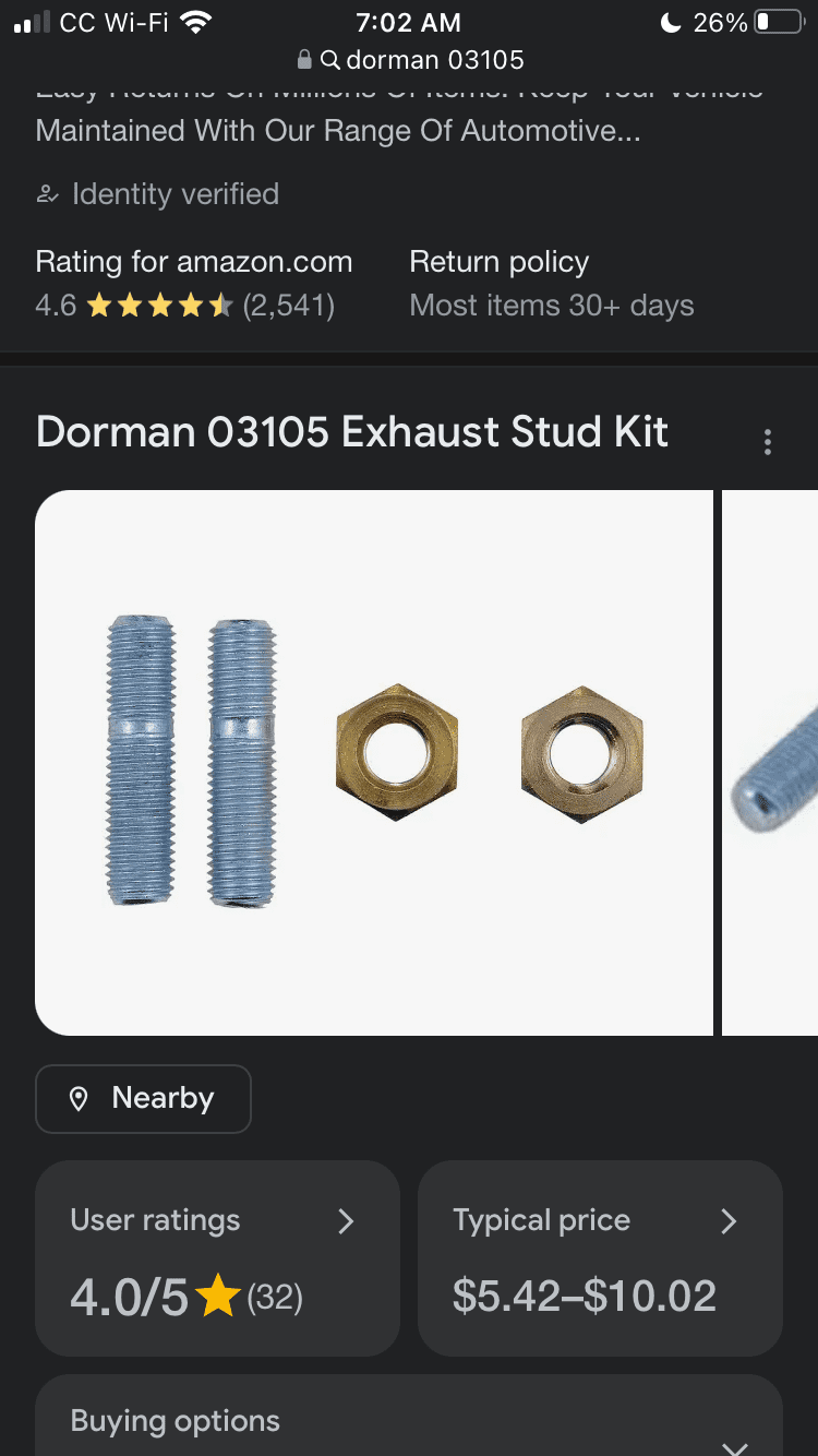

Also: if you find yourself needing new studs for your intake manifold but don’t need new bolts, grab yourself this.
Amazon product ASIN B000CO76HY
It’s Dorman 03105 exhaust stud and nut kit. The length and nut size are OEM and perfect fit. Add a couple crush washers and you’re good to go.
They’re like $9 at the parts store too if you go pick it up in person. Fit perfect and are great quality. Including a screen shot for posterity sake in case the link dies 10 years from now.
