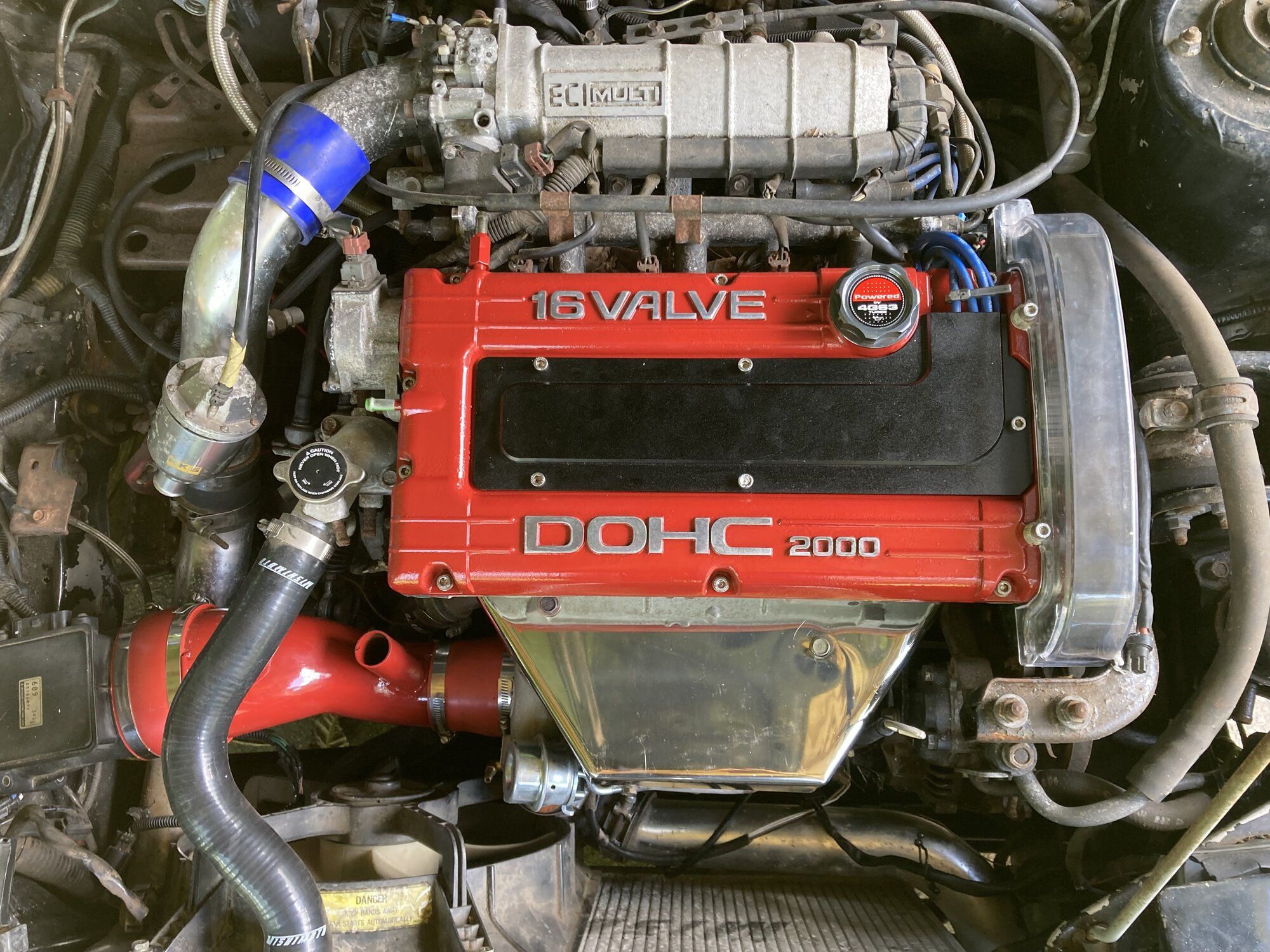

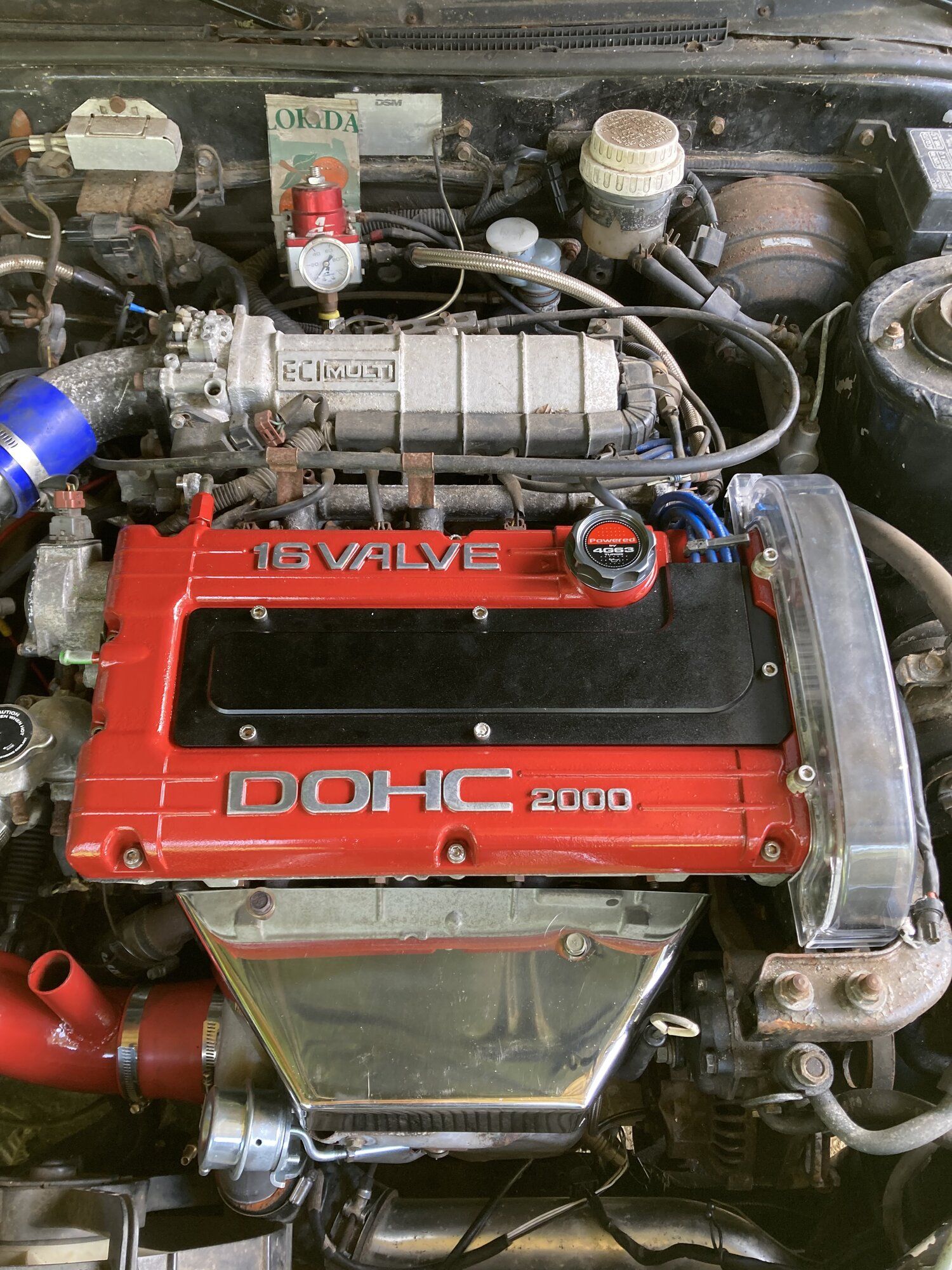

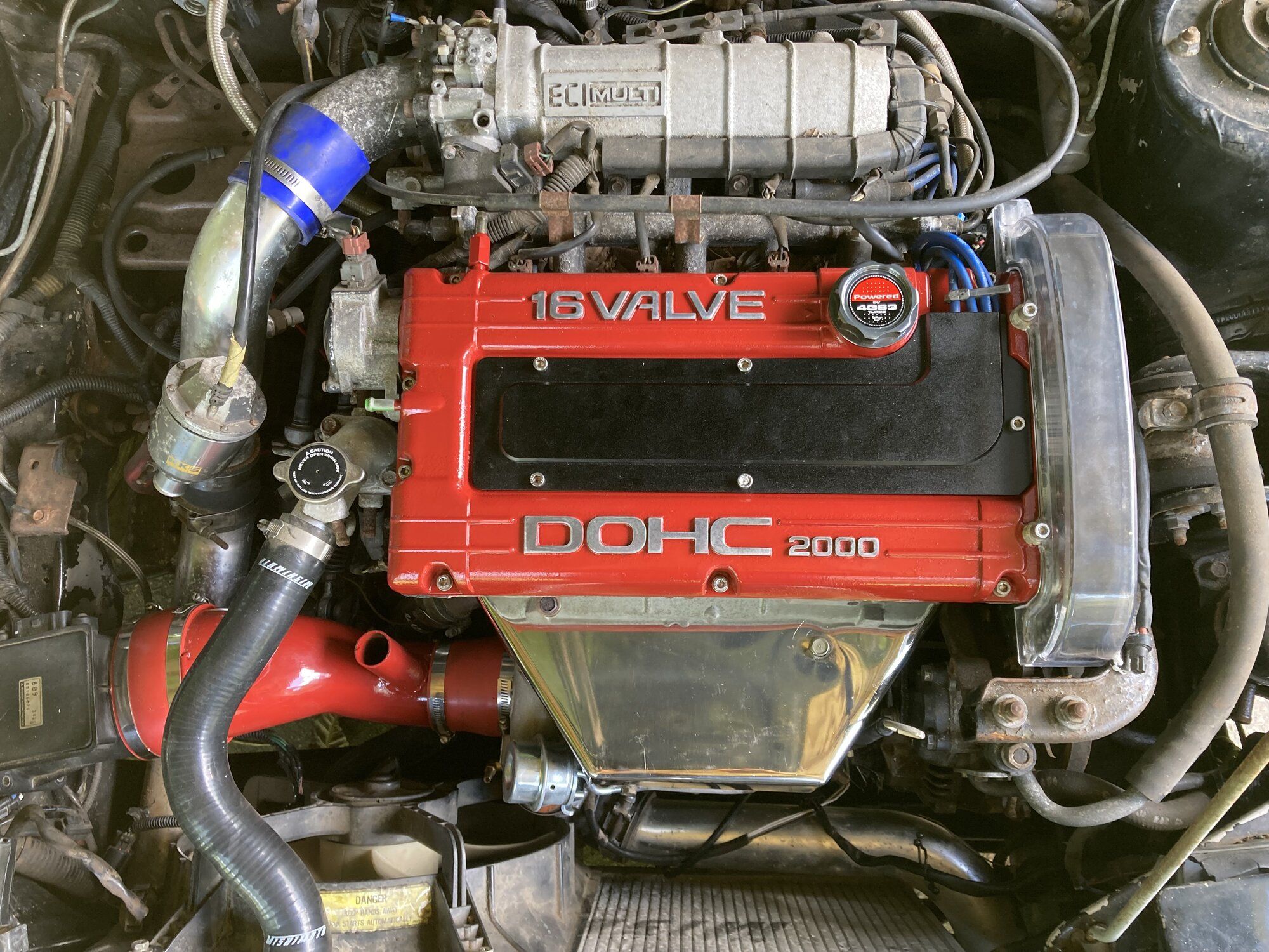

Finally did something I've been meaning to do for like 2 months now. Lol.

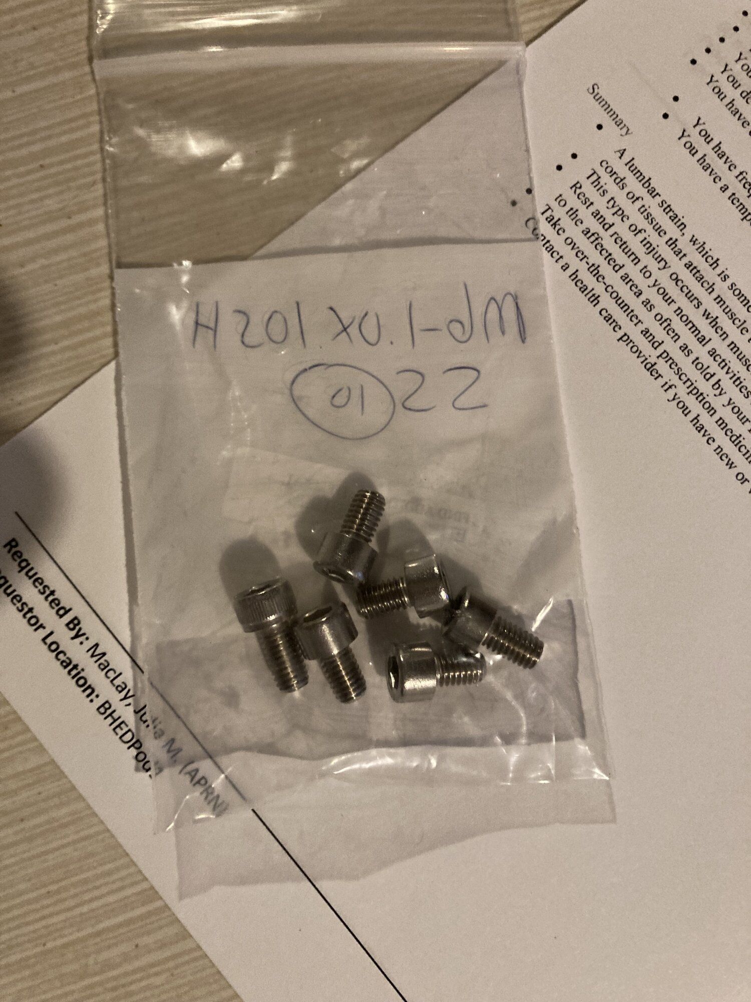

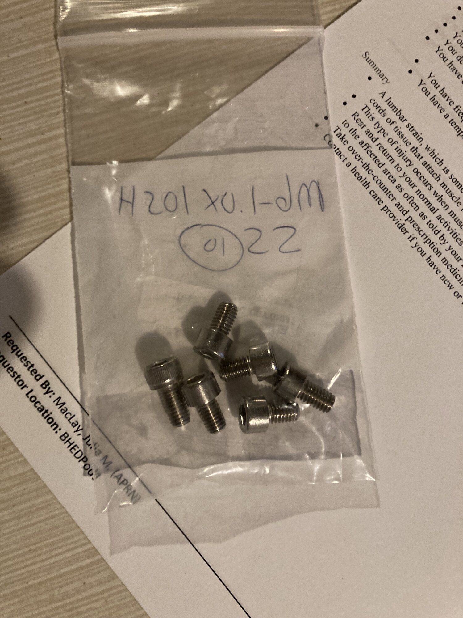

Finally bolted down the spark plug cover with matching stainless allen bolts. They're absolutely perfectly sized for the thicker spark plug cover OR the OEM cover(may need a wider washer for the OEM cover depending on how wallered out they've been from time and heat). I also added in an eBay special oil cap. One the terrible little sticker falls off I'll get a better one made of an Eagle or something. I'm also a little annoyed because it was supposed to be chrome, but whatever.
As a bonus for anyone reading this far, if you need some spark plug cover bolts and don't want to pay the $20 for them that other places charge, I'll just send you these for the cost of shipping. Hit me up.

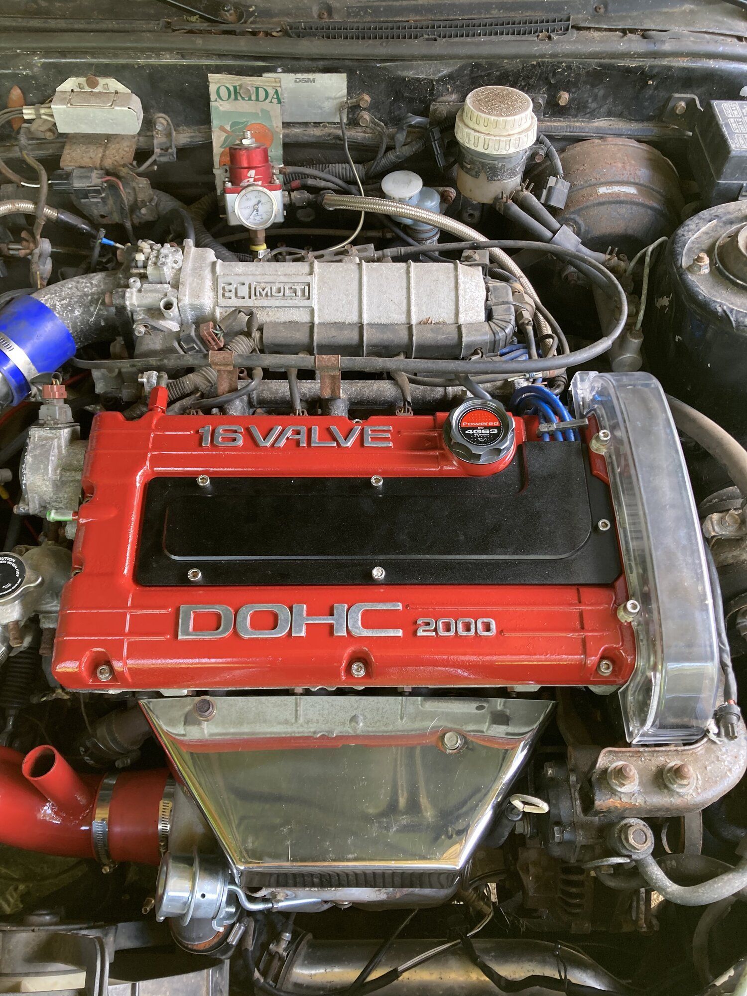

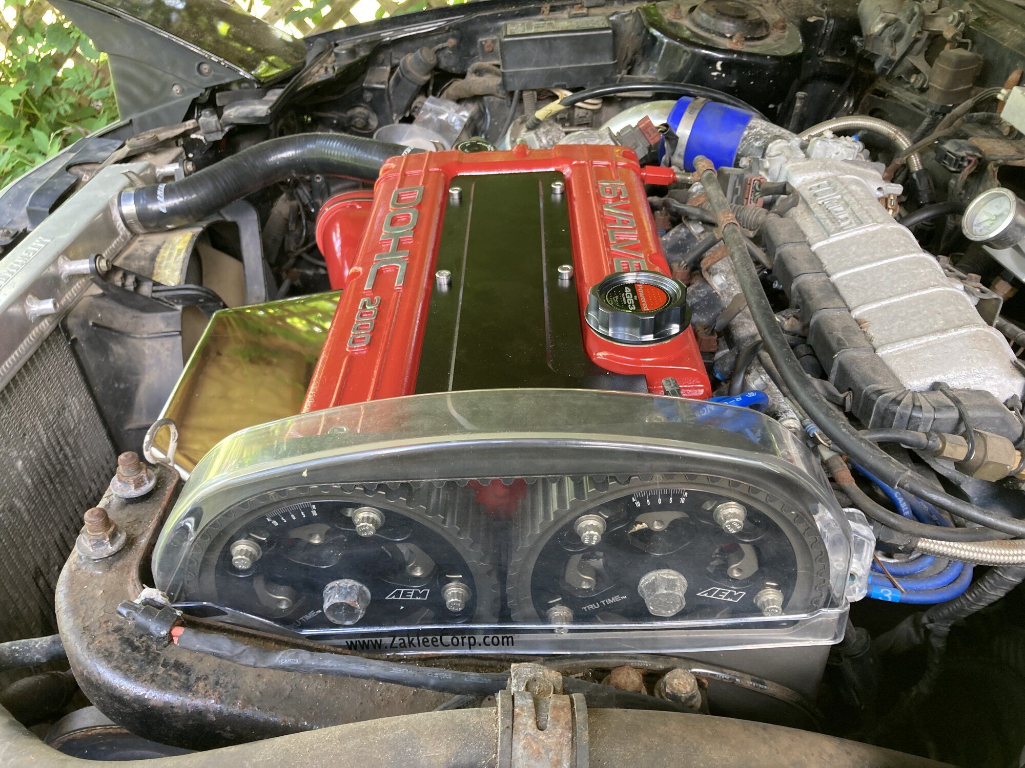

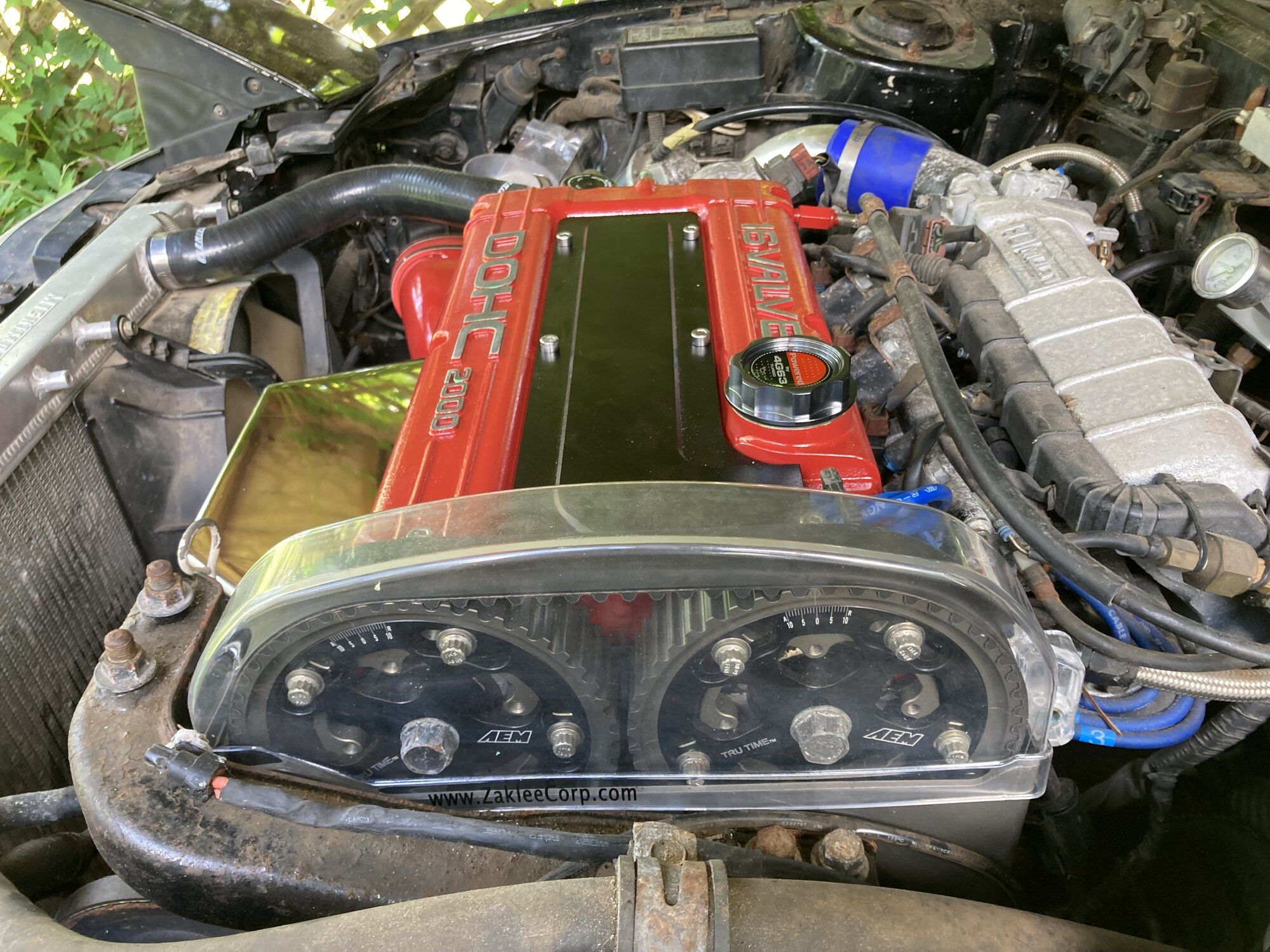

Ok - I’m asking how you managed to get stock cam gear bolts and original AEM cam gear hardware to fit under your timing covers without running into everything.
I honestly have no clue. Lol. I’ve heard they’re supposed to scratch or rub but they don’t. Not even close.
My best guess is that this is an original zaklee clear cover from early 2000’s or whenever he first produced them. On IMVFilms Texas streets video you can see the clear timing cover in the under hood shot and that video was shot ages ago. When Supra’s were the top dogs at TX2K.
But yeah. I have no clue LOL. AMS built this car so maybe they took a heat gun to the cover and widened it inside.

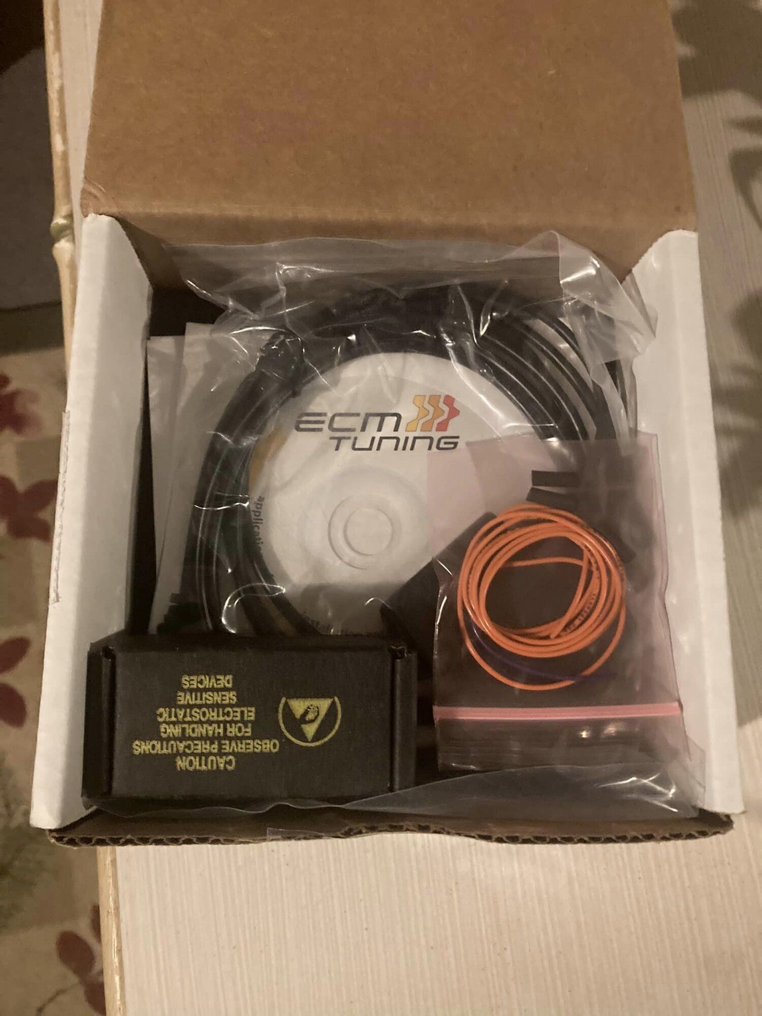

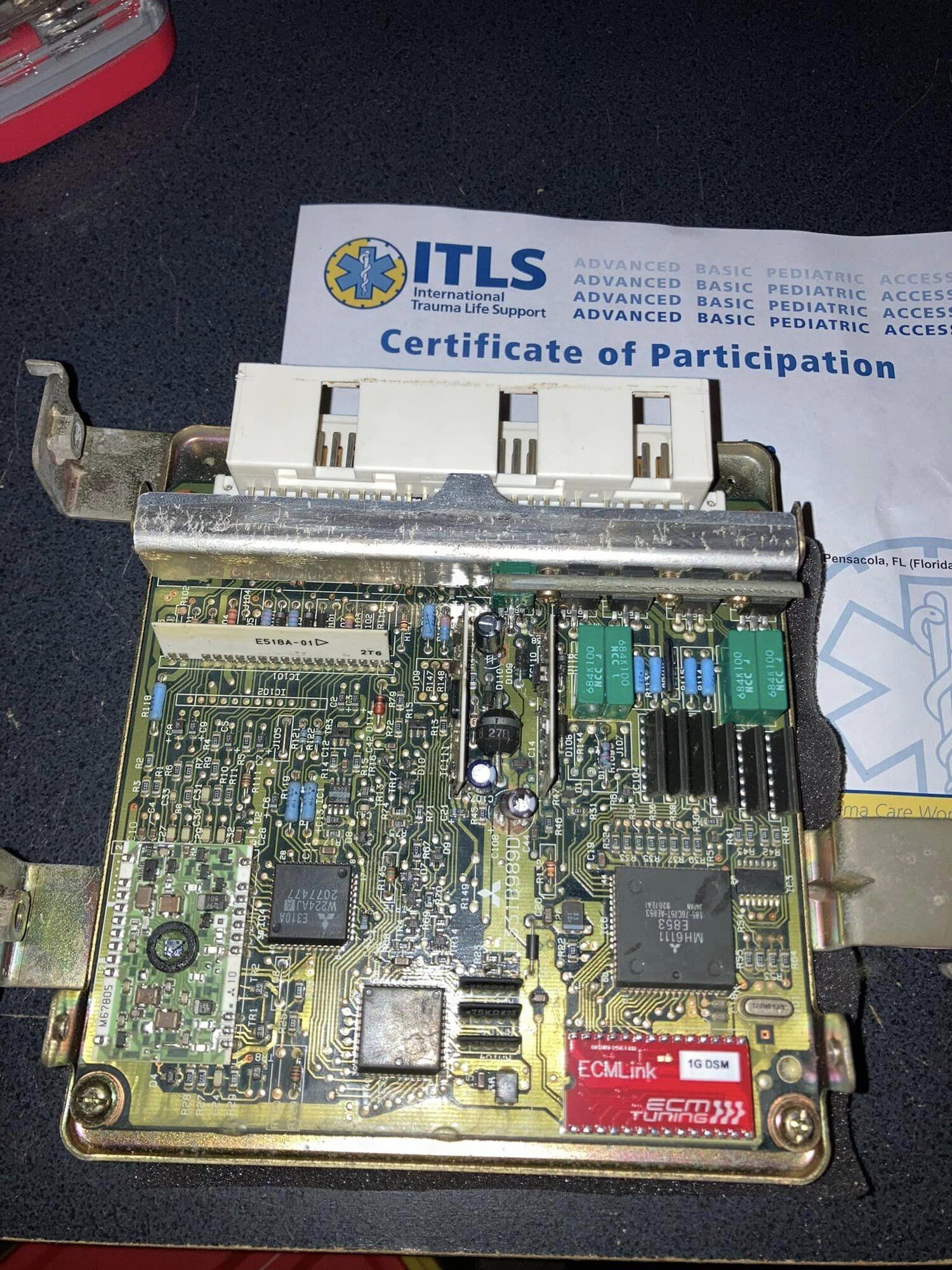

:D I sold my other ECMLink/ECU setup off because unexpected stuff happened. But now I've got it back, and this time it's brand new. So that's exciting.

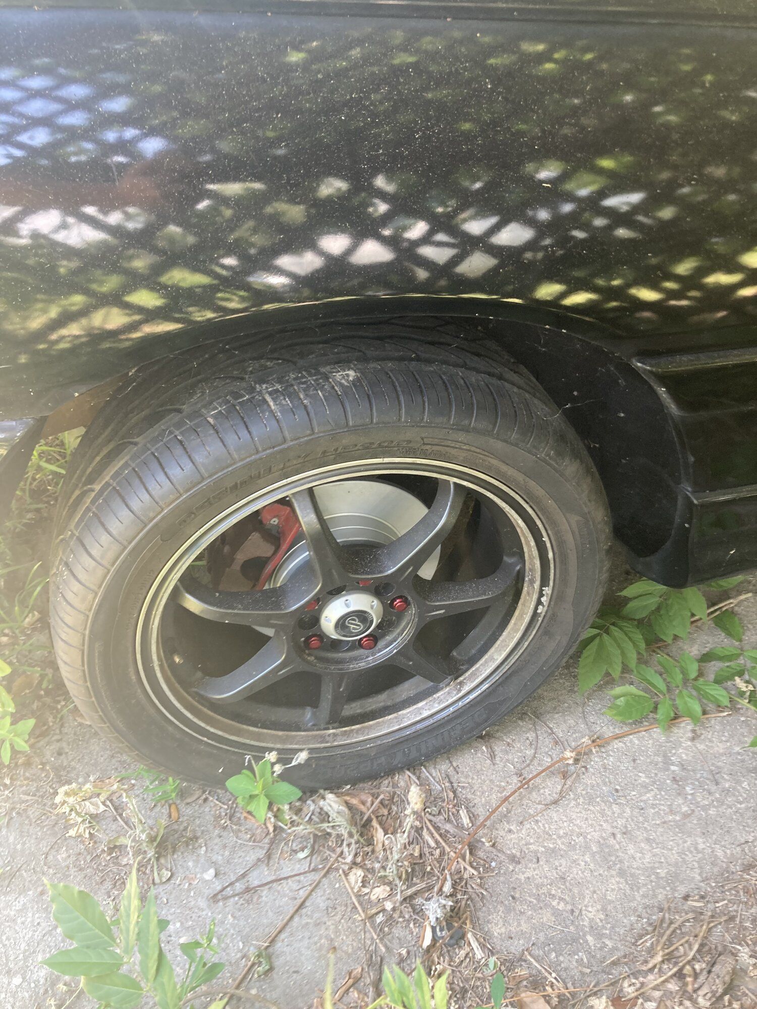

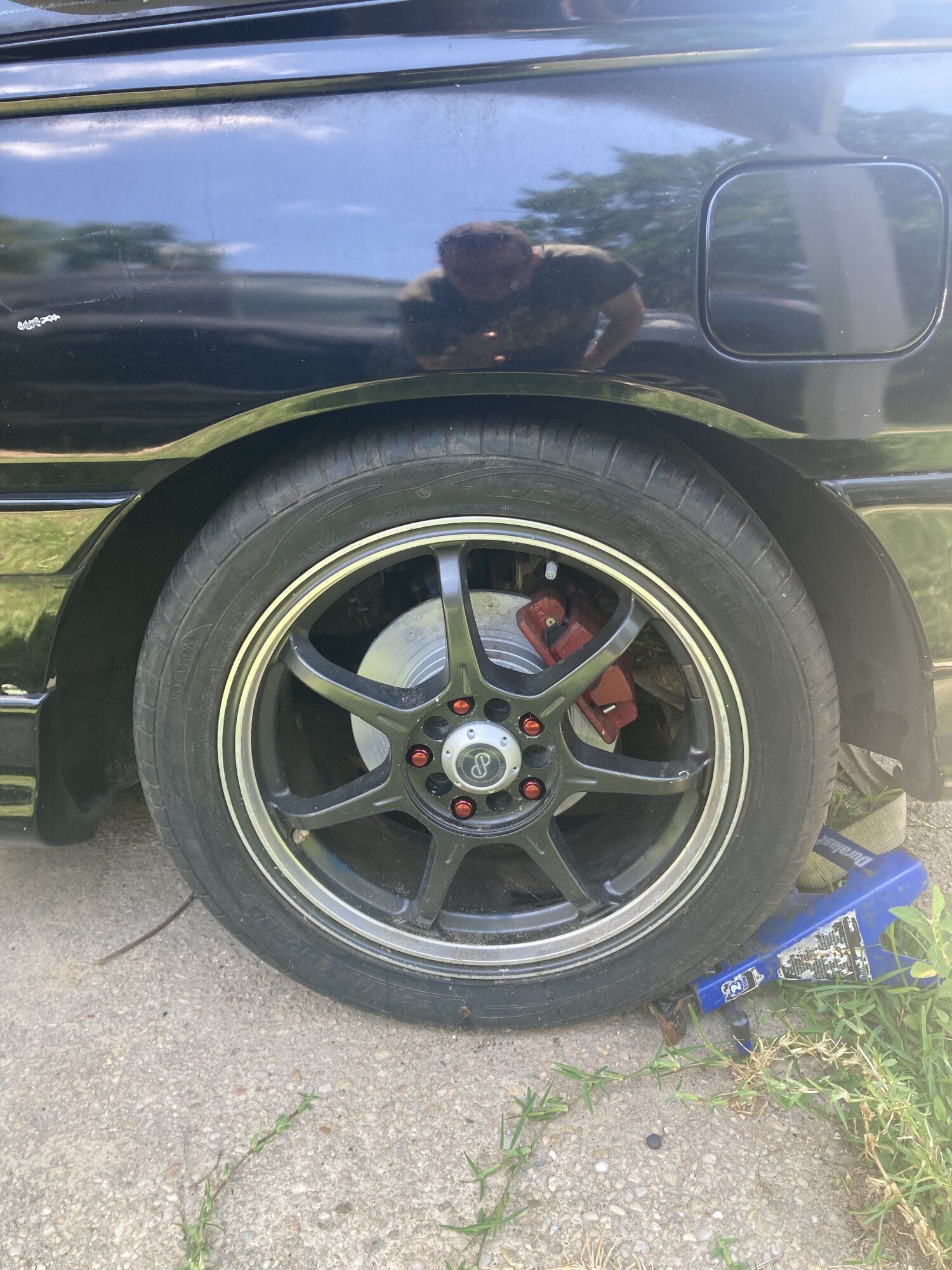

I've been meaning to dig into why the car has a gangsta lean on the back left side, and I think I found out why.
Everything else under the car looks straight and fine, or at least the same as the right side doing a direct comparison. It looks like the spring is either broken, or just gave up. Lol.
This is the Left side
To compare it, this is the right side rear
I'll have to give a better look but it doesn't appear that the wheel is severely towed in or anything either, so IDK. I may just go with some replacement control arms just to be safe. Here's a booty shot of said gangsta lean.
Well, that's one problem addressed. Not in a negative or bad mood, just a fact finding mission. Guess I'll put coilovers higher up on the priority list. Anyone got any feedback or theories? I have a video of the control arm and stuff I can upload, but to the naked eye nothing looks wonky.

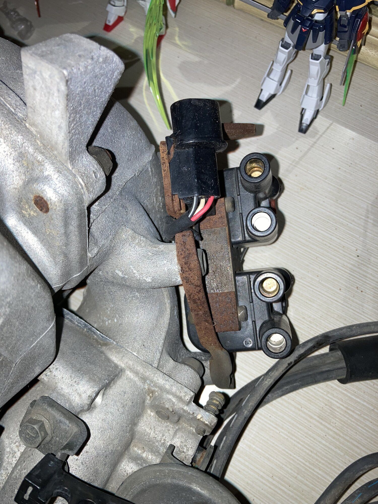

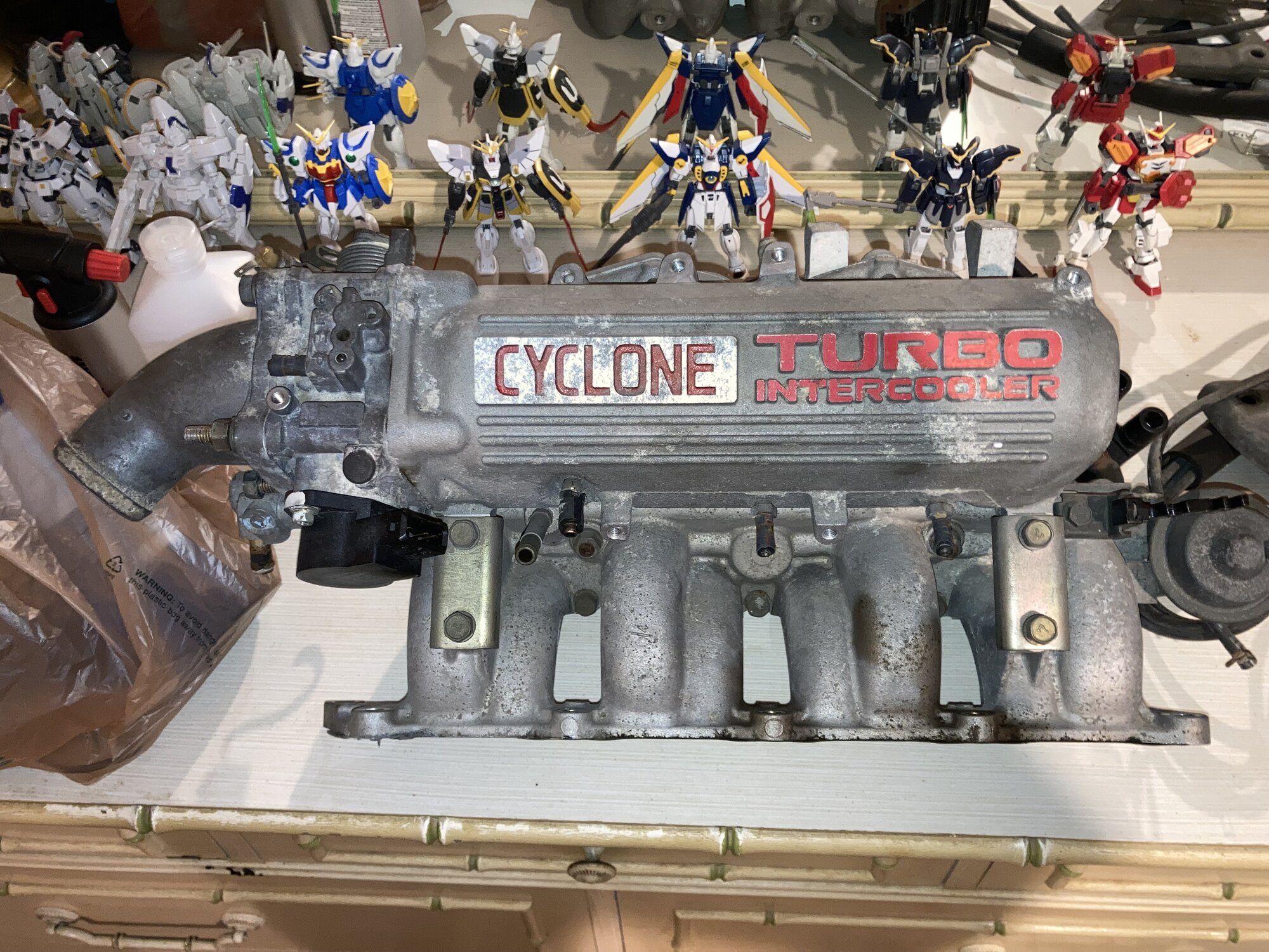

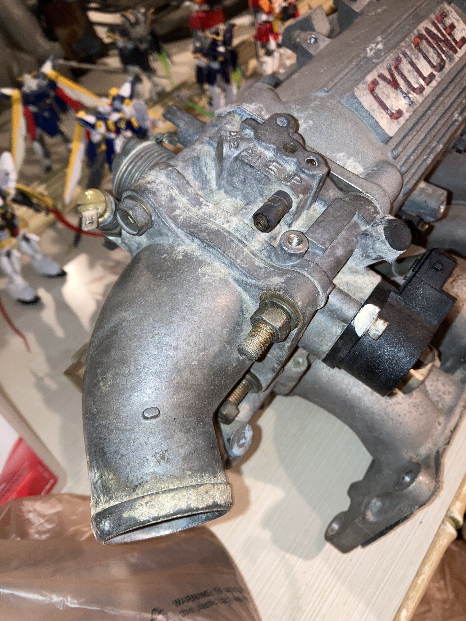

This came via UPS while I was at work. Freakin stoked. I got a fantastic deal on this and this is my favorite street manifold for a dsm ever. I think I especially got a good deal for everything that was included.
And something I’ve personally never seen…
The jdm coil pack with bracket! It’s a complete manifold. Blows my mind. The throttle body is still tight and not that dirty inside tbh, and inside the manifold itself there’s some oil but not bad at all. I’m gonna clean it out with some gasoline. But I’m stoked.
I’m gonna paint the manifold too, I’ve decided. It’ll be the inverse of the VC. Can’t wait to see how this pairs with the FP Green. :D

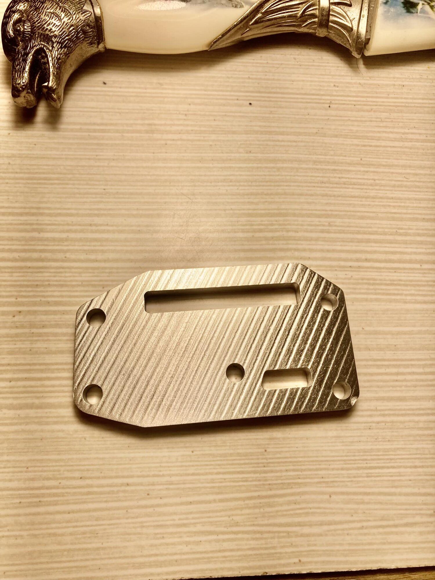

This came in while I was at work(getting my ass absolutely handed to me by a freak popup storm, more details in bottom of post) and I'm excited. It's tiny and less than $30 but good stuff nonetheless. From our very own @Gamble97 as well!
So pretty. Sad it'll be hidden away inside the TB. Can't wait for the paint to come in so I can paint the Intake and the other VC. Because then I can install the Cyclone. :D

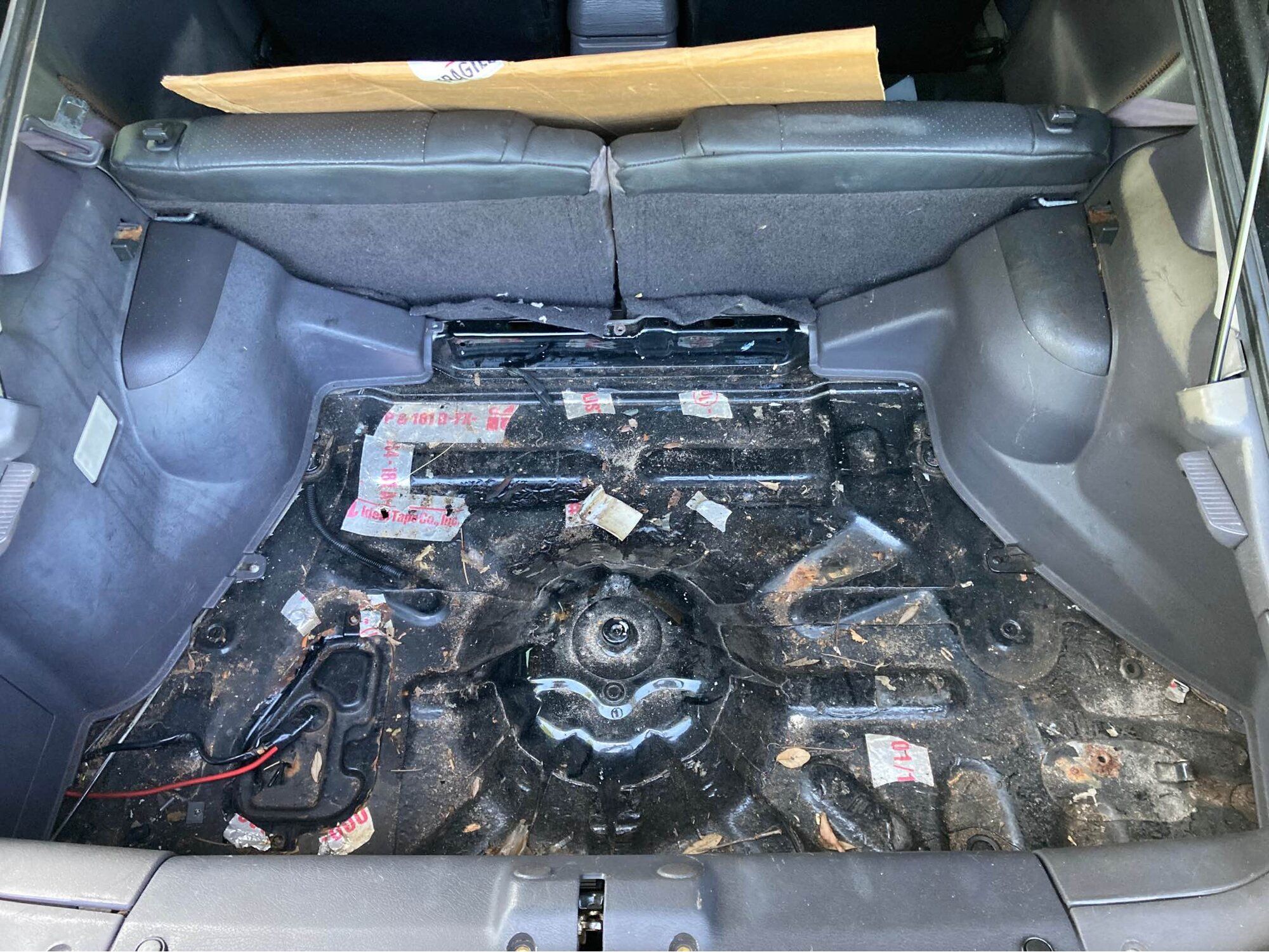

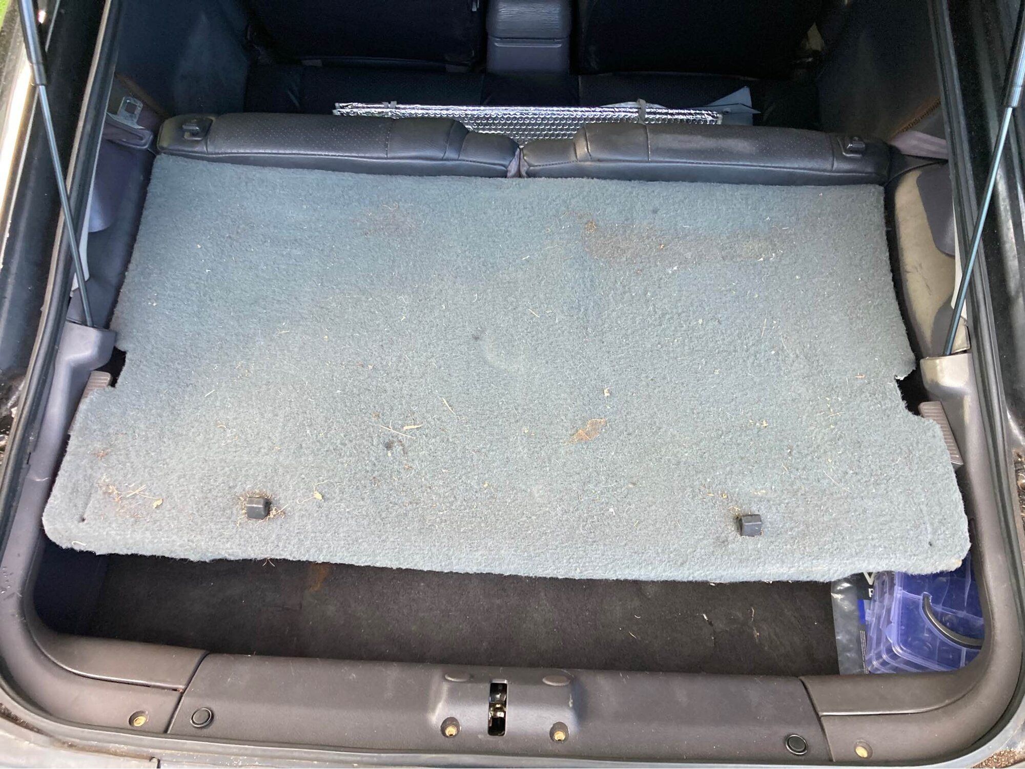

I got this from a friend in SoFla. The same one who sold me the black leather and the cyclone. I joked with him that soon I'm gonna just buy the whole car from him piece by piece. :p LOL
Before

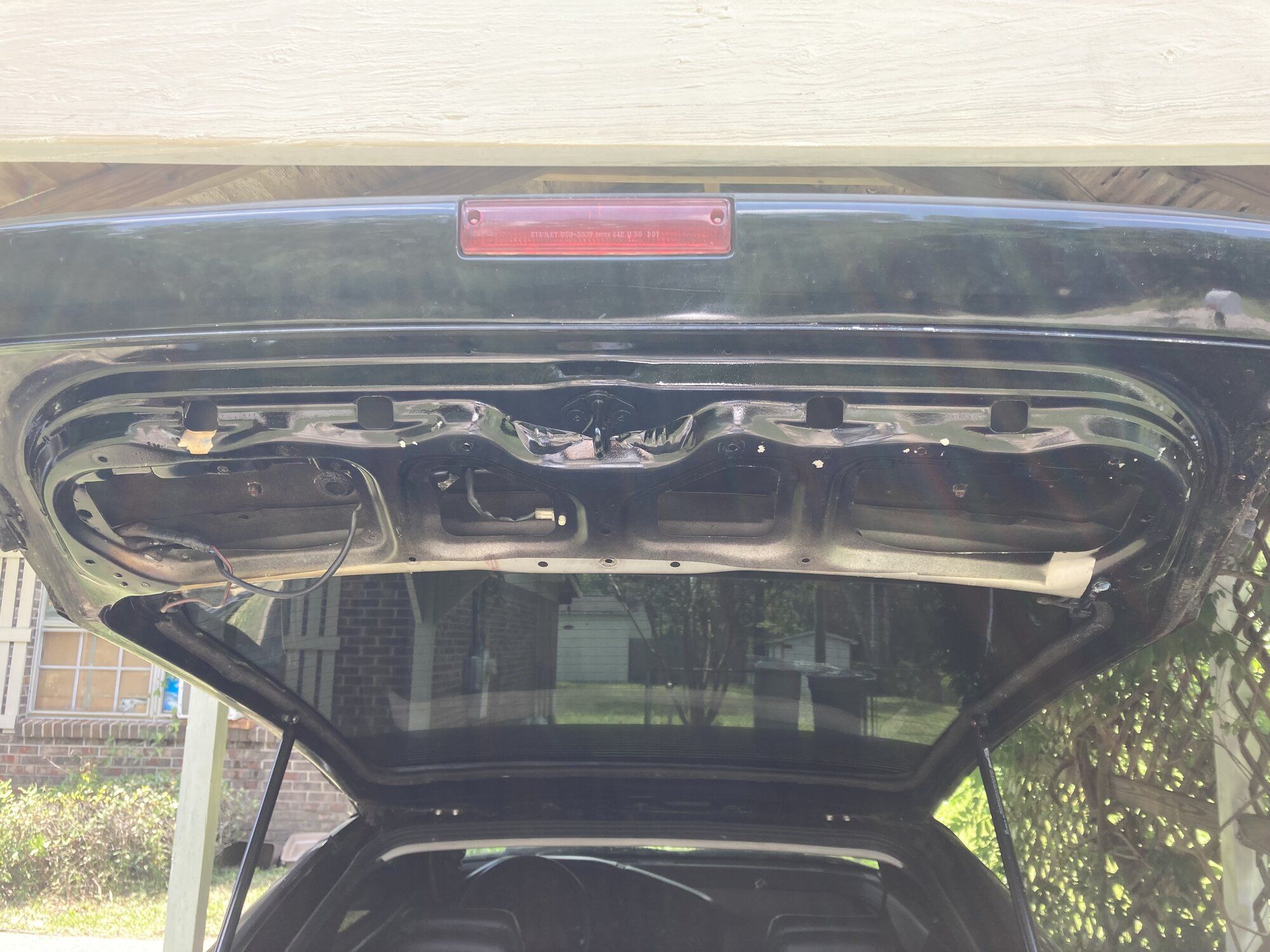

(still gotta fill the holes you see, I'm gonna line the whole floor with some sound deadening mat. That should do it nicely.)

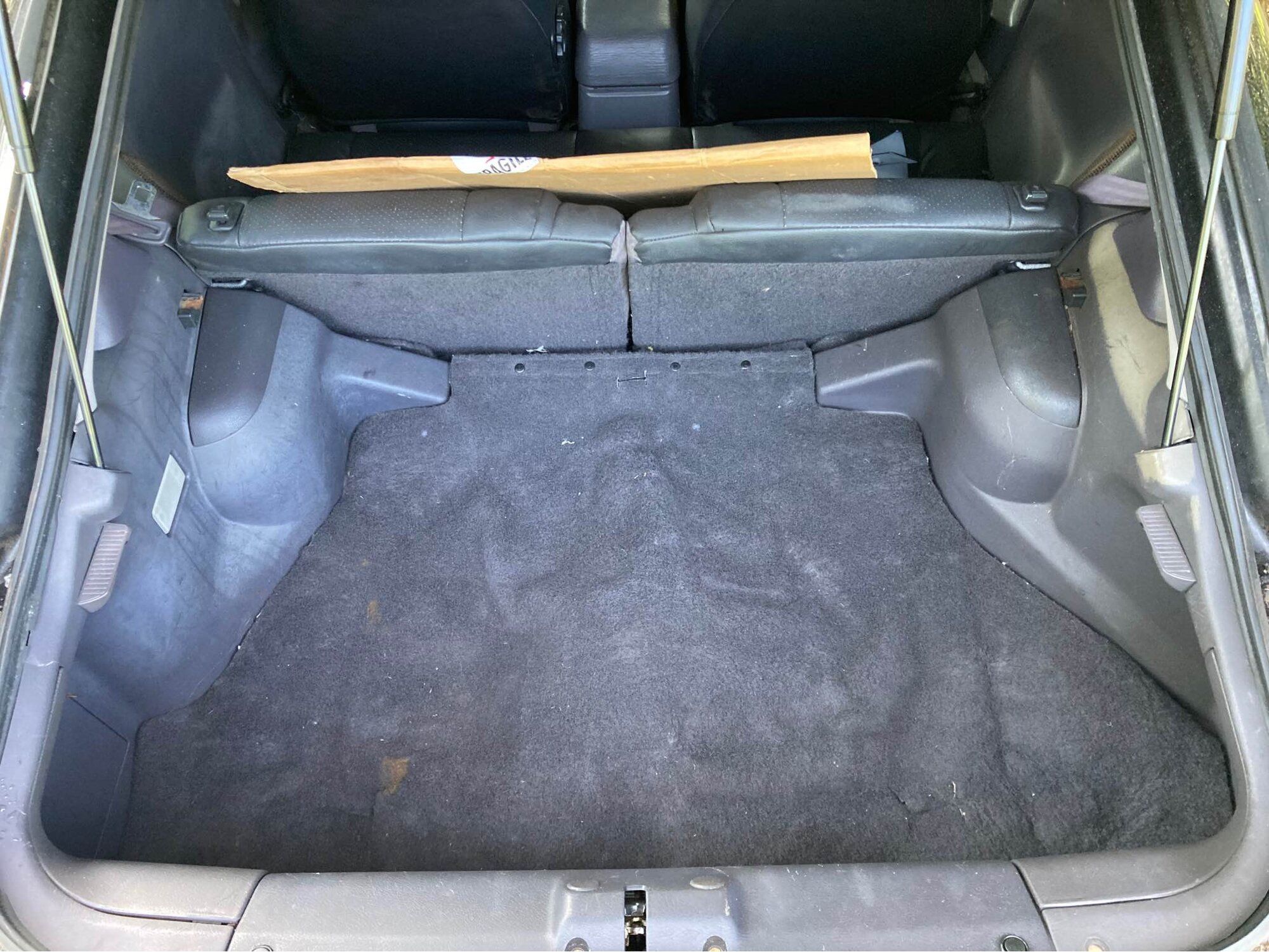

After!
God that looks so much better. The stains you see come out easily with a toothbrush and simple cleaner, so I'll steam clean/detail the interior at a later date once the car is running. But it looks SO much better even with just this. So good in fact, I couldn't resist installing the terrible quality rear privacy cover I have just to complete it.
Dirty AF, but man. The cars interior is finally factory complete. Cannot describe the feeling. It's like the soul of the car is back. Now I just gotta get her started, and get the exterior all shiny straight and new. :hellyeah:

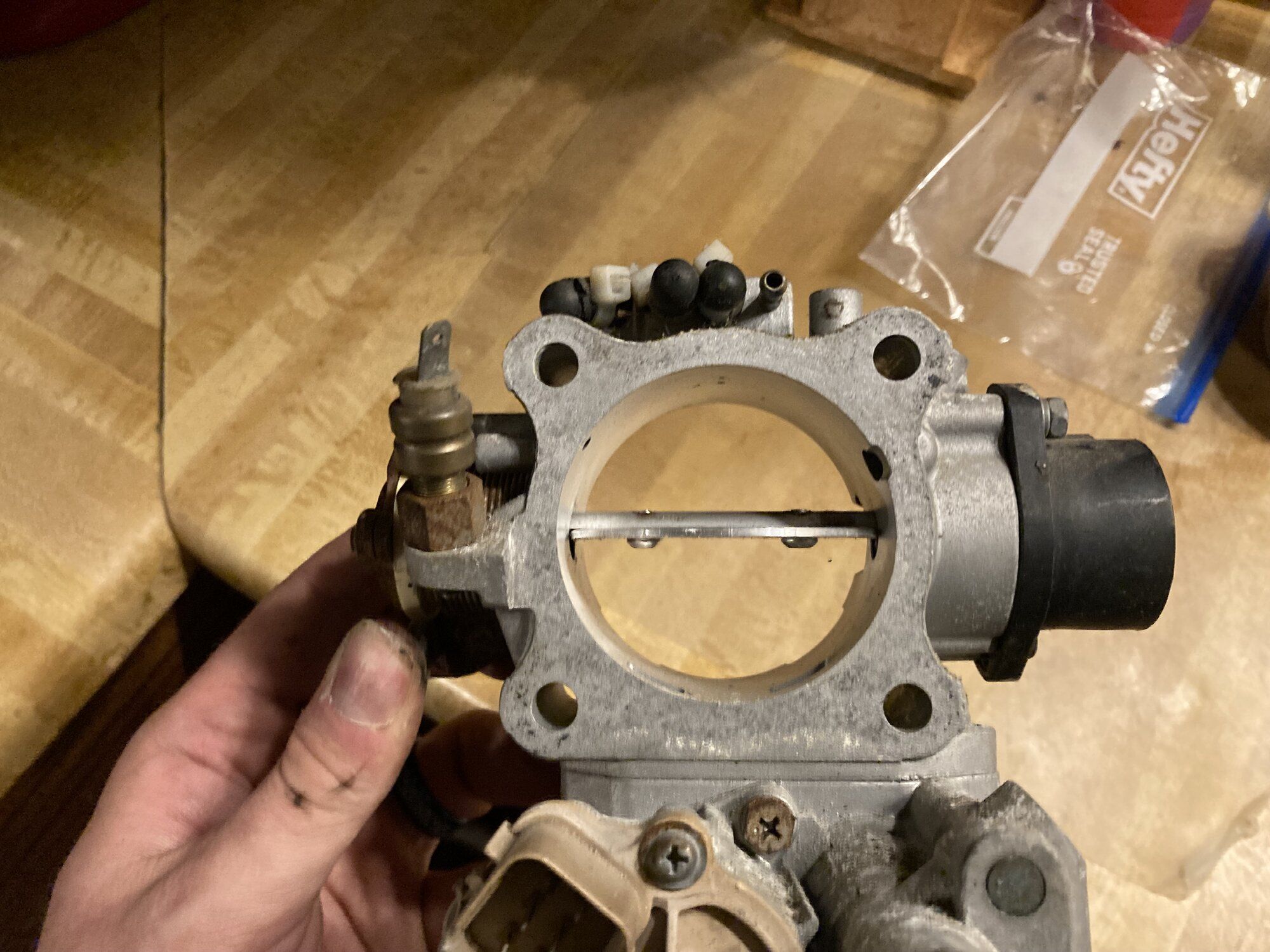

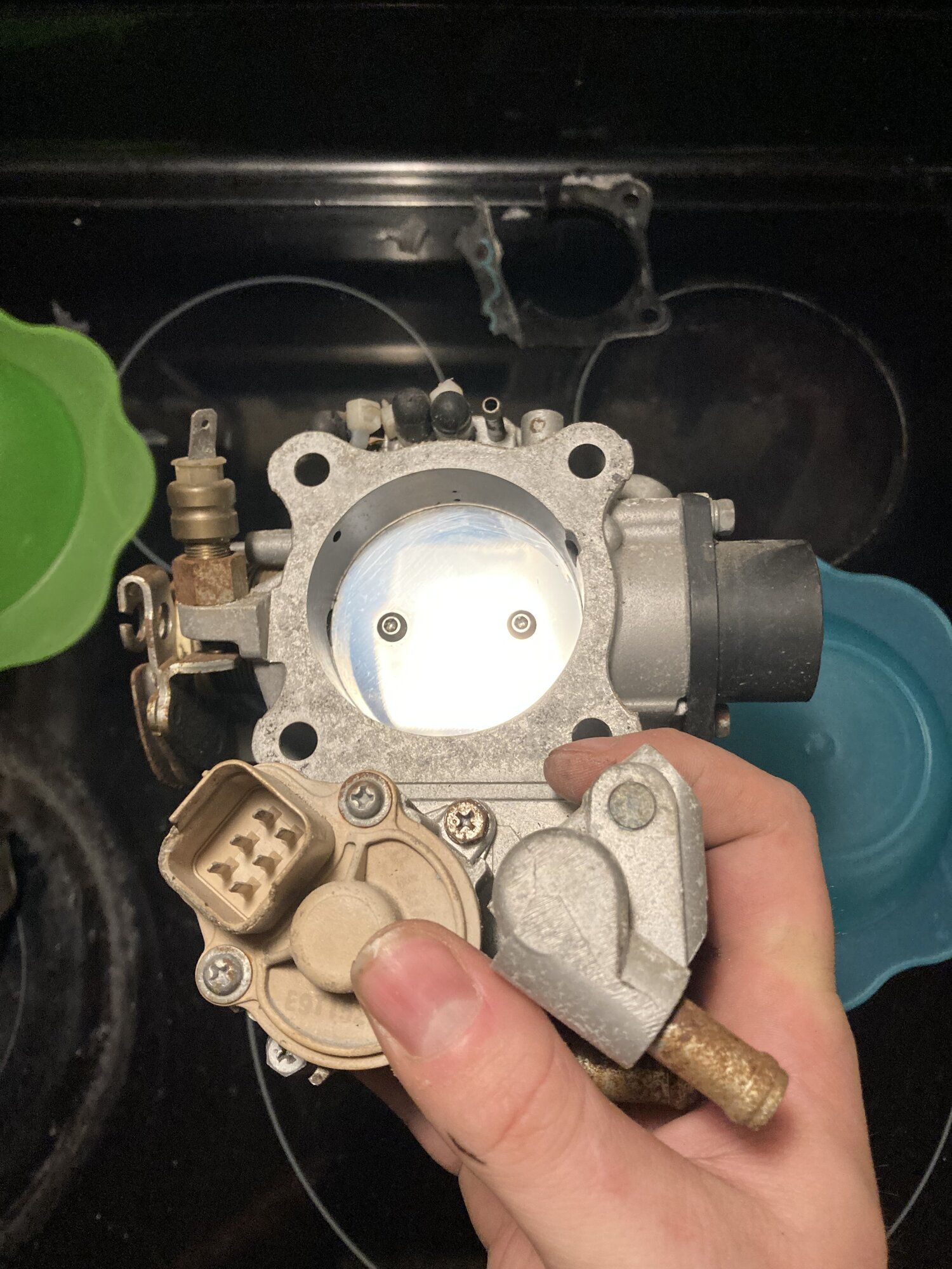

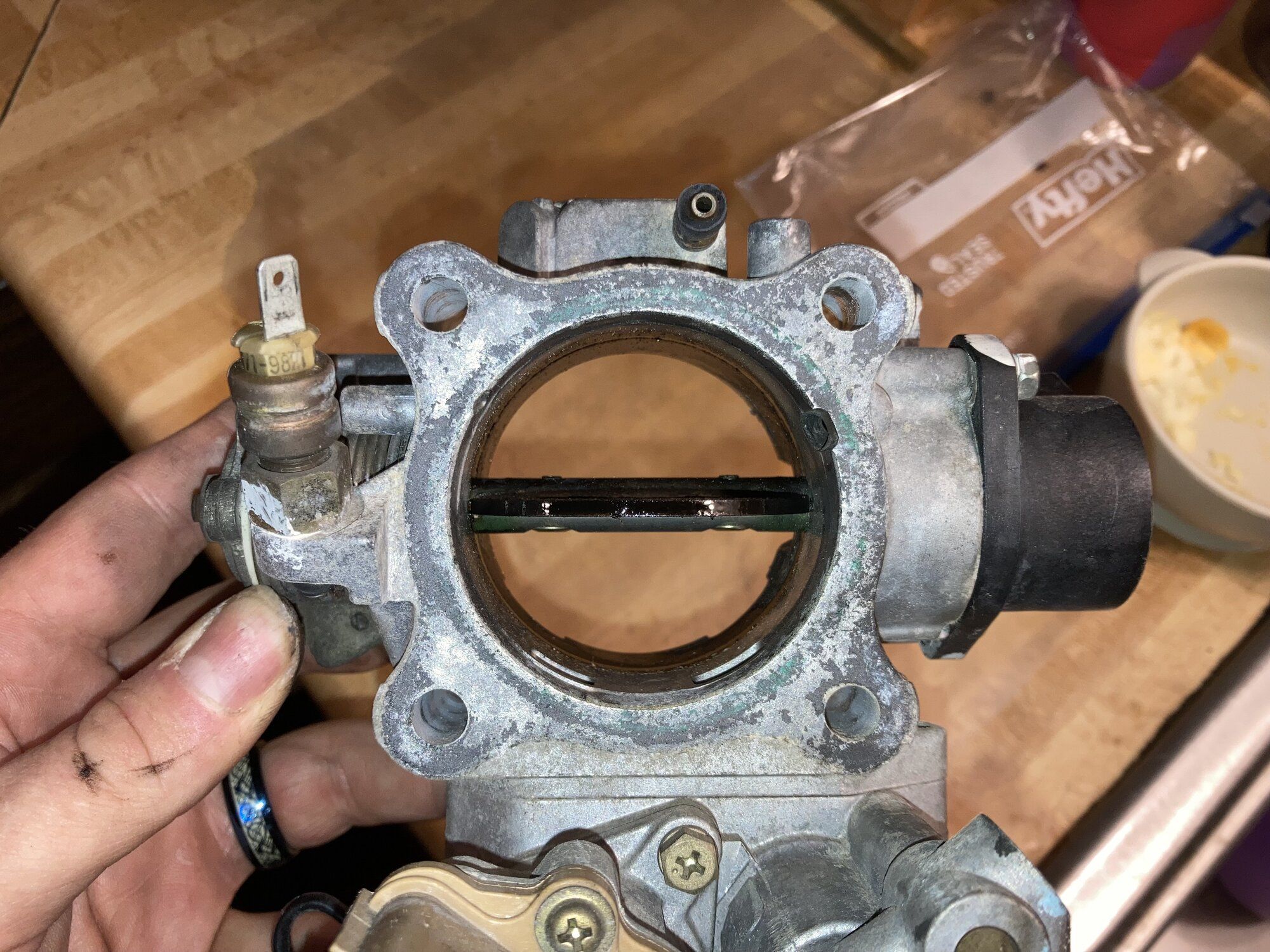

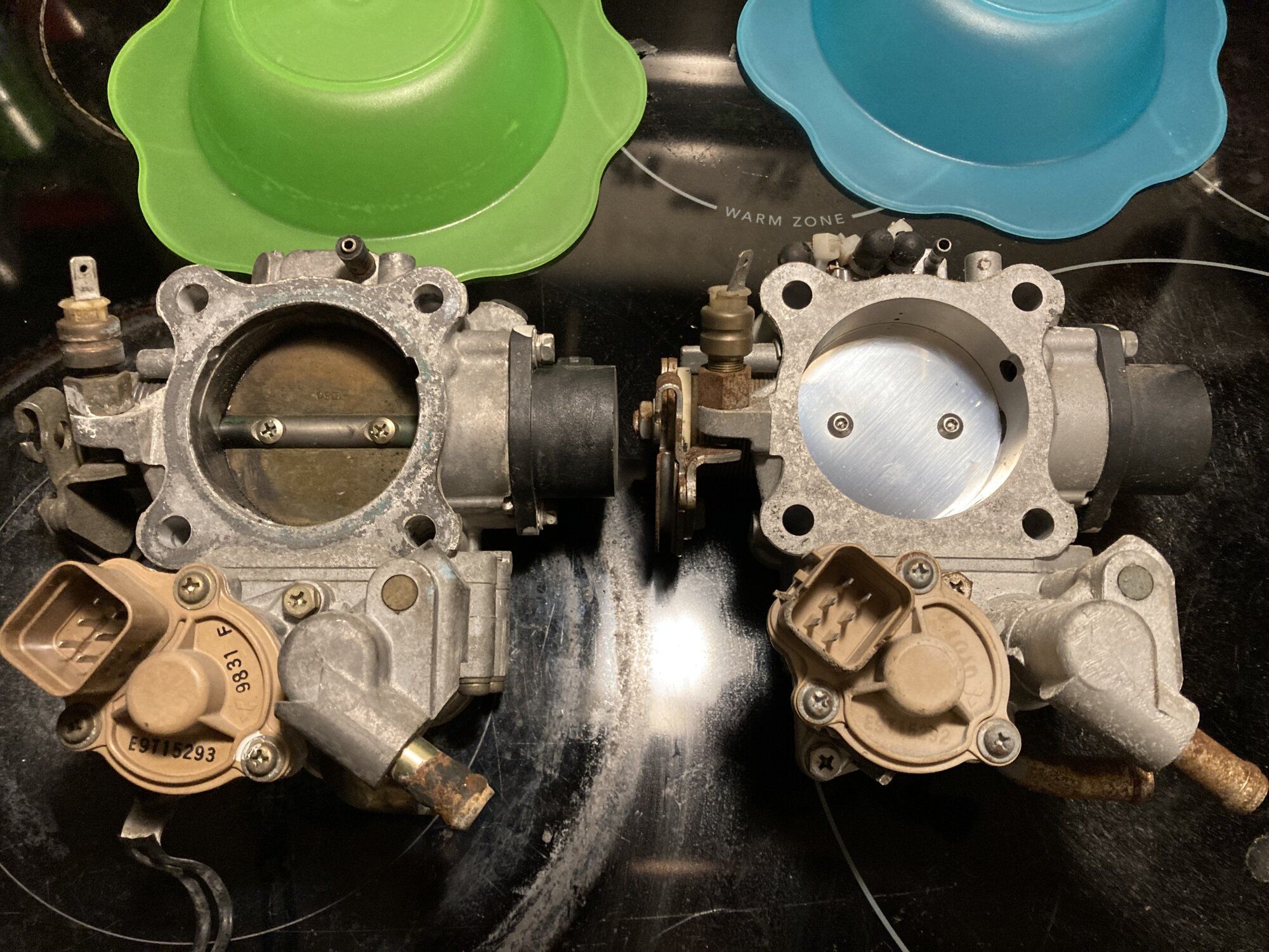

Well, I pulled the TB off to inspect it and install the FIAV bypass plate, when I discovered something.
This is what greeted me.

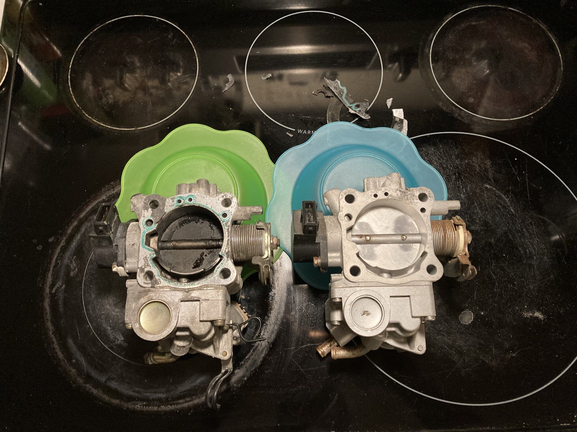

It's a brand-ass new Throttlebodies.com unit! Well that's just plain awesome. Here's a comparison of it and the JDM/Stock throttle body.
That was pretty cool to find TBH. I'm also starting to go back and forth whether I want to use the bypass plate. The little lines that are machined into it to make it pretty, I don't think are gonna end up sealing very well against the OEM gasket/o-ring type material. I'm gonna pull both TBs apart and compare the FIAV, because I think the TB.com one has the FIAV valve screwed all the way shut. If not, I may just take that route and do it anyway. Or I may honestly just make my own bypass plate out of sheet metal. Lol. IDK, we'll see what route I take though. I may just slather the hell out of the instagrammable plate in some RTV and hope for the best.
Regardless, this was an awesome find especially considering throttlebodies.com isn't in business anymore. It looks so much better in person!
Decided to use the bypass plate anyway but sadly it spaces the lower portion of the TB too far down and it hits the cyclone. So that option is out. I’m not gonna be deterred though so I filled all the passages of the FIAV system with RTV, and then cut a thin little piece of sheet metal to make my own block off plate. I was kinda worried about the rtv blowing out under pressure and I was worried about how thin the sheet metal was so with them combined I’m 100% confident with it. Improvise, Adapt, overcome!

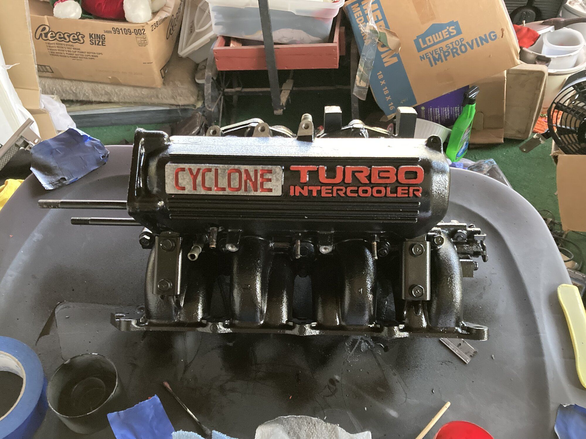

But yeah. That's all! I'm currently painting the Cyclone IM but there's a ton of corners and hidden crevices. I am NOT about to pull it apart either because it's got OEM gaskets in great shape on it, and I don't want to risk tearing them if I pulled it apart. So..it'll probably be a solid 3 footer paint job like the VC. But..it'll be better than dirty AF/rusty like it was. LOL
Cyclone is painted and curing. I’m not happy with how the TURBO INTERCOOLER letters turned out so I’m gonna sand it off and do those letters by hand. But it’s a good idea of how it’ll look. All the paint you see is dry so it’s a nice gloss black. The rectangle area around the “CYCLONE” will be sanded and polished nice and shiny too so it’ll be a shinier barrier. I think it’ll be a nice offset to all the red on the VC and intake pipe. I’m happy with the scheme. :)
