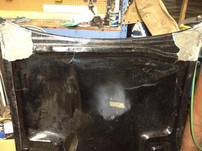

Excited about the new change I let the car cool down to make one more pass. Of course it never goes that smooth. The wind came up and ripped my hood off the car. It was already weak at the hinges from flippin up on my other car. I felt it to be a waste to run with out a hood and packed up for the day.

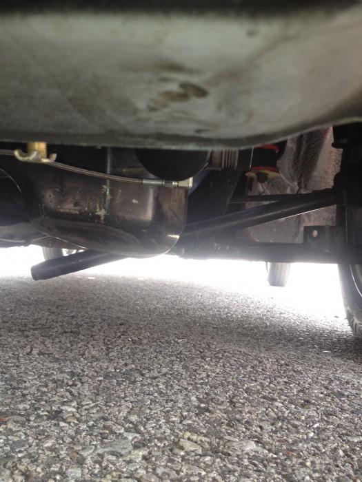

It is a pan hard, not that too. That is the actual name of the part. Keep trucking with your record goals.
Panhard rod - Wikipedia, the free encyclopedia
Just a quick example. I know I've seen the term "Track bar" used other places to. Might have been suspension books I've read. Not trying to argue. Just show ya what I've seen to.

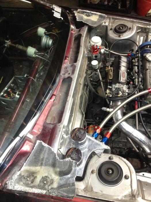

My poor hood:( I do however plan on saving it and have some plans to put it to use. Its going to be a lot lighter to. Along with the I have a bunch of stuff that I am changing around before I take the car back out.
Lighter flywheel
Rebuilt AWD Trans
Flywheel shield
Taller slicks
Sheet metal dash
Heat wrap some stuff
Possibly a CNC handbrake
Different catch can setup
I'll keep updating as I get work done. Hopefully more pics of the stuff im doing to.
That hood is definitely fixable. Mine looked like that too when it decided to fly off the car and into a river. LOL
I got it all fixed up. Ill have pics of what I did here in a few days.

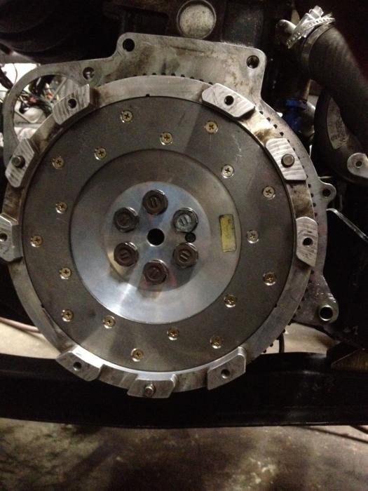

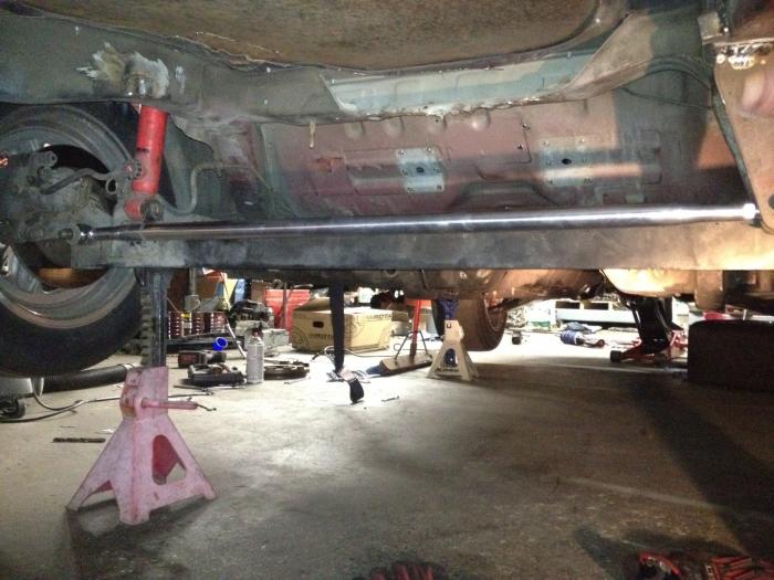

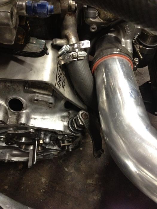

Updates..................... well im finally switching the car over to the awd trans. Some pros about doing this is that I have a scatter shield that fits the car without modifying anything, I have dss awd stronger axles, I also get to play around with flywheel weight since I have 3 different awd flywheels. For the swap I needed to mount up some M/T 26"X8.5" slicks that I already had from running this trans setup before. I hope that they will stick enough to have the traction I had before with the M&H 24.5X8.5" tires. If the trans swap is a positive move forward I will be purchasing a pair of M&H 26X10" slick to get this car to cut really good 60' times.
I have a few pics of what I have been adding so far. I have a race this friday and still have the trans to fully assemble. If the awd swap proves, I am swapping in the E316G for a local shootout we are having. I have a great tune for that turbo that went 11.3@122 in a 2950lb awd car at our track. Id keep the 14b on for this event but it just wont be enough for some of the cars that will be attending. NOS is a very last resort thing to add to the car. I dont want it in the car until I break Joe Bs current record. Just want to keep it clean.
