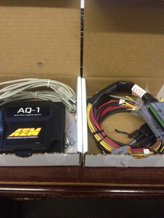

Got a little excited when this little toy came off the UPS truck today, I had to post. Looks like now I can get more data and really squeeze out all the power I can. Thanks to Brandon (1SloEvo), and South Grind Performance for getting this out so quick. :thumb:
No problem Justin! Just hope you get some good info you can share with the rest of the 14b runners, which I'm pretty sure you will!!
