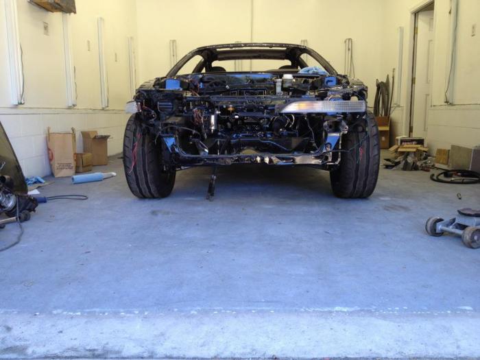

Booooo. Stay here its way better! :thumb: LOL Anyways what rim and tire size is on that? Are you gonna run it with those, or get something lighter and smaller and have slicks?
Believe it or not they are EVO 10 rims. The tires are 245/40 18's. There is roughly 9.5 inches of contact surface on them. Gives me a good idea of offset and tires size for my slick setup!

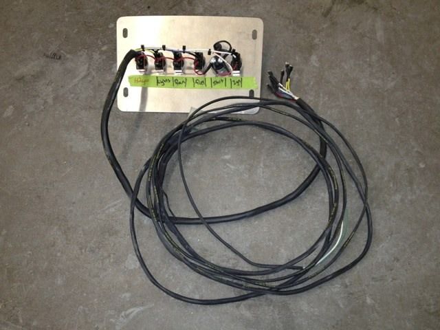

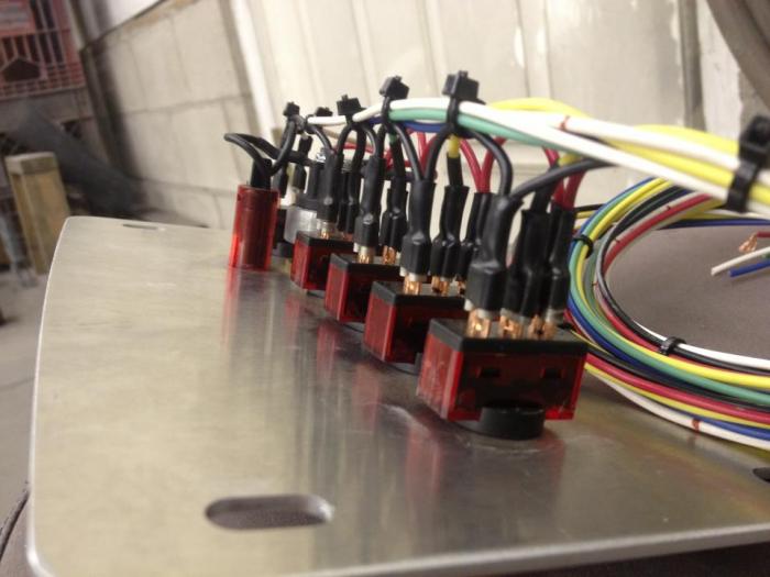

You guys seriously rock! I woke up this morning in a terrible mood, then I came on here and it put me right back in the mood to work on this thing today! I must say this is the first thread I have ever started that has nothing but positive comments! There are a few pictures I have not shared and there is no updates on the car yet so I will just post some pictures from along the way!

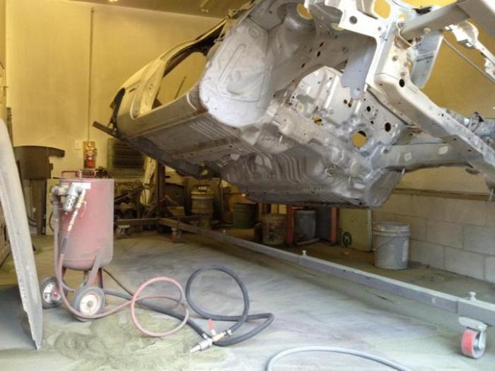

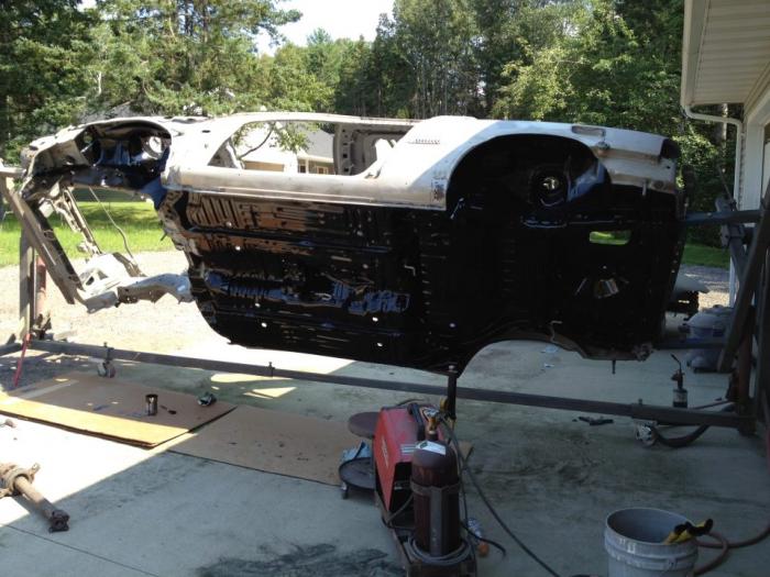

I love it. It is always nice when you can follow a build especially one like yours where you are not messing around at all. I love that you went and sandblasted the underside. That is one part that alot of people dont do cause of the cost.

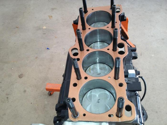

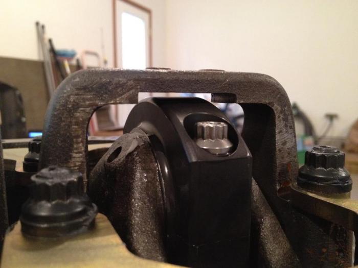

As for the piston/rod combo it looks as you could go with a larger turbo setup so why do you choose to go with a smaller setup?
Either way Im hooked on your build. Keep up the good work:thumb:
I went with the piston and rod combo so if and when I get the record I can bump up to something bigger. I want to have a strong bottom end so I can throw anything I want at it. And lots of people dont agree that you can daily a car on aluminum rods. So I am trying to prove otherwise. Plus who wants 700 gram+ rods whipping around down there to trash bearings?

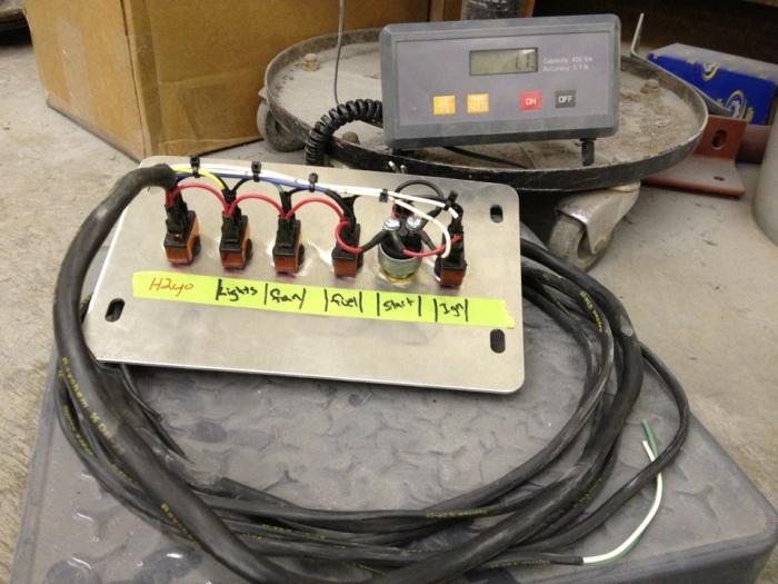

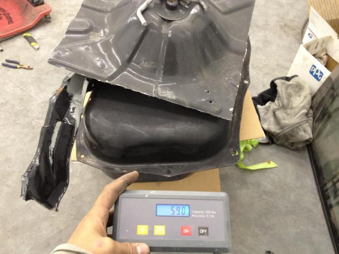

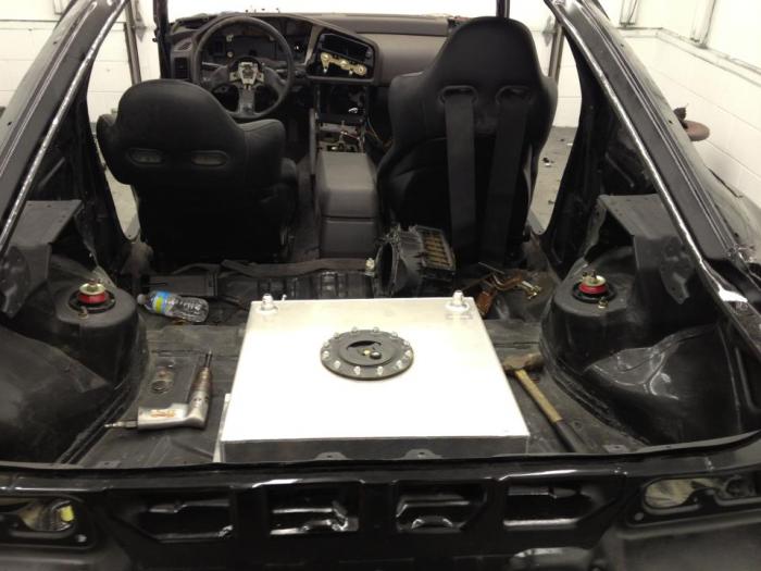

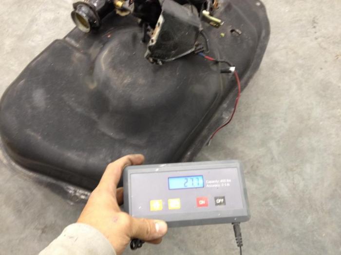

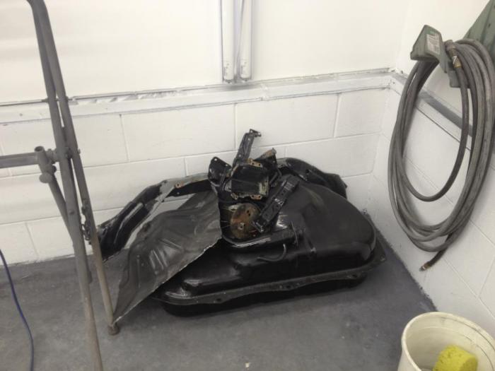

Little update here. I am still waiting for my transmission parts to be finished so she still has no heart, But I am finding more weight to take out still. Should be interesting to see what she weighs in at!

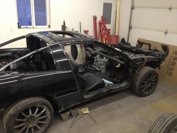

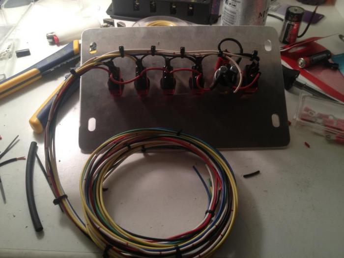

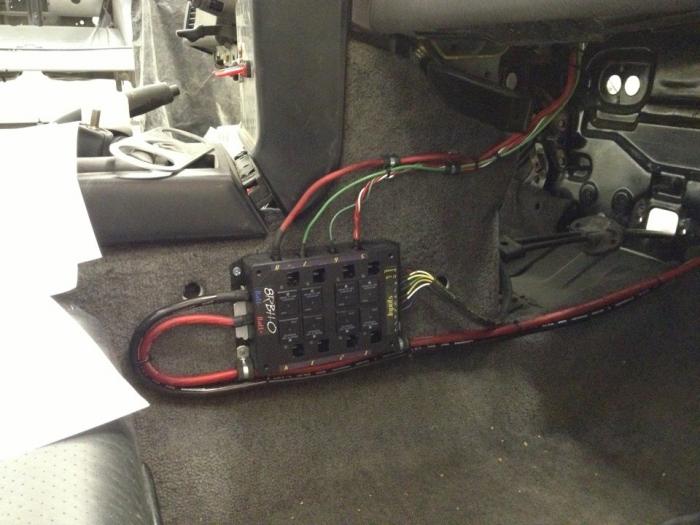

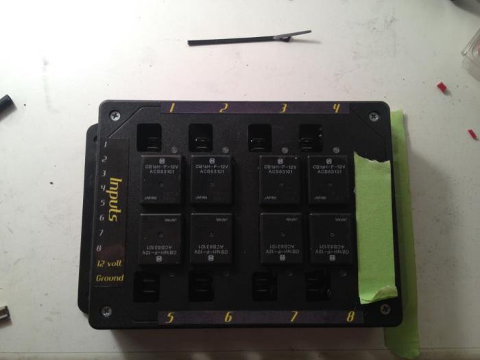

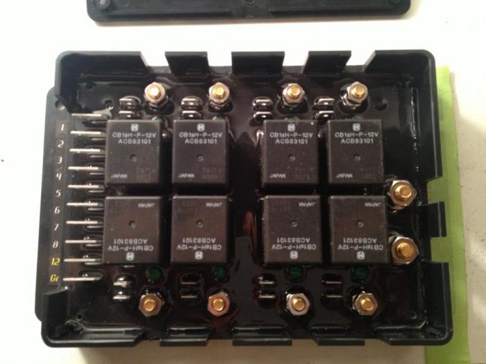

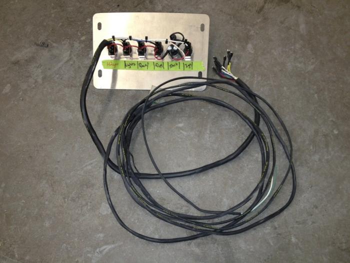

Alright guys, back at it! After a much needed break and away time from the car I got my thoughts clear and I got the project back on track. The car sat for a month and a half without being touched. Ill share some updates of whats going on with it. But essentially I am attacking the interior for weight and some appearance. The entire car is getting fully rewired front to back, pin to pin. Not taking short cuts on this car, and certainly not rushing it.

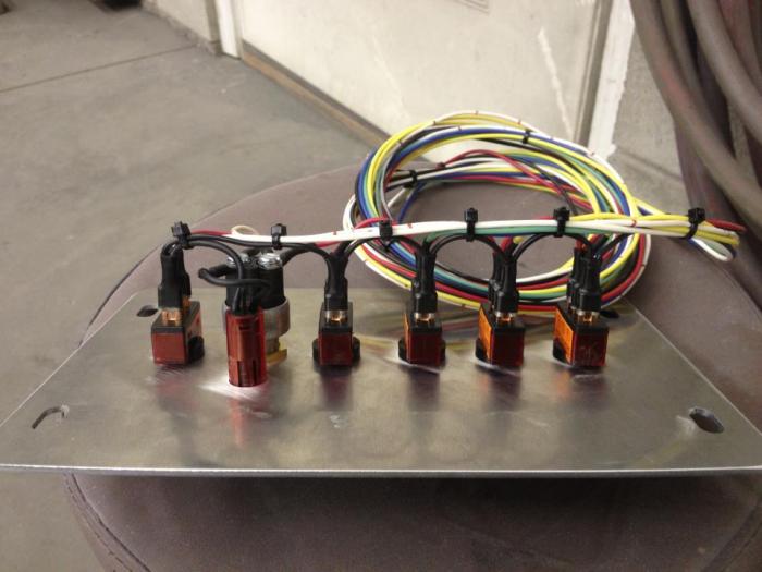

More electrical work is being done at this time. The engine is being tore down again at some point to get filled. Looking to make somewhere around 8-900 wheel after I go for the 14b. Here are some updates

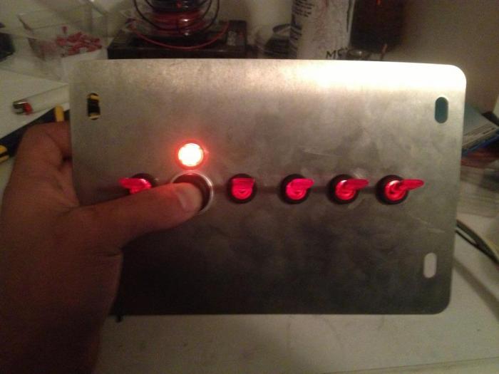

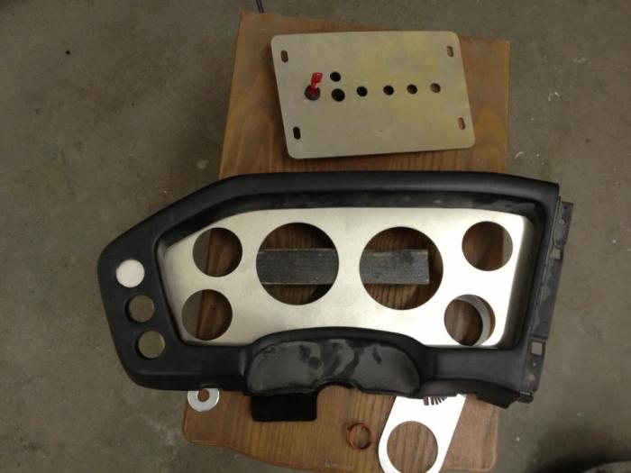

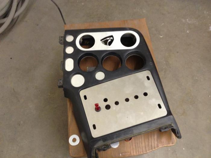

Sweet! Glad to see your back at it! I love the center console gauge bezel with the talon symbol. Was it custom fabbed?
What he said^^^ Did you make the gauge bezel or did you have someone else? I want one! :thumb:
