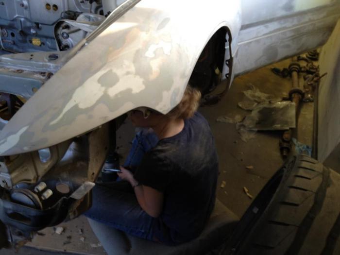

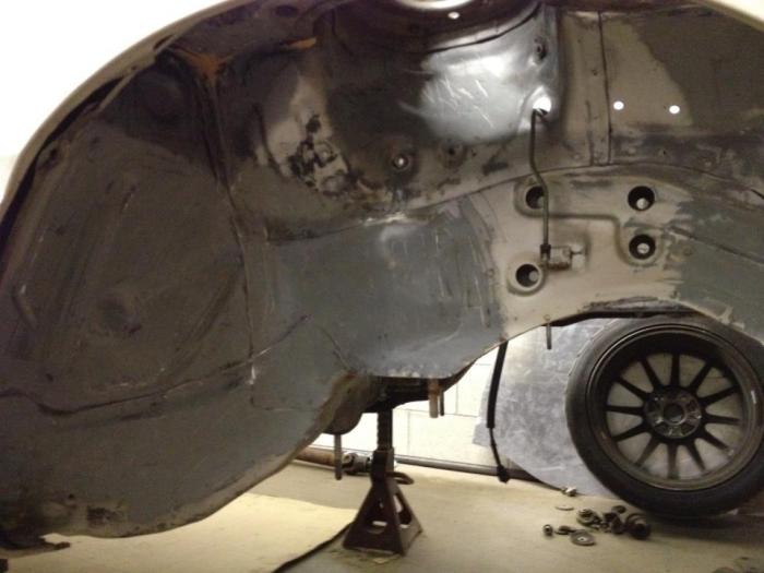

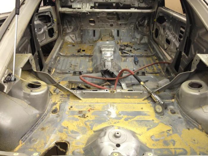

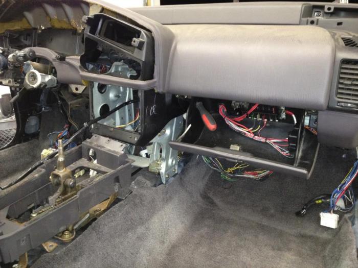

The car is officially 100% gutted. Time to start getting as much weight as possible out of it. So far I have put my girlfriend to work on stripping out the wheel wells and underbody while I work inside the car. Here are some progress pictures.

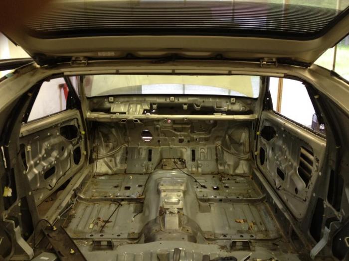

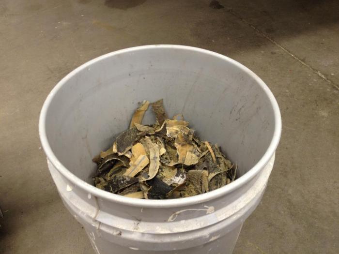

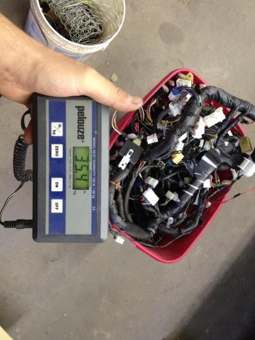

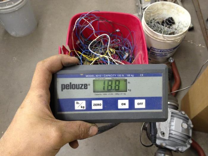

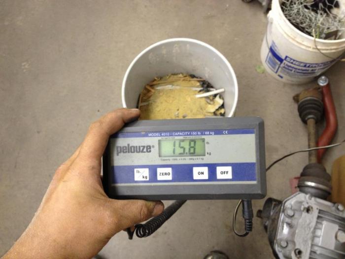

Woof, its been a long few days. Long story short the seam sealer just keeps coming out and the weight keeps dropping. I am hoping to have the under body and all seams sand blasted within the next few days so I can start doing the welding. Still cant believe the weight that is coming out. The harnesses are not even done yet and are insanely light!

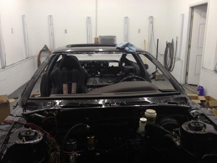

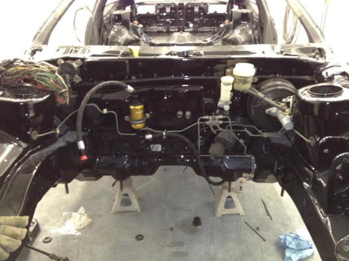

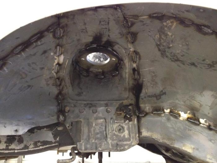

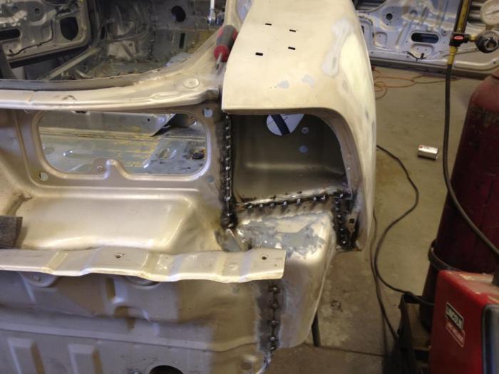

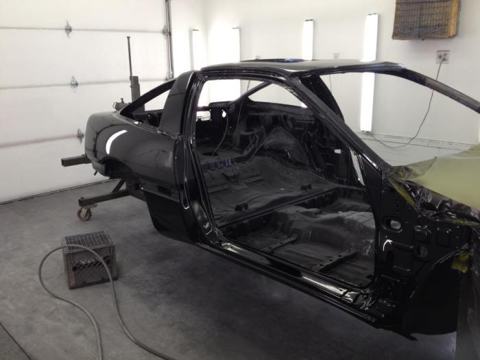

Its Official, The shell is now as light as it can possibly be without cutting metal. Which is not happening. I have began the stages of stitch welding and only have the underbody and engine bay to finish up then its ready for sand blasting and paint soon after!

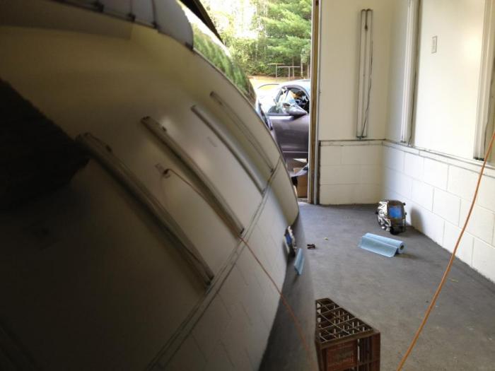

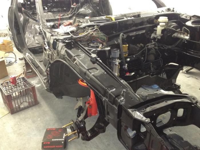

Well it seems as there is no interest in this build. But I figured I would update it anyways because its been quite some time. Tons of progress being made, and as usual I will let the pictures talk!

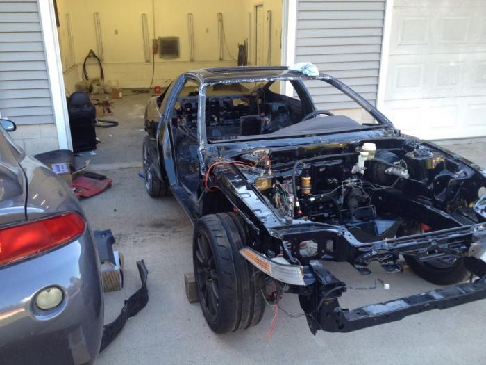

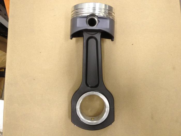

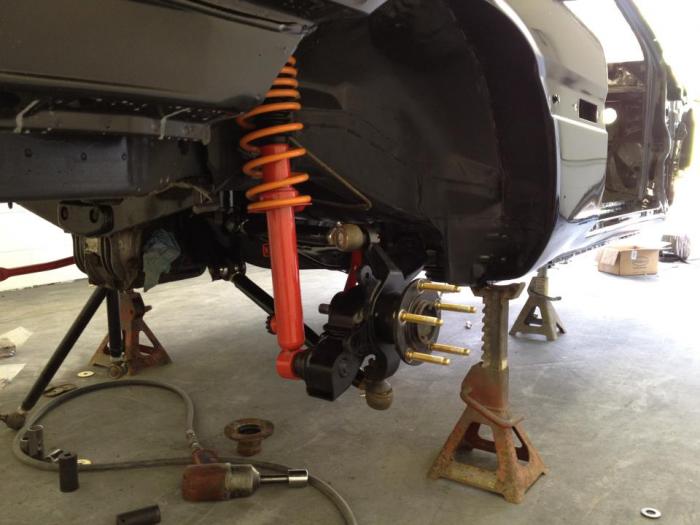

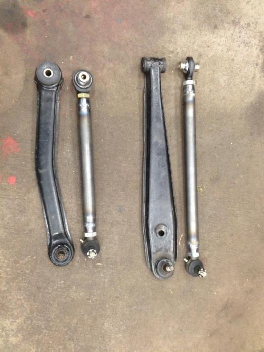

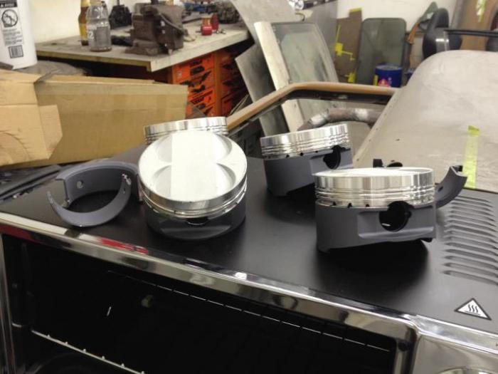

Im glad everybody likes it! Trying to get some of my work out there for people to see what I am capable of, The compliments mean the world to me so thank you! The car did hit the ground tonight, though the alignment is way off but that was to be expected. I also started fabricating seat mounts for my SSL Recaro's. 1 down 1 to go! I am waiting on some "prototype" gear sets to come in then the rest of it will go together.

As for the people who keep asking about the weight. I have kept track of what's been taken out and kept an entire log of the weights. If my math is correct it should be sitting in the 2500's with 3/4 tank of fuel. And I am happy with that number!
