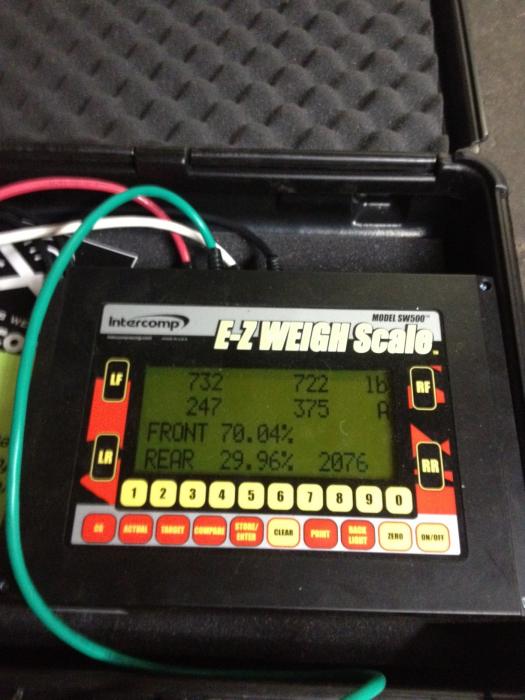

Suspension is pretty setup now. Weighed the car yesterday and made some adjustments. Car without driver 1876lbs. Add another 200lbs for driver and the car is 164lbs lighter than Joe B's car. Had to fix a few other things on the car but it's looking pretty good for next weekend. Pretty excited to hit the track.

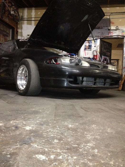

Another thing, I pulled the car outta the shop tonight and got to launch then test the brake setup. I feel comfortable in how it stops. I dont feel I've gotta burn a leg muscle to press the brakes. More to come once I get to the track.

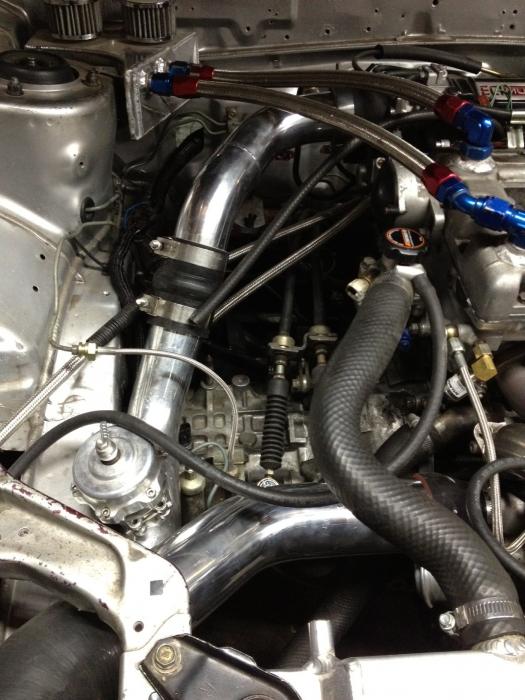

Just a few quick pics I took last night before we head out to the track.

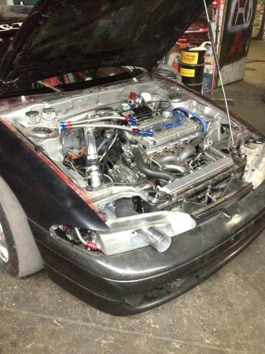

Another small little mod that might help :cool:
Car looks sick! I would hack that intake tube off closer to the headlight just to look cleaner, but that's a personal cosmetic thing. Engine bay looks great. What FMIC are you running?
The intake isn't staying like that. I ran out of time but I'm making the headlight into a scoop. I did trim it down and taped off the hole. The fmic is one of the large short route ones that slowboy used to sell. I think it measures out at 31x10.5x3.5

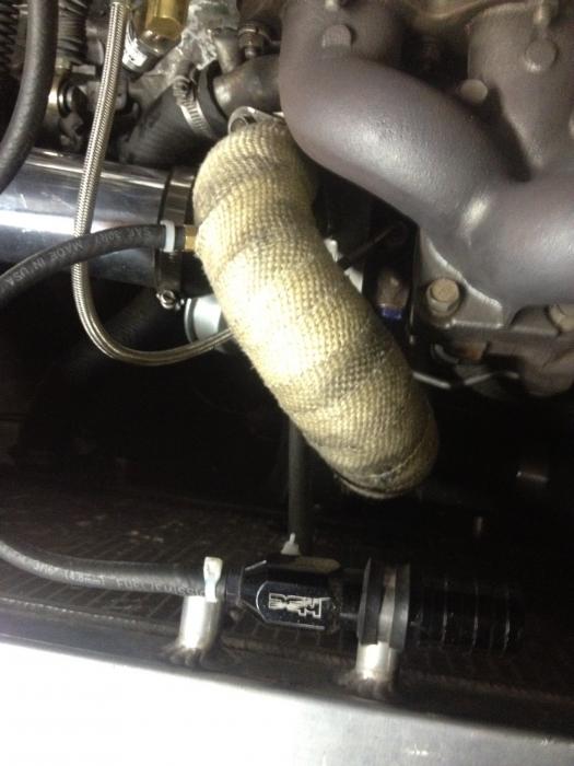

I have thought about switching over to an A2W setup. I dont know much about them to pick the right core yet. Maybe later I will look more into it. My intake temps at the TB are not to high. The highest Ive seen where around 111 degrees at the end of a pass. The avg is right around 106-108. Im gonna get some shielding for the turbo manifold and see what I can do to get more air to the intercooler. I think I can pick up a few hp there.
