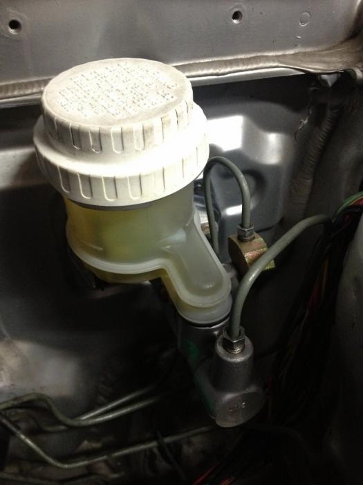

So I get a rod made and get it in. Start pumping the pedal and the damn master leaks right there under the dash. Started digging through my masters and have one more that came off the 3G eclipse. So I swap it over and that stupid master leaks. The original one leaked but was no prob. But now im kinda stuck until I figure out what im going to do. I dont want ot buy a new master and have it not work well manually. I need to wrecking yard hop tomorrow and hope to get lucky. If not I may make longer lines to the factory reservoir and use a factory 1" bore master instead of the 3G 1 1/16" master.
Down sizing the master bore will increase pressure at the calipers. Just a thought but why not a wilwood that is meant to be used on manual brake apps?
That's what I've been reading and hearing. Stock being 1". I really like the reservoir incorporated to the master one this. I may just end up pulling one off a low model mirage or colt. I think they are 7/8". I really see no point in spending big money on something like that. Takes away from the budget racing. The money has better places to be spent.

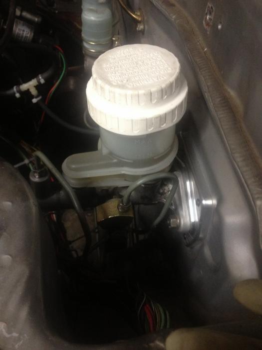

Ok so tonight went well. Got a master cylinder Saturday. It came from a 94 Mitsu mirage. The bore size is actually smaller than the stock one so the pedal effort should be good. Got them bled and I'm not really sure how the pedal is suppose to feel. I pump it and it's consistent. It doesn't bleed down. It's a little soft right at the top but gets harder as you push down. Feels fine but I'll have to wait to drive it to get a better idea. I'm gonna pick up something to help bleed the brakes to just to make sure I get all the bubbles out.

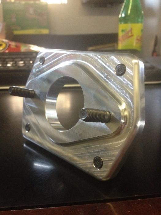

Ok heres the new master delete bracket and a couple shots of the master installed. Got lucky and the car I got it from was very clean and in good shape.
Pretty cool....gotta see how it works now right?
Ya Phil. Gotta take it for a test drive before I go down the track. I feel pretty confident that its going to work and work good.

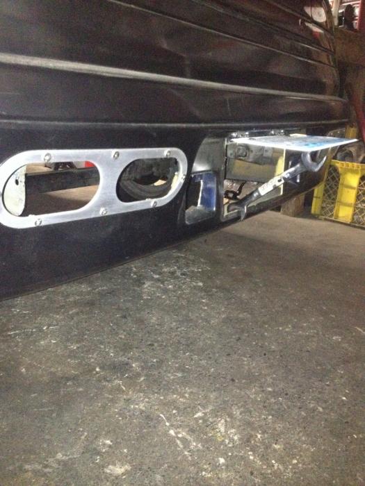

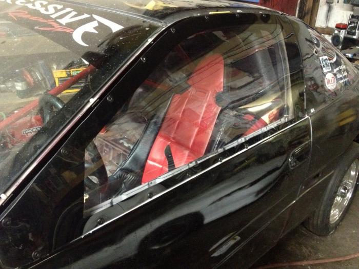

As promised I have a couple pics of my doors and the lexan job we did and my rear ducting work.
Hey, not bad at all, it works, and it's light!
I have the JMF diffusers in my pile of parts....nice stuff...
I figured all that little stuff will add up to help. The fwd chassis was sure in need of it since when you look under the car the tunnel leads right to the back bumper. When you flip up the license plate and look through you can see that. I just need to cover the old reverse light holes with something that will flap up to make that section look a little cleaner.

Yeah the rear bumper cover we all know is a factory parachute.
The area where the plate mounted on my bumper cover is now open. Got the idea from an S2000 I saw at a track day back in 07.

The master I picked up was stamped 13/16" on the bottom. So it's quite a bit smaller than the stock one.
