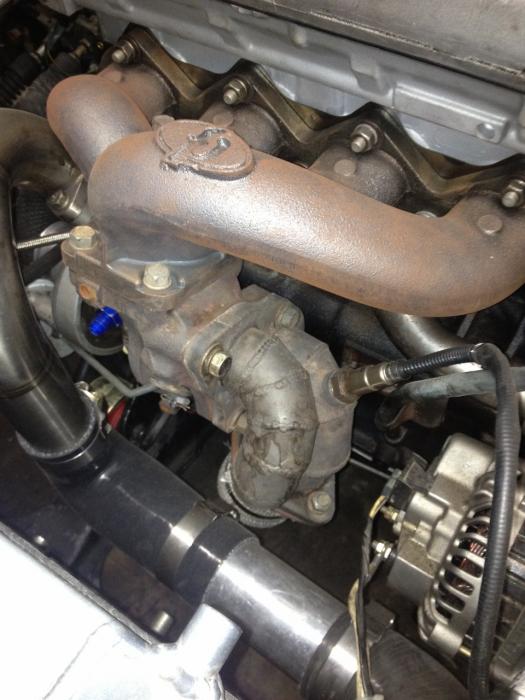

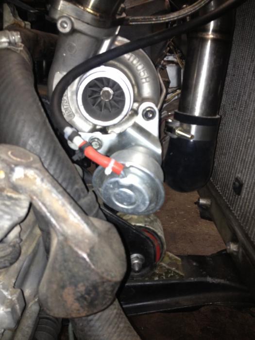

Heres some pics of the current turbo setup with the evo 16g wastegate.

Nice, that's a wild looking 02 housing!
I pulled it off a car that I parted out. I'm not even sure who makes it. I am probably goin to swap it out with an external dump that I picked up from Brandon (1SloEvo).
Pretty different...an old friend referred to stuff that looks like that as 'Japan-drel,' as in Mandrel...LOL. Ok, so you did pick that up. Cool.
I wouldn't doubt it since the turbo was eBay. I thought at one point in time slow boy sold housing like that. I wanna say an old punishment housing. But this was quite a few years ago.

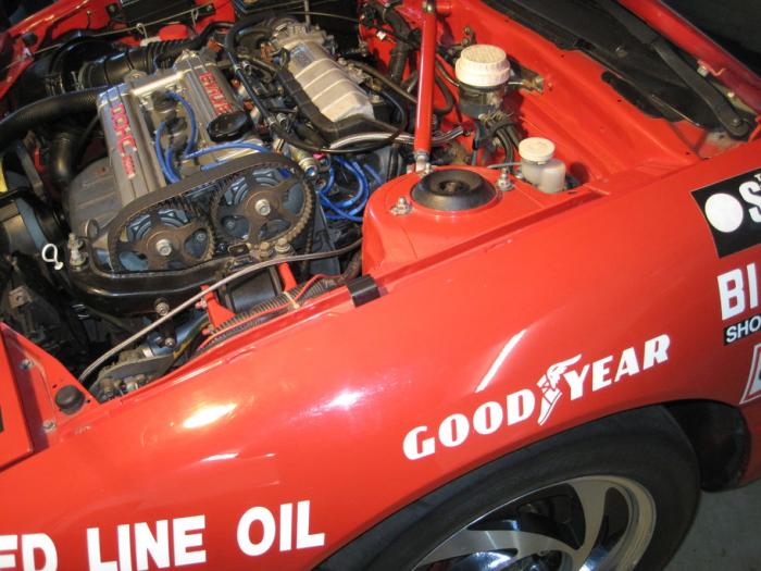

No! Would not do that buddy. I do have manual brakes, but, not on my AWD! They are on a car that I acquired a while back, which I have only driven once. It's a unique car that was prepped by some of the best in the business, at least back in the day. I'll be back with some pics that I think you will find very interesting. Unfortunately, I do not know what master cylinder was used. Maybe by looking at it you will be able to figure it out, or maybe someone else in the know. What I can tell you is that the car has 2G front brakes, so the master has to be fairly stout. Pretty sure this car had the Corvette PBR set up on it initially back in 1991. It's possible it could have had Stealth brakes or something too. So, the master had to be available back then, when, obviously, the 2g brakes might not have been...? Standby for some old school dsm goodness:sneaky:

Old Archer Brothers car?

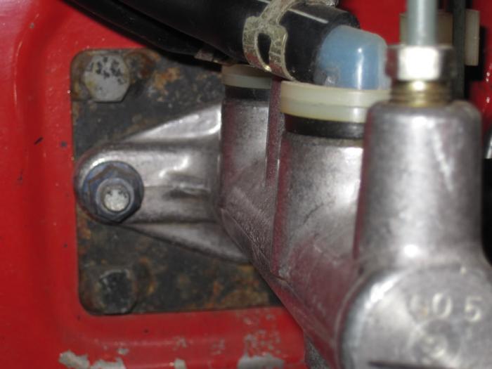

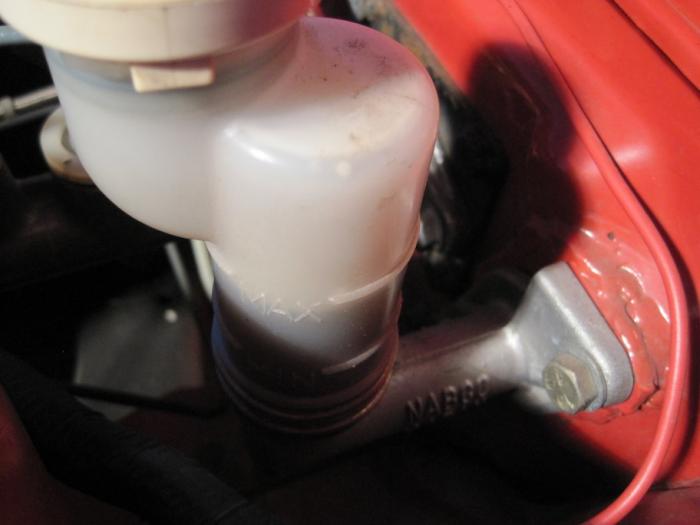

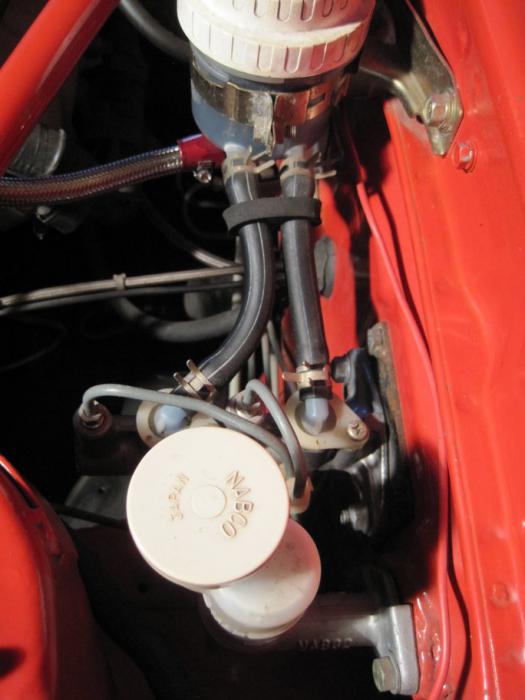

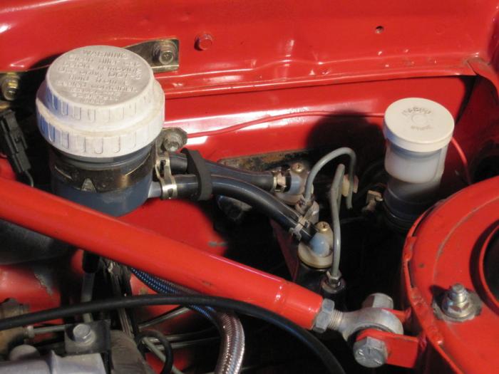

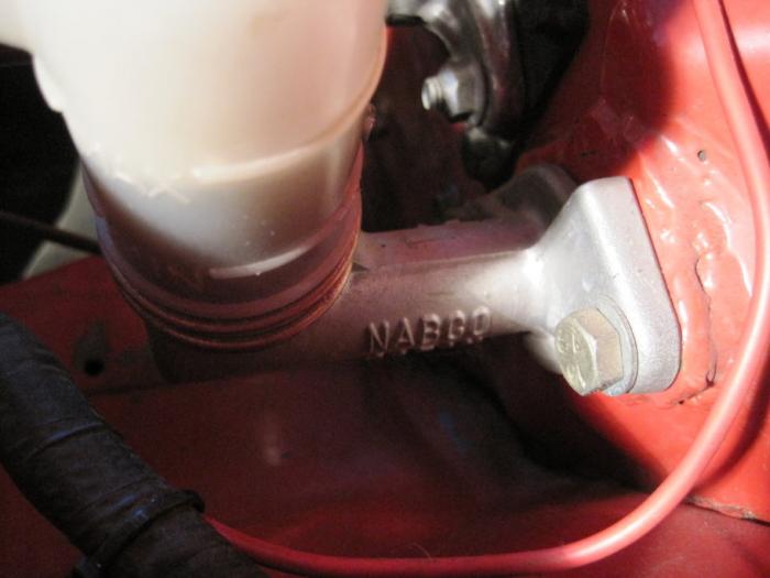

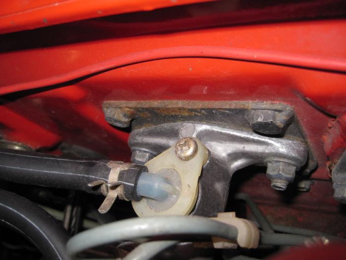

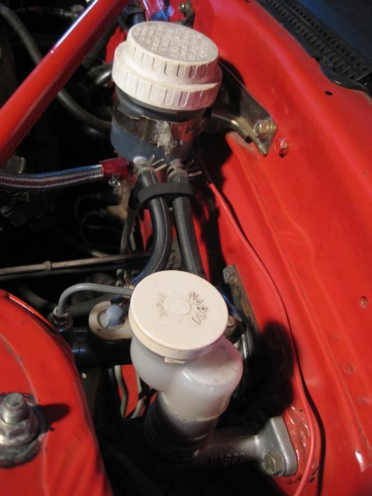

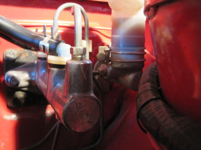

This here. This is where I got the motivation to do the manual brake swap.
That master looks stock in the pics. Is it a smaller bore?? Say 7/8". I saw a few other cars that run that same style master but lower model and smaller bores.
Oh and I like the remounted cluch master. Did they have it mounted straight to the pedal.

Yes, 1991 SCCA Champ Talon...

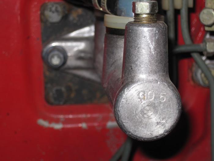

I am not sure of bore, where would I look to find out?
I figured you might find that interesting. Another good question, however, I've never even looked under the dash. It'll be tough to get under there with the Nascar bars, but I'll check it out next chance I get.
I figured you might find that interesting. Another good question, however, I've never even looked.It'll be tough to get under there with the Nascar bars, but I'll check it out next chance I get.
The bore size should be stamped on the bottom of the master usually towards the front. A mirror and backwards reading should tell ya what you need to know.
Didn't you have a thread posted about getting this car?? This is serious dsm history.

It is a nice piece of history for sure, and I think it's the most significant Archer car of them all. If you look close at the last pic, you'll see why.
