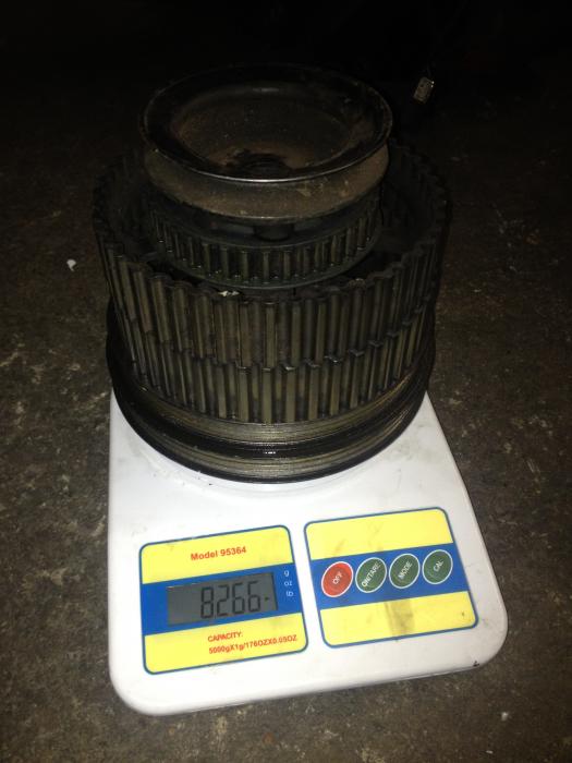

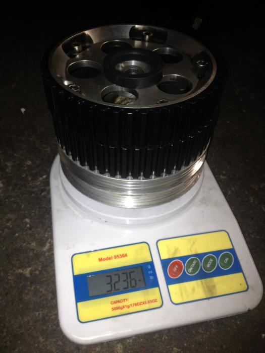

Worked on the car for a few hours last night. Since I got the back of the car pretty much where I want it weight reduction wise, I decided to get back to working under the hood.
I decided that I needed to change out all my pulleys and timing gears for lighter stuff. Even replaced the balance shaft gear and ditched the P/S pulley. I was surprised that I was able to knock off another 5lbs. Not only is it 5lbs lbs, but its 5lbs of rotational weight gone. Should free up a few extra horses.

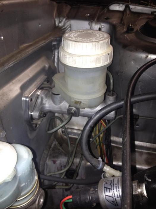

Ok so I had this nice piece made by Andrew K. from frontline fabrications. I've have him make a lot of really nice custom stuff for my cars. I mainly wanted this for the 6 lbs of weight to lose. It also clears up some space in the bay. I wouldnt do this if I was auto though.
Real nice....not sure if I'll entertain it or not, however, 6lbs is 6 lbs.!
I really had to toss the pros/cons of this one. For me knowing the 6lbs was just hanging out there, I couldn't let it happen. We will see how it goes with this master. Nice thing is I have other options.
Ok, maybe I'll snag one...! Is that the 3G master? I have no clue...
