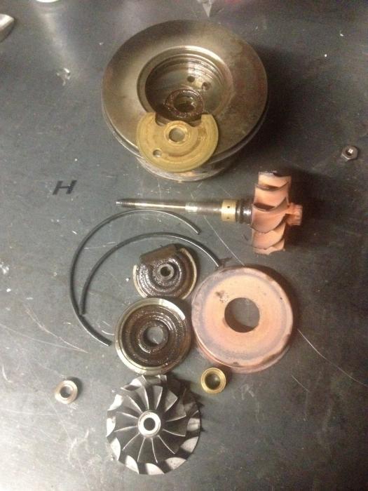

Getting the car ready for the 28th of this month. I took the 14B apart and of course the rubber seals are hard as a rock. The oiling looks pretty good since the shaft and bushings looked good for what this turbo has seen and what It has been through before I got ahold of it. While I have all this apart I fixed a few broken bolt holes in the turbine housing. Seems that I had a little bit of an exhaust mani to turbo leak. Nothing to big though.

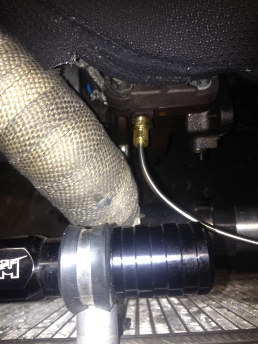

I also FINALLY tapped into the turbine housing and am setting this thing up to start logging turbine backpressure. Found a nice solid little spot to tap into. Also got a fancy FP turbo manifold heat wrap. Thats going on to.

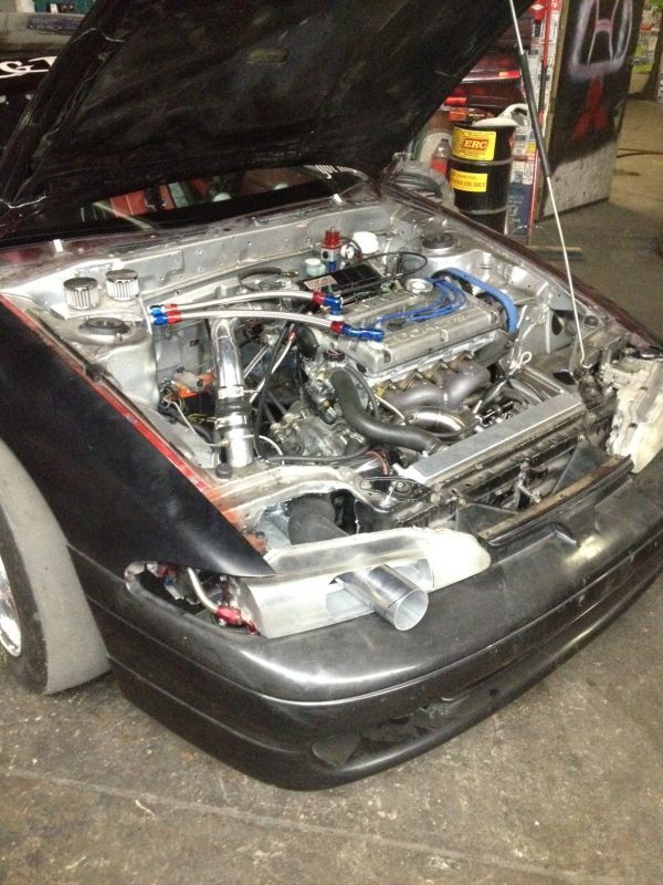

Making a few more changes to the car. Finally making my intake scoop and ditching the headlight. Got me some camber plates. Changing out my front coilovers from the ebay one over to the Ground Control ones so I can keep track of spring rates.
Im going back to the track one more time with the 16G to dial in the suspension and then swapping in a fresh rebuilt 14B. And then.......................................... Off to Sacramento for as long as I can handle. I figure the seasons almost over and I played and tested enough with the car its time to get serious. Ill get some pics posted of the scoop and some other mods when I get this stuff done.

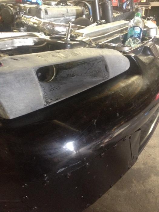

A few small updates. Haven't done a whole lot to the car. Had so much going on I only had time to move it into its own spot in the garage. Gave me a little more space. I am planning on hitting the Fallon track Friday night. I know "not again". Its closer and its only $5 to race. Cant beat that. Besides this will give me a session before I start traveling to sea level tracks. Ya tracks. Been looking for a newer truck and an enclosed so I can go to even further tracks. I really want to head up to the Washington Oregon area and go play on the English Racing stomping grounds.

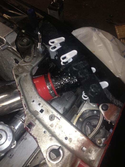

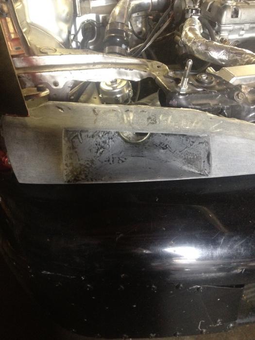

Enough with that. I finally decided to get an intake duct built. I started with one in aluminum with a 4" outlet for future upgrades. But it wasn't turning out how I liked it and was taking way to long to get right. So I took and the past two days, cut apart my headlight even more and went the fiberglass route with a 3" outlet. It turned out way better than expected. It wont be 100% completed but will be functional for Fri night. I got the rough draft down as you can see in the pics. Plus this will look so much better than the horn thing I had sticking out of the front.

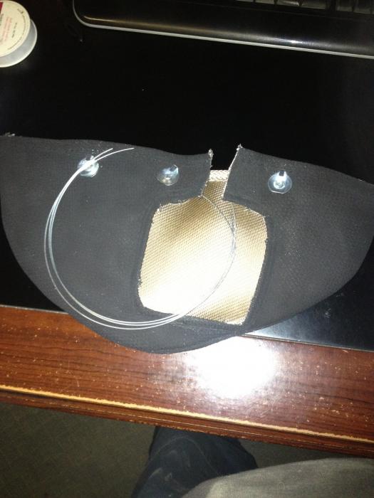

I've also been trying to be creative and get rid of all the heat I can by moving and wrapping stuff that reflects heat onto any of my intercooler pipes and turbo inlet. I had my car running for maybe 10 mins a week ago and grabbed the turbo inlet. It was hot to the touch. I guess resting on the lower radiator pipe will do that. Its all wrapped and barely gets warm now compared to before. Another area I am working on is the lower intercooler pipe. Laser checked the temp on the turbine housing and it was around 400 degrees just idling. The lower pipe was so hot I couldn't even touch the side that faces the housing. The side towards the radiator wasn't as hot. Imagine how hot that pipe get when going down the track and that turbine housing is glowing. So cant be good for my Ait's. So Ill be making a shield for that and then here in the near future will do some ceramic coating and a turbine blanket.
