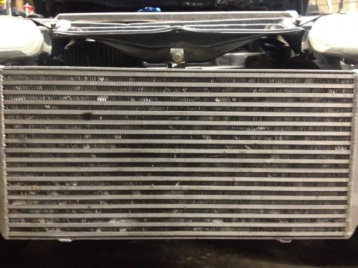

I'm sure I've got a good amount of pressure drop through this IC. It's a very big core. I'm gonna swap to a 1gb talon bumper and duct the face of the IC so it all gets air goin down the track. I'm not much of a fan of the cut open bumper for the IC. This will test to see if the IC being fully exposed will drop charge temps any.
I'll post some progress as I get the bumper ready.

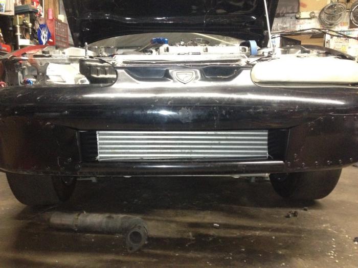

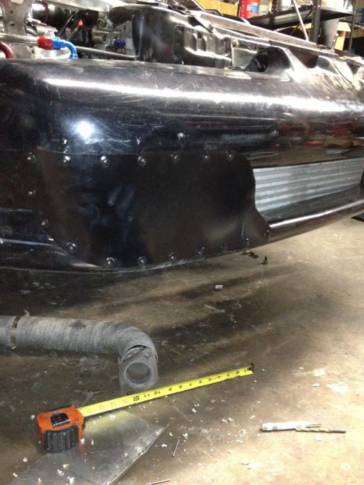

So ive been doing little things here and there to the car over the past few weeks. I havent had time between races to do any of the bigger projects that I want to do. I kinda started making my new up pipe. I had a weird looking o2 housing and a heavy downpipe and a huge hole in the hood where my old exhaust use to go. So I am going to run th exhaust up and save some weight. When I pulled the Wideband sensor out youll see the damage it took when I blew the turbo up my last race. Still worked good though.

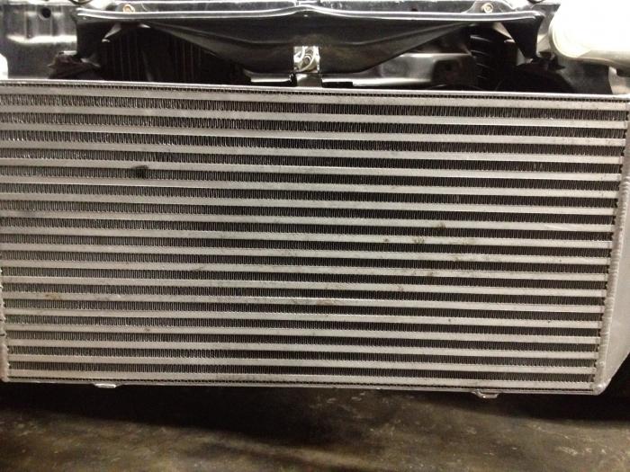

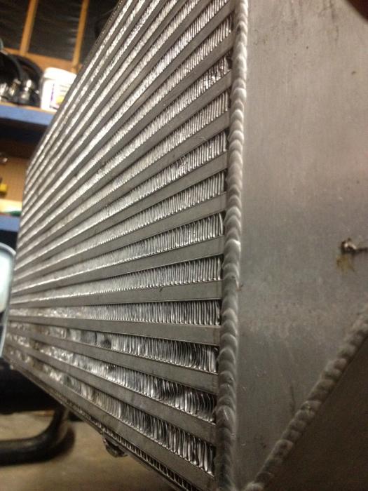

Few things I did, cleaned and straightened all my intercooler fins, changed the front bumper out to a talon one and made some cover plates for aero, and changing the clutch bushings out.

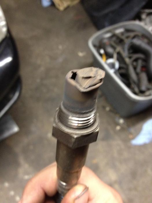

How does that sensor still work? Lol...that thing got destroyed.
BTW - nice job on the intercooler. I wouldn't be patient enough to do that.
Yup sensor works great. I ran all day today with it. The intercooler stuff pretty much payed off. Temps never saw over 84degrees but it was no warmer than 65 today.

Were you running the bigger Talon front bumper to help get more air to the I/C as well?

Ya it was the Talon bumper. I need to go through my logs again to see what the gain of temp was from start to finish. Can't really compare it to sacs runs because the coolant temps where much hotter then. Im pretty sure there was a small gain though.

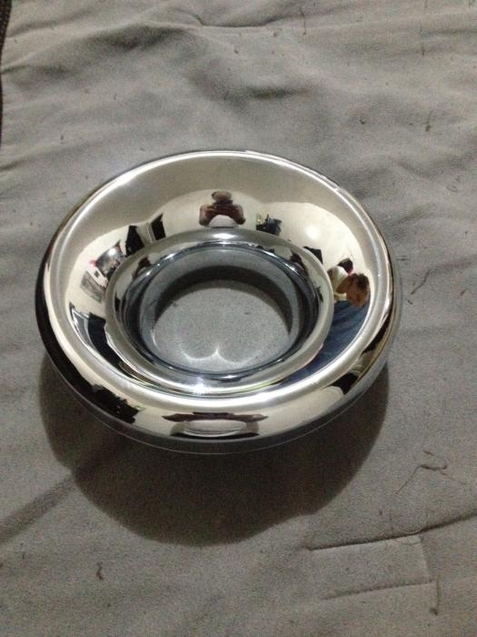

Before My last race I added a cheesy velocity stack to my intake to help out a little. I also finished up my aero front bumper.

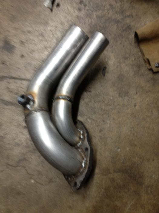

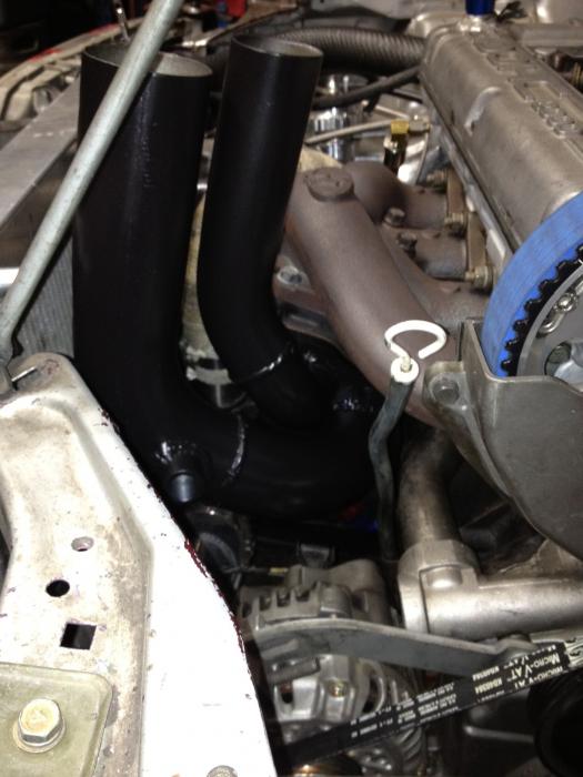

Had the hole aleady in my hood for the up pipe on my last turbo. I threw together the setup with what I had to get the car to the track. I finally had a little bit of time to redo the exhaust. Its lighter plus its an external dump unlike before.

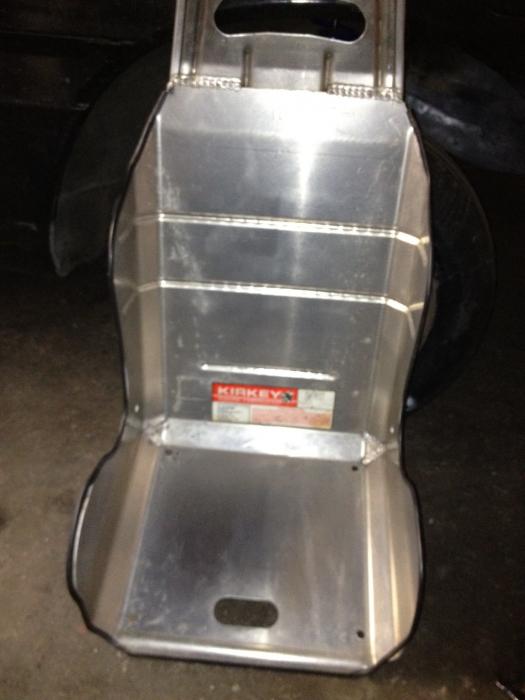

I weighed my summit seat with cover and my kirkey seat with cover and the nicer seat wins. So I get to change out to the kirkey before I bolt it to the cage. Also had the aftermarket steering wheel laying around. Weighed what I had and the aftermarket one the lighter one wins again. And while I have the summit seat out I spot weld drilled the factory seat mounts out. Another 2lbs off the car.

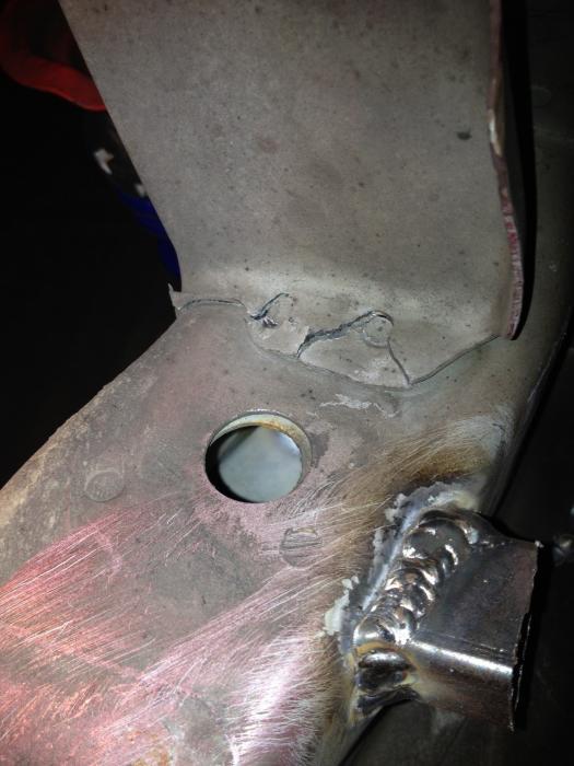

I ran an 11.2@122 with over a 5000ft DA. Track had bad prep that day. Car was just fightin. Went to measure my rear track bar and found the mount to the body side was broke. So I got that all fixed and made an adjustable bar. It's 2lbs lighter plus I can preload the rear for a better launch.

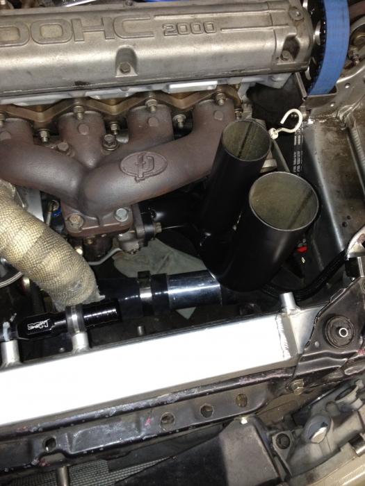

So brandon you like how you o2 dump turned out?? I'm now officially external dumped. I hope it'll help in the boost department.
Yeah...I liked it when it was on my car! Seemed like there was a slight increase in response and peak boost since there isn't any air returning back into the exhaust piping, thus letting the exhaust flow without any turbulence/restriction!
Good luck with the new mods and tires! I think you'll see some significant gains!
