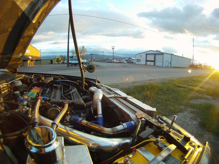

Tossed the engine in and began fabrication of basically everything else in the engine bay.
first picture of the manifold *cell phone style!*
After the manifold came...
Dual pass radiator
IC pipes
Intercooler (mounted where the grill used to be in between the headlights)
Intake
Catch can/coolant overflow
exhaust (3 to 4 inch as i re used a muffler from an R34 exhaust, then necks back down to 3.5" at the tip/tail pipe)

Decent picture that shows the top half of the IC

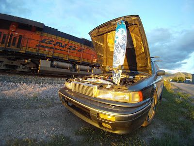

I'm interested to see a pic of how that intercooler looks when the hood is closed.

As for pictures of the IC set up with the hood closed unfortunately i can't seem to find any on my computer (not with the car now) I can tell you the top of the IC tucks up under the hood though (have to modify the hood to make this fit) sits very flush with head lights and you can't see the top of the IC at all with the hood closed.

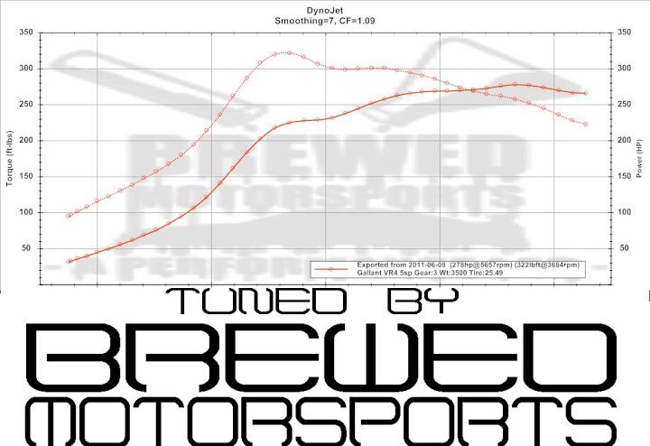

graph on Montana pump gas after some tuning

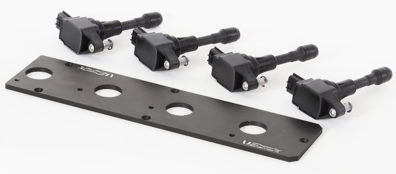

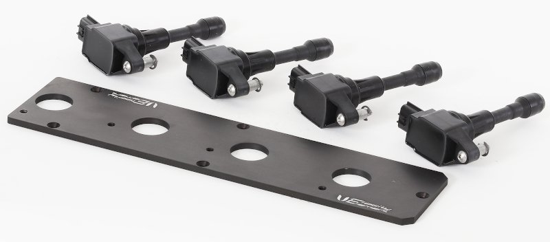

How did their kit work for you? I was thinking about using one myself
Yes kit works great, i have an AEM ecu in the car so i also got to go direct fire with the R35 cop conversion.
My stock coils had finally pooped out, i had a few good years at 22psi with stock coils/plugs gapped to 0.019" but as time went the stock coils just couldn't keep up anymore and i ended up having to drive around at only 16psi. With the R35 coils plugs gapped to 0.029" and happy at 24psi (fuel limited atm).
Badass! I ended up getting the OhmRacing setup with the Haltech coils and their milspec harness. Almost the same price too.
Nice one, the ign1a coils are great and stupid strong spark! I went r35 coils just to keep it simpler no plug wires and little lower profile sitting on top of the engine.
