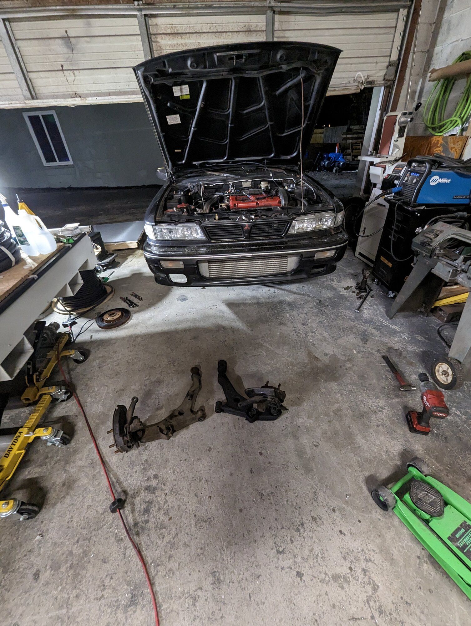

Well It's been a bit since an update but everything seems to be getting in the way of me making progress on the car. Well i've been driving the car but the front just doesn't feel right and i've been gathering parts slowly. I picked up everything for the front end minus a tubular subframe and new suspension which is also coming this summer. My clutch was also slipping under heavy load so i decided i might as well change that as well since i have a third of the job done by having to remove the axles for everything else. I for some reason thought i was still in my hayday of being able to do big jobs quickly so i decided to do it at work on a friday after a long day and since some of my co workers were staying to do some cad work it was perfect. Well i was wrong LOL. I started at 8pm and didn't leave till 8 am in a uber since my other car was at home LOL. I came back saturday night to finish everything up. I ended up finding some pretty interesting finds. The PO used a stock disk with a act PP and fidanza flywheel 2nd i figured why the clutch just never felt right with dis engagement the divet were the slave cylinder sits on the old fork was almost .250 deeper than the new fork i picked up:rolleyes:. Got everything buttoned up and left my car at work. I remember the slave looking wet during reinstall and told myself i would get a new one in there during the week since the clutch felt terrible after the new clutch went in. I installed the new one and didn't notice a big difference. So i started going through everything the the part that connects the master cylinder rod to the clutch pedal assembly was stripped. I always was suspect of the amount of play with it threaded into the rod and sure enough that was the issue. I have a nice billet one i caded up a while back but just have been so swamped i haven't been able to get it machined in the mill. Anyway i needed a quick fix so i took everything out fixed the threads which are m8x1.25 by the way and tacked a nut onto the piece that was fully stripped. That fixed the issue so now i'm waiting on an alignment. On a positive note the company just closed on a sick piece of property with a private strip to do car things on LOL

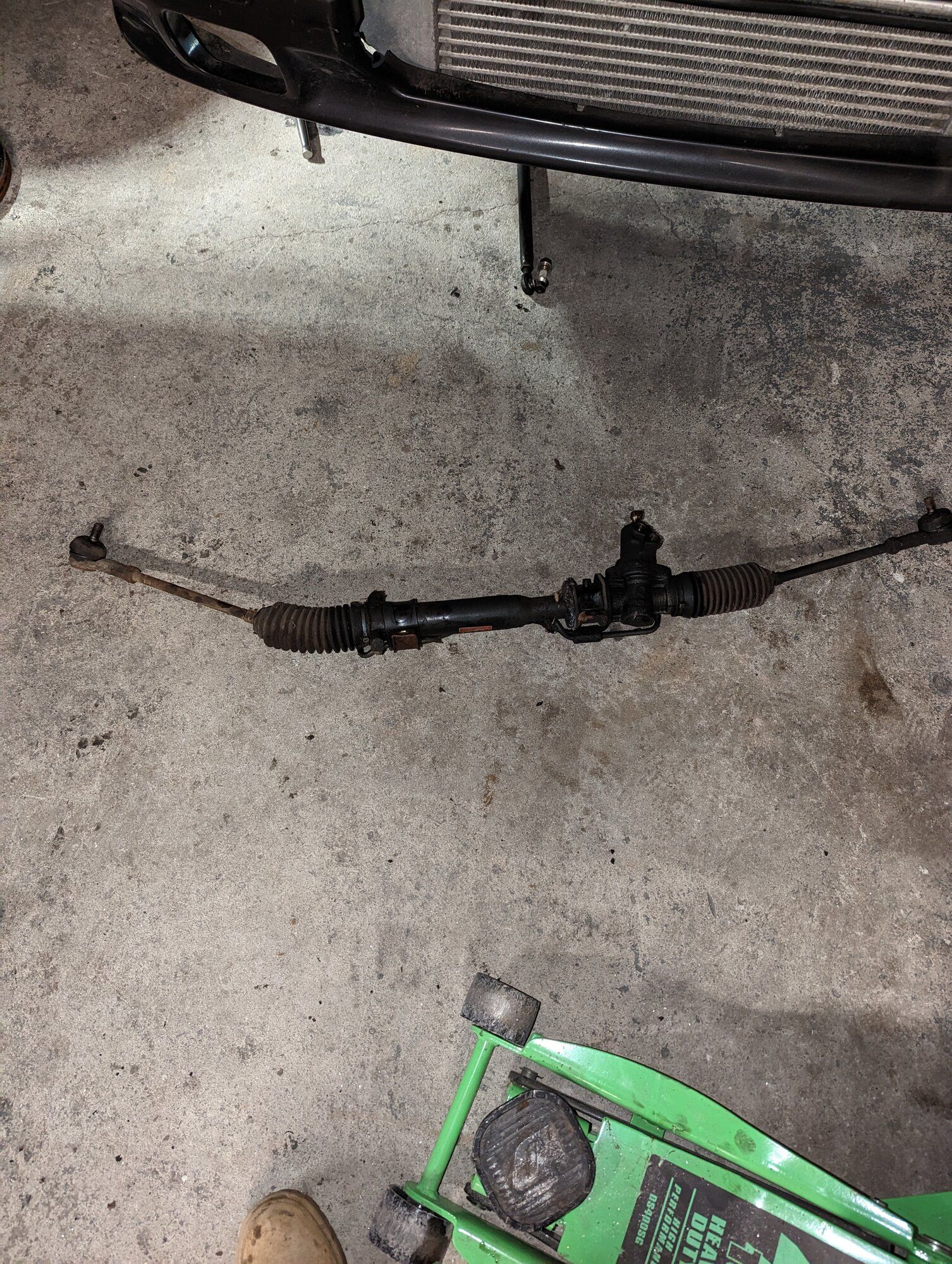

So i realized after doing the rack that the wheel moved but didn't realise how bad it was. Brought it to a local mechanic to see he was able to align it but told me the steering is off to much and it would require to disconnect the universal joint and get it back into line. Took the car home and over the weekend i tried to see if i could just remove the hub adapter and straighten the wheel that way temporally for a car meet that saturday night. Well when i took the nut off it felt really tight like the threads were damaged . So not thinking about it to much i straightened the wheel and tried to reinstall the nut and that was the wrong move LOL. After i broke this i gave up went inside and made a drink. I reached out to john from performance partout and was able to get another column and all was well. It came middle of the week and over the following weekend i started ripping everything out to swap out. I was stuck with a issue that the new column was not allowing my key cylinder to disengage and go into the lock position. After going through it for awhile i found the issue. Inside the key cylinder lock housing there is a lever that rests on the bottom of the lock button and when pushed in allows the back of the housing to spin and enter the lock position. Well my button was too worn on the replacement column key housing and not allowing enough throw. So i had to swap my old housing over. This was a first for me but pretty straightforward. These have security bolts installed. I was able to drill and extract them pretty easily now i was up about reinstalling new security bolts that i found on ebay for 14 a pop. I decided a simple cap bolt would suffice. Went to ace hardware picked up a set for 3 bucks. The head was slightly larger then i needed so i threw it on the lathe real quick and took it down .025. Got everything installed and was finally able to bring it to the same shop so they could finish the alignment.Overall i'm happy i can drive the car in peace but i'm not really happy with the alignment and will have to bring it to another shop since i can't find a good shop were i moved too. Need to source a volvo electric pump so i can finish the front and get rid of this eye sore of a hydraulic pump.

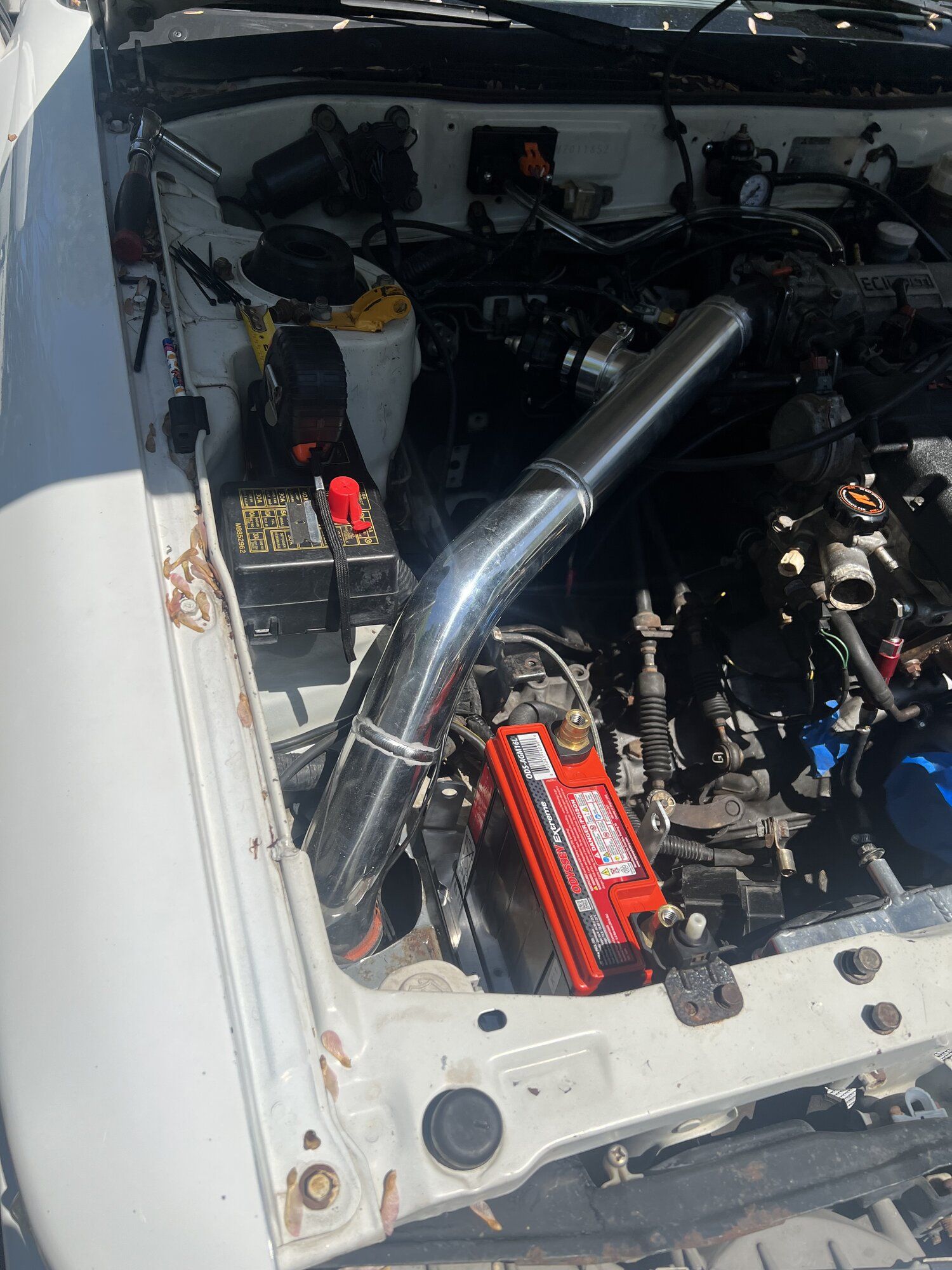

So after my last post on here i ended up getting sick so i got delayed. I ended up cutting up a battery tray like i said i was going to do
I got it tacked up and welded the bottom completely and just 4 stitches on the inside of the tray.

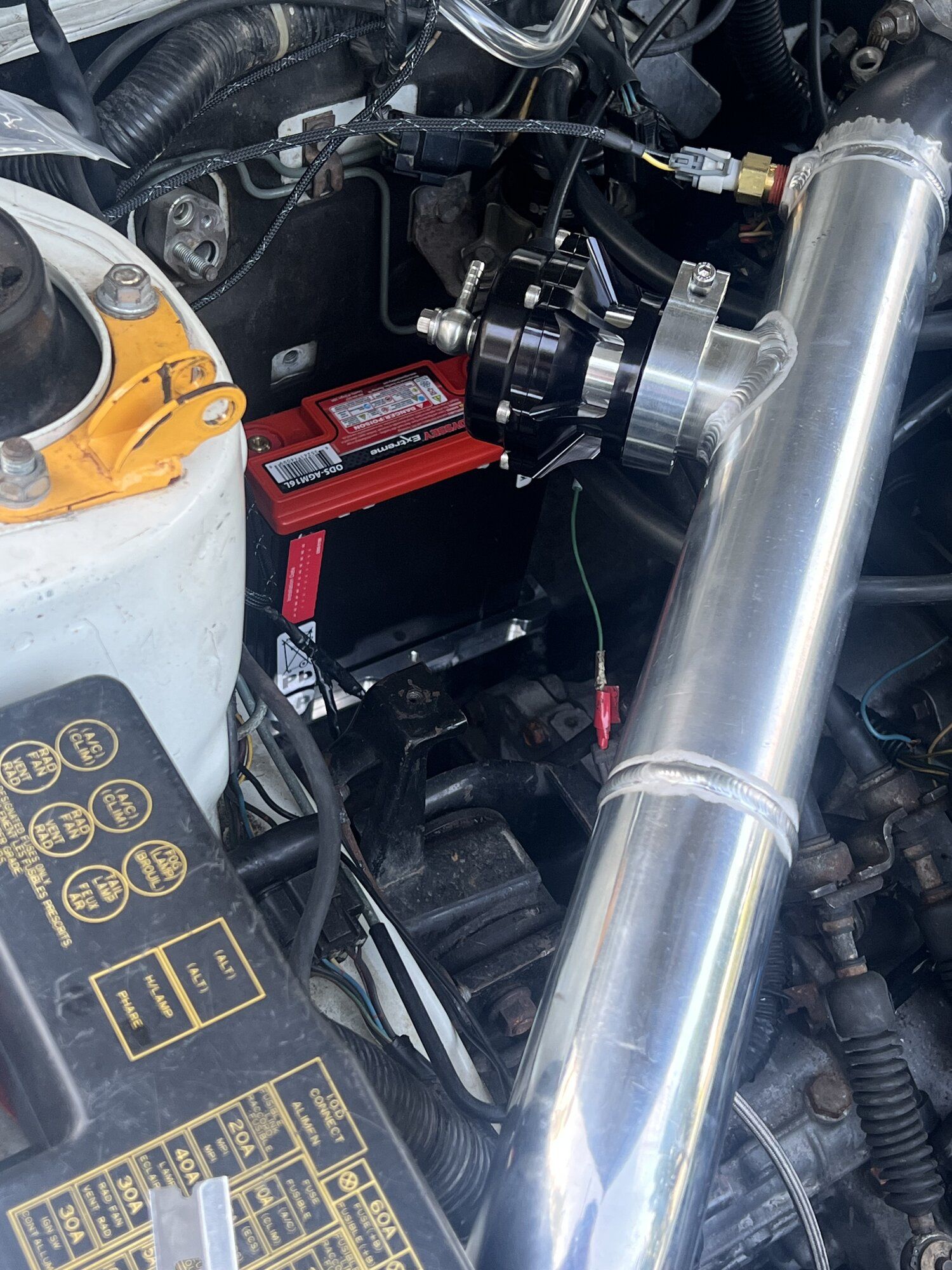

So i removed the battery and started on my intake i ended up going with a 45* coupler to a carbon fiber 45 to a filter and it worked out quite well.
Then the fun started i couldn't get the battery to fit how i wanted on the subframe it was too tall and was hitting everything plus the AC line. So then i checked in back of bumper but wasn't a fan of a full size battery there so i had to move it to the back. I placed a couple of next day orders on amazon and off i went on sunday to move it to the back. I wasn't sure if i wanted to keep my tray or make a box or what. So i just ran the wiring and left the battery loose in the back until i could figure out my life LOL. I wanted to get rid of the fusible link on the battery so i ended up getting a 200 amp fuse right off the battery then a 1-3 distribution block for the engine bay with anl fuses. So i used one of the bolts that holds the rear bumper in the truck as a ground and didn't think much of it again i was in a rush for some unknown reason. I go to try and turn the car on and i get nothing i was a bit of a loss. I decided to call it a night i was shot and had to get ready for a early morning meeting on monday i'll get back to it monday night. I was thinking about it all day and realized i missed a wire on the block. I go try again and i start to crank over and nothing again. Long story short the PO had a rubbery lining in the trunk which wasn't giving me a proper ground fixed that issue but now the car would start but wouldn't stay on. I thought either fuel pump relay or inline fuse sure enough it was the inline fuse. I change it nothing again. I hooked up my laptop i wasn't getting a proper signal and reading -29 with the car in the on position. My worst fear is i might have damaged the ecu with my stupidity with my grounding mistake. I wake up early on tuesday to remove the ecu and send it out to tom and dave to get checked out. I got home tuesday night and mounted the battery in the rear with the tray i made. I used SS 1/4-20 rivnuts into the floor for anchors and then drilled and countersunk the tray and off i went. It looks really clean and got a nice hold down.
Sorry for the mess i still need to tidy up but i like testing everything before i tuck wiring away. On wednesday i wanted to finish putting my interior back together but that wildfire happening in canada f***ed us and turned all of NY to this weird strange orange huge with a AQI of 340 in the city and 270 were i live. Safe to say i went straight home after work and didn't touch the car LOL
The following day it cleared up and i got the clear bill of health from dave at ecm. When i got home i started really digging though the wiring and found my issue. When i was test fitting my battery must of been yanking on the map sensor pigtail since mine is mounted to the firewall. I got the signal wire to come loose and that was the cause of my issues:ohdamn:
So now comes today i made a new pigtail and wired it in to test and long and behold i have a car that runs again LOL. The white wire you see is for the power belts which i still haven't routed into the fuse box. By sunday i should have everything tidied up and hopefully a new filter. The one in there was for mock up. So now again i'm torn what i should do for a catch can. Should i make something custom that wedges in-between the fuse box and filter or just get a vibrant 2 port and just mount it on the firewall?:idontknow:

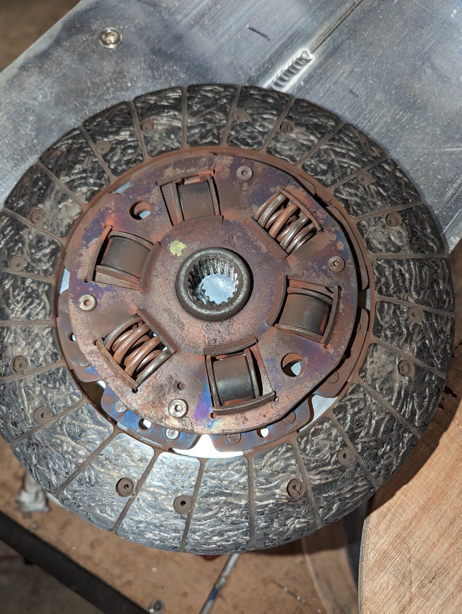

Finally driving the car after the last updates. On sunday i took it for the whole day which included a good mix of city and highway to see how the car behaved. I found a couple issues one of them being the clutch feeling very inconsistent and making noises. So during this week i looked into had a friend in the car pushing the clutch to see what was happening. The block was separating. I know i was missing the 12 in the back of the transmission but this was excessive. Nest day got home at a decent time and went over all the bolts and 2 of the 3 14mm were loose but didn't look loose with a visual inspection:banghead:. I tightened those and then i wanted to figure out how to get the back 12 to work. 2/3rds of the ear was cracked off so i didn't have much to work with. I got 1.5 aluminum angle .250 thick and drilled a offset hole so it could catch the remaining stub of the broken ear and it was a success the car felt worlds better. So i've been very happy with the car so i've been driving it but the exhaust has had a slight rattle at certain rpms which were driving me up the wall. Today after work i took an hour and added 2 hangers now no more rattle:pray:. Been keeping a eye on voltage since the battery swap and still a solid 13.8 while driving at night with everything on so that's good. I'll be adding a restrictor to the turbo since i get slight puff after a pull. I found a had a tare in the driver side cv boot so i'll be taking care of that then that will be the last thing to mess with besides a oil change. When i get back from vacation i will start tuning it to see how i like the turbo. So far from the partial pulls just to feel responsiveness its meh. At least for how i drive at my current ageLOL.
This was pretty common back in the day. ACT used to basically use stock clutch discs on their clutches, then started heat treating them and changing/adding springs.
I used to sell them all of their Mitsu discs/pressure plates/throw out bearings for several years.
I figured as much and a friend older than me told me the same thing when i showed him. First time i ever ran into personally though.
