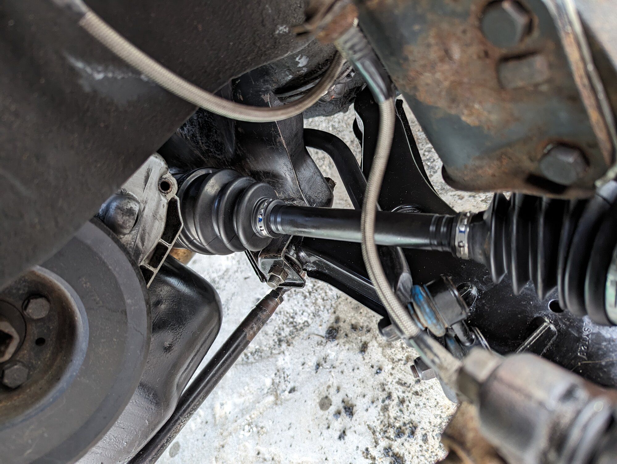

Figured i should give a little update. Nothing to big since i've just been enjoying the car which is nice to say. I picked up the driver side axle a few days before my birthday and my vacay but didn't have enough time to install before i left. So i figured i would do it today. The torn boot made a mess and a half. So after spending 20 mins cleaning everything i threw the new one in

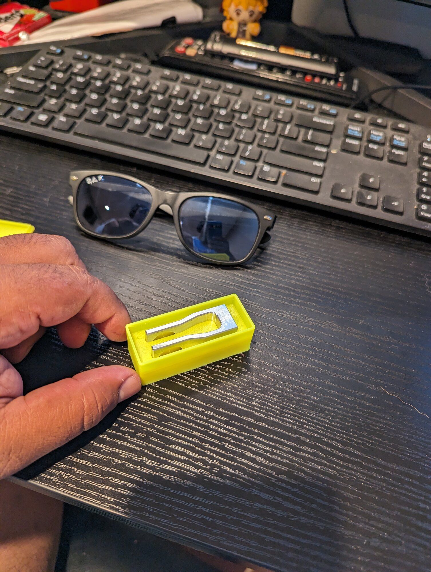

While i was on vacay which was during my birthday the guys at the shop had a chance to machine the billet clutch pedal bracket that attaches from the master rod to the pedal. I thought it was pretty cool they even 3d printed a case for it. I'm almost inclined to keep it as a gift since i appreciate little things like that.

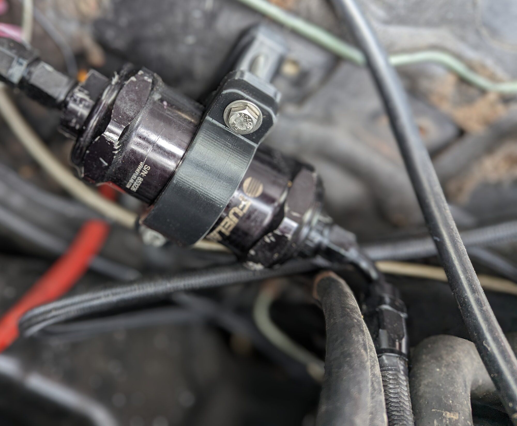

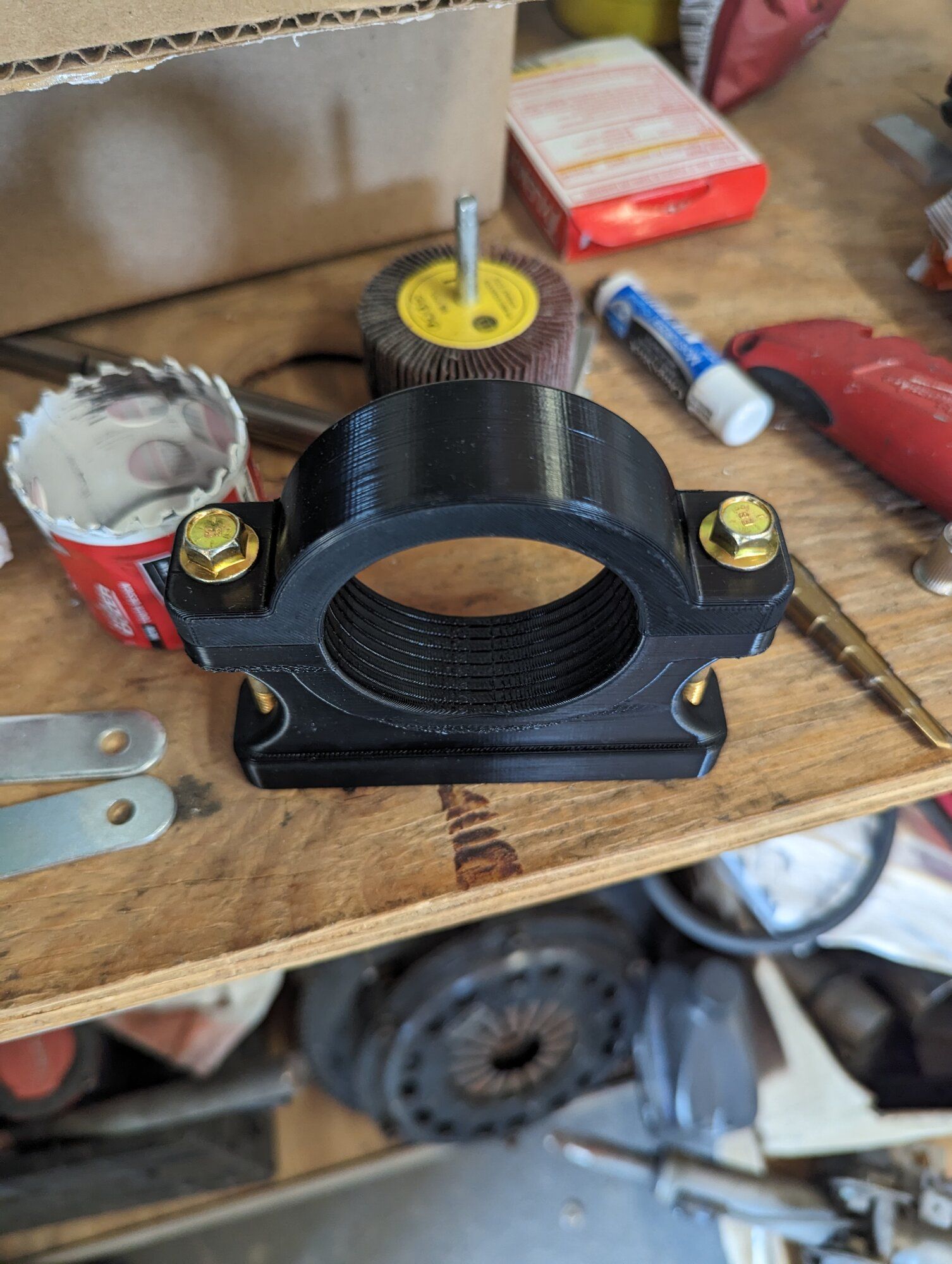

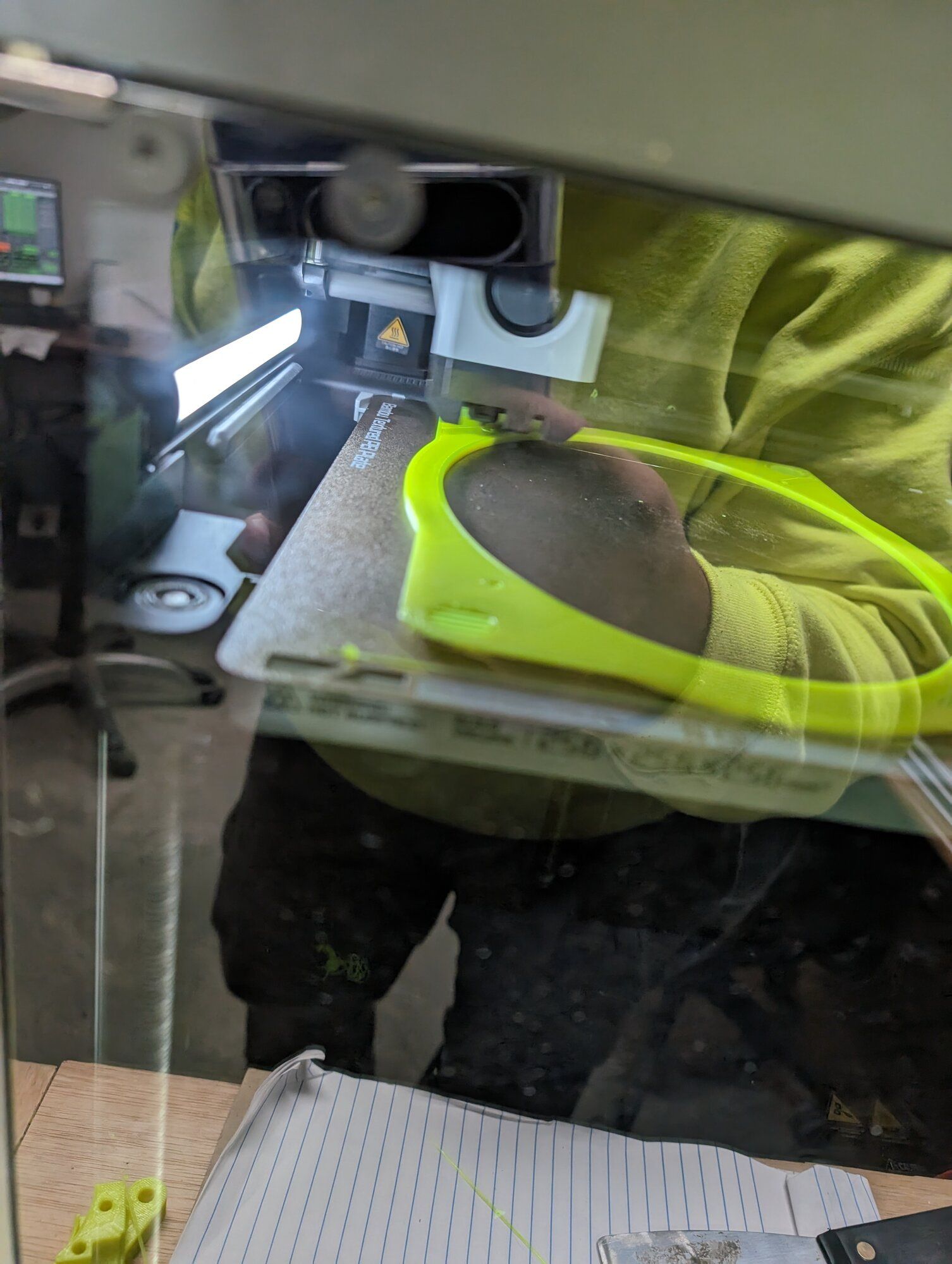

Small update since my trip to ohio. I wanted a better mount for my fuel lab fuel filter so i designed something a little beefier then the one fuel lab supplies and gets mounted into the firewall with rivnuts. I printed it out of abs and the finish is beautiful. I've been testing it for almost a month just to see how it stands up to all the vibration and heat before i offer these to other people but i'm happy with the way it came out.

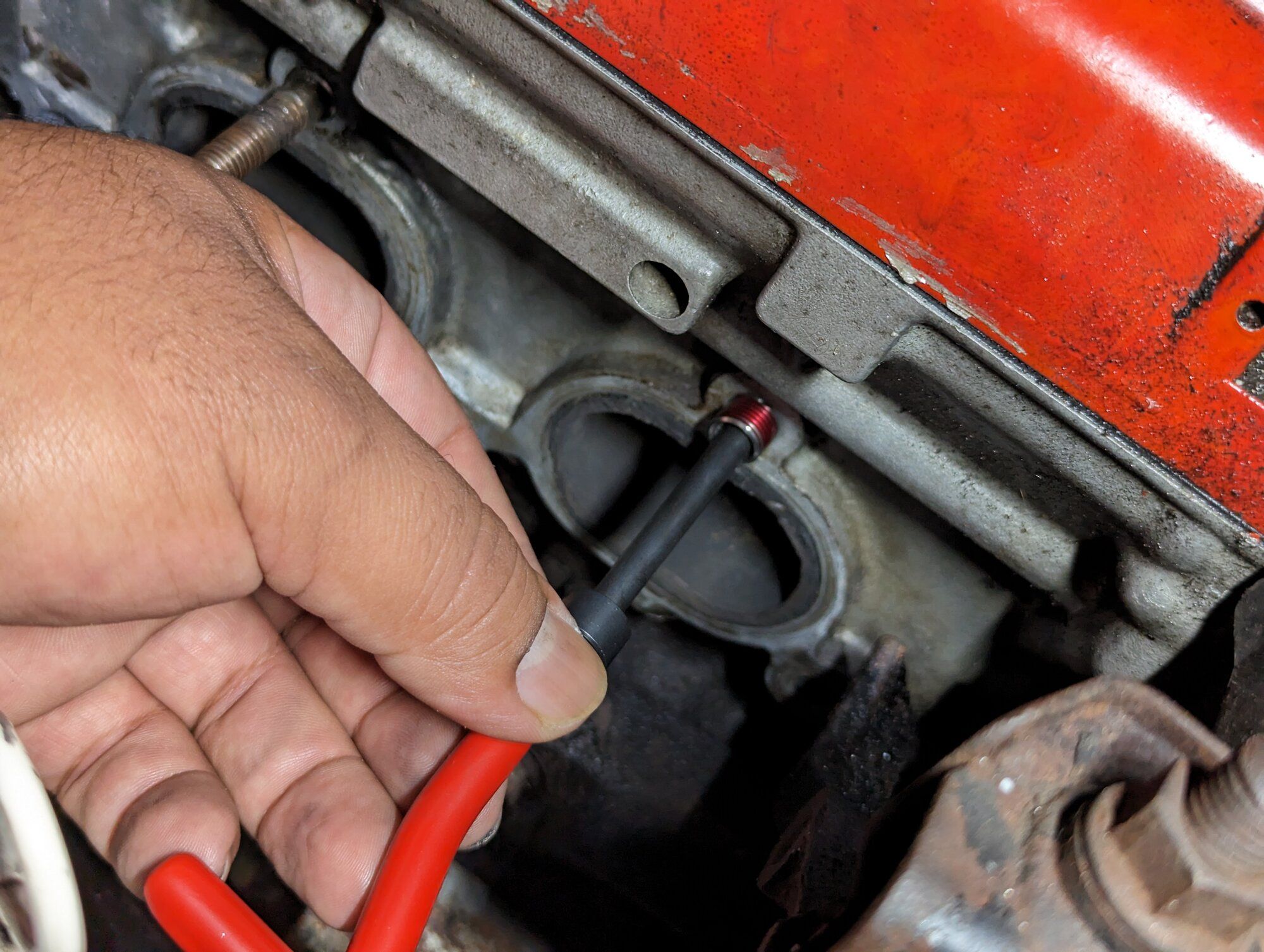

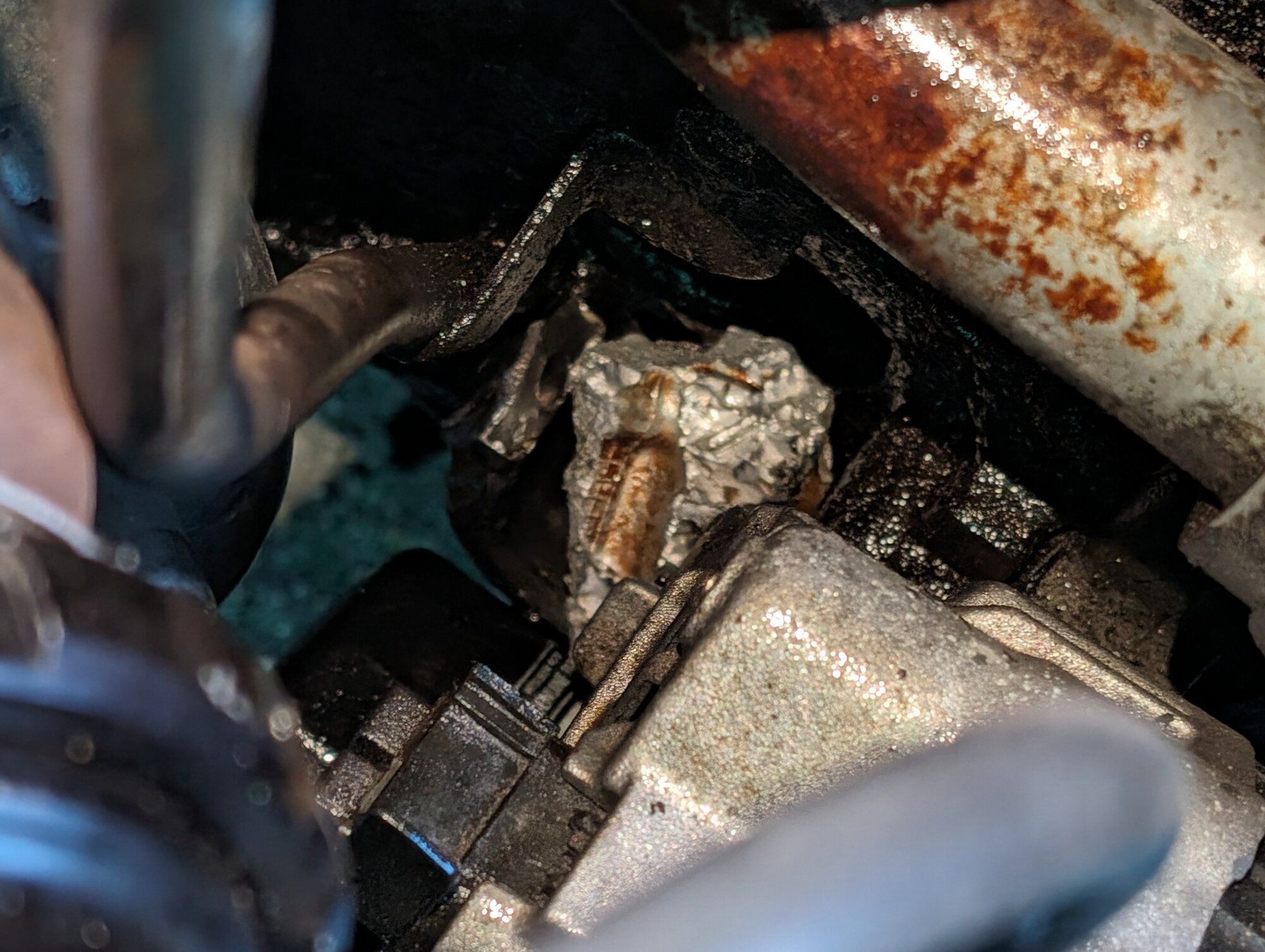

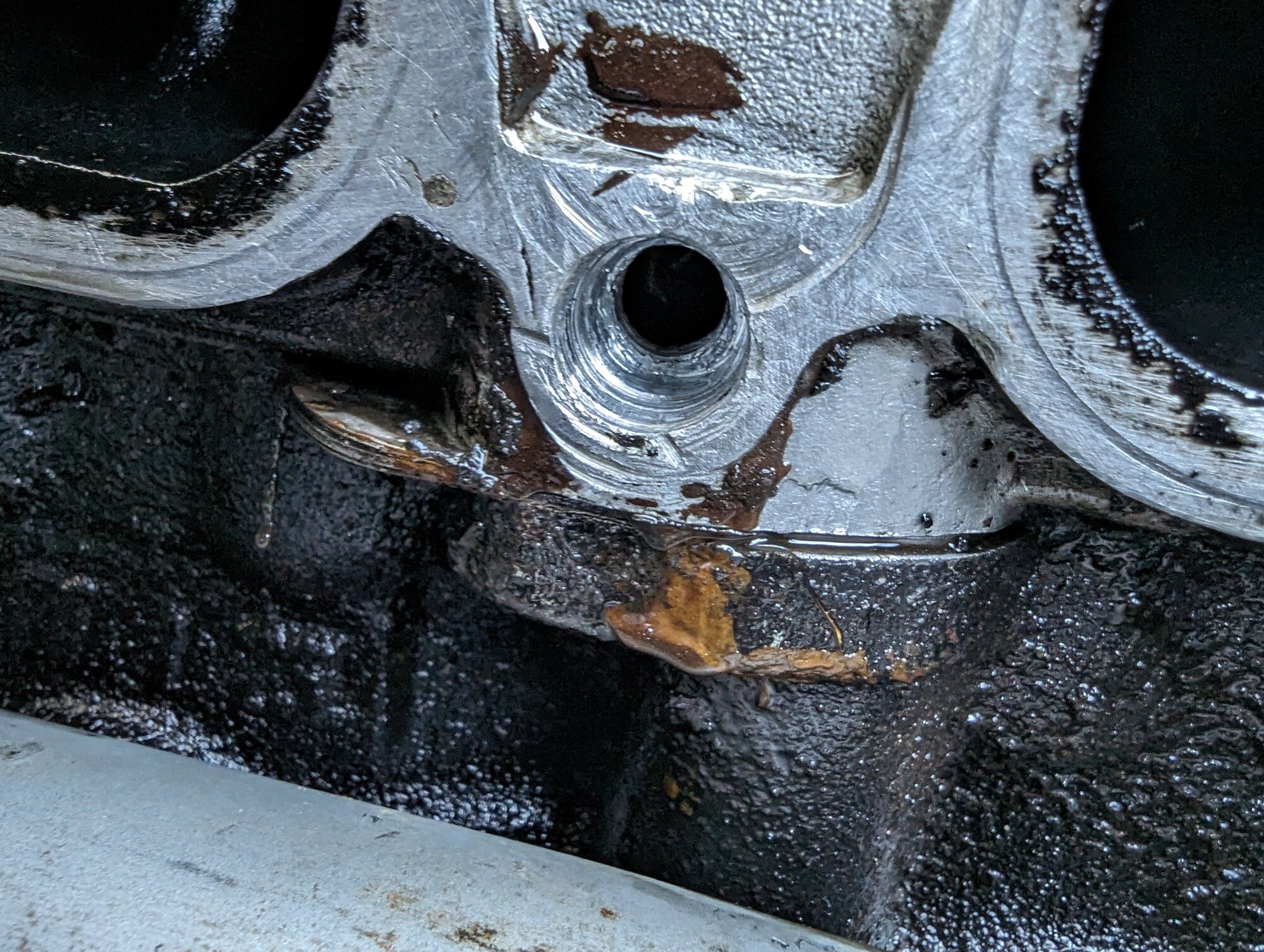

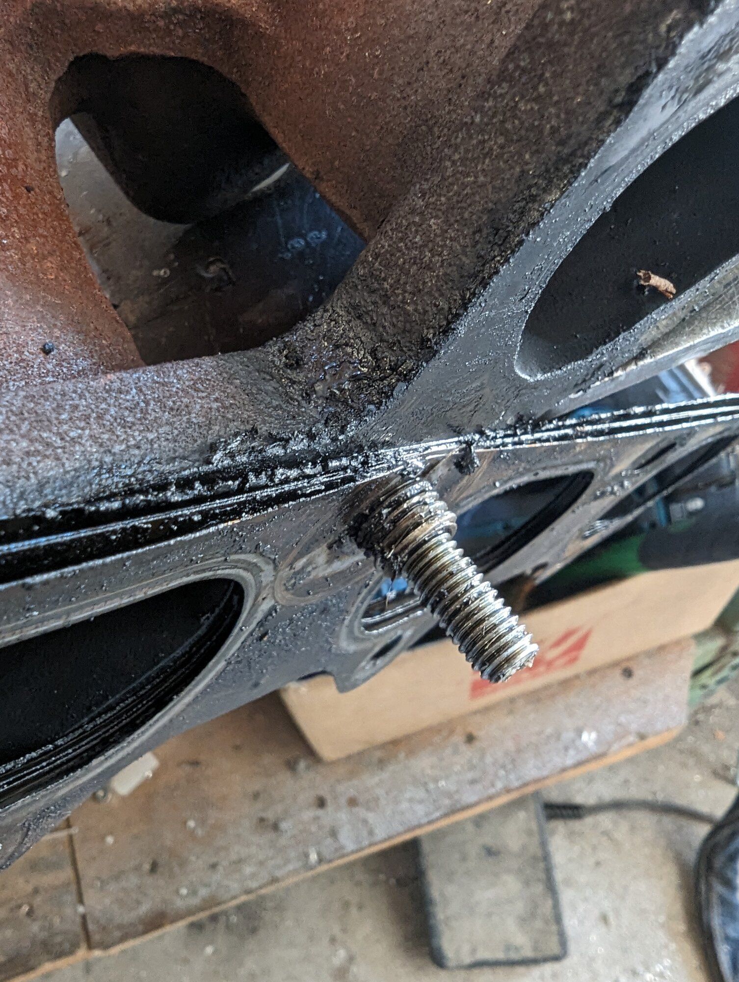

I also had a oil leak that got stronger since the trip. The stud that goes into the oil galley was leaking ever so slightly months back but it got worse. So in my head i figured i would take it to work and throw a helicoil into that hole since the threads felt shotty and i had 2 other holes that were starting to give out. A job that i though would be no more than 30 mins ended up taking a day and half LOL. The stud that goes through the oil galley wasn't coming out. When i finally yanked it out the stud and helicoils came out with it:cry:. So apparently when the PO tried fixing this he messed up the original helicoil hole and ended up drilling it to fit a larger helicoil and then threaded the m8 helicoil into that one. So the hole measured out to being .485. I wasn't sure how to fix this on at the moment so i took some time to weigh out my options. Tap the current hole and use a loctite and a plug to seal it up or clean the hole out and use high temp jb weld. There was very little merial left so i figured i would try jb weld.I prepped up everything and cleaned the head and applied a liberal amount of job into the hole. I put everything back together and when tightening up the manifold 2 of the studs that were fine before decided to give up. I gave up for the night and removed everything and left it for the next day. Following day fixed the stripped holes and long and behold no more oil leak:hellyeah:. This is a fix for now i really need to finish my other motor or at least my other cylinder head i have laying around.

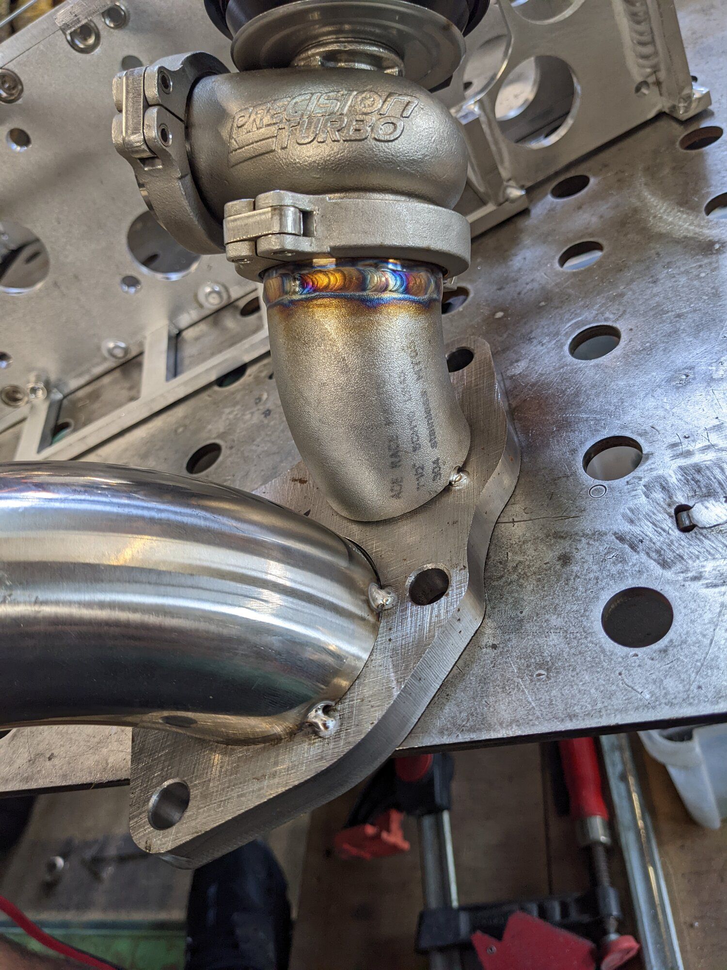

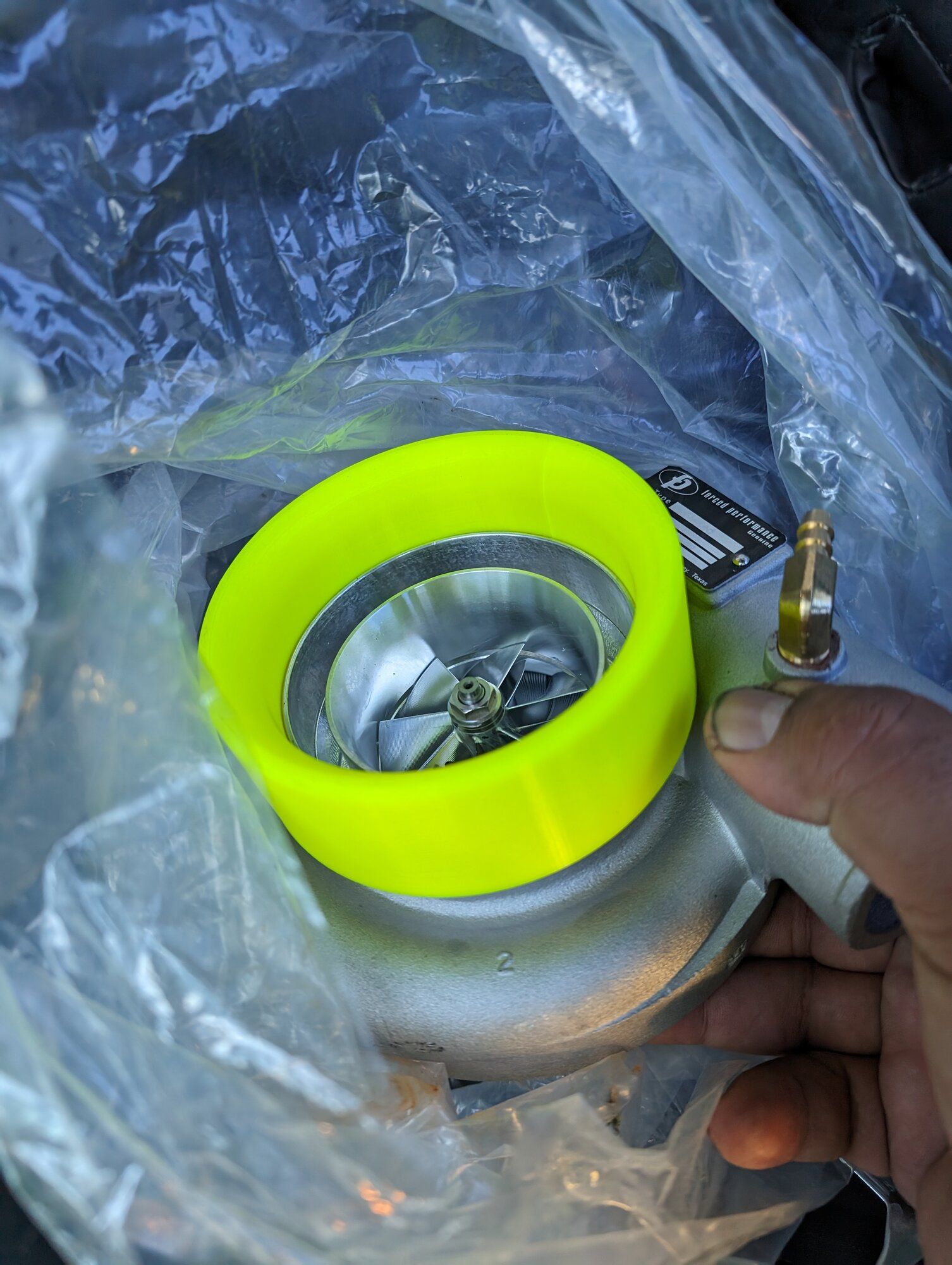

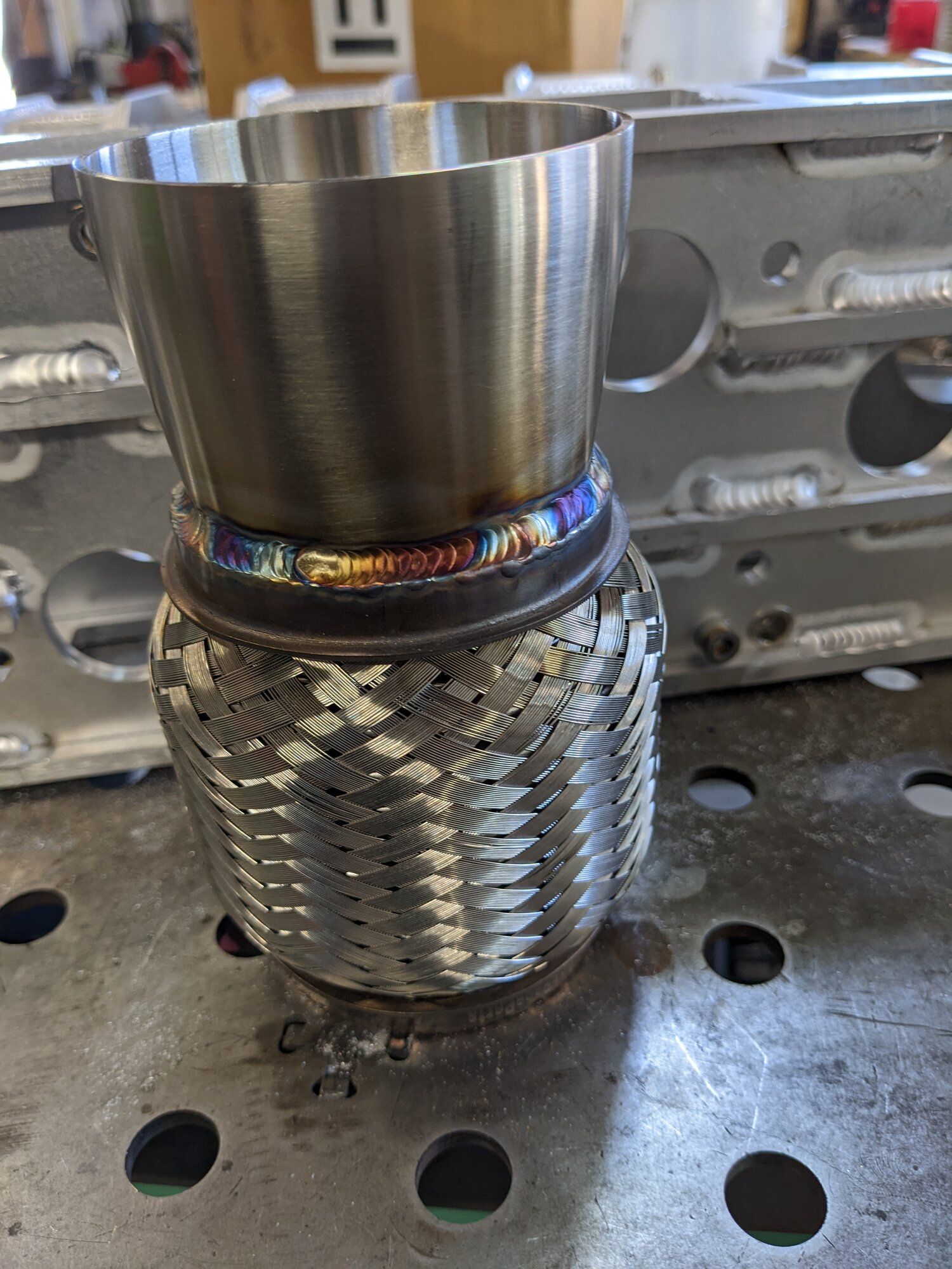

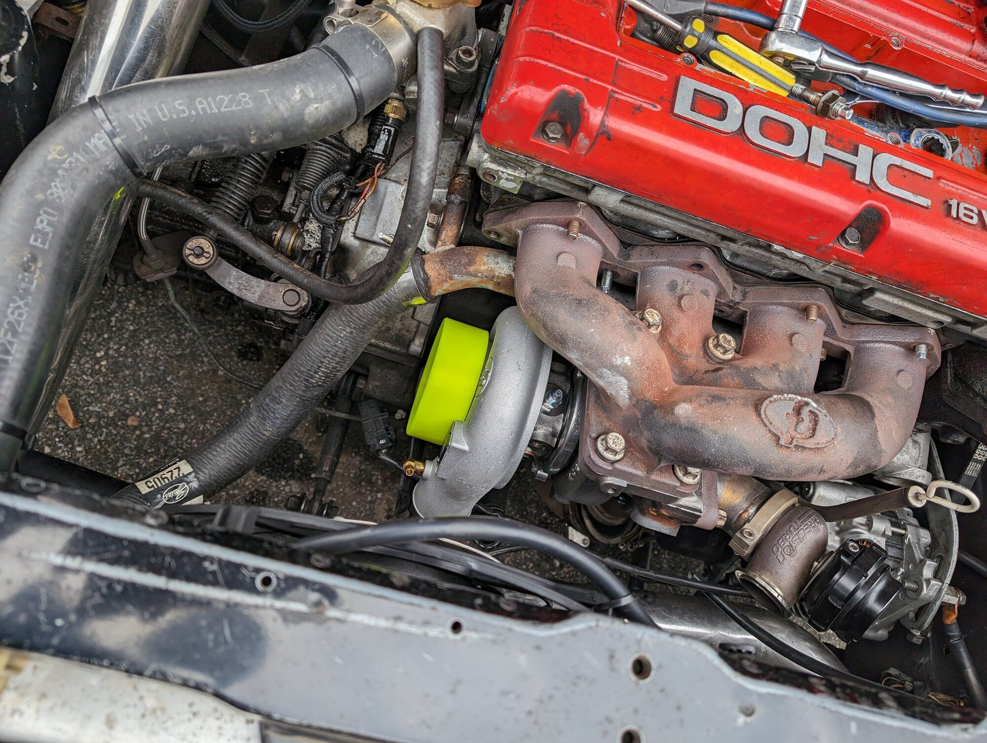

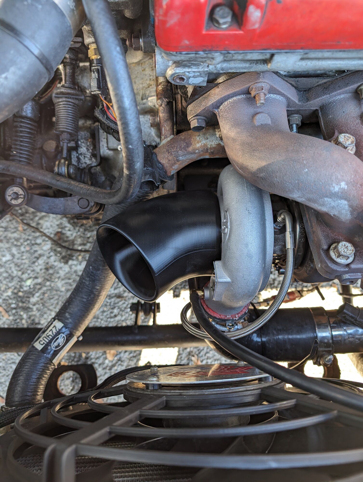

Next on the list was to finally install the FP red i got over a year ago LOL. I made an adapter to reuse my intake since it was all relatively newish. I made the ID .015 smaller for a tight fit and made the OD .100 bigger for a snug fit as well. I ordered a new feed line with a FP inline filter and picked up another Morrison drain line kit. By far my favorite return line kit i've used and i'll keep buying them for every turbo i buy moving forward.
I'll get some more pics once we get another nice day. But intal opinion without redoing the tune is this turbo feels amazing and the new aero compared to the older reds i've tuned feels super responsive even at light load. I'll update as i continue to chip away at making the car my rendition of a perfect sleeper.

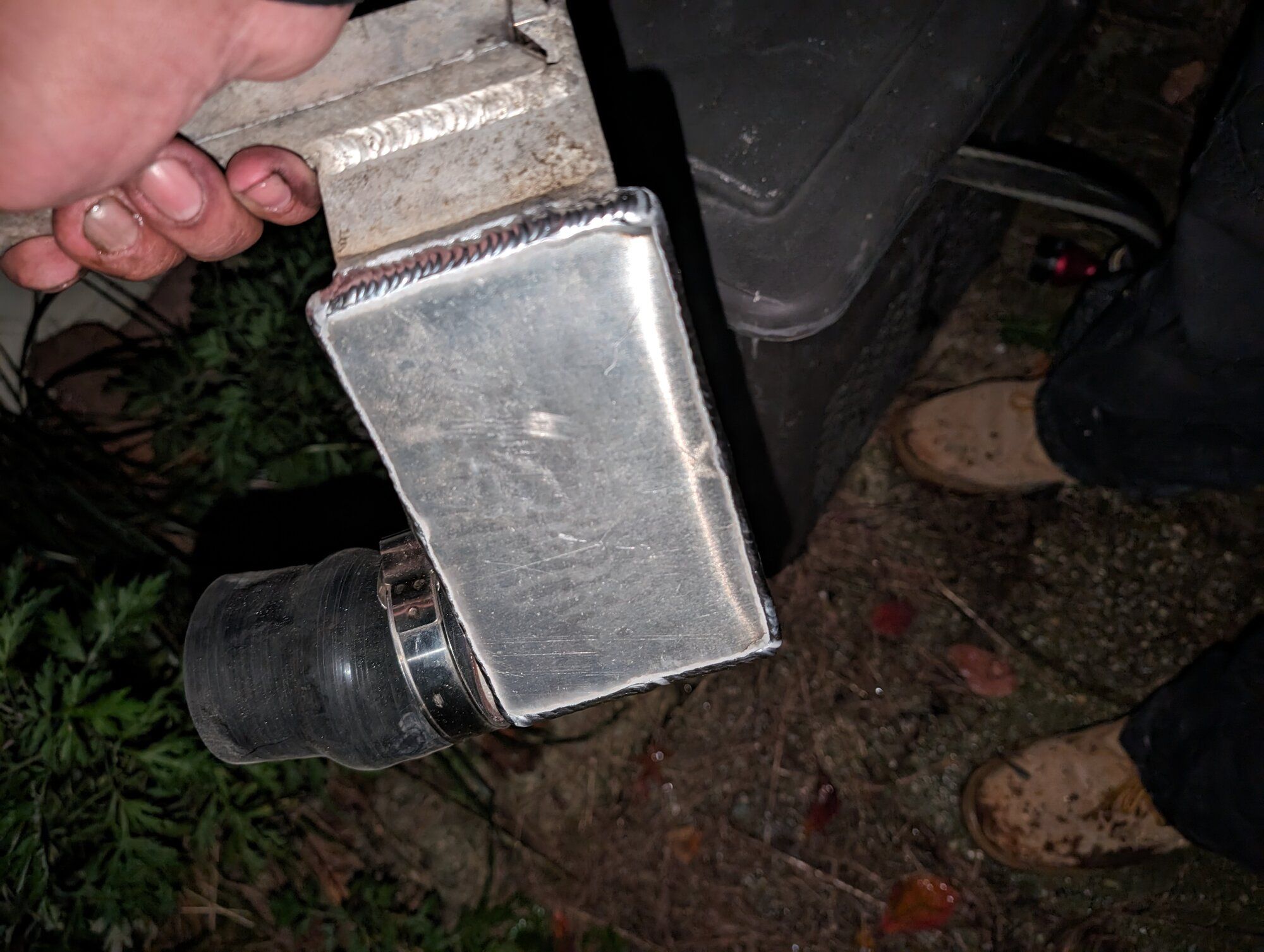

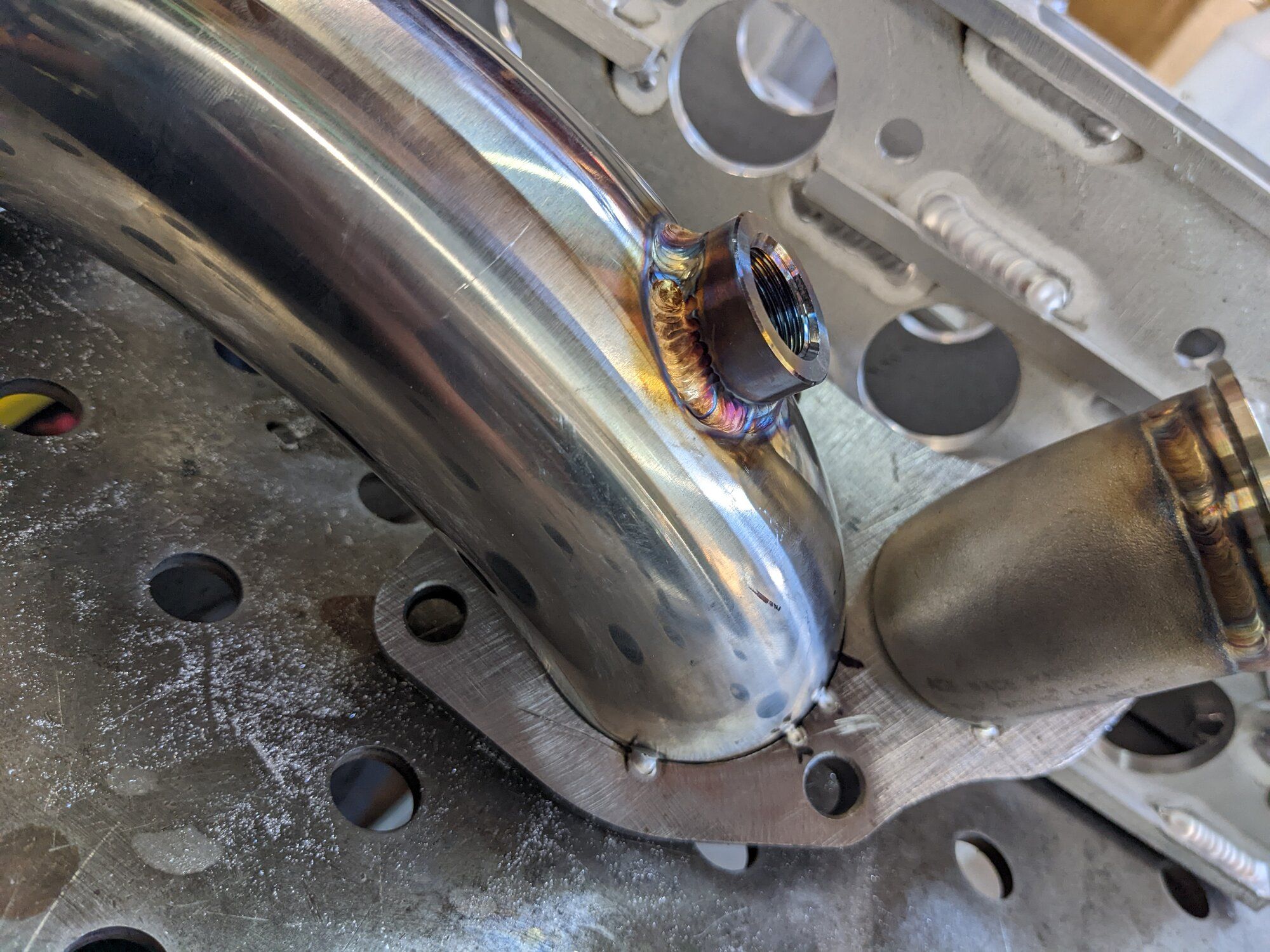

So a few things have been going on since the last update. I blew a section of my endtank out LOL. I ended up overboosting and it gave out. It was a very simple repair and had it fixed the same night.

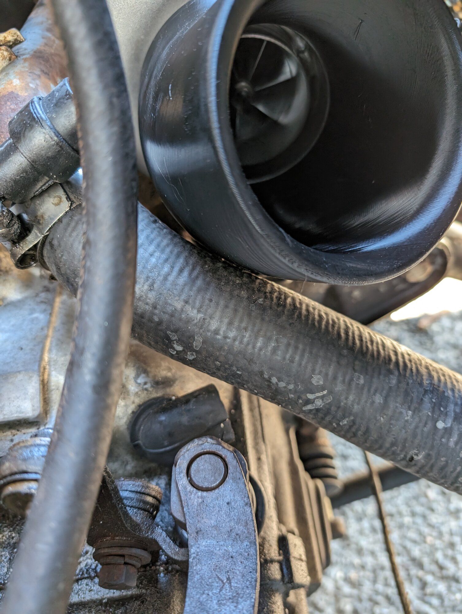

I also have been playing around with my adapter i made for my turbo to keep my 4" intake and i am much happier with how it came out. No more fighting with it being right up against the lower rad hose.

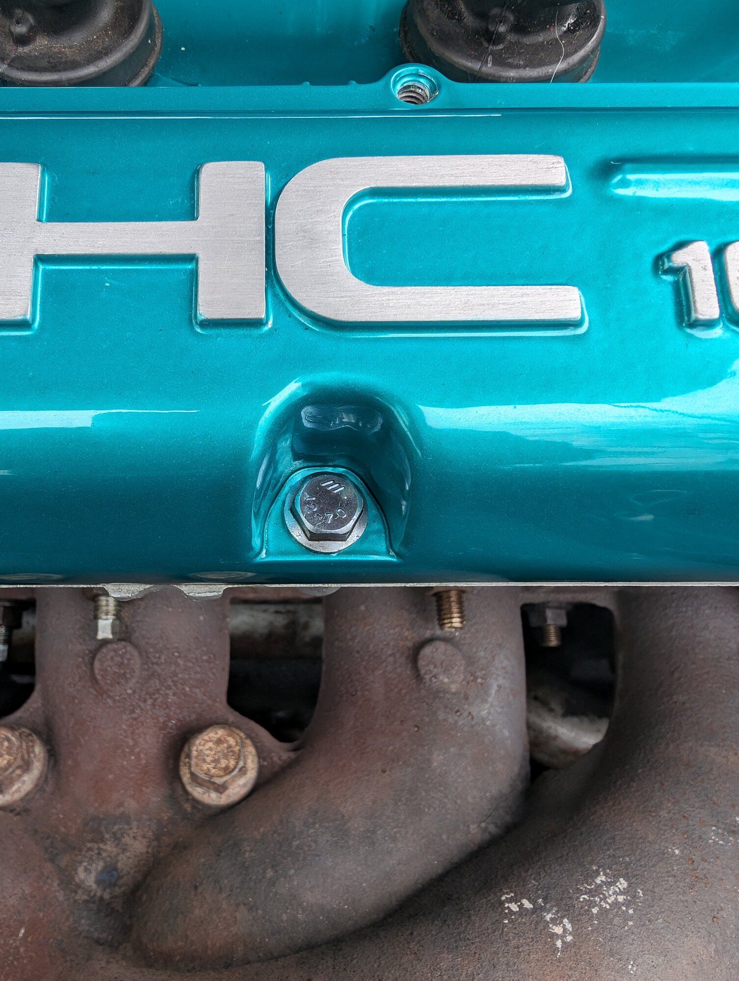

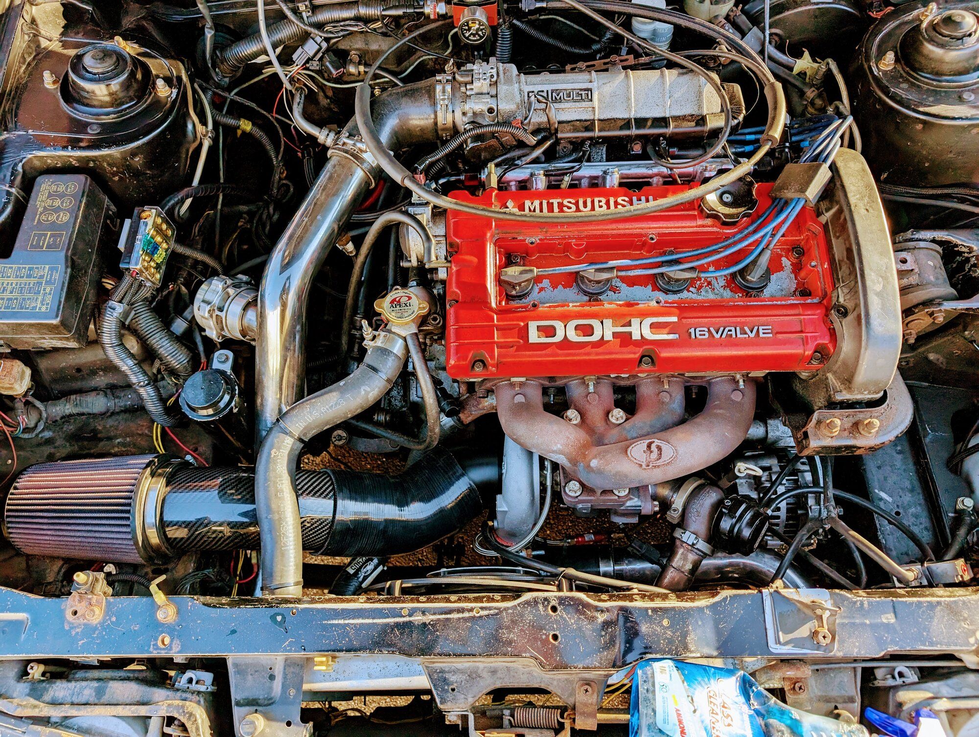

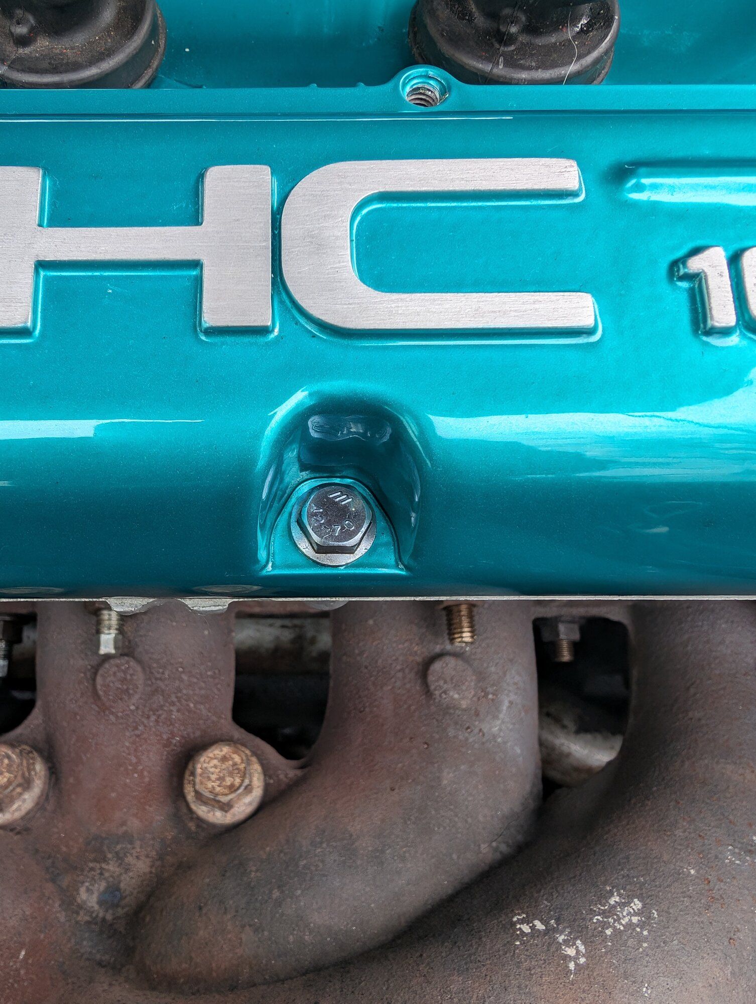

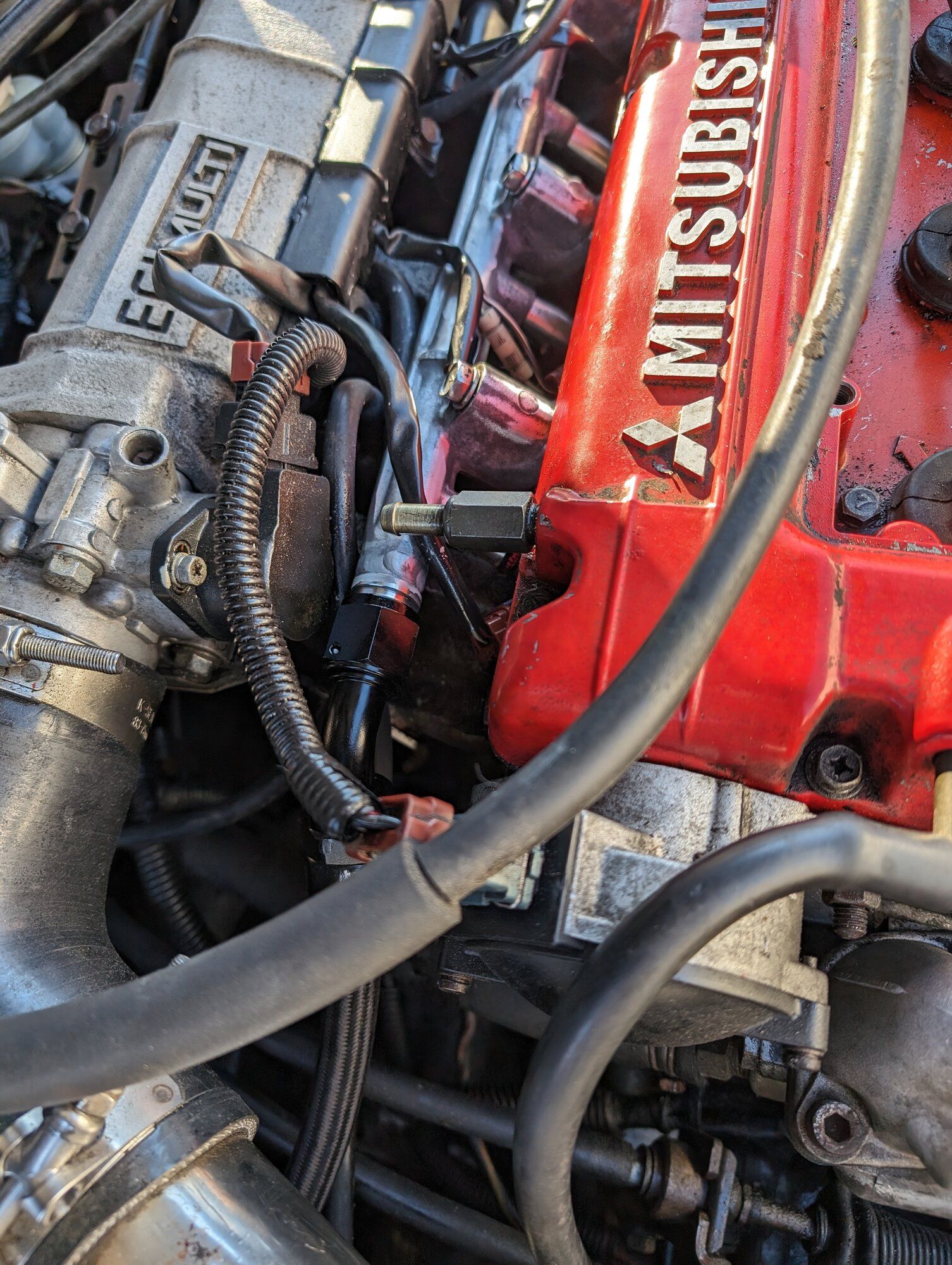

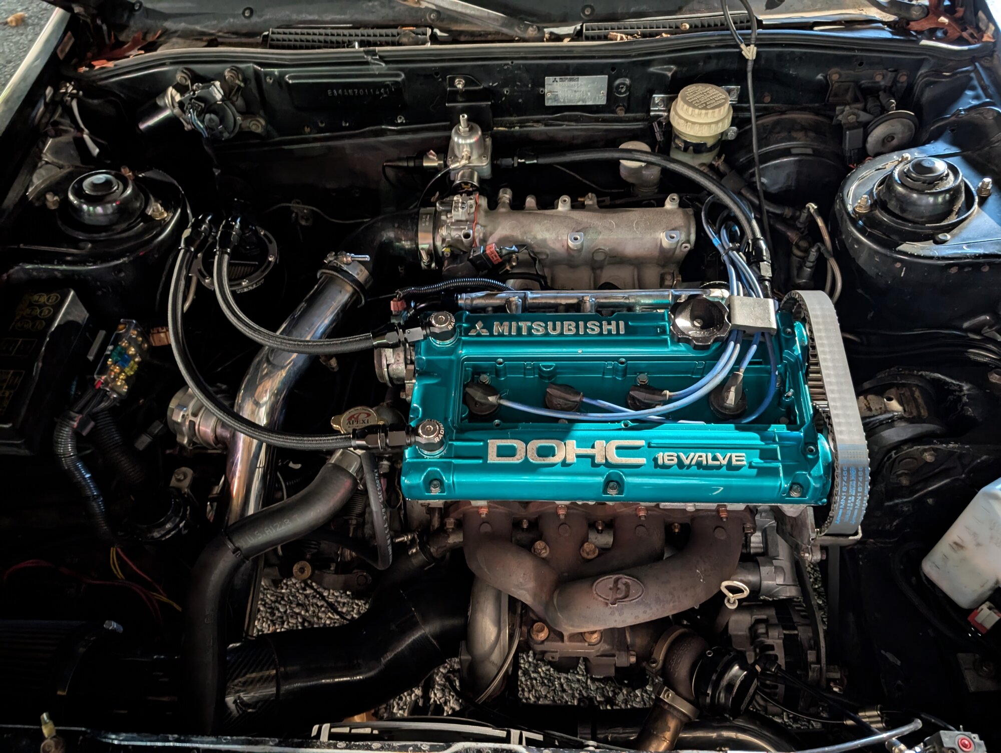

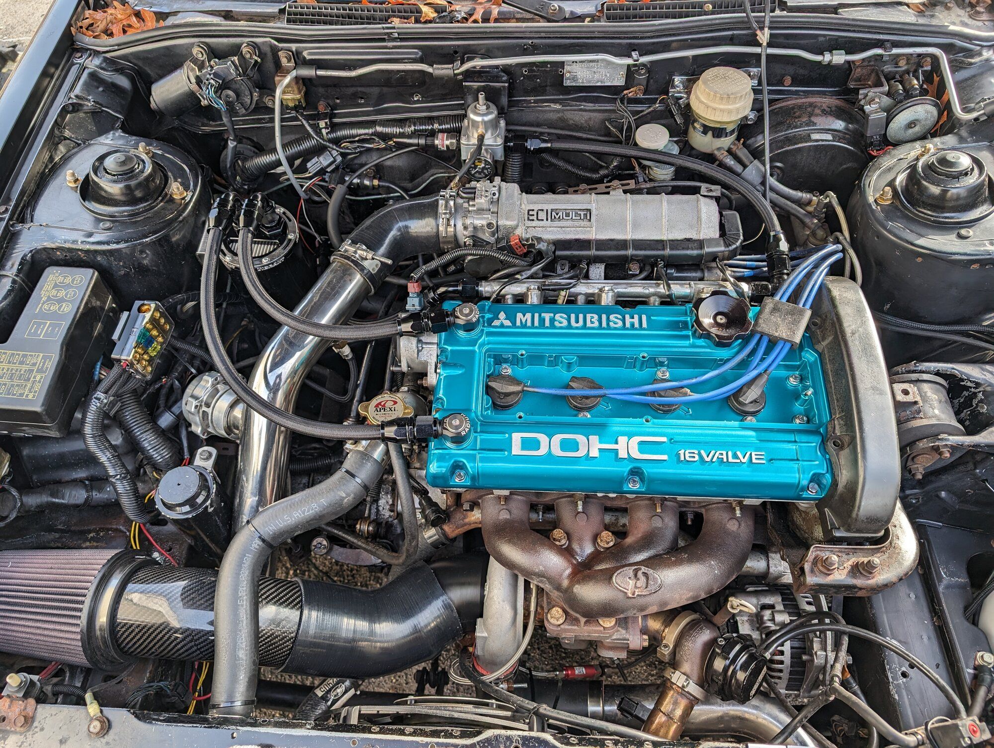

Small but meaningful update. I finally installed my valve cover that i powdercoated 2 summers ago LOL. I used female orb fittings and welded it from underneath to have no visible welds from the outside. Then got radium engineering low profile swivel orb to an fittings. Used PTFE line again since i'm getting decent at make them now LOL. I ended up going with a vibrant gen 3 catch can. I still want to make custom one i've been talking about. But unfortunately the shopis in the middle of finally moving so i'm swamped currently. I installed this last night after work since rain was on and off but it was surprisingly warm so i said why not. I did have to fix to stripped holes but that was simple since i already had a helicoil kit from when i fixed some other stripped holes a few years back. I ordered a pack of SS flanged bolts in 25mm. I trimmed 5mm for the middle and timing belt cover bolts and the rest of them i gave them a little heat treatment to match with the valve cover.
I also spent an hour today cleaning the engine bay since it's been a few months. I got a weldon regulator awhile back shortly after redoing the feed line since i wanted a bigger return orifice.

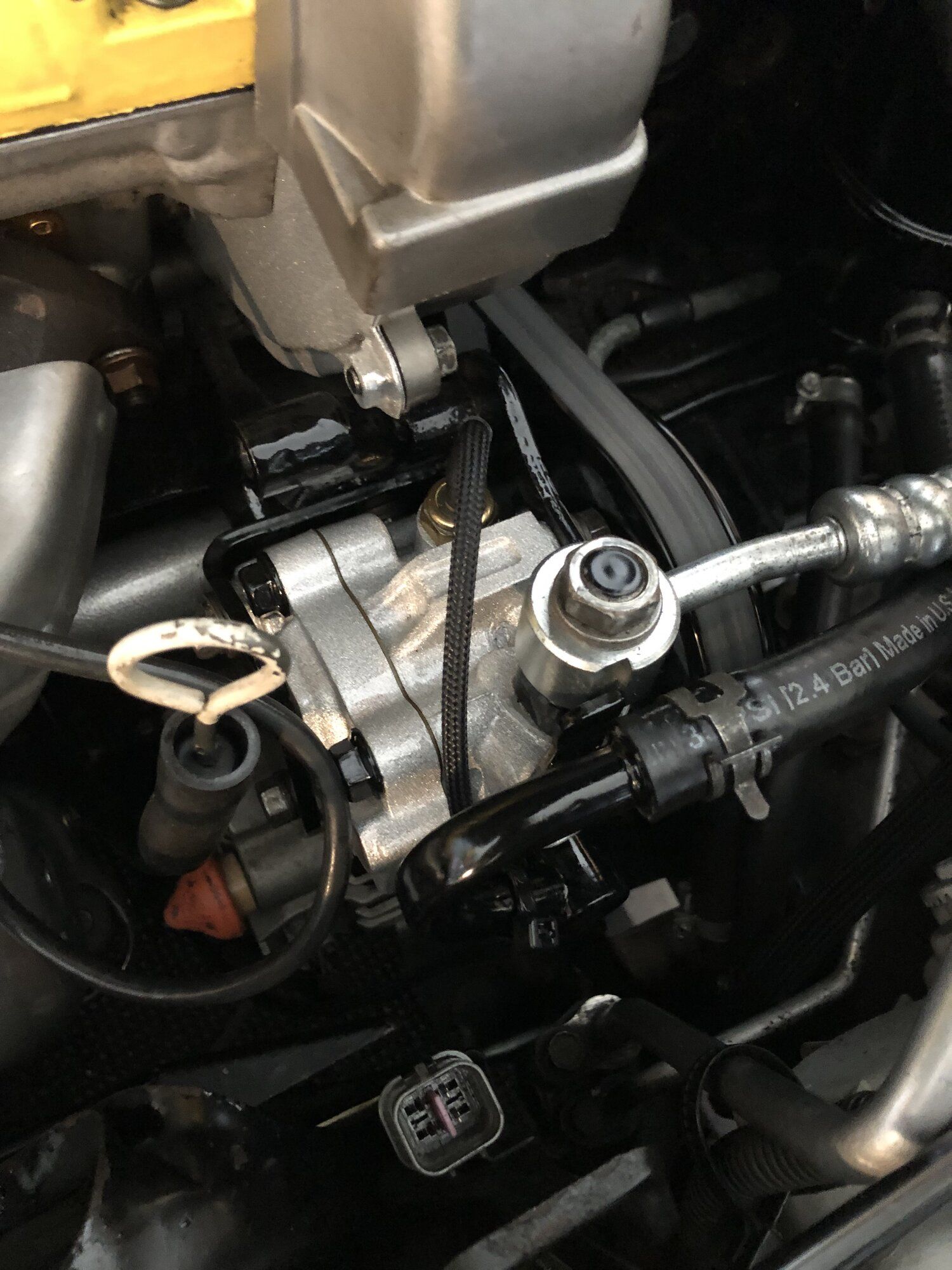

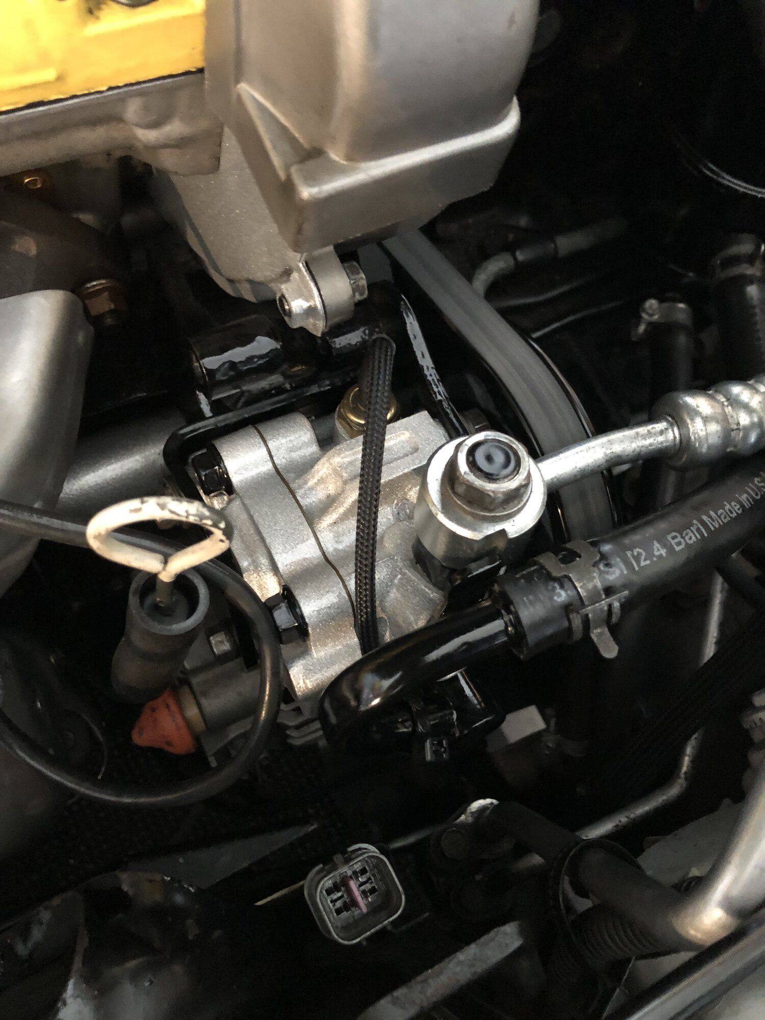

Finally got around to ordering the volvo pump each time i slept on them on ebay they went up 50 bucks LOL. I ordered all the fittings. I'm going to actually include links for whoever is looking to do this to their car. It's not a new thing but i finally had time to do it and it's a nice upgrade from the old system. I did not have time to take detailed photos but if your doing this kind of mod this is all pretty self explanatory.
These are the adapter fittings for the rack and volvo pump. The M16 is for the pump and the M14 is for the rack. The low pressure line is also a M16 but i ran regular return line hose for that. The return line i used a sunsong fitting with a 90* to run the line close to the firewall and then the frame rail.
Amazon product ASIN B014XF4N3W
I personally ran -6 ptfe line for the high pressure line from rack to pump. I ran the sunsong fitting to keep it simple and use a regular 3/8th return line you could source from autozone.
The volvo pump pump gets input for how much to assist via can. Obviously our cars don't communicate like that. I lot of people just run the power to the communication wires to power and get full assist all the time. Some have it wired in to a rotary knob.I used a guy from Portugal who has a board to control assist via gps and it works beautifully.
Next is powering the pump. It is super amp dependent. In my personal car with a 90 amp alt its fine but regular driving and turning while in motion. I did log the voltage during idle and in my driveway and it was able to drop it from 14.1 to 13.0/12.8. In motion while driving it only knocked it down .5/6 volts. I currently have it wired to the battery in the back with solid strain copper 10 gauge wire and a 40 amp fuse. I will be redoing all the wiring to the alternator since i plan on switching to a 200 amp single wire alternator from mcr. I'm still up in the air on how i want to redo the wiring but i will include a link to the alternator.
As for driving impressions . I loved it. It really gave it a modern car feel and the gps based assist was nice. I wasn't a big fan of the rotary knob to have to adjust all the time.

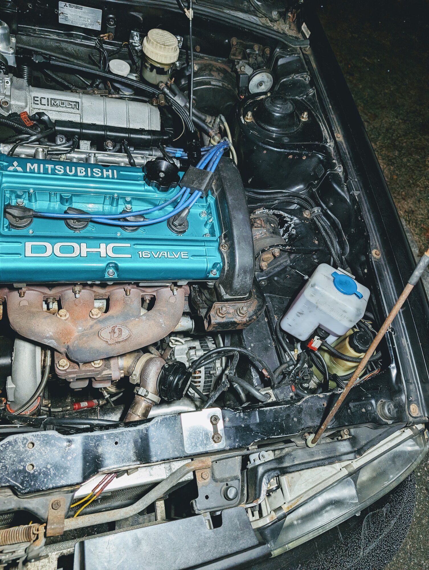

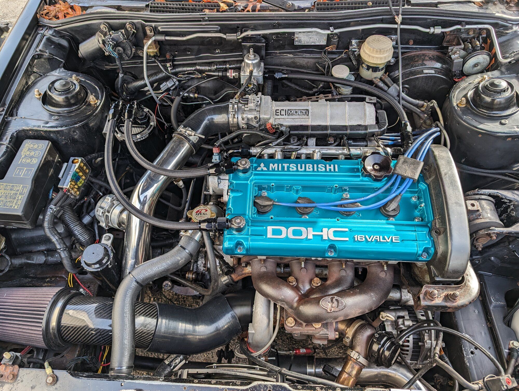

All in all well worth the endeavor. I'm including a current engine bay shot. I will be redoing my bracket for my coolant reservoir so it sits parallel to the body line where it is sitting.

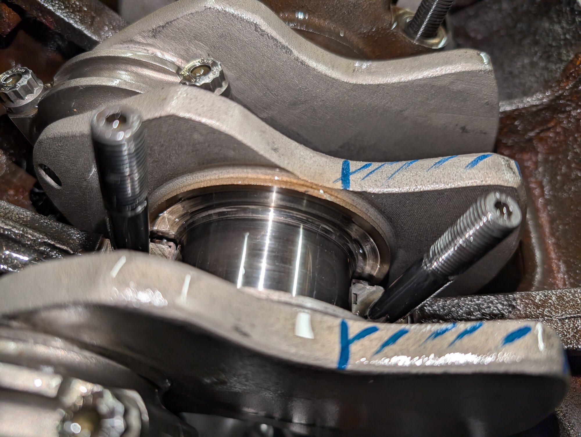

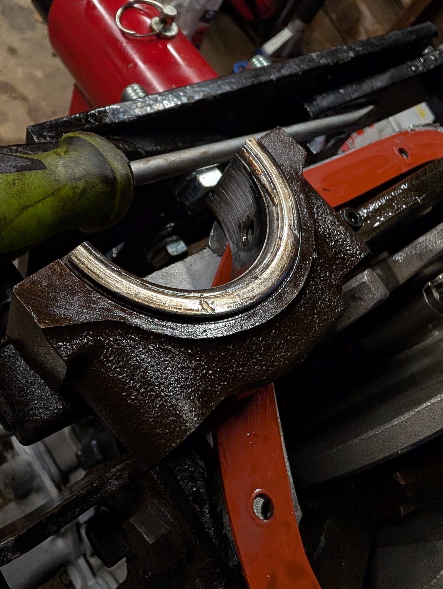

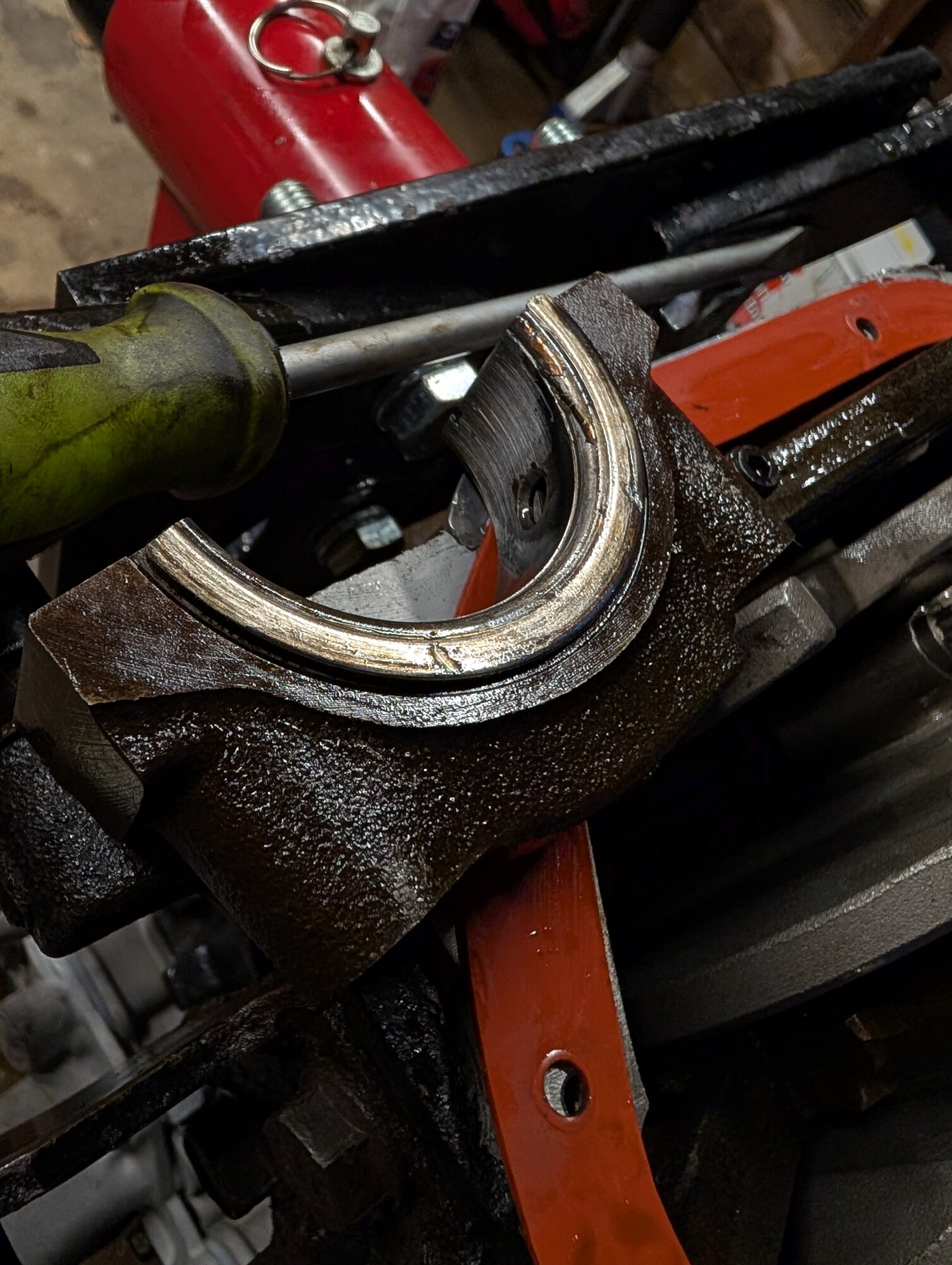

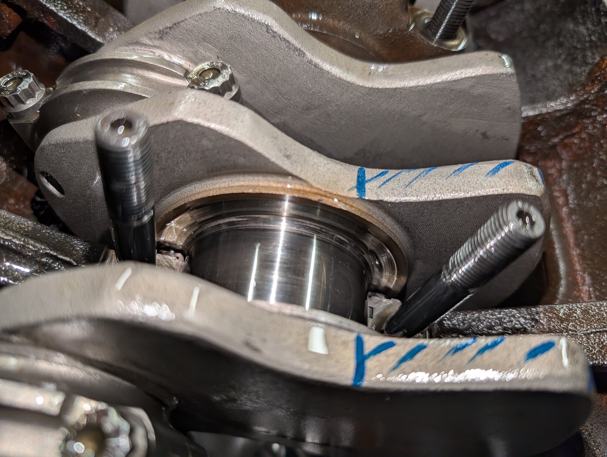

I finally got around to pulling and the motor and inspecting the bottom end. The rear thrust face is almost gone and the crank got slightly heated up. View attachment 743995View attachment 743996
After going through the motor i found the cause of the failure. The machine shop didn't rotate the rear balance shaft bearing all the way and was partially open leading to low oil pressure on the main. I didn't check the rear one during assembly since i have used my machiest for over 15 years and never had an issue until now. I dropped it off tonight. The block is salvageable but the crank is done. Mistakes happen so i'll chalk it up to that. I'm waiting to hear back from him monday so see what we can do moving forward. I still want to have this running since i miss driving the car. Hopefully next update can be something more positive.

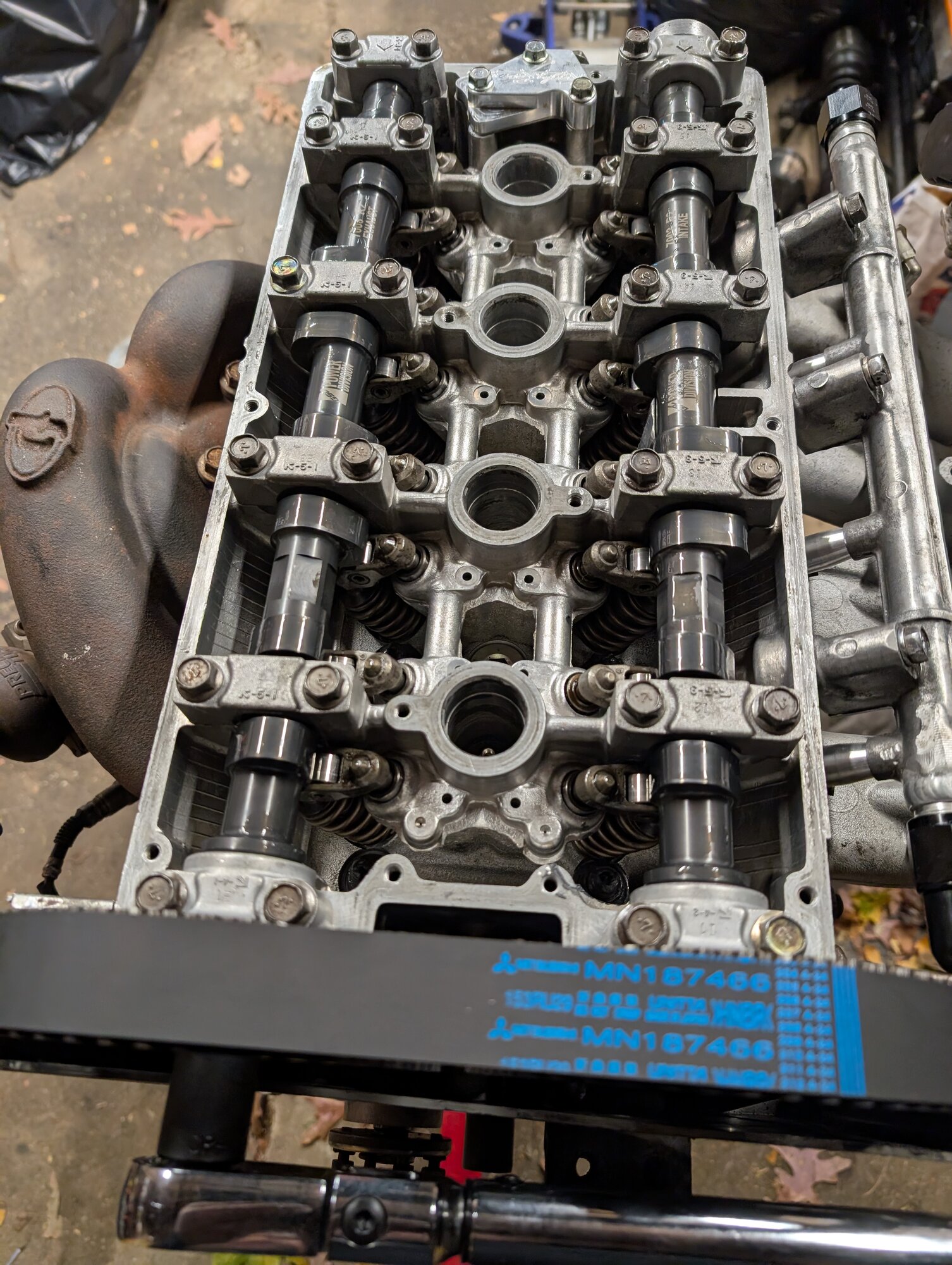

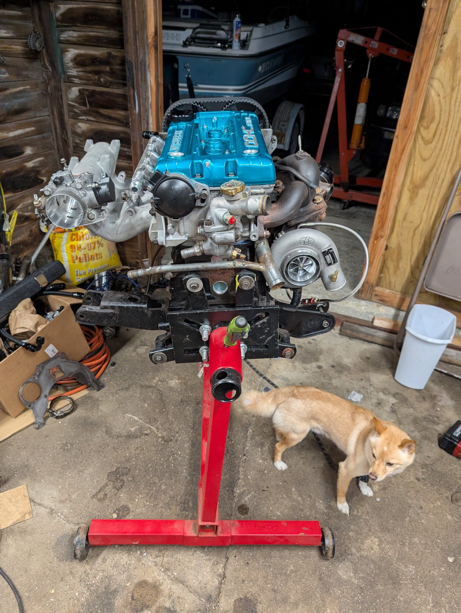

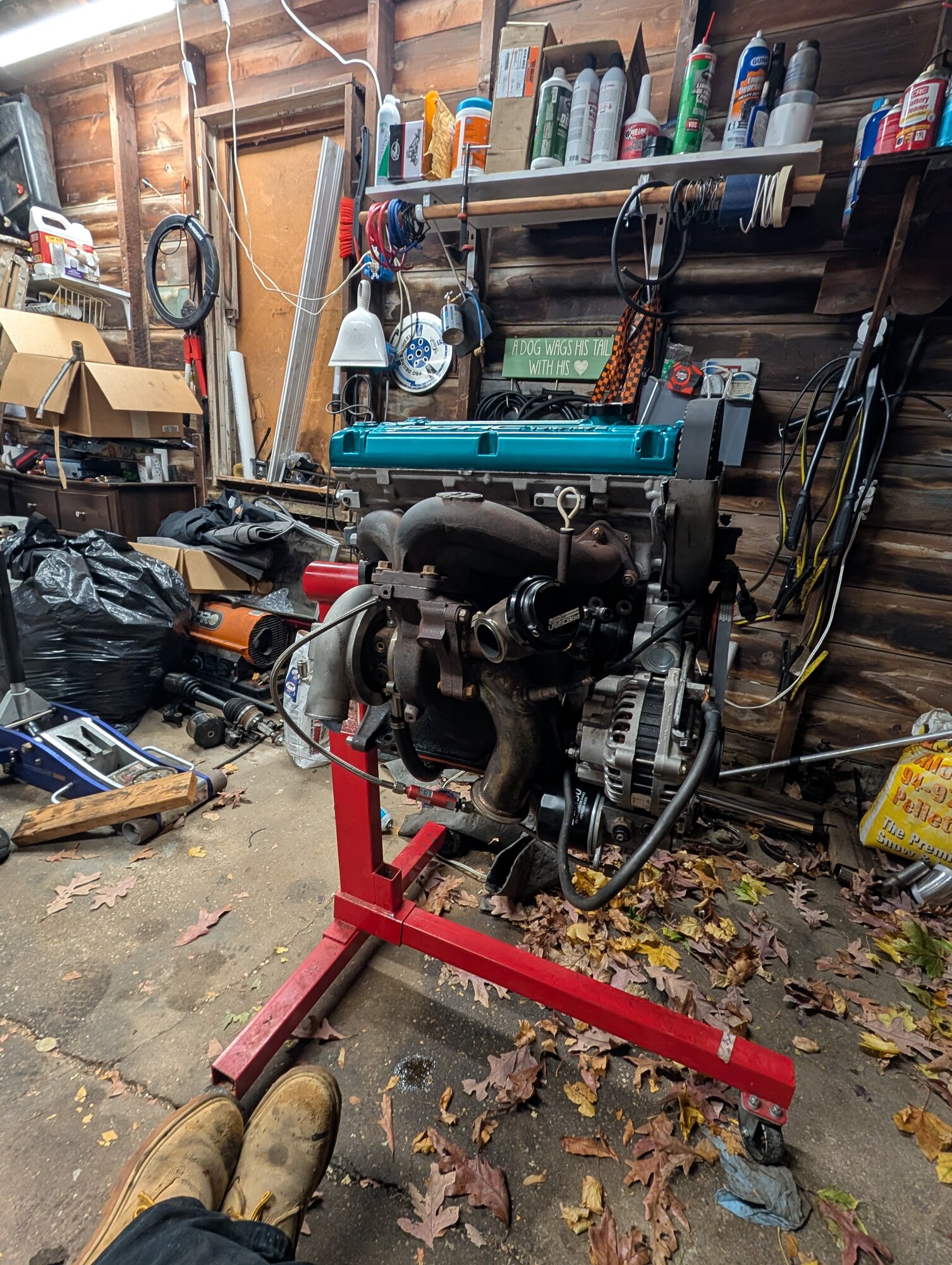

Well i was finally able to get the 2nd motor done. I thought it was a mis clocked rear balance shaft bearing but i ended up being wrong. The bearing was close but not open. I ended up finding a oem 4g64 in nevada. I got the 64 crank in and i found a few differences between the eagle and the oem. I reached out to eagle and they were initially helpful but then stopped responding. I didn't feel like getting caught up on getting a response from them and just chalked it up as a loss and just moved forward with the oem 64 crank with the same block. I went to my machine shop last friday morning to assemble the long block and was able to finish. Than later in the evening i fully dressed it.
Saturday i was able to drop it in and get a few things buttoned up. Sunday i finished but like any new build i forgot a few things and had some leaks. On initial prime i got 40 psi. I had a misfire ended up being a stuck injector from sitting for a few months. After some run time it got unstuck and was fine. I did switch a few things from last time. After a vac test on the head i found a few leaky valves which lead down the path of upgrades LOL.

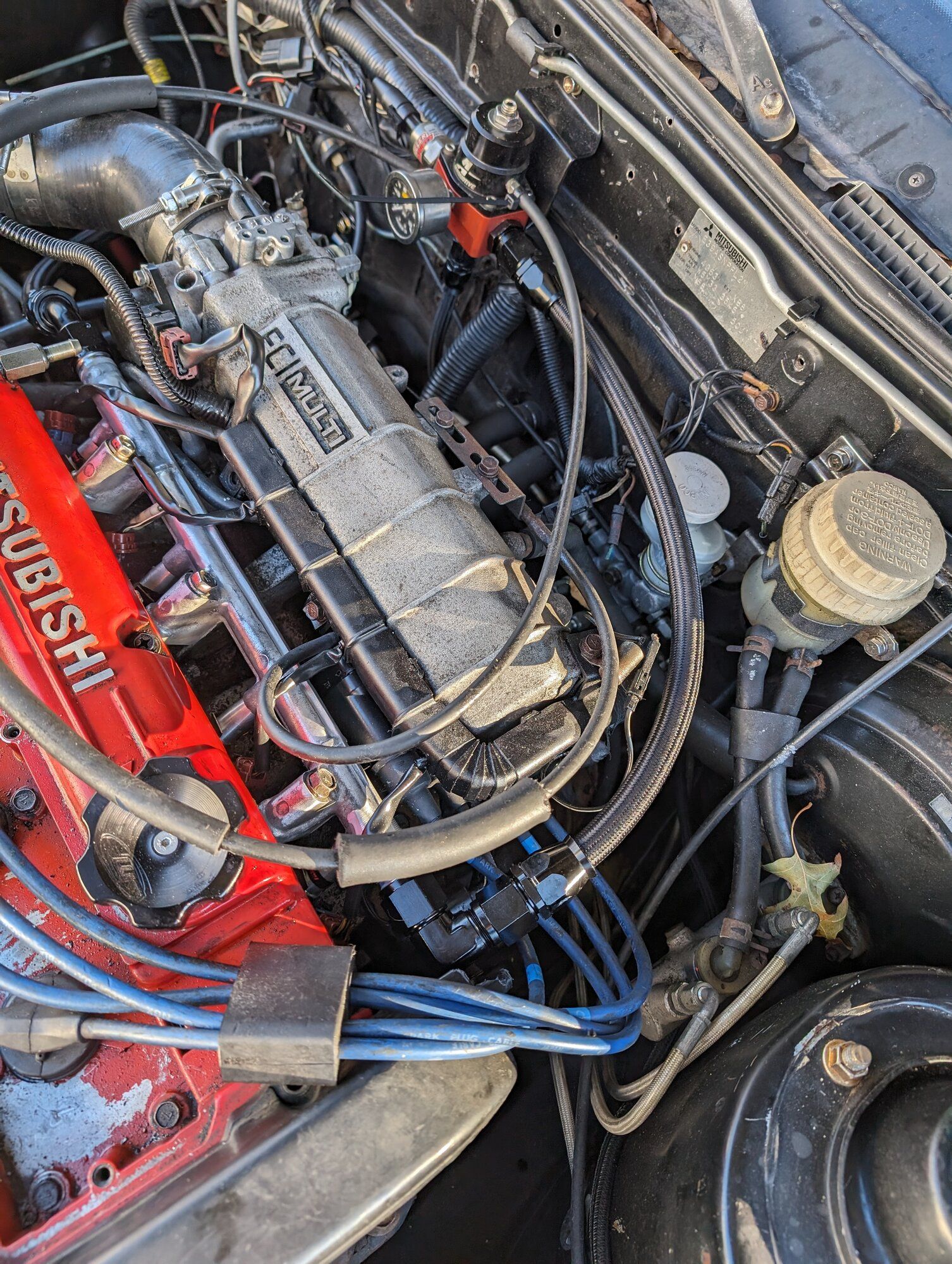

Well it's been a bit since the car has been out and about. I've been fixing little issues here and there. I switched all my vacuum fittings for push lock to clean up the bay and stop dry rotted lines and fittings popping off. I did have a issue finding fittings for my 38mm wastegate but if anyone is in the same boat you need 1/16 npt fittings. I made a bracket to move my coil pack next to the manifold instead of it sitting on the manifold. I started tuning the car around 30 psi but i'm having an issue with my KS picking up false knock. I did find that my driver side axle is not seating on the half shaft without moving. It's been a bit cold so i haven't had the motivation to take all of it apart. Also have a drivetrain noise which i think has to do with the axle not seating. Maybe once it gets a little warmer i can find the issue out. Besides that the car has been great and pulling harder then ever so i'm happy.
