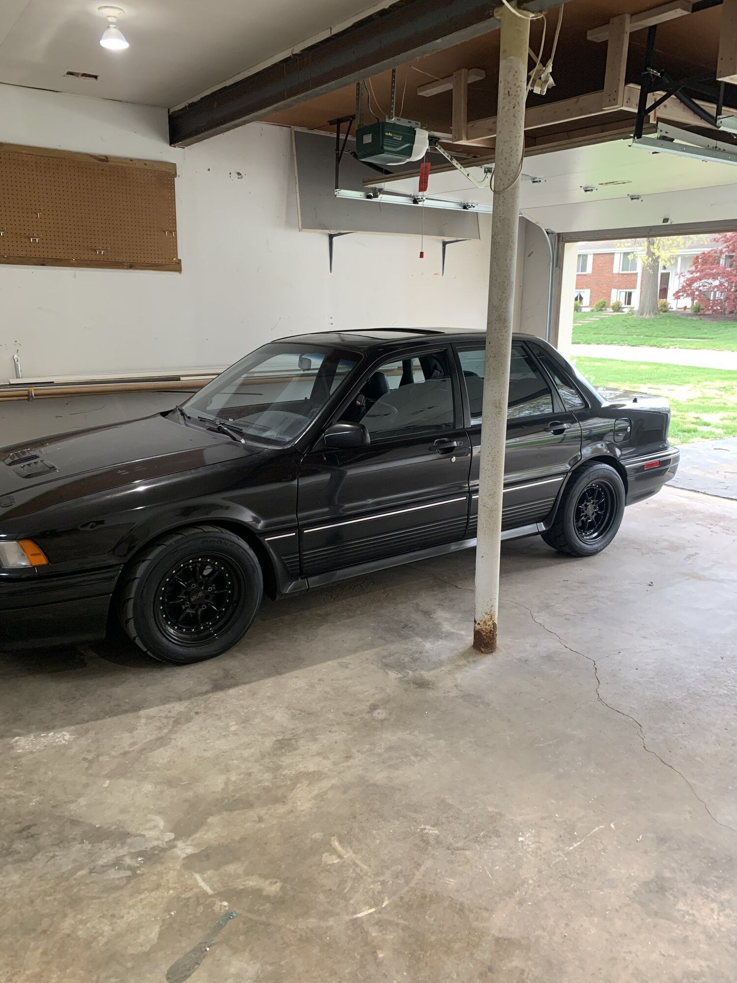

92 Galant
Been out of the DSM scene for over 10 years, but finally got back into it this past October. Purchased a built Galant, and have been stacking parts for further upgrades. Ideally I'd like to make 700 whp on the new setup, while keeping outside appearing "stock". Only thing is the wheel/tire combo are very aggressive so anyone in the "know" will know.

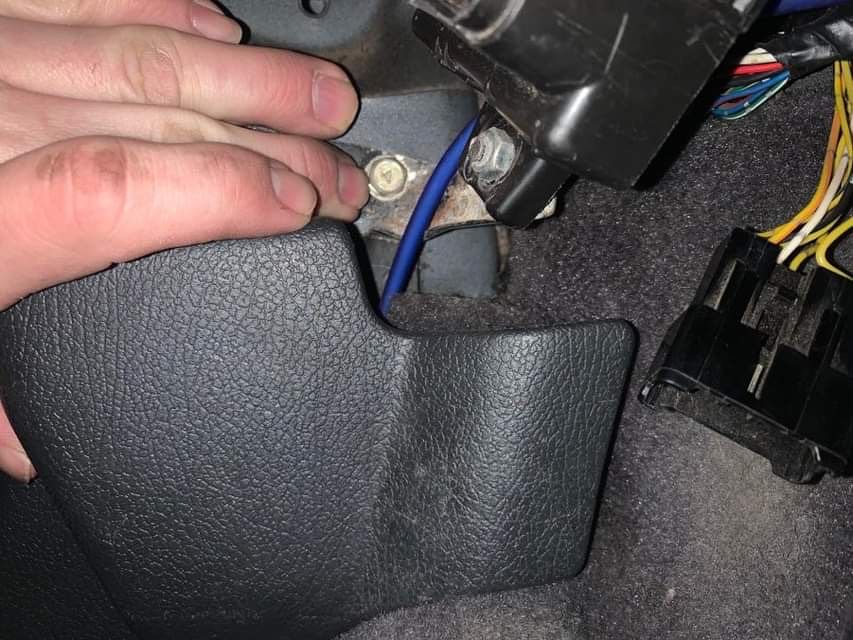

Definitely, will be pretty silent over the coming weeks as I try and hunt down this ECMLink issue, but should see some big updates coming late April/early May.
Just need someone to walk me through using the voltmeter to test things, and I'll be smooth sailing.
I've done some digging and looked up a few tutorials online, also have someone local coming to help me out. But does anyone viewing want to answer this from my OP?

Quoting myself and I think I found a video explaining it/showing it.
Someone correct me if I'm wrong:
1. To check for ground on pin 12, set the meter to OHMS, black lead to ground, red lead to pin 12. I should expect a 0.0 reading and get a beep if I turn sound on.
2. To check that pins 1 and 2 on ECU have connection to pins 1 and 10 on OBD 1 port, set meter to OHMS, place one clamp on pin 1 OBD and other on pin 1 of ECU, I should hear a beep if I selected the correct setting.
3. To check pins 1 and 10 against grounding, would I just make sure that it doesn't beep?
4. To check pin 10 is getting 4.5v, change mulitmeter setting to volts, black on ground, red attached to pin 10, and I should see 4.5v - https://www.ecmtuning.com/wiki/connectionproblem

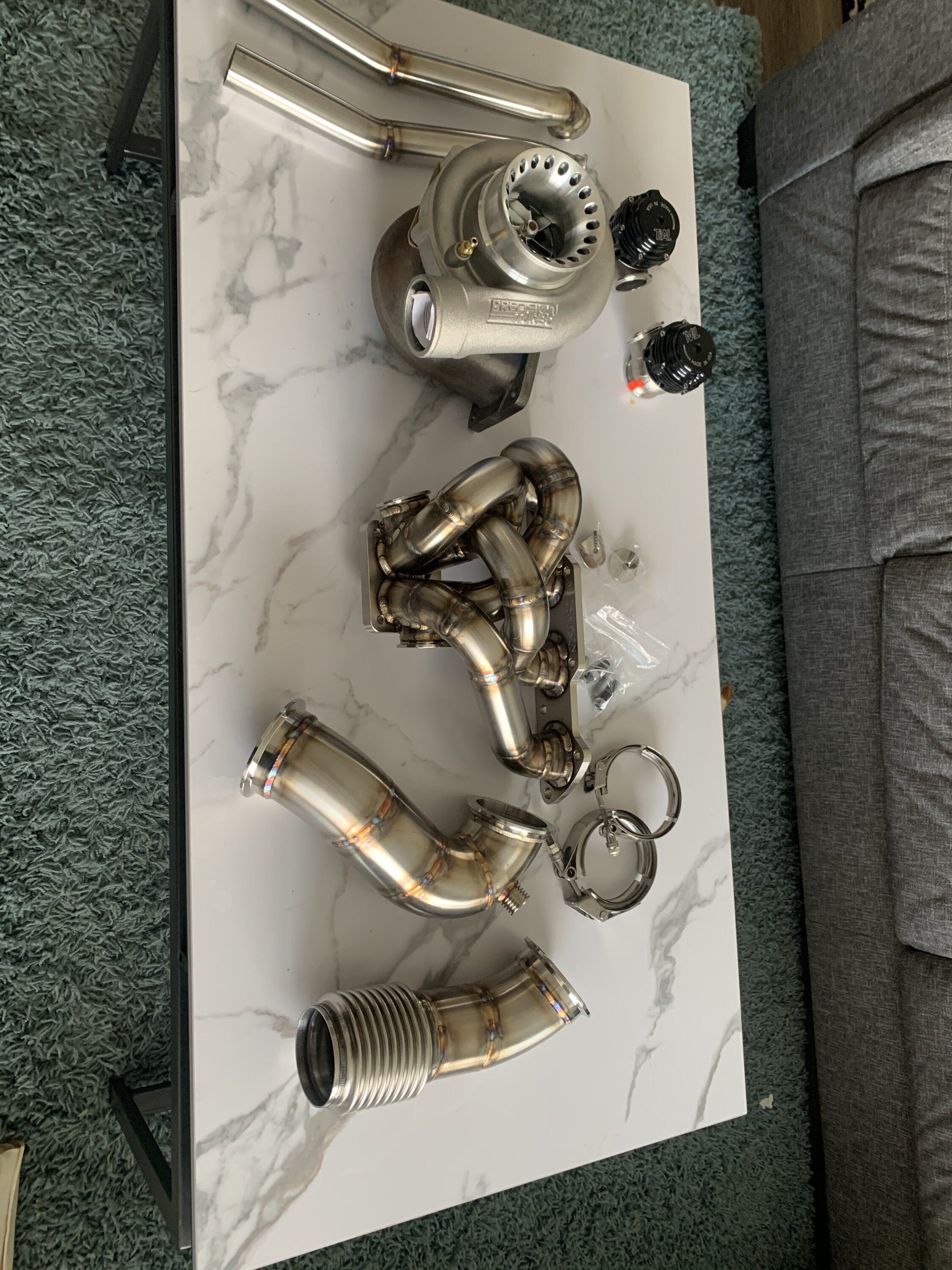

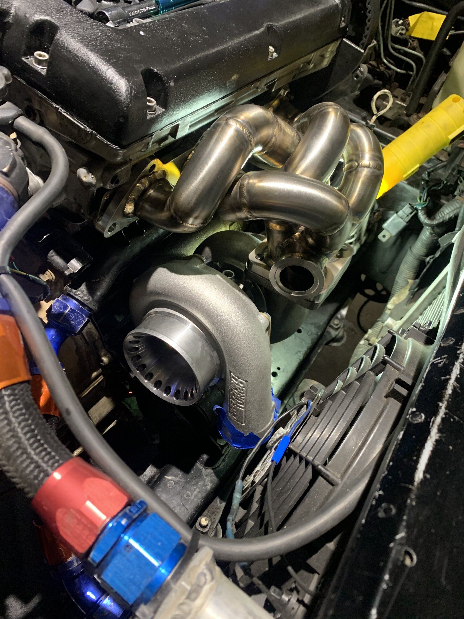

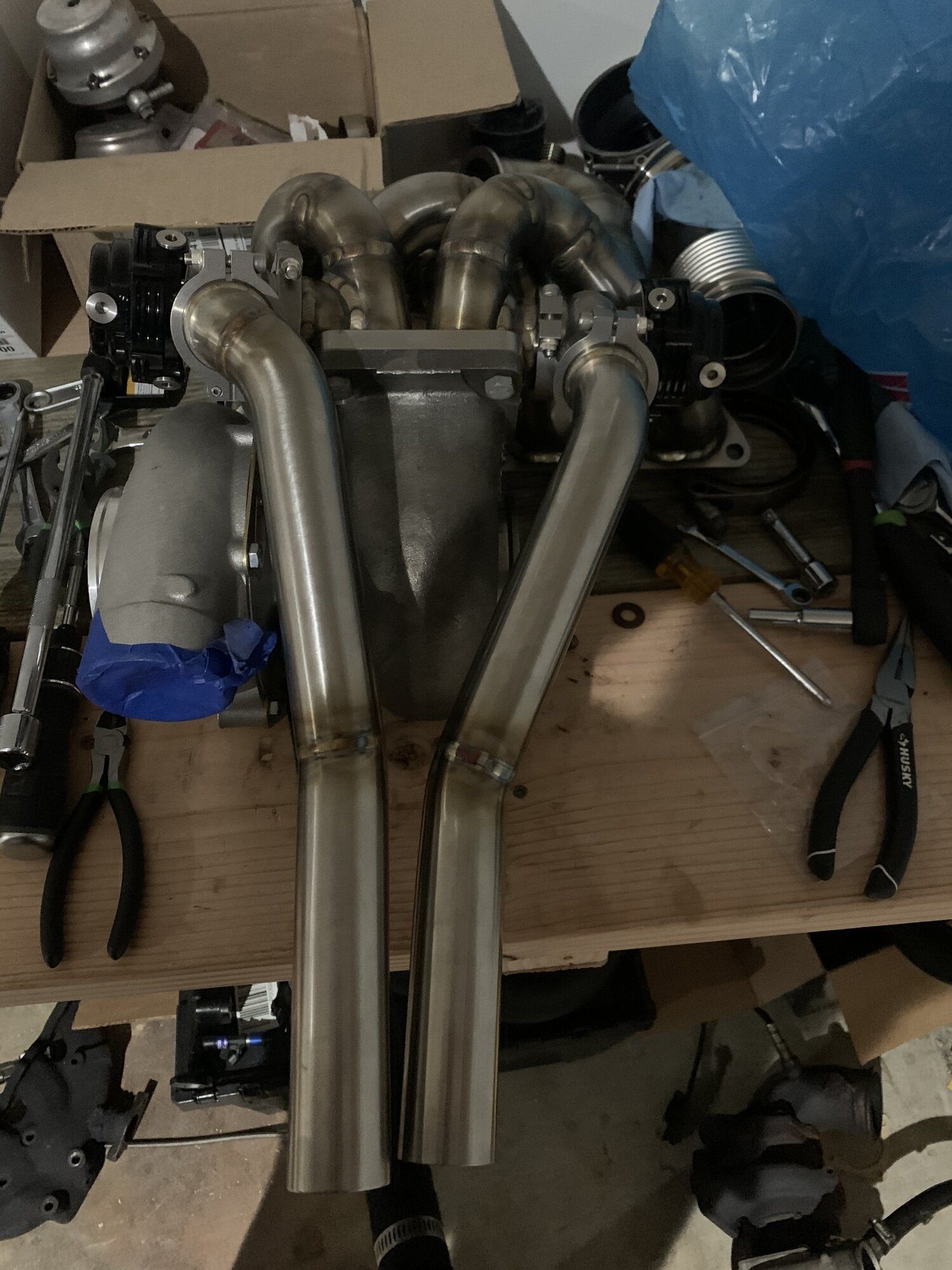

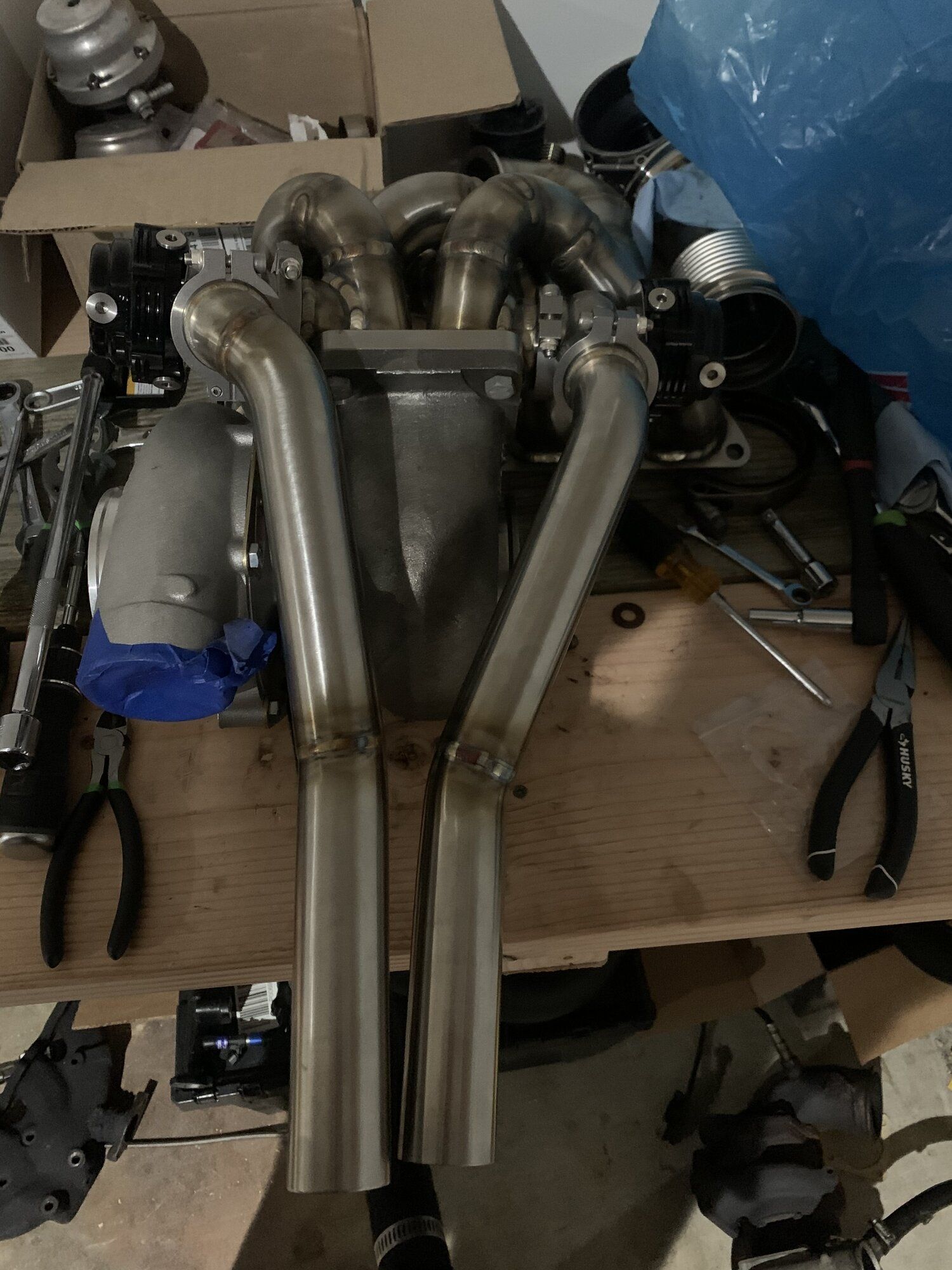

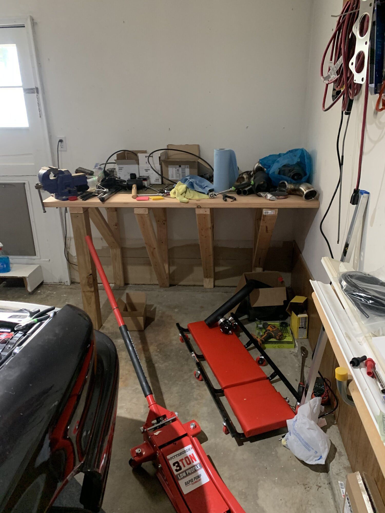

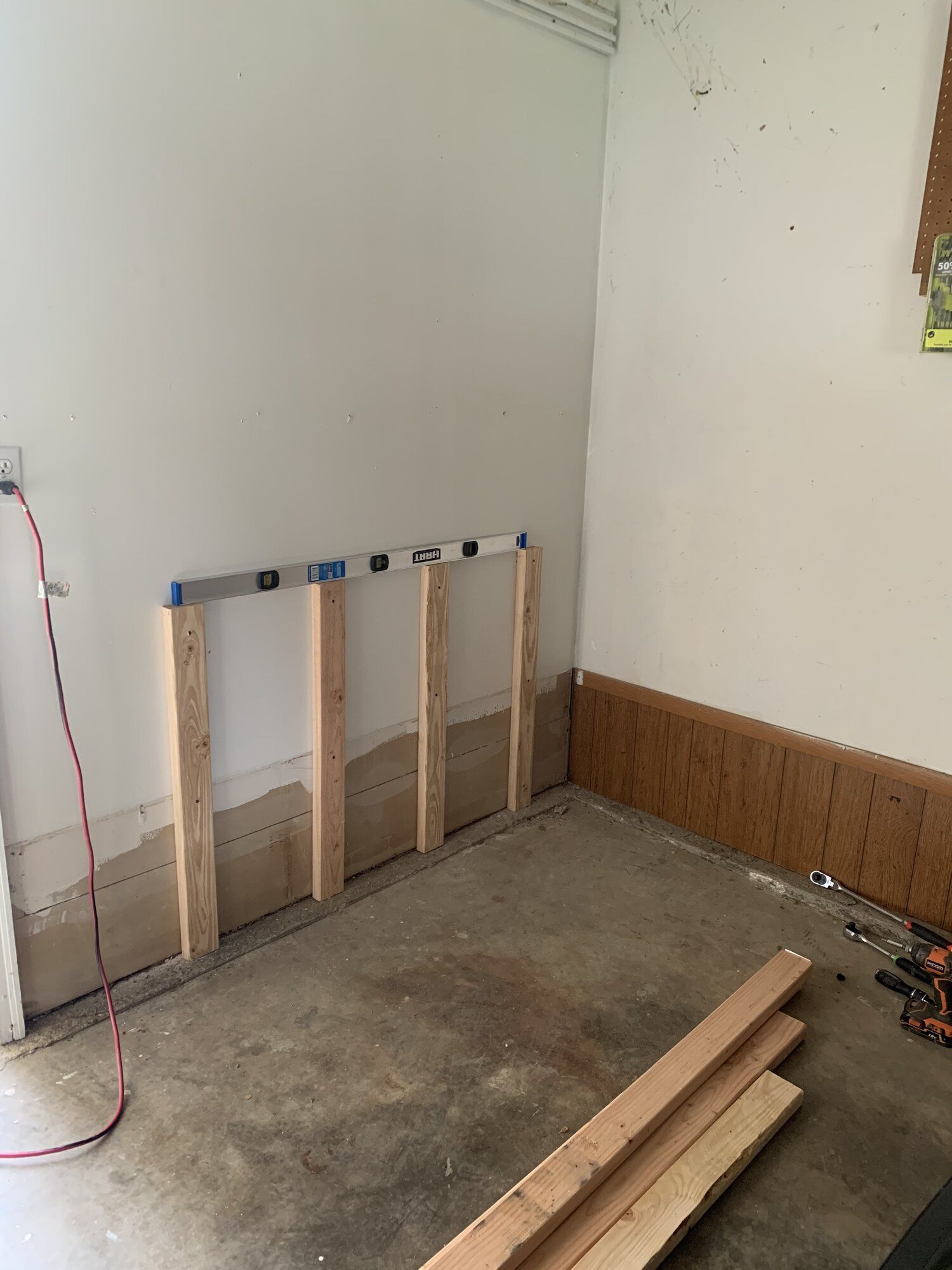

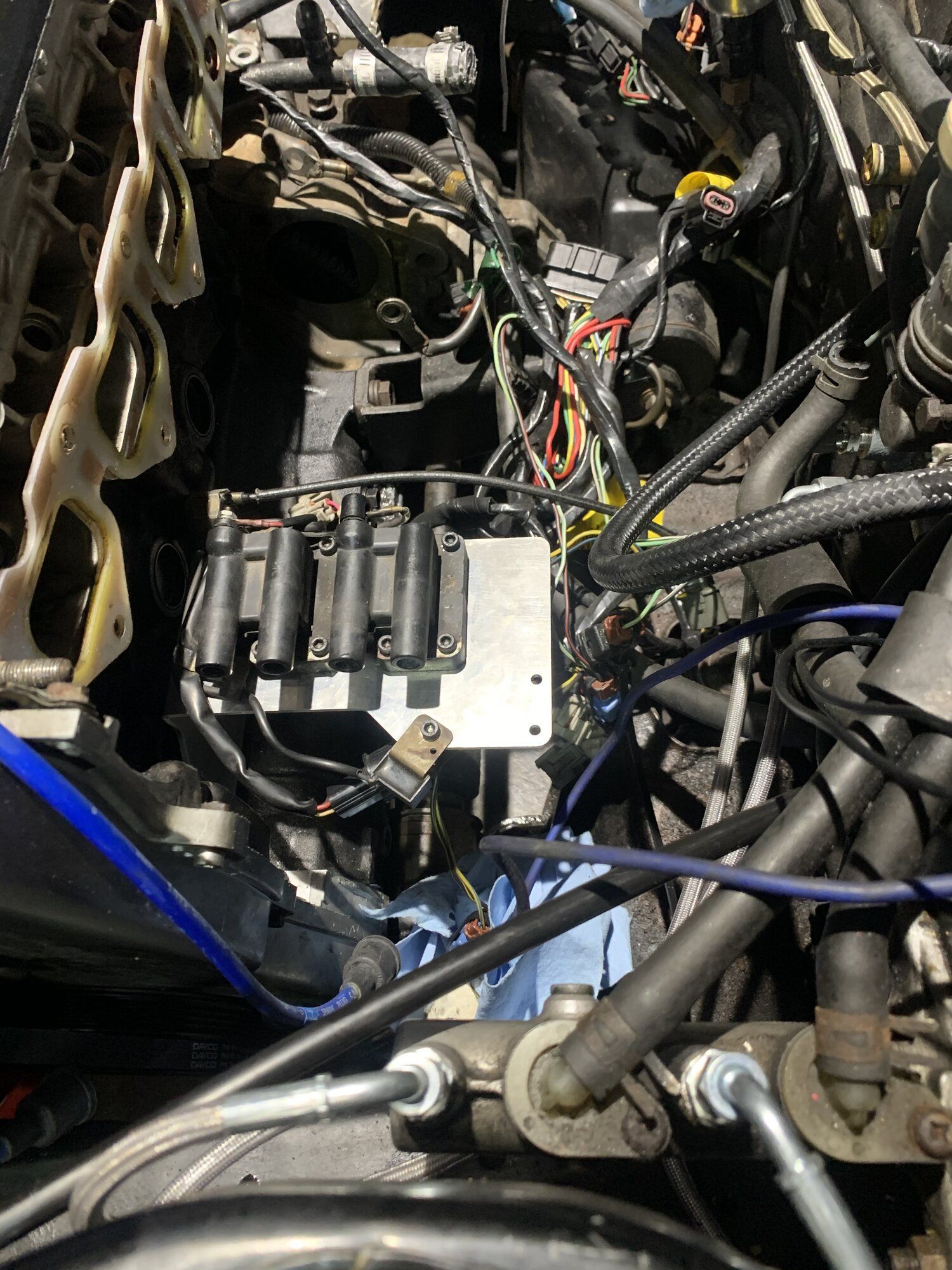

Well, got 99% moved in and started tearing into the car; but first I needed to build some type of work bench because there is no way I'm doing all of this on the ground. Will likely be building another one on the opposite side of the garage that's about a foot longer so I have over double the work space.

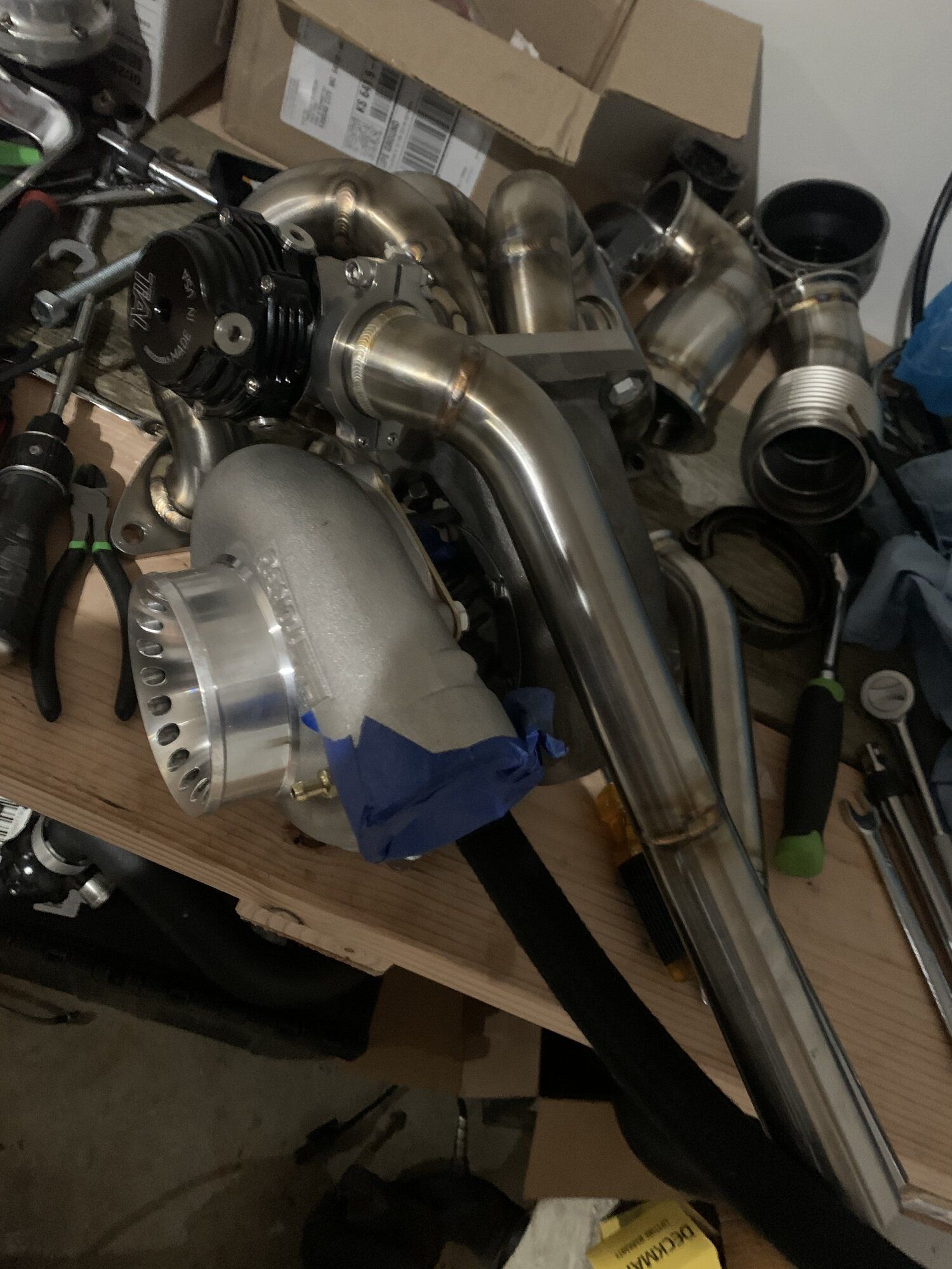

Next I started tearing into it; removed the tb intercooler piping, current turbo setup. Battled the usual difficult bolts, rusted and old... PB blaster saved me on a few. I'll need to heli-coil a couple of the exhaust studs as I somehow managed to mess up one with this turbo install, and one was already messed up as is. Got the turbo and manifold on for test fitting, one thing I noticed was the oil drain and the front motor mount is going to be an issue, looks like I'll be ordering the boosted fab front motor mount. https://www.boostedfabrication.com/collections/galant-vr4/products/galant-vr4-344-mount
While the car is down this time, new turbo setup, new 3" exhaust, new 2.5" IC piping (powder coated wrinkle black) rebuilt tb, changing from AEM UEGO to ECB-1 wideband kit, put the DSS driveshaft in, replace all brake lines with stainless, and upgrade the stock feed and fuel return to 6AN feed/8an return, front motor mount... anddddd taking some degreaser and cleaning the engine bay.
Assembled one of the wastegates tonight and put the 1.7 bar (~24 psi) combo of springs in, black, blue, yellow. Removed the fuel rail, intake mani, jmf coil pack bracket in preparation of running 8 an feed/6an return and swapping over to non-ABS setup, will be using a 3an brake line size from JNZ tuning when they have it finalized for the vr4.

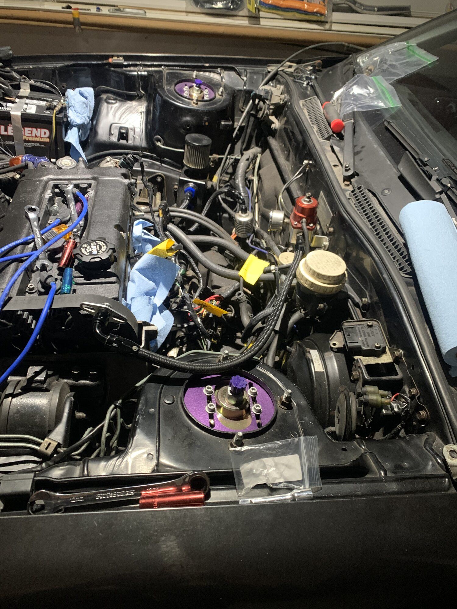

Didn't get as much done as I wanted to, house stuff and other life items came up.

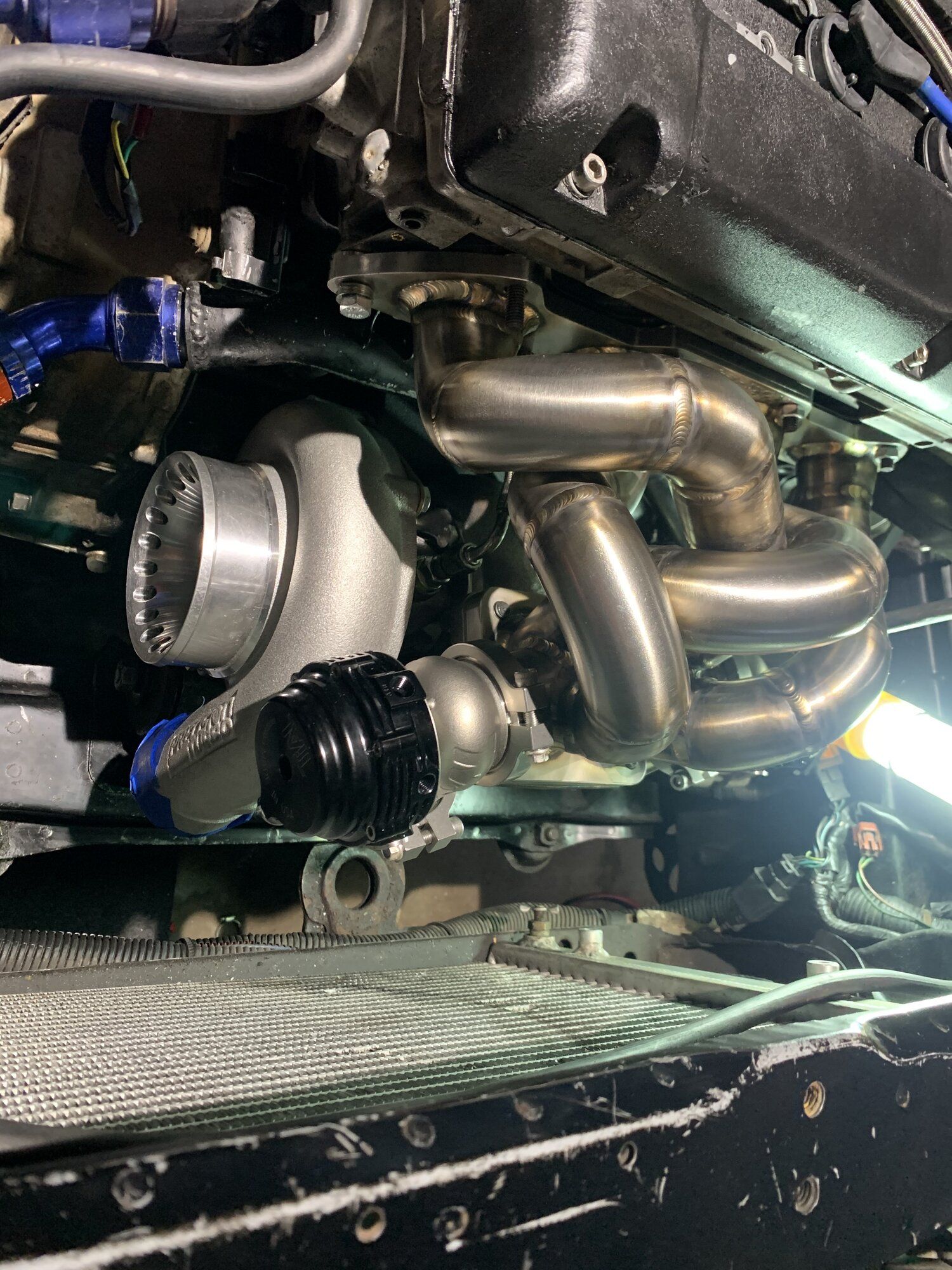

-Partially installed my Hallman MBC cockpit add on, thankfully I have two of those boost controllers because I lost one of the barbs/fittings so I'll just take it from the other.
-Assembled the other wastegate and put it on the setup for viewing pleasure, I will need to rotate the compressor housing and placement of the dump tubes when in the car, but for now it looks pretty.

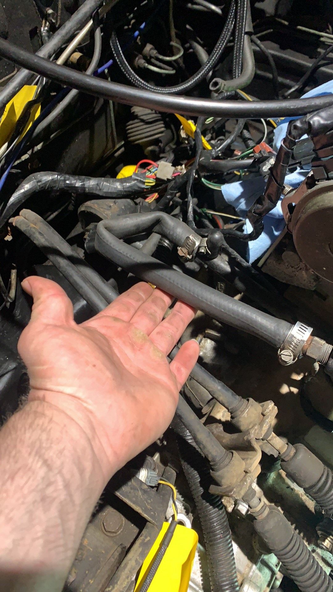

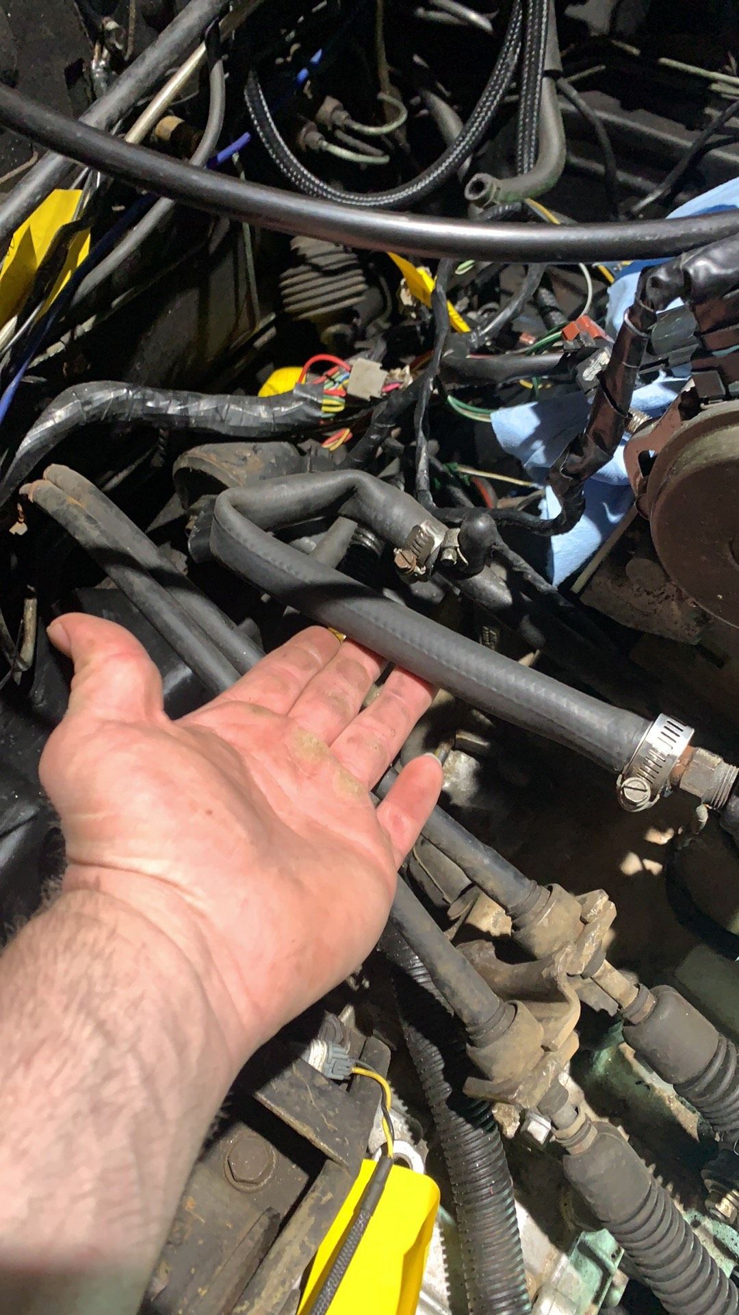

- Removed the coolant lines flowing to the firewall. I wont ever need heat in the car as I don't drive it when it's that cold, if I do, they make jackets. I looped the lines within in each other.. BUTTT it looks terrible, so I may have someone weld them closed and remove the rubber hose all along.
-Sold my old 6262 setup

Can you, please, add some arrows to you photos

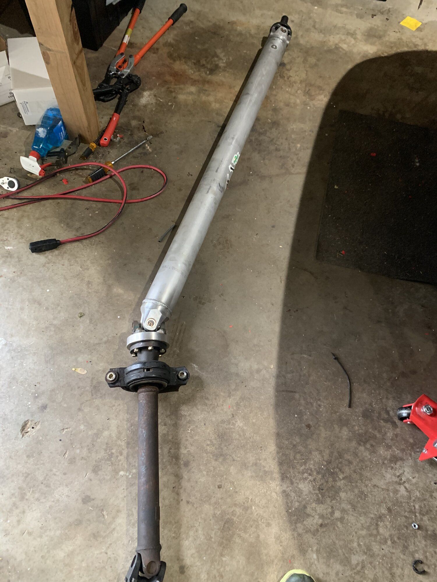

Not much to update, didn't touch the car and won't until I get some other parts in. ABS delete kit from JNZ is supposed to be here soon. Boosted Fab front motor mount looks like it's showing up on Saturday.

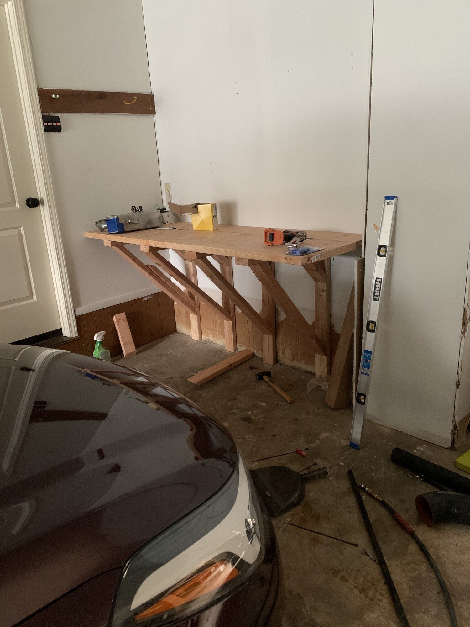

Started on a second work bench to give myself over double the work space.
Got the following done on Friday evening/Saturday
- Second work bench done
- Removed the ABS unit and all the front lines - except the ones in the wheel well, haven't taken those off just yet. The stainless line/non- abs prop valve shows up tomorrow from Fedex. Damn ABS unit itself weighs 19 lbs!

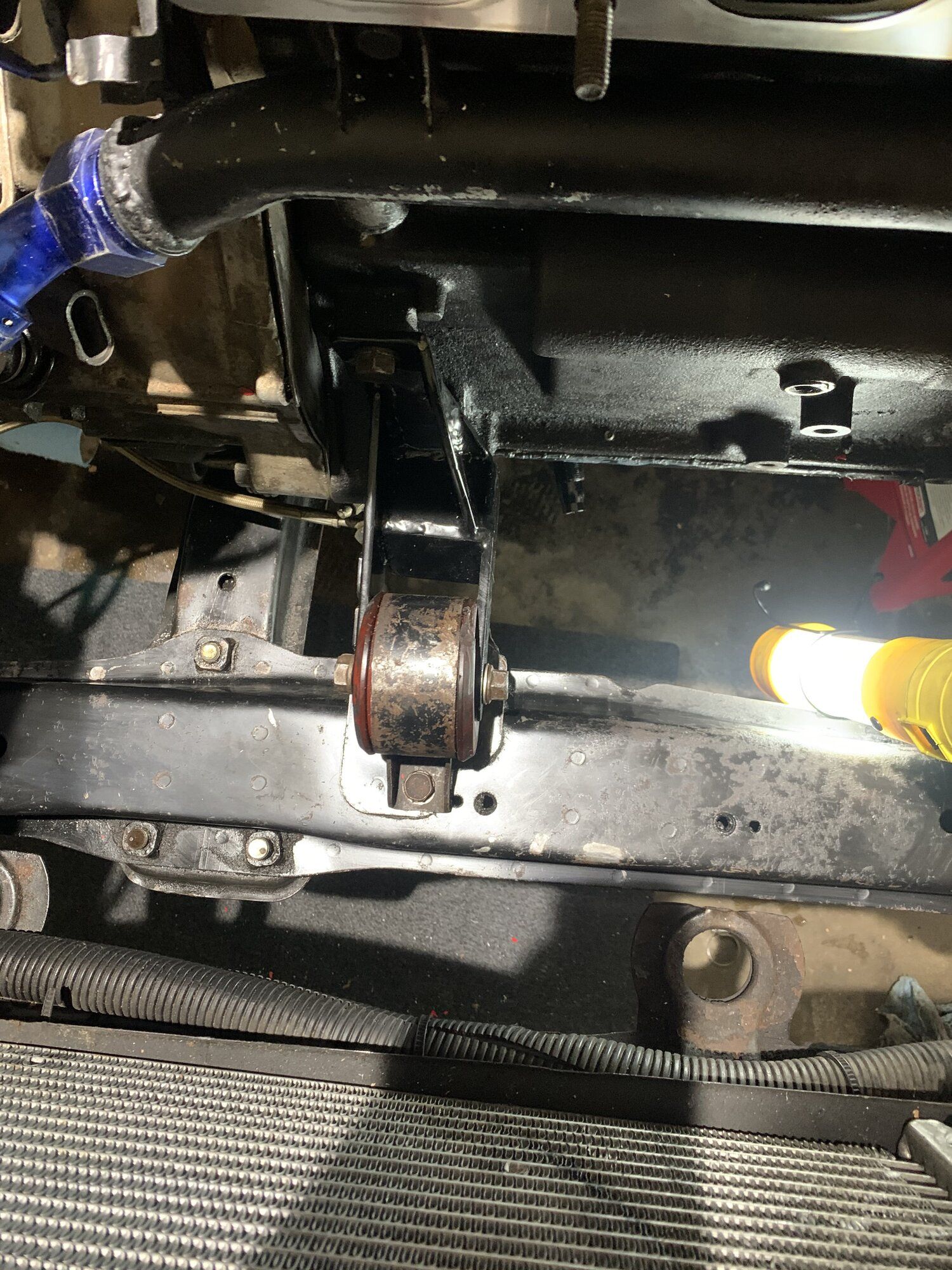

- Boosted Fab front motor mount - had to buy this one due to oil drain/compressor housing clearance - I need to run to Ace Hardware and get a new M12 x 1.25 bolt for one of the two bolts that hold the motor mount to the block; the head is kind of beat up and don't want to deal with a stripped head when trying to torque this thing down or remove it again.
-Moving my fan to opposite side of the radiator - puller to a pusher - gives me a lot more clearance/space in the engine bay.

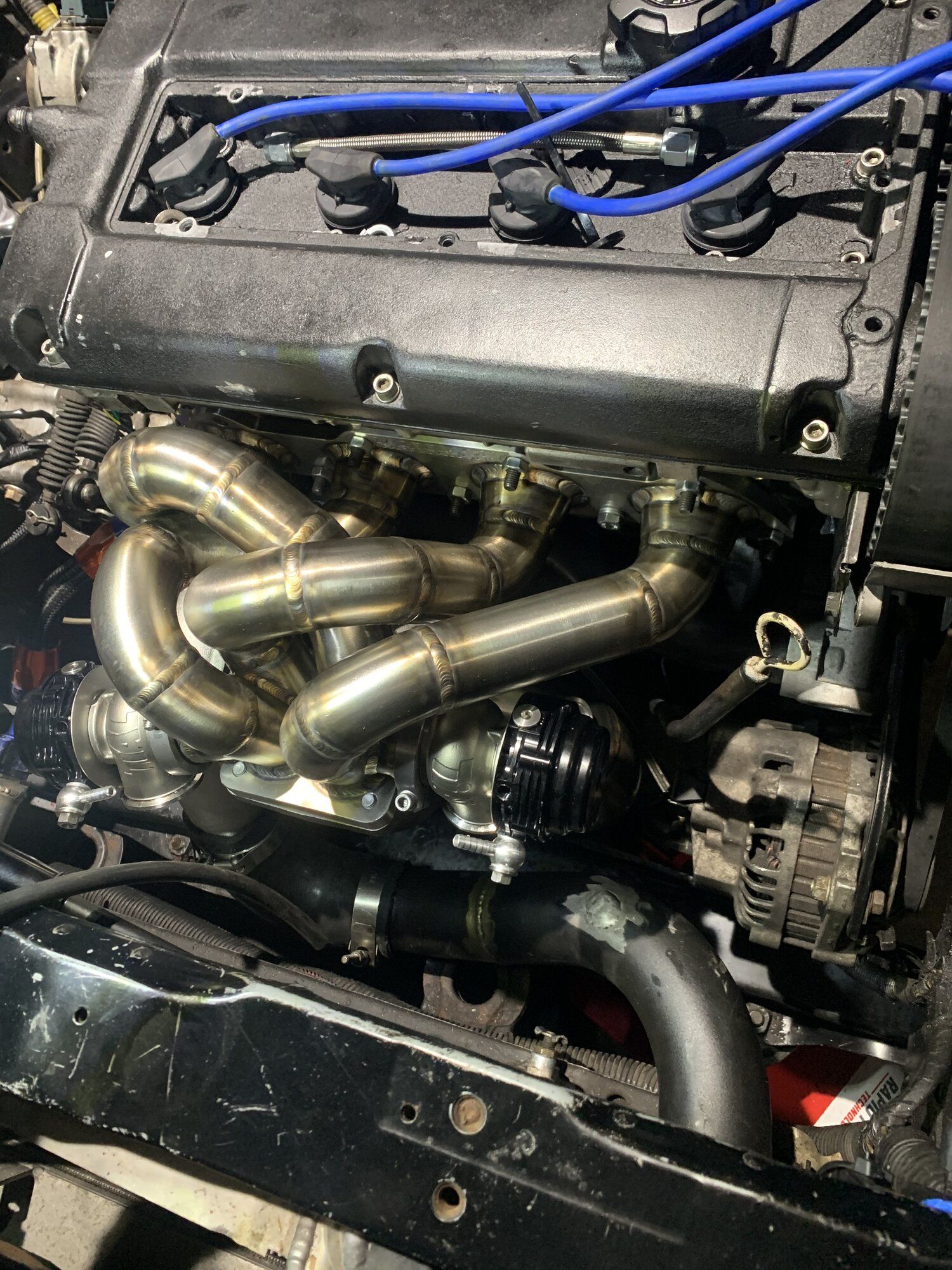

-Mounted up the turbo setup with the dump tubes and downpipe attached - pulled back off car to tighten up v-band clamps and will do a final check when installed on vehicle.
- Took some engine degreaser to this frame and will continue to clean up the years of oil/grunk/debris that's accumulated in the engine bay.

Wanting to replace the colored 16an radiator hose and fittings with black line and fittings, as well as do the fuel system. Decisions, decisions...
As for the fuel system, has anyone used the Vibrant lines with success? https://stmtuned.com/products/vibrant-nylon-braided-flex-hose-black

You will really like the Vibrant line. It will make you say "why did I ever fool with that stainless stuff" after you get to work with it.

Got a decent amount done.
-Driveshaft and t-case out to swap over to a DSS aluminum drive shaft.
-JMF ignition bracket installed as well.
-Hallman cockpit MBC add on - now I can adjust boost from my drivers seat.
-Turbo setup on the car, oil feed and drain on... when I was tightening down the manifold the LAST EXHAUST STUD decided to come out... do I need to take everything off and helicoil that one, or is the exhaust manifold going to be secure with 7/8 on tight? It's the far left, upper row when looking at the car.
Also decided to wait until next winter to take the car down for fuel lines and SS rear brake lines, I'd rather enjoy it this summer/fall; only reason it's down is because I wanted more power. I'm finding guys making 600 whp+ with stock fuel lines, I have the pump for it.
This coming week I hope to.. bleed the brakes, install the driveshaft and t-case again (changing t-case fluid while it's out), install new starter, wire in the ecb-1 items and remove the old wiring fore aem uego, hopefully reinstall the intake manifold, cleaned injectors, and rebuilt throttle body by TMZ.
The instructions for the ECB-1 say to put the sensor 24" from the turbo, but the bung that came from Morrison fab is more like 6" from the turbo. Is the only reason they advise putting it so far away from the turbo to increase life of the sensor, i'm really only concerned with reading correct AFR.
