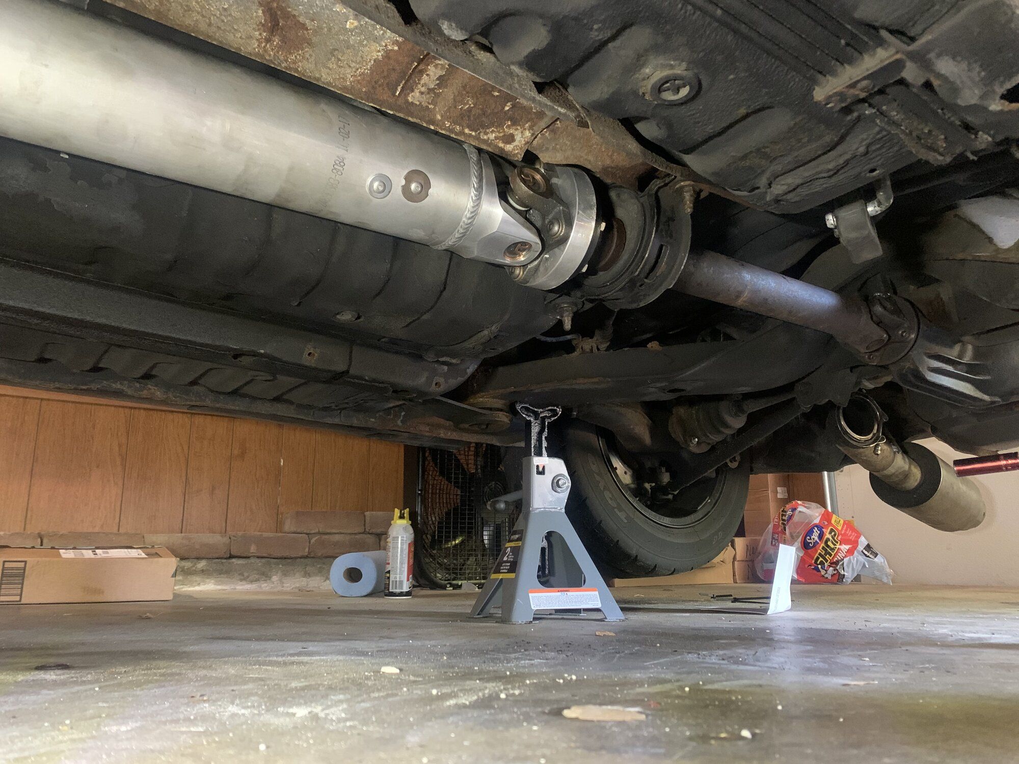

-Got the driveshaft installed, but now I'm leaking out of the output seal, you can see a little droplet in the photo. I ordered two input seals, two output seals, and a couple other seals from Extremepsi. Oddly enough, swapping out this driveshaft was the most straight forward thing I've ever done on any of the DSM's I've had, everything lined up perfectly and bolted right in. Put in all new hardware as well, really dislike the idea of using 30+ year old nuts and bolts.

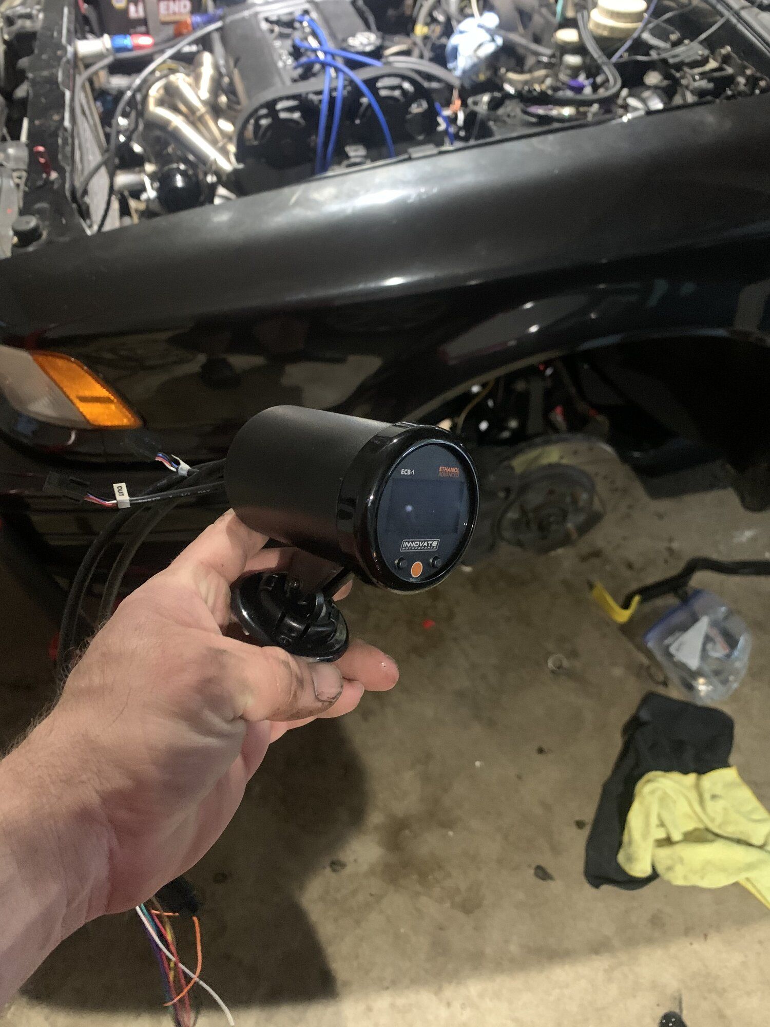

- Ordered a $10 gauge pod off Amazon, had to drill out the back of it to fit all the wires for the ECB-1 kit. Going to mount this on the steering column with some tape and see if it holds, I'd rather NOT drill into it with some little self tapping screws, but will if I have to.

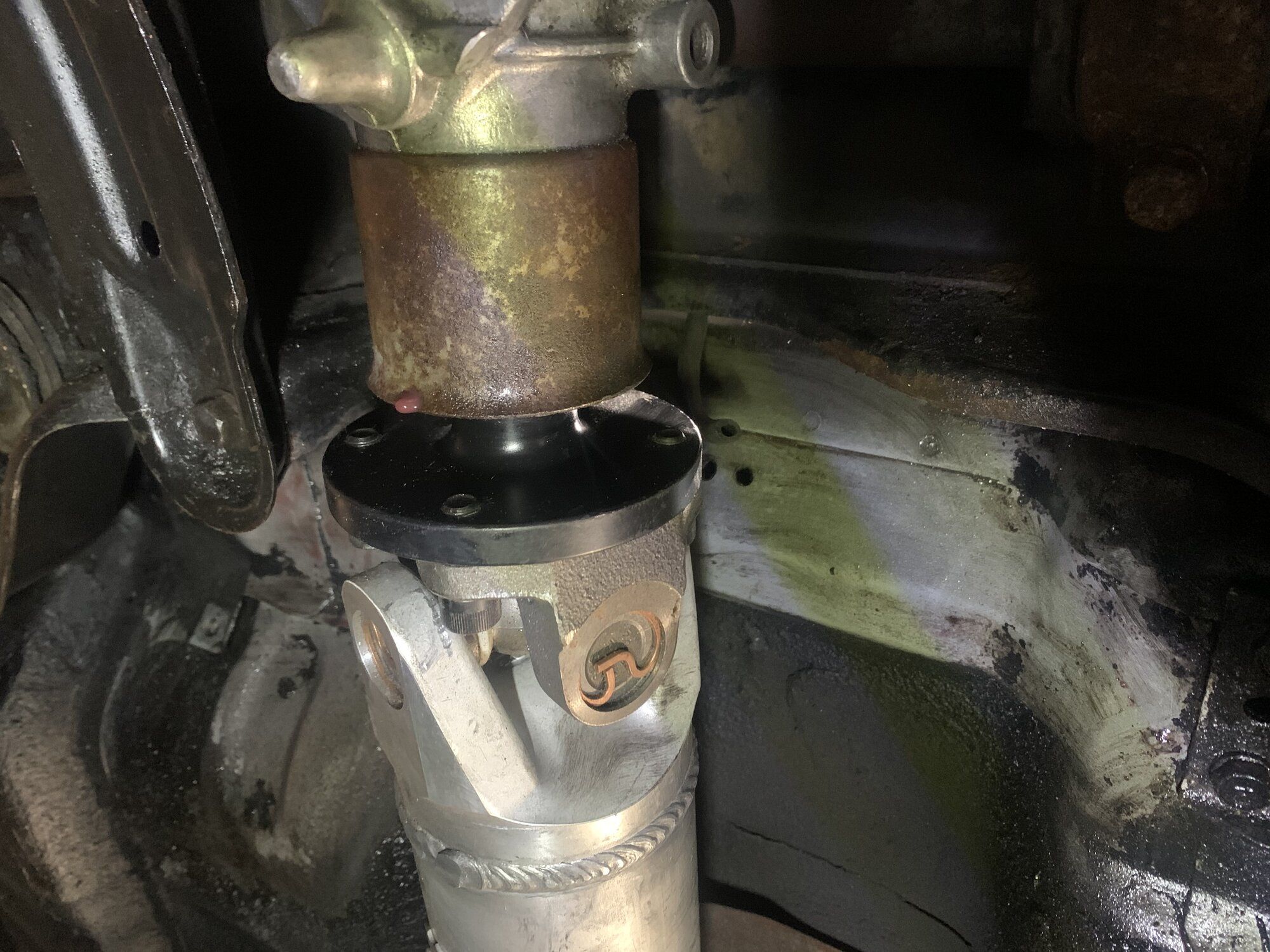

That's interesting...Looks like DSS changed their design.
The slip yoke on the T-case side used to be a single machined piece. Now it looks like they use that adapter thing. Not sure how I feel about that.
Is the front adapter machined on the U-joint side to be properly centered/located on the U-joint, or are the mounting surfaces flat when the adapter and U-joint are mated together?
I bought the driveshaft directly off another persons drag Galant and was glad they had the upgraded yoke flange with it.
Ah, I see. What's the measured diameter of the driveshaft you have?

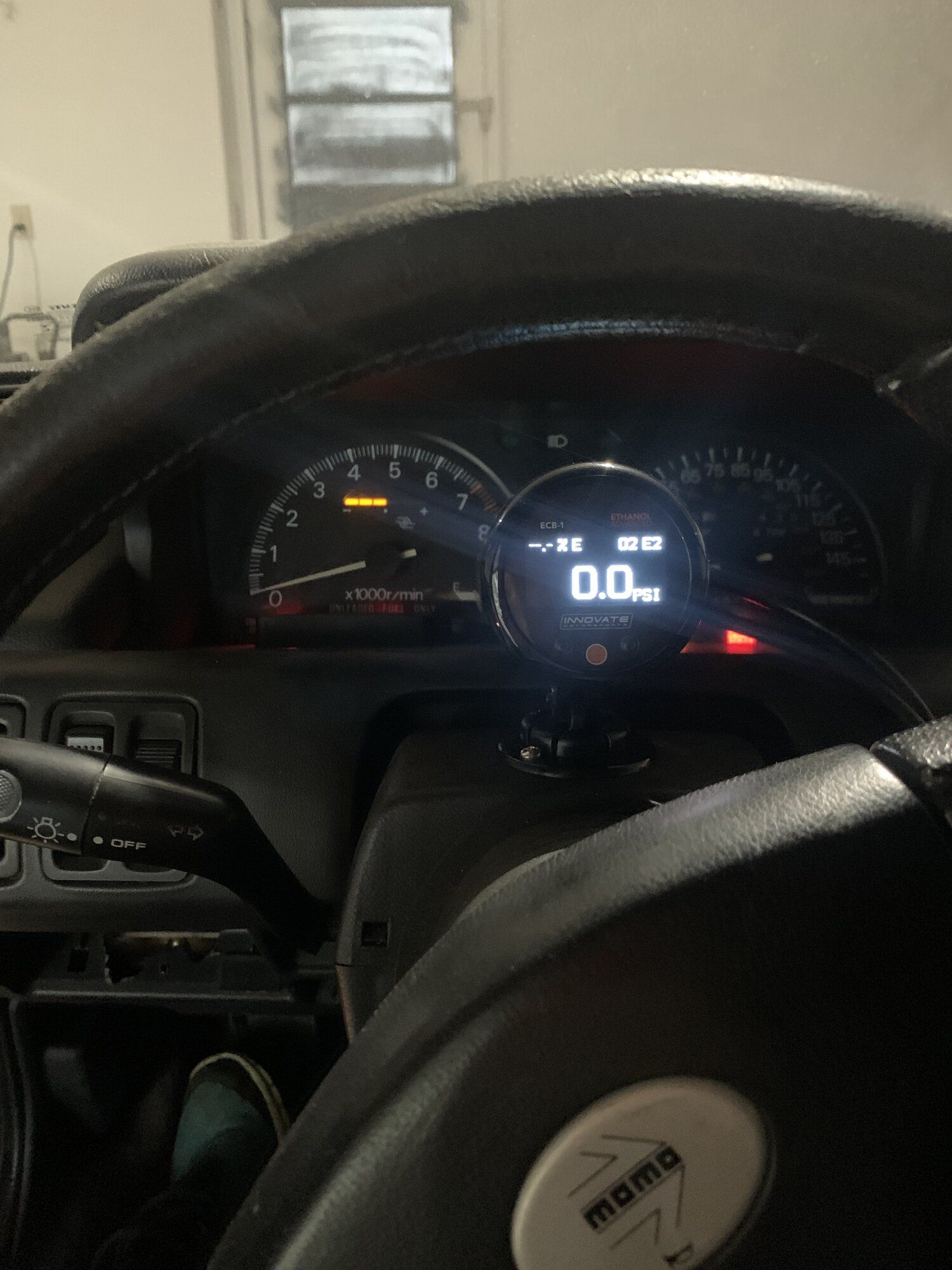

-Installed the ECB-1 gauge and wired it in. I won't be using the exhaust gas temp function so that wire will be taped off; additionally I won't be wiring this to a dimmer so I've left that loose too. 14 gauge to 7.5 amp fuse to 14 gauge > soldered to 16 gauge wire run through firewall > soldered to 14 gauge relay - I don't like the 16 > 14 > 16 BUT, the only thing on this circuit is this gauge and even a 16 gauge wire will be able to handle this simple gauge. Ground from battery through firewall that is then soldered in with the ground from the relay and ground from gauge. The wideband wire from gauge soldered directly to front 02 pin wire on ECU. 12v power source came from the blue wire leading to cig lighter.

- Flip key to ACC and see if ecb-1 kicks on

Well, hooked the battery up and just flipped the key to ACC - we has power. Gauge looks awesome here IMO and will be easy to monitor AFR/Boost during a pull.

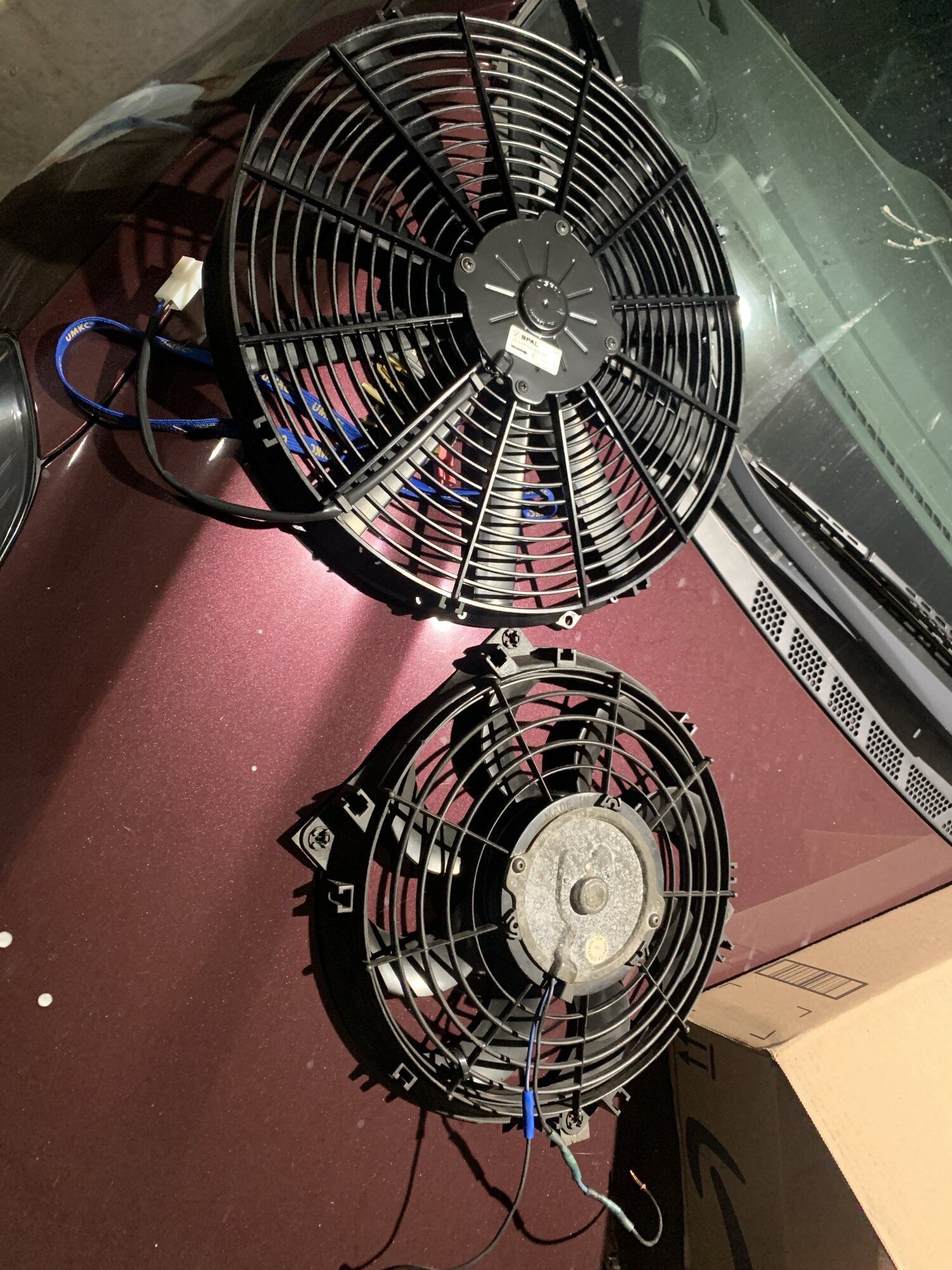

Also elected to upgrade the fan to a 16" slim fan - pusher.
