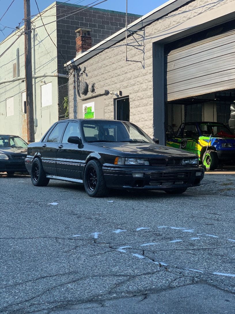

Had the Galant tinted yesterday. 25% all the way around and 35% on the windshield.

Decided to tint the Galant, so glad I did, love how it looks. Won't look too bad either after I have the trunk/roof wrapped to mask the messed up clear coat, and give the rest of the body a good waxing/paint correction. Thrilling to think about this cruising down the highway at night with the open downpipe LOL.
