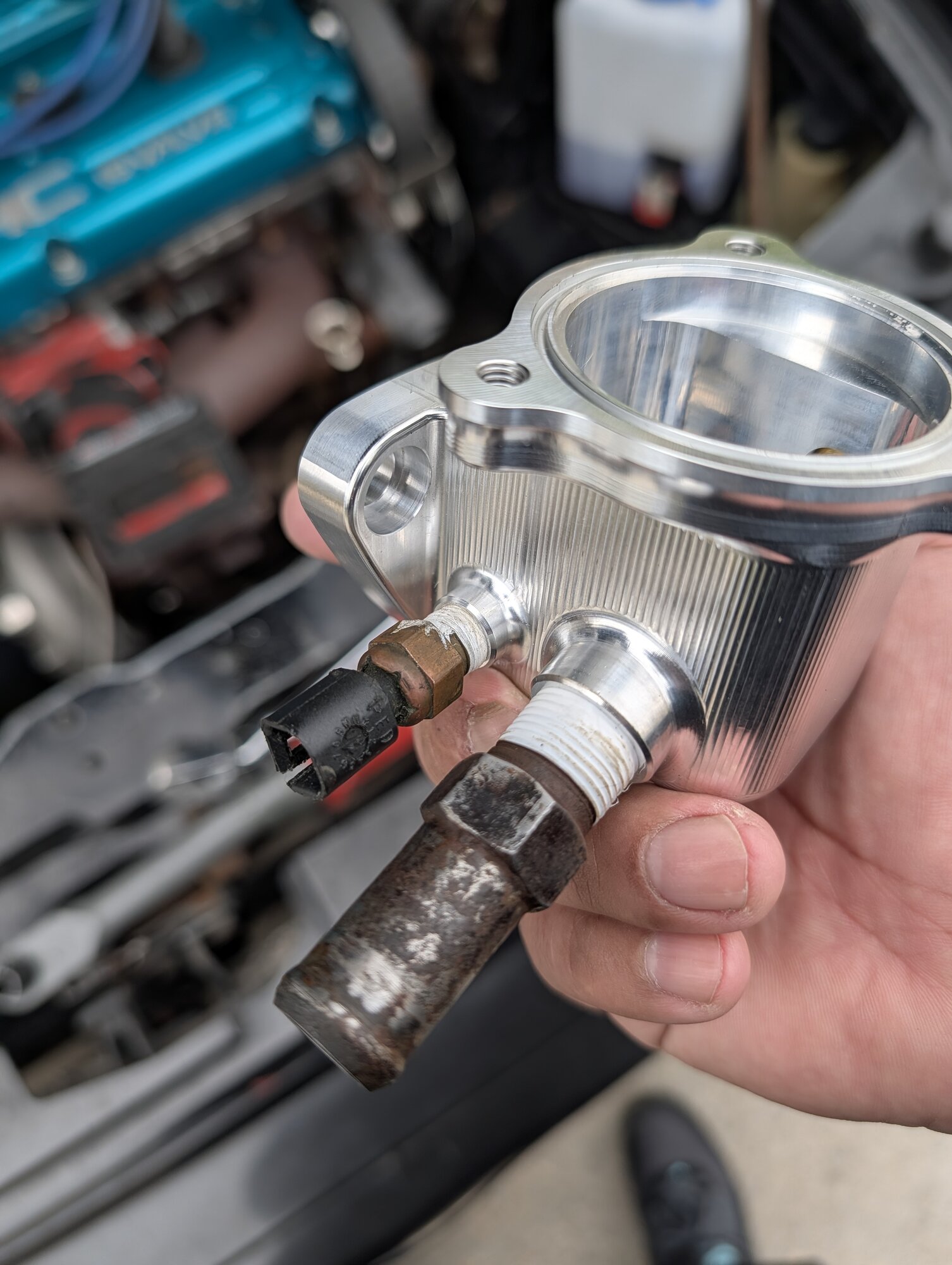

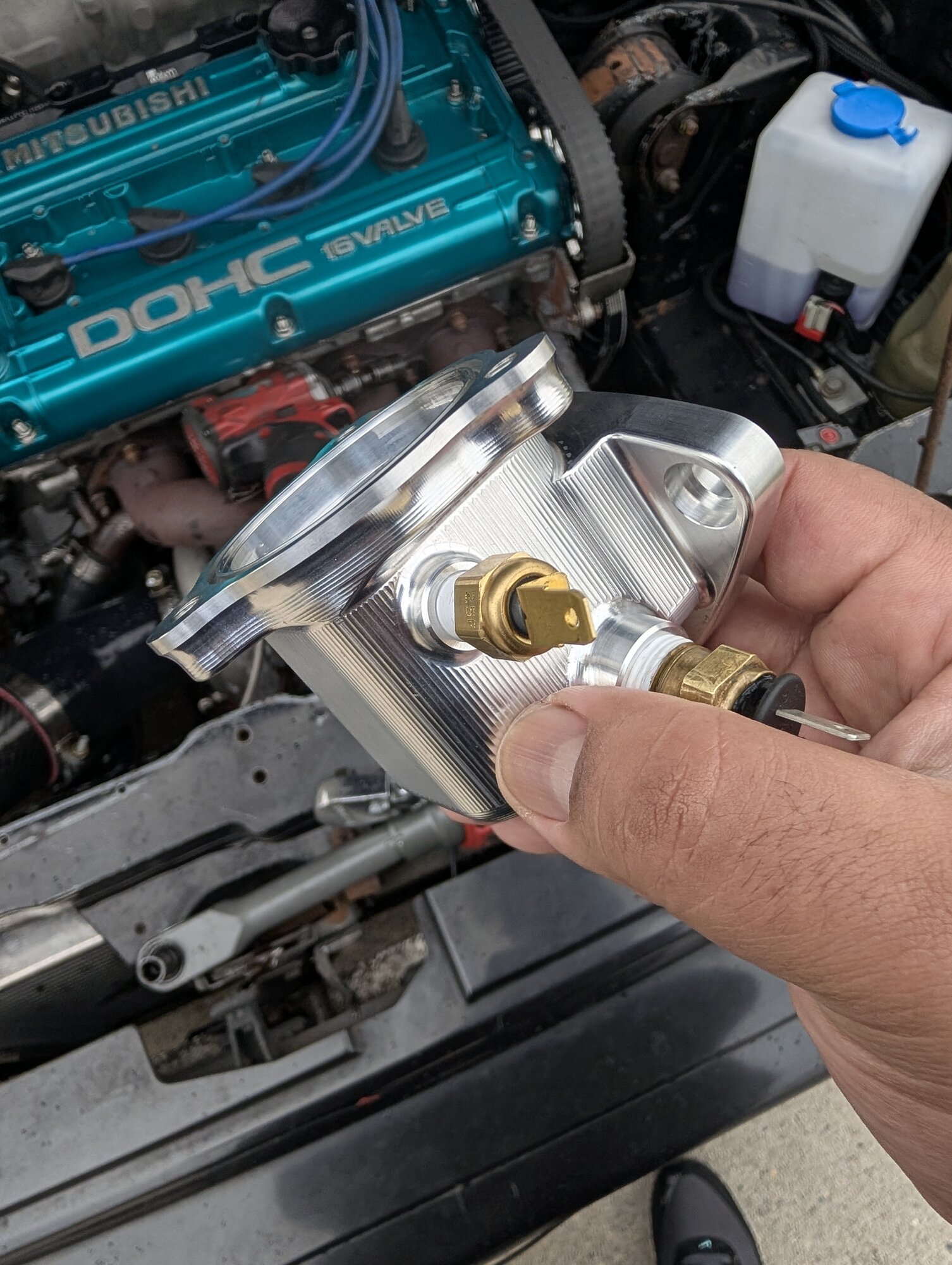

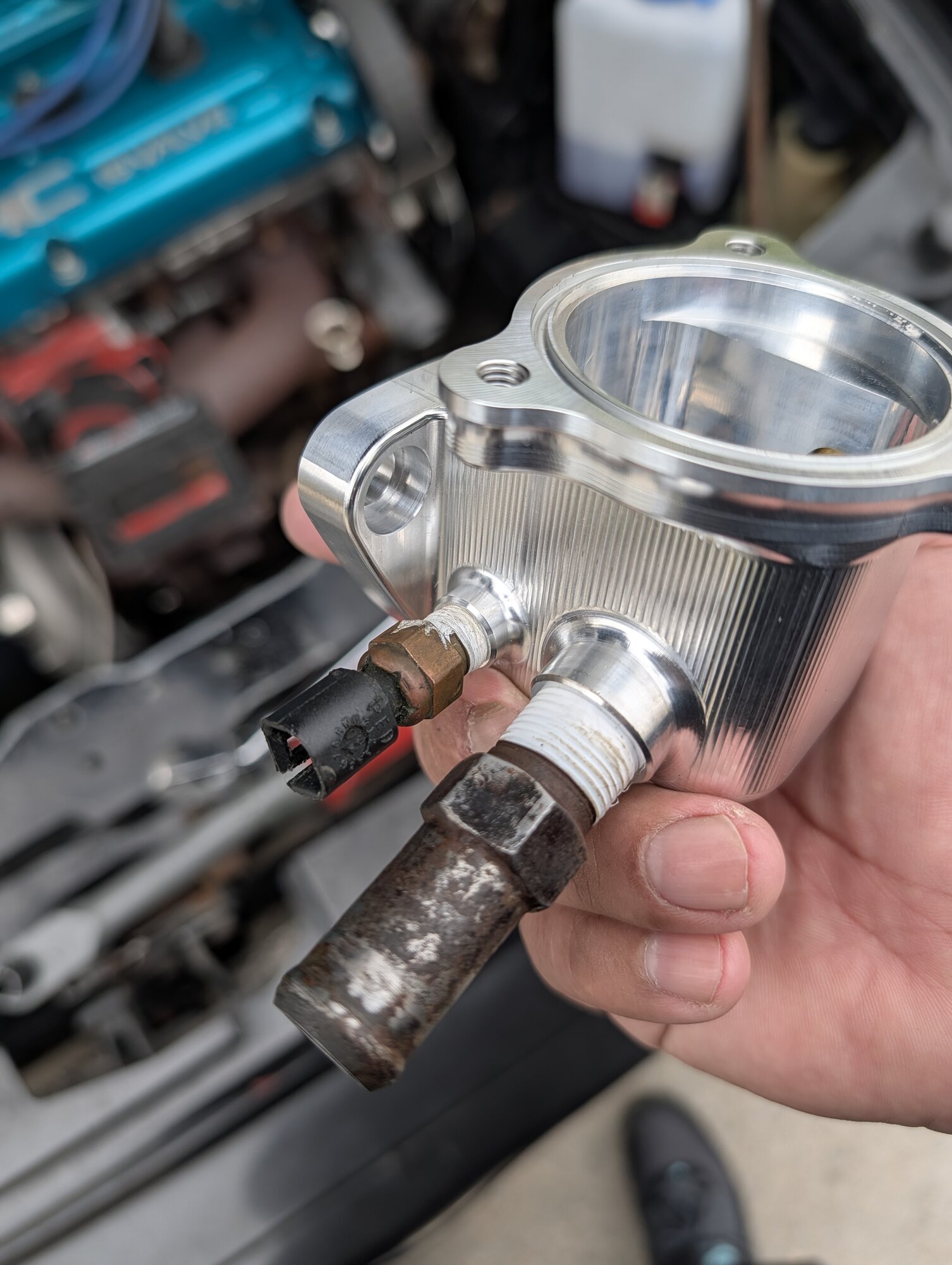

I hate when updates are far and few between but we suddenly been so busy that when i get home my motivation is at a all time low. The 90 transmission has been in but it was notchy and there a few factors. I remade most of the plastic bushings by 3d printing them. I also adjusted the cables. It still felt off so i eventually swapped to a new slave. But between the air i had stuck in the slave i noticed the master rod was wet so i swapped both to new units. The shifting is finally feeling good again. I also swapped over to silicone radiator and heater core hoses since they were swollen. After swapping i realized a had a nasty air pocket i couldn't bleed. When i had one of my guys weld the spare ports in my housing shut they created empty voids that would normally have a sensor in it. When i took the car to work it would make the gauge peg to the H but my coolant temp sensor never read that high since the check engine light didn't come. I have it set to go off at 216F. I was able to get the light to go off throwing it in neutral and then popping it back into gear that would normally make the air pocket pass. I was looking into making my own thermostat housing when a guy posted on FB about his billet housing he just made. I was sold. I ordered a day after. He is on here but doesn't frequent the board. @Fatboy Fab . He was awesome to deal with and i couldn't be happier.
I can't say enough good things about how happy i am with the housing. It even includes a rear 1/8 npt for a aftermarket coolant temp sensor. I have been driving the car a bunch which makes me more motivated to fix all of the little nuances that annoy me. I finally took the valve cover off and threw on a new gasket and rtv'd the cam cap corners. I did some research on rtv's and i was surprised to see mopar rtv was so good. So that's what i ended up using. I didn't want to change the oil into a billet forward facing i ordered in october came in but i don't like to go over 2k or 4 months on the oil changes especially with it being a fulltime e85 car. I am a little disappointed on these silicone gaskets i bought because my oil pan always looks wet by the gasket. I will re seal the pan with rtv next time i have the time to do so. My friend is going with a cop on his car so he gave me his bracket and spark plug wire cover which i think looks pretty neat.

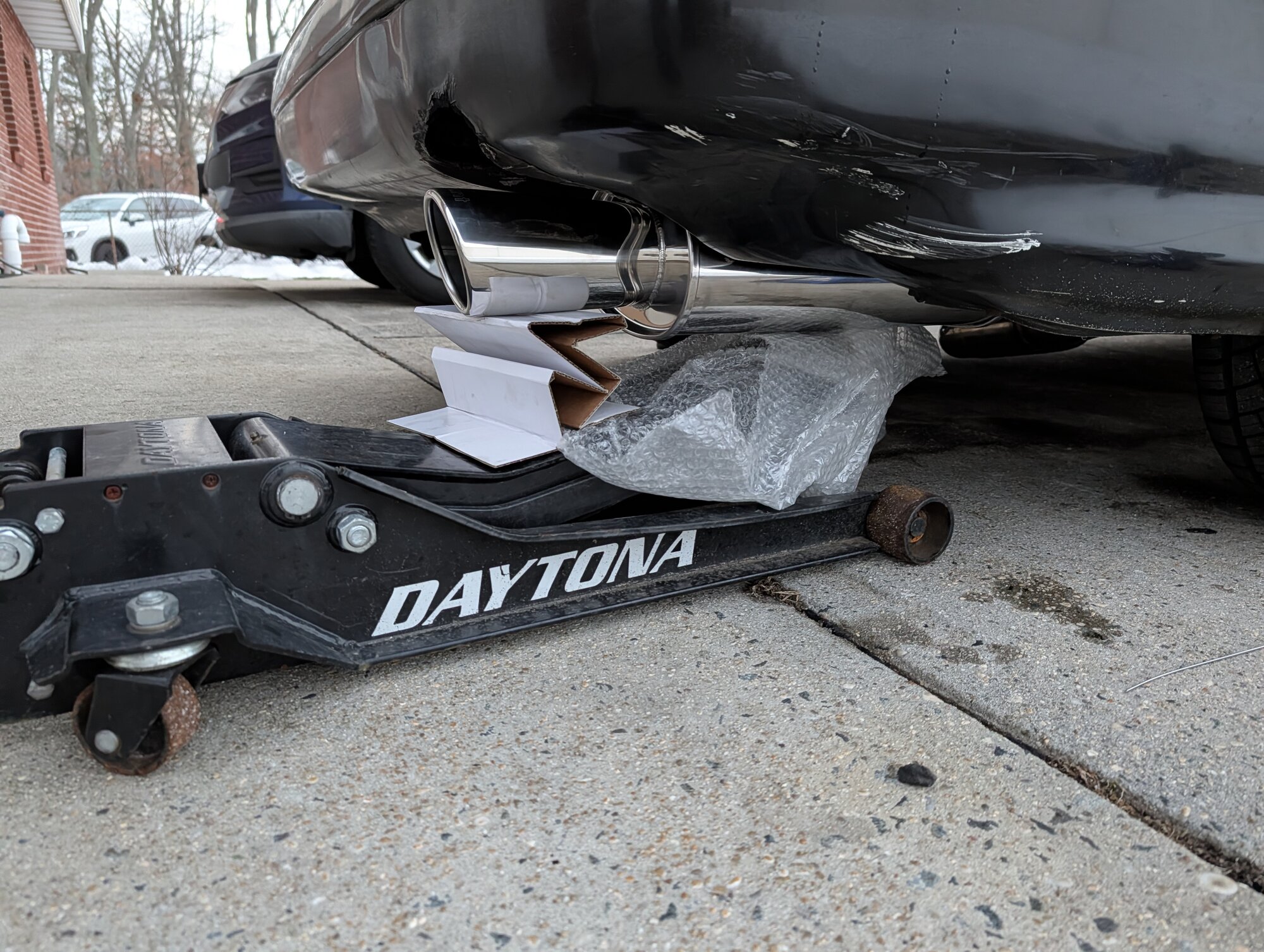

I also finally fixed a enhuast leak i has from the apexi muffler. I ended up going with a vibrant single tip muffler. I hated the chrome muffler when it was new but it doesn't stick out like a sore thumb now after a few heat cycles. I took before and after DB readings. I dropped almost 10 db from the switch.

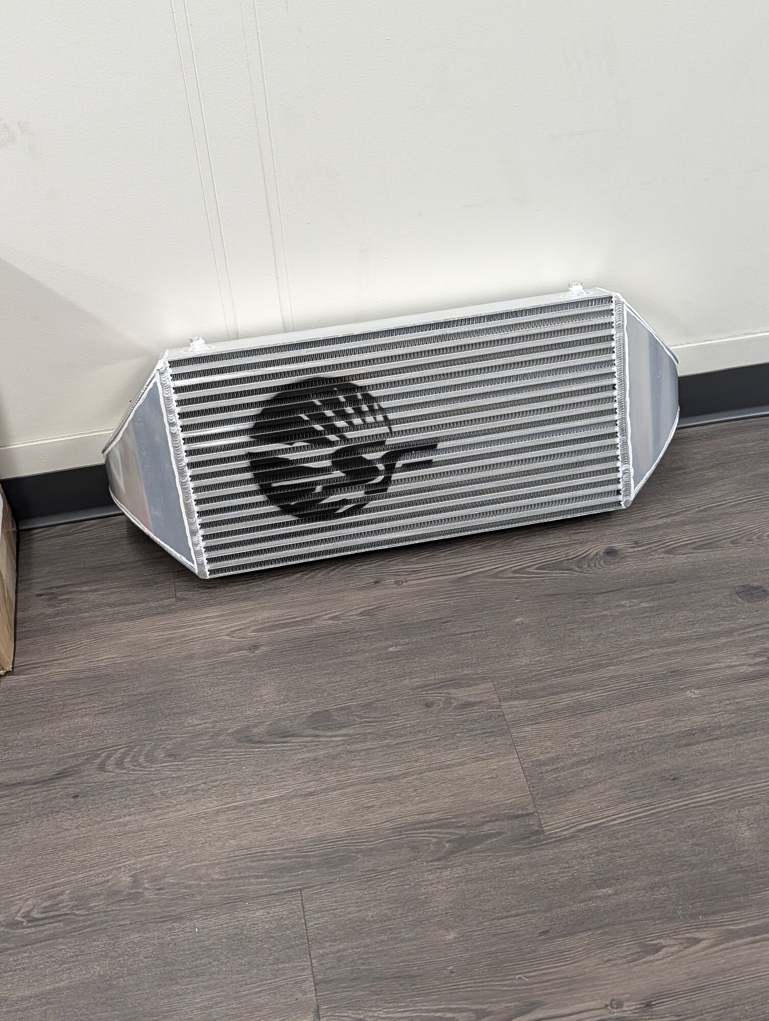

I keep forgetting to take pic of things i do. I redid the hangers over as well. I also picked up a new FMIC i just haven't had time to get it mocked up yet but maybe that will be my next update.

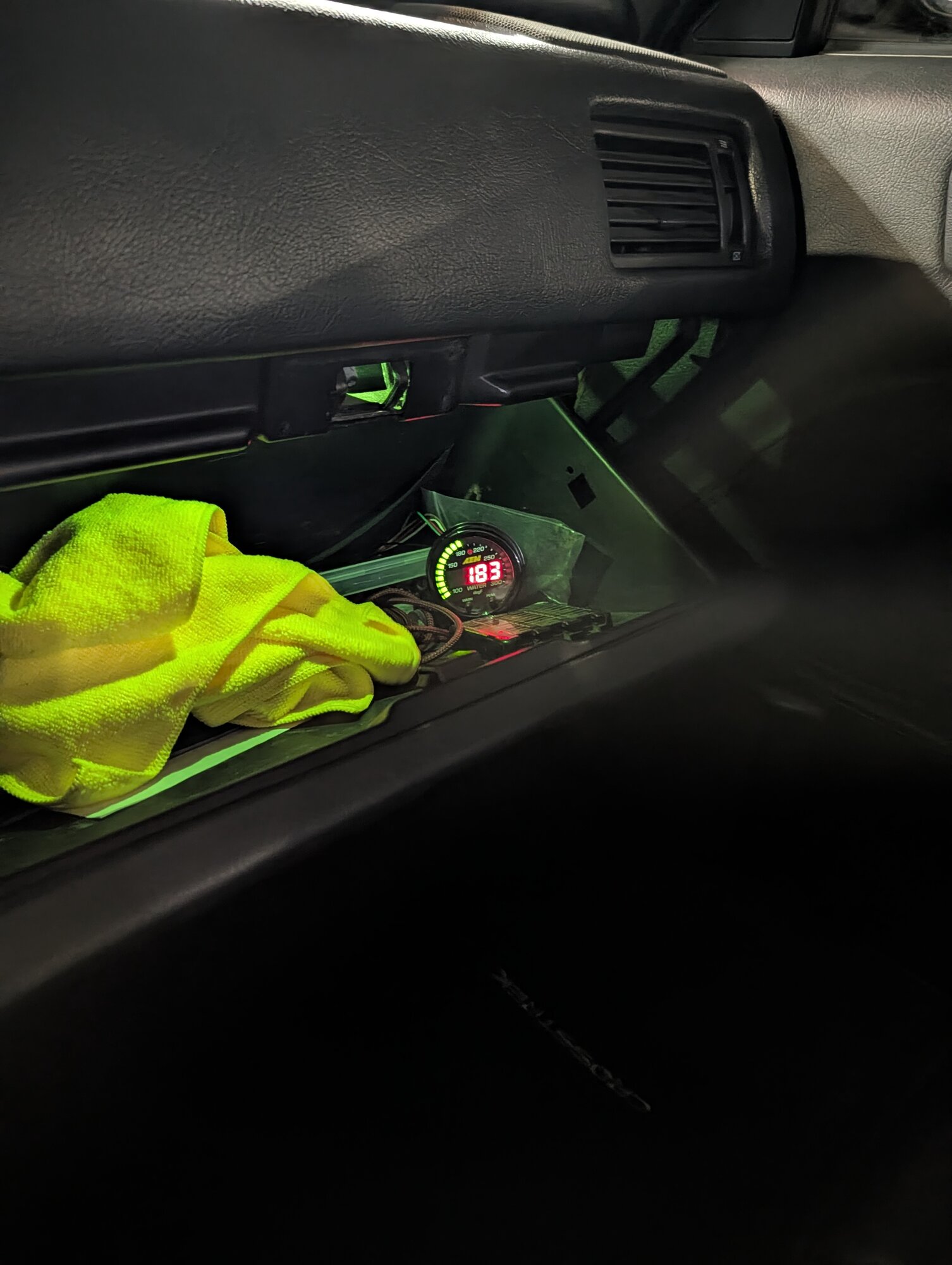

Now that i don't have to weld a bung onto my radiator i finally installed a aem coolant gauge i picked up. Now i can see the real time temp. Not that i really care since it's set to go off at 216 but the gauge on the cluster can sometimes be deceiving .I never go over 190 and i hang around 180 which is awesome.

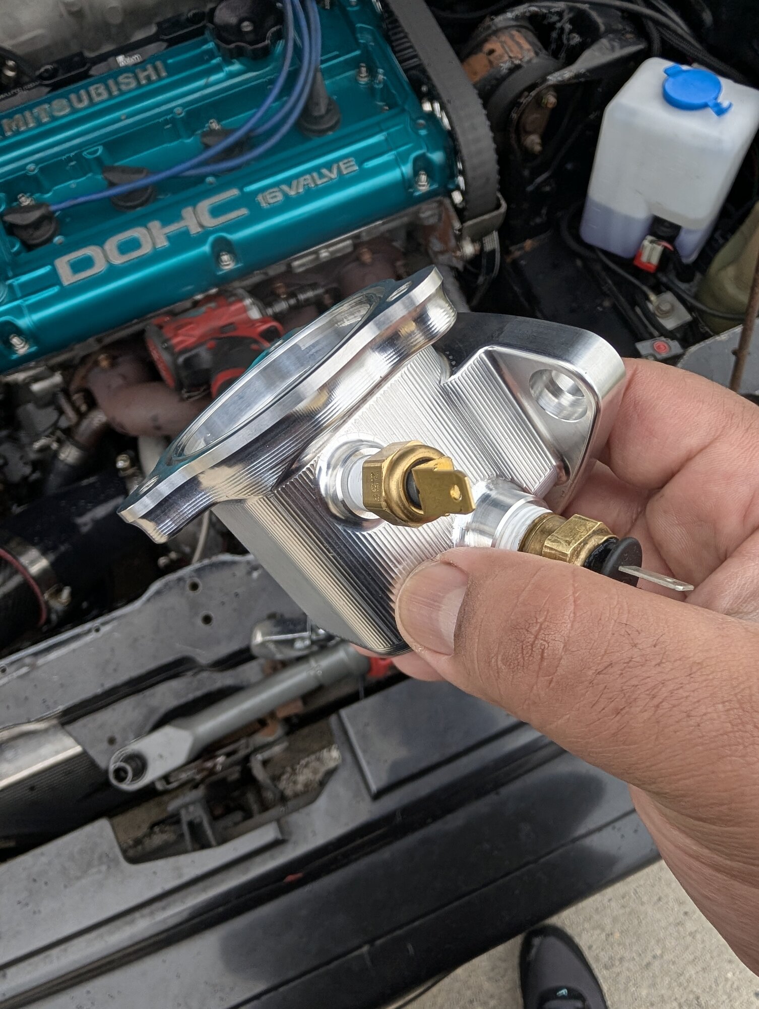

…I was looking into making my own thermostat housing when a guy posted on FB about his billet housing he just made. I was sold. I ordered a day after. He is on here but doesn't frequent the board. @Fatboy Fab . He was awesome to deal with and i couldn't be happier.
I can't say enough good things about how happy i am with the housing. It even includes a rear 1/8 npt for a aftermarket coolant temp sensor…
Nice to see someone is making this!
Do you have pictures of the inside? Or can you comment on whether he retained the (for less of a better word) “baffling” on the inside?

Thanks man. Yeah the housing is solid. It's a shame you couldn't snag up that vr4. I have a local that is selling his. If none of my friends buy it i can forward you his info before he throws it on FB
I don't but i can take some since i have a friend that will be getting one for his Galant as well. There is no baffling .

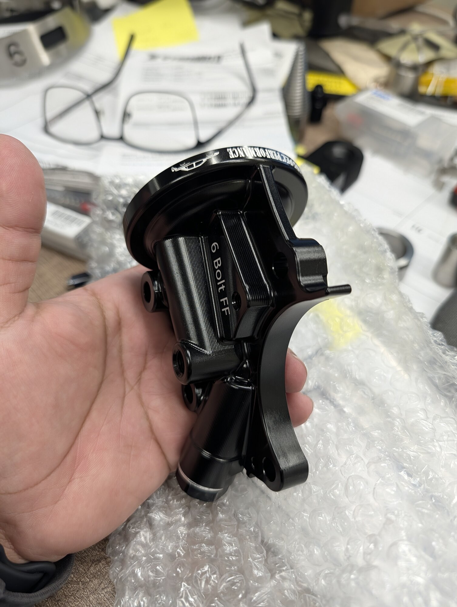

So i've just been in a waiting stage for parts and I finally got a few in this past week. This is the new billet forward facing housing from evospec for a 6 bolt. It's nice to see some love for 6 bolts since the 7 bolt guys have a lot more options.

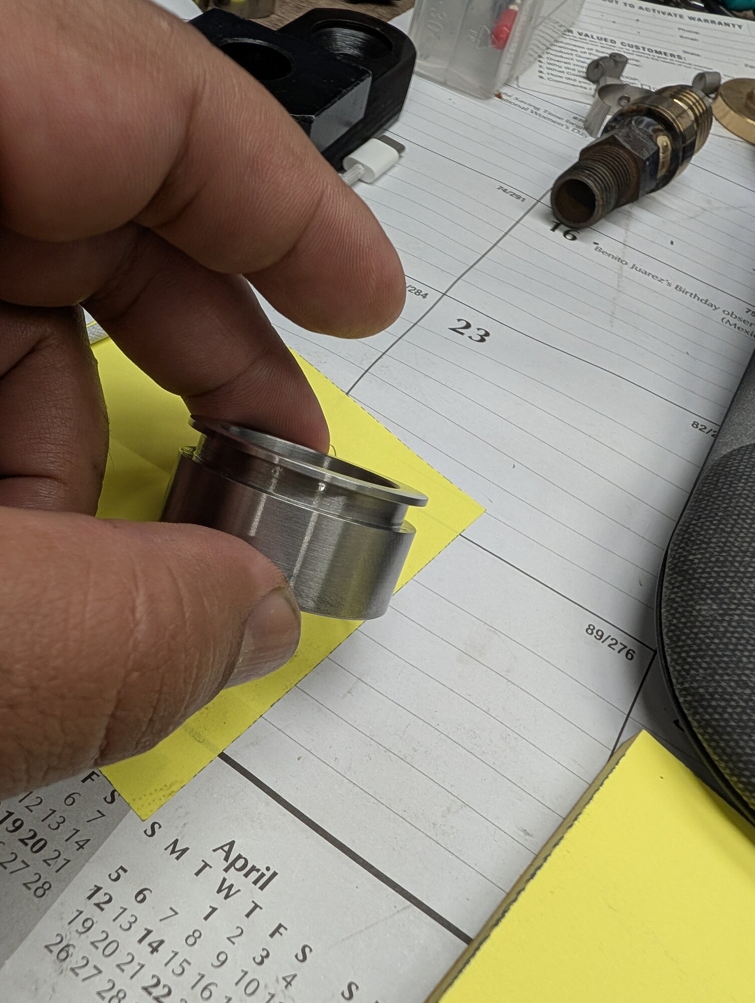

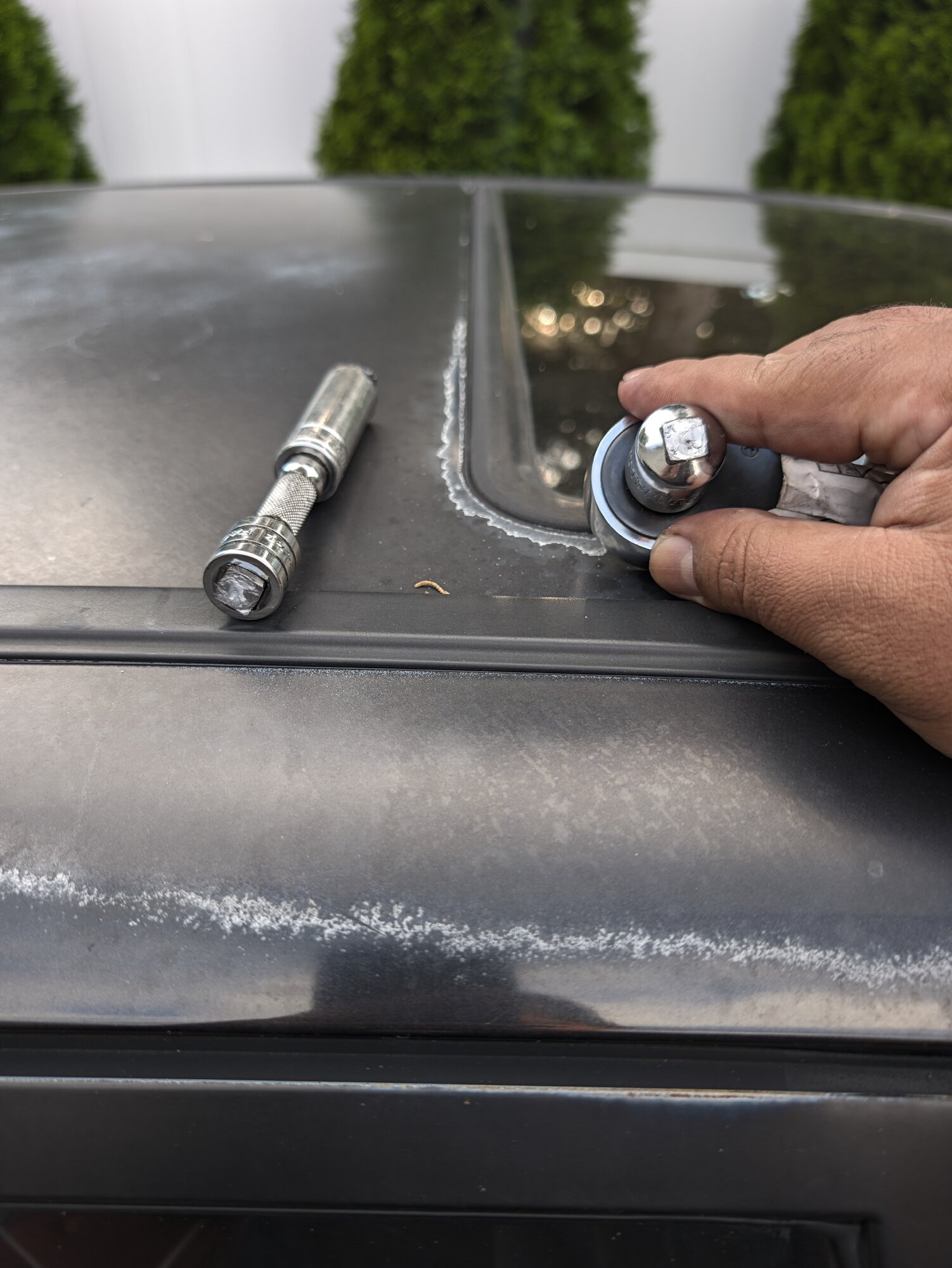

I also finally got some time to start a project i wanted to do a few years ago but every time i was close to starting something came up. I started getting the machining done for the o-ring to make some SS waterpipe for me and a few locals.
