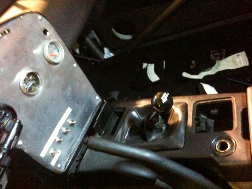

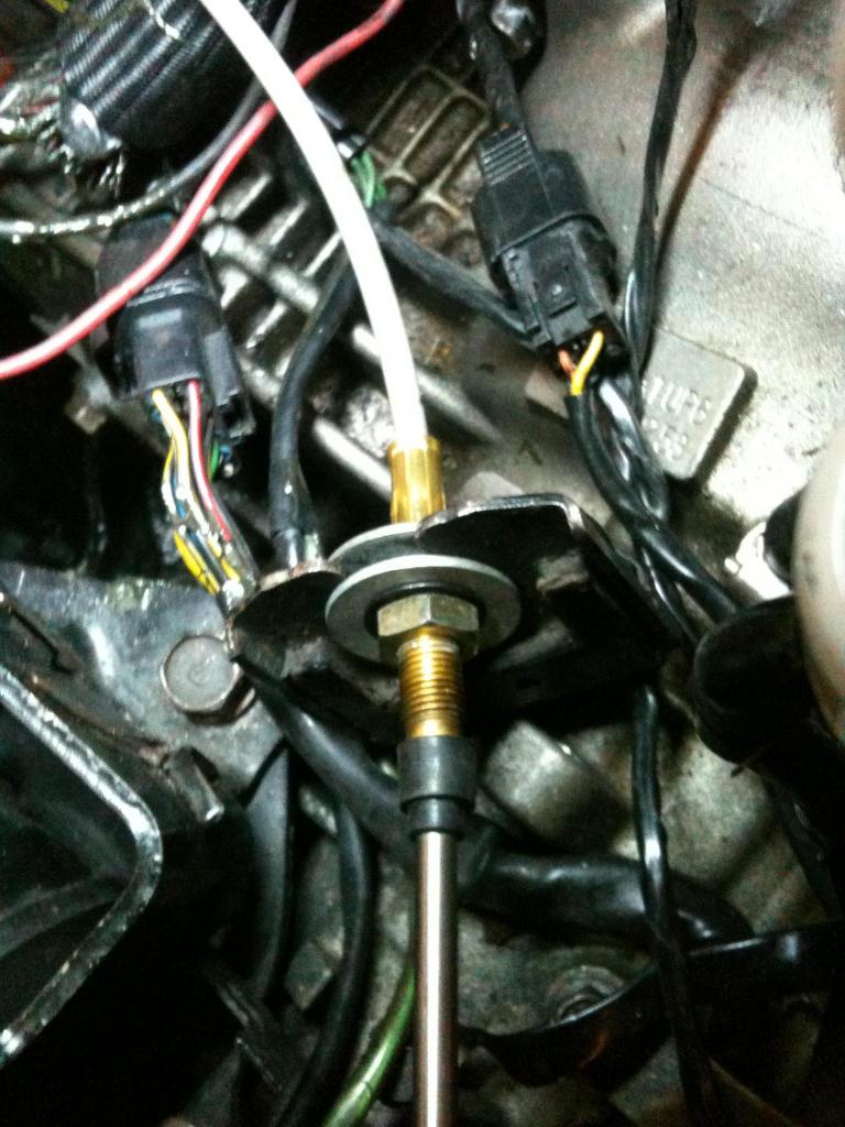

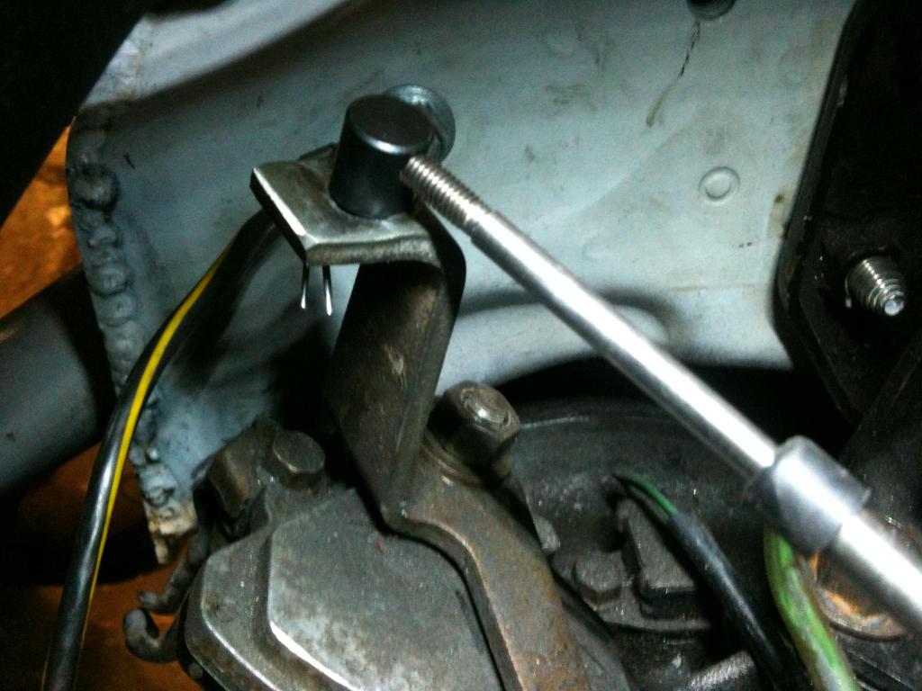

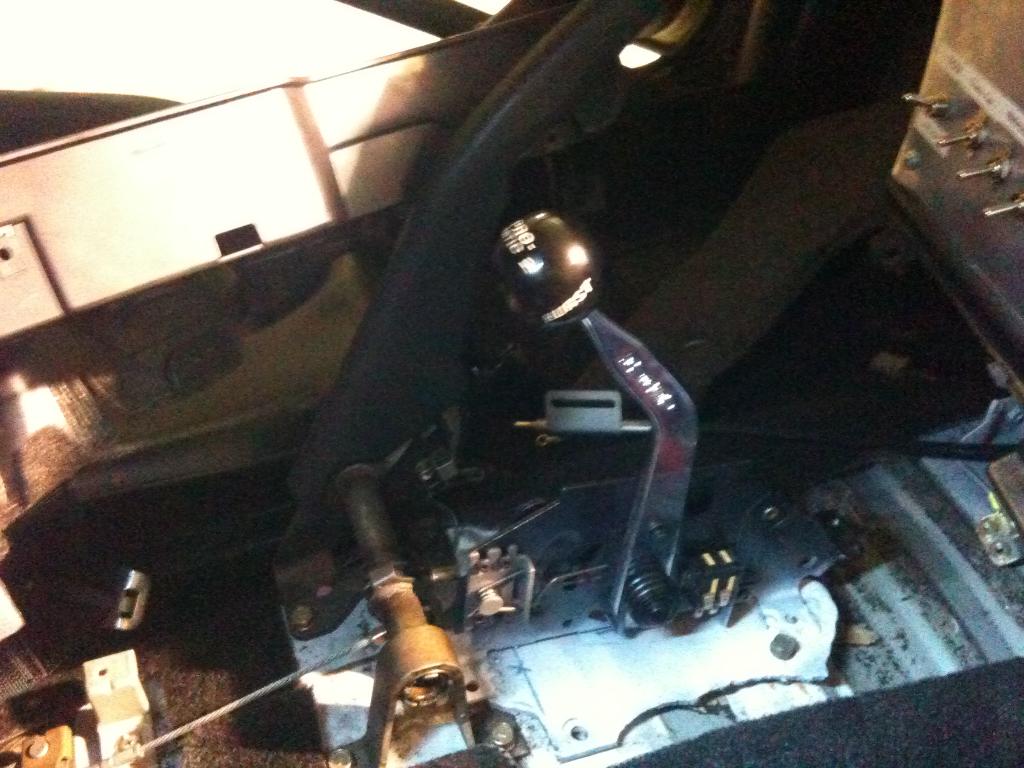

yeah, shit happens! All the damage is fixed luckily. Today I actually swapped in a B&M shifter setup. Made an adapter out of 1/4" plate steel that fit both the footprint of the stock shifter and the B&M shifter and then welded that to the B&M base since I have no plans of ever using it in a Mustang. :) Sorry for the shitty pics. Broke my phone a few weeks ago so i'm using an old iphone 3g that i had laying around. :(
