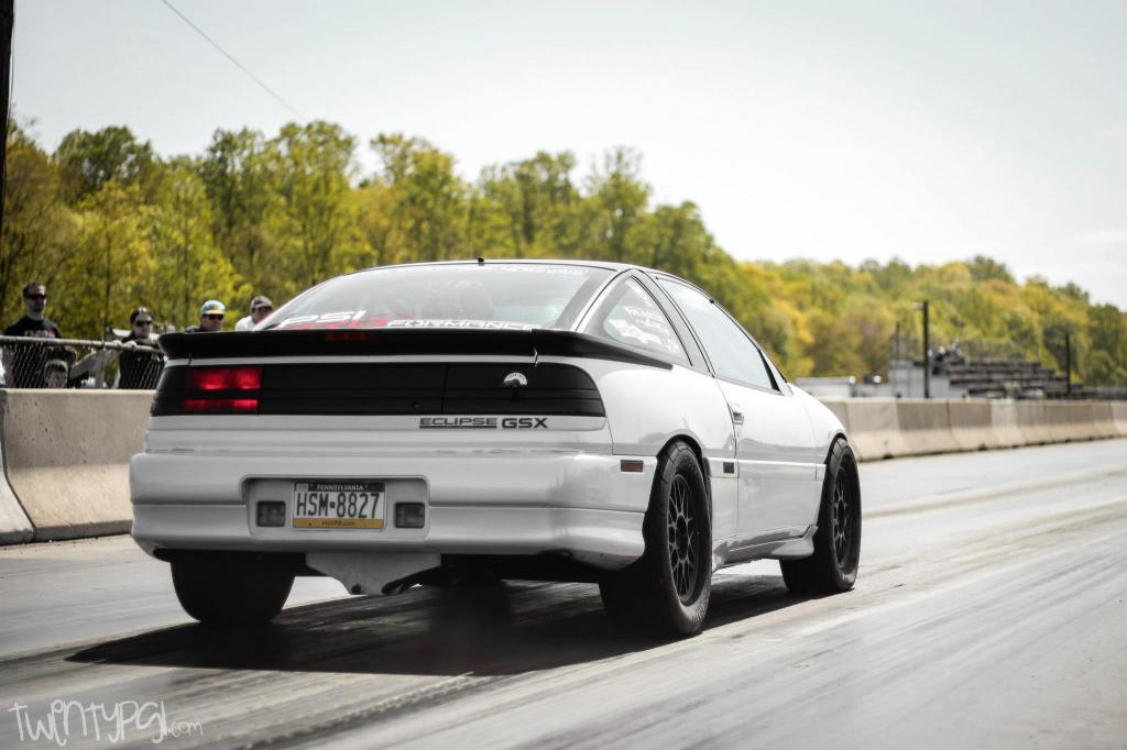

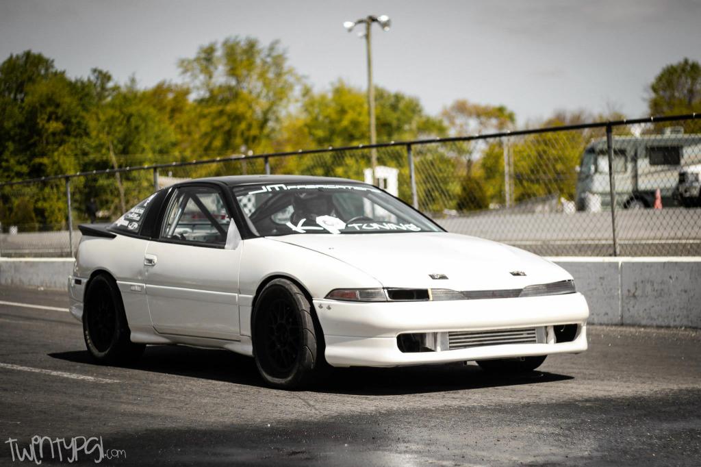

Car looks sick on those tires. Very beefy. Pretty good cutting 1.4s on street tires :thumb:
Yeah, rear is stock minus the coilovers. I want to do the toe kit, bushings, and upper arms but don't feel like tearing the rear apart during the season. It's working for now so i'll just make some minor adjustments and see if I can leave it alone for the rest of the season.
These tires are working pretty well but I have a feeling they're a big reason i'm destroying so many yokes since they don't give at all. Need to get some full slicks soon....
Car looks good! If you stiffen up the rear so it doesn't squat as much it will probably help the life of your tcase.
I'm hoping preloading the springs a bit will help stiffen it up. Short of that i'd have to swap over to a stiffer spring rate since my coilovers are set to full stiff as it is.

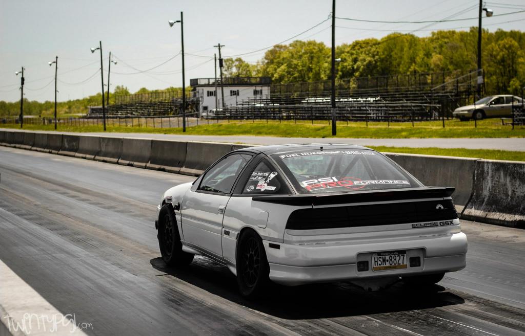

That's the baddest auto dsm launch I've ever seen.
It sure as hell doesn't look good! A buddy of mine w/ a turbo LS s10 was behind me and said he though I broke something until it came out of it's squat. ROFL
I'm a fan of squatting 1g's,maybe that's why I think it's totally badass. Flying rear spoiler section is icing on the cake :LOL:
Car looks great man! Awesome progress! Keep it up.
Also, I didnt see it previously mentioned but what wheels are those? Have the dimensions of them?

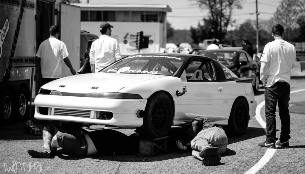

You guys had some great photogs there!! Definitely jealous!
Sick tattoos BTW!
We are definitely lucky to have a bunch of good photographers in our group of friends. There is still one set that is unedited plus we also had a videographer there who is editing his footage. So more to come soon!
We have NO CLUE what wheels they are! There are no markings what so ever! But they are LIGHT! Probably because they're 15 x 6.5! :p
