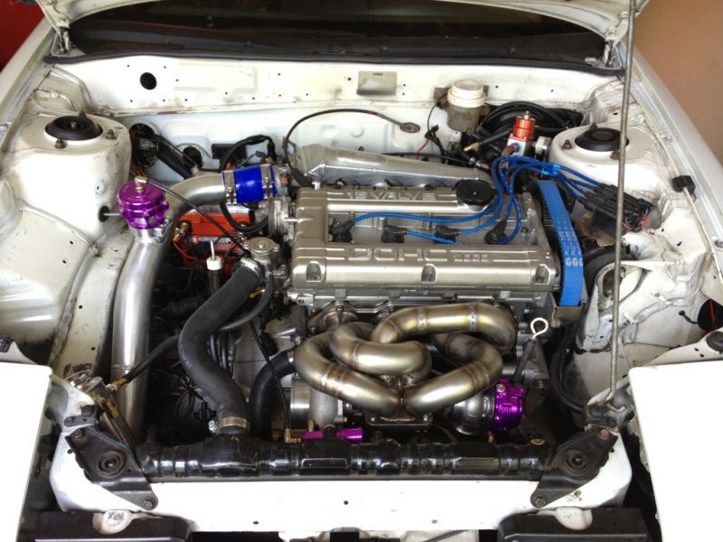

That is a gorgeous engine bay! Keep up the great work! Any plans to take your car to this years dsmshootout?

Thaks man! I'll definitely be at the shootout again this summer!

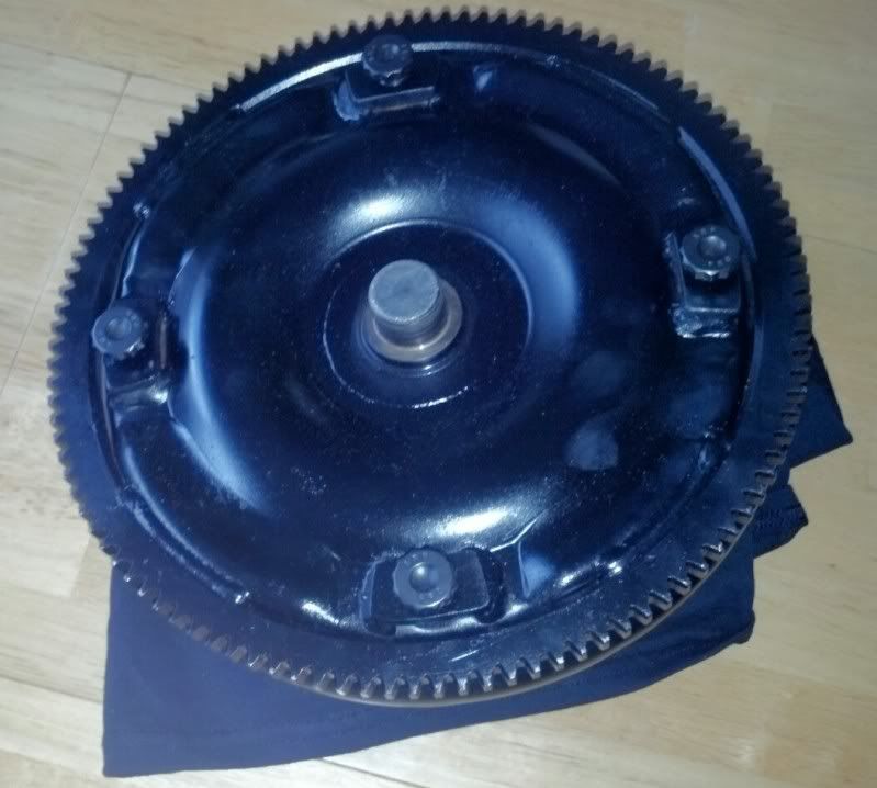

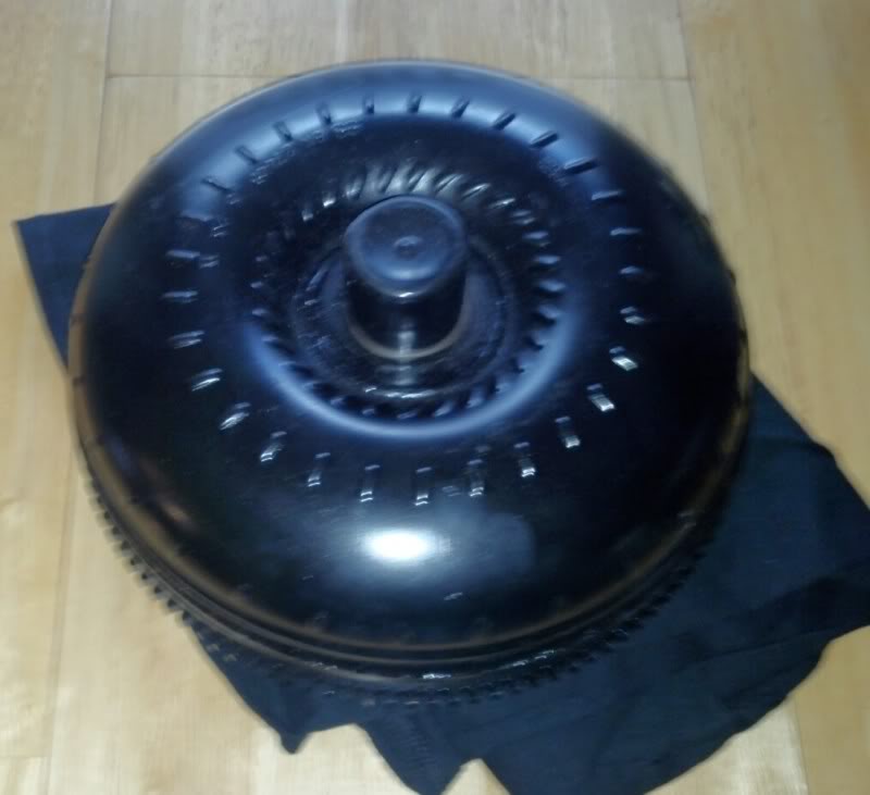

Two converter bolts backed out again today on the dyno. I'm forever plagued by them. Hopefully I can fix it w/o pulling the trans AGAIN. Tacking them this time around. Enough BS.

We had Hughes build the first DSM convertor nearly 10 years ago and went through several changes, the ones we run now re spragless but if you can get you setup to stall with one they are very efficient up top.
We always used GM convertor bolts cut down and 2 flex plates to keep them from backing out or breaking.

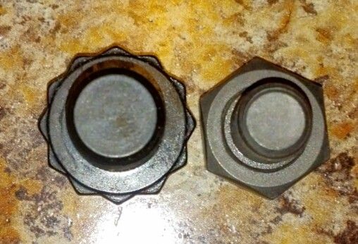

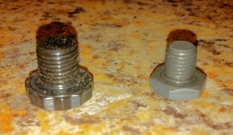

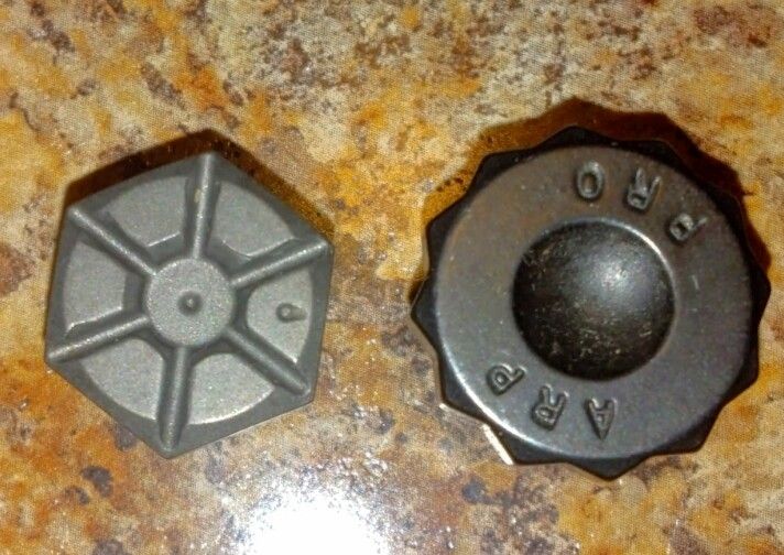

Brad also too adds material and drills and taps so it uses the Larger ARP bolts. I had the same thing happen to me, but they backed out at the track (IPT restall converter) and chewed up my Kiggly flexplate.
Hopefully with the new Bradco converter and larger ARP bolts I won't have that problem again.
Also, Kevin (Kiggly) told me to make sure you sand off any paint that is on the pads where the bolts go into the converter, as the paint will wear causing a gap and will assist in the bolts backing out.

I ended up pulling the trans quick this morning and will bump the holes up to a larger diameter and fine thread pitch so that should help things out. Most likely going to use 12x1.25 flexplate bolts since I can get a good amount of torque on them.
