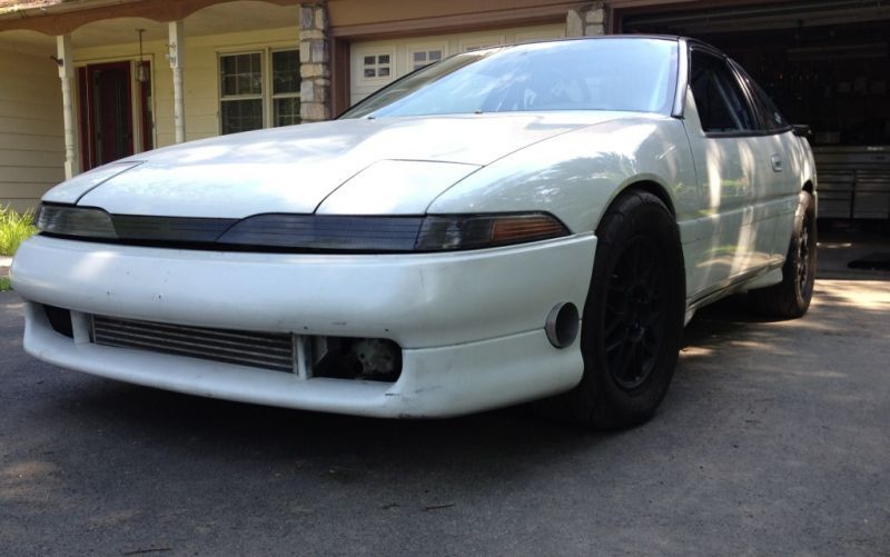

That is awesome man, that pic with the wing falling off is funny, but the camber is gross.
Nice work, we are awaiting your 8 sec post and 150mph traps!!
Thanks for getting that weight. I have a gutted stock hatch with lexan and no spoiler that I wanted to compare to.
You really need an alignment LOL.
Didnt realize you were on radials. What size and brand are those??
How much does your gutted hatch w/ lexan weigh?
I need more than an alignment!! I'm going to raise the car up a bit...the rear a good bit and preload the springs. Also going to get some adjustable upper arms and bump the camber out. Hopefully that helps.
Tires are 235-60-15 MT ET Streets.
