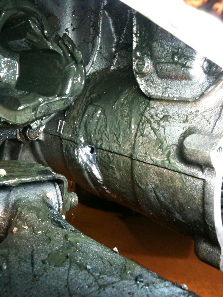

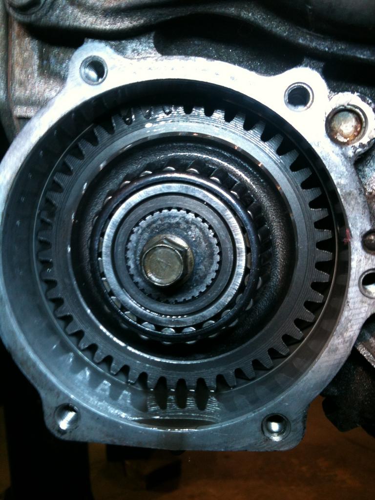

Took a few minutes to look into things....car rolls freely. Rear diff is fine, tcase is fine, center diff is fine, center diff transfer gear is fine. Broken axle and that knocked a hole in the back of the trans. So I'm HOPING a new axle and weld up that hole and should be good to go?? Guess we'll see soon.
Don't mind the bolt in the end of the output shaft... LOL

That axle made one hell of a mess...
Tough luck man! You can't seem to catch a break.... Looks like its time to get some DSS axles and hubs to help keep you from breaking a bunch of stuff :hellyeah:
The stockers typically don't break. There's probably something else going on... :(
He left it at home. Just give me the bottle. :)
The axles shouldn't be breaking like that. Isn't there some gears inside the tranny where the hole is now? Should weld up just fine IMO.
We think the control arm is moving forward from all the power and pulling the axle out of the cup. I don't have the triangular brace in any more that connect the subframe to the chassis so i'm going to have to find out and re-install it to see if it helps out. The axle itself did not break, it seperated at the cup oddly enough.

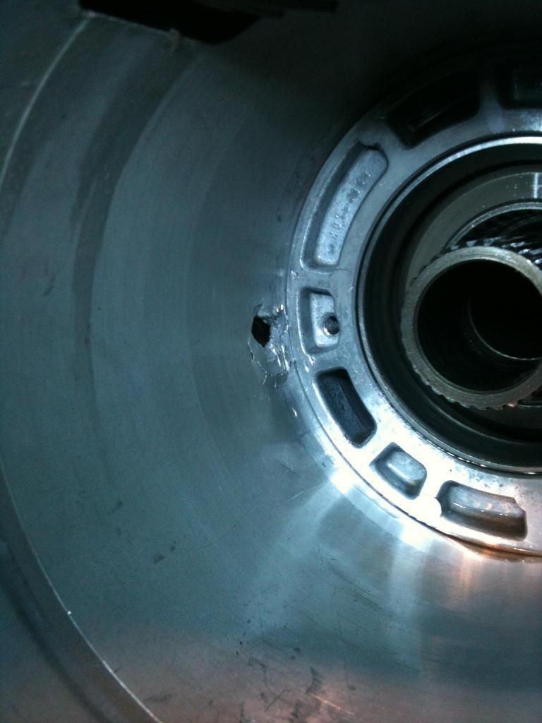

Pulled the center diff assembly today and figured out what caused the wheels to lock up top track. A chunk of aluminum from the hole jammed between the case and the center diff housing basically locking everything up. It must have settled when I stopped since the car could roll afterwards. We're welding the hole up and putting it all back together. Going to take a few days off from the track and head back out later next week.
