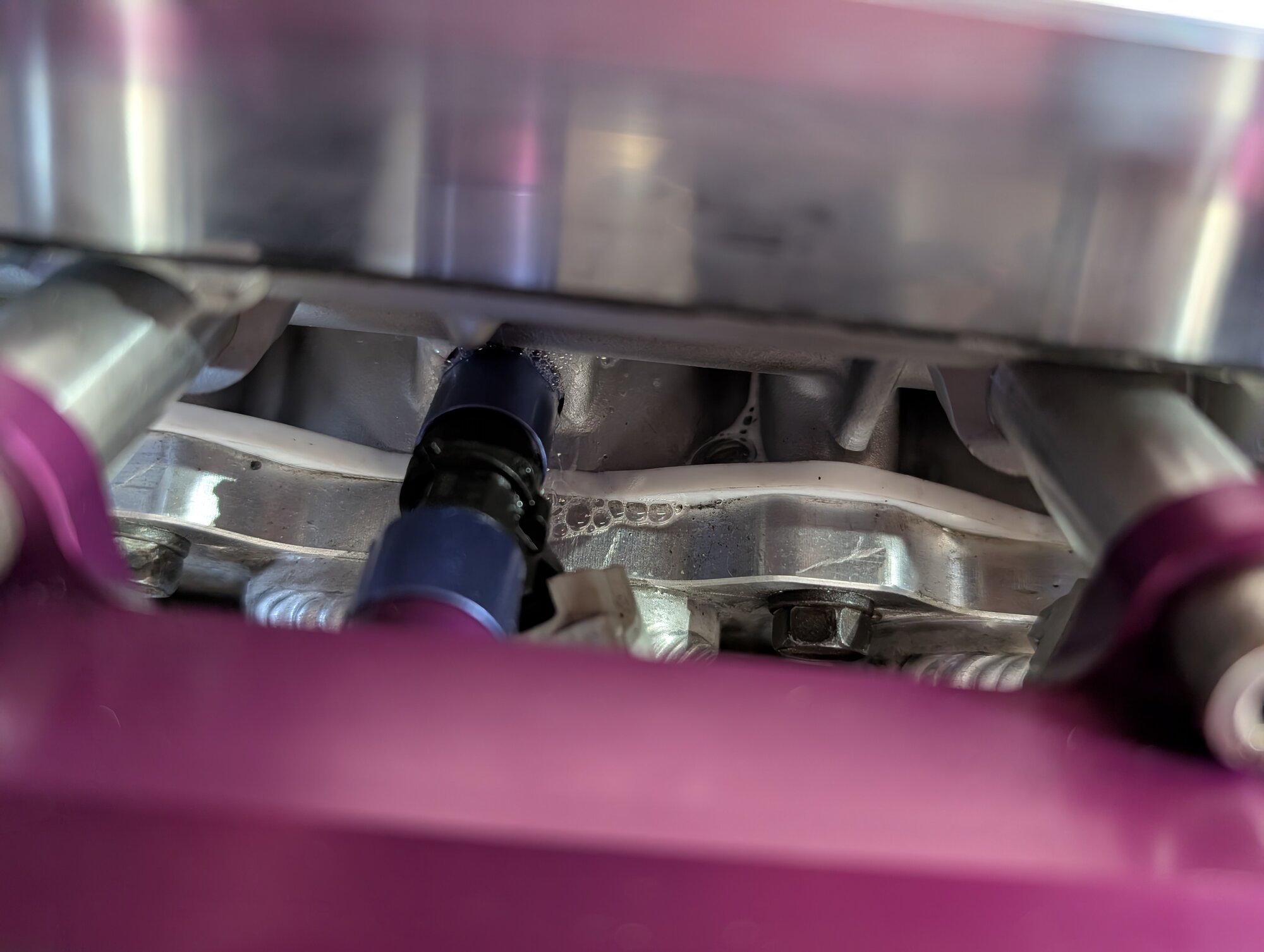

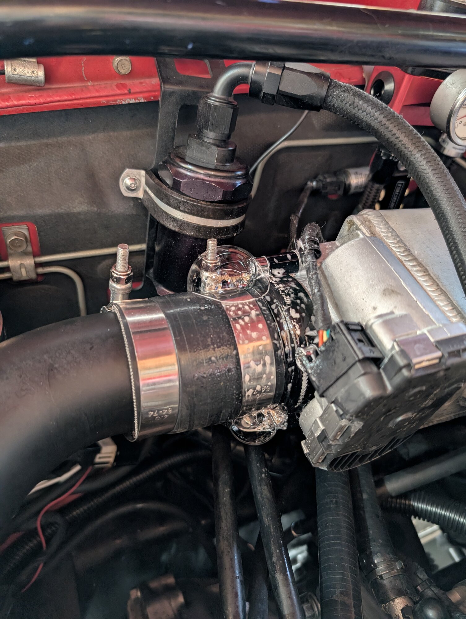

Tuner said we were down on boost a little bit. I got home and decided to do a boost leak test and I am glad I did. What I found was:
- Lower injector seals were ALL leaking. (Phenolic gasket was not leaking. Bubbles are from the injector seal) Cylinder 4 felt like someone was blowing through a straw it leaked so bad. The rest leaked quite a bit less, but they all leaked none the less. Replaced with some new parts I had and good to go.
- Throttle body bolts were leaking. Rtv on the threads fixed that one. I don't ever remove the throttle body from the manifold anyways so should be fine for the foreseeable Future.
- A few small leaks on couplers. Easy fix by just tightening them.

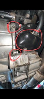

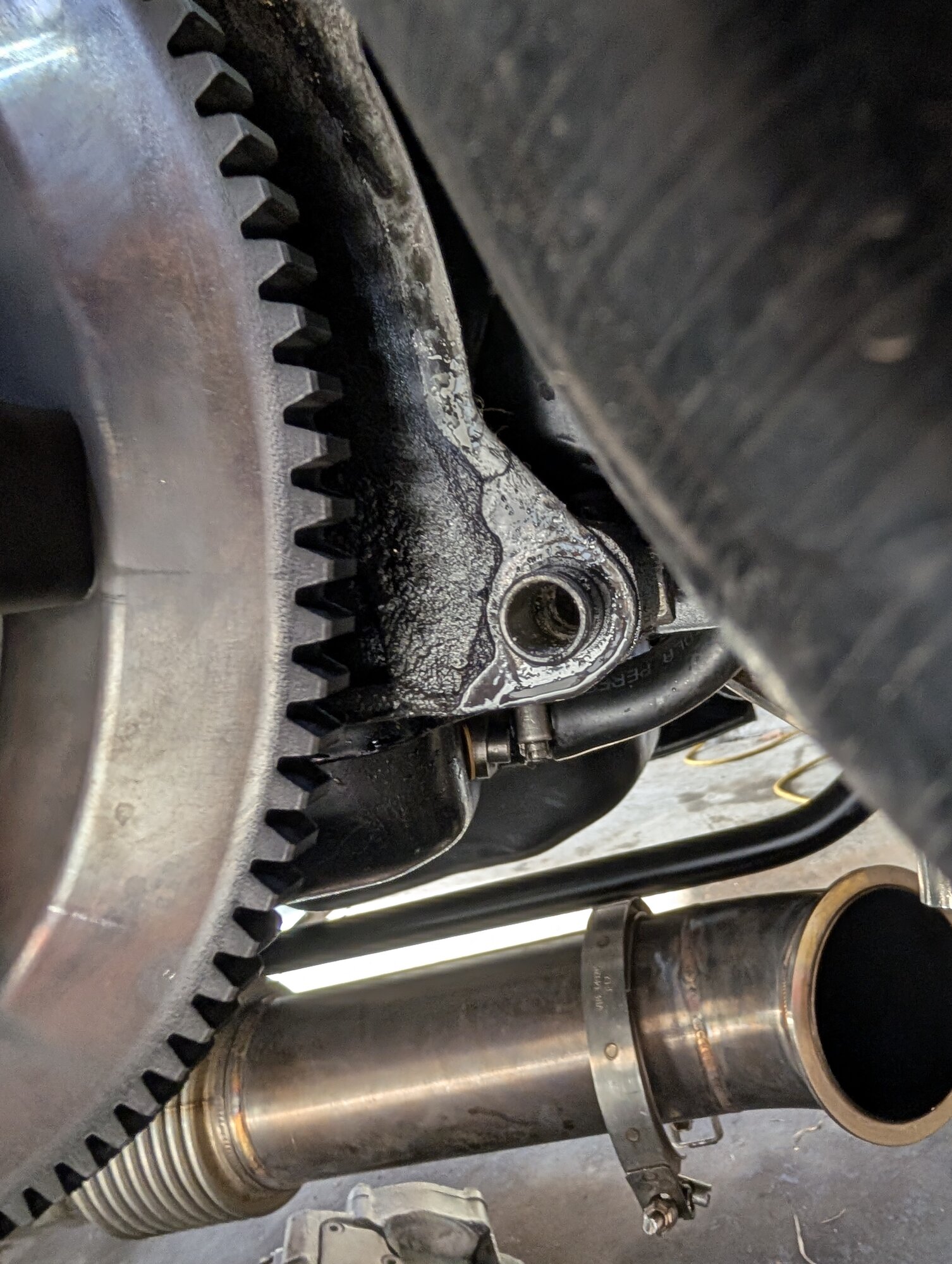

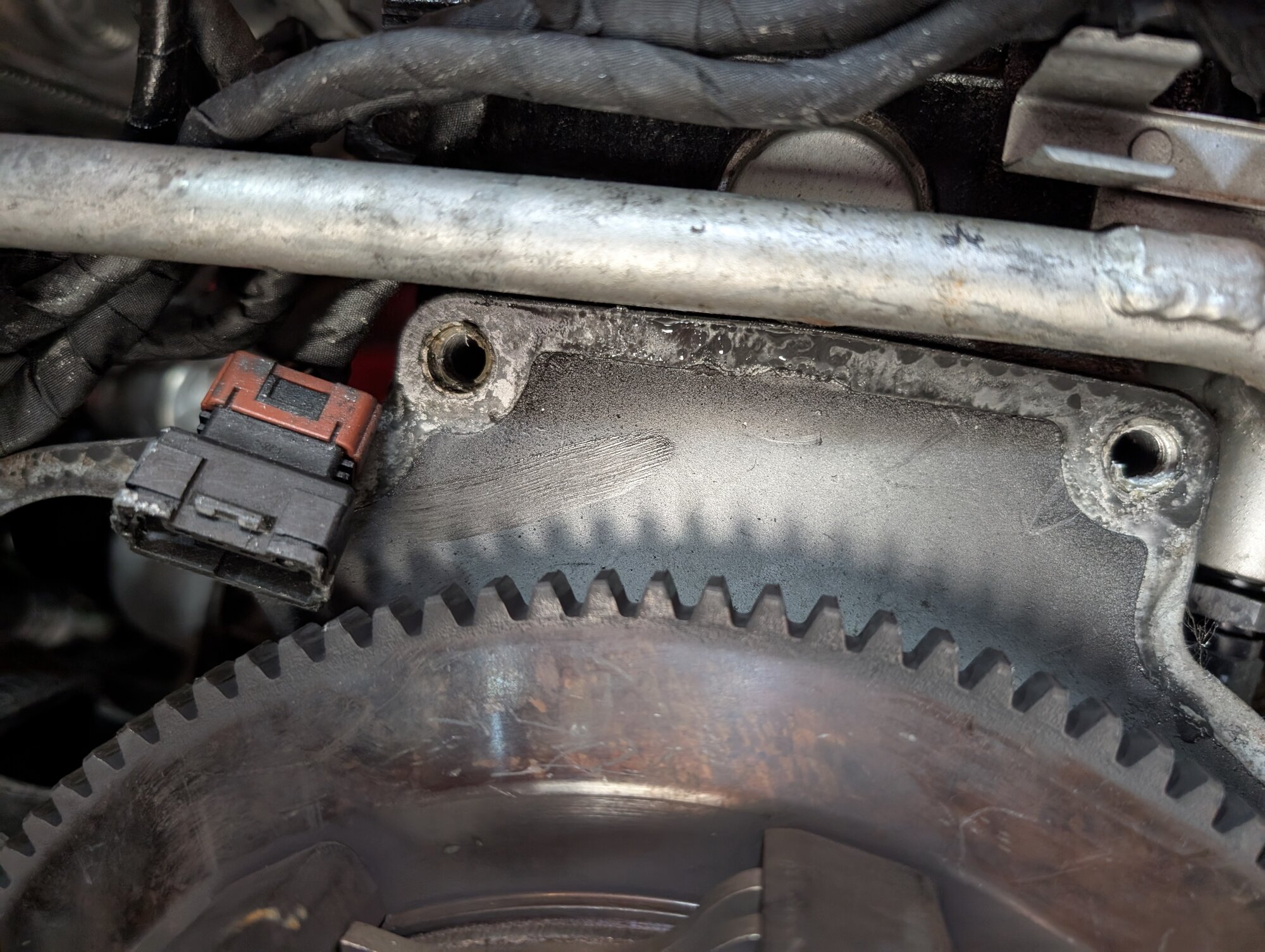

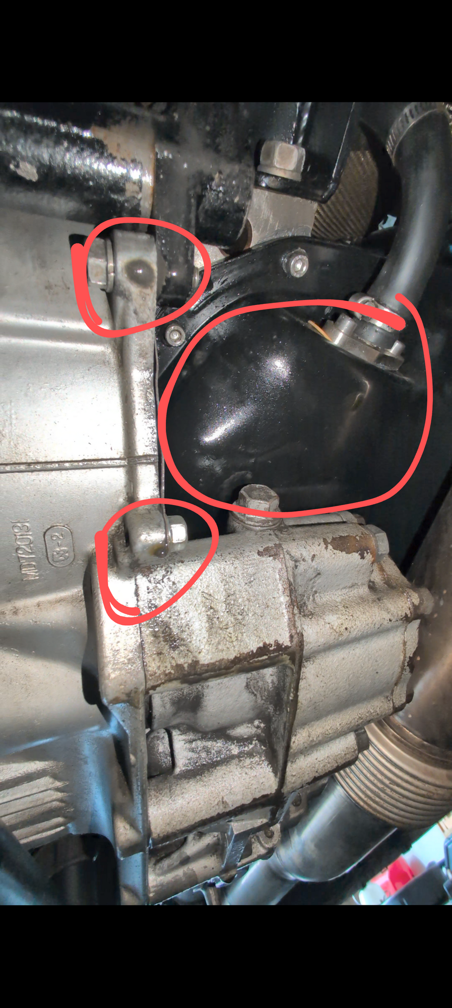

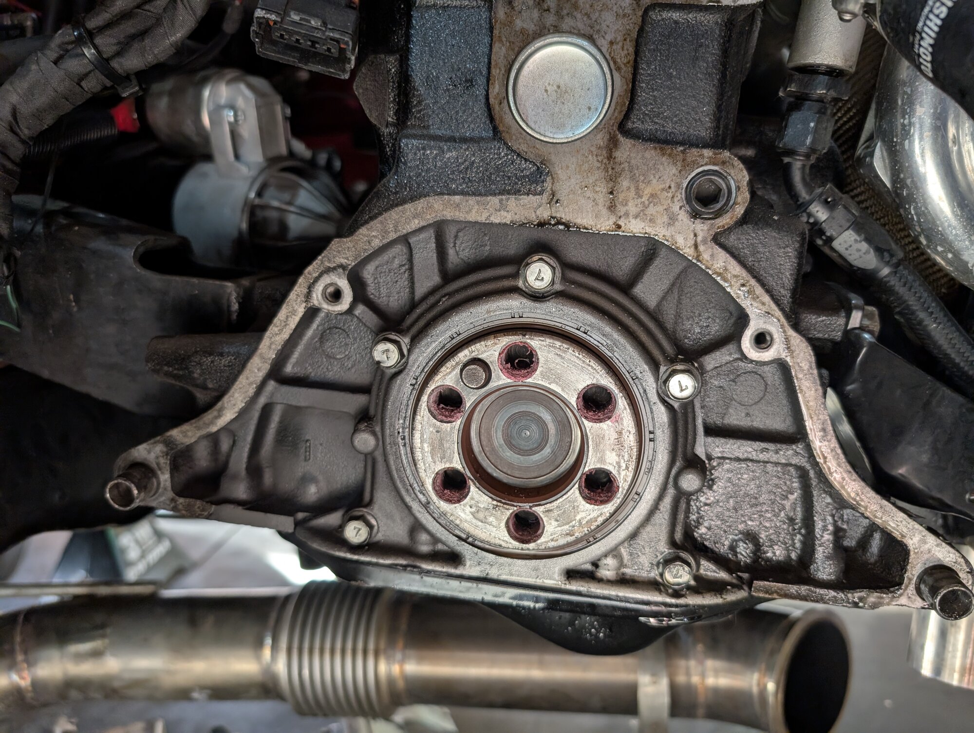

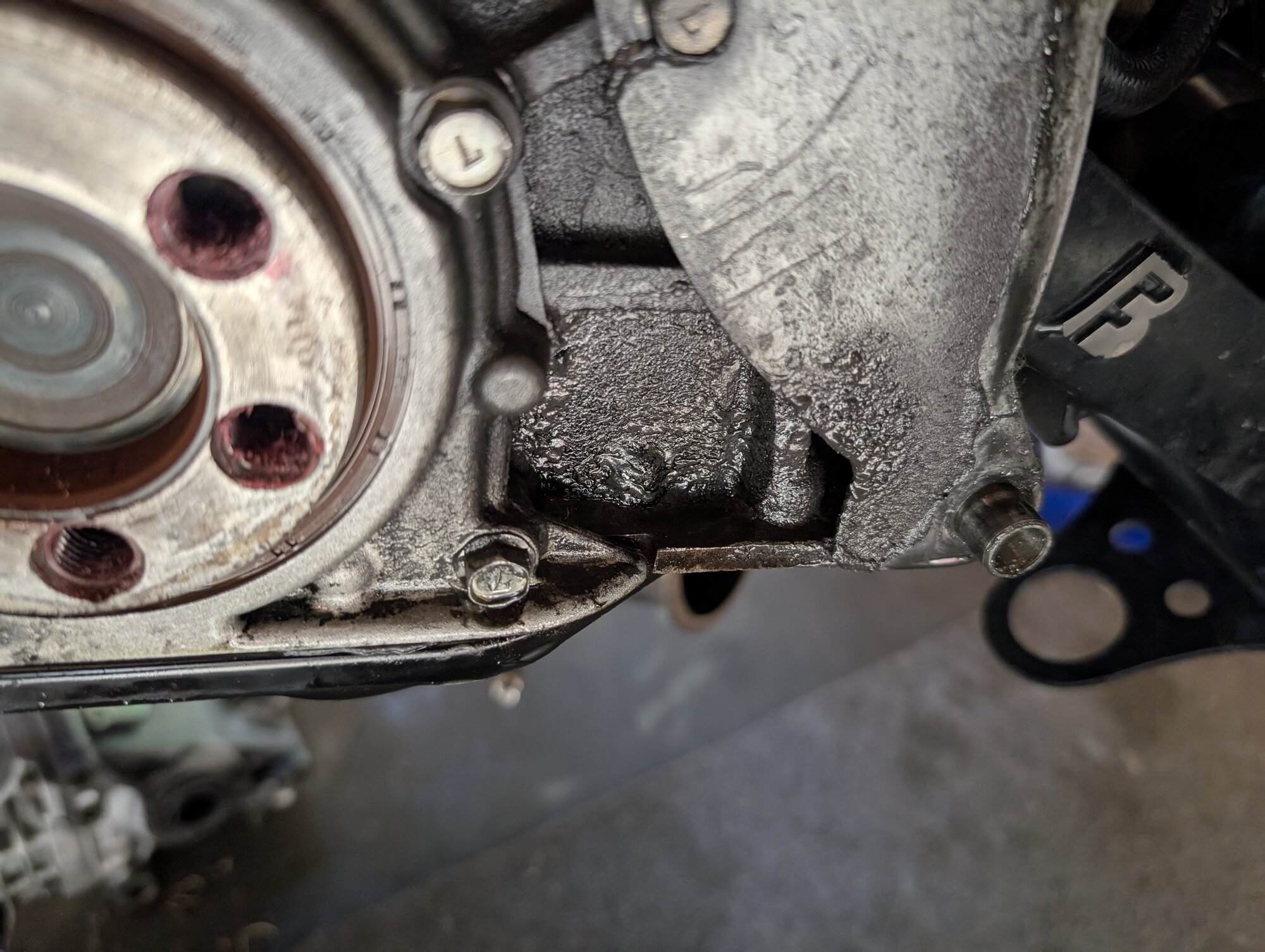

Car developed a leak on the transmission side, basically right where the bell housing meets the oil pan. It seems wet about 1/3rd the way up the bell housing so I'm thinking it might be rear main seal? I'm really not sure. Top of the trans is clean.
I did buy a whole new rear main setup. Seal housing, seal, gasket and oil/ seal separator just in case. I'll probably pull the oil pan AGAIN to make sure it's sealed correctly.
You can kind of see some of spots here. Looks like oil mixed with clutch material, really gritty/ sandy looking. All over the slave cylinder, couple spots on the trans, the oil pan is wet also. It does also make it's way to the far side of the trans where 5th sits on the last casing. Hopefully it's not getting all over emy clutch disks and flywheel.

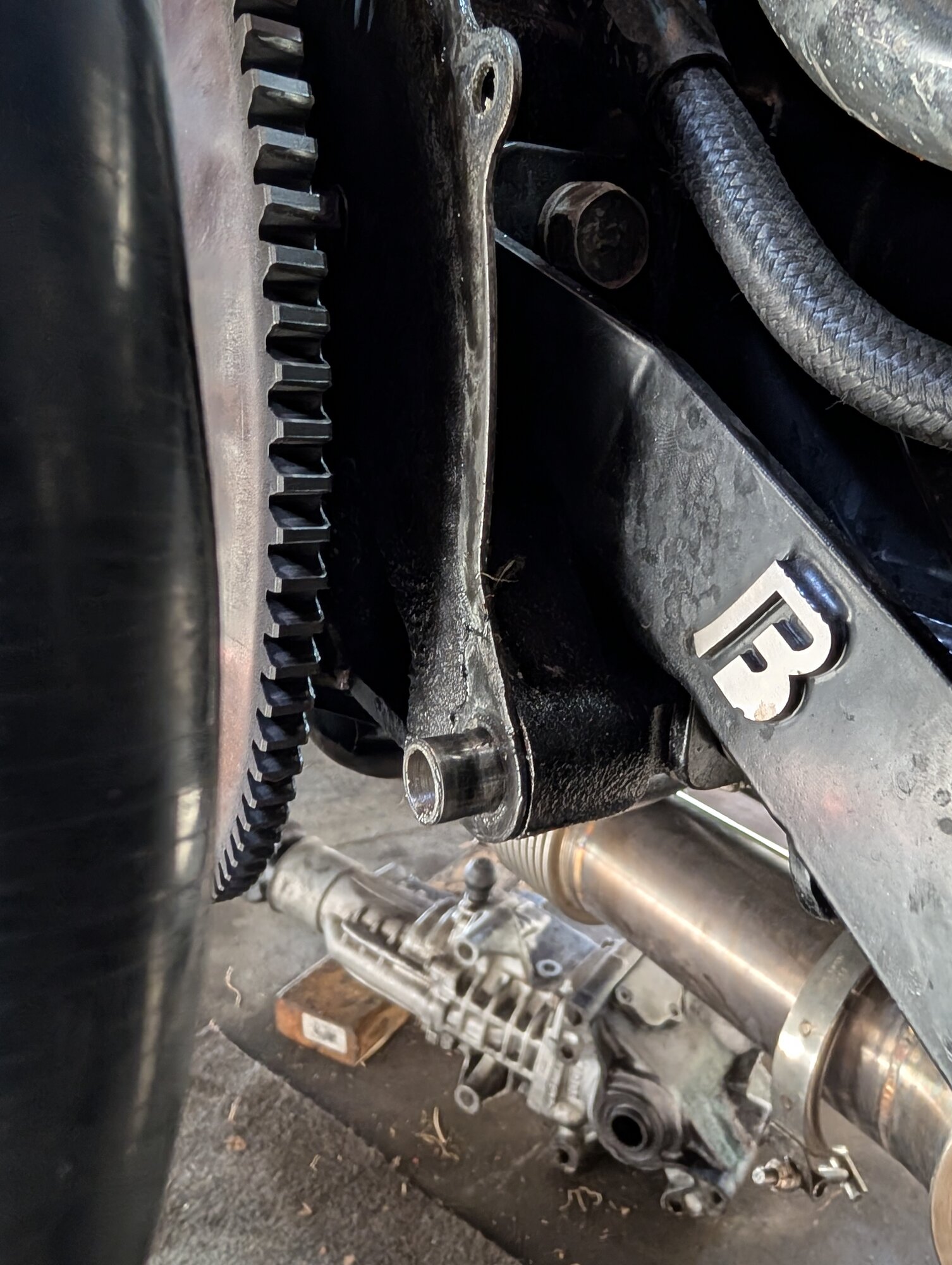

Well its a good thing I enjoyed driving the car as much as i did last week because now the car is shitting the bed.
Car is now not building anything over wastegate pressure and surprise, the alternator is dying again. After about 5 minutes of driving voltage drops to 11.5-6volts and then continues to drop. Tuner and myself think that the low voltage to the ecu is causing it to not activate the boost control solenoid. We're requesting about 31% wastegate duty cycle but only seeing about 15-20psi instead of the 35-40. I replaced the solenoid as well with a new one and still does it afterwards.
ANOTHER new alternator is on the way and while thats on the way, I also bought a new oil pan again and im sending that in to Buschurs to have them the thier baffle mod since the one i have on here doesnt fit quite right. I had my local fab guy weld this one in but it didnt turn out all that good because we didnt really locate the pickup anywhere inside the pan before welding it. Just kind of sent it.
I also bought a new universal replacement power steering line from the reservoir to the pump to try and fix this leak. Its leaking seemingly out of where the line goes over the barb. Ive already got another hose clamp on it but its still leaking.
My JNZ Shifter should be here this Saturday. Im super excited to see how this changes the shifting. I'll post up a before and after video of the throw distance above the console. I honestly could care less about how much it shortens the throw compared to how it makes shifting feel.

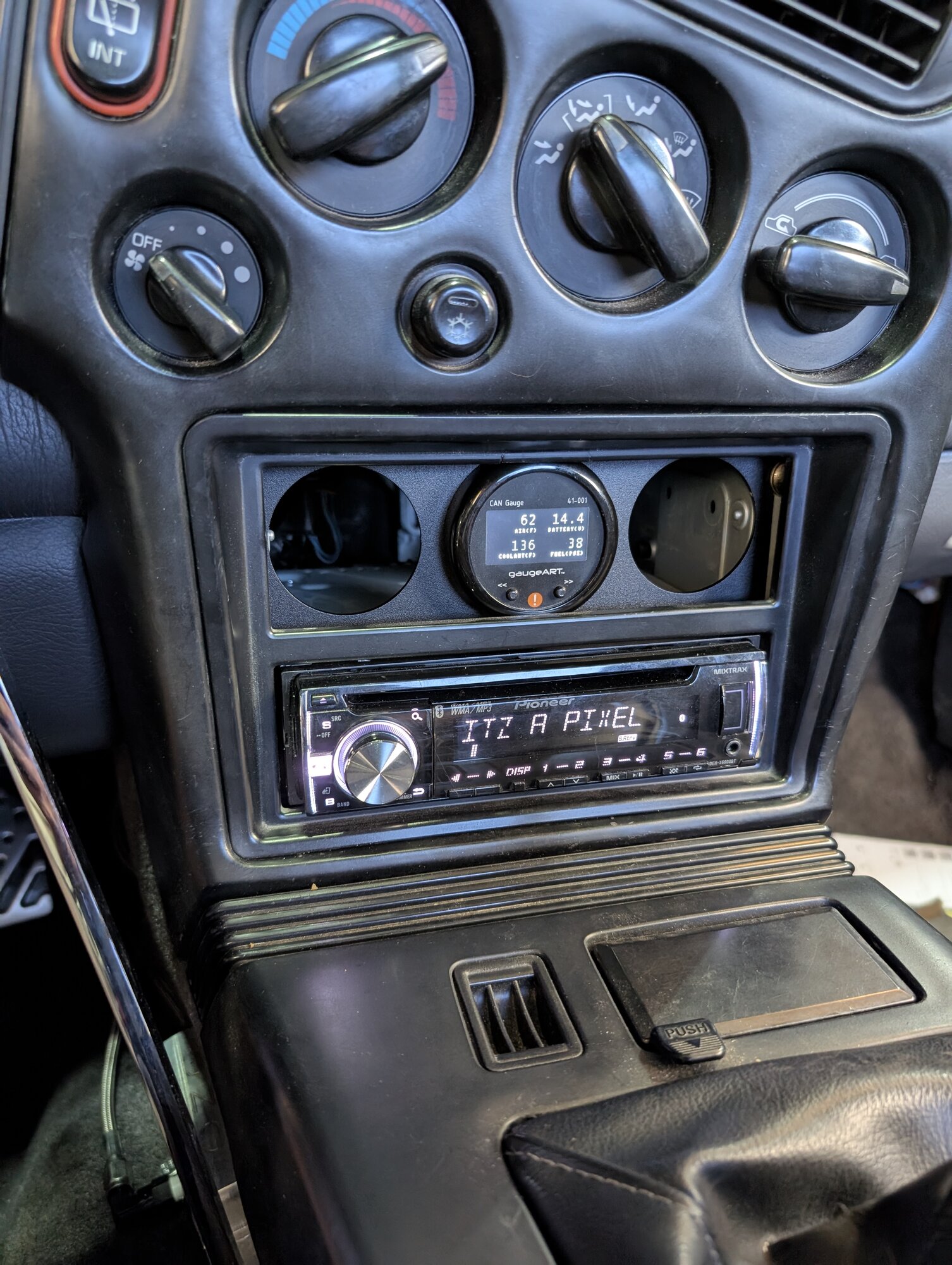

And last little thing is that I installed a different single dinn head unit in the car as well. Its a fairly older one but this one has bluetooth so i can actually play music from my phone on it and i gotta say, the speakers actually sound pretty decent! I was actually surprised.

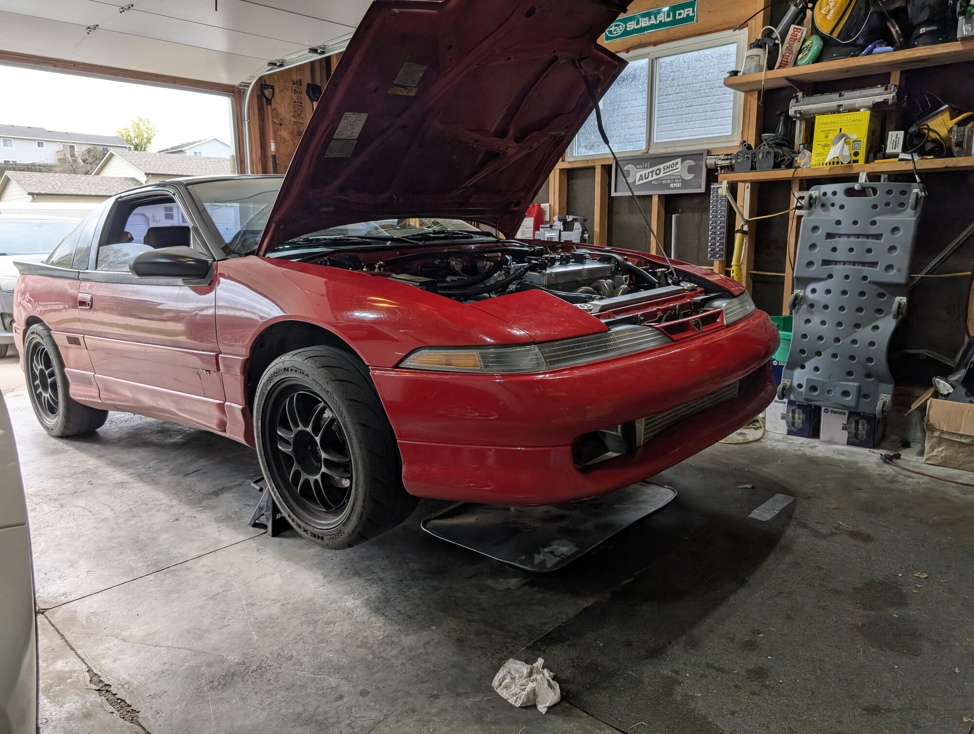

Anyways, plans for the car right now is get the trans pulled, which almost everything up top is basically done, all thats left right now is t-case, exhaust, slave cylinder, drain the trans, axles, then trans bolts and she's ready to drop out.
Obviously while its out, the rear main seal, new oil pan, shifter will all be getting installed.

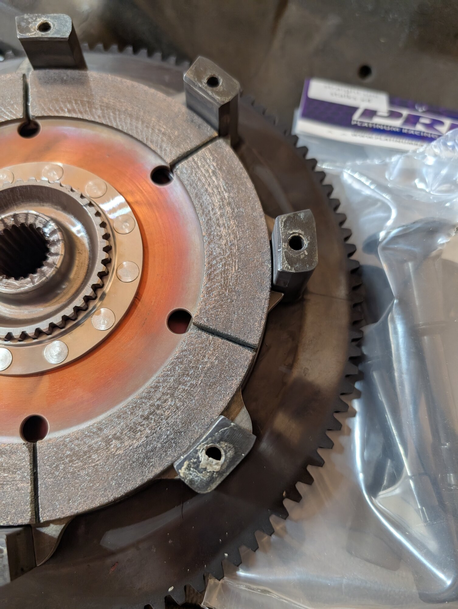

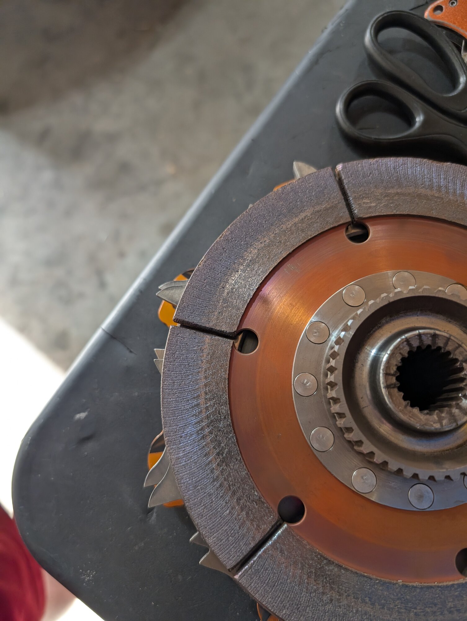

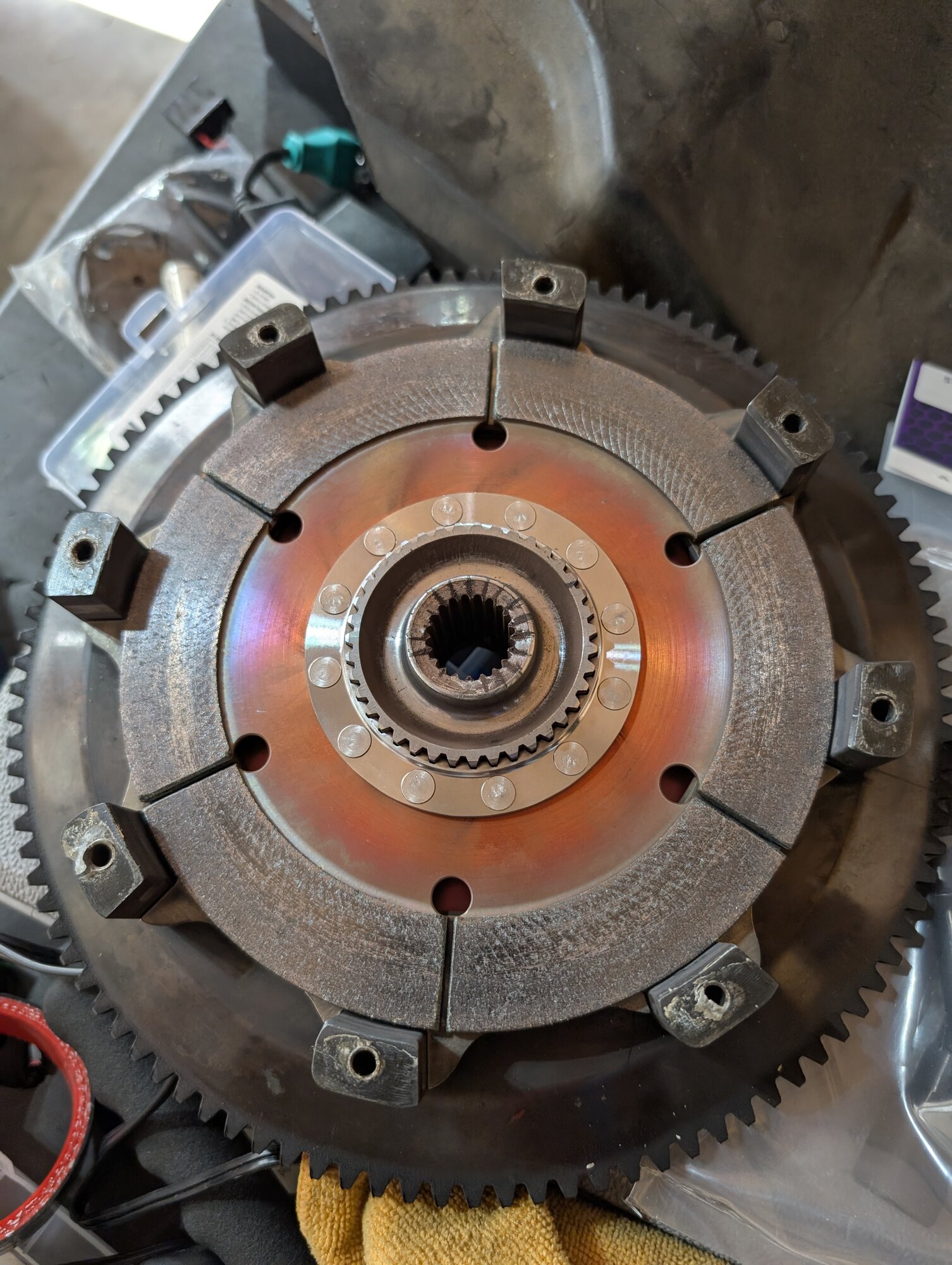

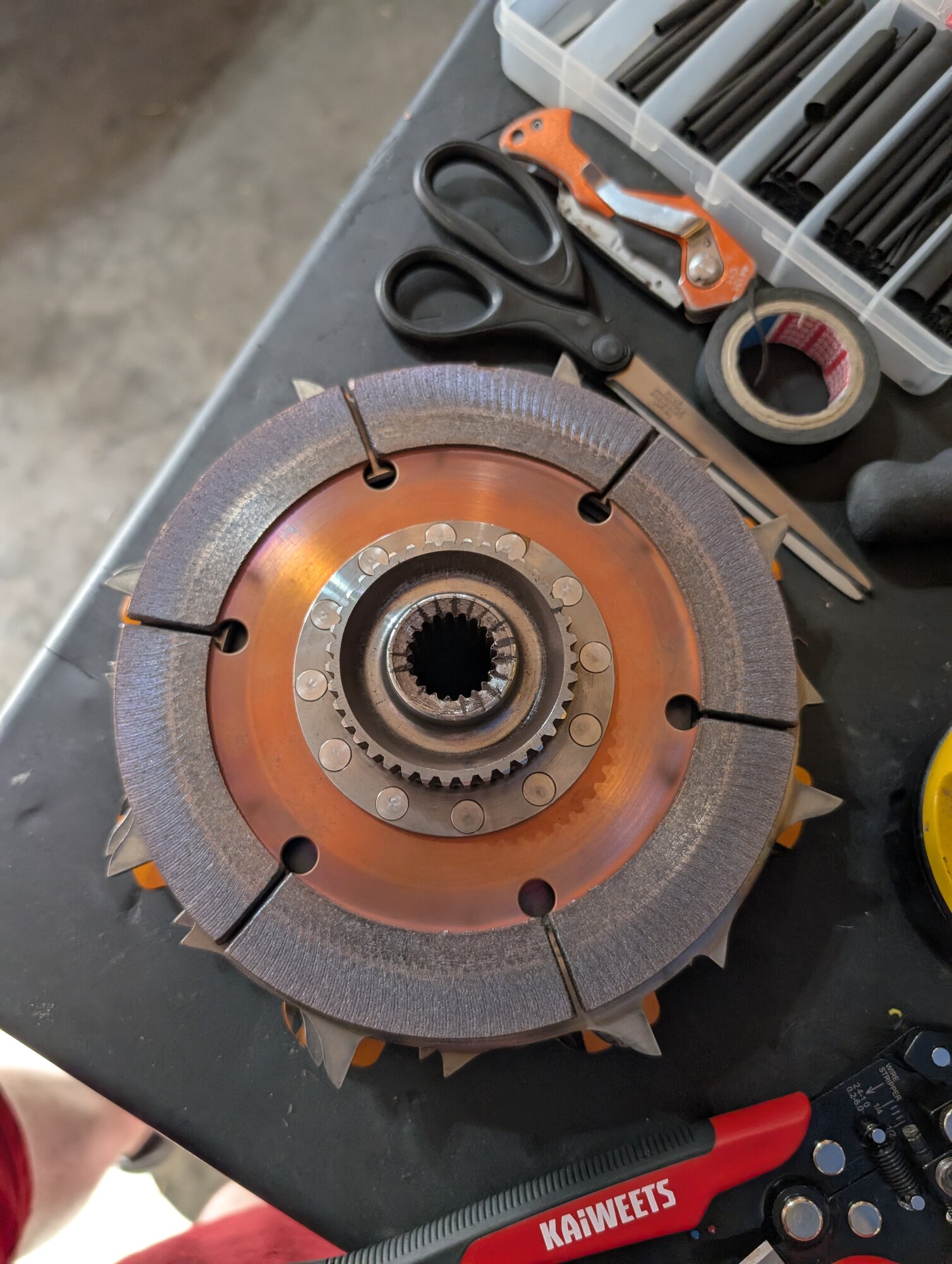

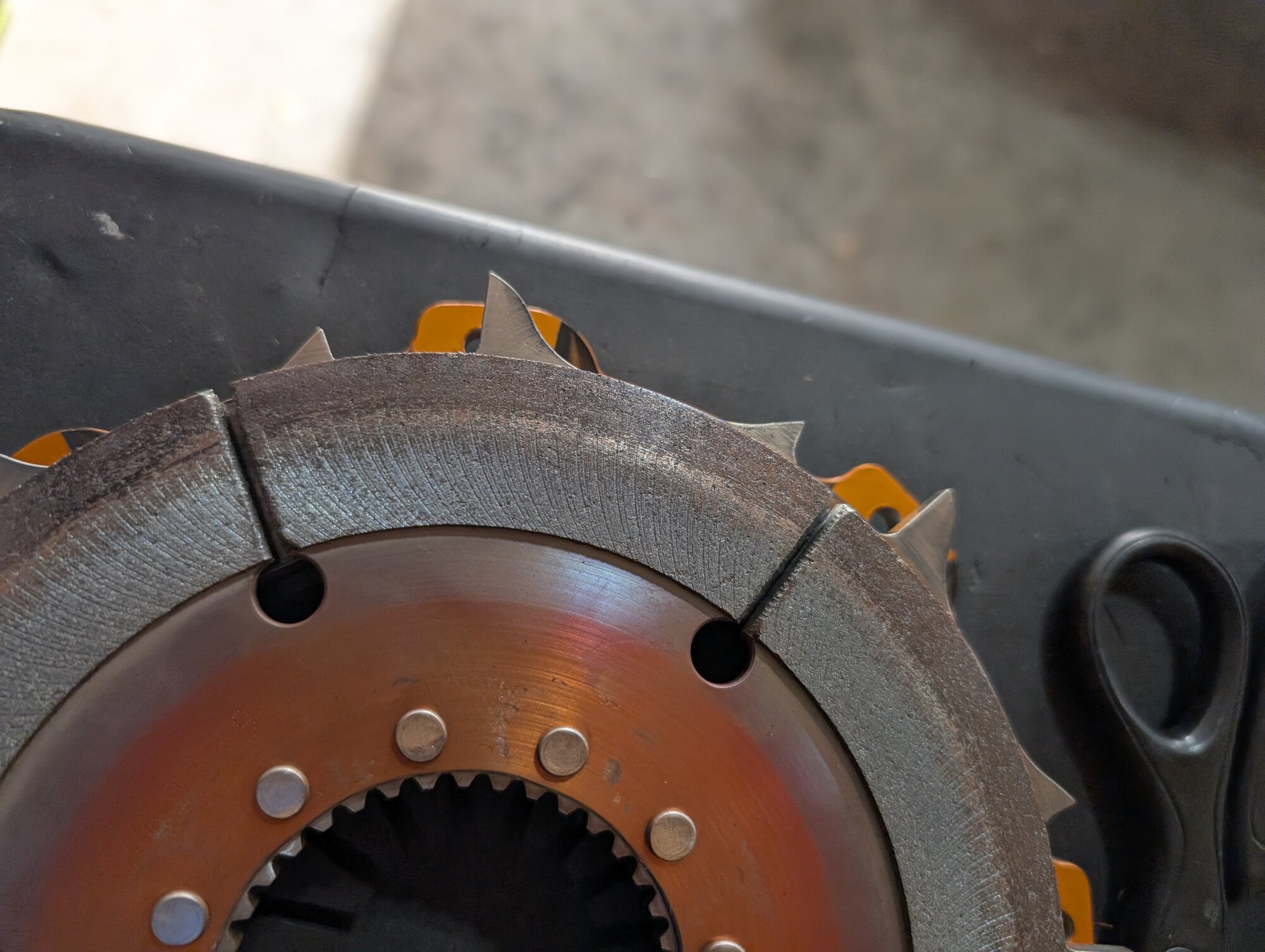

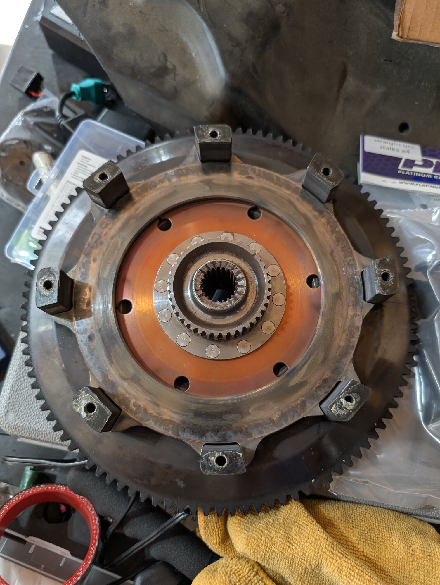

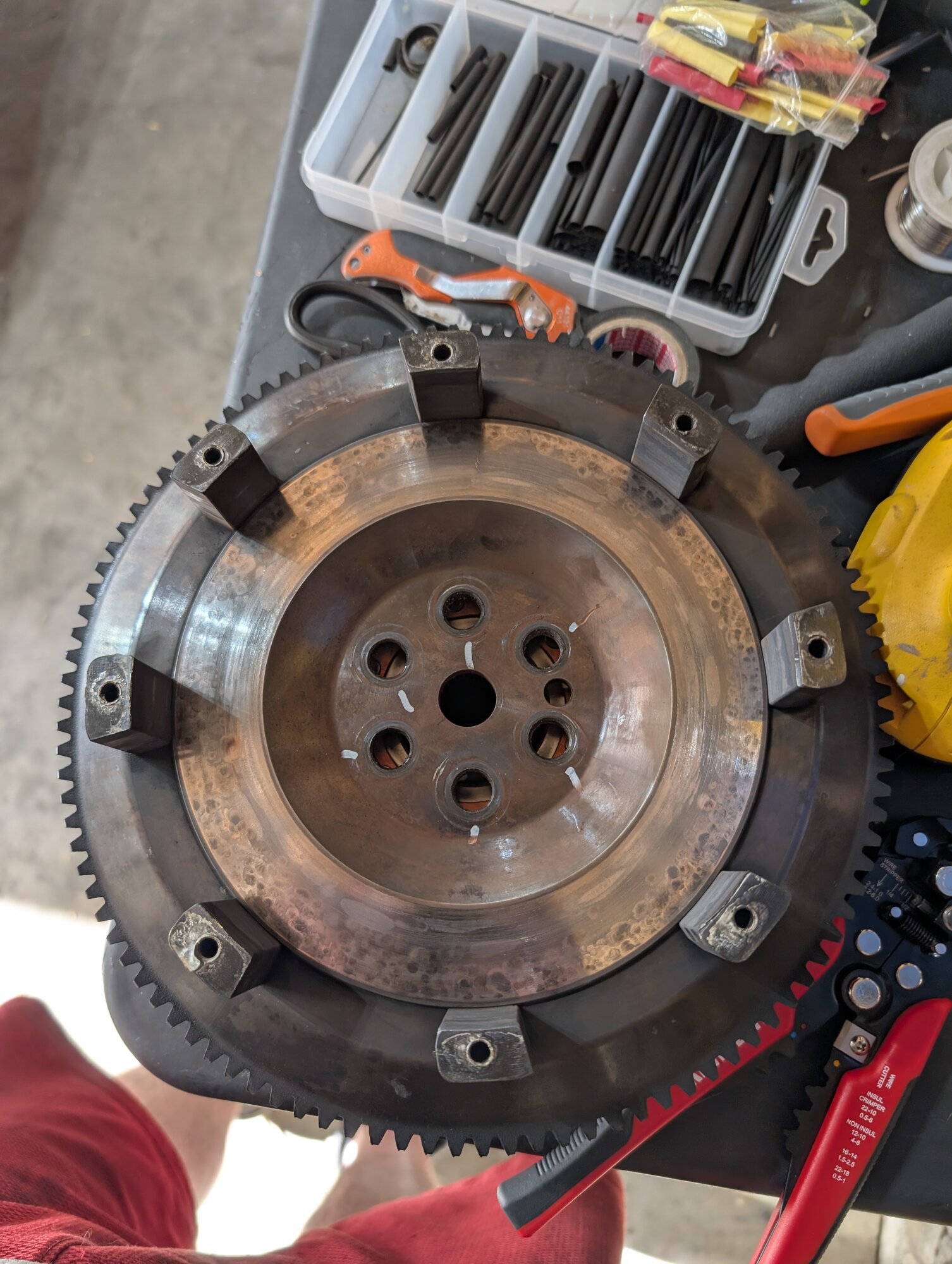

Well replacing the rear man I think was the correct move. Obviously as you can see there's definitely been some oil back here. For how long? Hopefully not long.
PXL_20250507_231724534.jpgPXL_20250507_231729111.jpgPXL_20250507_231804269.jpgPXL_20250507_234914448.jpgPXL_20250507_235101788.jpg

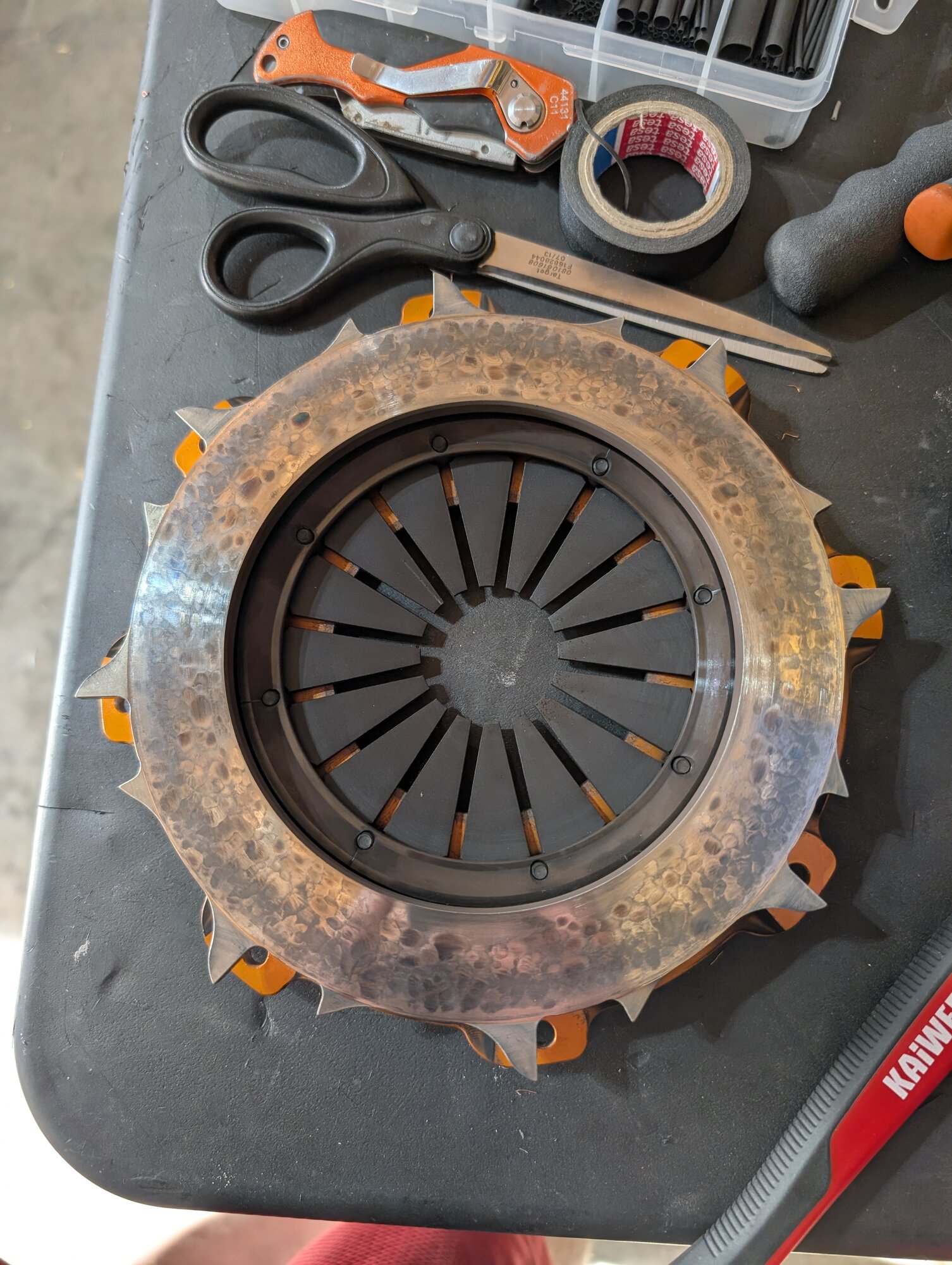

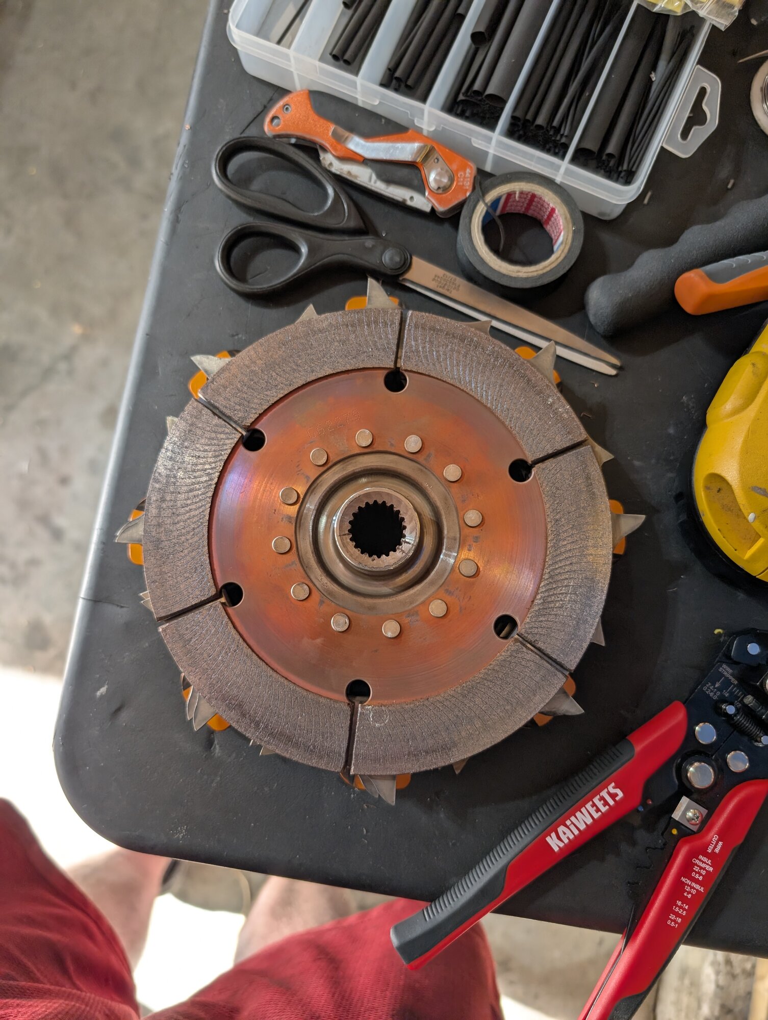

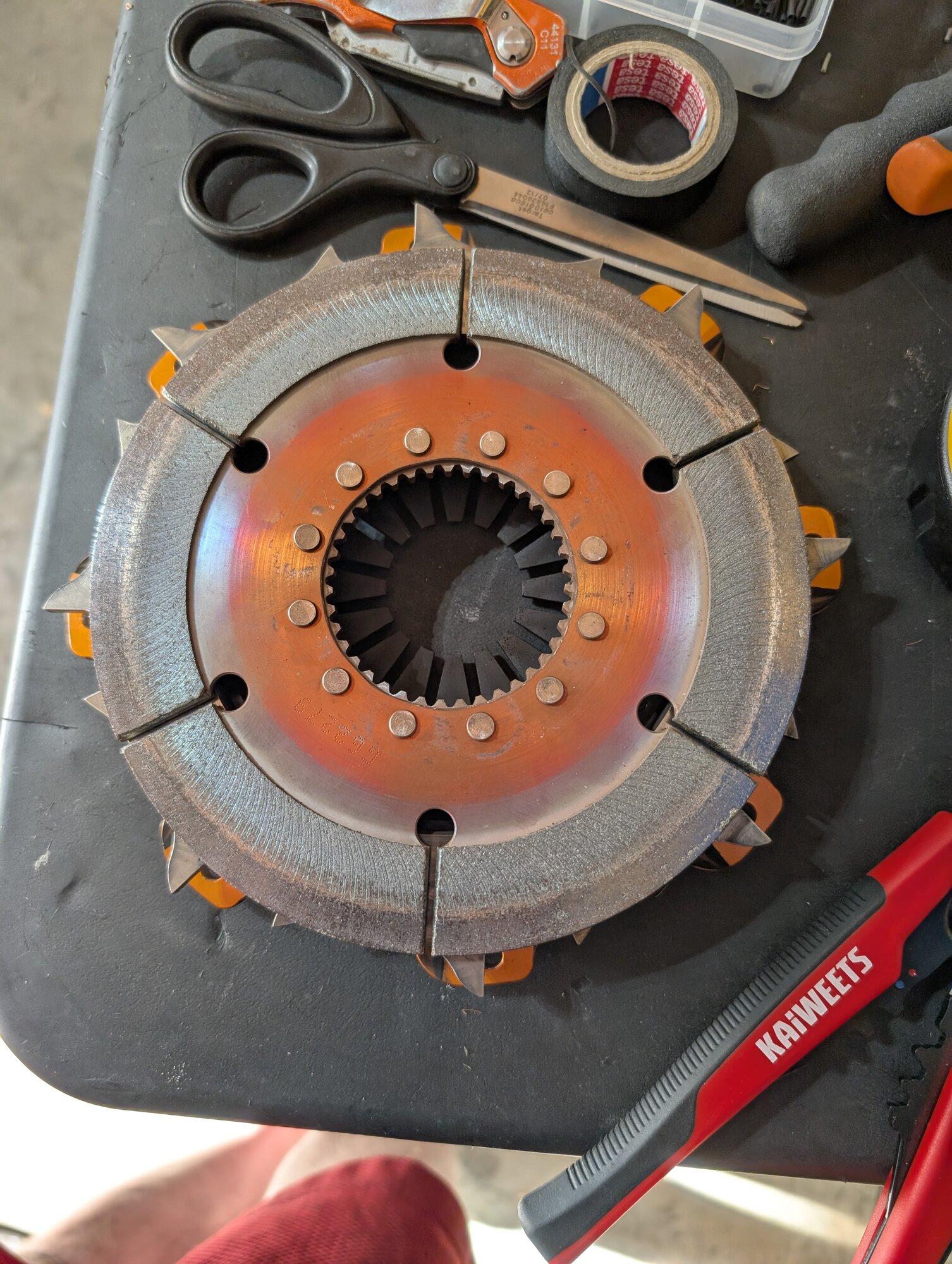

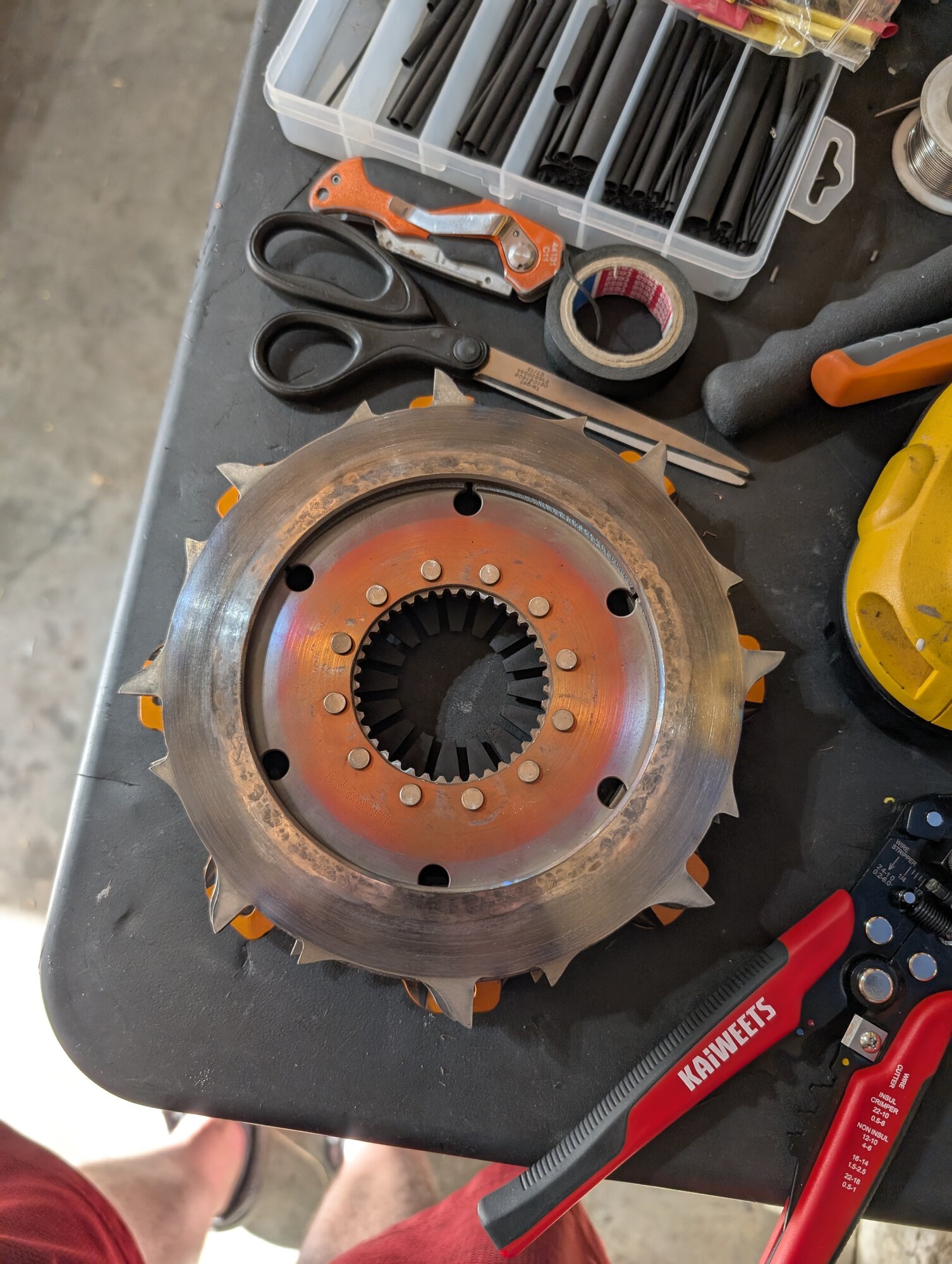

If anyone has got some advice on if this clutch wear is normal I'm all ears. Doesn't look like it got too hot at all IMO but I'm new to twin disks. I might make a whole new post for the transmission gods of the forum to get their input. It's just odd that one of the disks has wear on the inside of the friction disks and the other has wear on the outside. I'm worried that maybe oil got on the disks?
