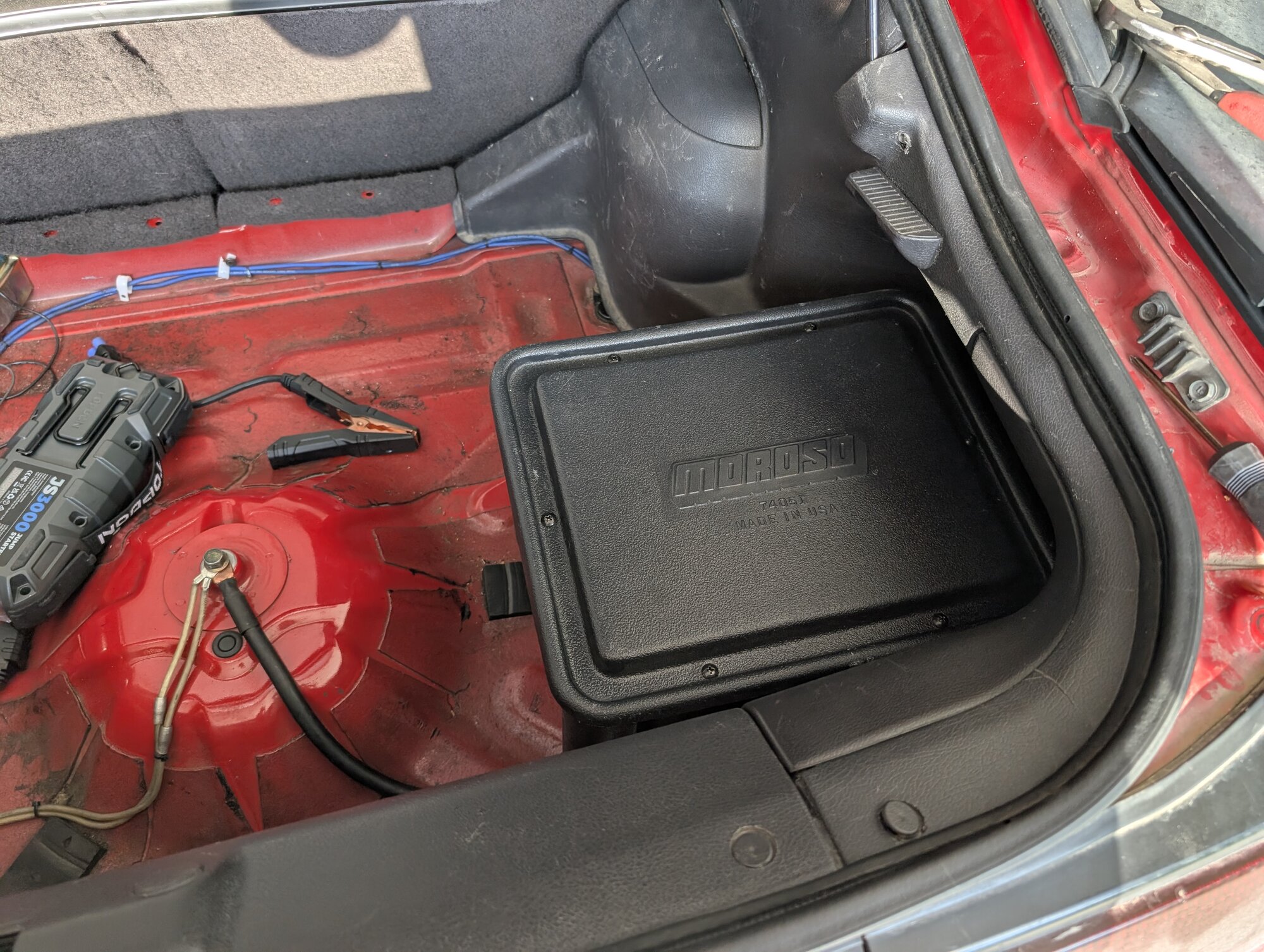

I got the battery box bolted down to the chassis of the car again so now the battery and box are sliding around everywhere anymore.

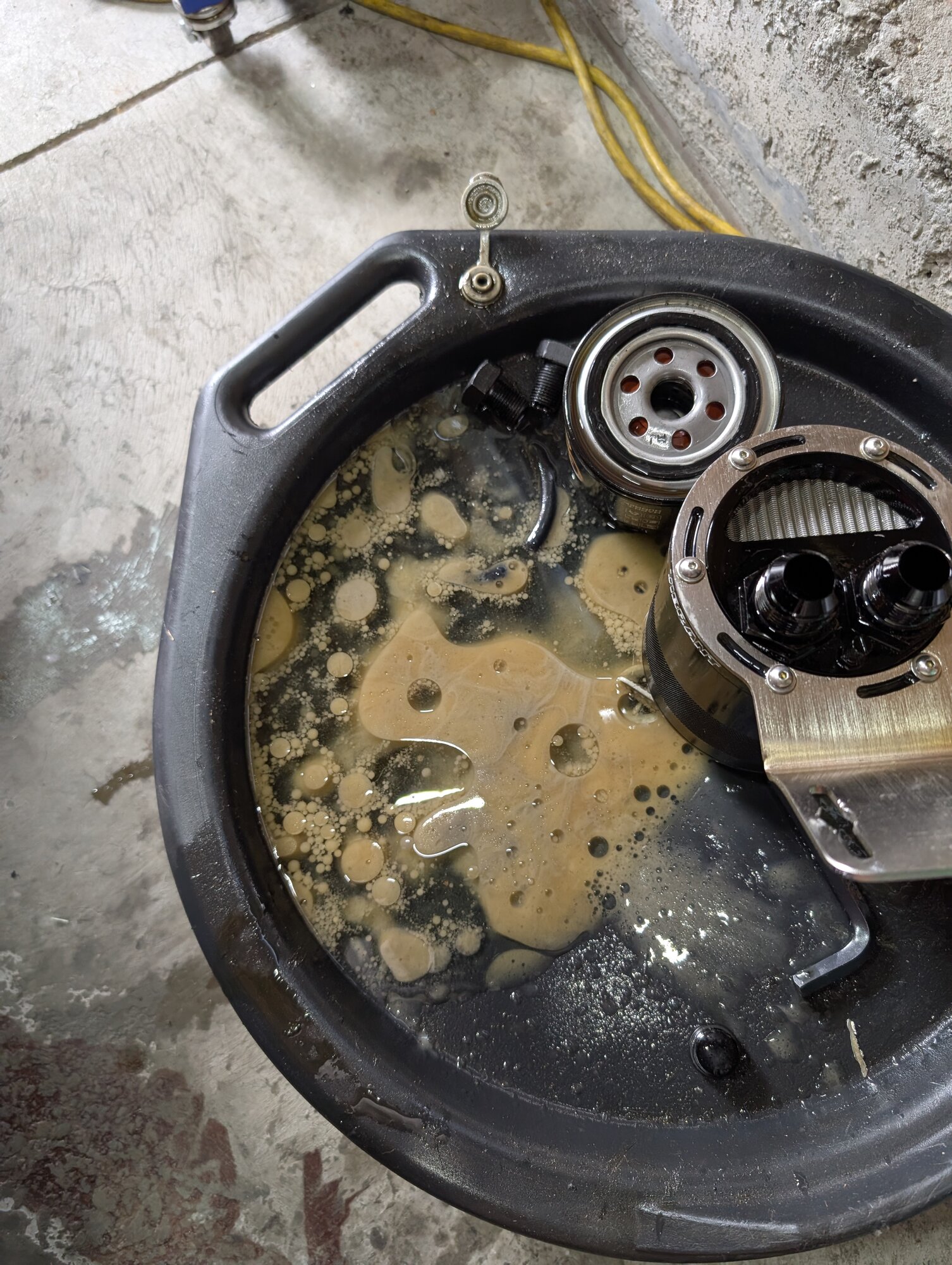

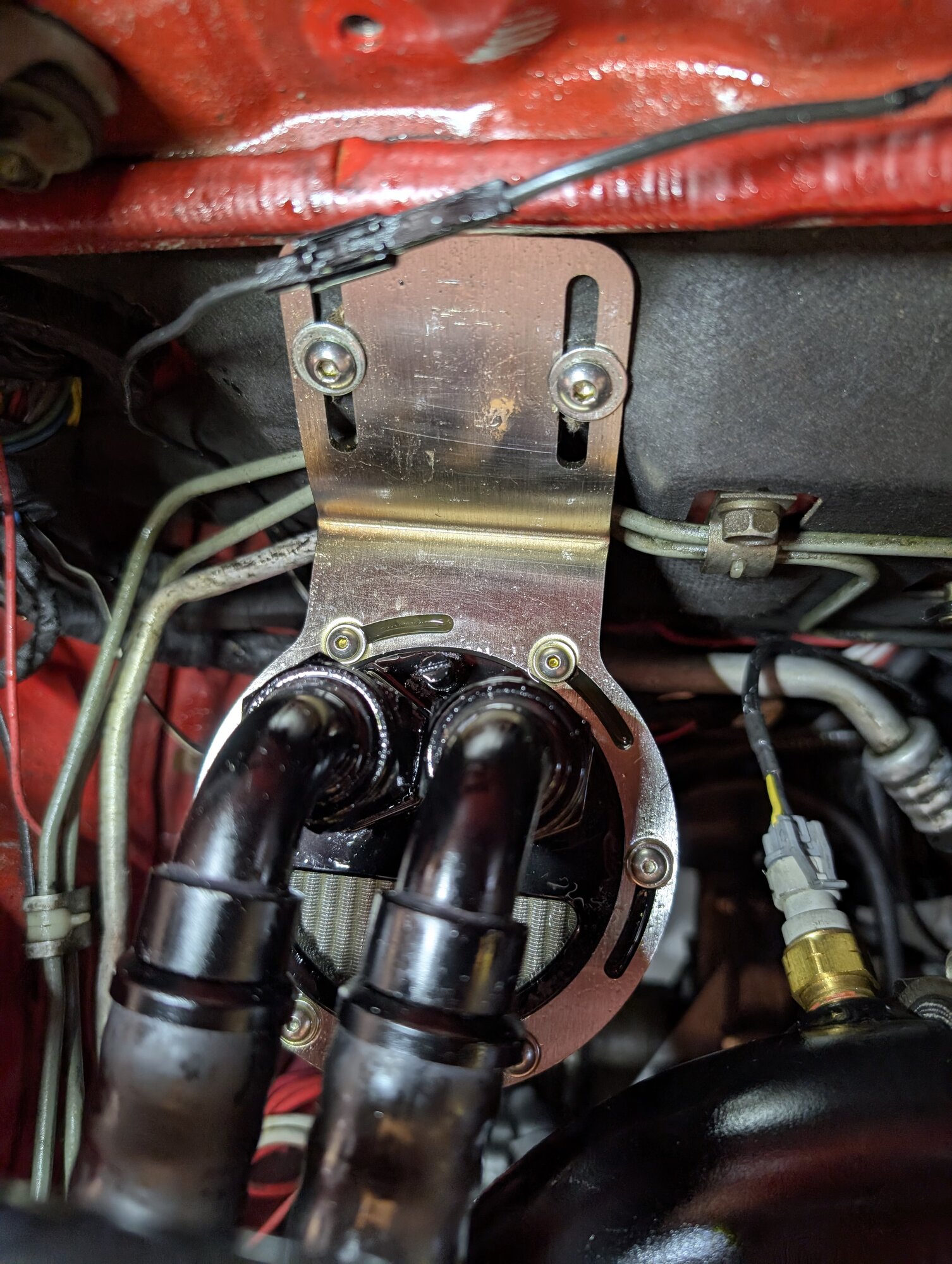

This week specifically i noticed more oil around the catch can area than normal so i decided to look into it. Turns out it was pretty much full so it was coming out of the vent a bit. Got that emptied and it was pretty nasty.

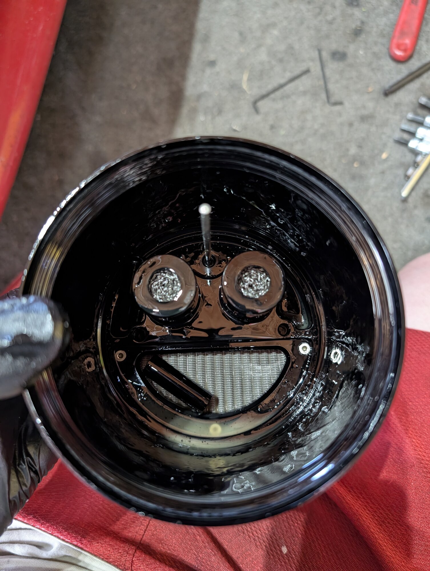

I also pulled the whole can apart and stuffed some more stainless baffling. There was basically zero baffling media in there, just a tiny bit inside the inlets of the catch can. Pretty disappointing honestly.

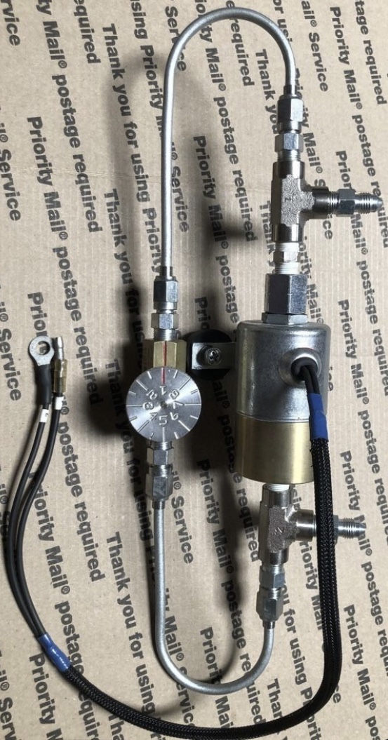

I picked something up from the classifieds here. A clutch slipper valve. I'll get it hooked up to the ECU and clutch line so that the solenoid will activate with launch control and control the rate of release of the clutch and should have some decent 60' times.
