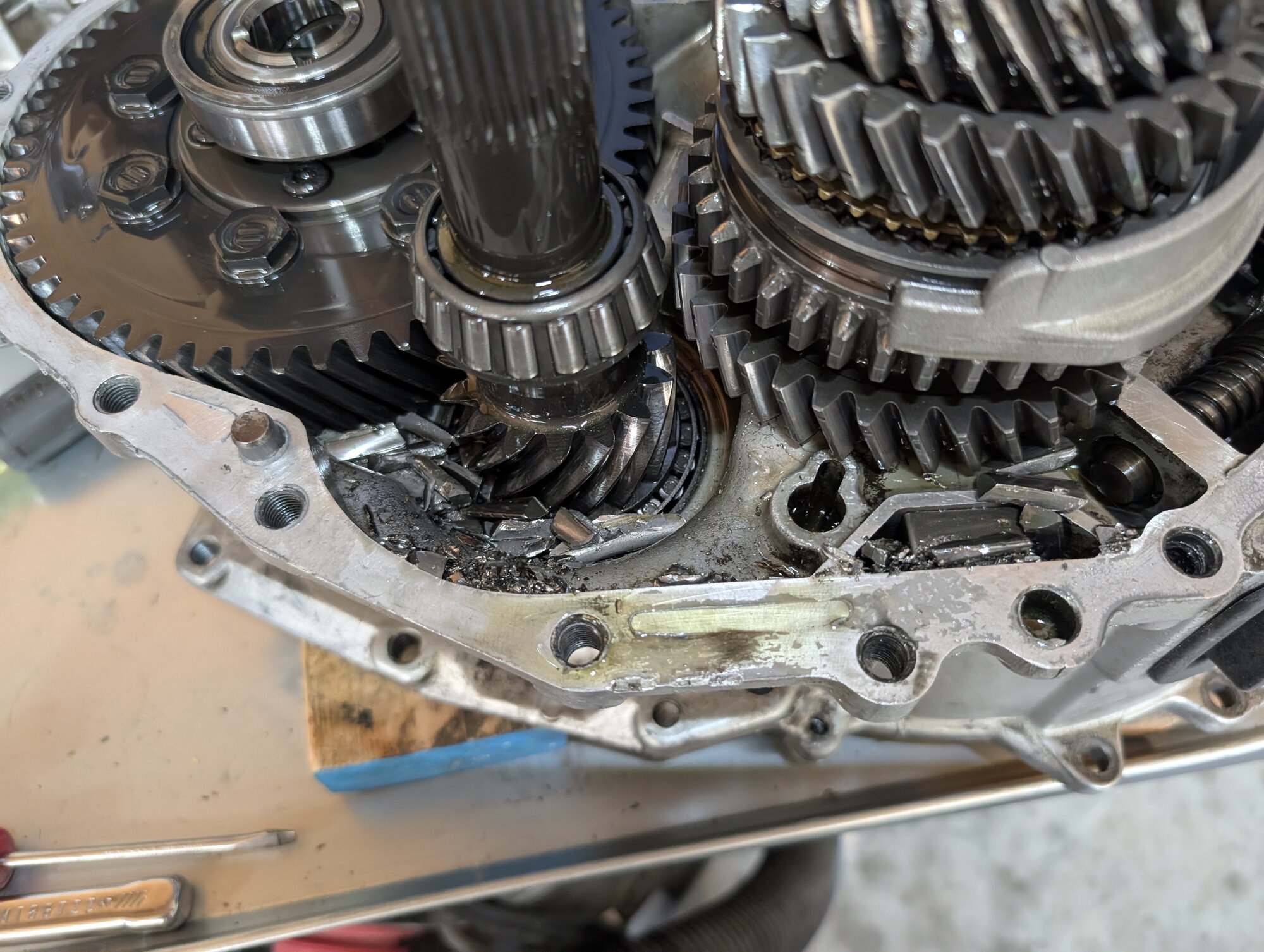

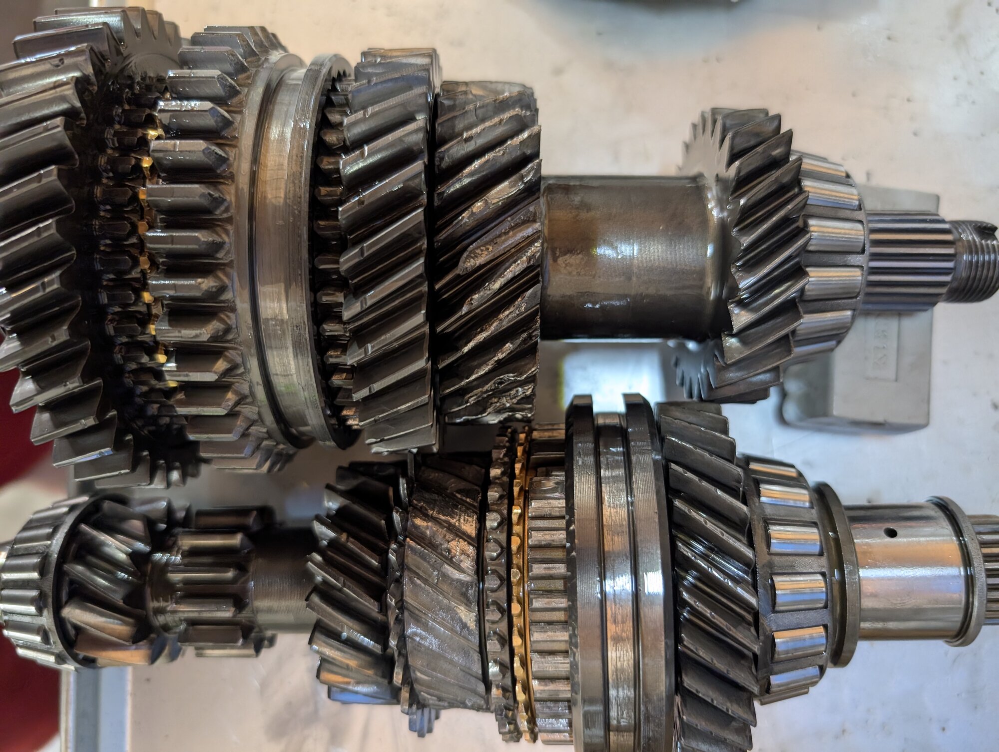

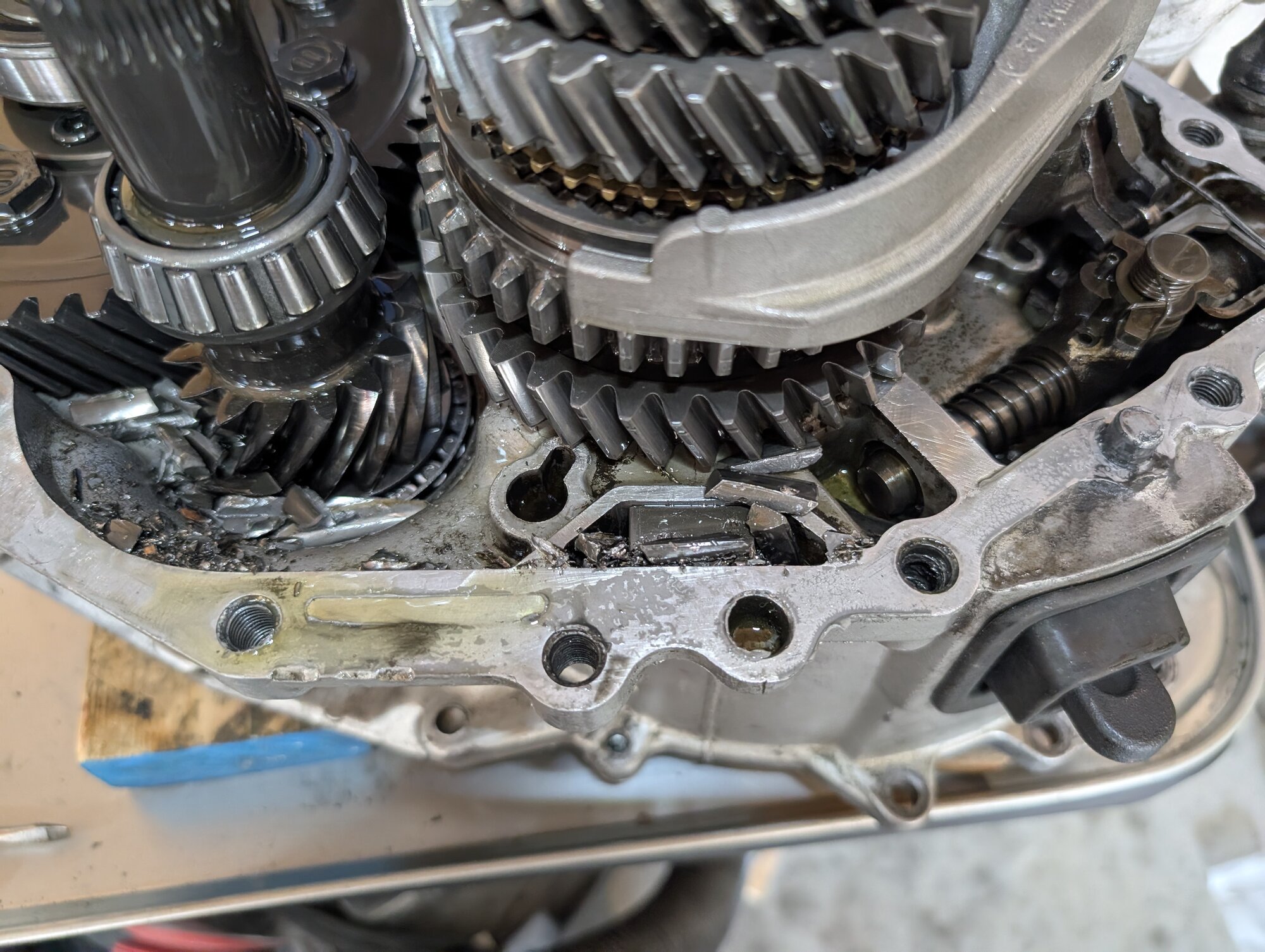

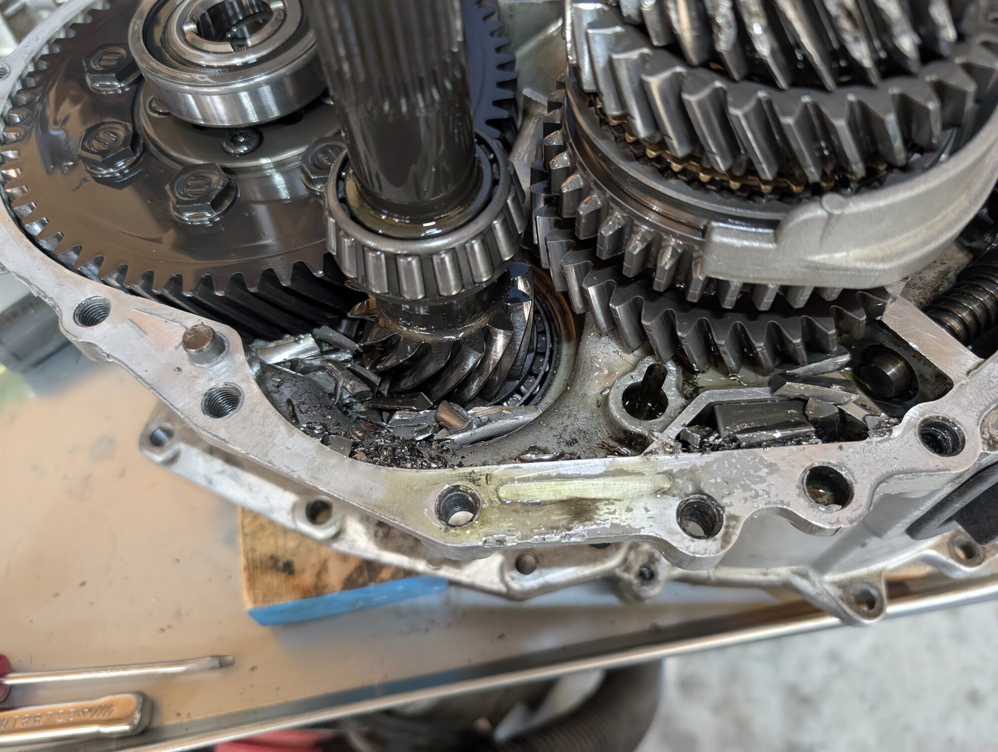

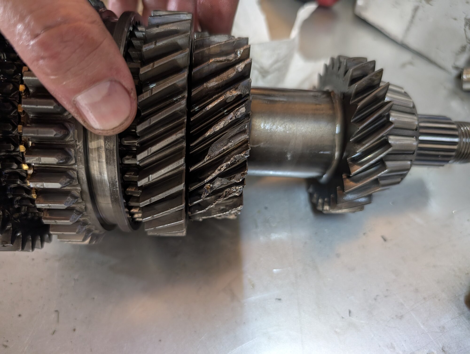

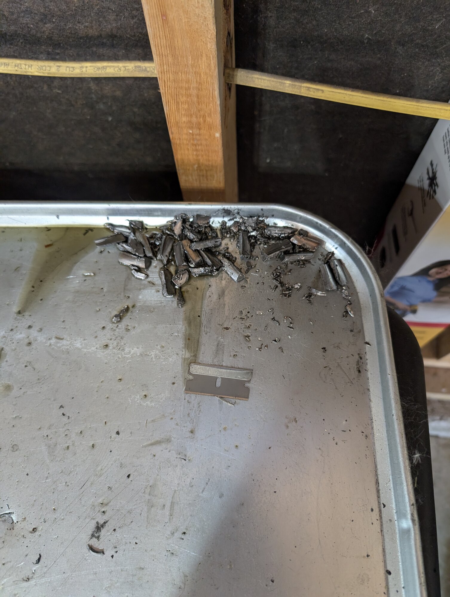

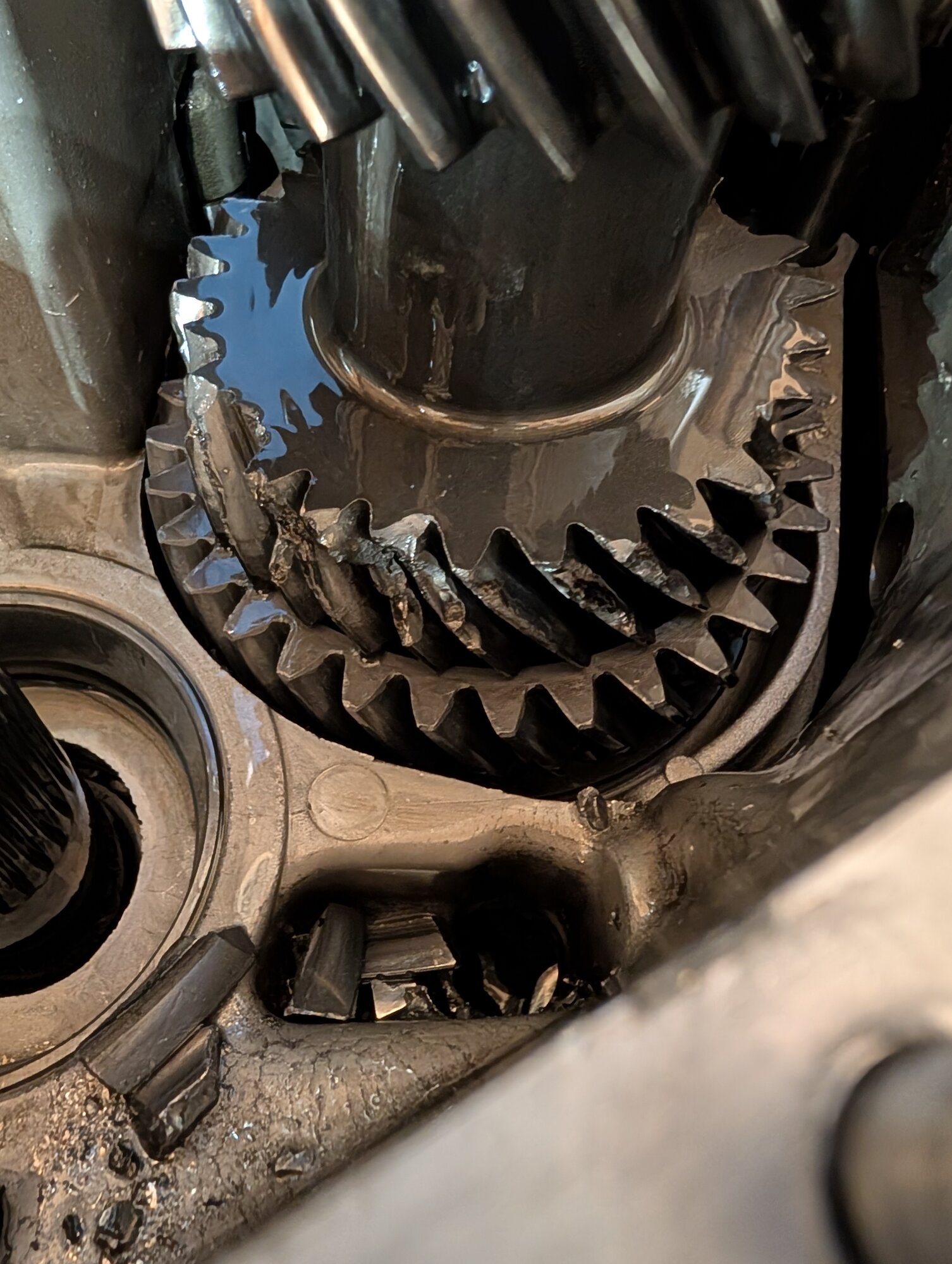

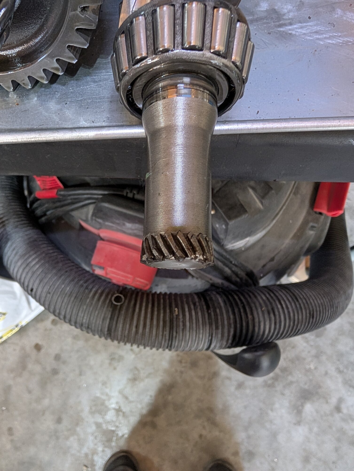

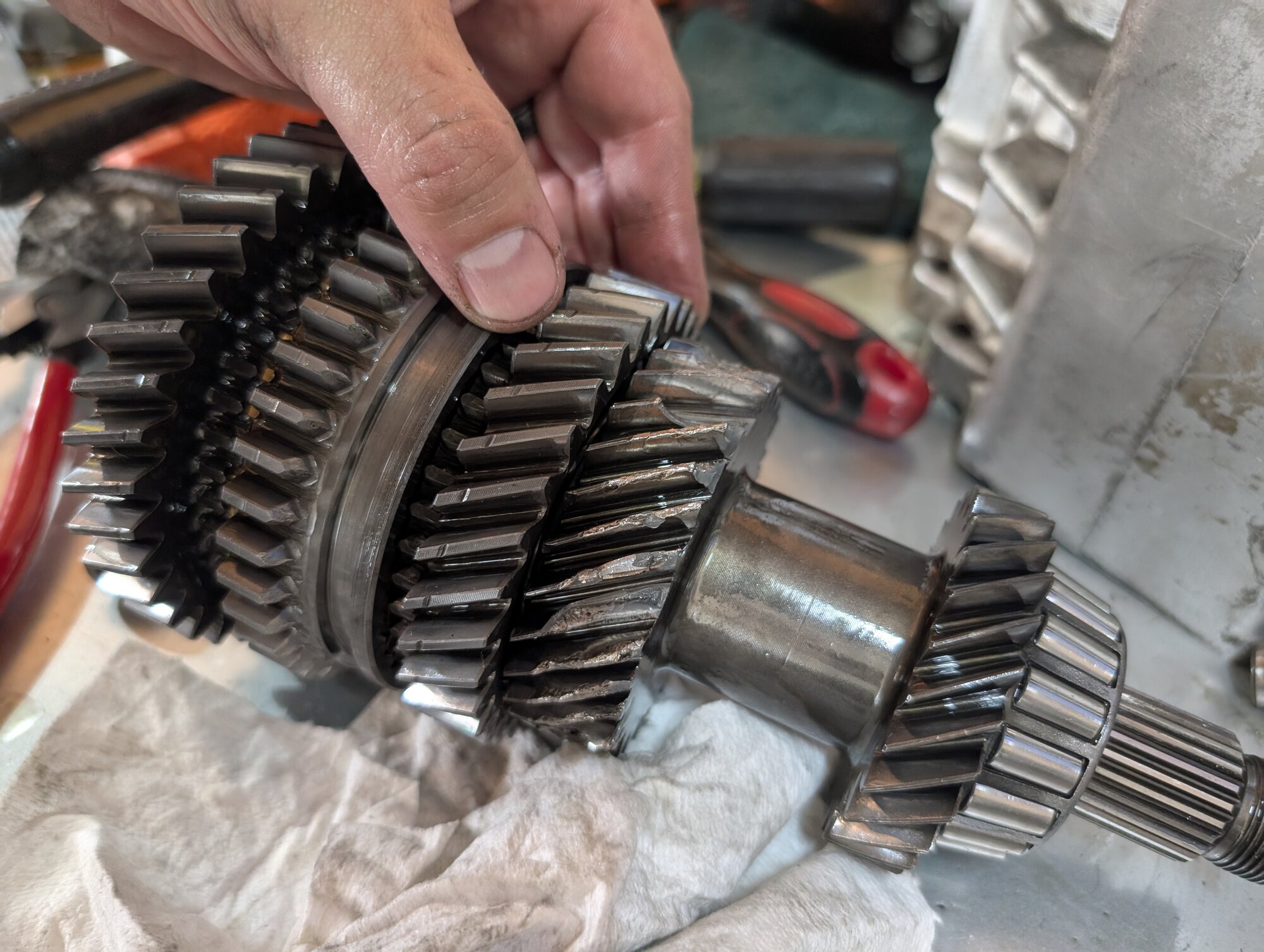

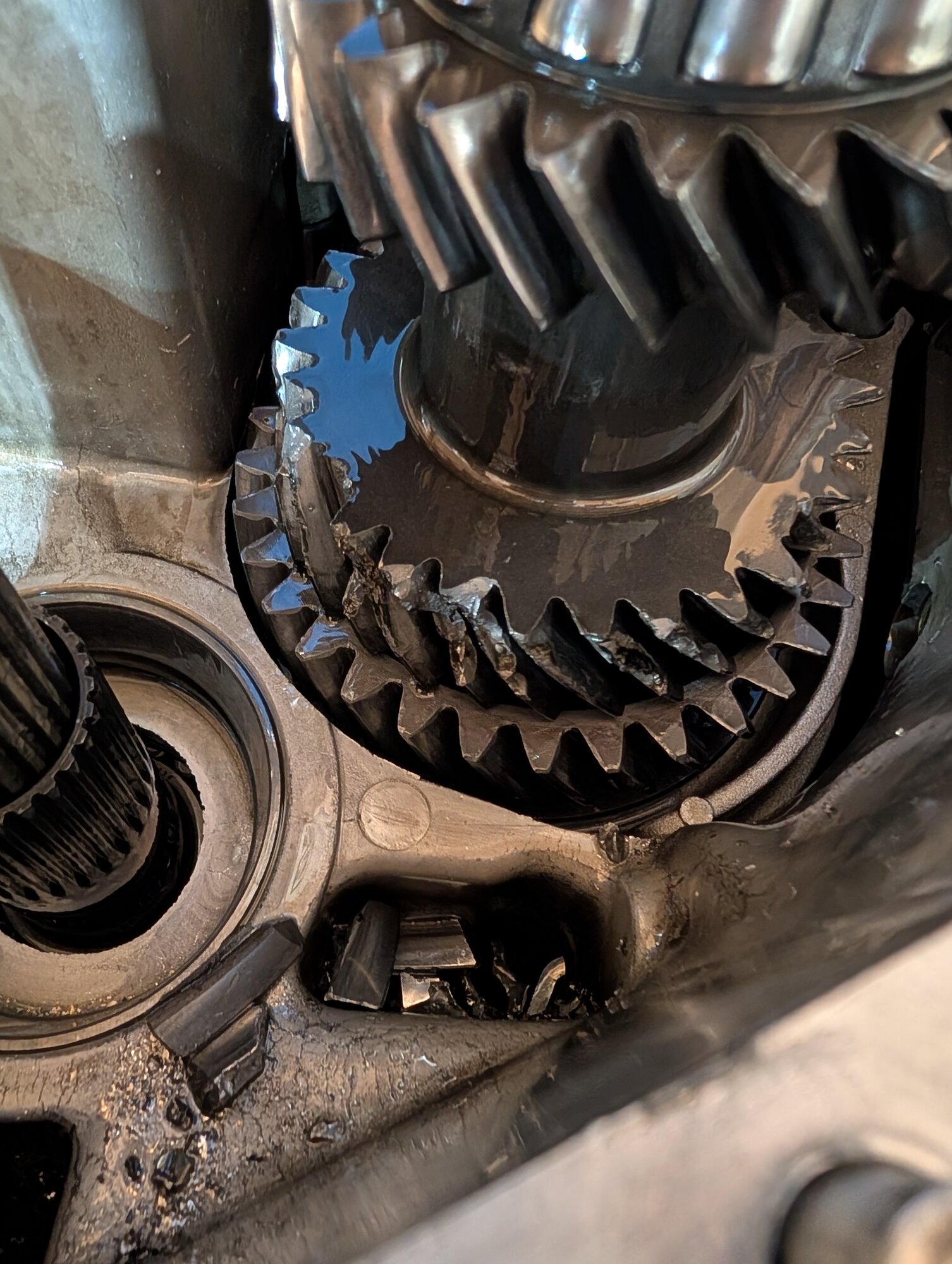

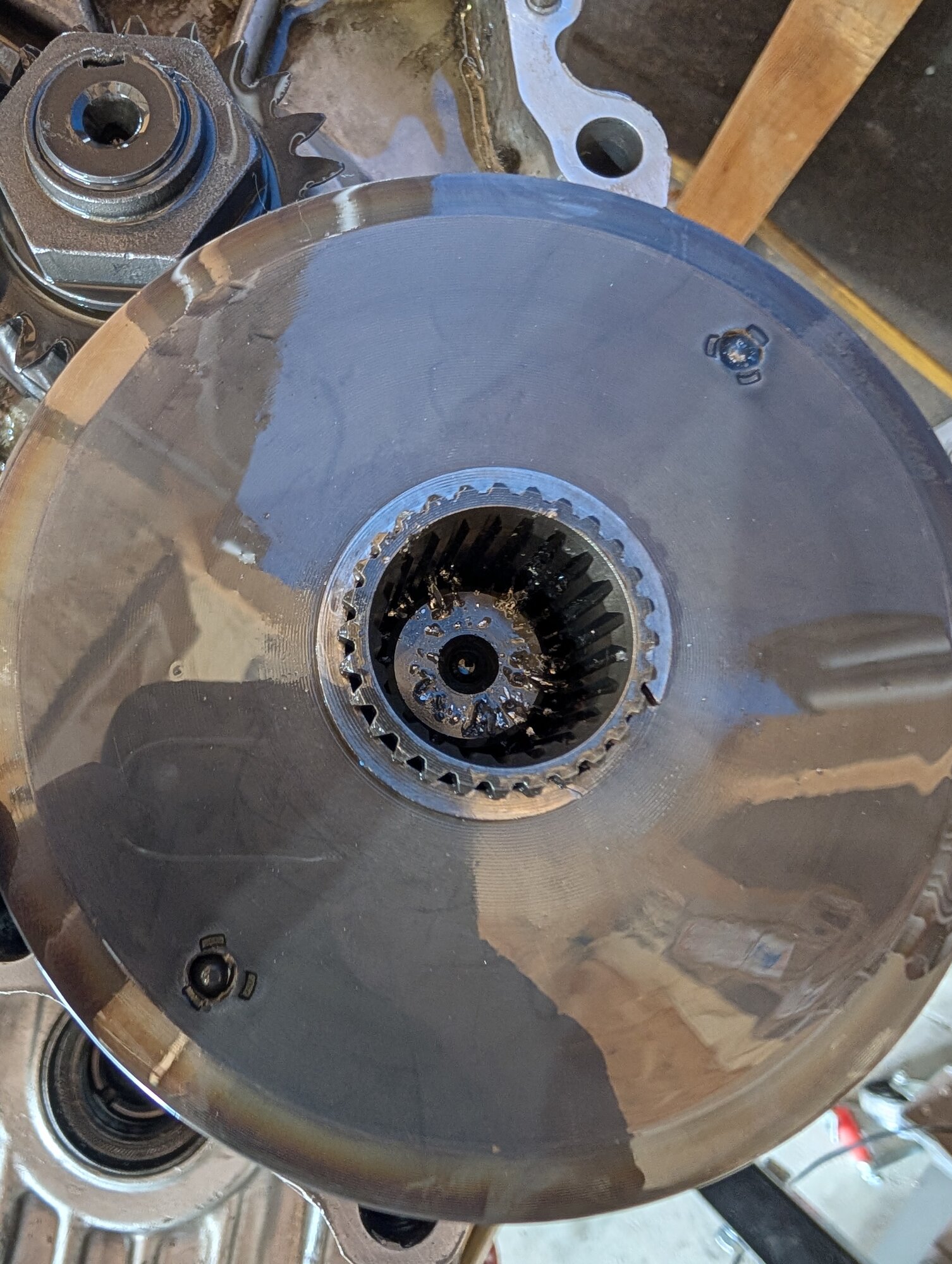

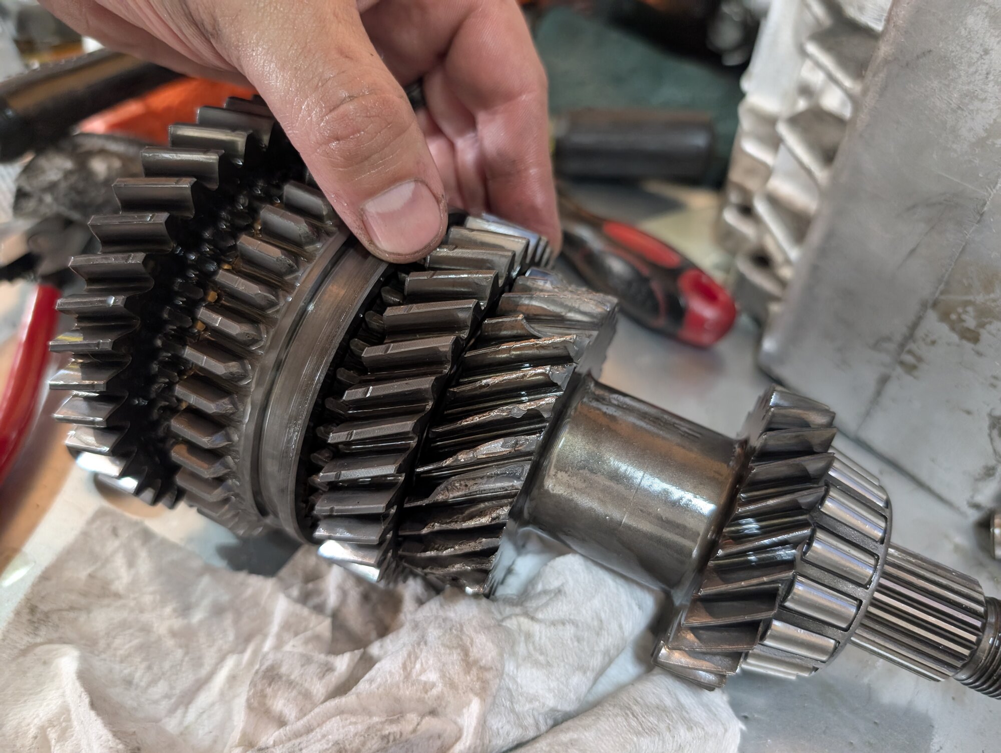

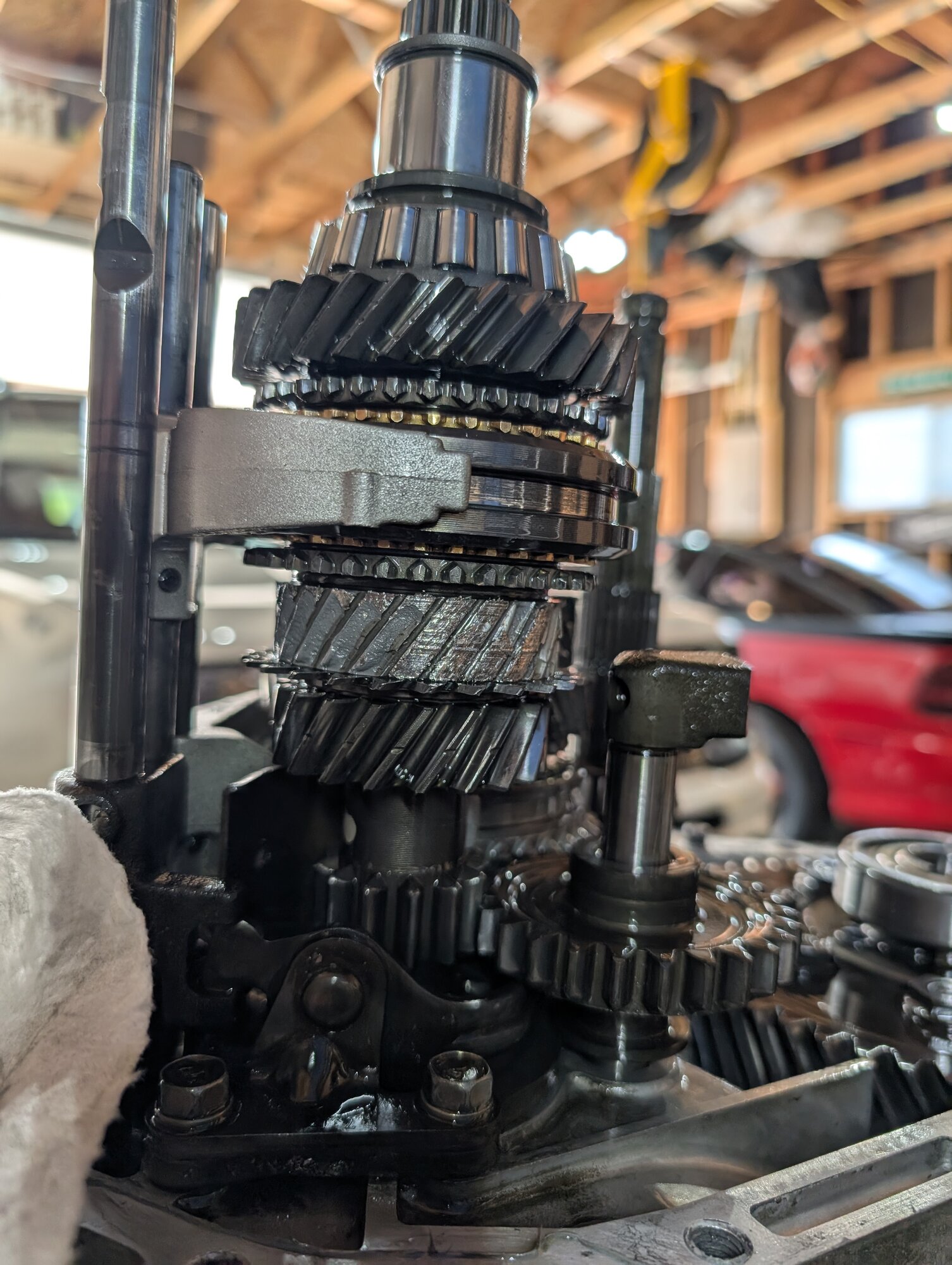

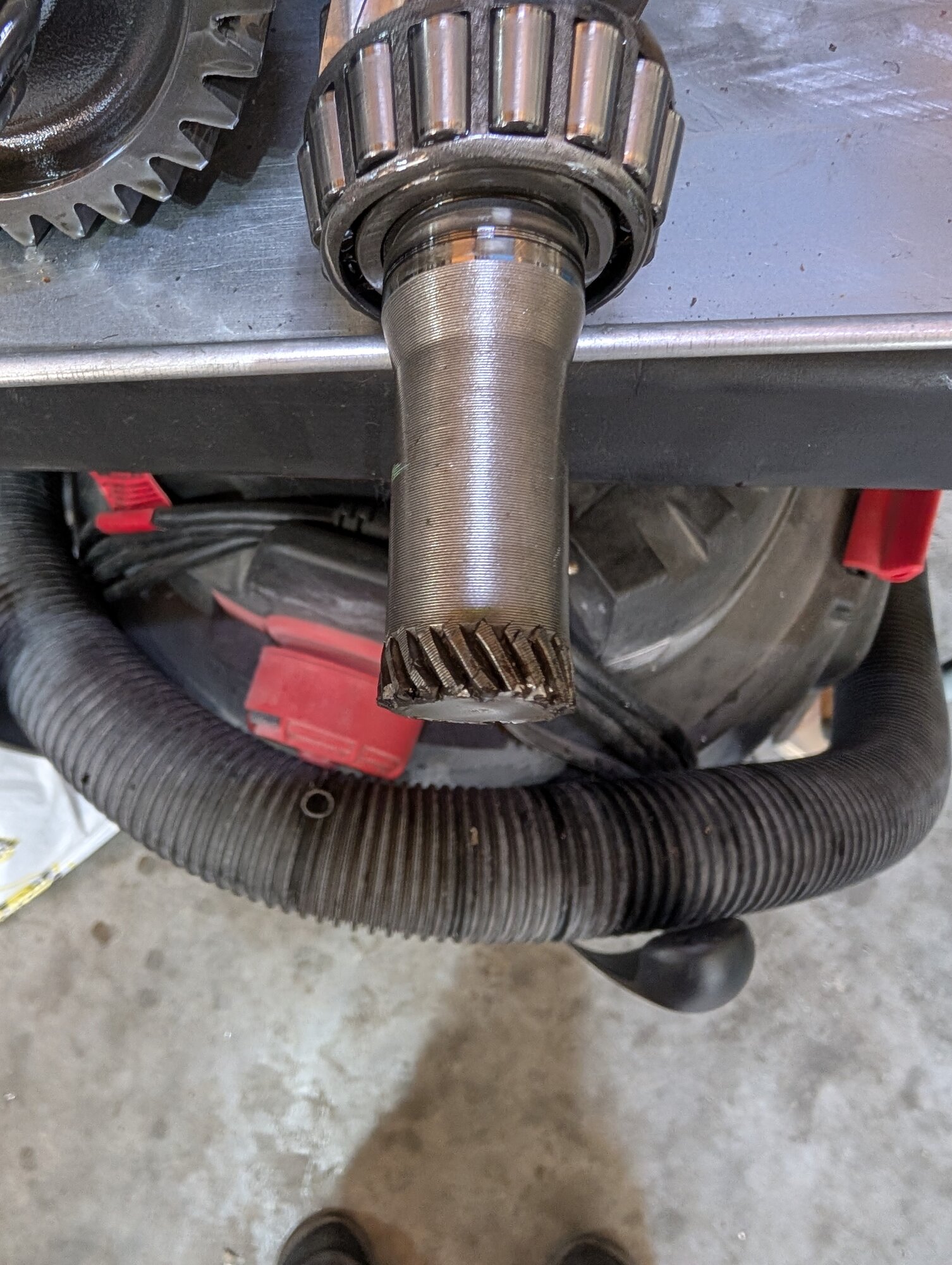

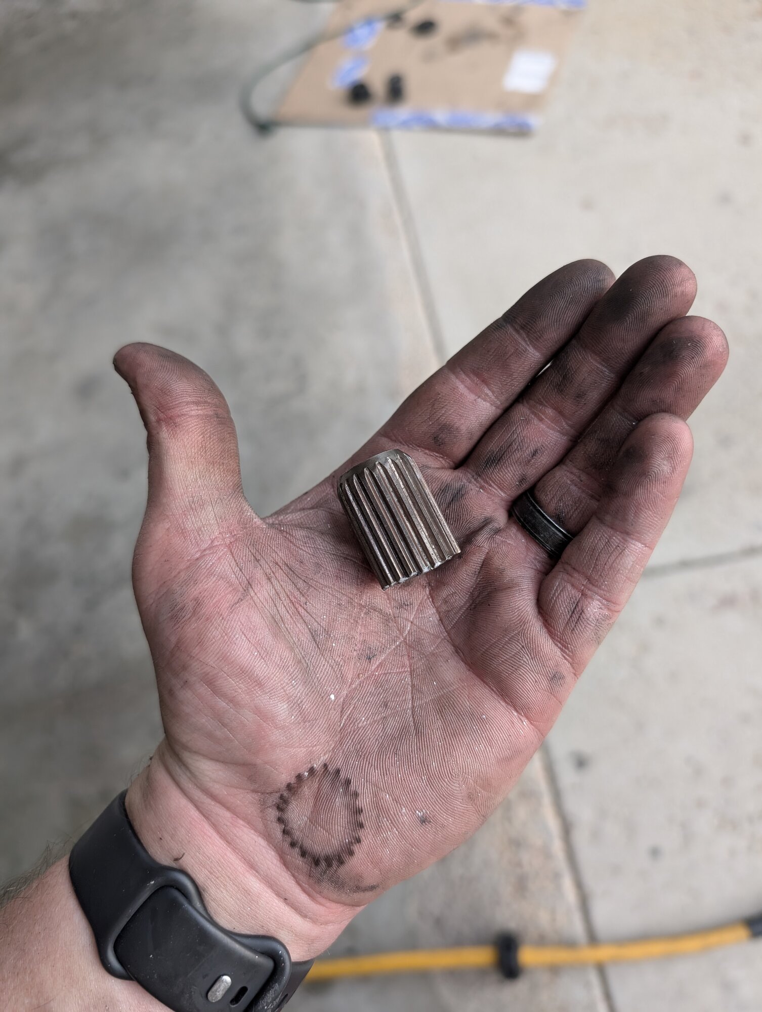

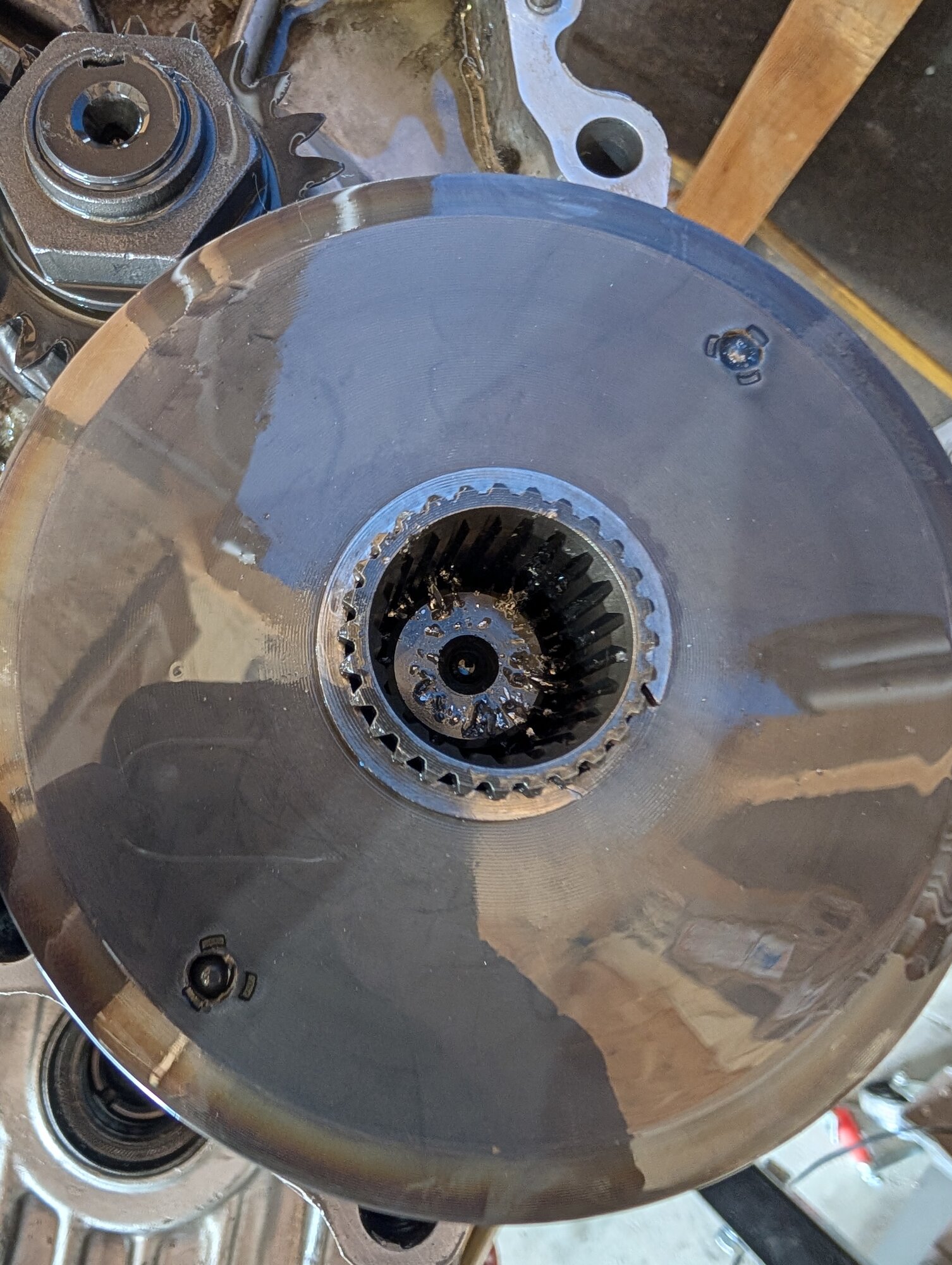

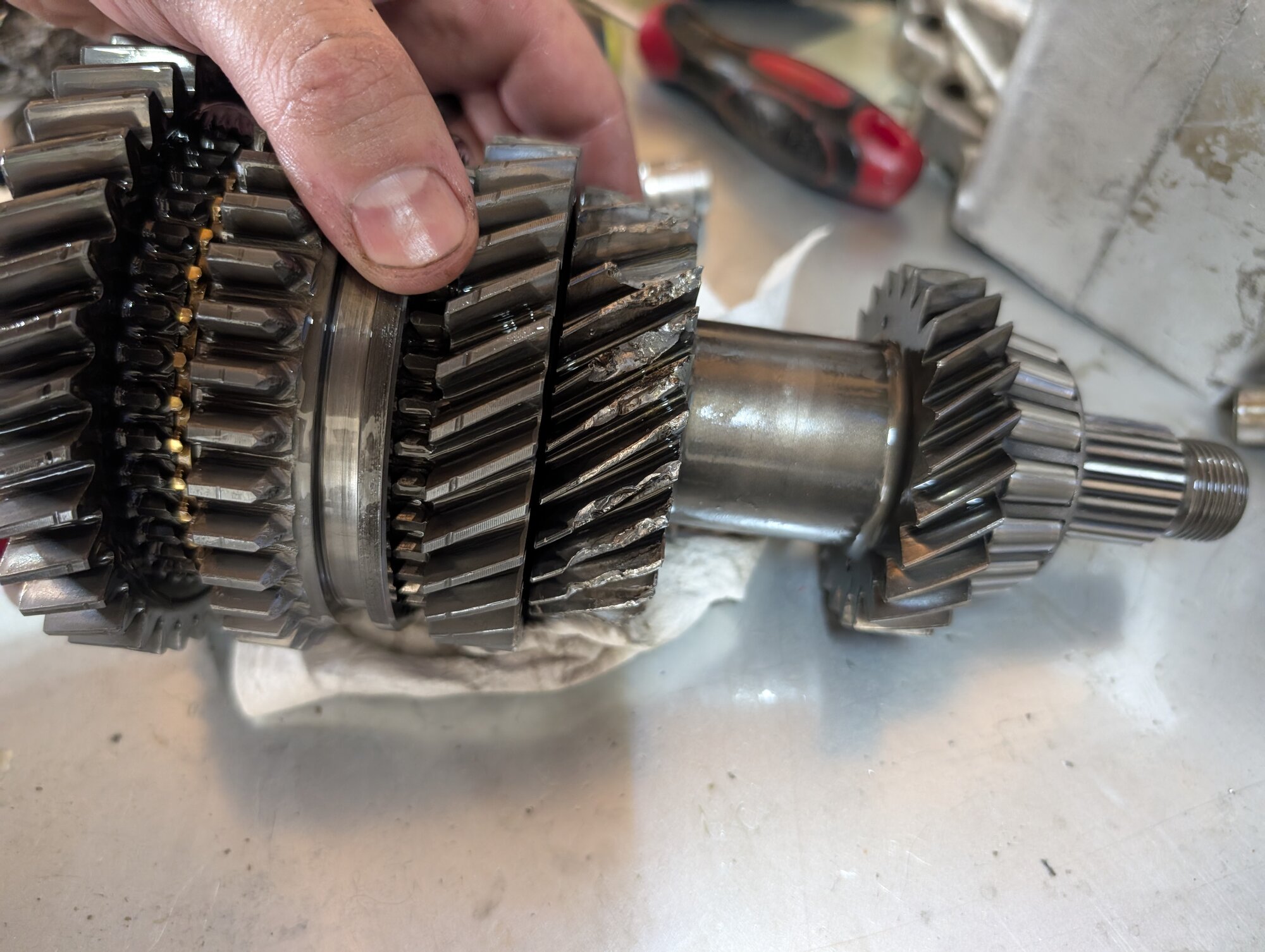

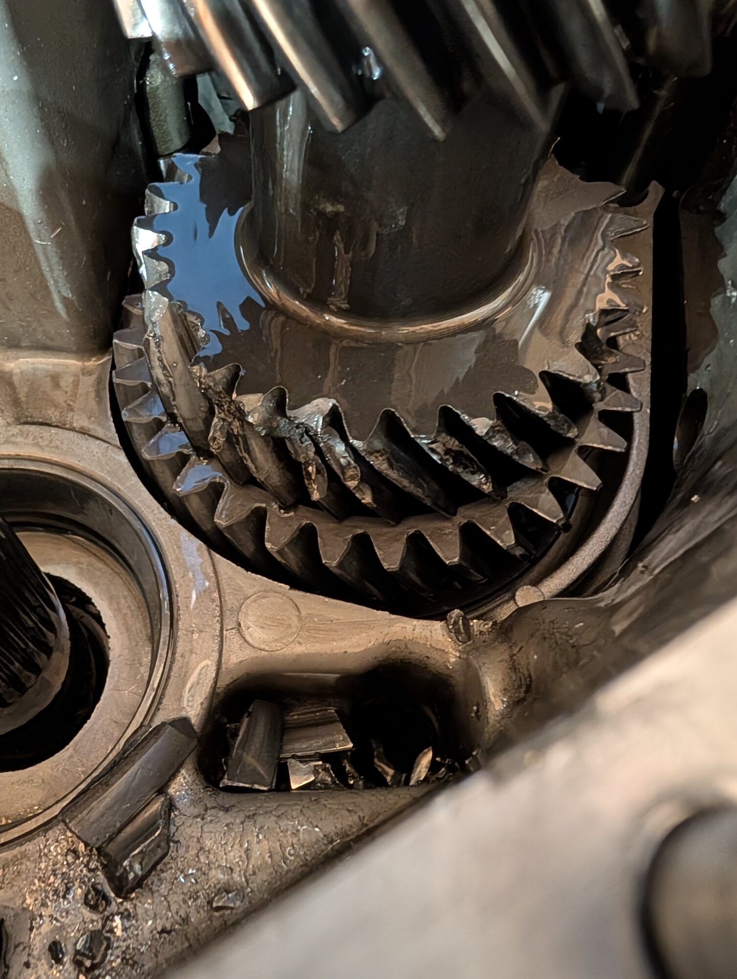

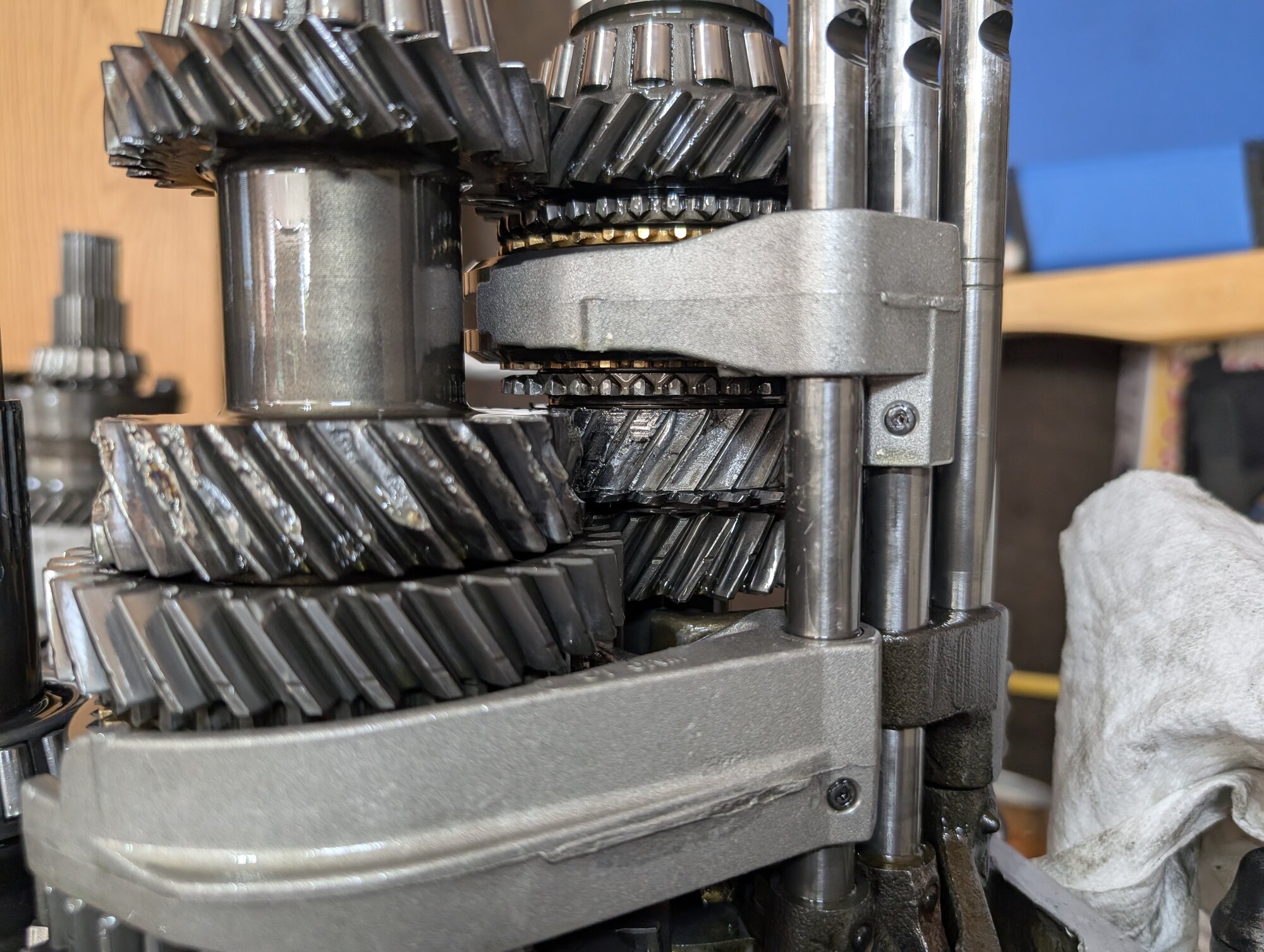

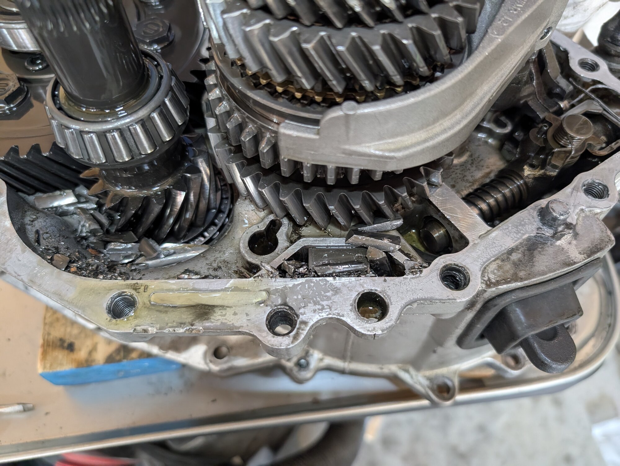

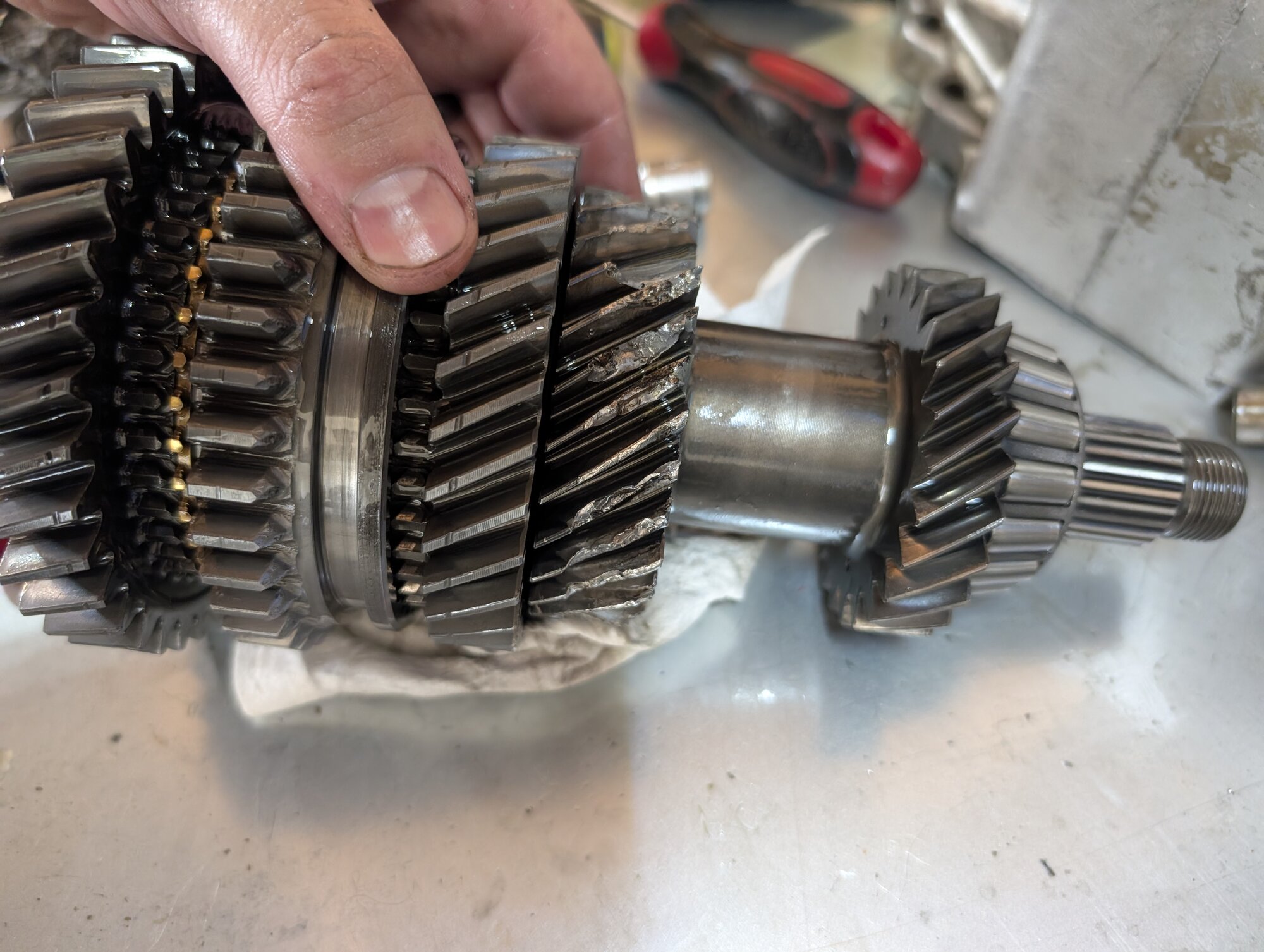

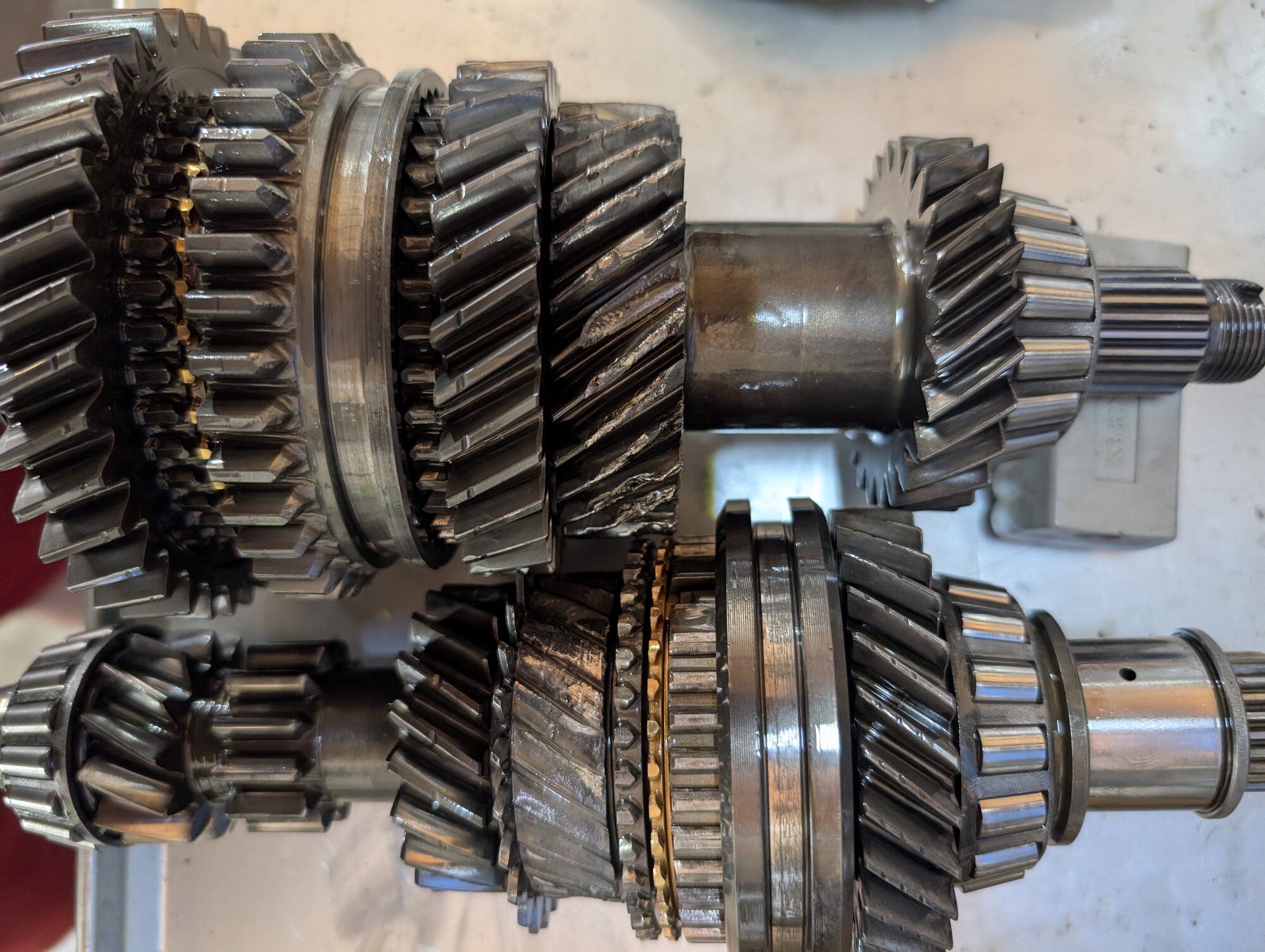

So I think I figured out why it broke...

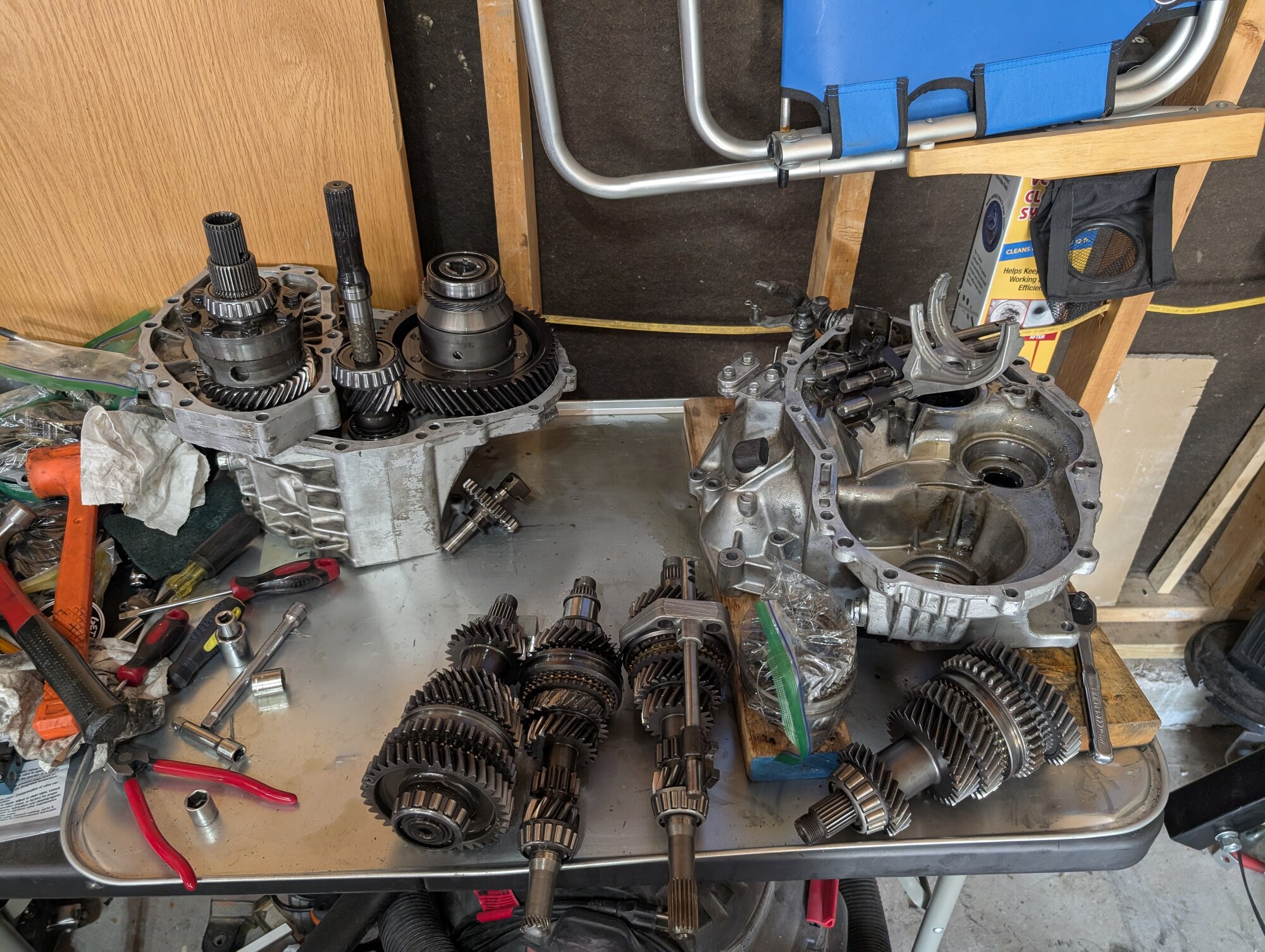

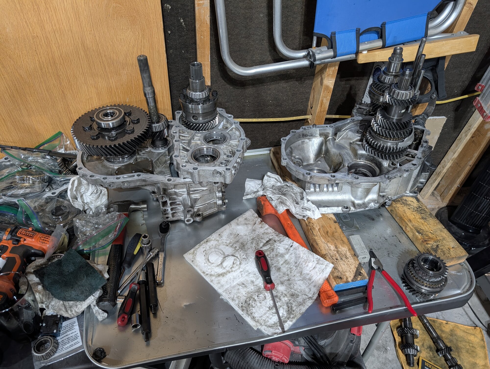

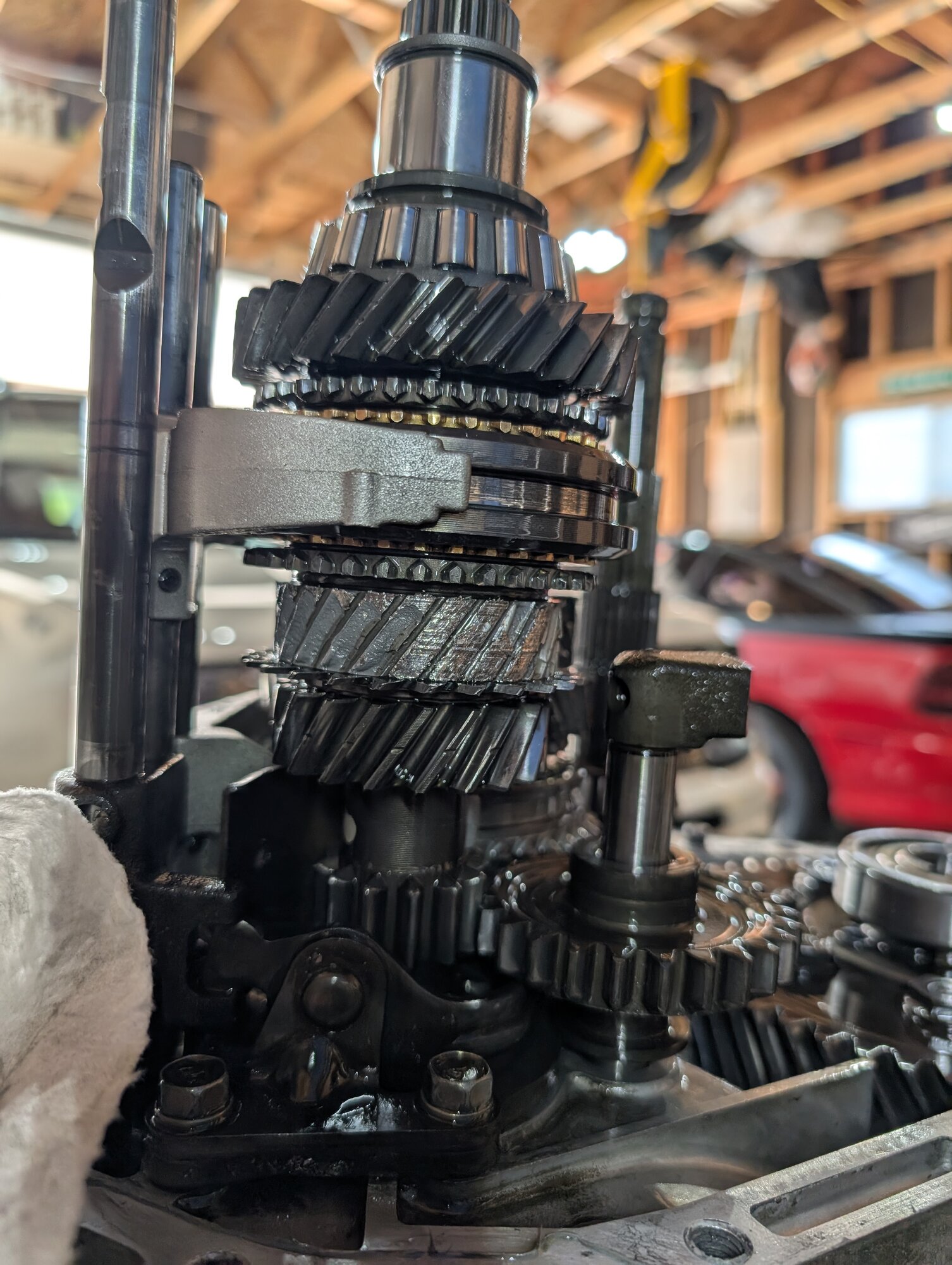

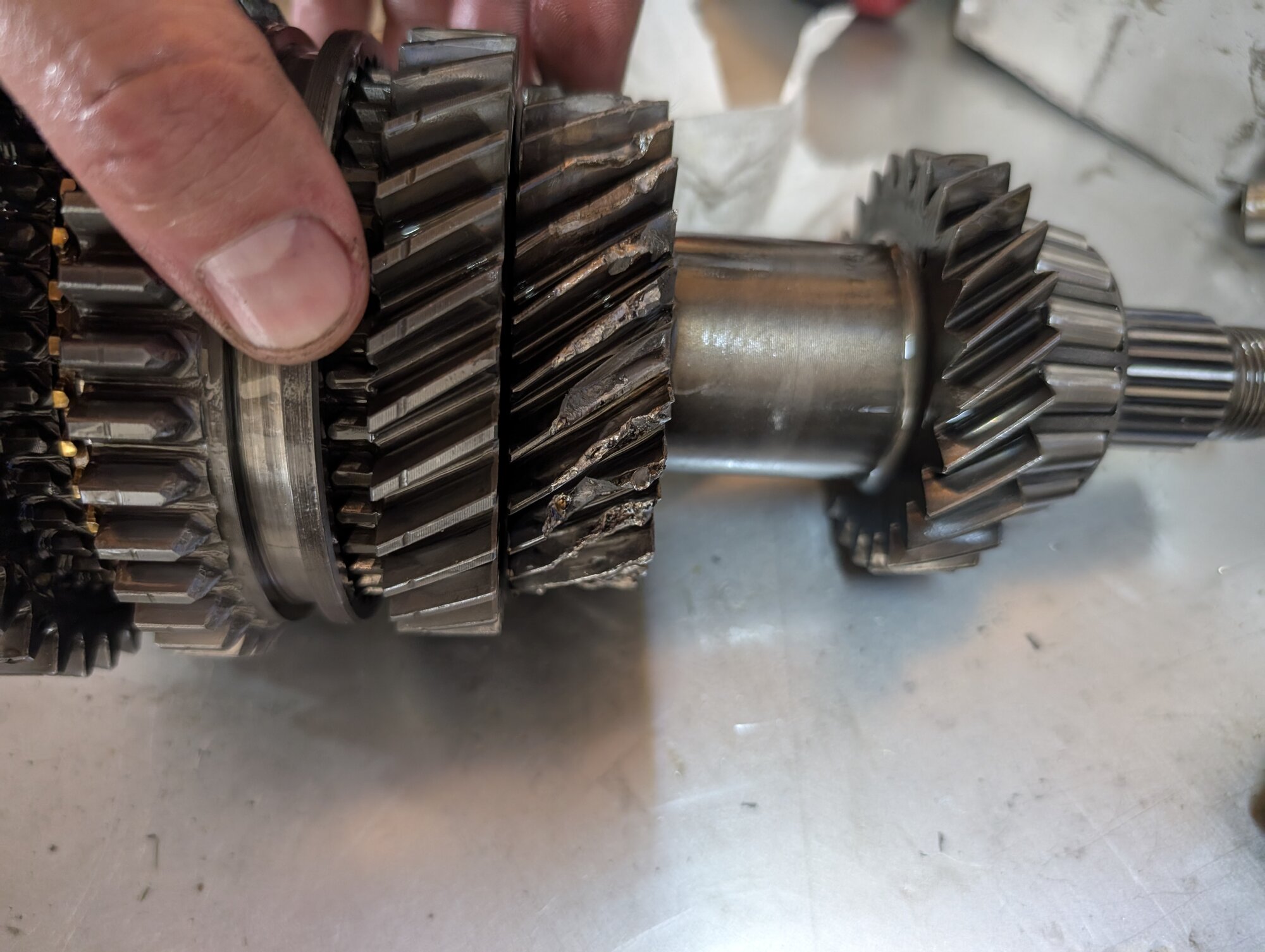

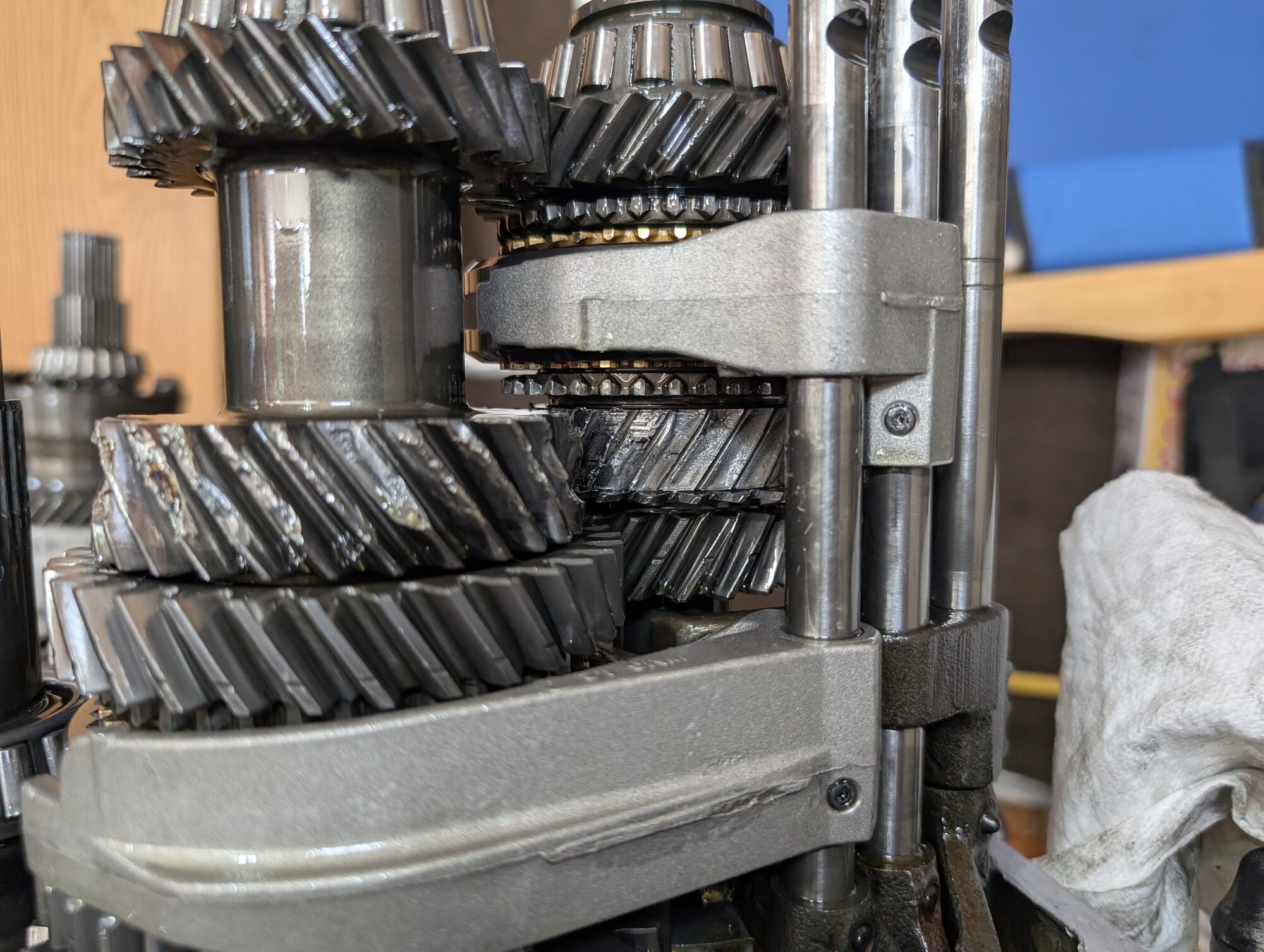

It's so much worse than I thought fellas. Just about everything needs replaced. It seems that 3rd shitted the bed and caused the gears to *likely* lock up and that's what snapped the input snout.
PXL_20250610_221014075.jpgPXL_20250610_223333694.jpgPXL_20250610_223339543.jpgPXL_20250610_223927854.jpgPXL_20250610_223928934.jpgPXL_20250610_223932501.jpgPXL_20250610_223947567.jpgPXL_20250610_230023287.jpgPXL_20250610_230025890.jpgPXL_20250610_230043431.jpgPXL_20250610_230045173.jpgPXL_20250610_230049645.jpgPXL_20250610_230503929.jpg
I’m sure shipping would suuuuck but I’ve got a spare 90 trans…just swap the output shaft to a 23 spline one.
I've got a other set already actually. There's a bit more needed for the 90 gearset like center and or front diff / ring gears.

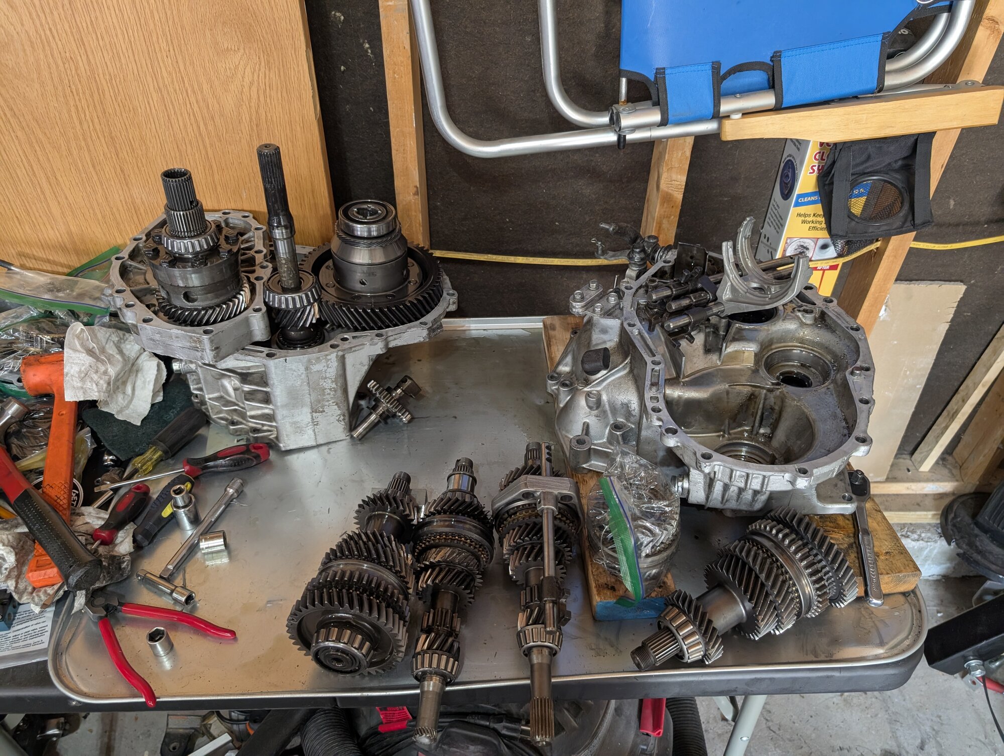

And....
PRESTO!
We're almost back up and ready.

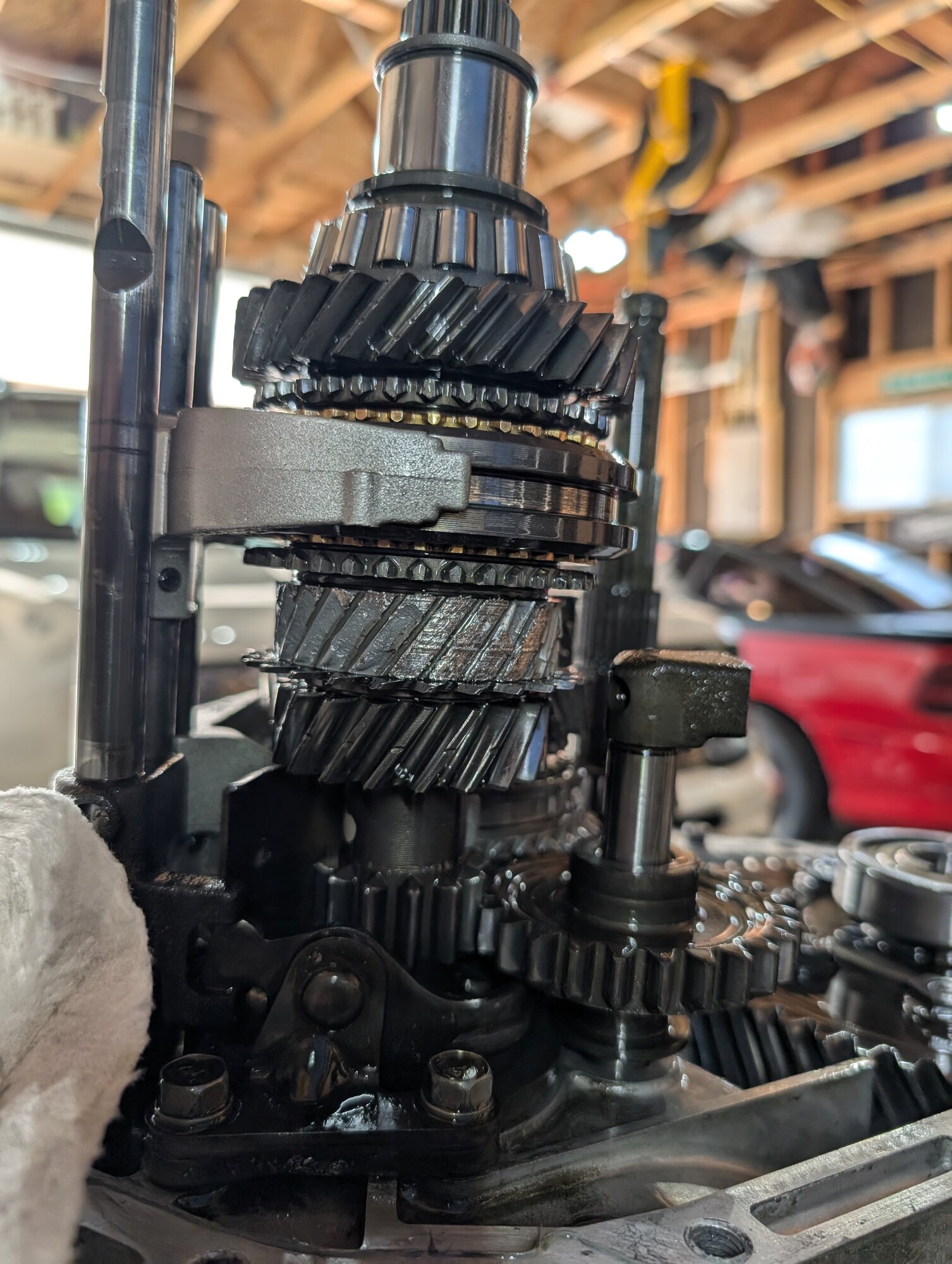

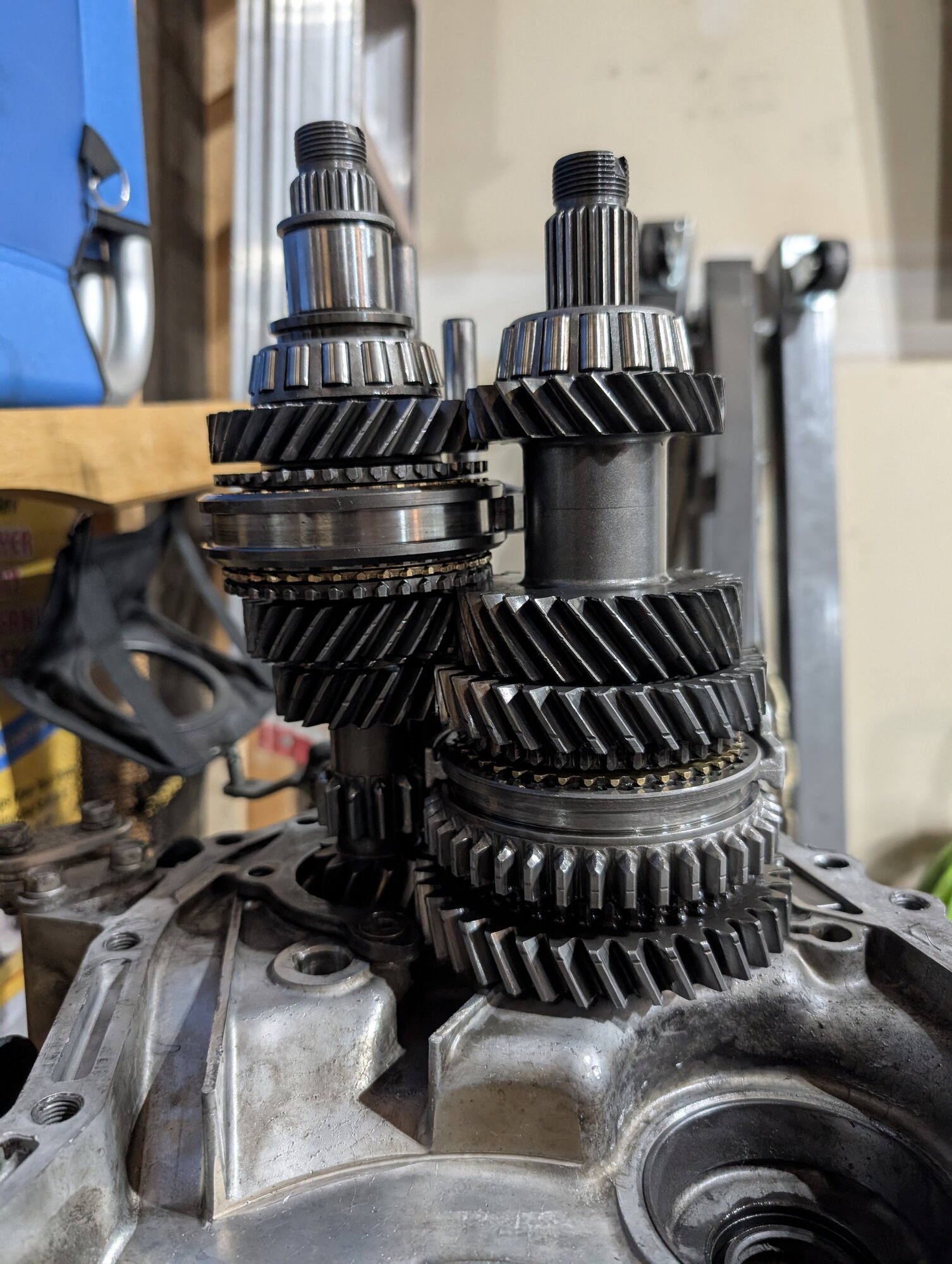

Cleaned EVERYTHING, inspected all bearings and races for any damage and nothing anywhere that I can find.
Swapped some gears and stuff around and now I've got the ol 95-96 input and intermediates with my old 1/2 and 3/4 on it. I guess so much for the "HD" gears :D LOL (I didn't really have a lot of hope in them to begin with)
Just waiting on some new seals and lower input shaft bearings since that one can't really be salvaged when pulled and it's gotta match the race in the case.

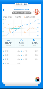

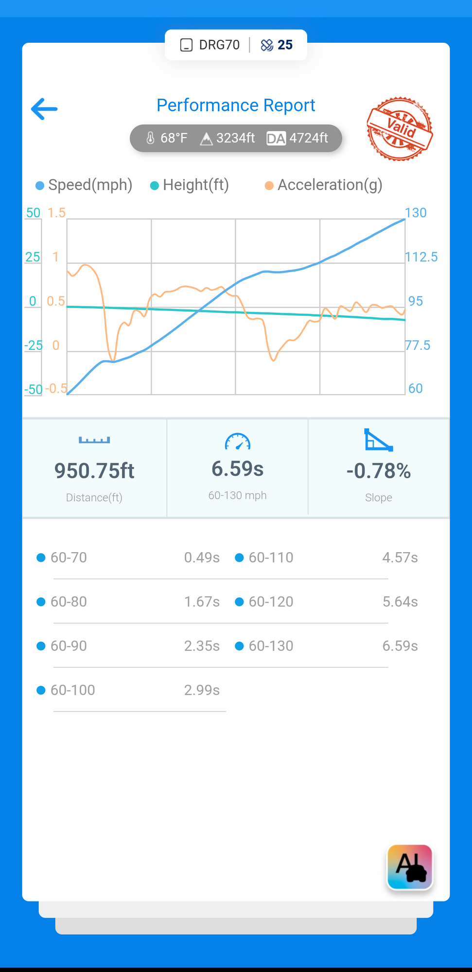

That’s flying!! That car should go deep into the 10s 1/4 with that 60-130. Looks like you could still shave a few tenths with those shifts. Awesome stuff!
Definitely. It should be able to do a mid - low 5 second I think but depends on shifts honestly. I thought I shifted quick enough but apparently not

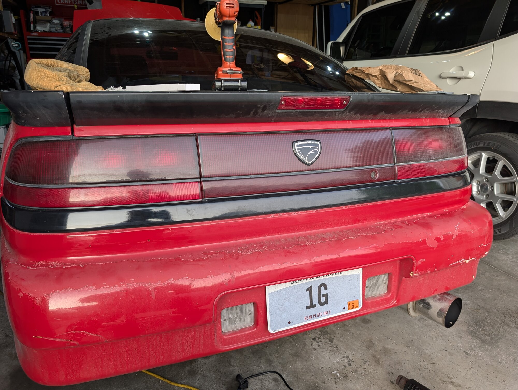

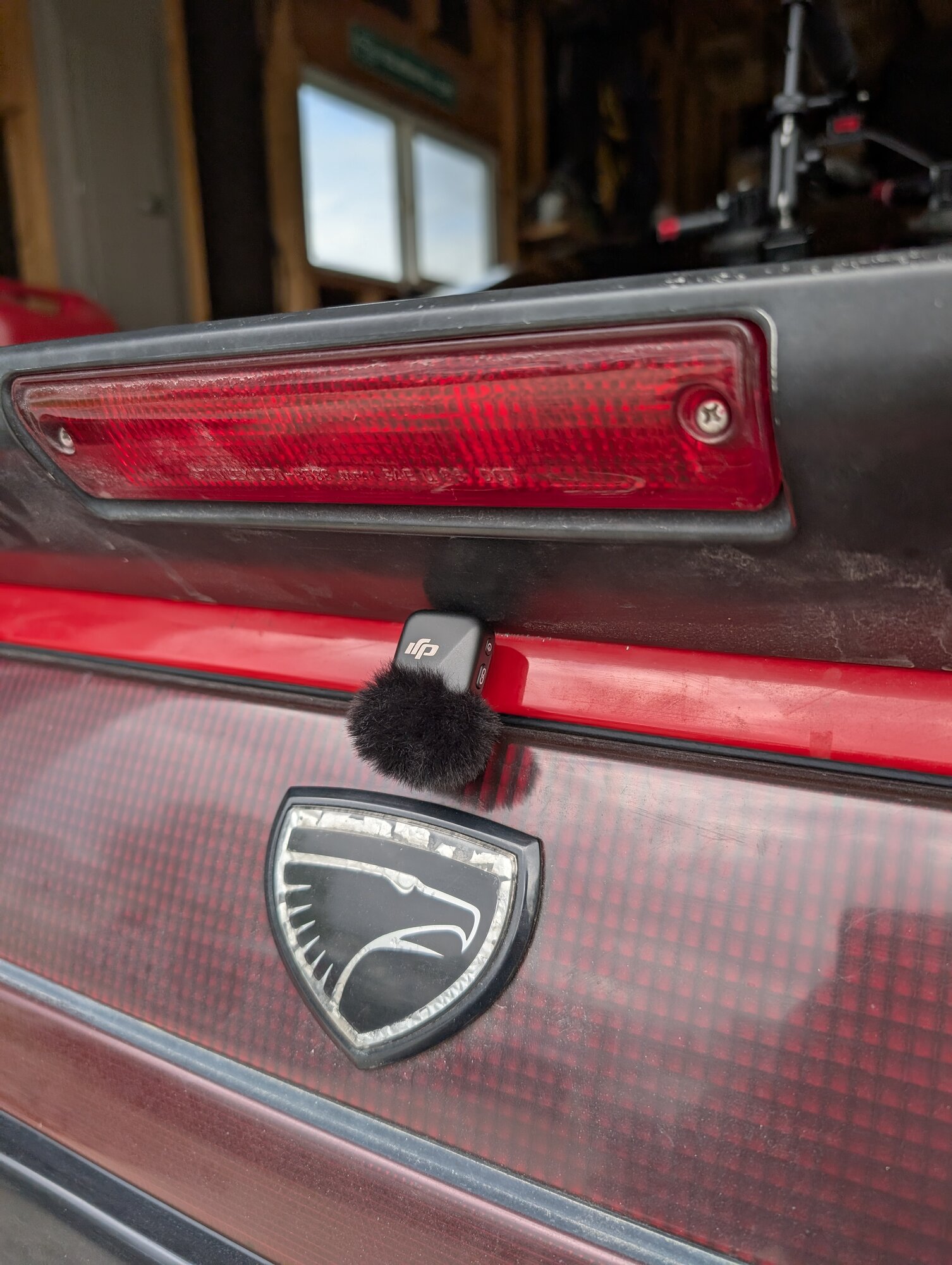

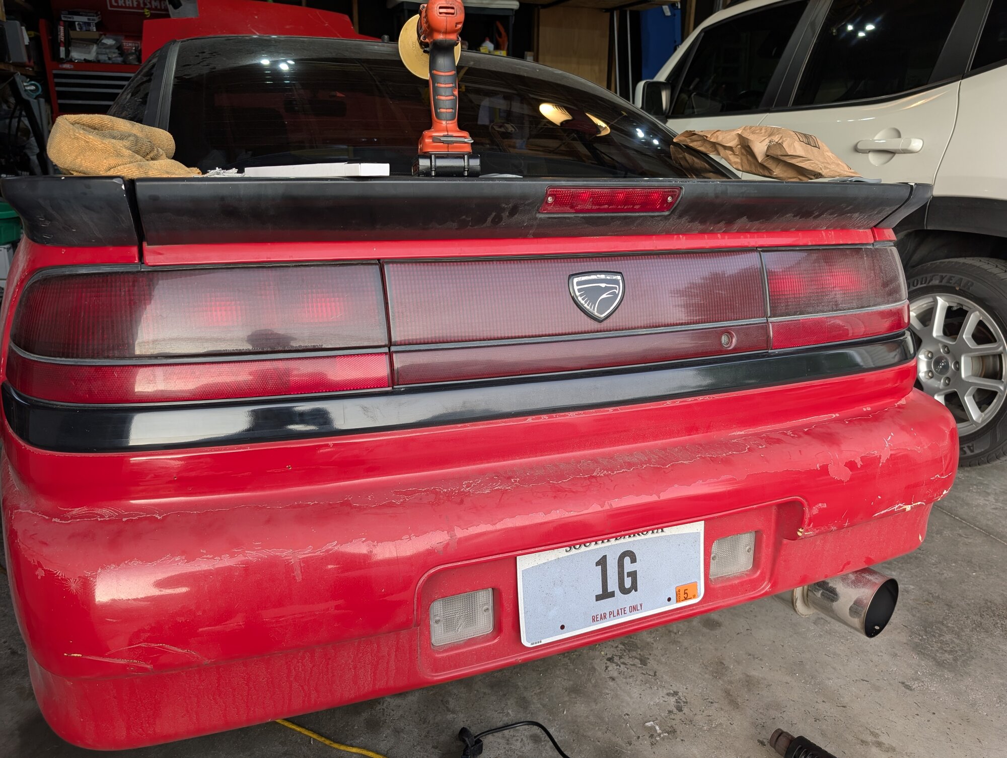

Debadged the rear, minus the Talon logo between the tail lights. Much better.

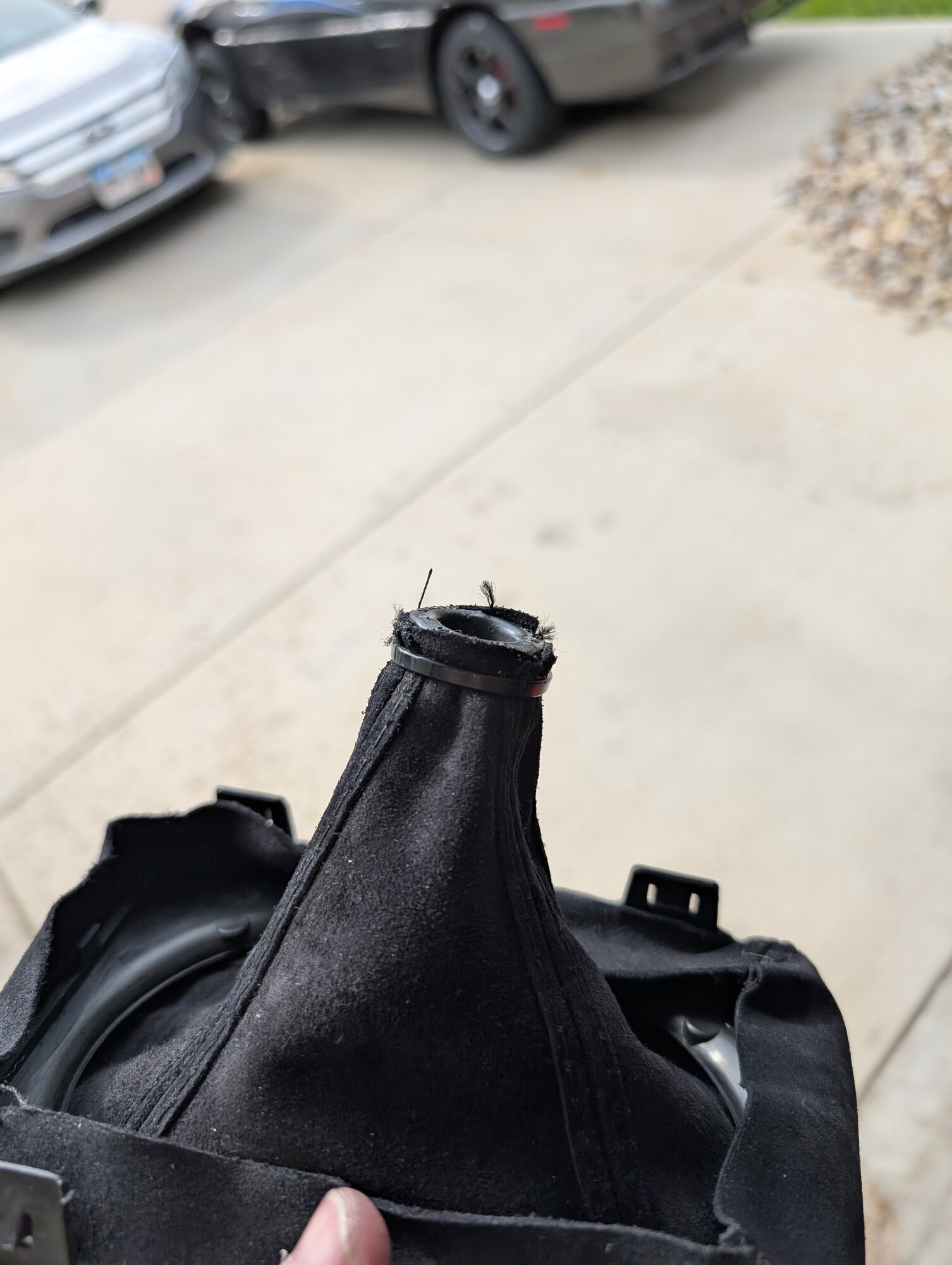

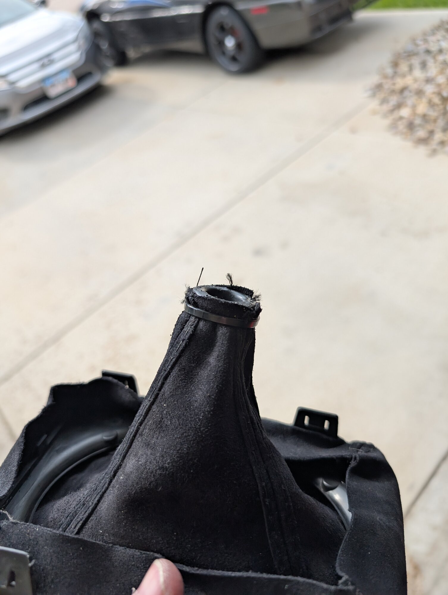

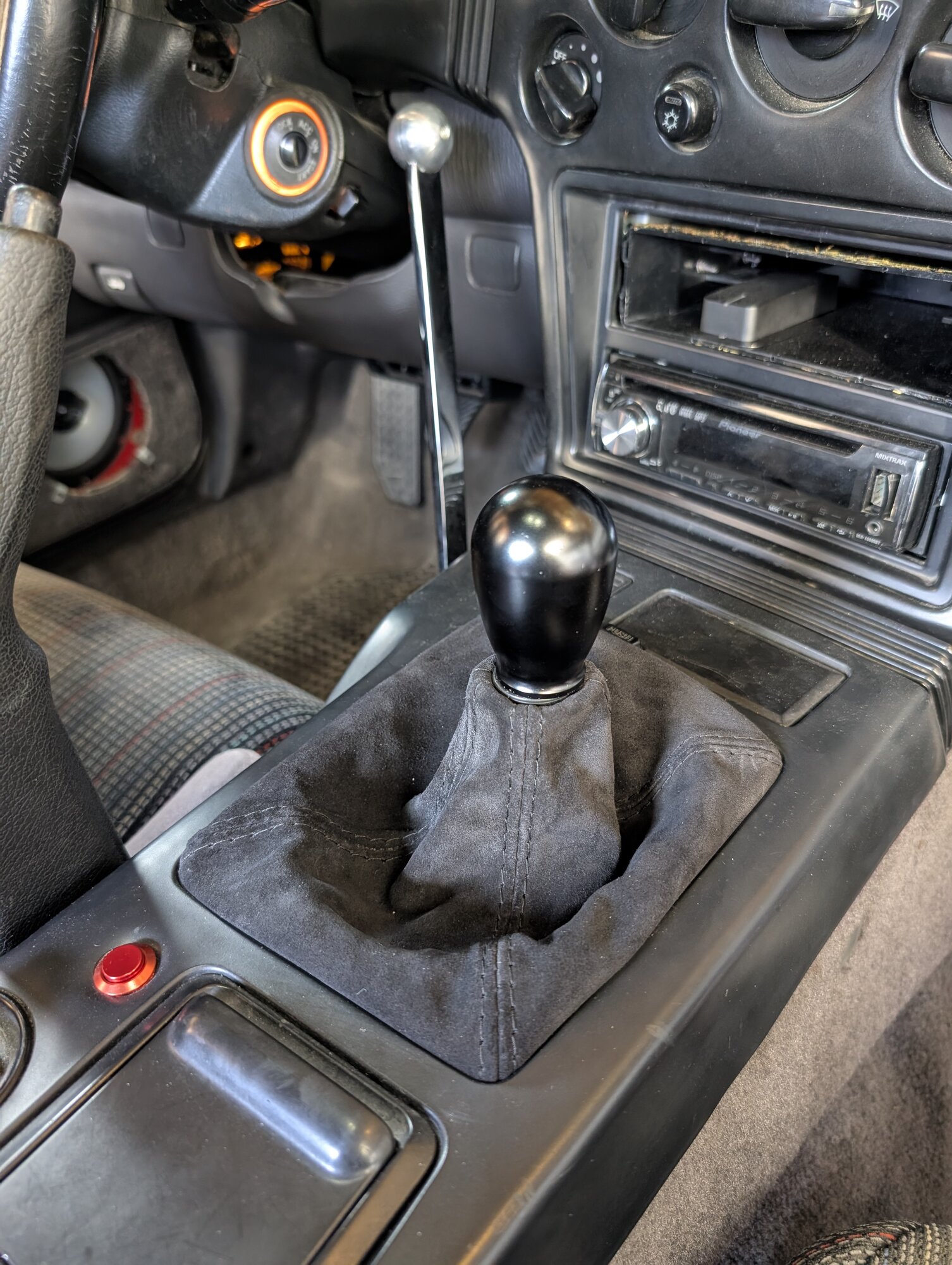

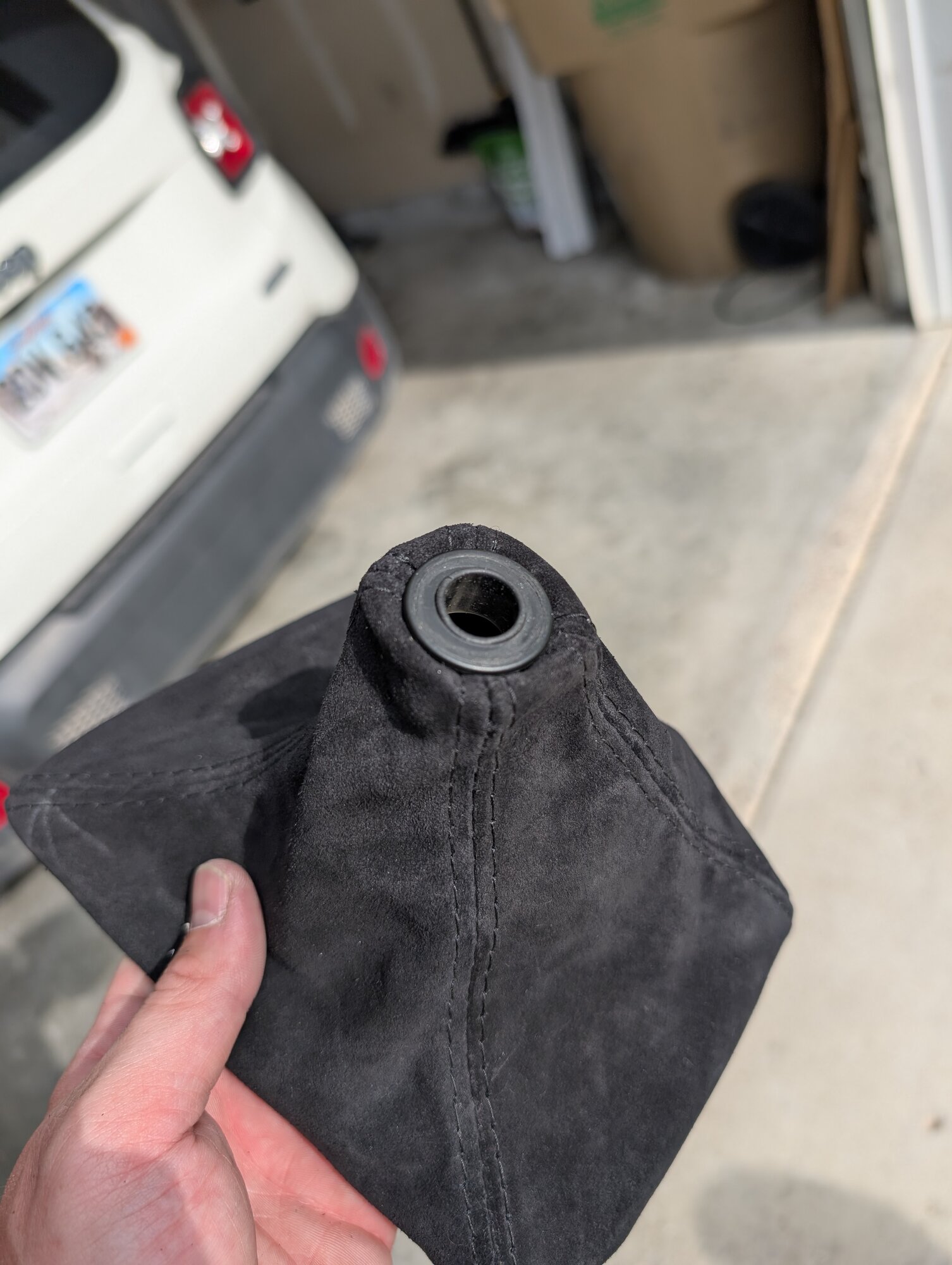

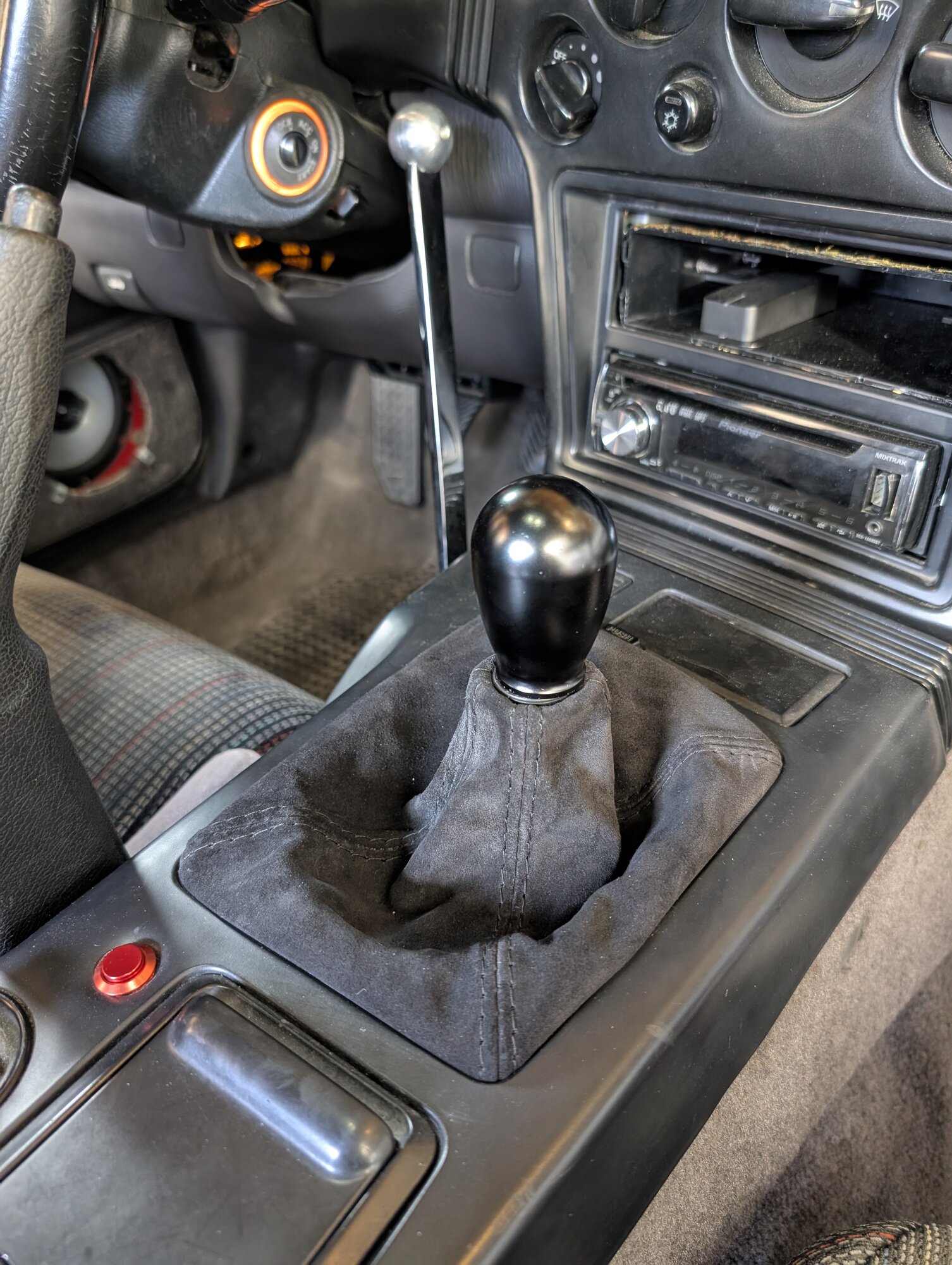

Picked up a new suede shift boot from @Jose gonzalez, looks great, fits great! I'd definitely recommend!

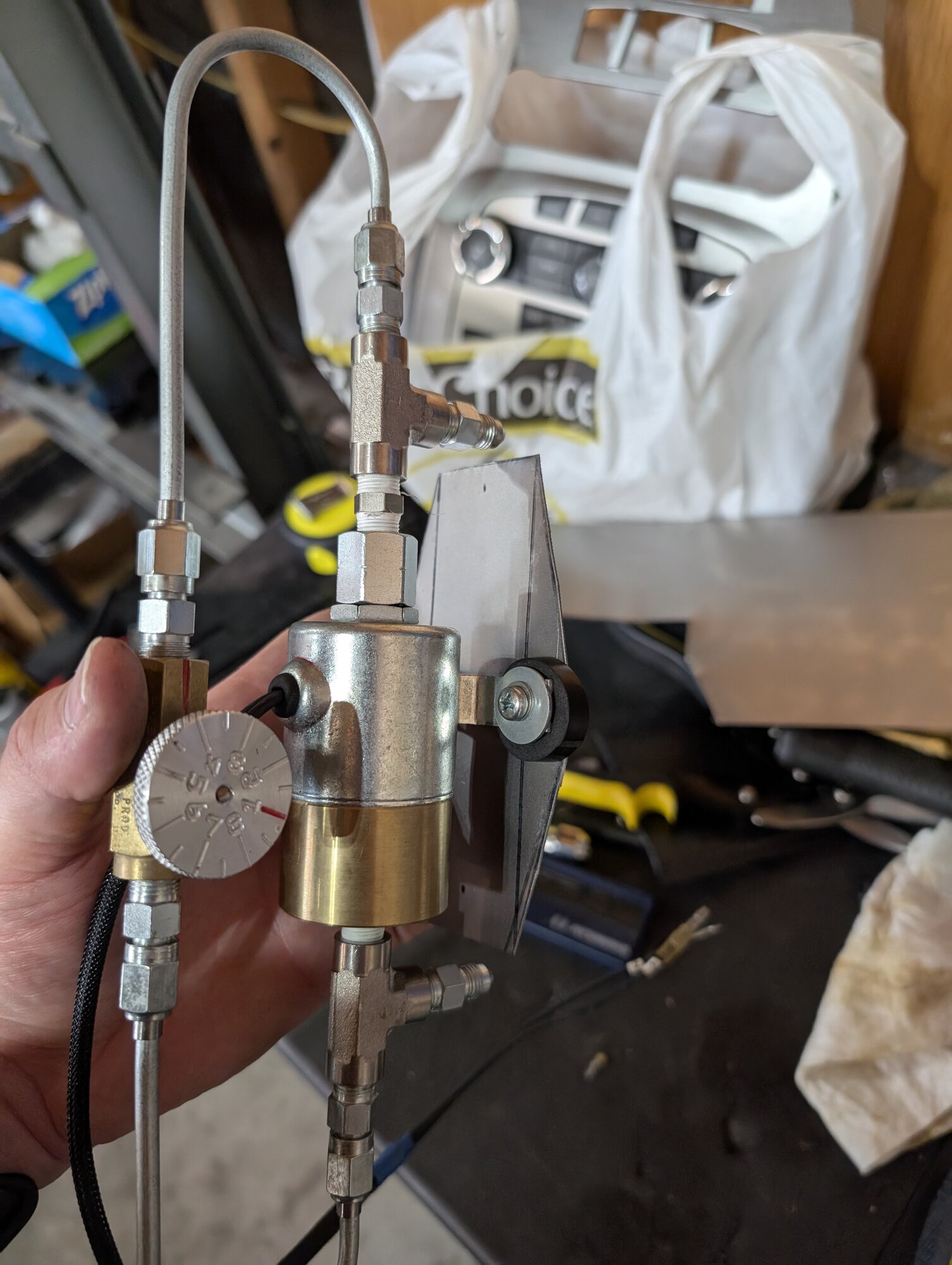

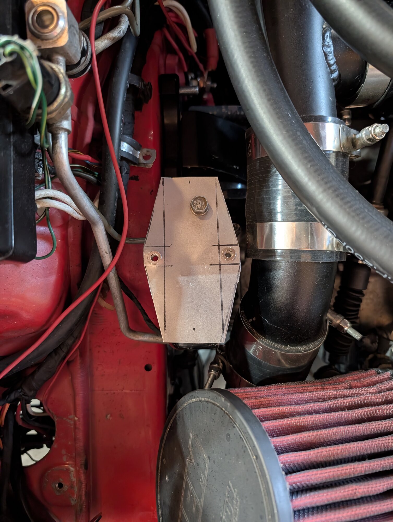

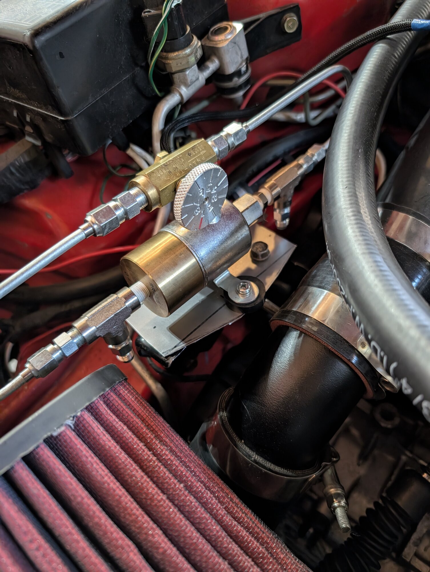

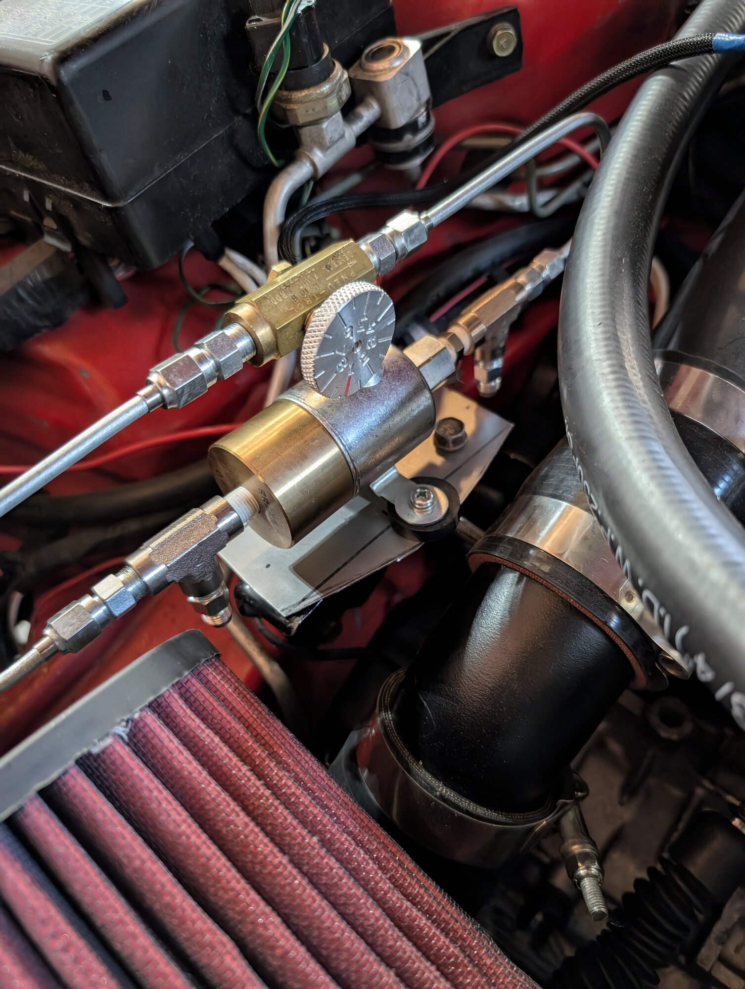

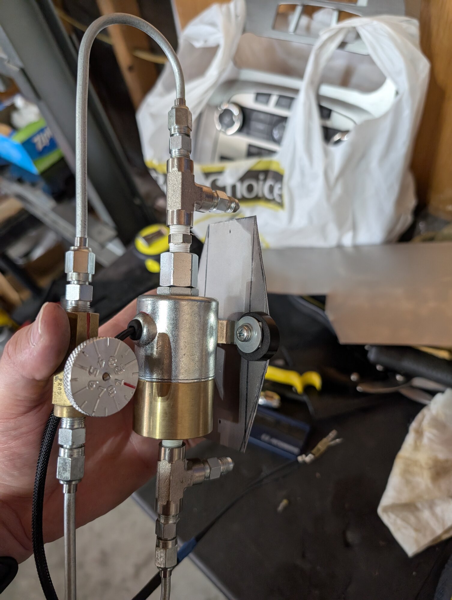

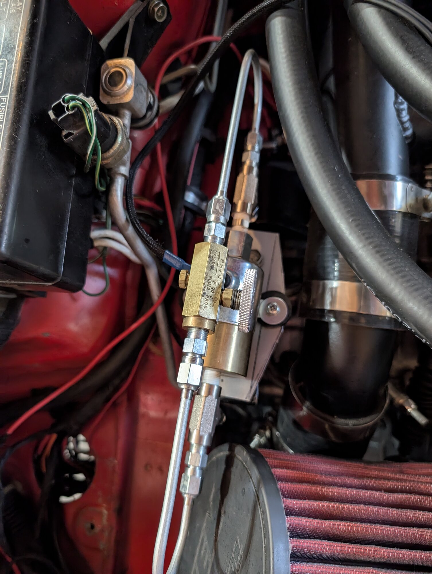

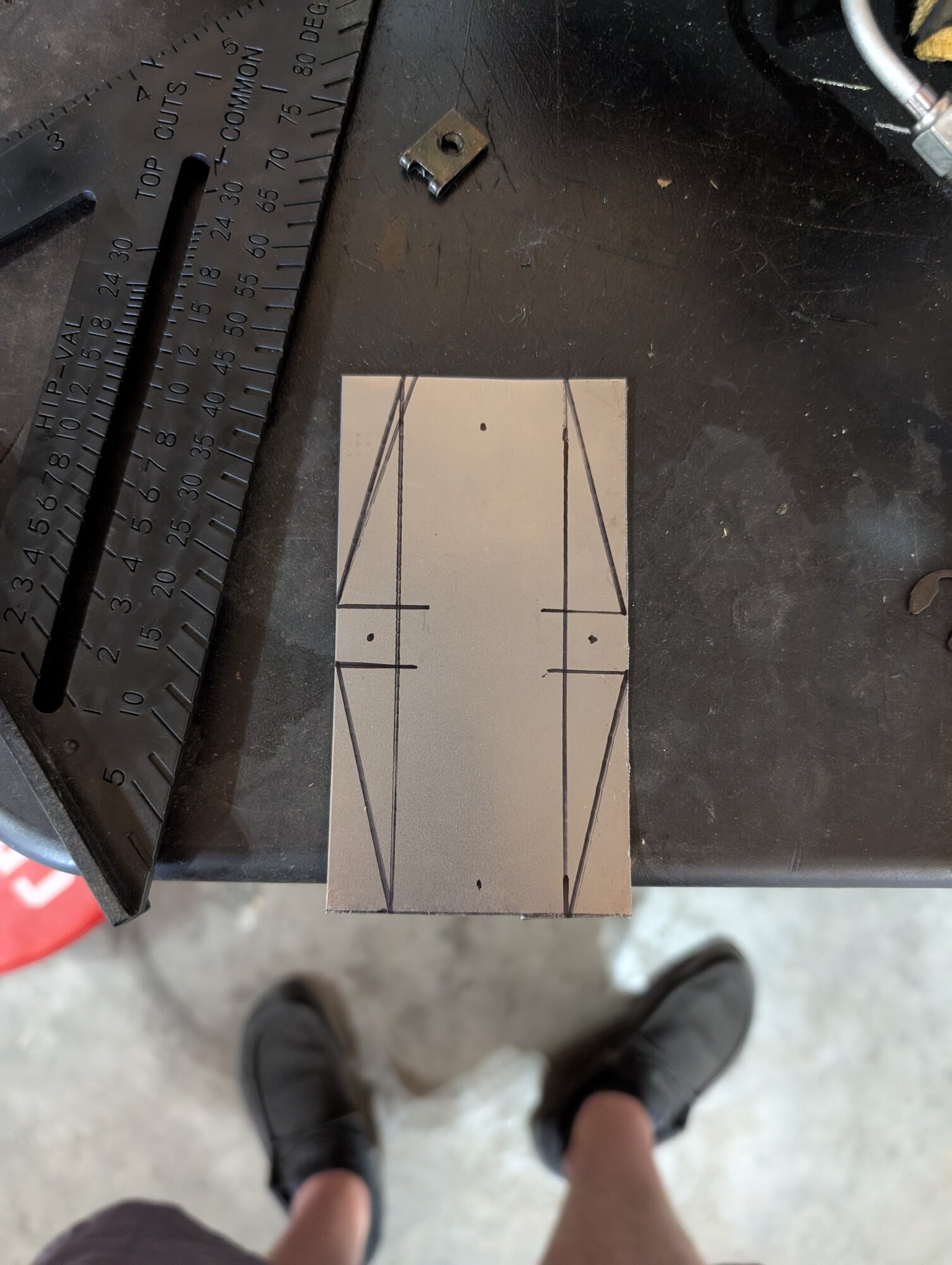

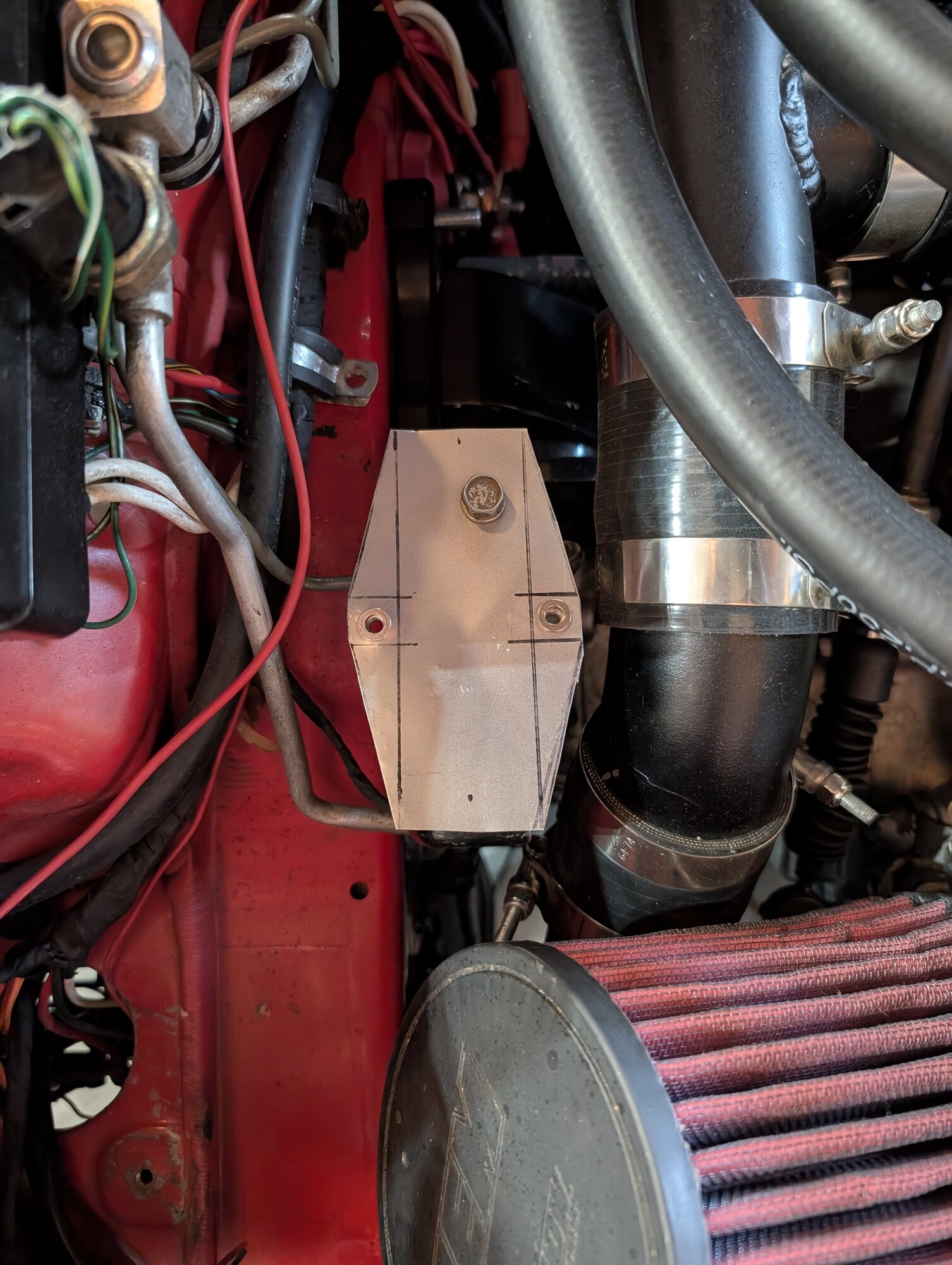

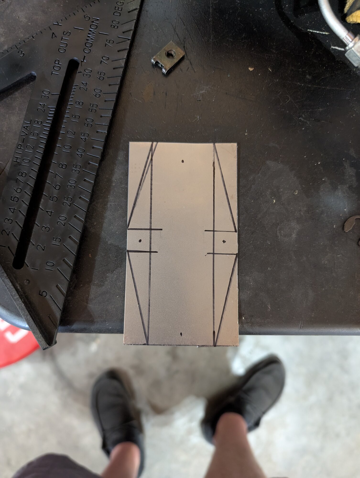

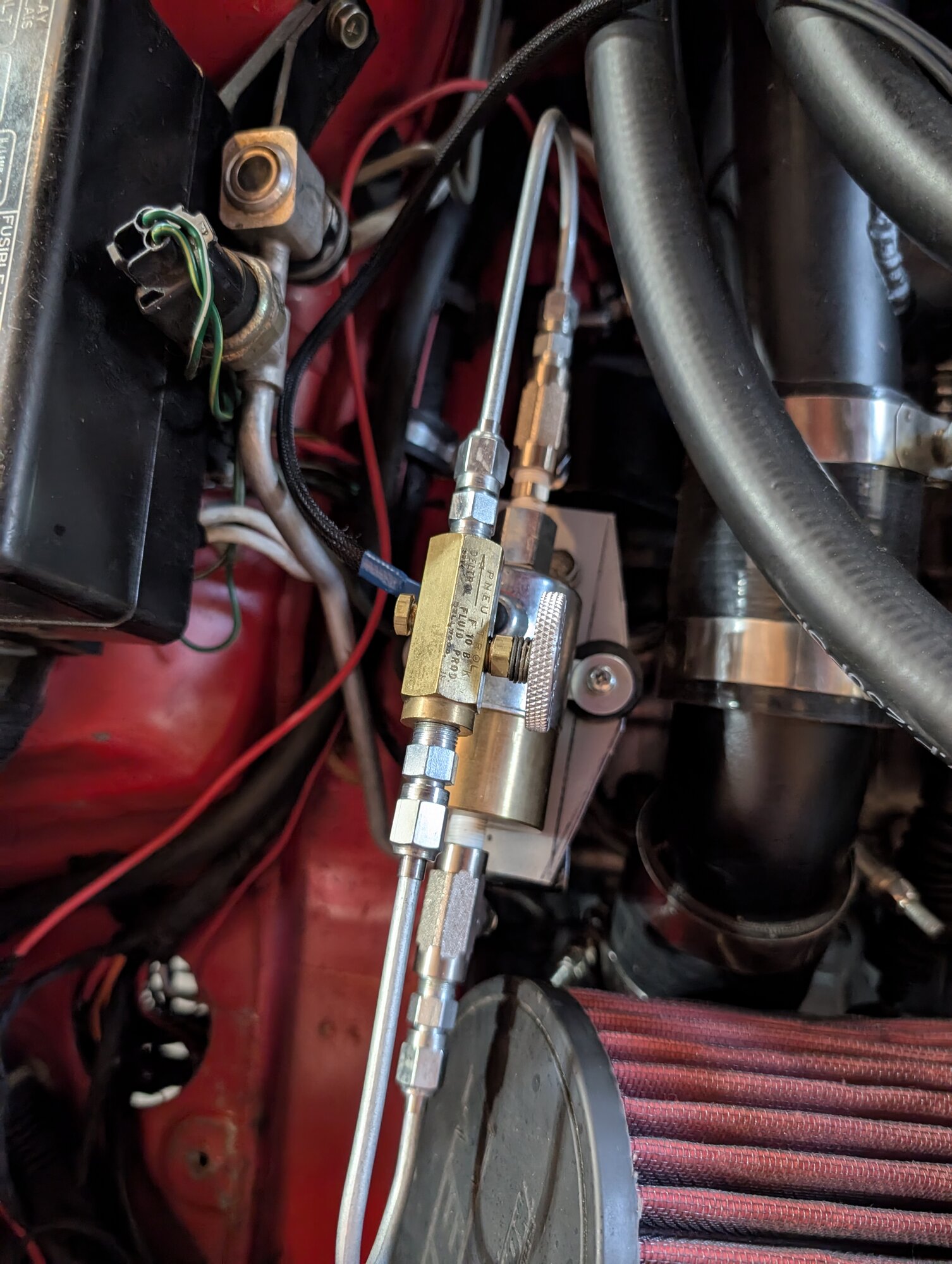

Made a little mount for my clutch slipper valve out of some steel sheet and snips. It's a little light but it should work fine. Need to order lines for it and figure out how to wire it ( it's a solenoid so it should just be 12v switched and a ground to the ECU)

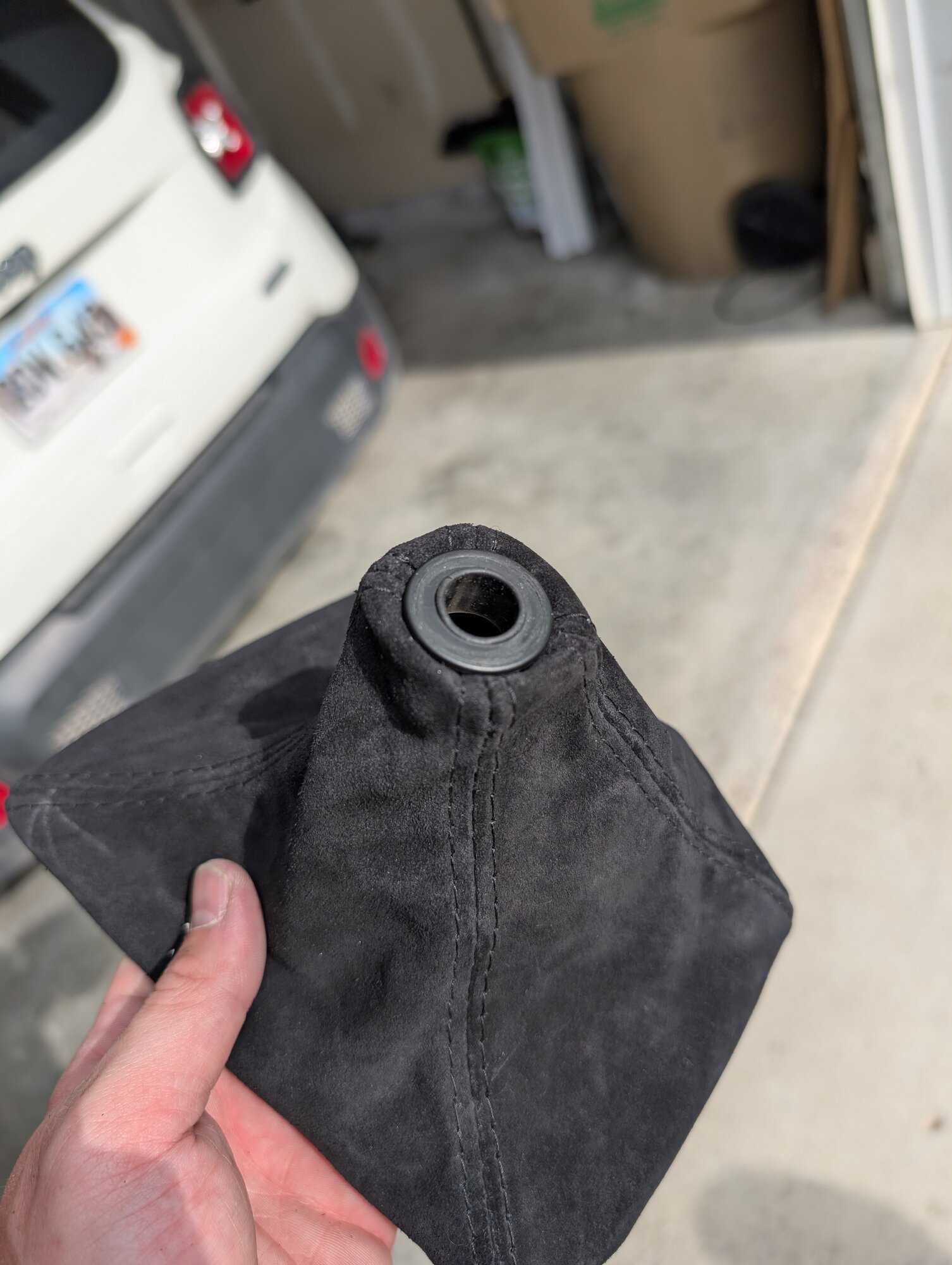

View attachment 767461View attachment 767462View attachment 767463View attachment 767464View attachment 767465
thanks for the shout out on the boot!

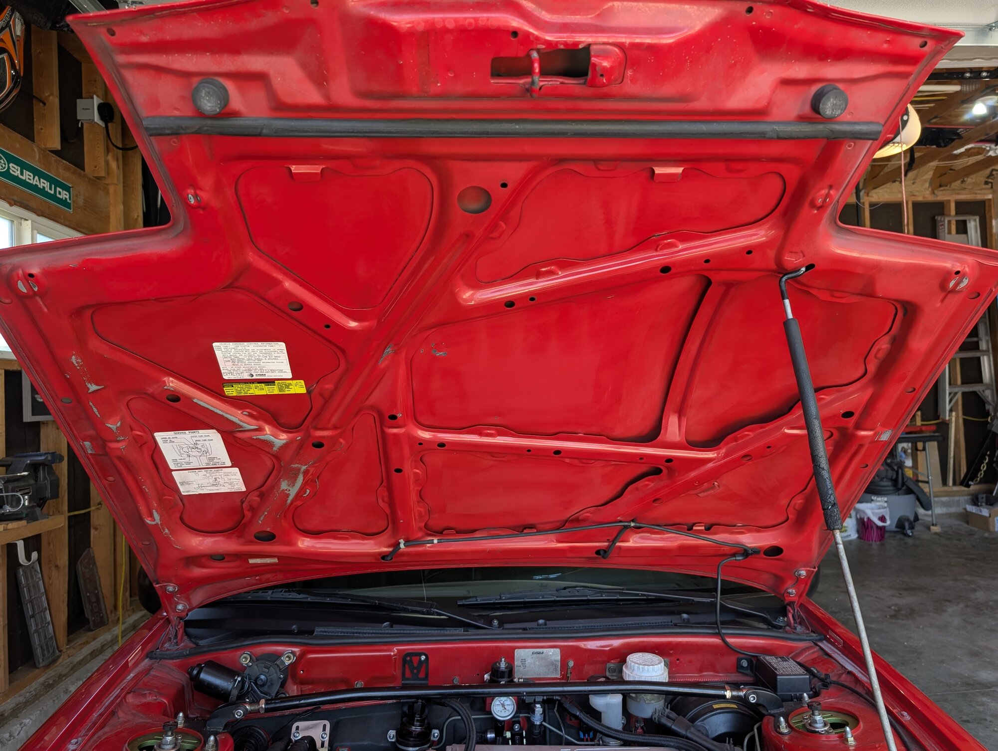

Got the car back up and running on Saturday just in time for a Fathers Day car show on Sunday. I cleaned off the underside of the hood on Saturday as well. It was unreasonably dirt and oily. Came out pretty decent.

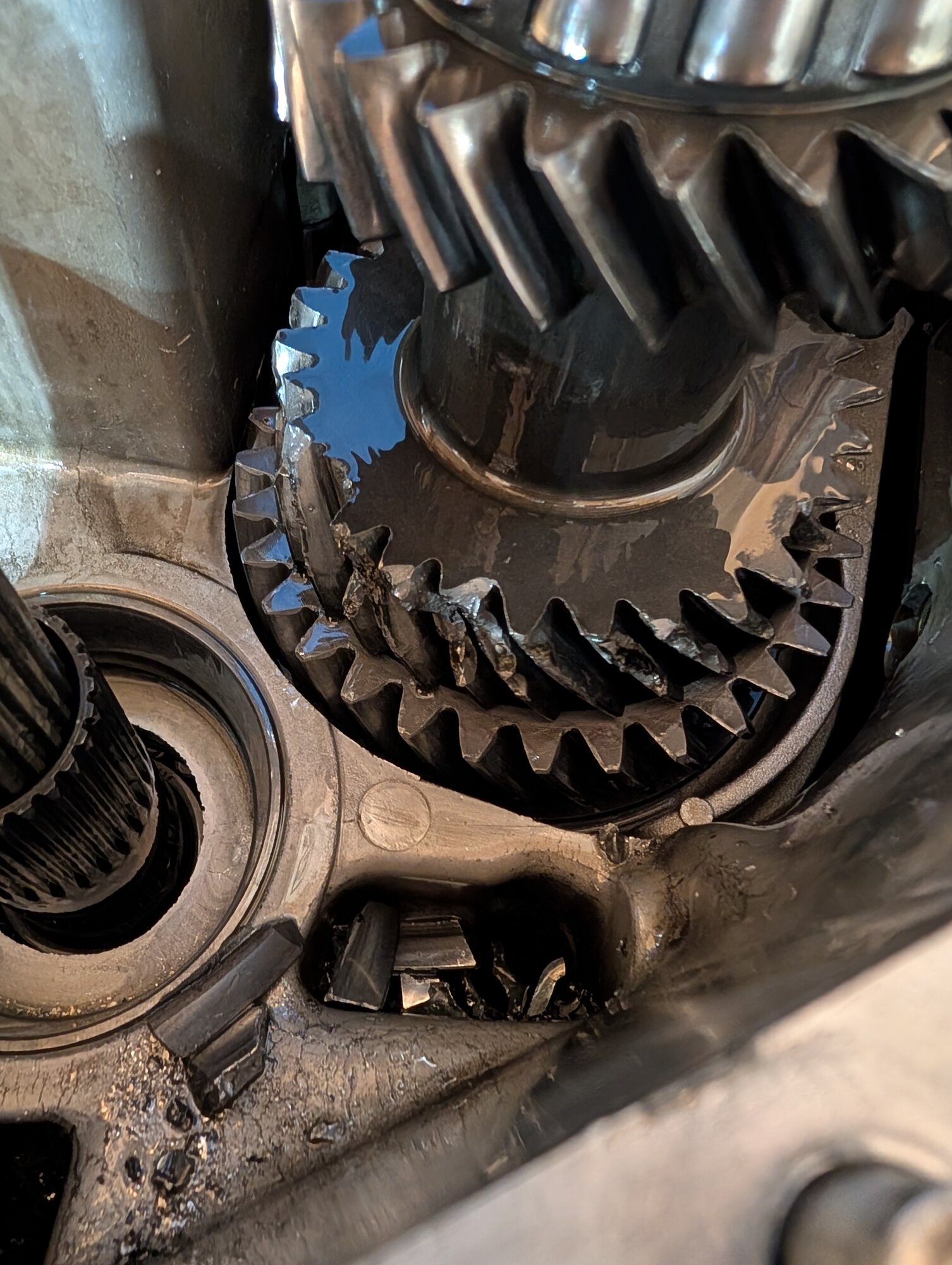

Here's most of the aftermath of 3rd grenading that I could save. Quite a bit actually.

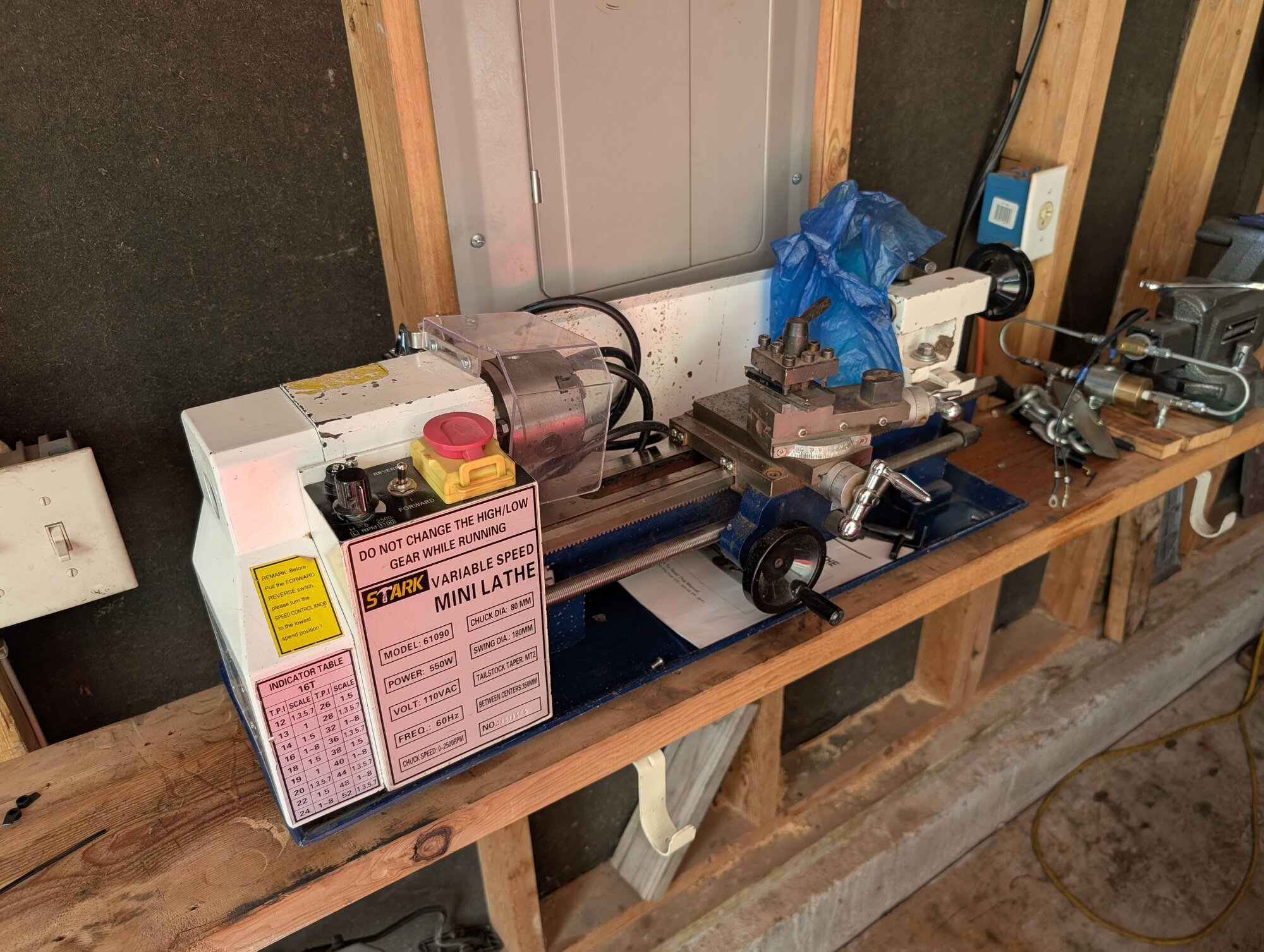

A coworker of mine gave me this mini lathe to fix and keep if I wanted it so I said sure. It needs some gears and electrical components and then it *should* work. I'm not exactly sure what I can man on this but the first thing that came to mind was some transmission shims but I'm not quite sure I'm smart enough to figure out how to make them LOL

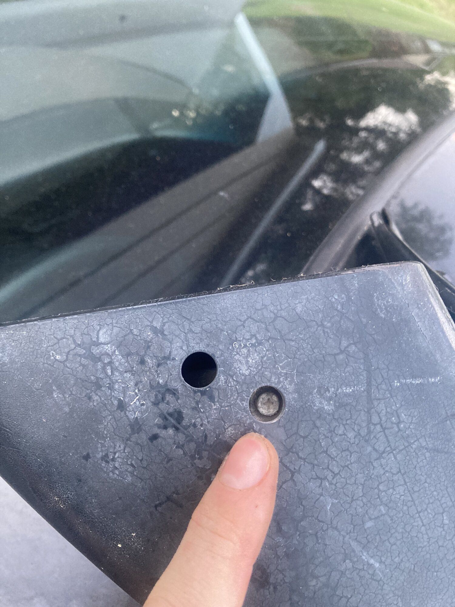

Before you go crazy trying to fix it with new mirrors or etc, try what helped me. Flip the mirrors over and you should see a screw recessed in a hole. Tighten it. That fixed my issue, previously they were so floppy that the motors seemed like they did nothing. Afterwords, works like new. Worth a try!

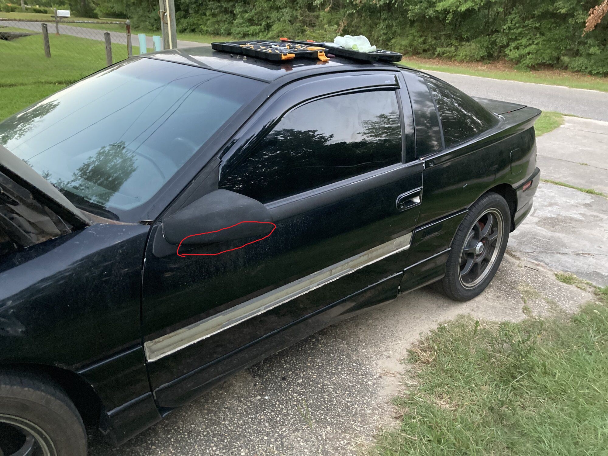

Take the whole mirror assembly, and turn it 180*. AKA look on the bottom of the assembly itself, on the outside. I think I have pictures in my build thread but gimme a few seconds, I gotta wade through almost 100 pages to find the one post. ROFL
Found 'em!
Circled in red is where I'm talking about. This is how it looks.
That's the screw.
ooo nice score on the lathe! I’ve been debating buying my own mill and lathe for years now, but keep blowing all my money on car parts instead LOL
