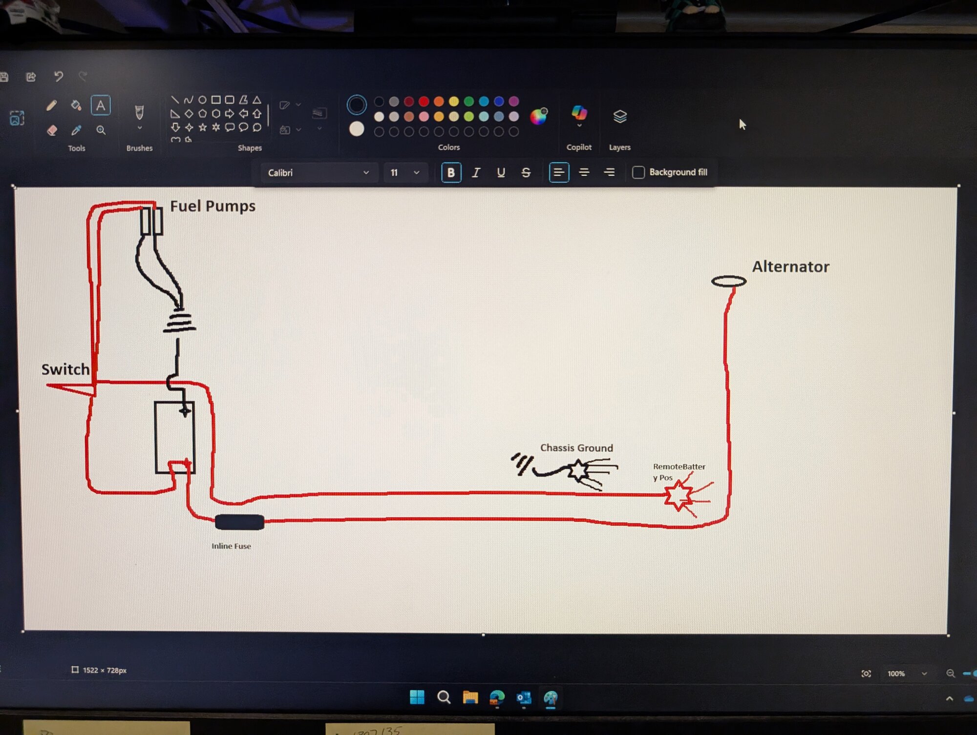

I also realize now too that since the battery is relocated I'll need to put in a Killswitch outside the car.
And to do that I've got to redo quite a bit of my alternator / battery wiring.. unfortunately.
Here's the plan:
Starting from alternator the route goes:
Alternator > battery + > battery + > kill switch > Killswitch > engine bay remote + post.
Fuel pumps I think could go on the switched side of the kill switch so they only get 12v while the switch is not triggered, as is everything else on the car. The remote post in the bay is what powers the original fusebox, my MPI stuff, fans, etc.
It think this idea should work.
Let me know fellas.
Pretty sure that’s exactly how my setup is, only thing is when I switched to the 2 gauge feed for the alternator directly off the + post it’s always gonna draw from the battery, however it was really never an issue tho because I always just hit the kill switch whenever I got home, my car has been parked since last September and the battery still currently sits at 12.4 volts LOL
I run 1/0 gauge for all big power and ground.
Good to know this should work though!

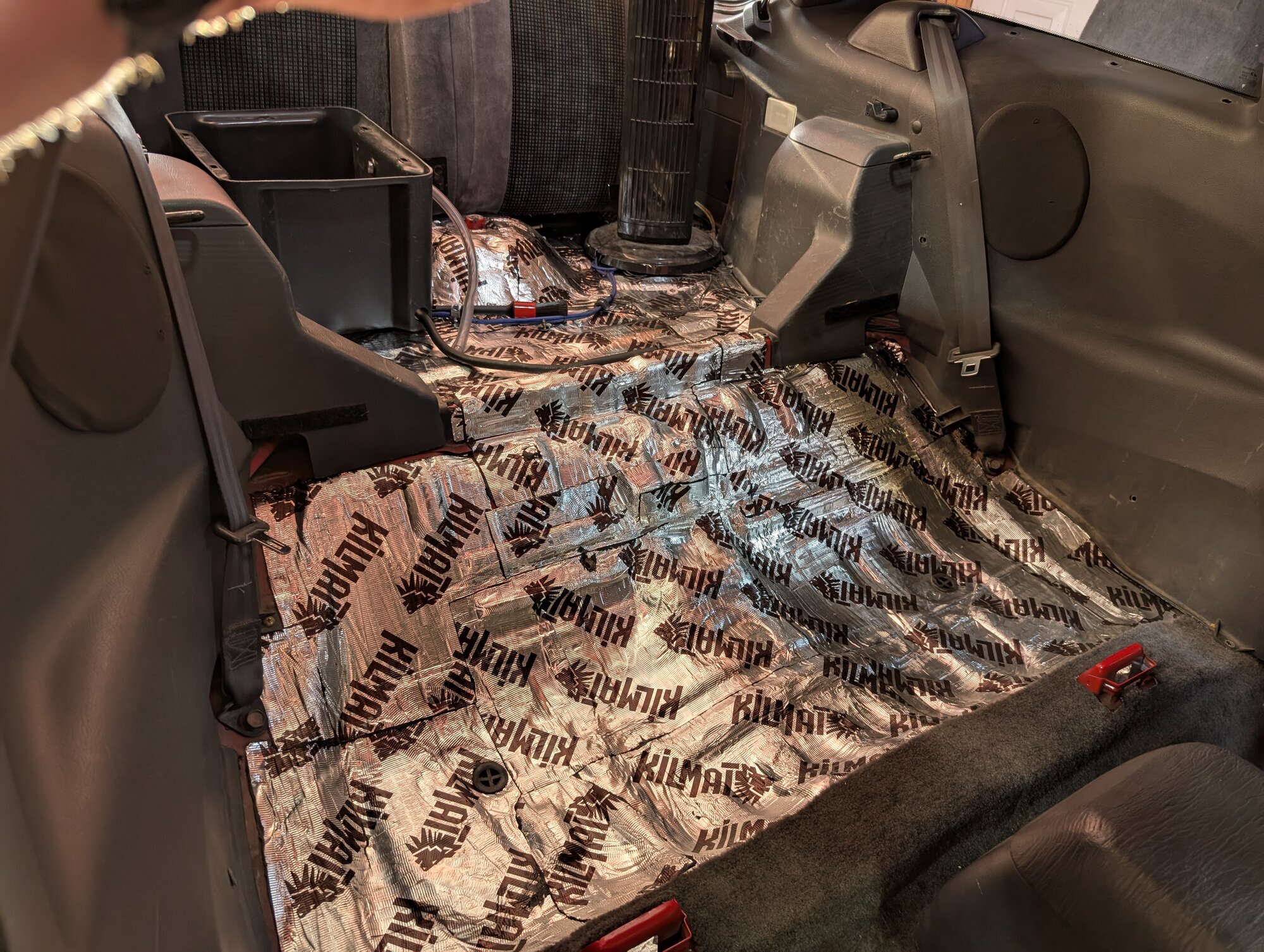

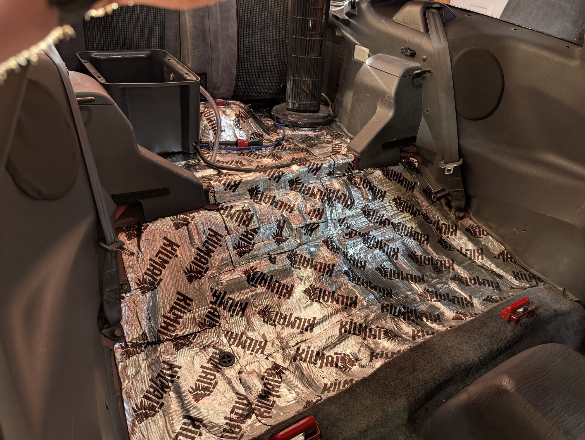

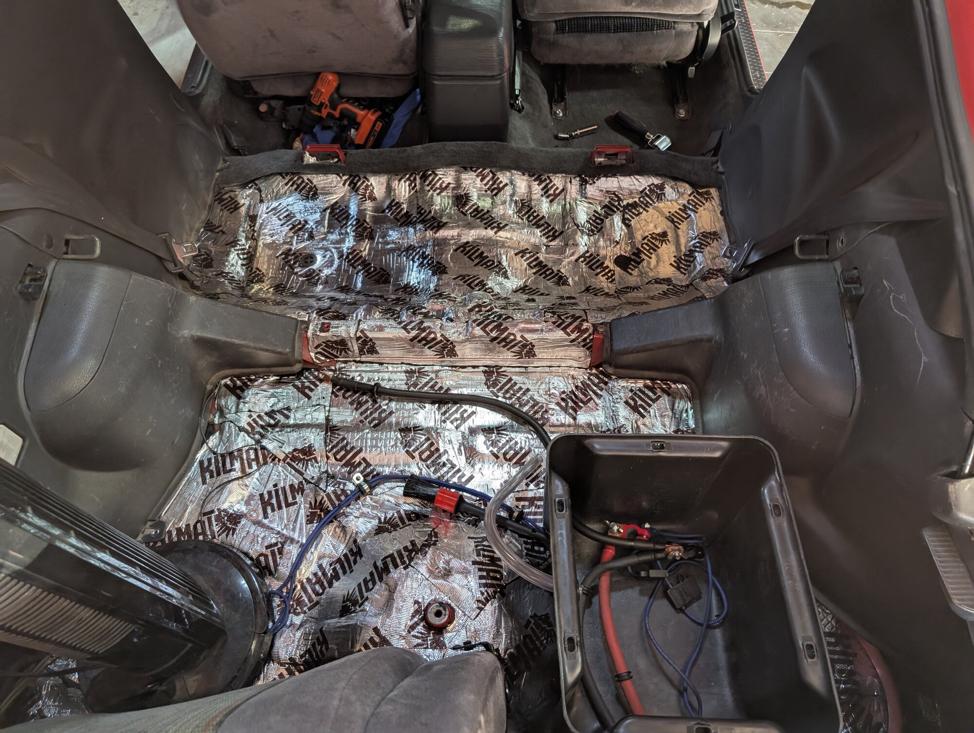

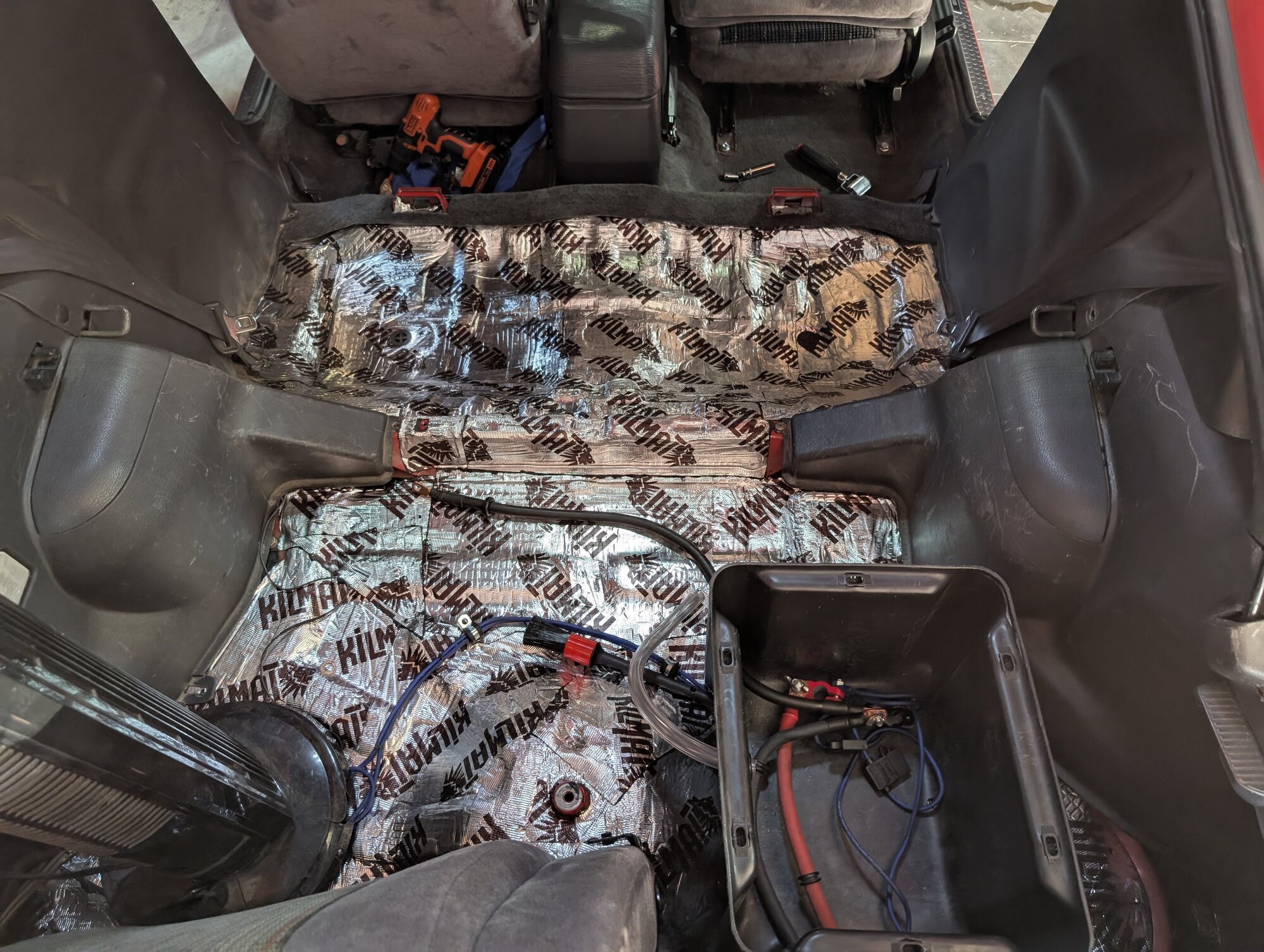

Finished getting the KilMat installed where I could without taking the interior panels off.
Made it as far as the edge of the back seat and that's where I'm going to stop for now at least. Hopefully this helps with the drone I have which isnt AWFUL but it could be better. If I need more, I've got enough to do probably one half of what's left of the car.
This process wasn't hard but it was a decent amount of work. Mostly just rolling everything down.
Made it as car as the edge of the back seat and that's where I'm going to stop for now at least. Hopefully this helps with the drone I have which isnt AWFUL but it could be better. If I need more, I've got enough to do probably one half of what's left of the car.

I was thinking about getting into this project when fall rolls around, how much time do you have into it so far? My Thermal has gotten louder over the years. Not enough to annoy me just yet, but enough for me to thnk to myself "God damn thats loud.."
Doing as much as I did without removing panels and what not I would say I'm about 4 hours in

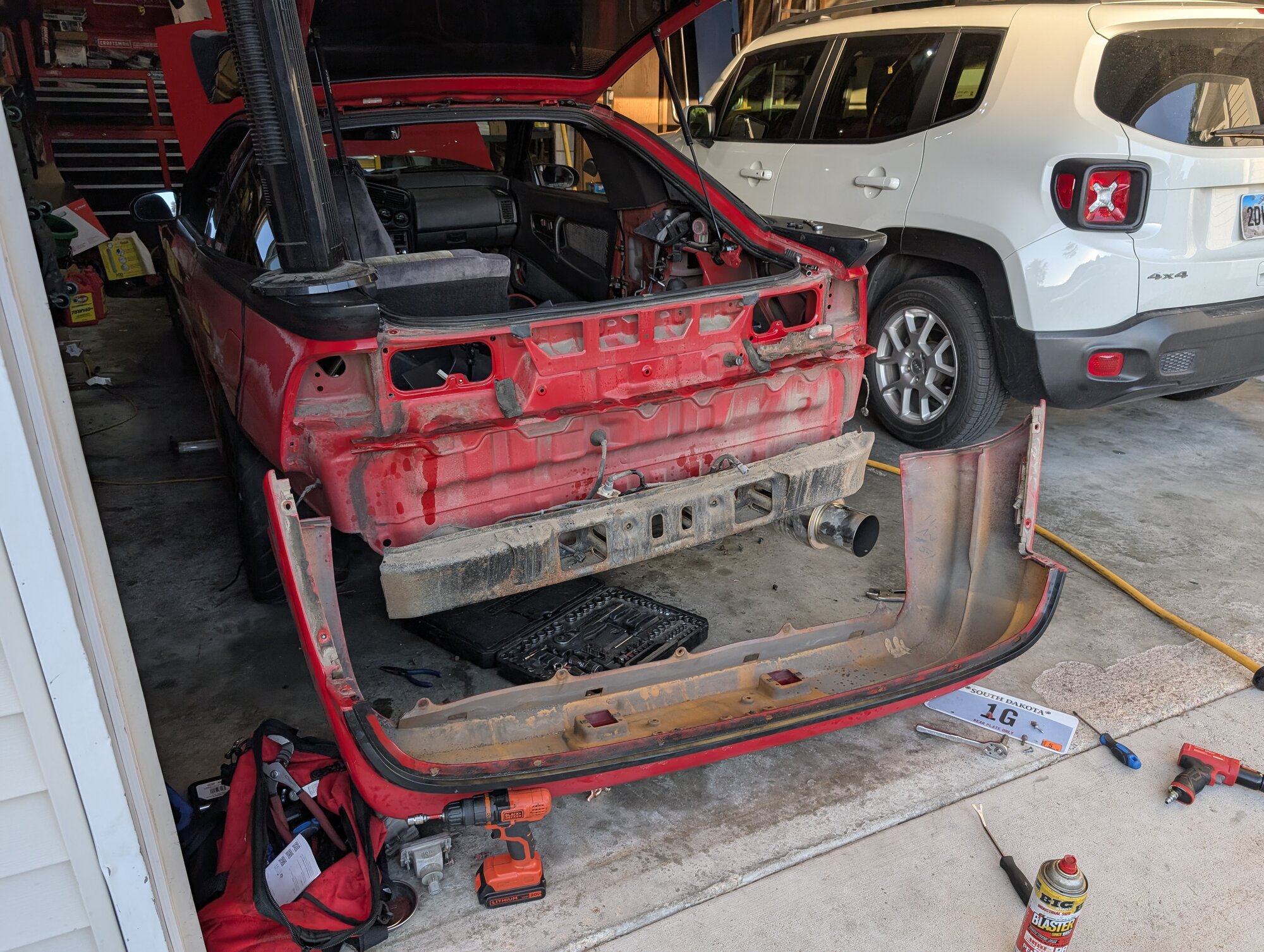

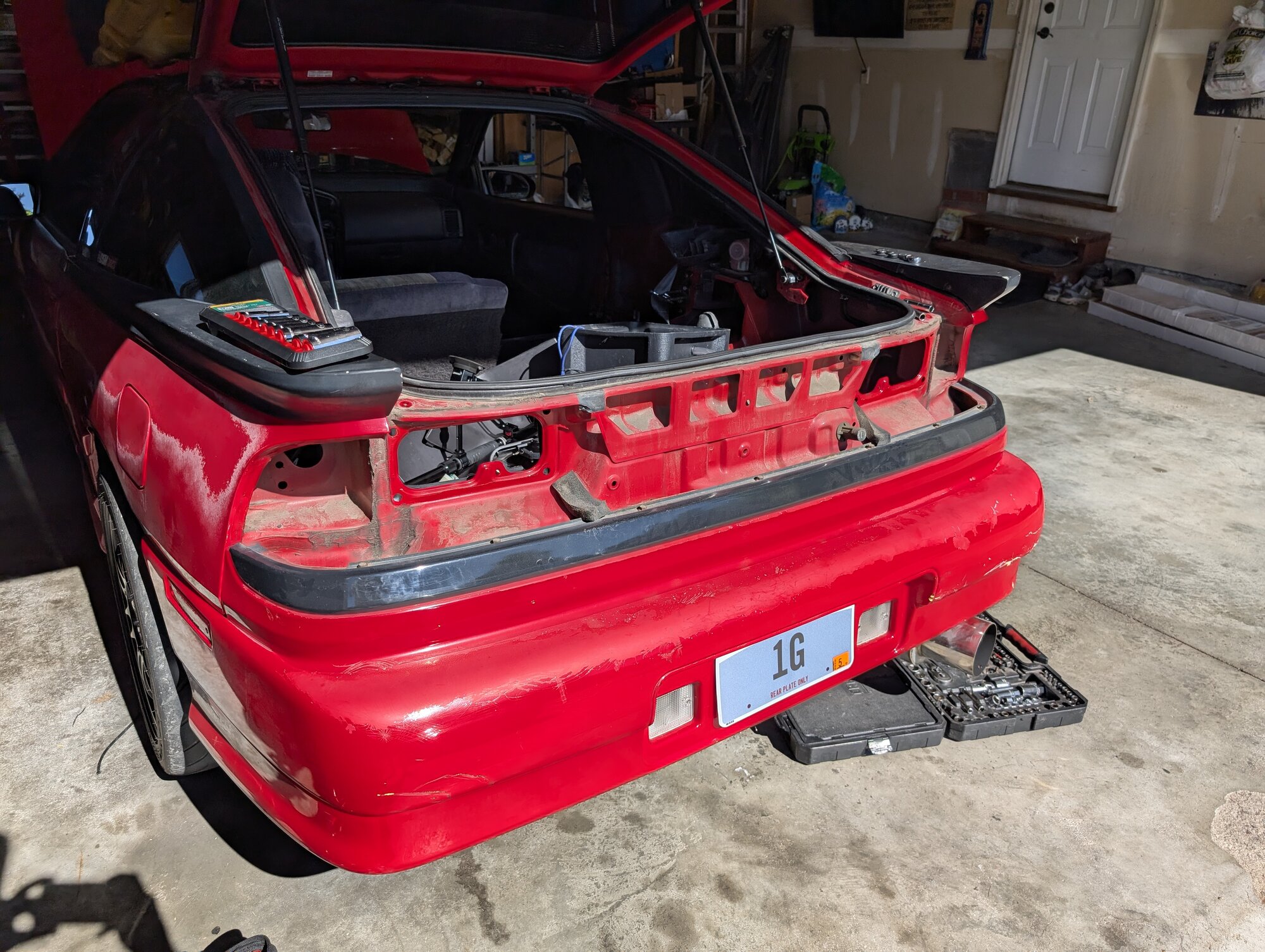

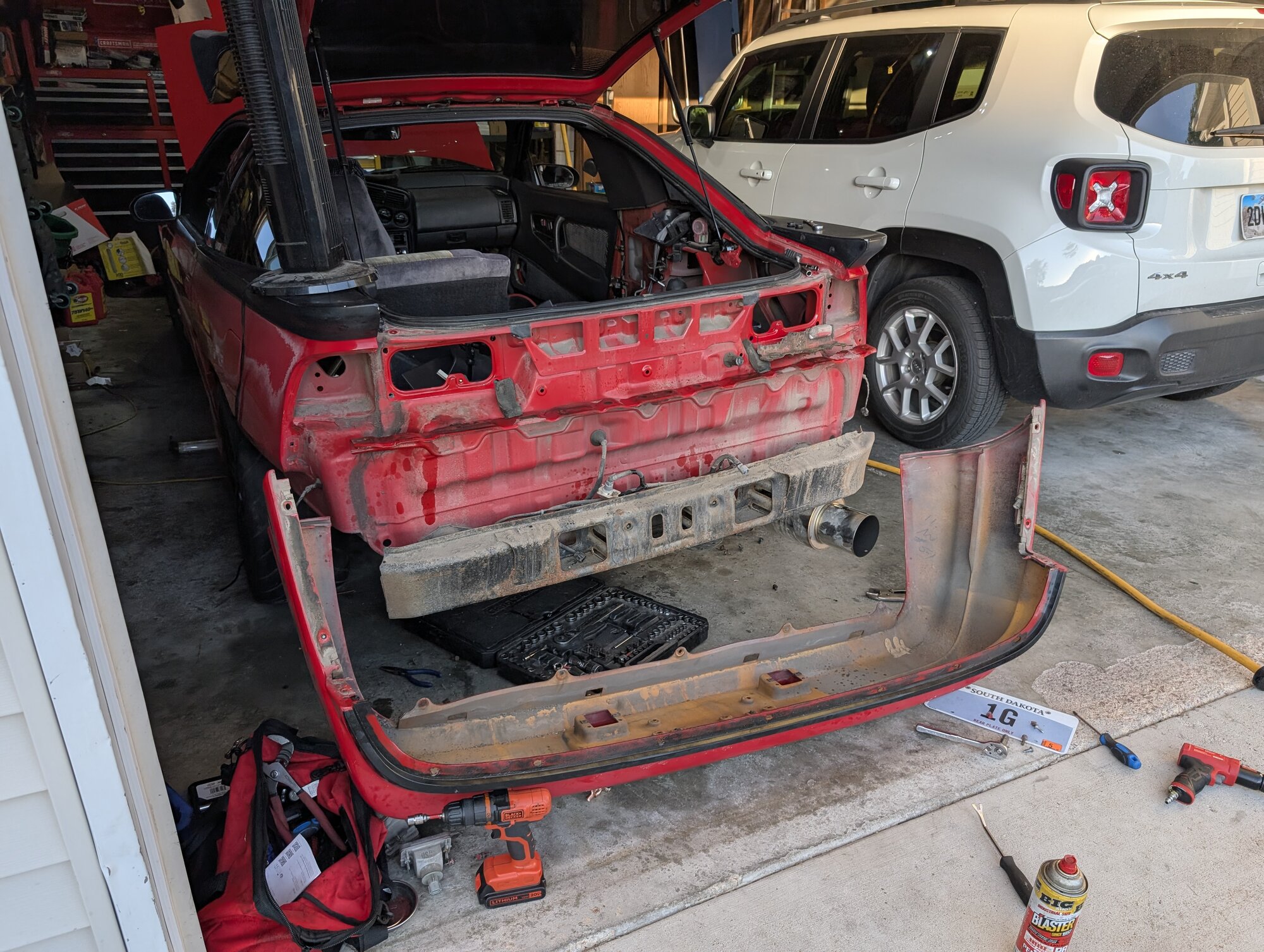

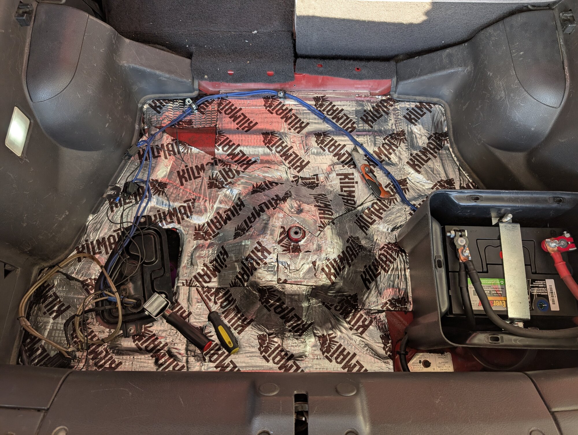

Well, the battery re-wire AGAIN has commenced. Pain in the butt like it always is.
Biggest thing right now is getting the remote shut off switch mounted and installed.

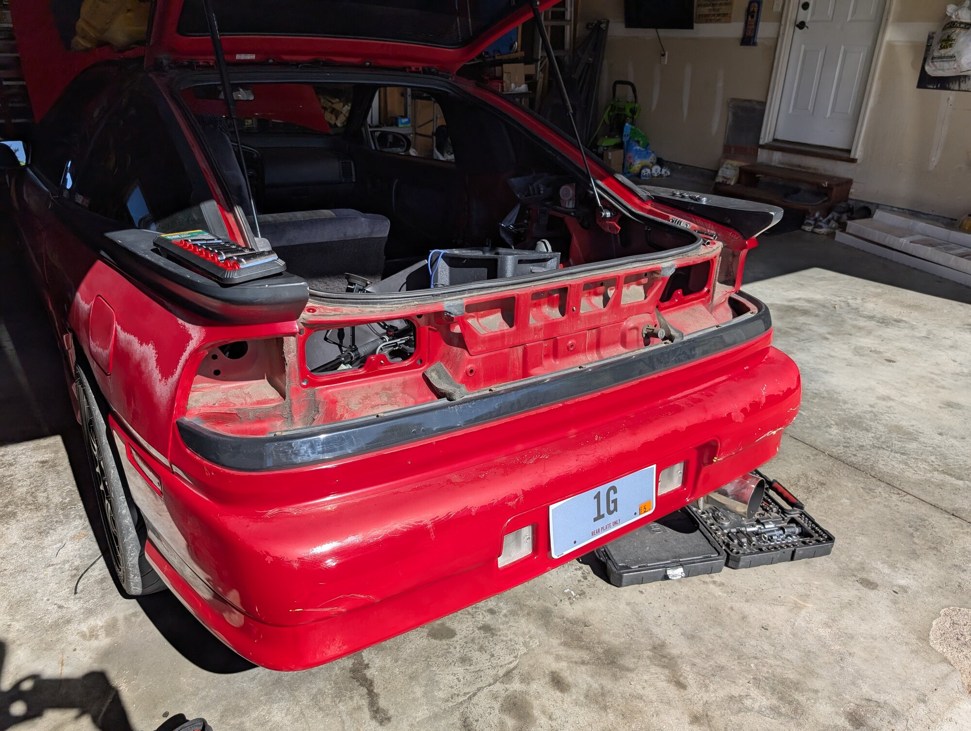

Removing the rear bumper is the most frustrating thing I've done on this car to date. Broke all but 2 screws that mount the bumper. After I broke them I was able to use vice grips, heat and penetrating oil to break them loose and manually unscrew them. I'll have to get some new bolts for them.
I think I'm going to mount the switch to the rear crash beam and the switch should stick out right above the passenger side reverse light.
Dude, removing the rear bumper is WAY more work than it needs to be on these things! I was shocked by how much effort it was to remove it from my car.
No doubt. It really sucks haha. Sucks that the tail lights have to come out too. Makes a lot more work for me since I have to remove the battery box in order to remove the trim back there.

I was going to help a local by giving him the rear bumper off the parts talon for free but then I looked into it and noped out. Screw that. Lol.
You did yourself a favor LOL I'm really not exaggerating. The only thing that has come close is steering rack bushings. Sway bar with new bushings. Those were a b*tch.. and I've pulled the dash 3 times too.
The only thing that has come close is new steering rack bushings. Those were a b*tch.. and I've pulled the dash 3 times too.
So you're saying the steering rack is harder to remove than the dash? I R&R my rack 3 times but never the dash, which is on my list for a new heater core. I'll avoid the rear bumper cover, thank you very much.
Not just removing it, but installing with new bushings was definitely harder than removing the dash.
Sorry I mean away bar! Not steering rack. Sway bar and bushings.
