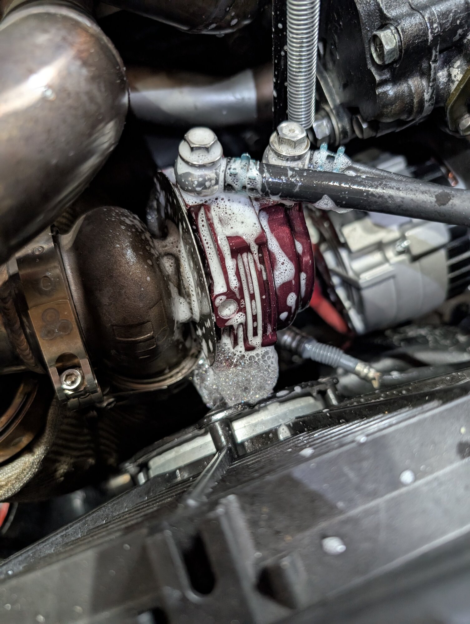

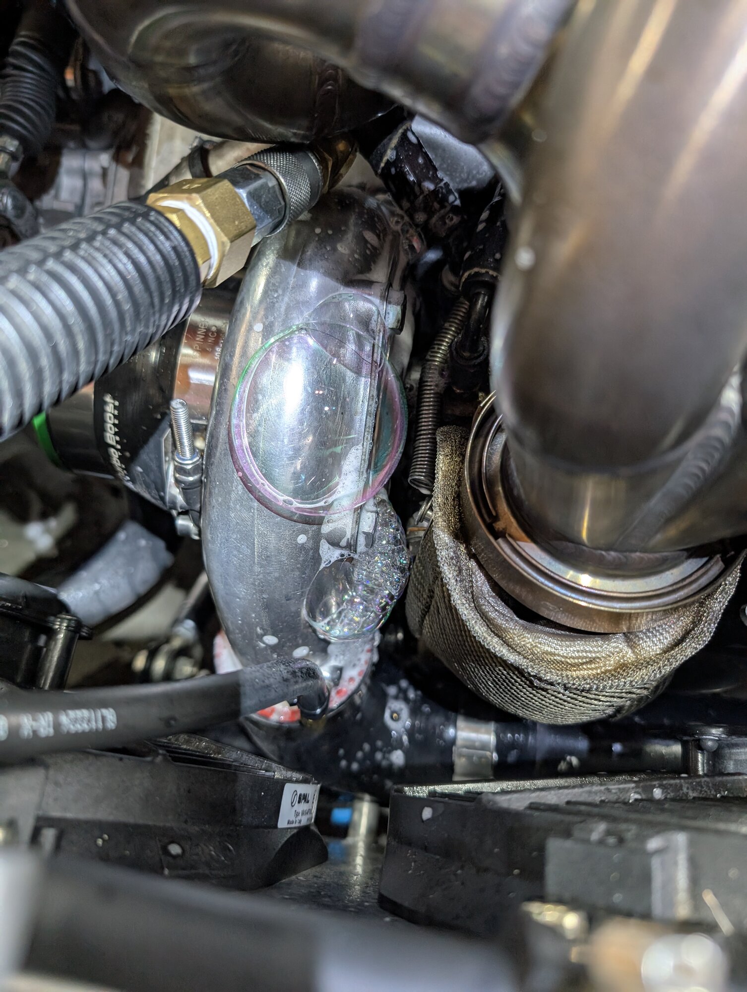

Saturday I did a boost leak test again with soapy water but this time I sprayed a few more places.
The backside of the compressor housing. Between the housing and backplate, and the wastegate lines AND the plugs for the bottom of the wastegate too while turning on the solenoid in the ECU to send boost pressure to the wastegate
This is what I found:
I guess make sure to check everything that sees air when you do a boost leak test.
I have a new oring on the way for the turbo, and I've already fixed the wastegate ports.

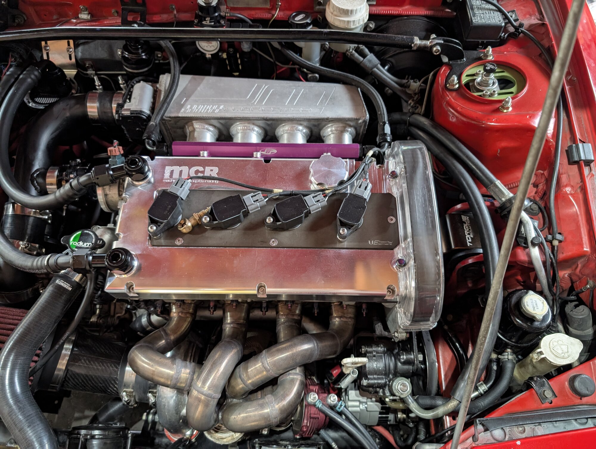

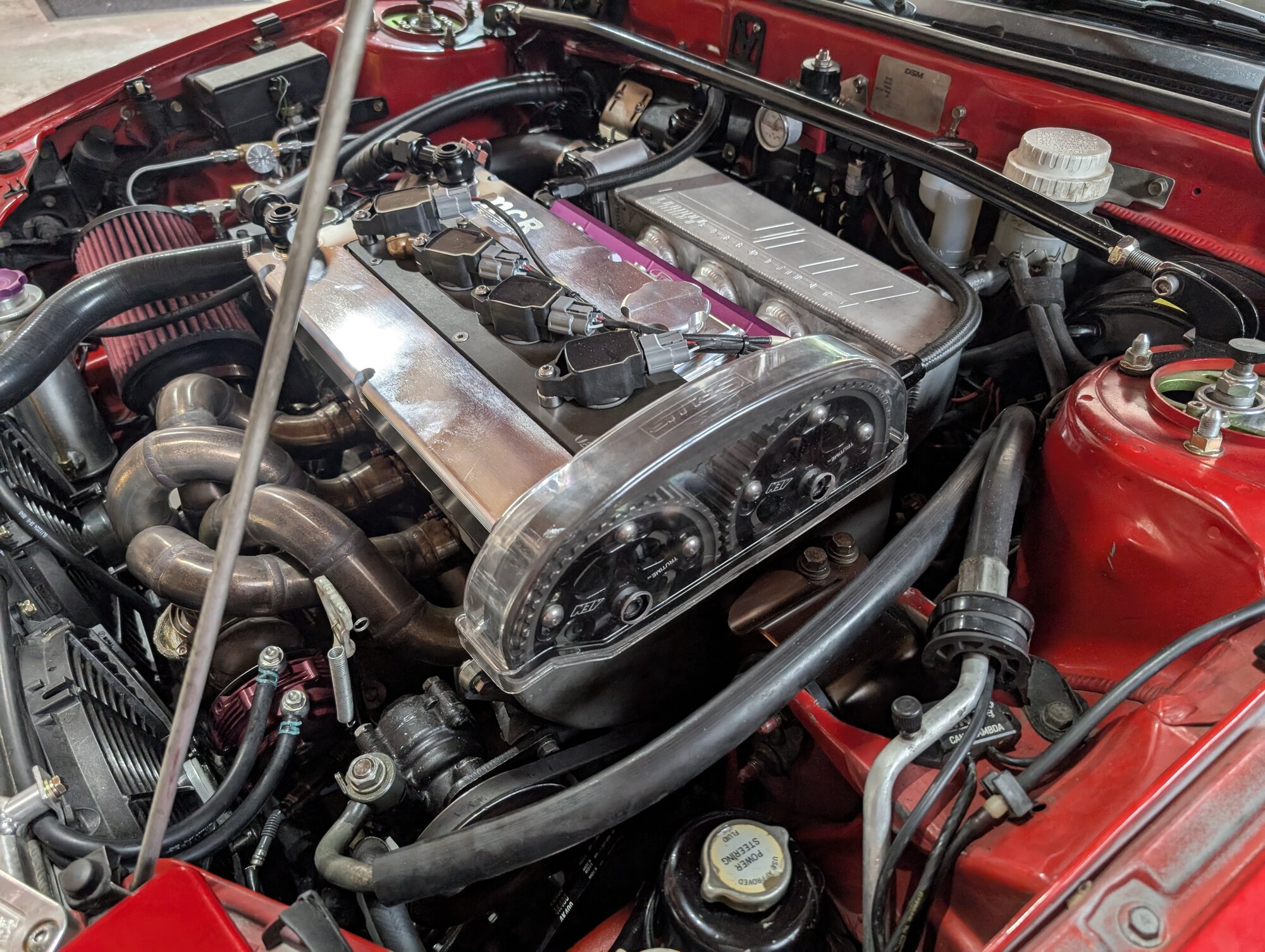

Also trimmed up the timing cover and got the clear cover back on with the MCR valve cover.
Ended up having to buy YET ANOTHER freaking alternator belt for the Fluidampr Crank pulley since it's apparently bigger. I did shave down the little bit of timing cover behind it with an electric sander and a file where that wouldn't reach. No real noticable difference between stock pulley and fluidampr but I didn't expect to.

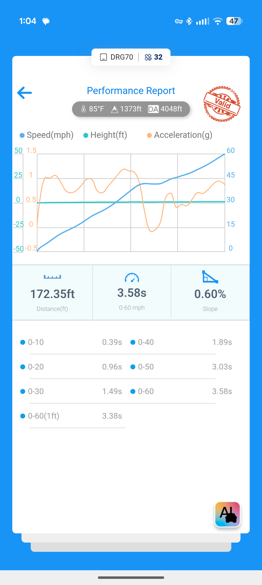

Well boys n girls we made it to the track last night and made 7 passes.
6 hour drive back home and then maybe tomorrow I'll upload some videos of the runs and what not. A little disappointed in the time but I have no actual drag seat time and it was almost 90° AND 85+% humidity all night and I was down on boost likely because of it.

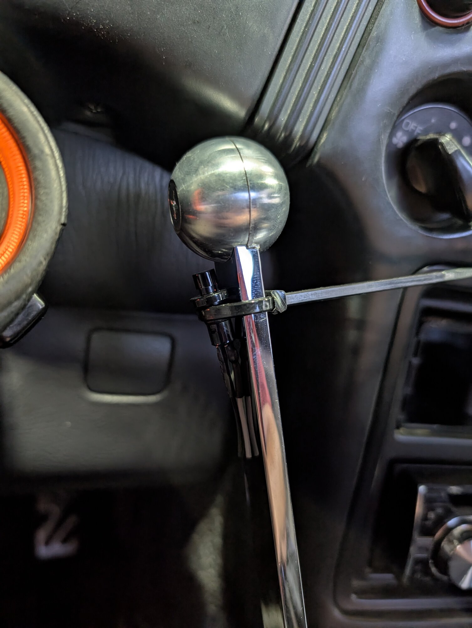

Thinking of switching up my launch control strategy from using my clutch switch to a button on the staging brake since my clutch doesn't really even start to engage until close to the top it feels like, I'd like to be able to stage and pick up the slack in the drivetrain while using launch control also.

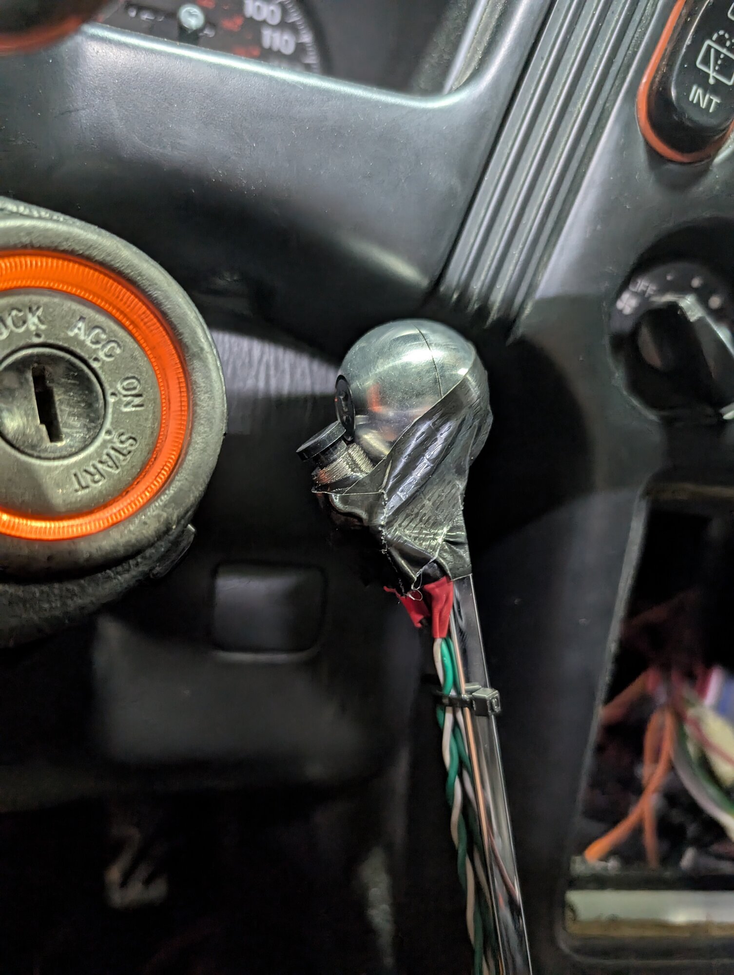

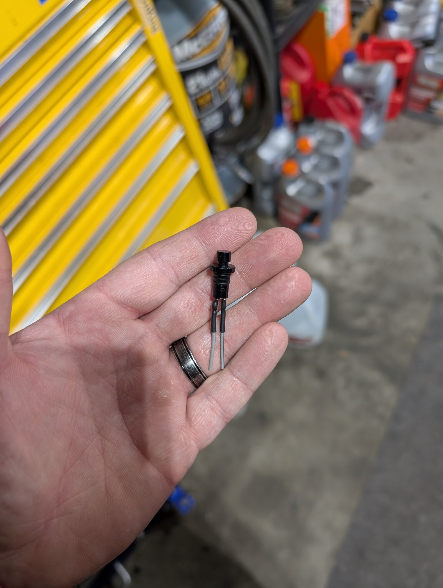

Been awhile since i even really touched the car but got around to bleeding both the brakes and the clutch again the other day and then worked on wiring in my switch i posted in the last one into the clutch switch so that i can use a button on the Staging brake for launch control so that i can preload the clutch.
I was able to get the wire wired in but i ended up having to wire it into my Antilag button instead because the lower clutch switch, and my button are reverse default state. The lower clutch switch is default CLOSED so its completing the circuit all the time and the button is default OPEN. Obviously this wasnt going to work. I did verify that with a multimeter as well, AND the config in the ECU.
I did have to switch what switch i used on the staging brake too because i must have damaged mine when i soldered new wires on to the contacts on the bottom of the switch because it only worked sometimes. New switch works 100% all the time its pressed. This is 100% the most "DSM" like thing ive done to this car LOL this is hopefully only long term temporary and someday if it works out well ill incorporate a smaller switch of some sort into the handle and itll be a lot cleaner.
