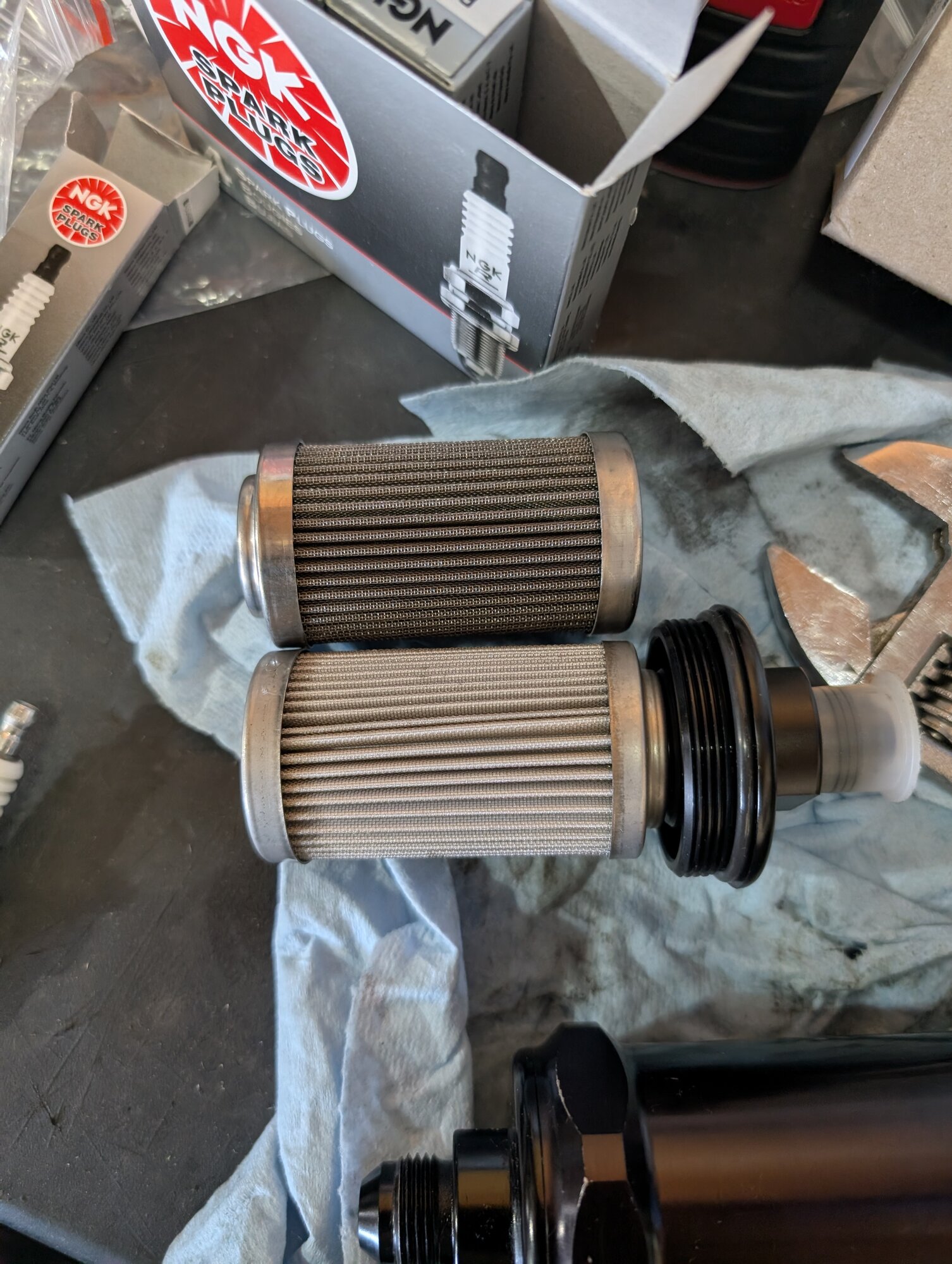

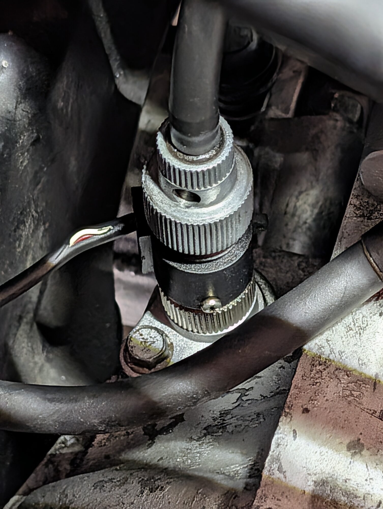

Replaced the fuel filter. Still looked decent but you can see the darker discoloration in the old one (top) from the ethanol I'm assuming. I never saw any fuel pressure issues but preventative maintenance I guess.

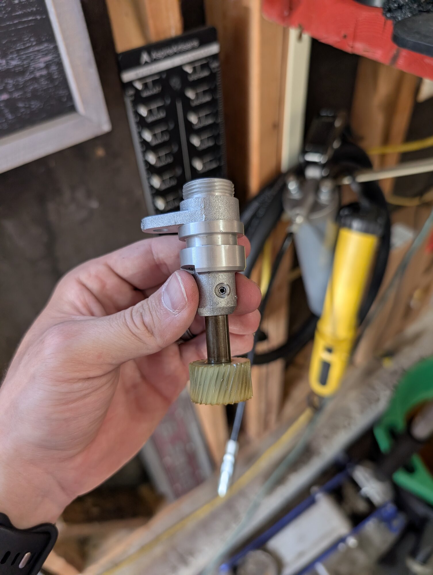

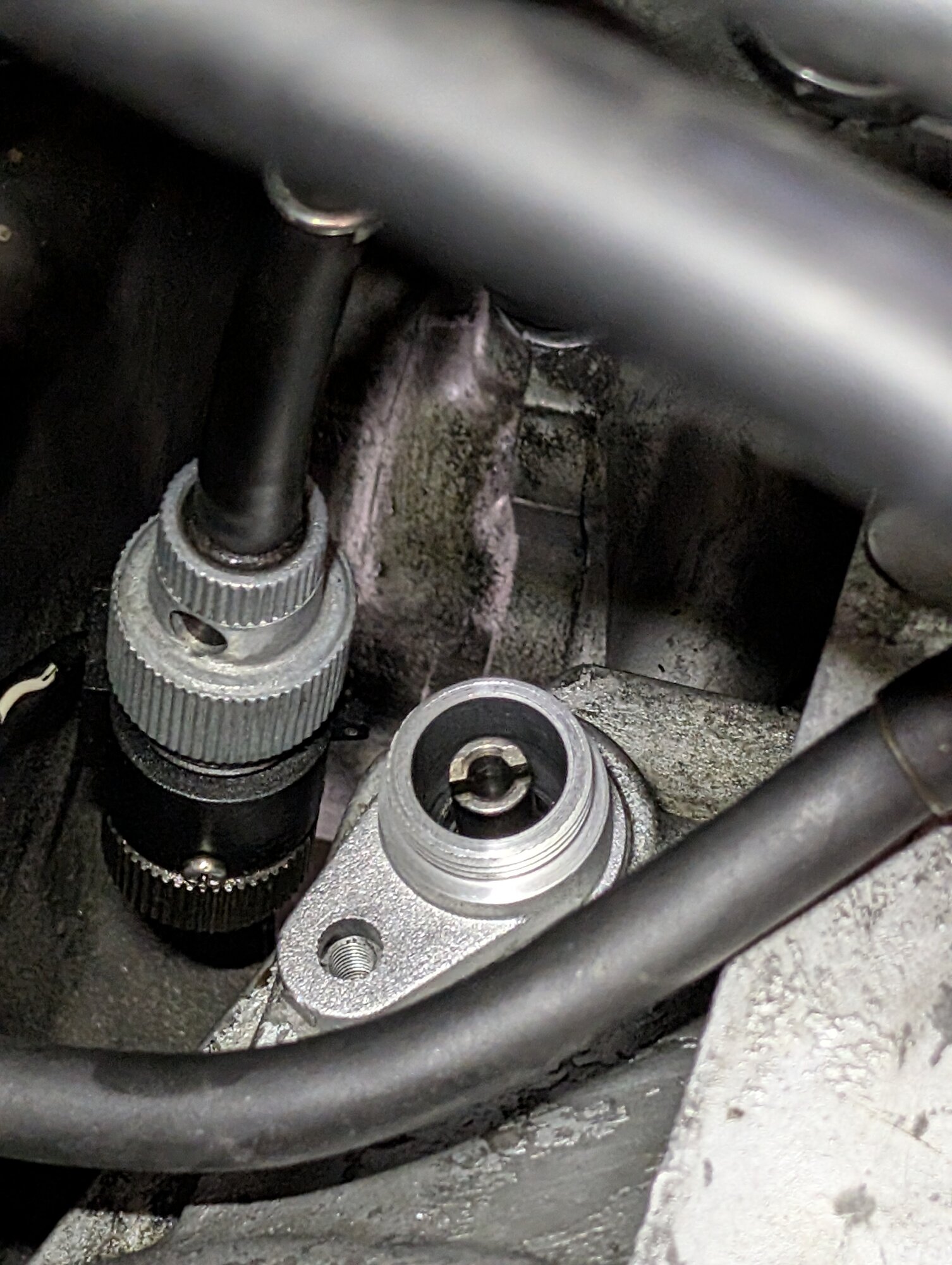

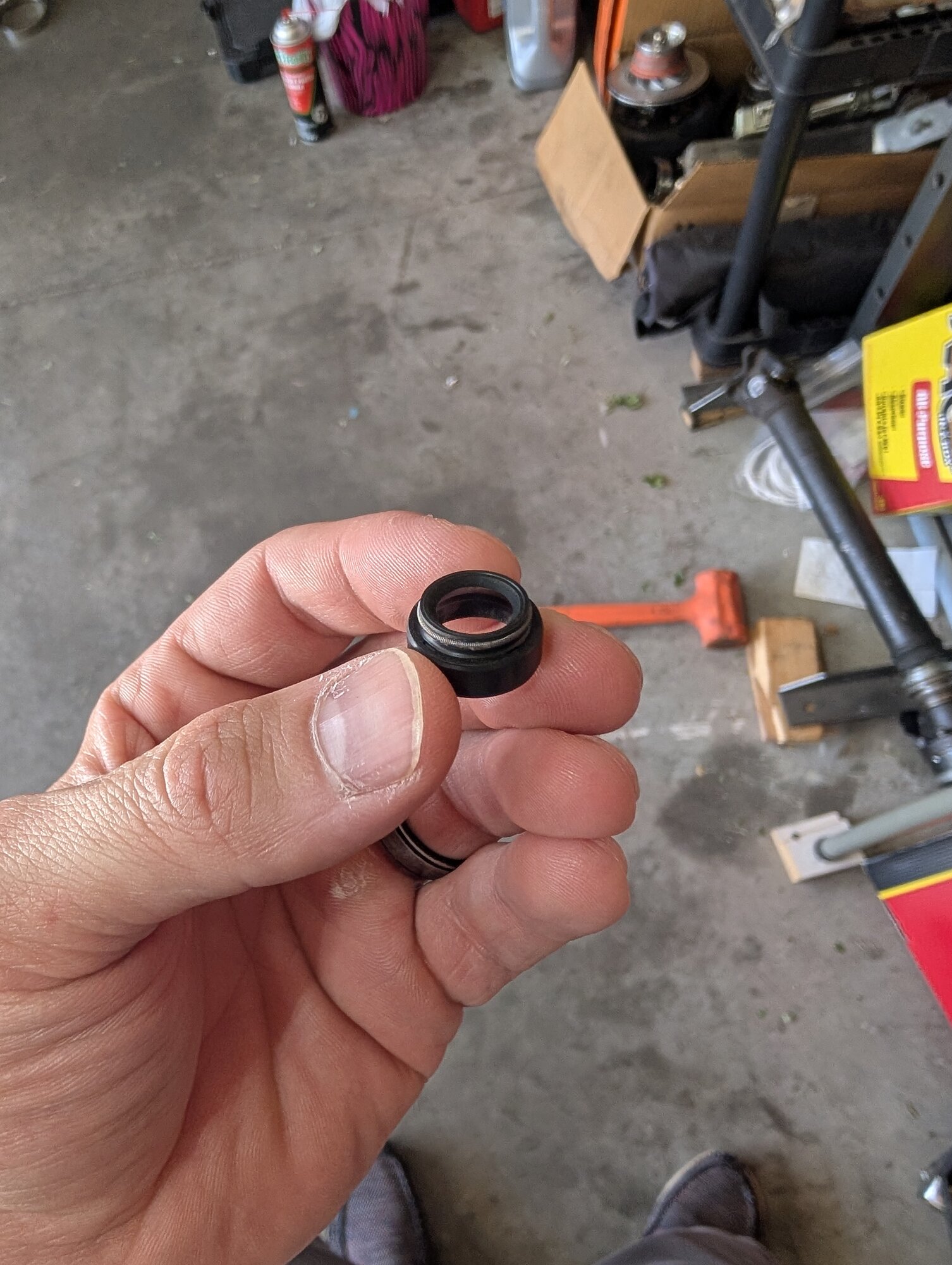

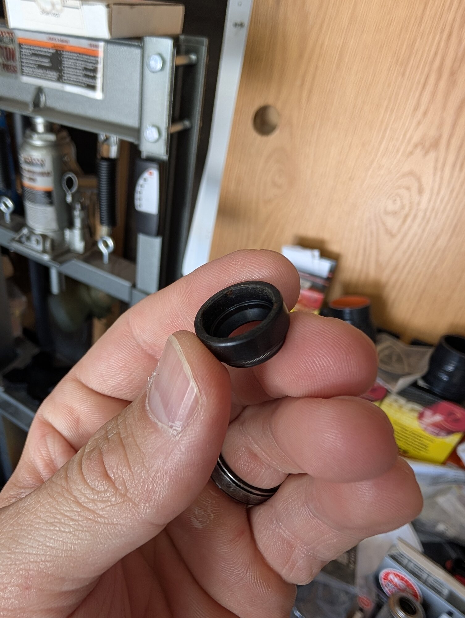

New seal for the speed sensor gear came in. ( Part number in pictures) It looks almost identical to a larger diameter valve stem seal which I thought was interesting. Also when these are installed, they are installed upside down. So the spring side is pushed in towards the gear / transmission side. I pushed it in the wrong way the first time and then checked the old one and it was opposite. Managed to carefully push the new one back out and flip it.
PXL_20260714_220144438.jpgPXL_20260714_220149697.jpgPXL_20260714_221325970.jpgPXL_20260714_221830844.jpgPXL_20260714_221630079.jpgPXL_20260714_222009563.jpg
Definitely feels like it seals against the gear shaft now. It's firm but not hard to spin. Can wait to drive this thing again. It's been pretty much 90+° everyday for the last like 2 weeks here and I HATE driving this thing when it's that hot because it turns into an oven.

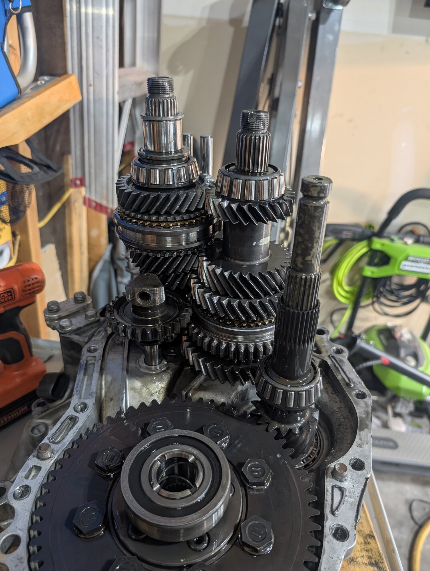

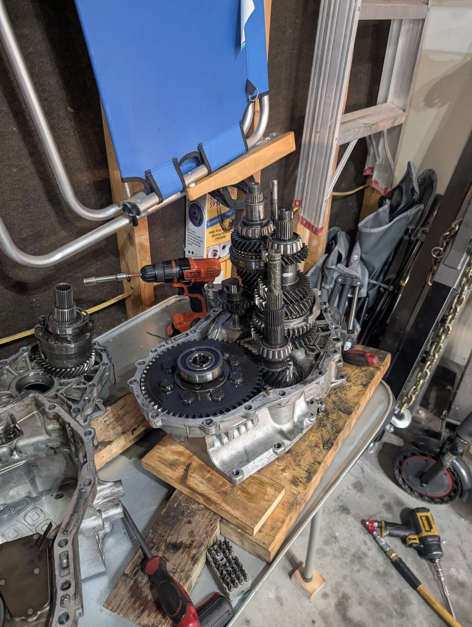

So I took the car out last Friday night for a cruise night and 3rd was feeling a little goofy. I had admittedly missed 3rd pretty bad twice now which is weird for me but it happens.

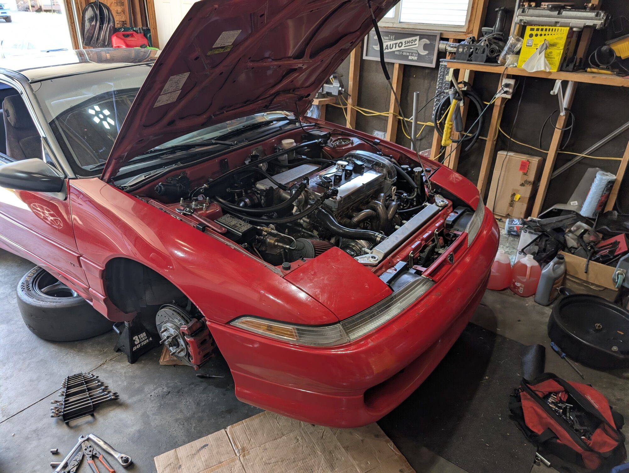

With the track coming up in a couple weeks I made the last minute decision to pull the trans a tear it apart to check 3rd and see if I can swap in another 3/4 setup to see if that helps or is healthier than the one that's in there.

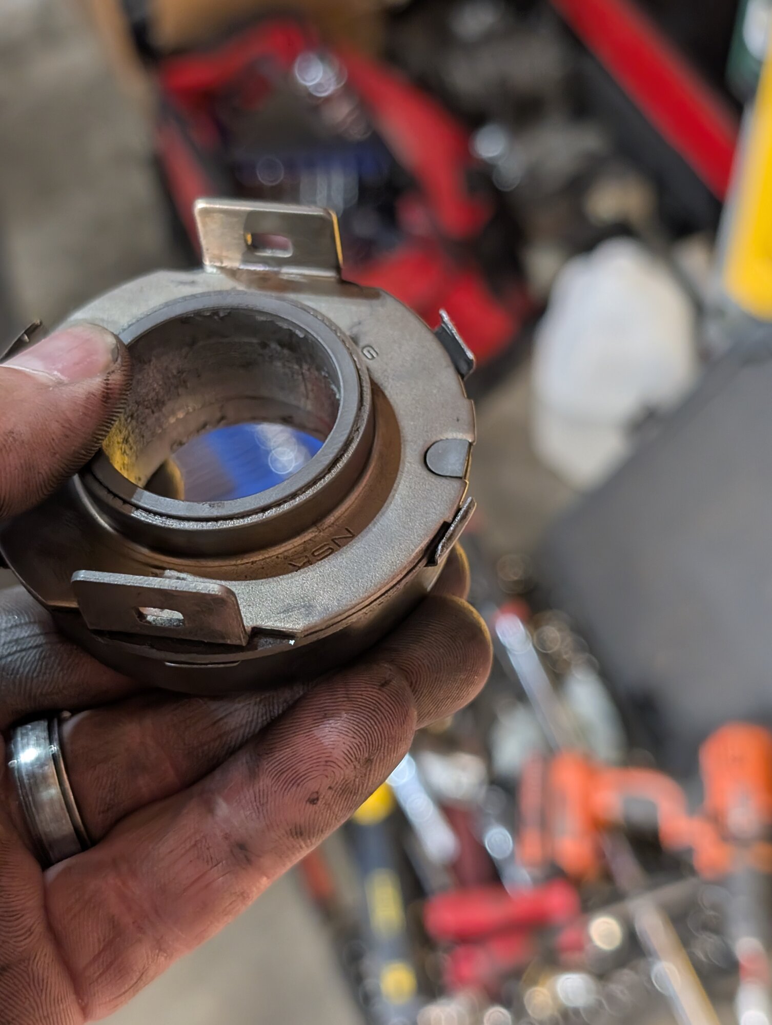

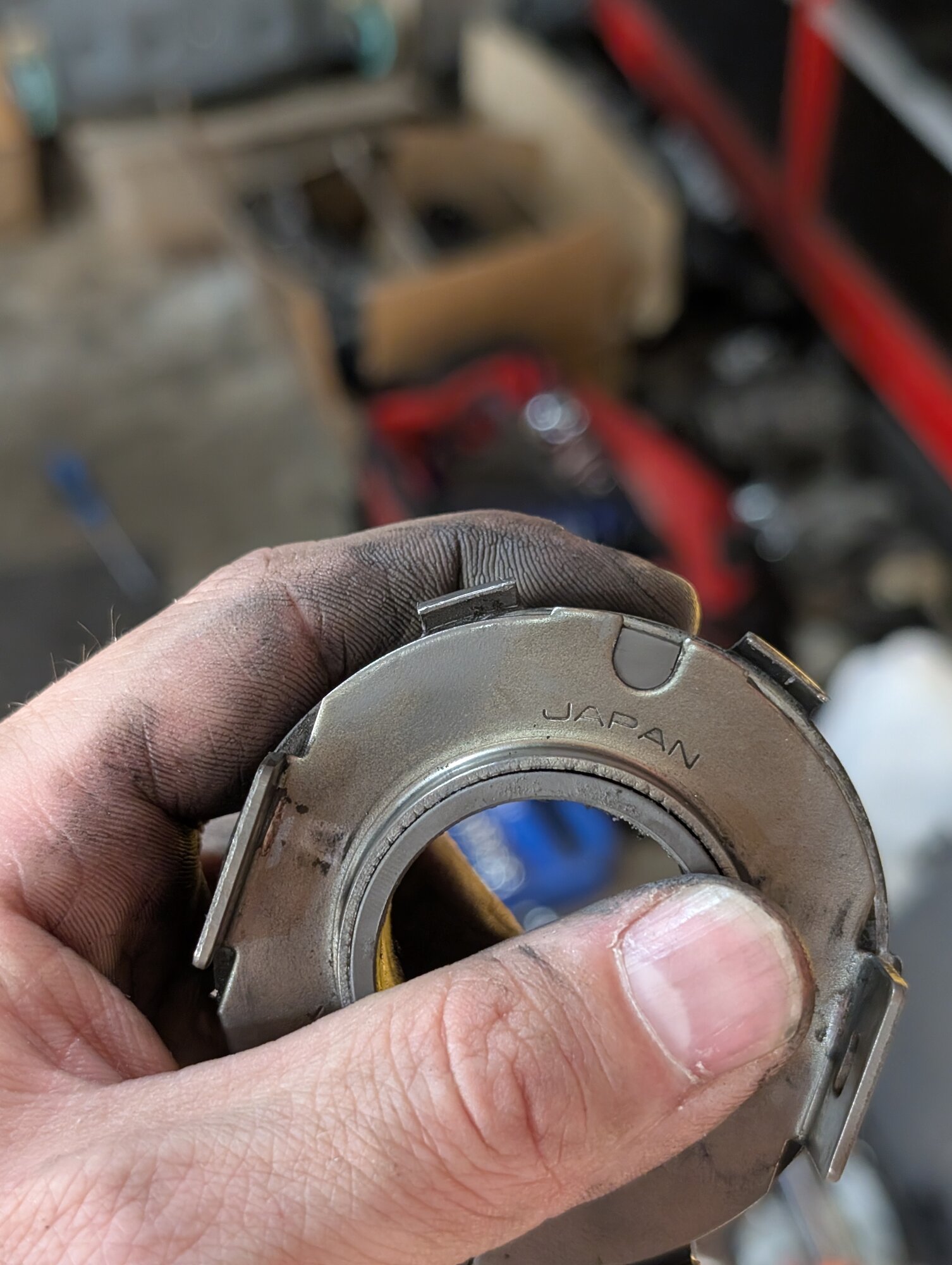

Boy am I glad I did. I found the throw out bearing like this after pulling the trans out.
This throw out bearing was replaced like 1000miles ago when I rebuilt the clutch with new friction disks and floaters, brand new OEM.
There was no actual damage of any sort. It didn't explode. The tabs that hold the 2 halves together just literally bent and it fell apart.. I can only imagine that the pressure plate and clutch fork were the only things holding it together.
In hindsight I do remember the transmission area making noise when I first start the car up but figured it was just the twin disk floaters clattering around like normal. Noise significantly quieted down after pressing the clutch in once.
Does anyone know why this would happen? So I can try to prevent it again?

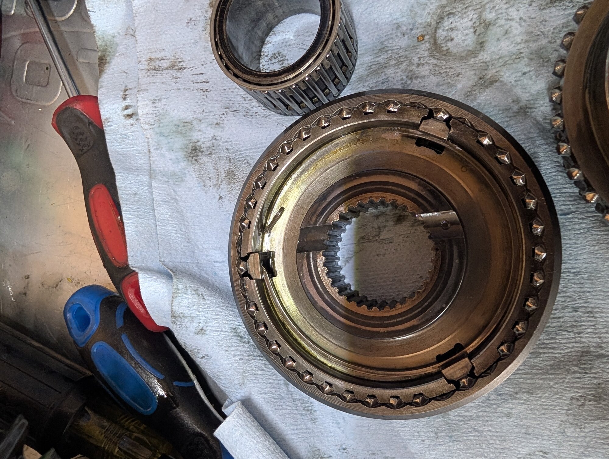

Fortunately I don't see anything else catastrophic INSIDE the trans but preliminary looks at the 3rd hub/ slider looks like they definitely took a beating so I'll see about cleaning up this spare deal I got and swapping those in.

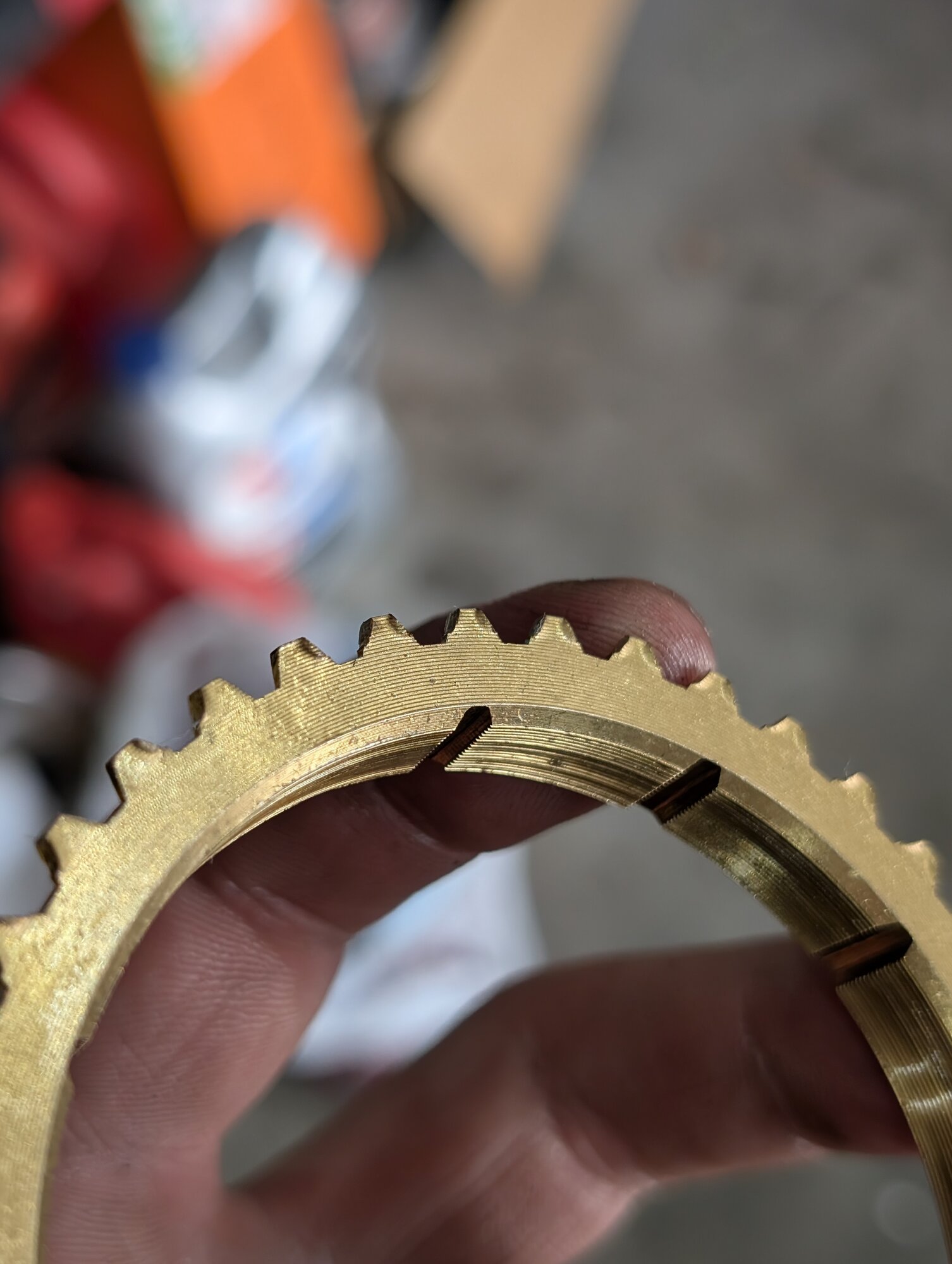

Well I cleaned up and deburred my spare hub and slider and 3rd gear dog teeth the best I could and got it all slapped together with new synchros for 3rd, 4th, 5th and reverse synchro. And got the trans all back in the car. Waiting on gear oil (should be in tomorrow) and I need some new cotter pins for the axle nuts. Gotta stop at hardware store on the way home today.
This was the topside synchro for 3rd, definitely chewed up good.
Every time I've taken the trans apart recently I find the synchro key springs broken right after the little bump in them.. why does this happen? This happened on both 3rd and 4th gear side of the hub.

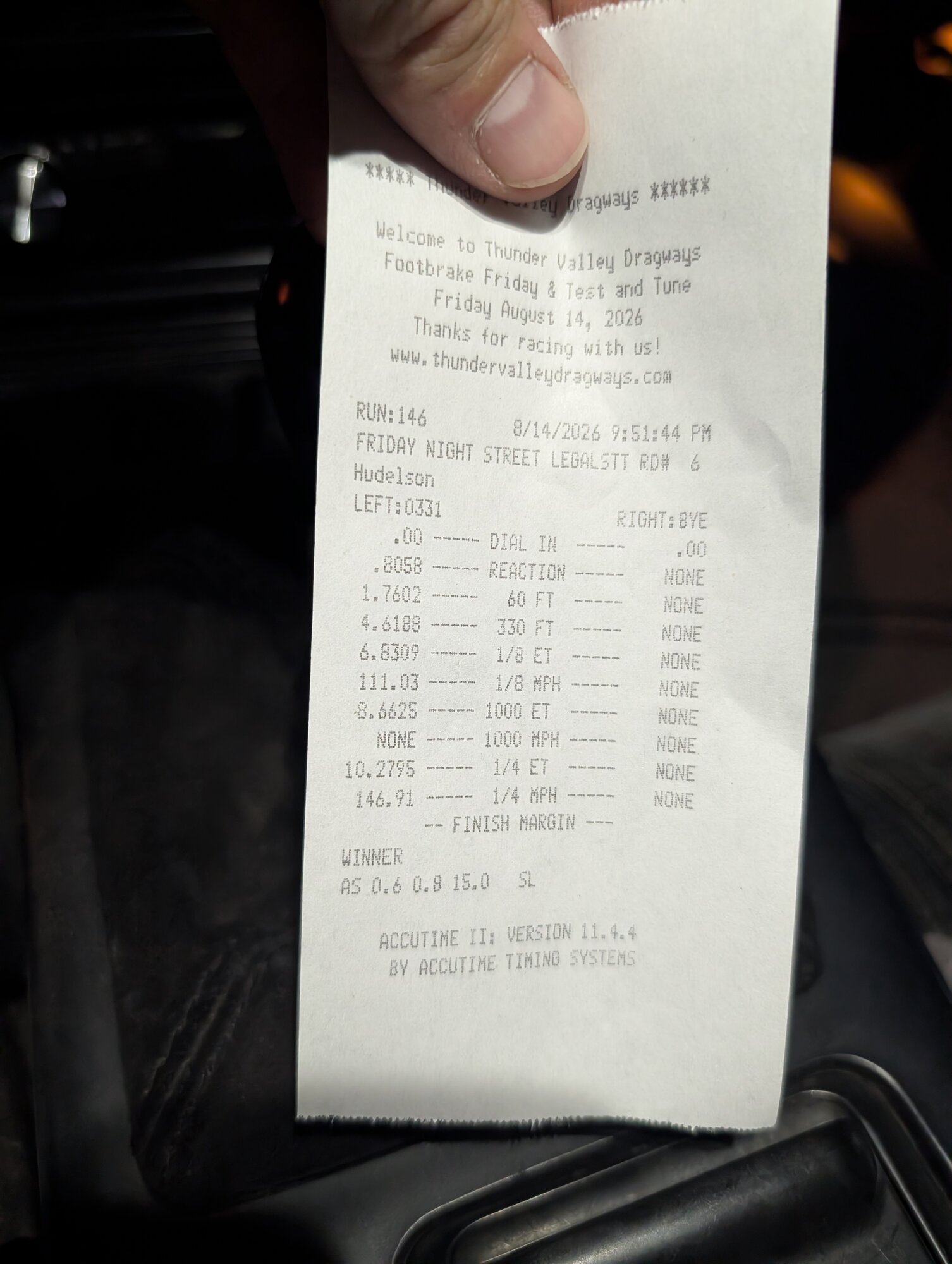

We didn't quite hit the 9 I was shooting for but settled for a SOLID 10.2 @ 146.9

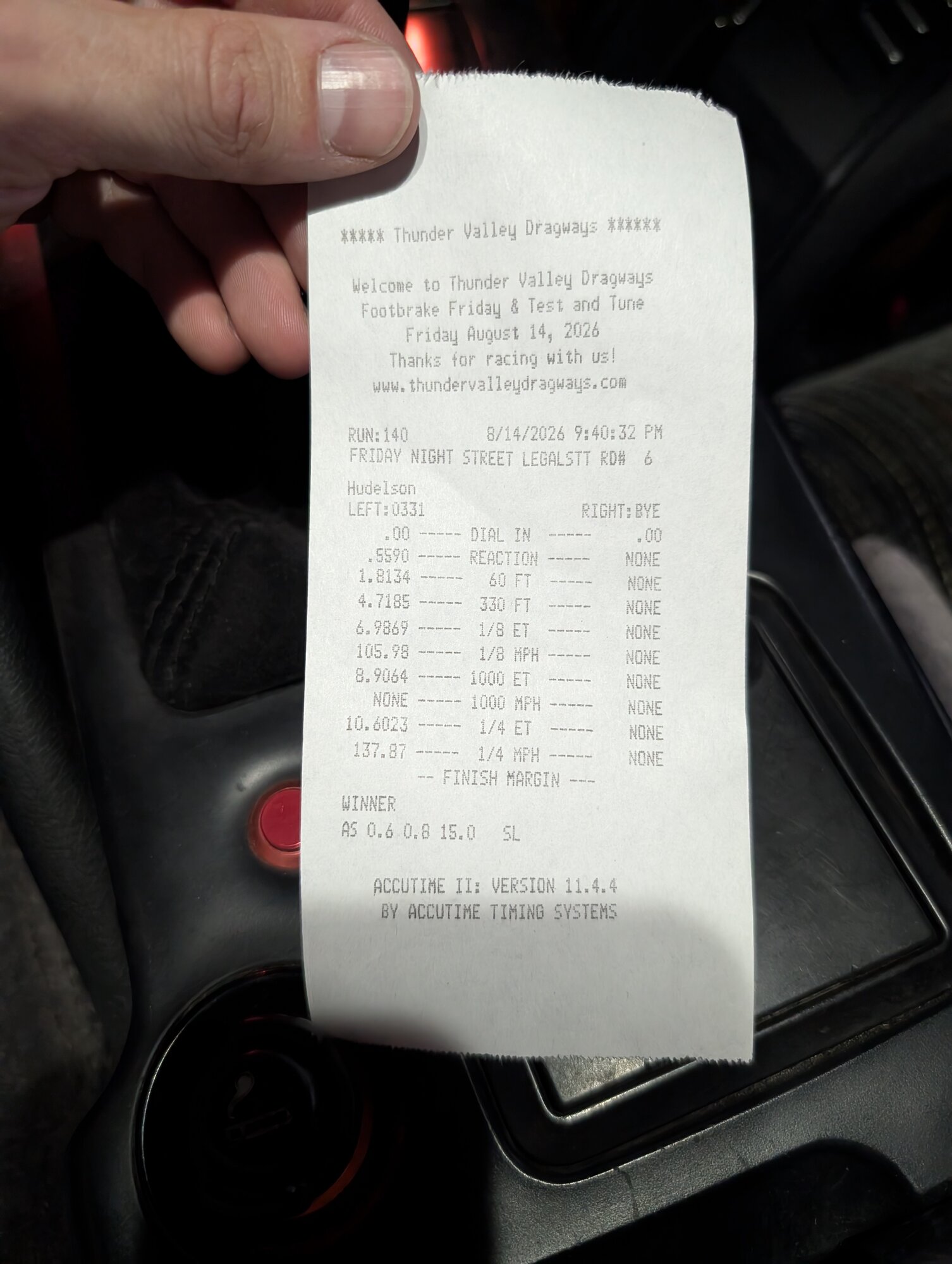

ALL of my passes besides the last 2 had issues with boost cuts due to hitting my boost cut safety @ 50psi. It was humid but elevation is about 1500ft lower, DA was ~ 1200ft.
My 2nd to last pass I lowered wastegate duty and and went 10.6.
Then the last pass of the night I lowered wastegate duty again about 2% (started off the night at 50% wgdc because that's what it requires to make 47psi at home, and ended the night at 45%wgdc) and I raised the launch rpm from 5500 to 5700 and focused on preloading the clutch. Car bogged but still managed a 1.76 60' as the car came into boost after the bog I said "eff it" and no lift shifted the whole deal and that 10.2 was the result. No break ups or boost cuts!
So close to a 9. New 8th mile PB as we @ 6.8x
I didn't record inside the car because I was pretty frustrated with the breakups and what not. Hindsight, I wish I would have.

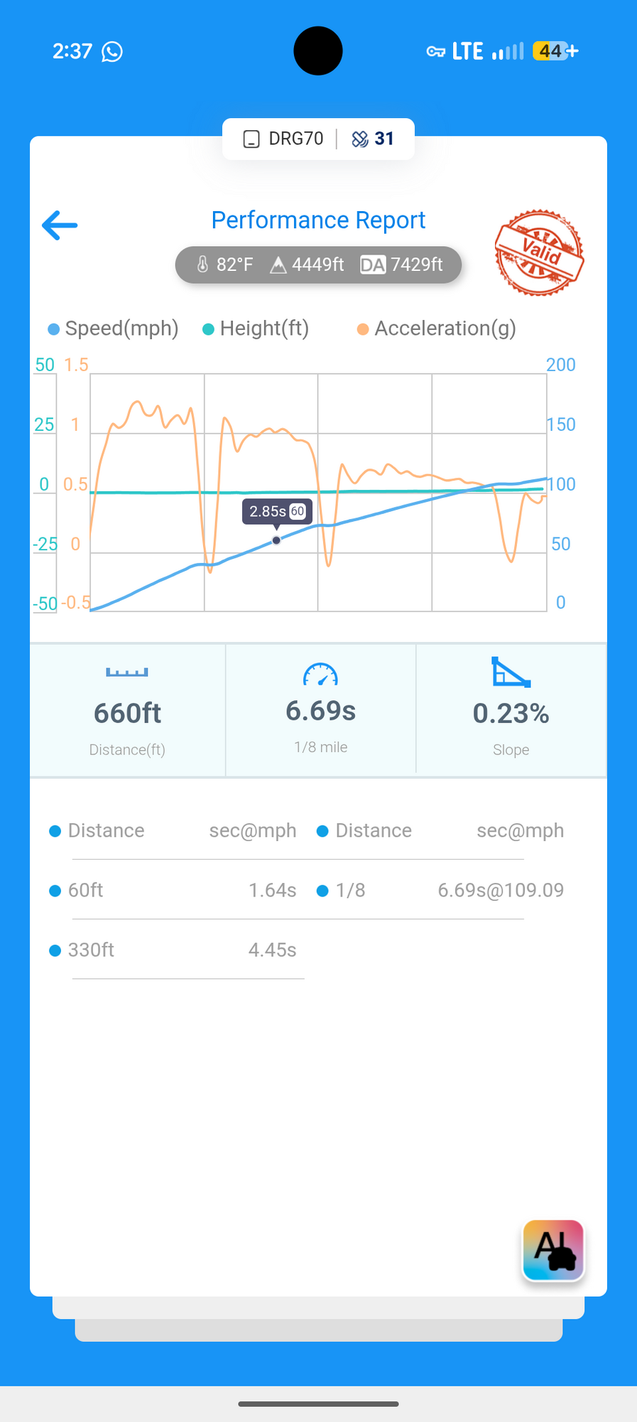

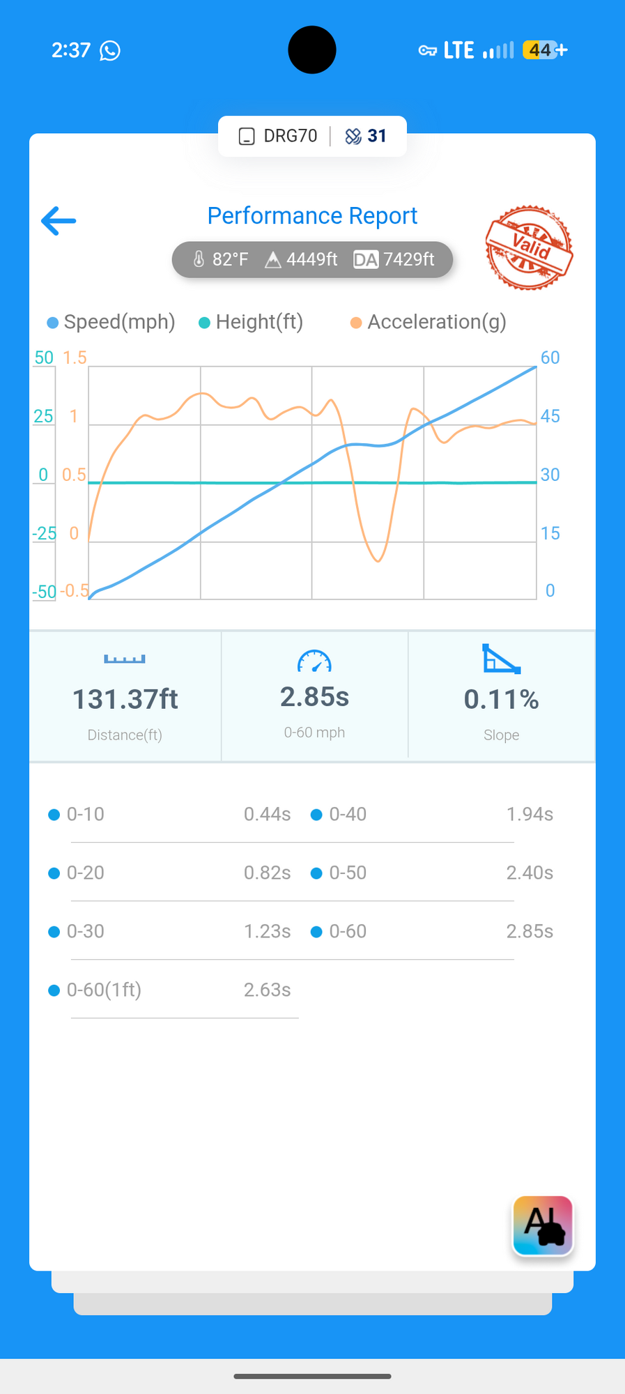

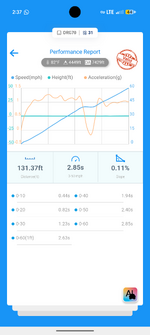

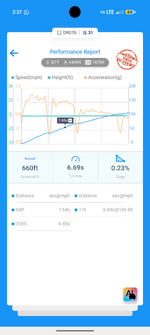

The good news is that according to draggy I PBd my 60'( 1.64), my 8th mile (6.69) and my 0-60 (2.85). I called it a day there. I was happy about the new PBs and didn't feel like potentially breaking the car. Super fun turnout!

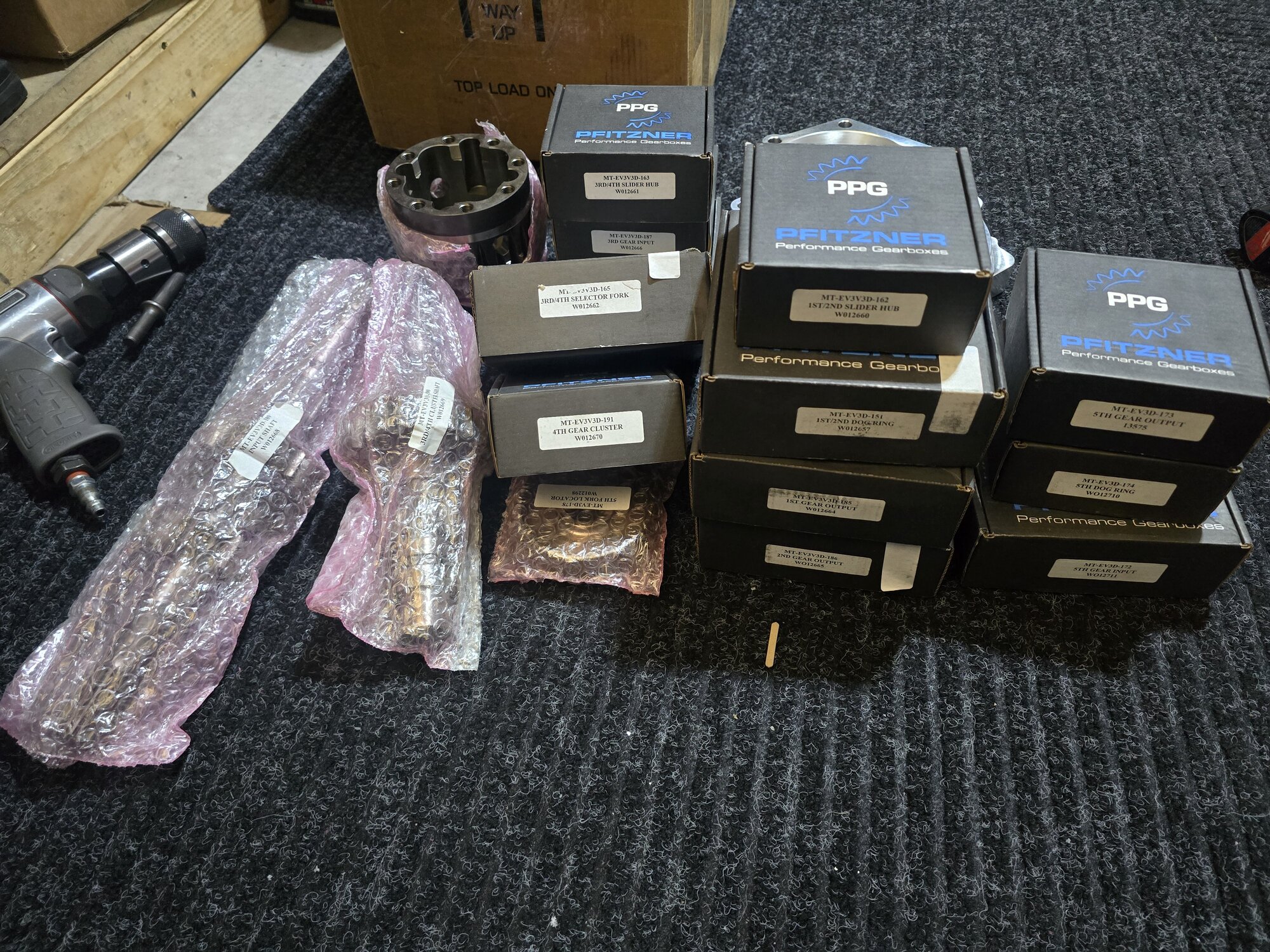

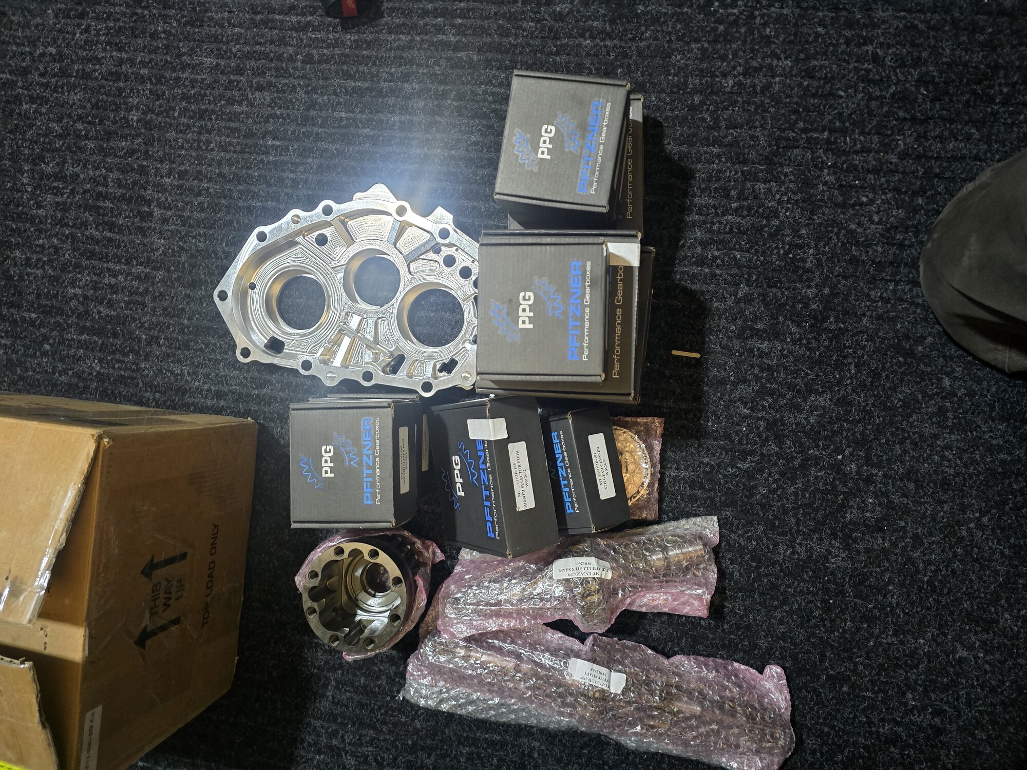

Okay boys big news. This has been in the works for a few weeks I was able to do some restructuring and make this work.
After a post looking for PPG stuff on Facebook someone messaged me and they already had one state side so I didn't have to pay tariffs and I got it for a decent deal. So this is going down!
Gearset already paid for and it's already with Tim at TMZ.
The trans setup will be:
- PPG 1-5 ( I wanted helical 5th but Tim said that 5th synchro becomes a wear item and needs serviced / replaced quite a bit more often due to the shock of the dog engagement of the rest of the gears)
- Boostin billet bearing plate
- 4 spider center diff (already have)
- Quaife LSD front diff (already have)
- 300m Output shaft (already have)
- WSS Billet 1-2
- WSS chromoly 3/4 shift rail end
* ADDED*
- KDN shift cut knob
Should be a pretty stout unit!
