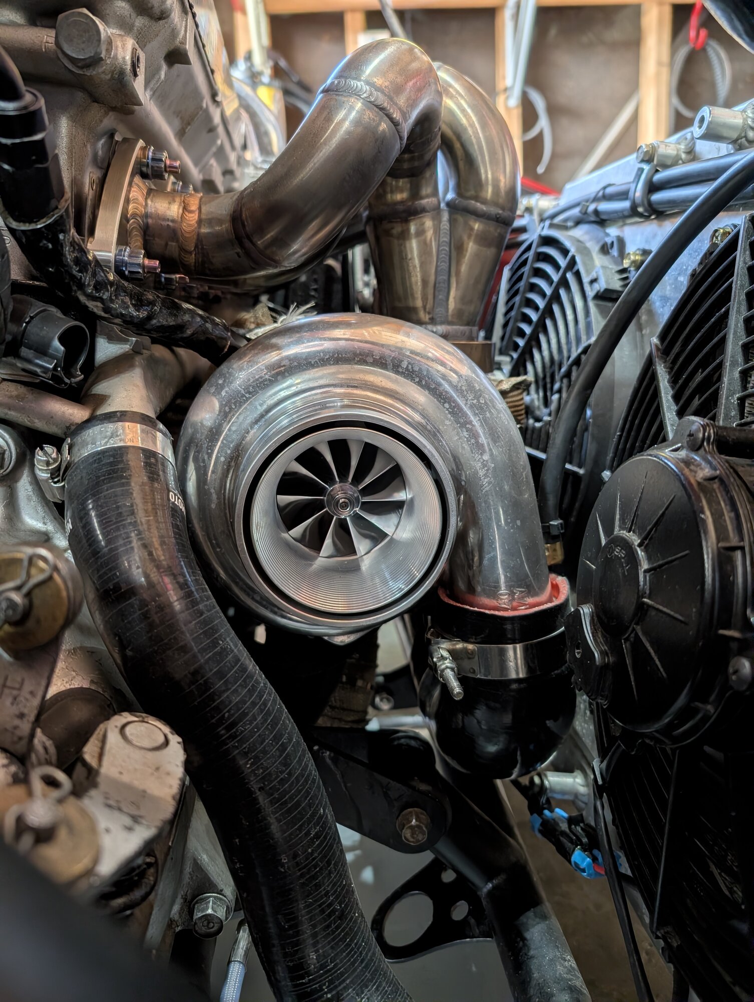

I feel like the boy who Cried Wolf with this boost control issue. I was doing some more troubleshooting and testing of the boost control to try and get back to where i was at on boost Ken said to set boost cut at like 44psi and pull the boost reference line off the turbo and cap the port on the compressor housing and basically just let the turbo eat and makes what it makes.
So i tried that and the car made the same boost as it did with the wastegate connected which was 37psi.
I got the new replacement turbo in place of the rebuilt unit that i rebuilt and threw on the .83 housing again too.

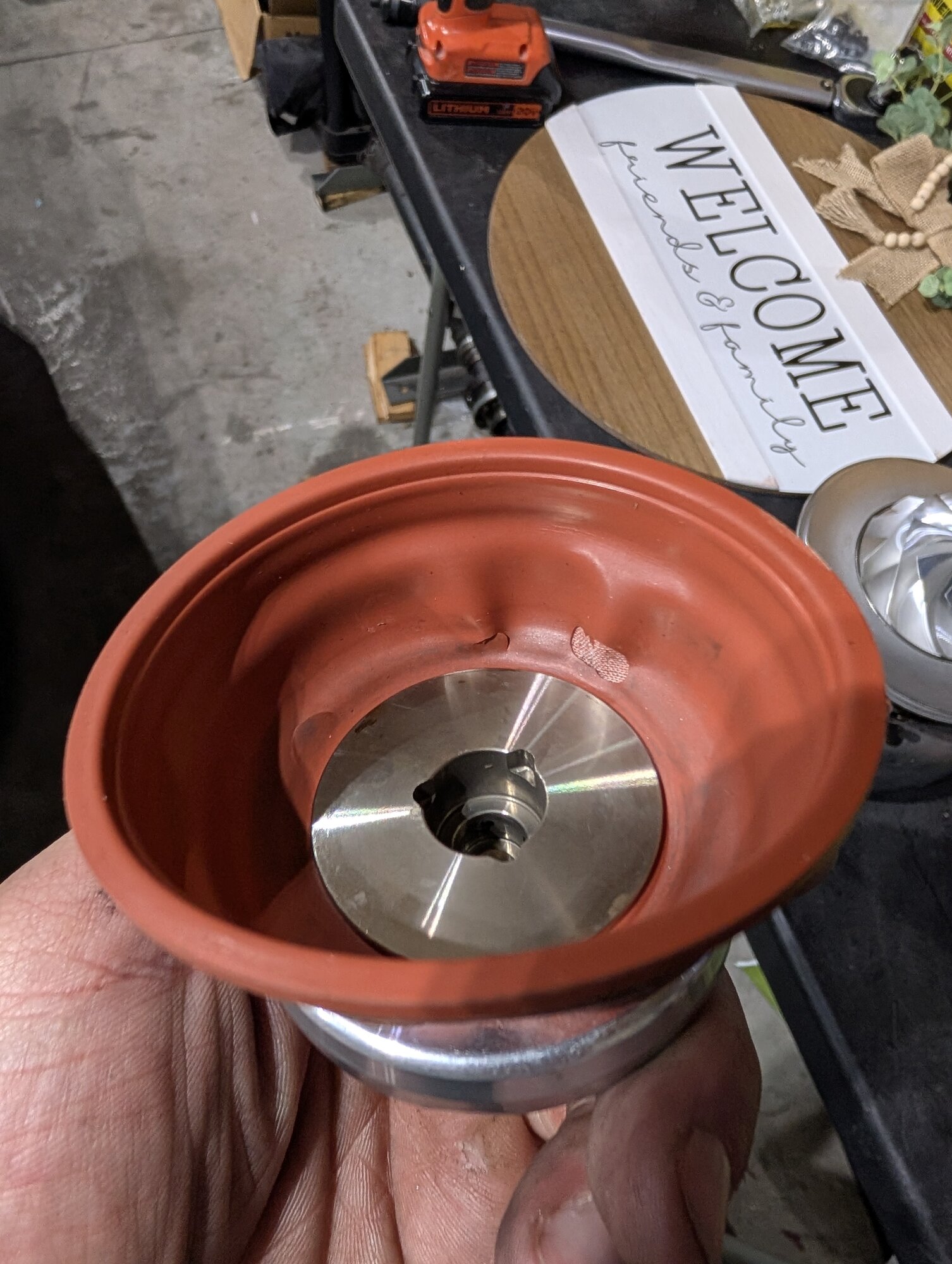

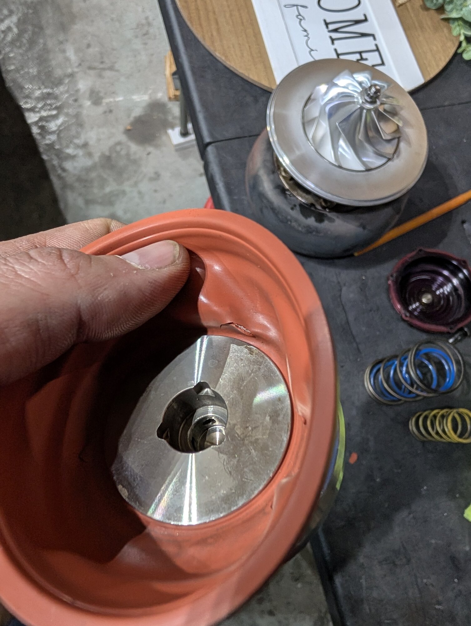

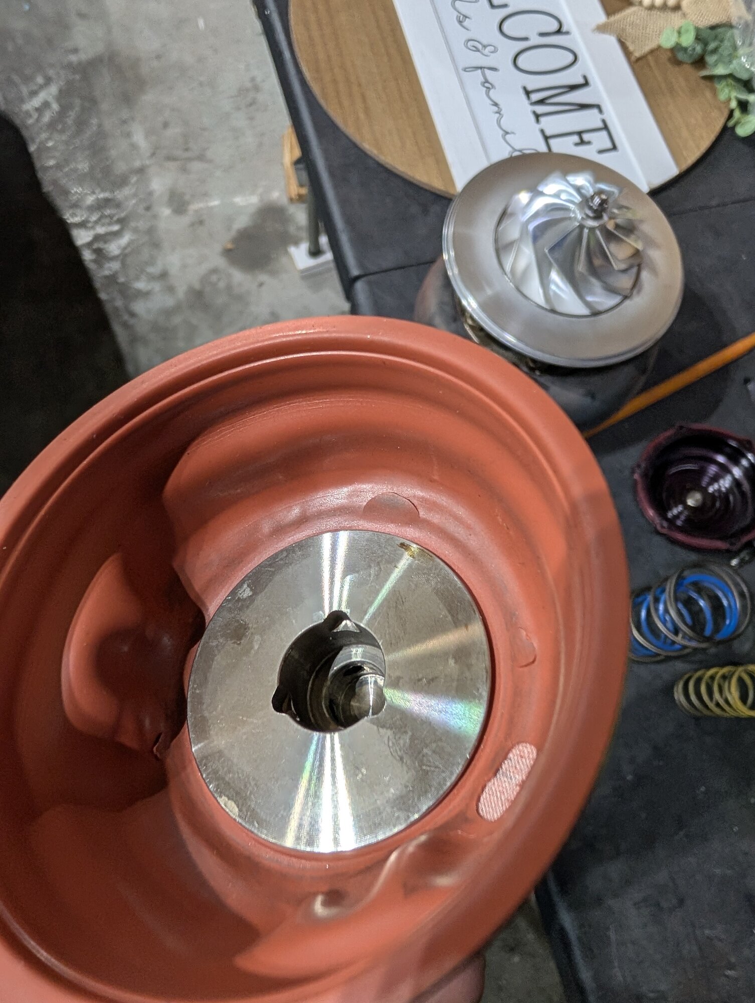

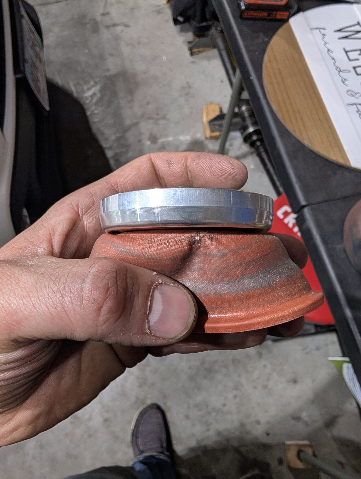

I also decided to pull apart the wastegate to check that out and at first glance it looks fine and i cant see anything. Decided to just pull the diaphragm off the valve of the wastegate to 100% make sure it was okay and found about 6 holes in the diaphragm. Not like poked holes but the rubberized / teflon material had been like peeled off the fabric layer of it. Super weird.
PXL_20260506_013610722.jpgPXL_20260506_013628859.jpgPXL_20260506_013623329.jpgPXL_20260506_013613664.jpg
So my theory of what is happening and why boost control basically isnt working is this:
With holes in the diaphragm, both the top and bottom ports are now seeing the same pressure so they are equalized and cancel eachother out. The EMAP is now the restricting factor and is what is capping the boost by pushing the wastegate open at that EMAP pressure. (17psi spring) but the wastegate cant vent ALL of the pressure from the exhaust. Just remember that boost pressure does NOT equal exhaust MAP (EMAP).
I believe this was also the case when disconnecting the boost reference line and letting the turbo make what it will. Boost was limited by EMAP. Anyways so a new diaphragm gets here today and after this weekend I can get back to testing boost control and see if that fixes the boost control.

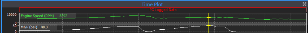

Anyways, I got around to getting into some boost to test out the new diaphragm and it seems to be working. I had the duty cycle to like 30% and it was making 40psi on 3 separate 2nd gear pulls.
I added a 2% duty cycle at peak boost and added some more to spool up a little faster. Haven't had the chance to drive it since doing that.

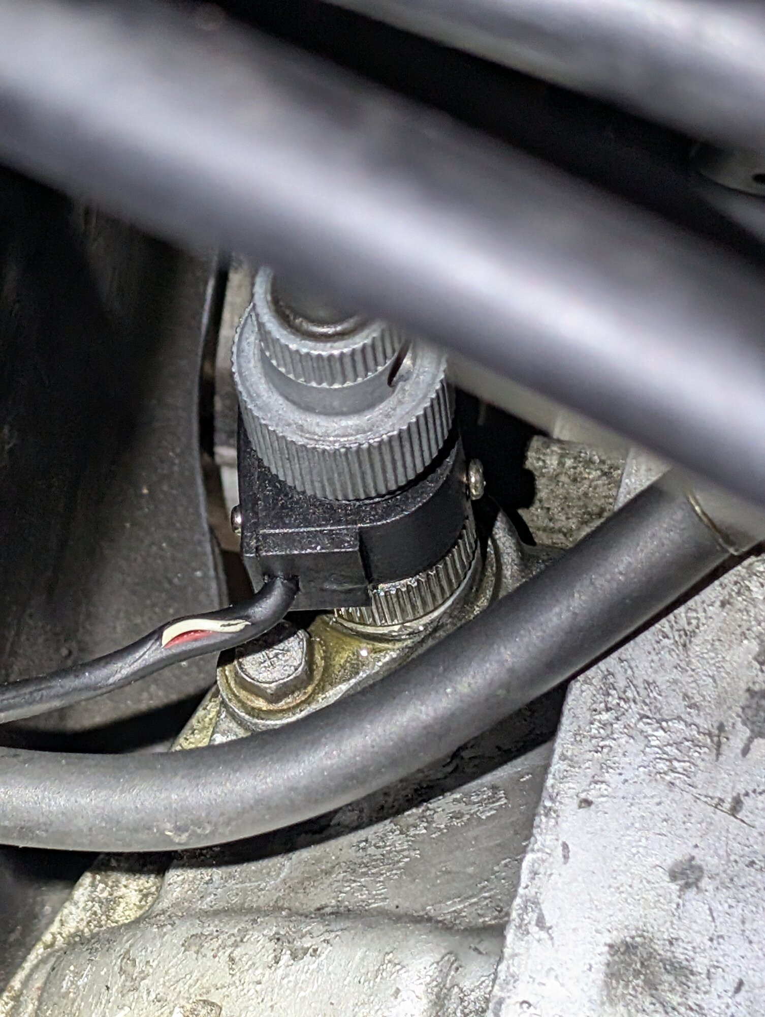

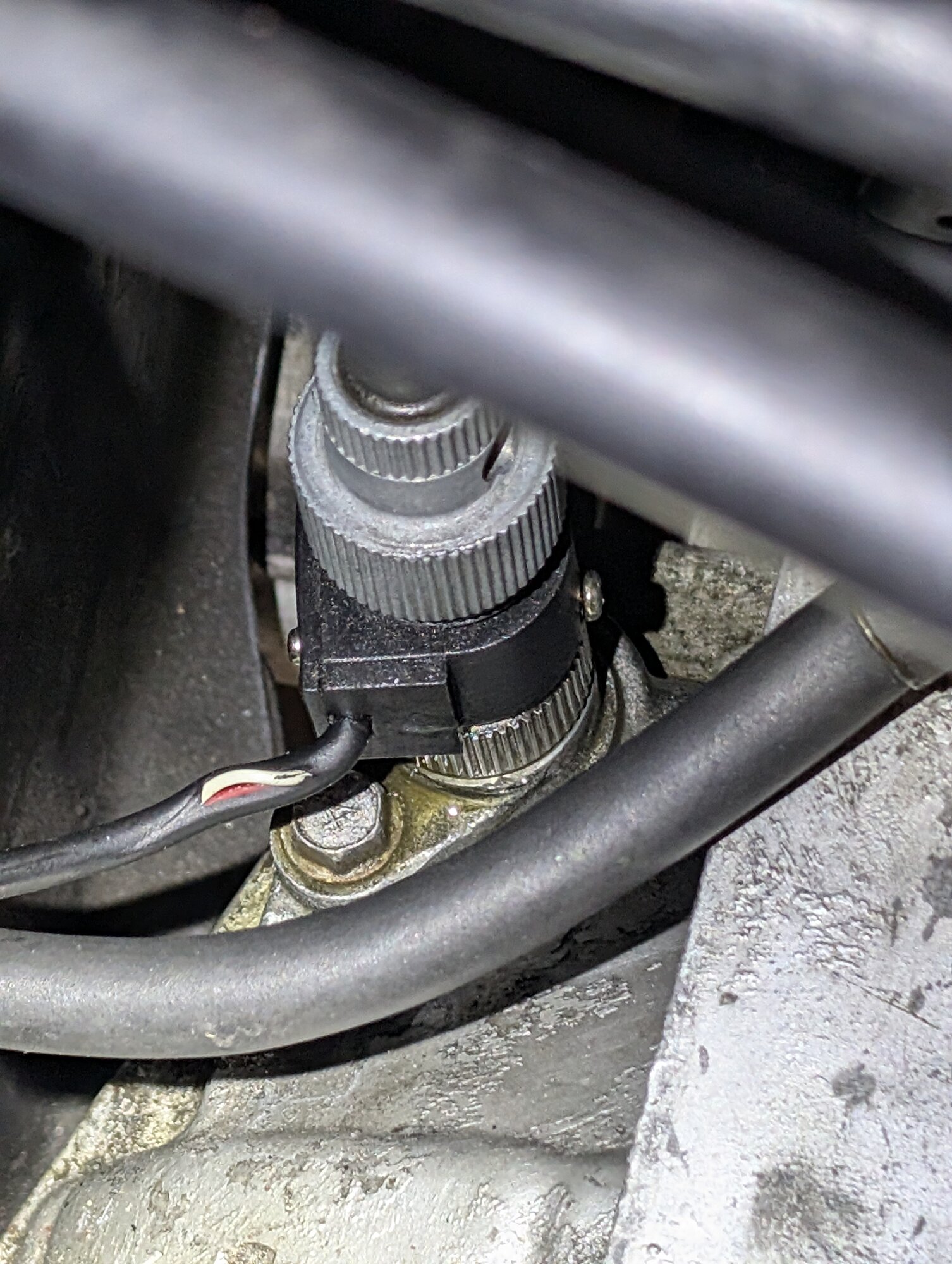

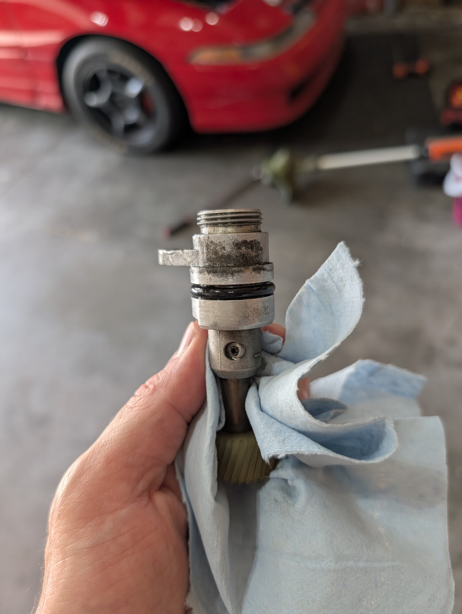

Took some time yesterday to find the source of another transmission leak and I found it. It's the speed sensor on the transmission. My setup is a little unique because I have a Brantz motorsports speed sensor coupled between the transmission and speedo cable because Link ECU does Not like the EOM speedo output for whatever reason.
I know the factory speedo cable has a seal in it. I looked into the bottom of this Brantz sensor and it didn't. I don't know if it was supposed to have one either. I tried stuffing an oring the same size as the top lip of the sensor threads on the transmission into the Brantz sensor but I think it made it worse.
Then I pulled off the seal / sleeve from an old bad speedo cable I had and threw that in there but I'm not holding my breath. I can't tell if it's leaking from somewhere else like inside the speedo sensor itself or what.
Maybe some Teflon tape would help?
Instead of an o-ring , try one of these gasket seals. I have an electronic speed sensor from a montero and it has one of these teflon seals.?
Thanks this is what I had in mind. It's also very similar to what I put in there from my spare speedo cable

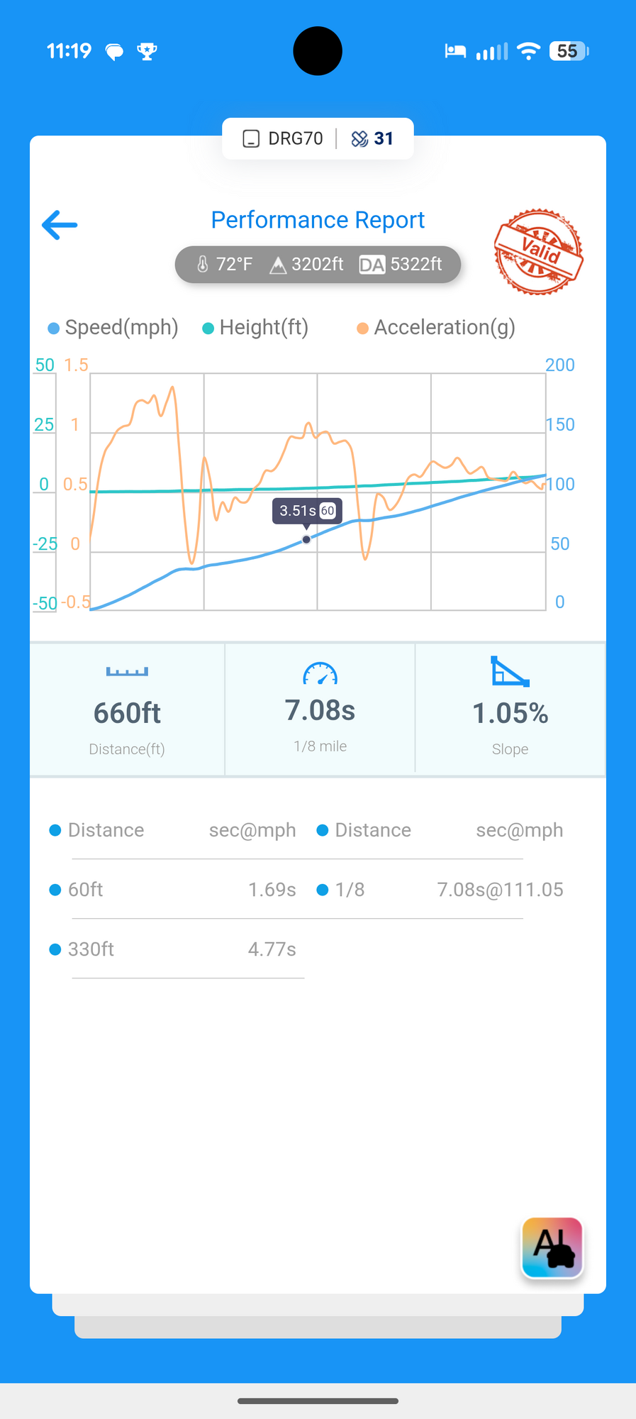

Boys we were RIPPPING last night at the track. Got kicked off for no fire jacket and no rollbar/ cage.

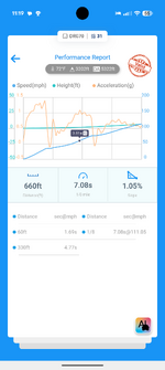

New PBs all around. I finally got the slipper somewhat dialed in, as well as launch control for the most part. Probably a little too aggressive but oh well it worked out and ran a 7.03 @ 111 ( according to the timing system)
Slips (left lane) dragy for comparison
The track was having some odd timing issues. My 2nd pass I managed to double clutch off the launch and killed my 60' but still ran an 8.05 @ 110 according to the track timing system.. but dragy showed a 7.19 @ 110 and like a 1.89 60'.
Other people had really odd times as well. Some matched dragy and some were way off.

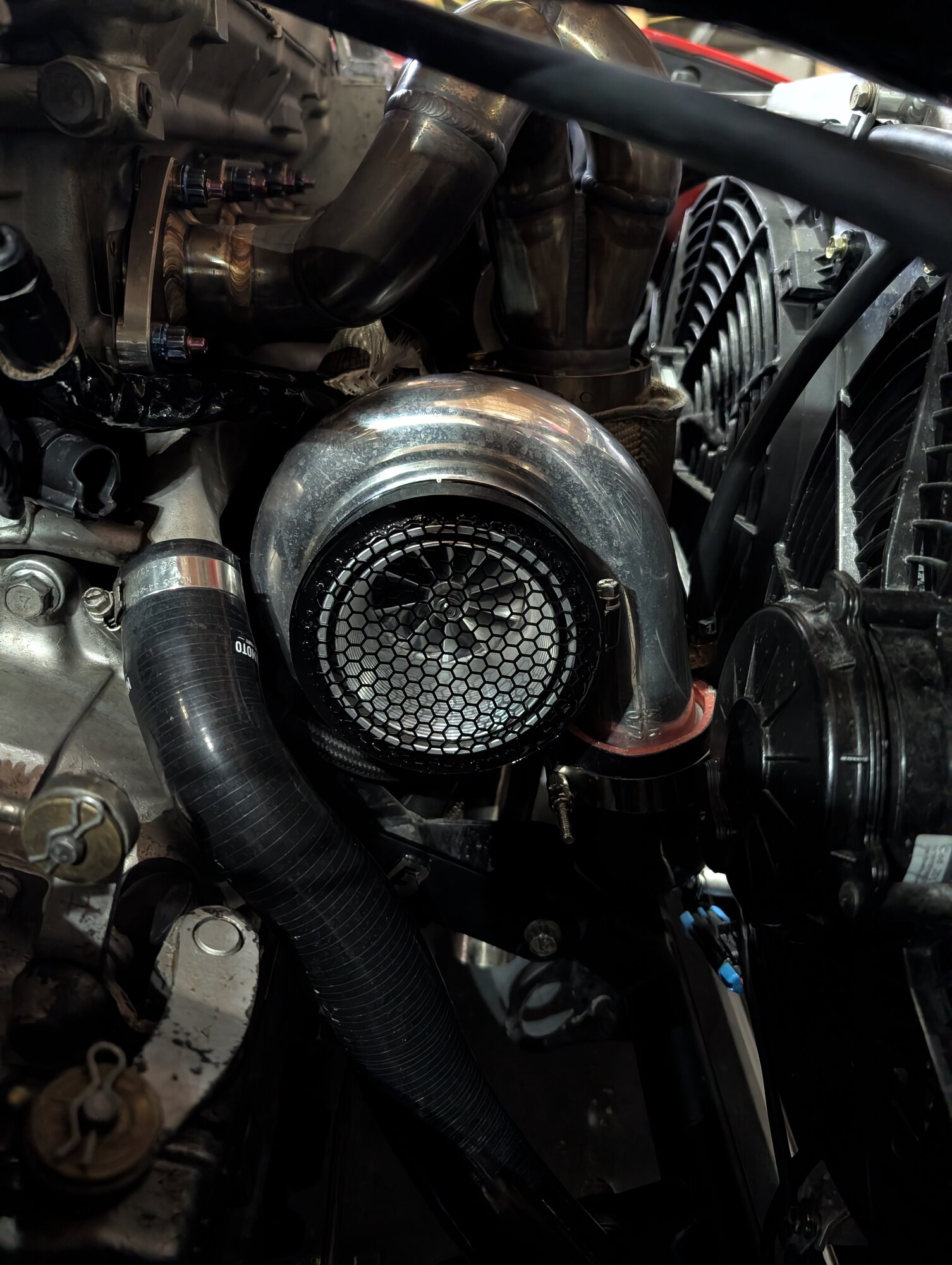

- Turbo guard ✔️

- Fix the damn speed sensor leak in the trans
I don't know how or why that gear / sleeve thing is leaking but it's pissing me off LOL

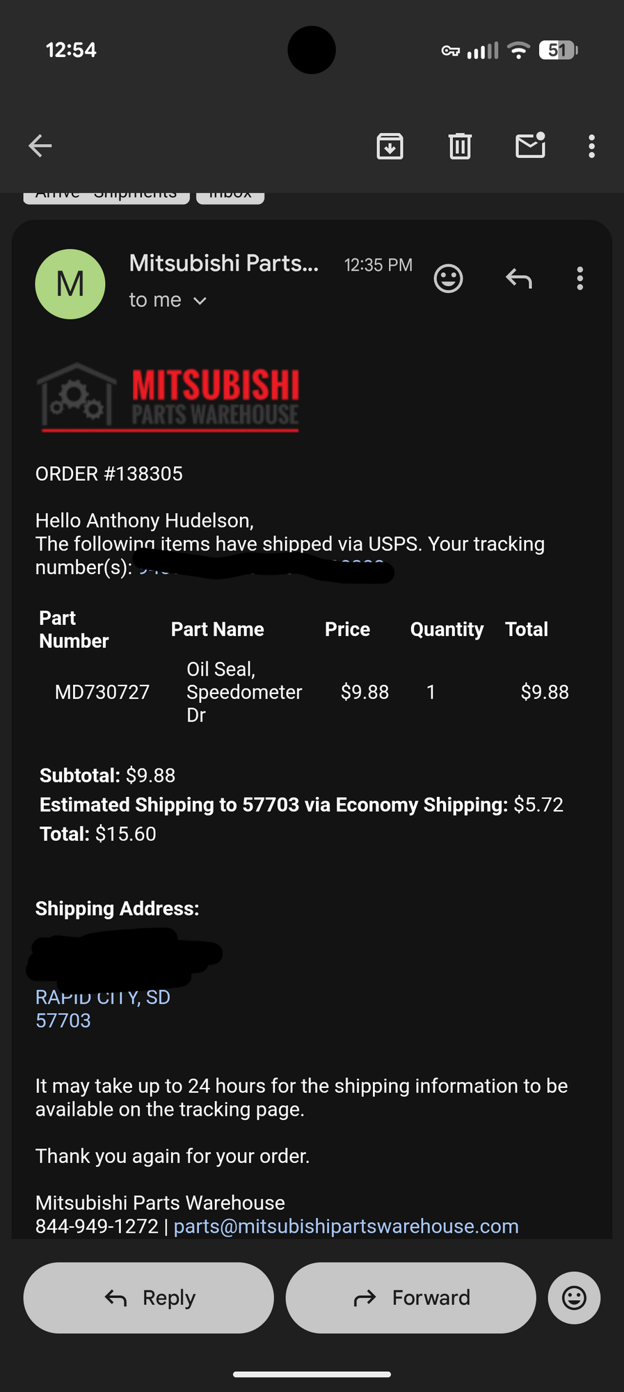

I have a new sleeve and OEM o-ring coming but I don't think the o-ring itself is going to fix it. It almost seems like it's leaking from inside the sleeve somehow. I'm assuming there's some sort of seals inside the sleeve that would seal to the speedo gear but I can't get mine apart to check that. If anyone has any ideas, or if they wanna sell me some one of their sleeve things with the gear on it I'll happily take it.

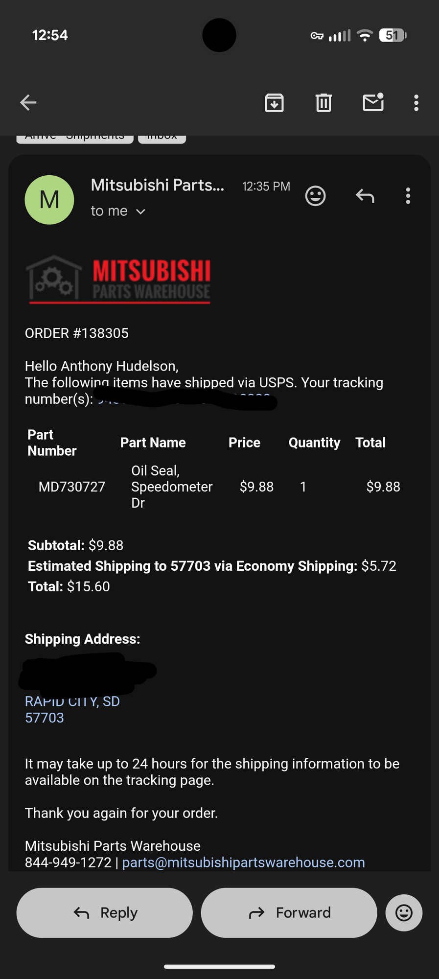

I ordered that same speedometer seal 5 years ago from an online mitsu dealer and it came direct from Japan a month later. Glad to hear you had a good experience
