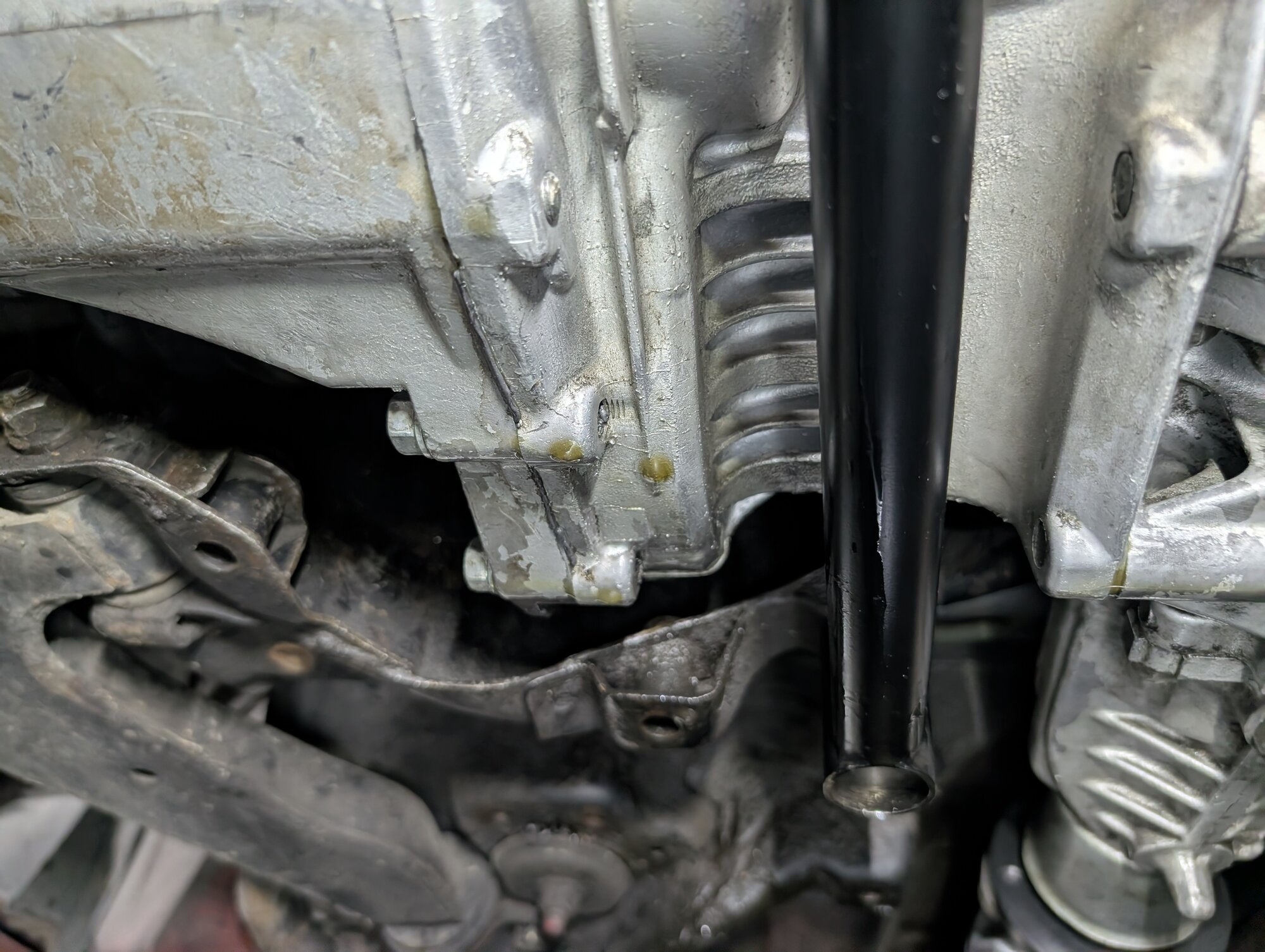

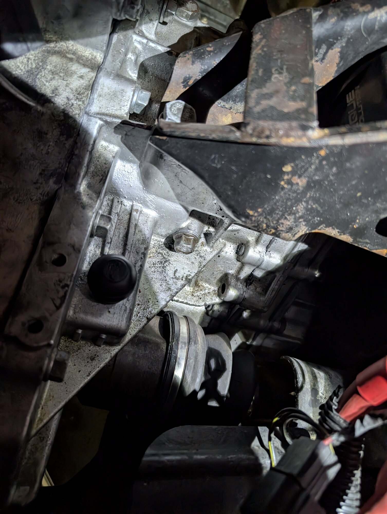

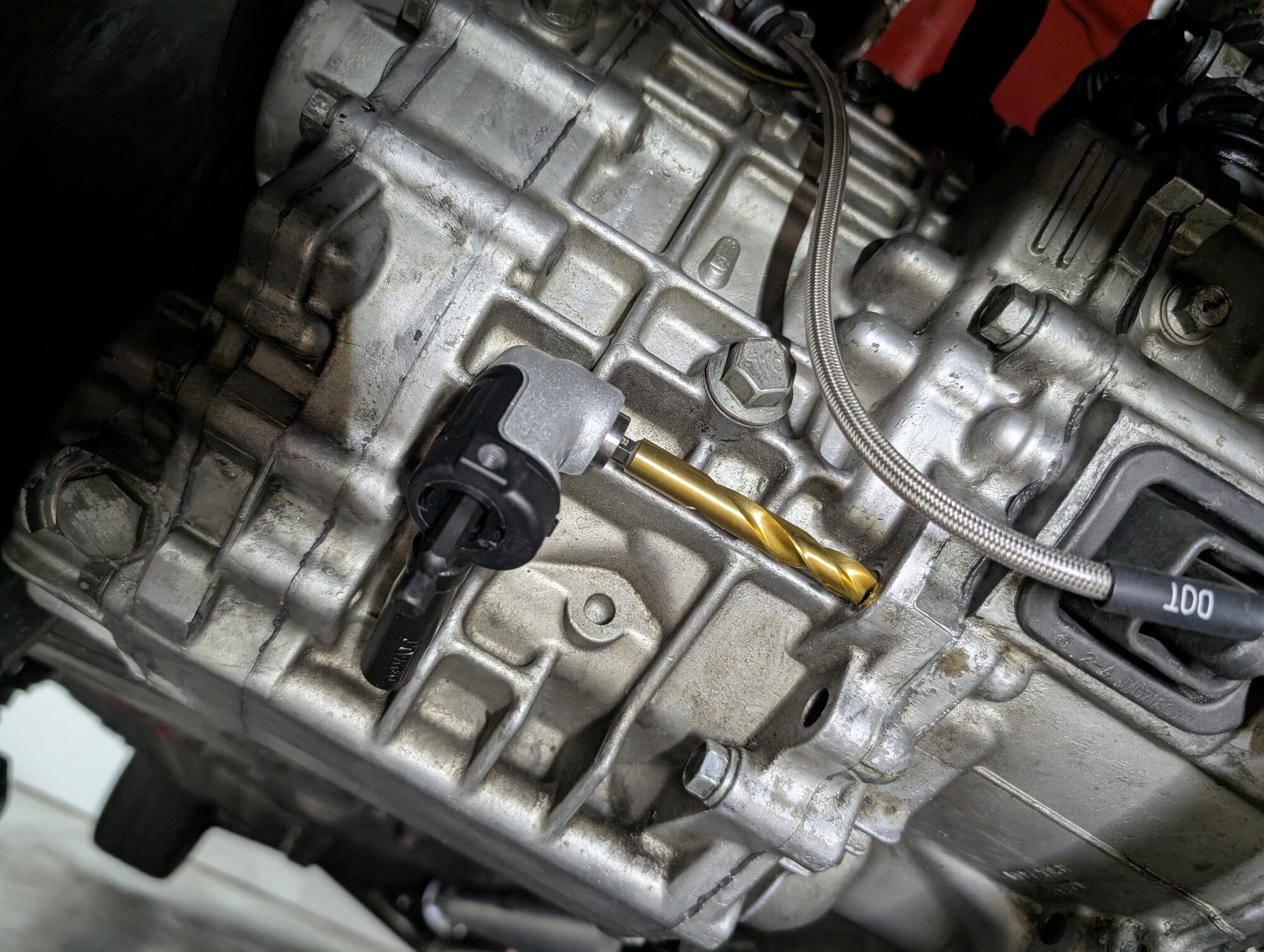

Havent driven the car for a little while because I've got a transmission leak and I think I've finally found it.
Looks like one of the transmission mid case > bell housing bolts stripped out. I dont remember this happening when I put it back together but it must have happened. Anyways now I get to helicoil it. I'm sure as hell not taking the transmission apart to do it soo wish me luck on doing it in the car LOL
I thought about helicoiling it from the backside of it was an open hole but of course it's not.
Ughhhhh!
Helicoil in the car successfully worked, I think. Drive the car to work today and didn't see any leaks / drips when I parked. I'll check again after work.

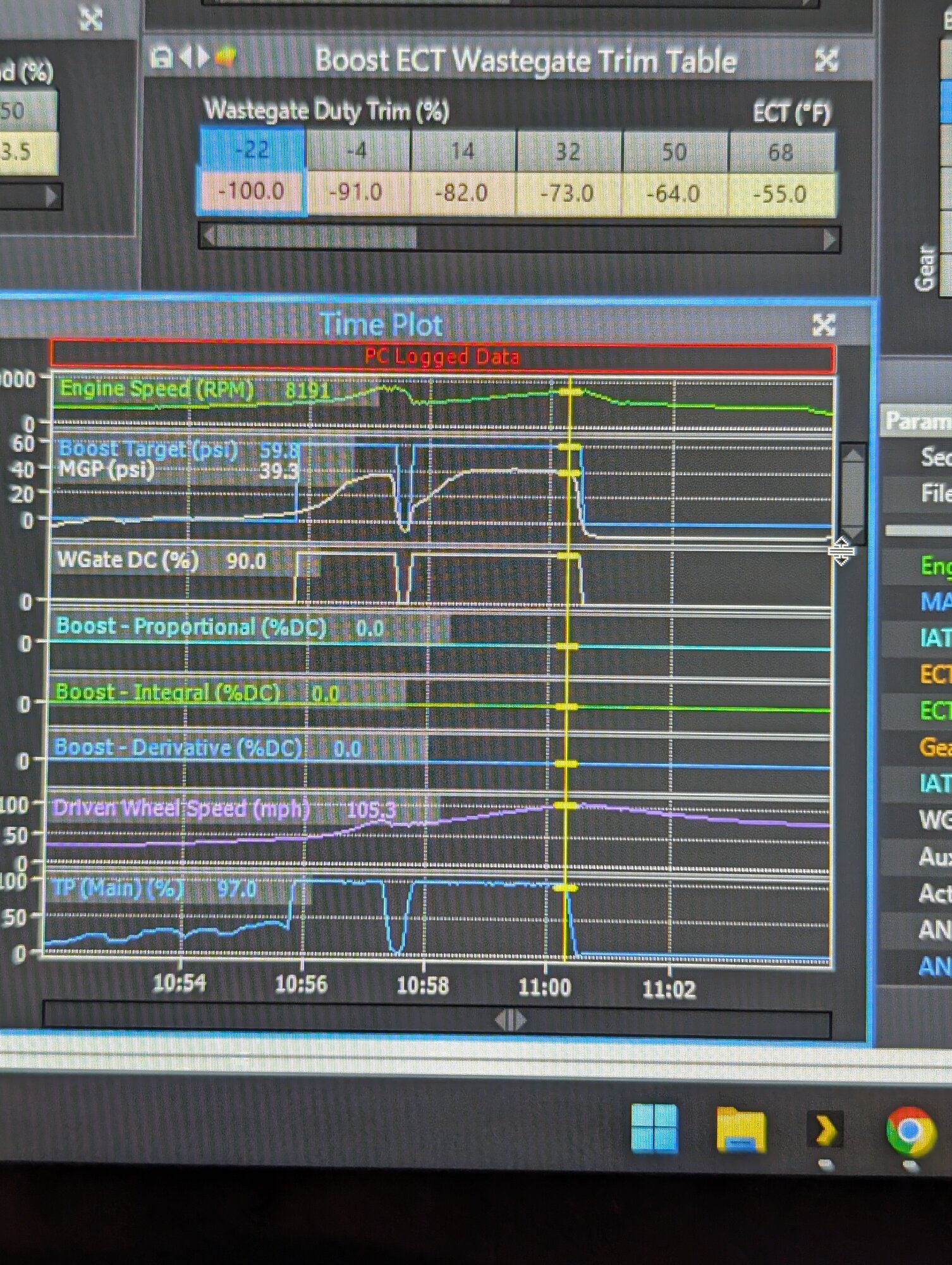

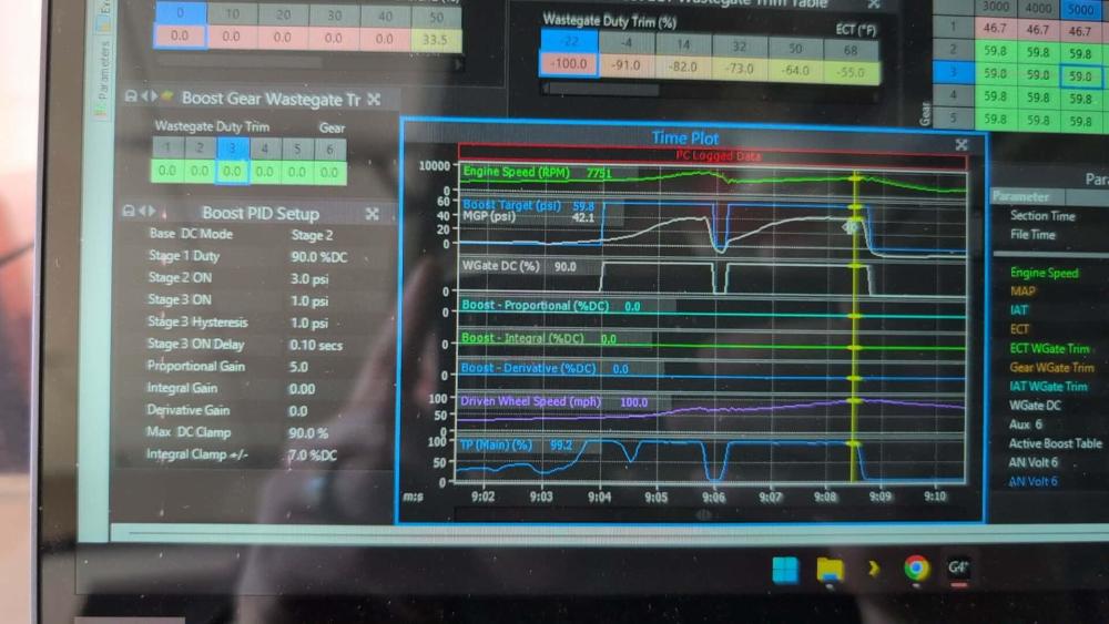

Messed with some closed loop boost after work and targeted 45psi and the closed loop kept the wastegate duty at 90% the whole time and managed to make a peak of... 41lbs LOL
So yeah. I might try swapping turbine housings to this 1.01 or just call it with the setup as is. It definitely still feels pretty spicyy 🔥

Okay okay I said I found my leak but now I think I ACTUALLY found it. Followed the leak up and found the reverse idler gear shaft bolt wasn't even hand tight.. it was loose.
I'll tighten that up and see if it still leaks. I think there might still be a small driver side axle seal leak but we'll see.

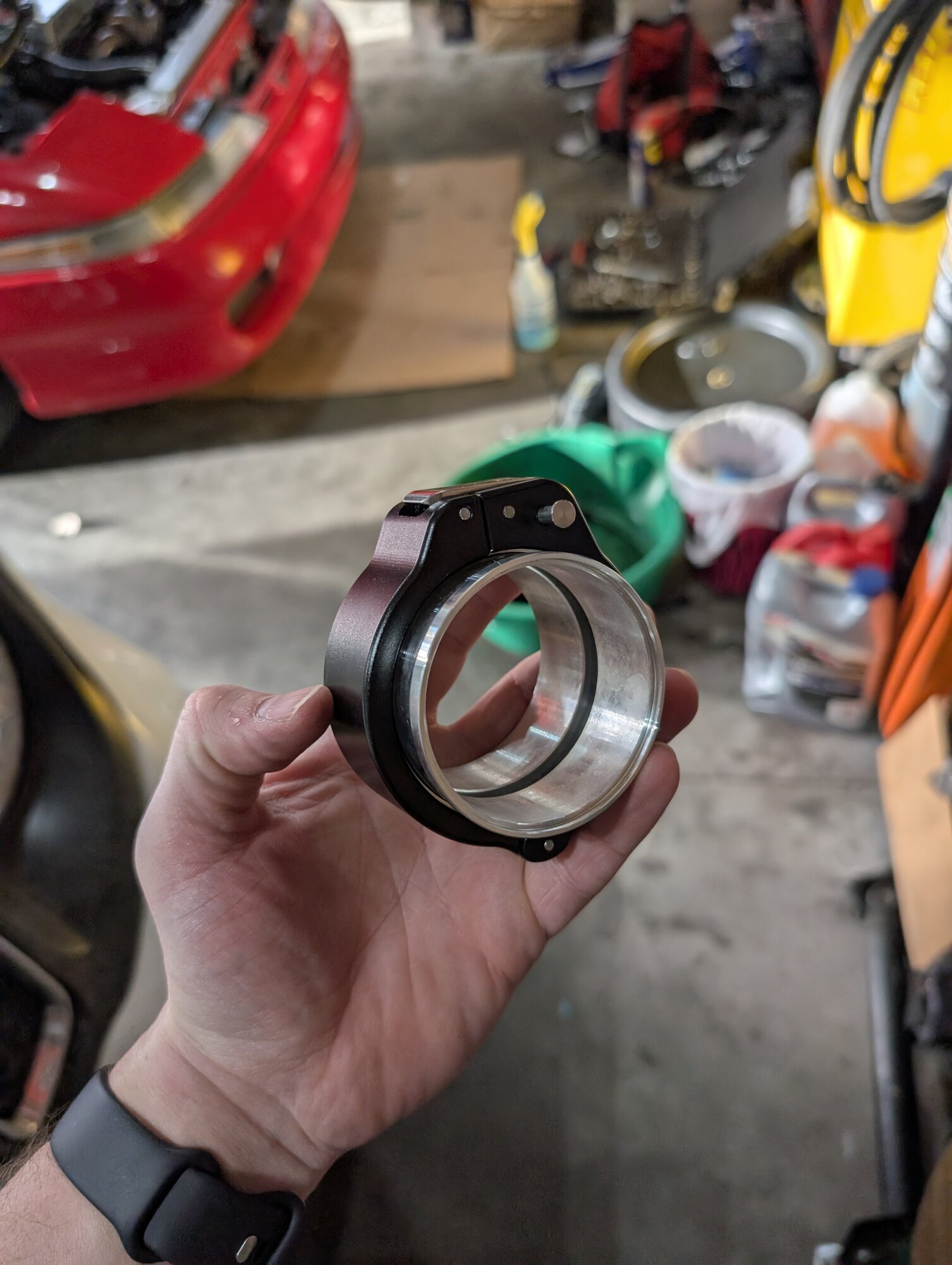

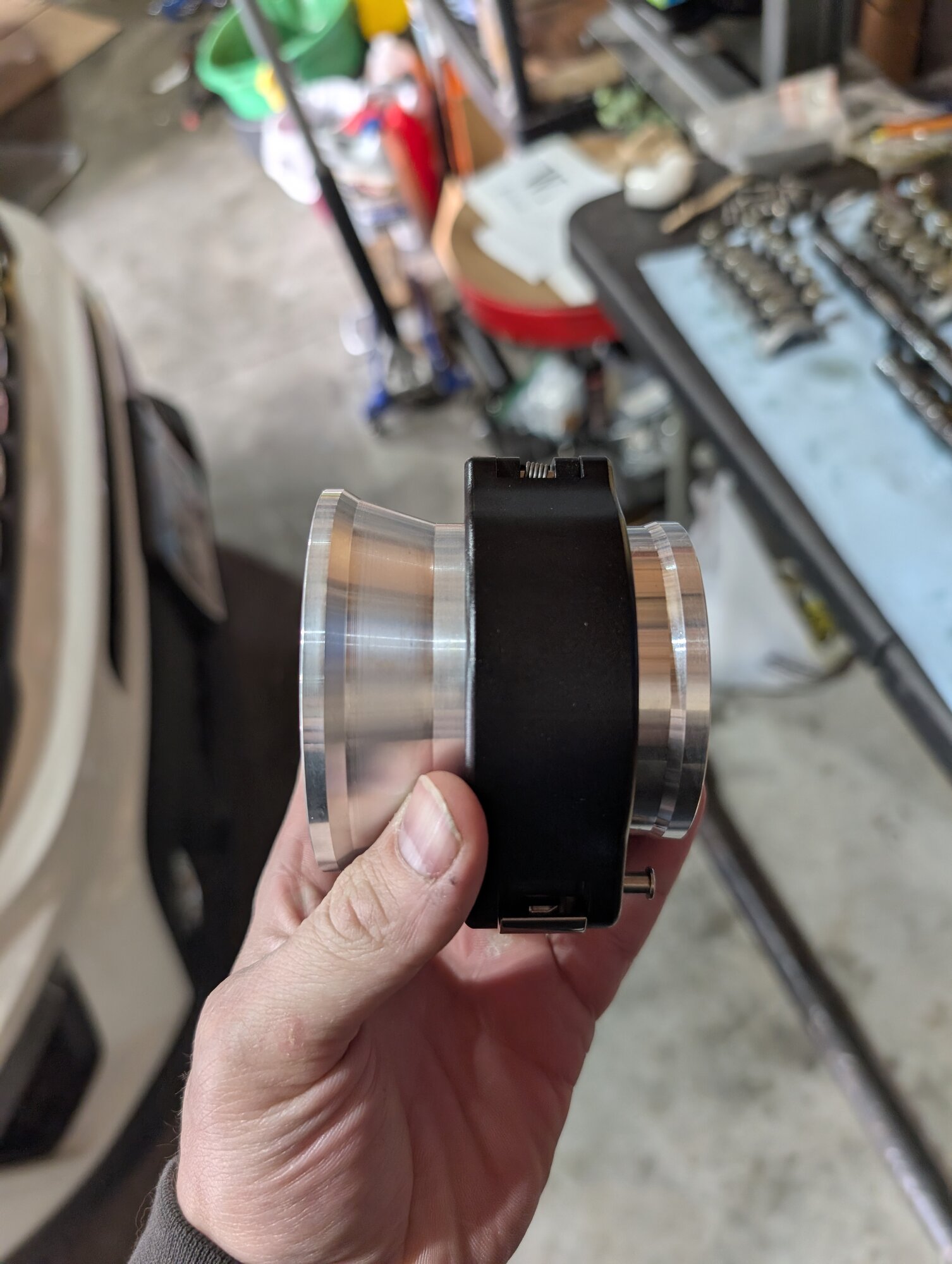

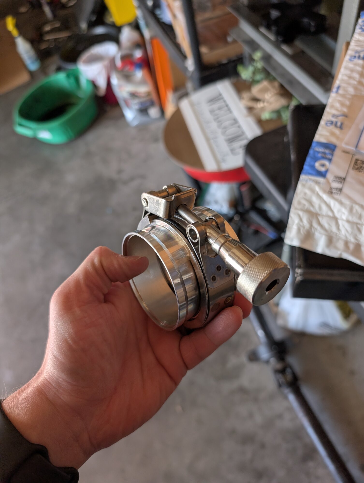

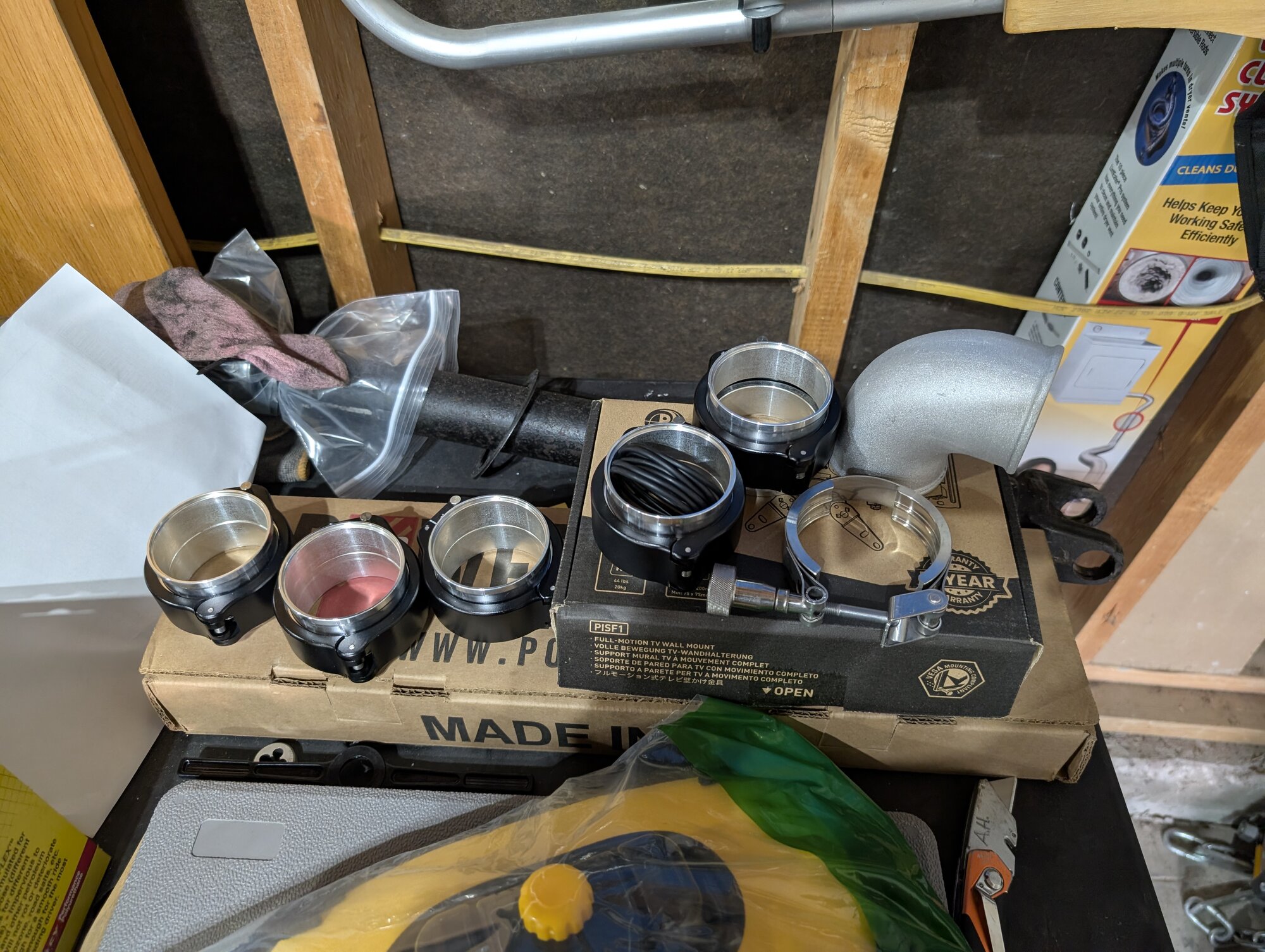

Alrighty my dudes I'm finally making the switch to HD clamps. Not any of the crazy name brand ones because I don't have that kind of dough. Lol
Also switching over to a aluminum 90° off the compressor housing too.
I'll be doing 5 of them:
One off each side of the intercooler
One off the compressor housing
One off the throttle body
And one that's splits the pipe between throttle body and intercooler
Clamps

So I kept troubleshooting the car with the boost issues. Thought maybe the wastegate springs were too low (11psi when I thought they were 15psi) so swapped those out to make 17psi base spring pressure and re did the boost control and it got a little better but not fixed. Even with the wastegate duty at 90% still.
I did a bunch of searching and asking around and everyone thinks it's back pressure in the turbine housing with the new overall flow of the S3 cams. I don't want to swap out to the 1.01 housing and make it even laggier.

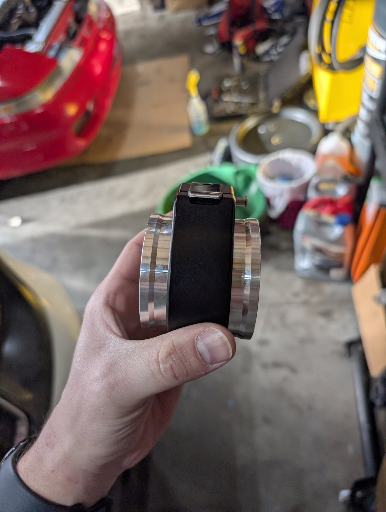

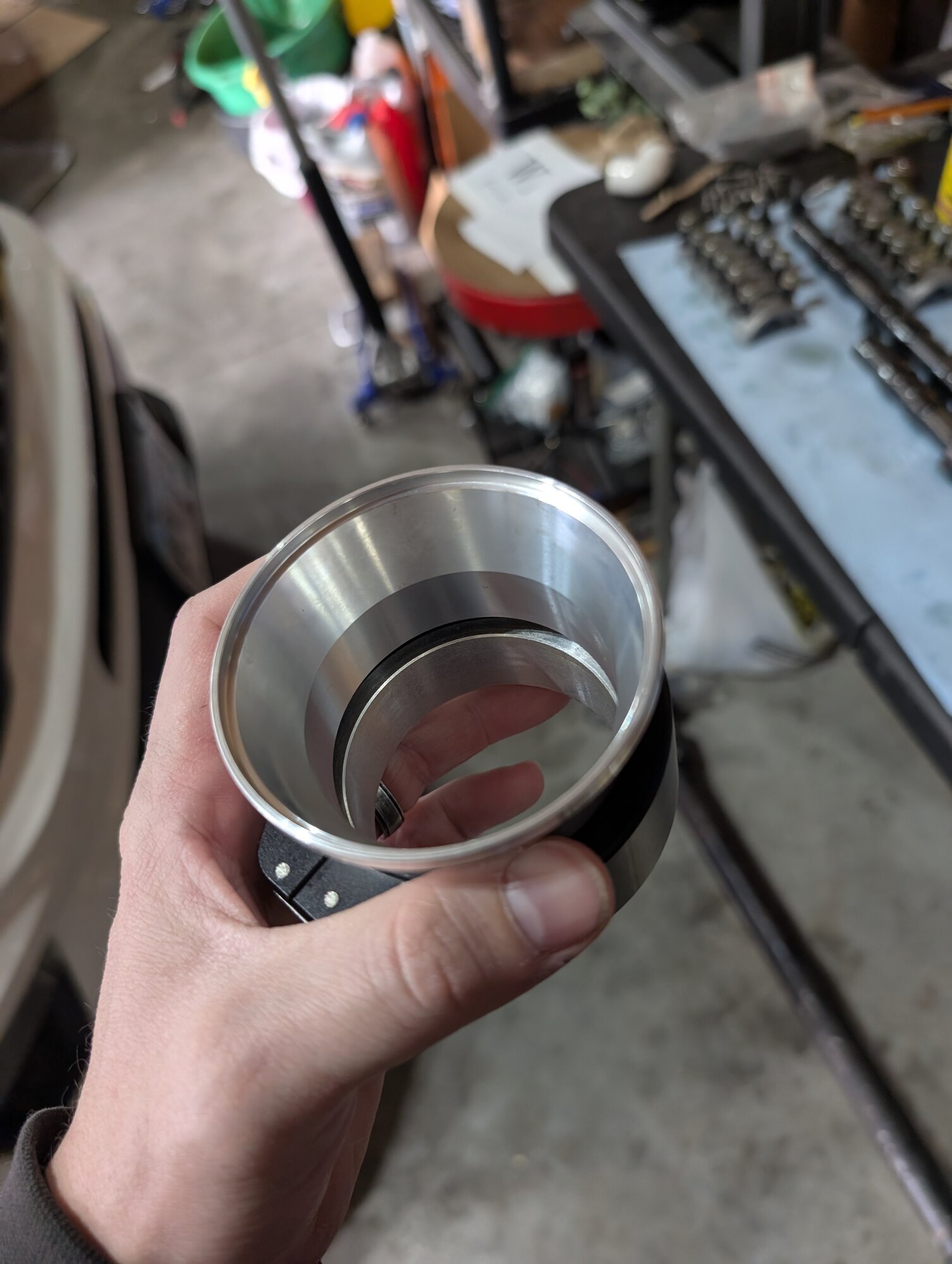

Anyways I also got all my sweet "HD" clamps and realized that my intercooler is a 3" outlet but my piping is a 2.5 so I also ordered up some 3" > 2" HD clamps weld on ferrule adapters. Fit perfect with my new clamps.

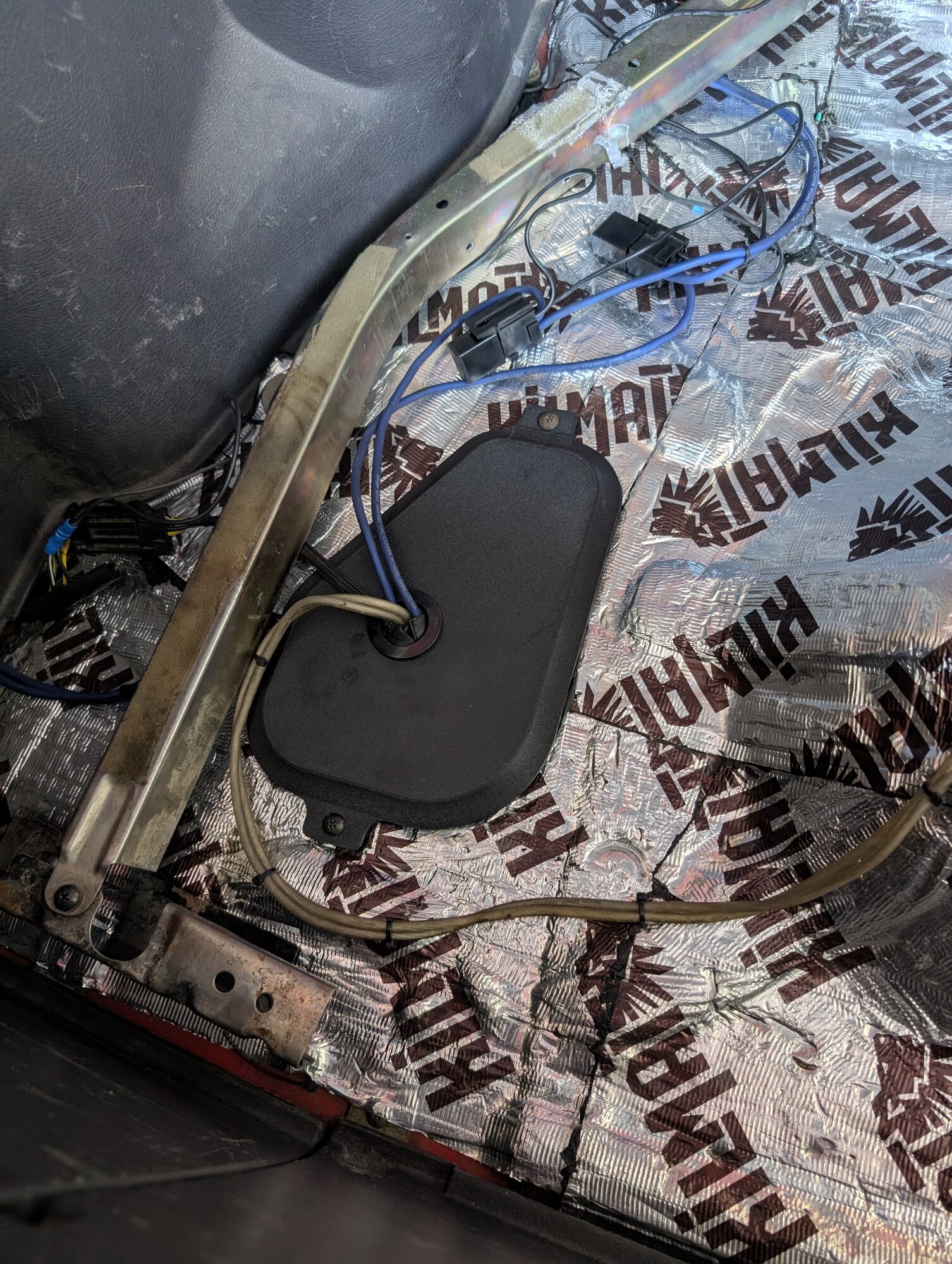

Picked up one of the 3d printed fuel pump covers from DSM3DCreations and that fits great and looks better.

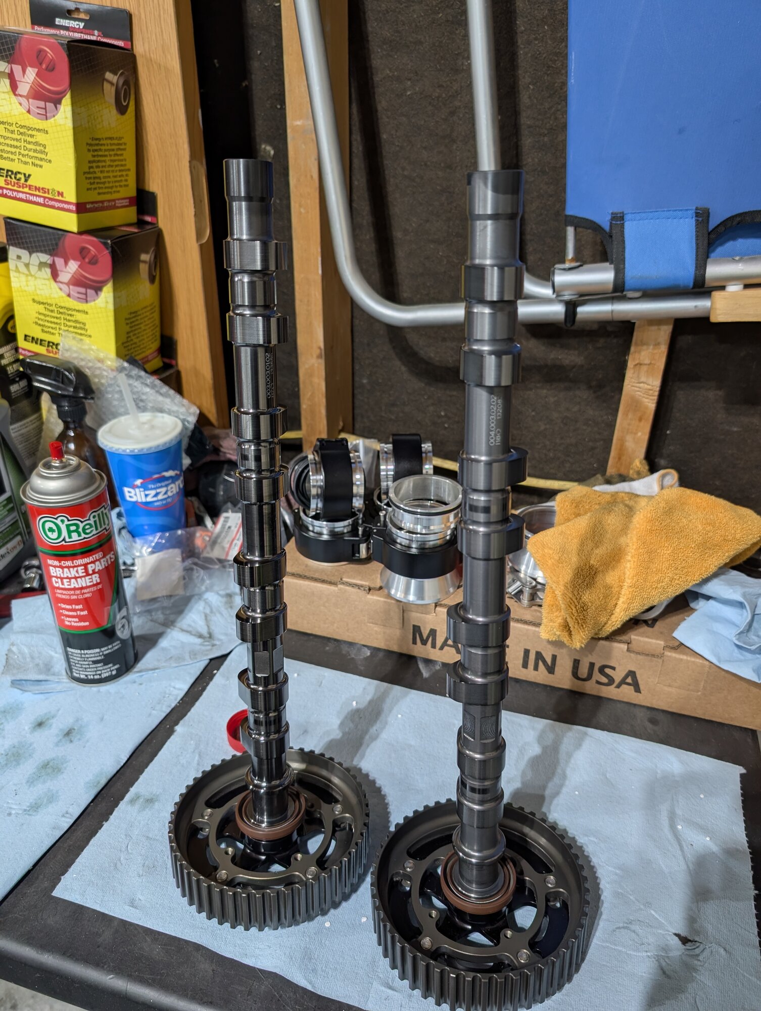

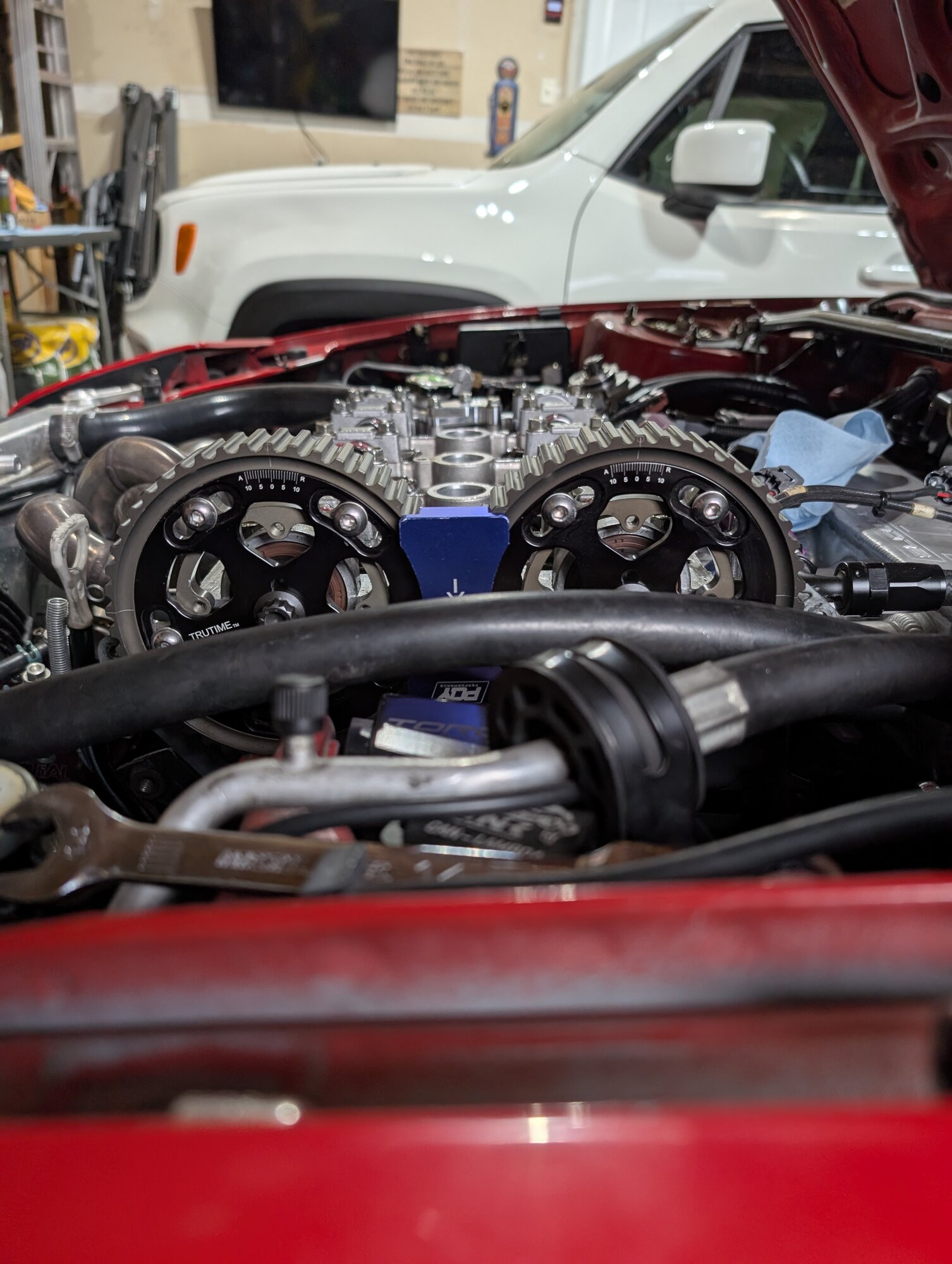

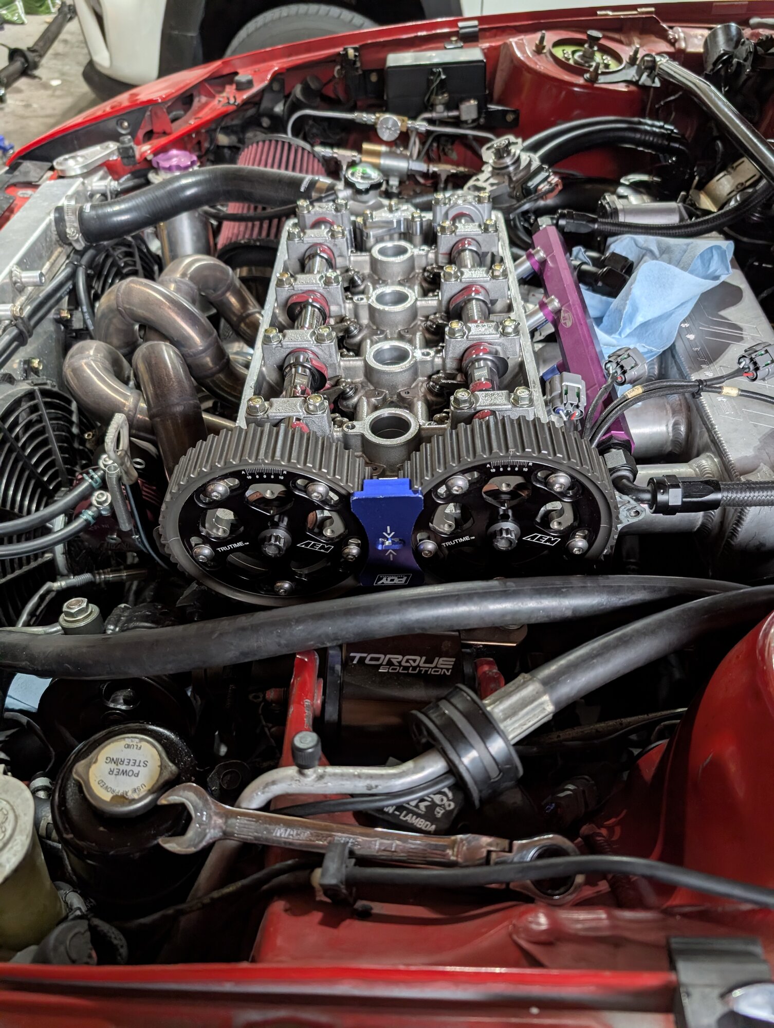

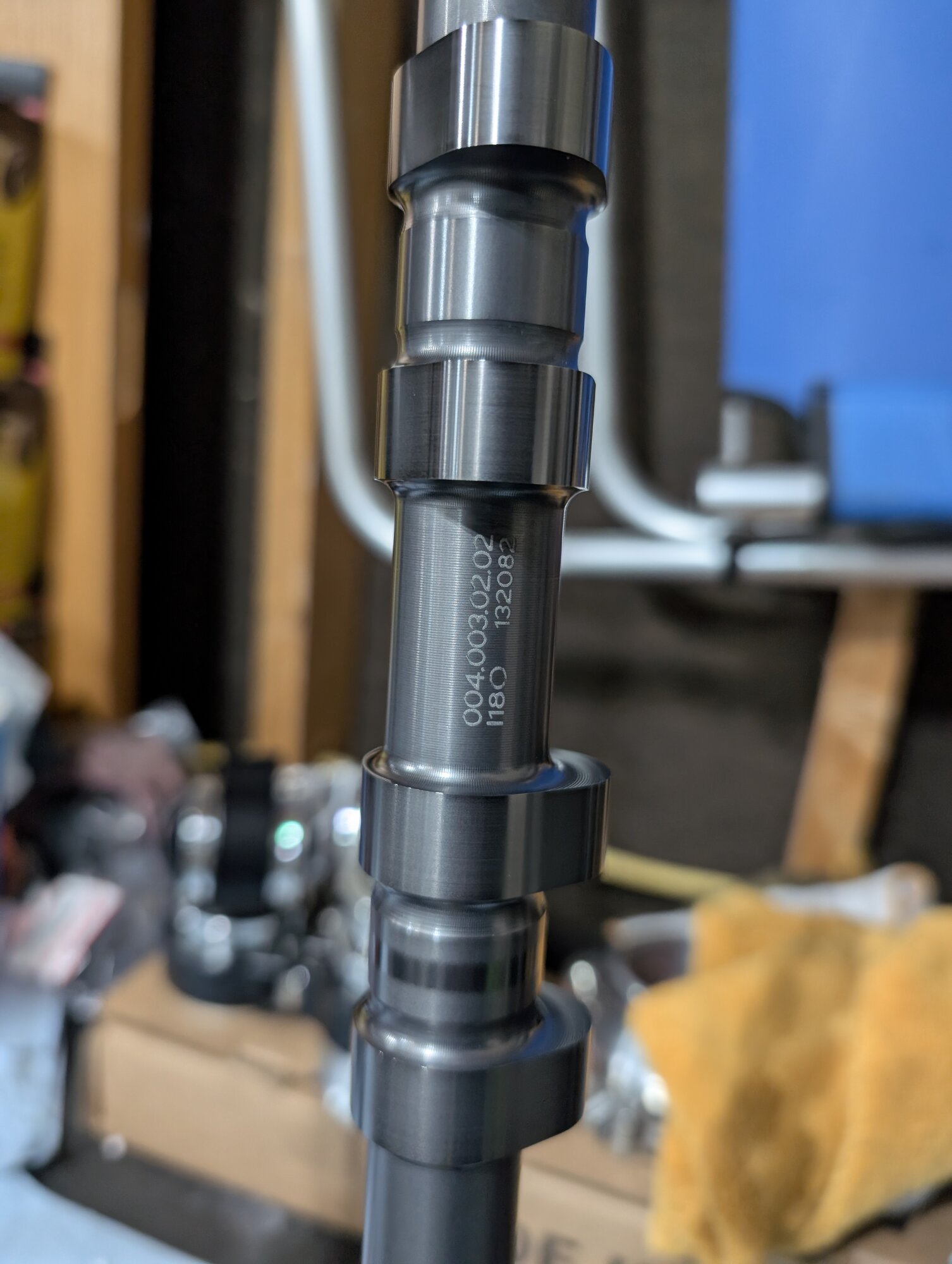

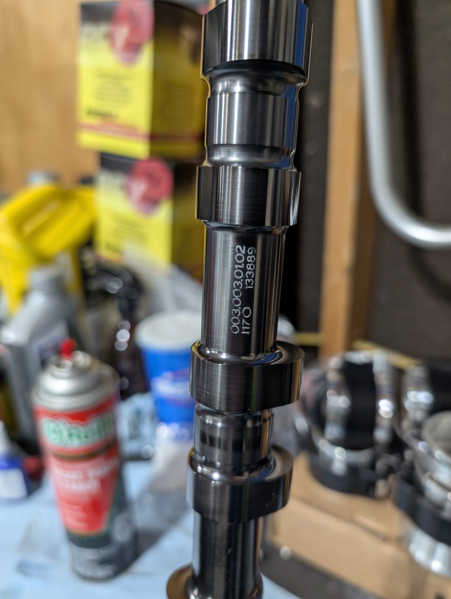

The new S2 cams are in. I noticed a difference in the finish of the cams which I thought was weird. The exhaust cam is shinier and the intake cam is pretty flat colored. I'm not too worried about it but a weird observation.
PXL_20260404_153850046.jpgPXL_20260404_153906391.jpgPXL_20260404_153917150.jpgPXL_20260404_160327806.jpg
Timing stuff will go back in once the new tensioner is here. With that, I'm going to go through and re-tension the timing belt manually. The current tensioner is giving me some vibes it needs to be replaced possibly. I'll keep it around for if I get in a pinch though. Since they are discontinued.

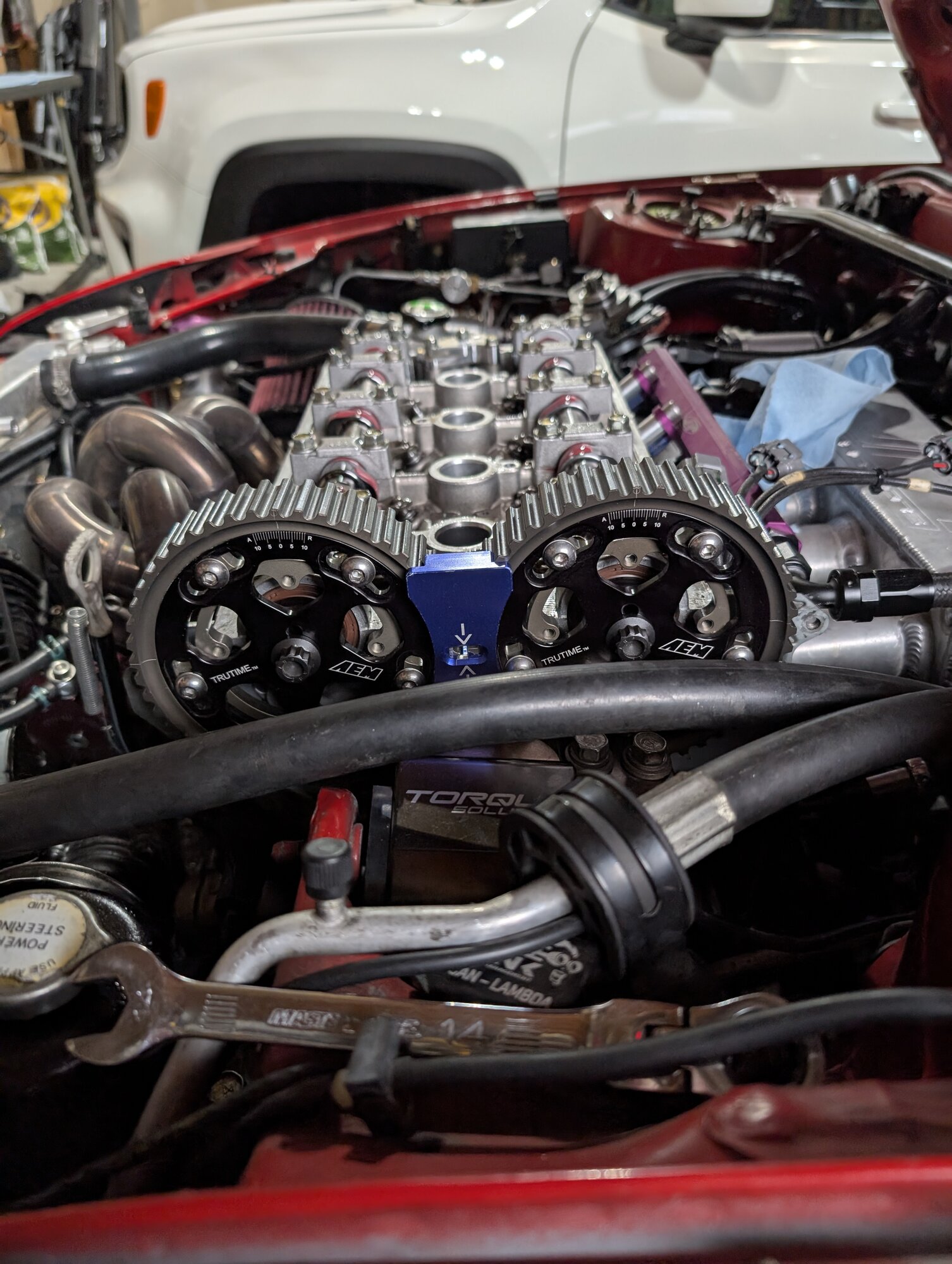

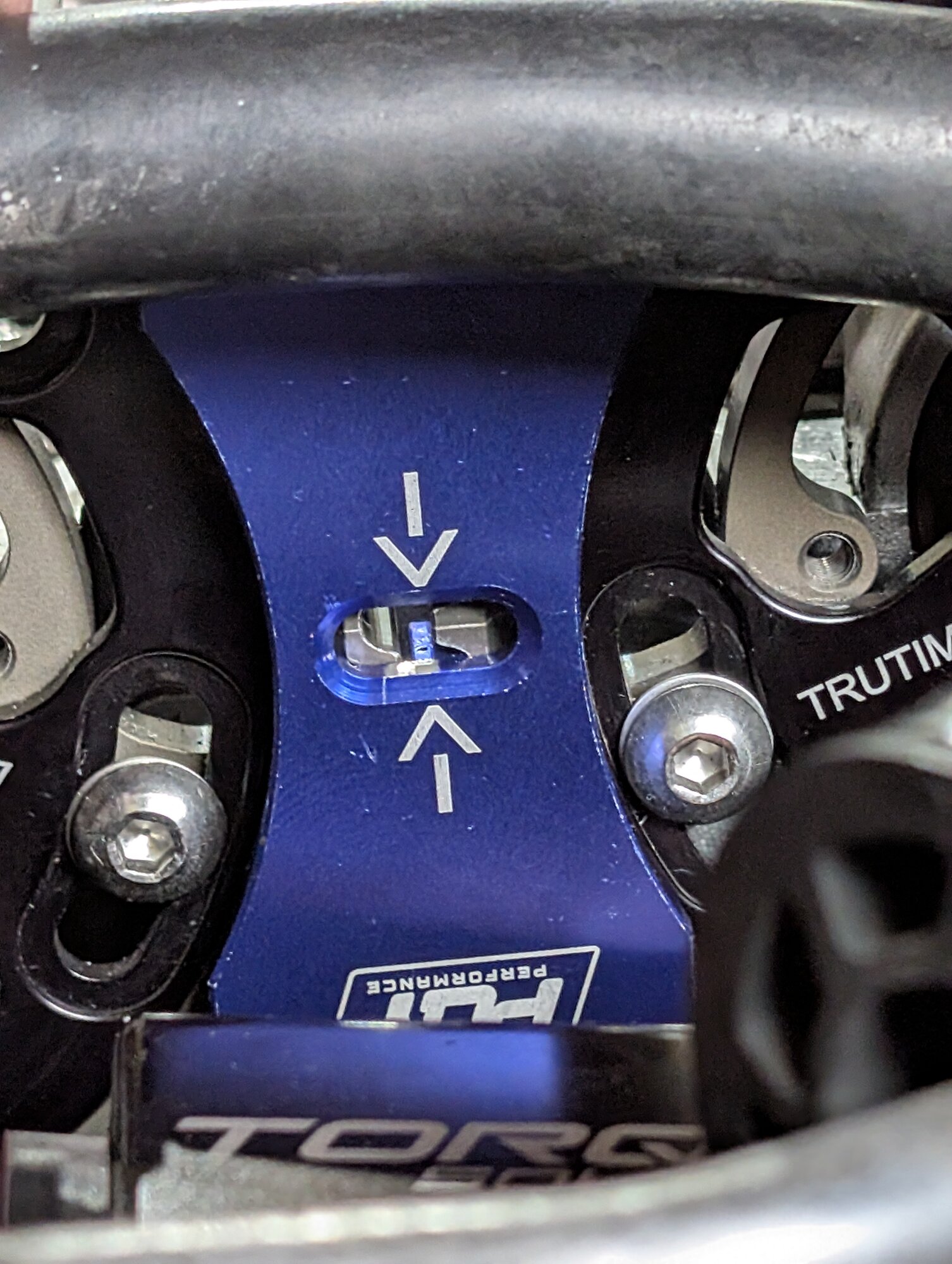

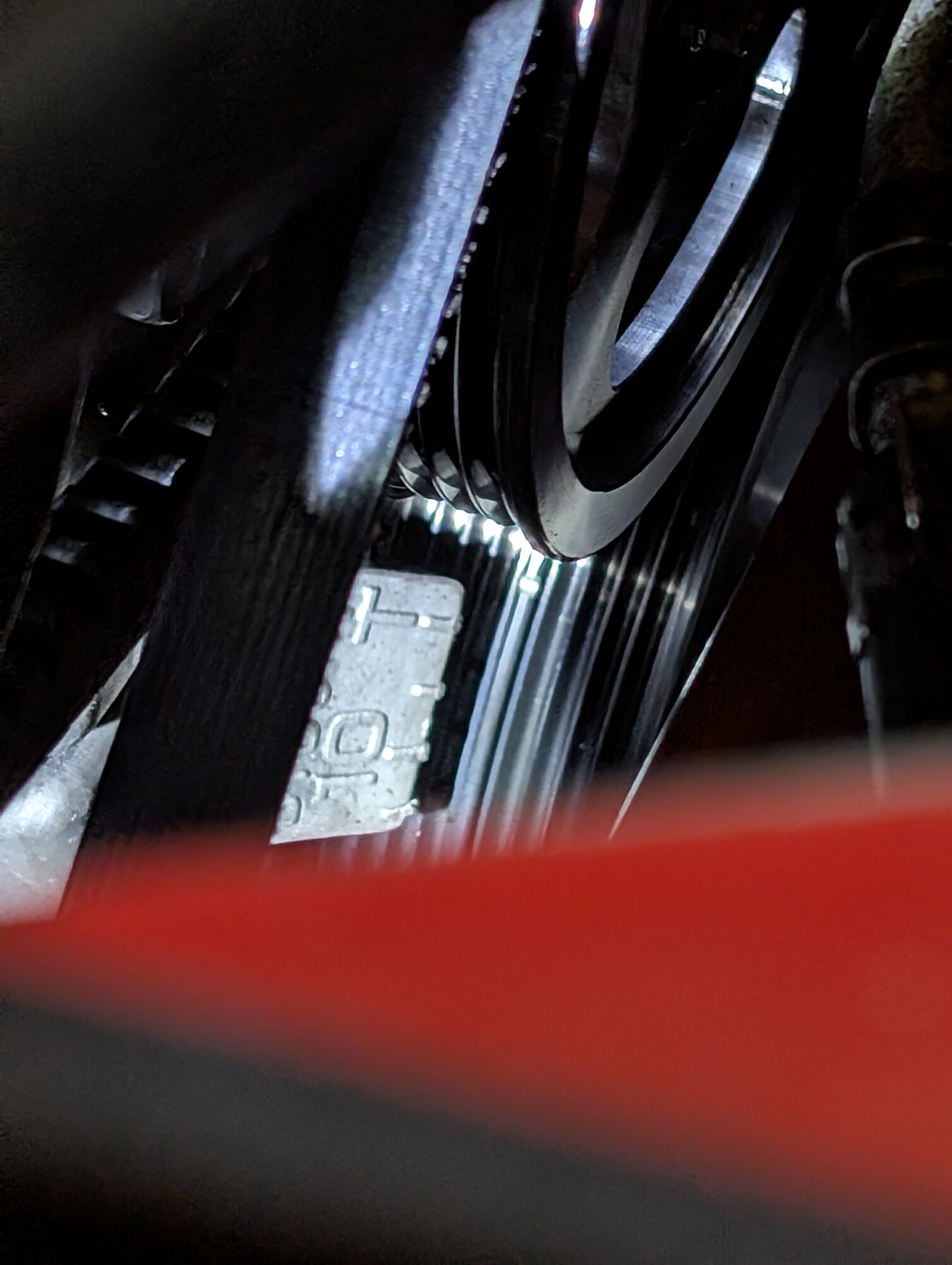

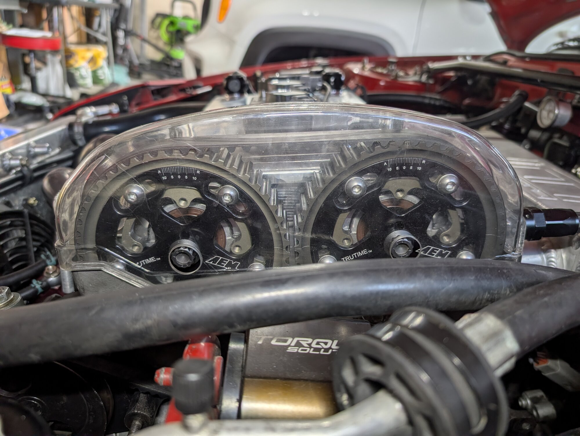

Okay so got the timing stuff buttoned up again on the talon but it's running like shit again. I wonder if I have the timing off again SOMEHOW. I verified that the marks on the sides of the cams were lined up as well as the crank and everything else but it's running pretty lean at idle now and sounds like its misfiring like it did last time..
The crank kinda looks like it's like about 5° advanced somehow.
PXL_20260409_005249647.jpgPXL_20260404_160330471.jpgPXL_20260404_160324425.jpgPXL_20260404_160338868.jpgPXL_20260409_005232333.jpg
Well this timing this got me worried.
Using THIS guide I verified that my timing IS correct counting belt teeth, and cam gear teeth. So hopefully it actually is.
Now Im wondering if the fueling was just so far off going back to the S2 cams? Going back and looking at my emails with Ken, he said he DID pull out 15% fuel when i moved to the S3s.. i wonder if thats because of the overlap in the cams causing the cylinders to fill with air less?
When i get home today im going to add some more fuel into the VE and see if the car likes it.
