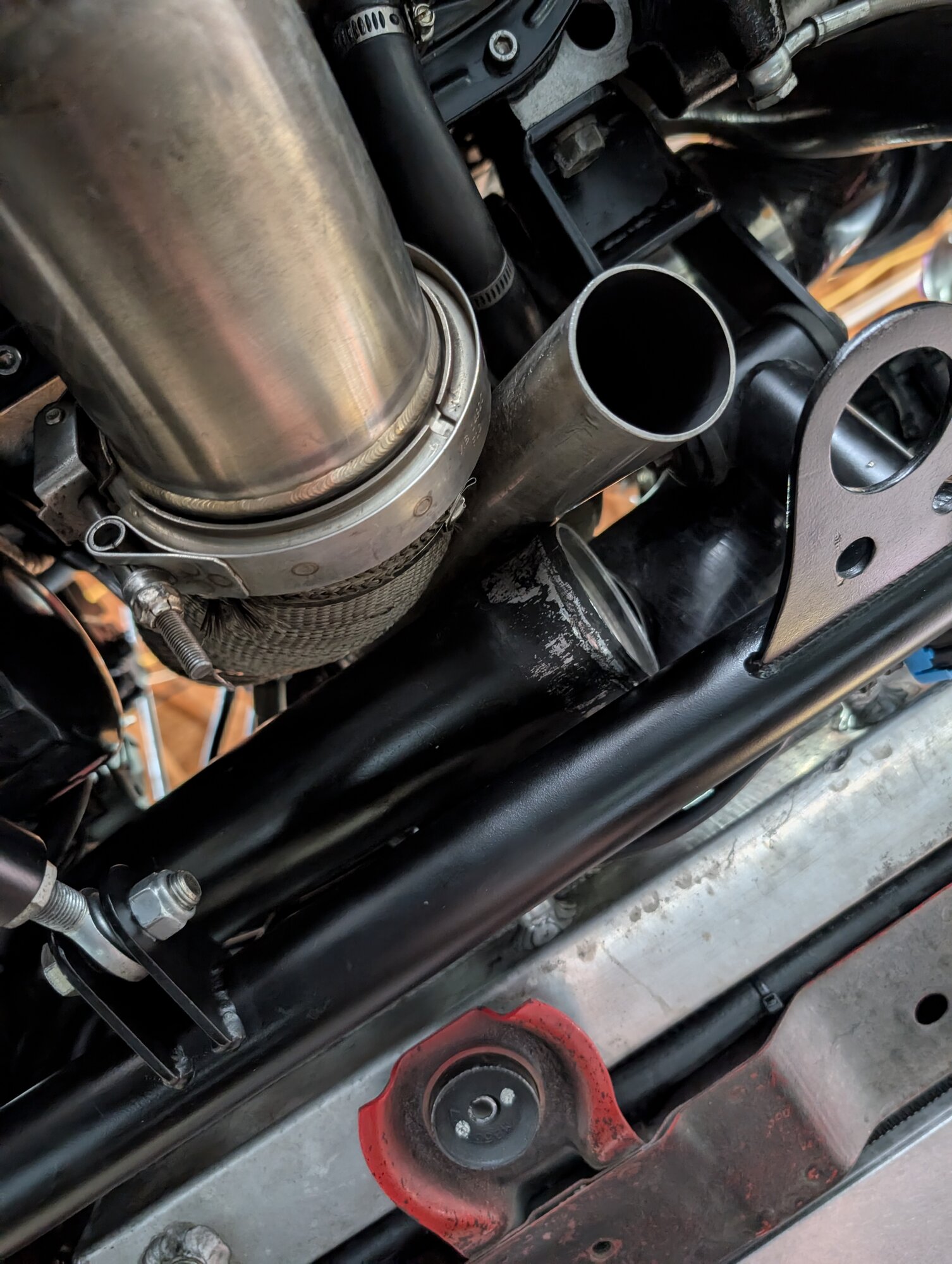

Oh and it blew the compressor outlet coupler off. I can't seem to cut those right so they actually fit well.. ordered a new one. 5th times the charm?

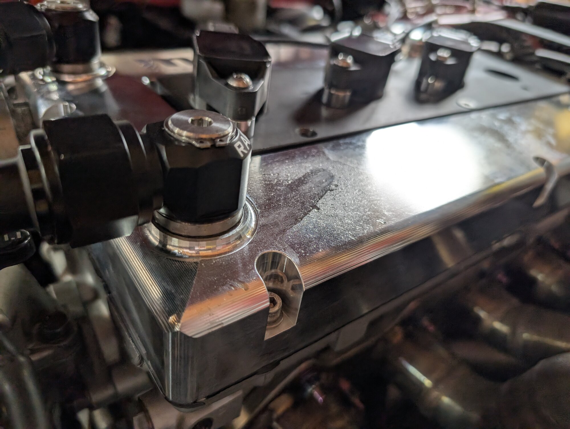

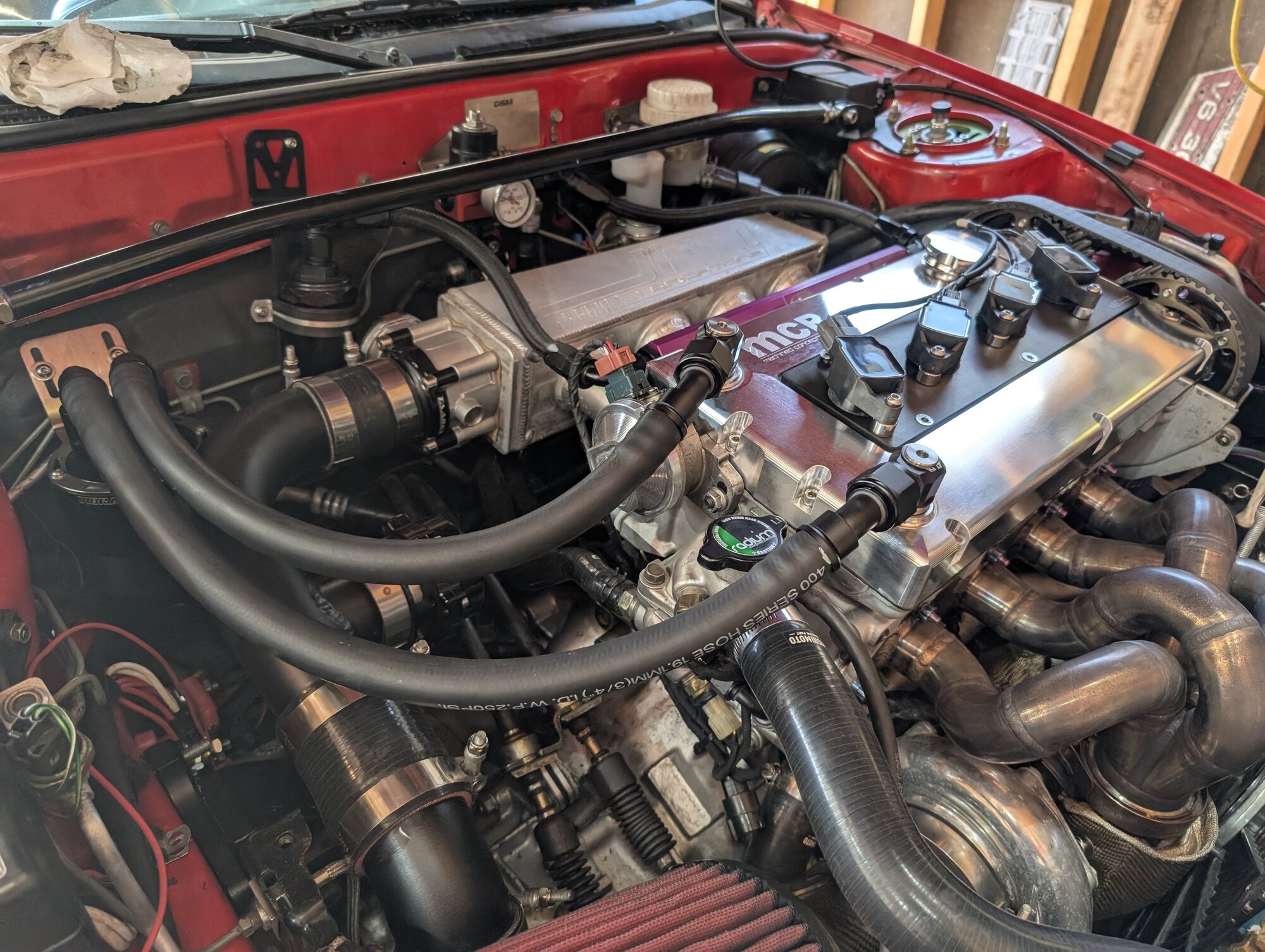

New 30° push lock fittings for the valve cover came in. Fixed the issue of the lines themselves hitting the hood. Side issue still though, the fittings themselves hit the hood still 🤦 also, these radium fittings leak.. right out of the swivel part of the body. Oil going all over the front and back of the valve cover.
I'm going to find the lowest of lowest profile fittings I can find an slap em on there. So far I've found these FITTINGS but at $90 a fitting.... Maaaaaan idk. They do say they are only .6" tall though.. not even sure how that's possible.

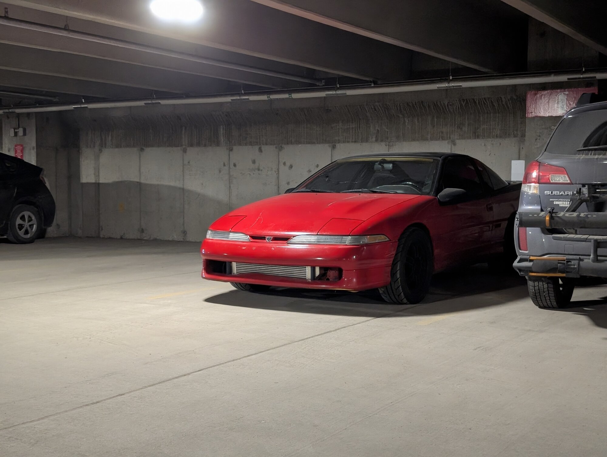

Friday night was a cruiser night downtown.
I fixed the blown off coupler from Thursday and Showed up with the talon. Ever since I got the car running again the switchover from idle to acceleration or just leaving from a stop completely bogs the car so hard it almost dies. Lambda shows pretty lean at like 1.2lambda when it does. I don't know if it's a rich misfire or what. I have to rev it to like 3k and let the clutch out slowly and then off and away.. but man that's embarrassing. I don't know how stuff like that happens when nothing has changed tune wise from before and after I pulled the head but somehow it's different. I slapped on an old tune file that was still relevant and it seemed to have fixed it about 90% of the way..
I didn't a couple small 1-2 pulls next to a parking lot where a lot of the kids come to watch and then shorty after parked to pick up a buddy for a ride and about 25 people came over to check out the car. Made me feel pretty cool. People ooo-ing and ahhh-ing.
Took my buddy for a ride but it was short lived because the damn coupler off the compressor housing blew off again. I drove 25 minutes back home with no turbo and the car drove absolutely great despite it.

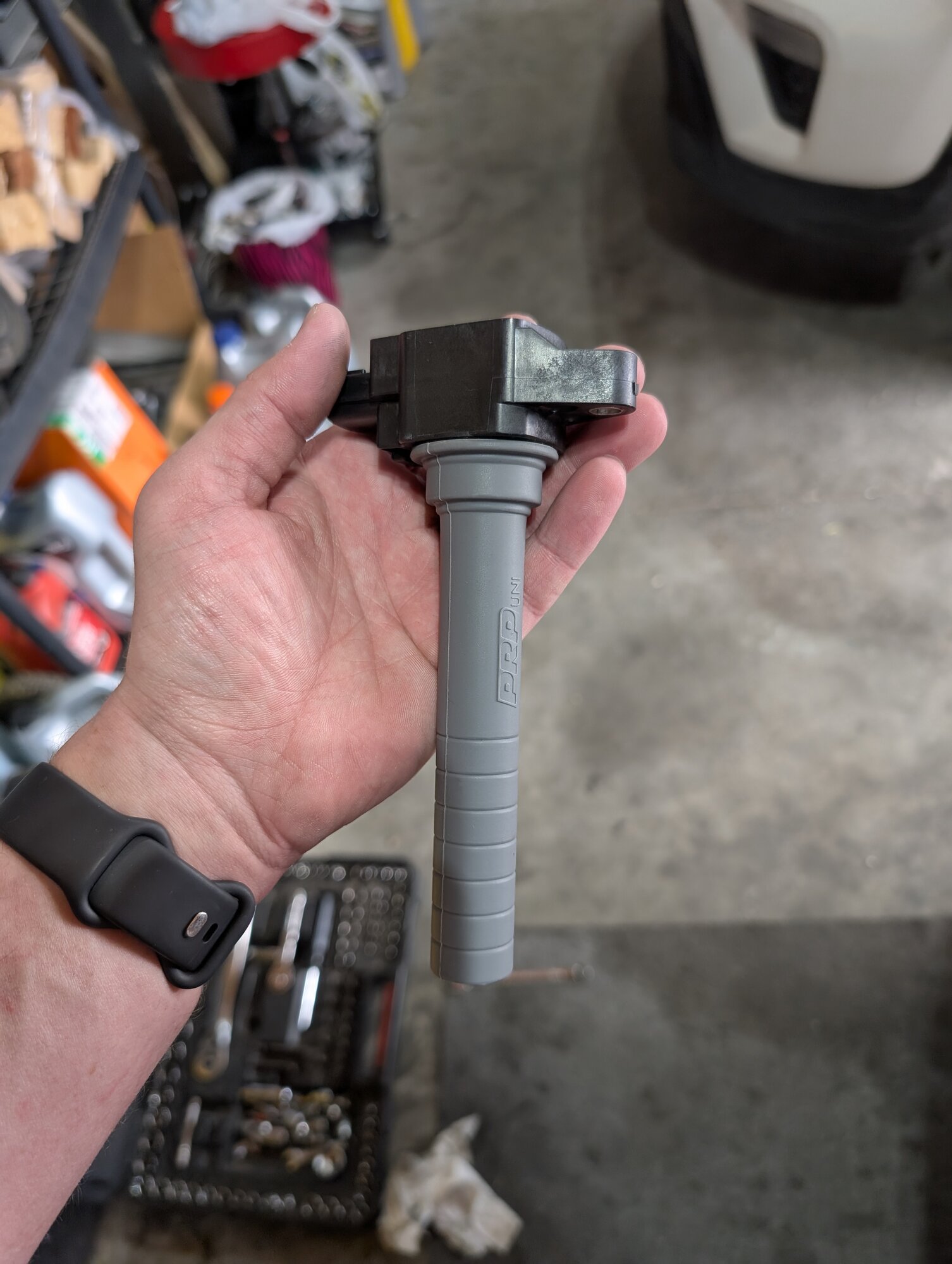

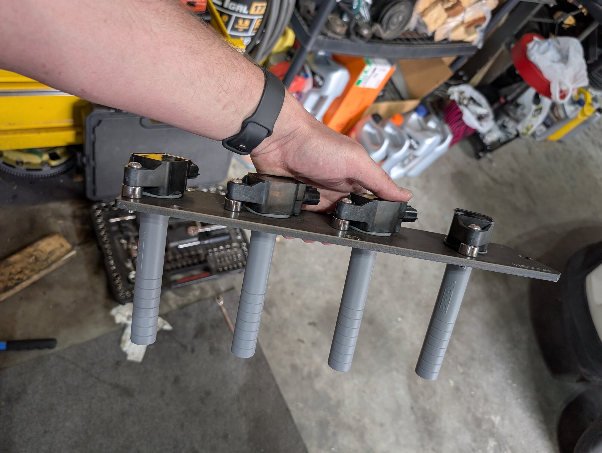

Saturday I pulled the coil packs to double check some base timing drift when revving and while doing so I put on those $100 coil pack boots that actually fit now. My wife helped and she kept giggling and laughing cause they look like dillys. 😉

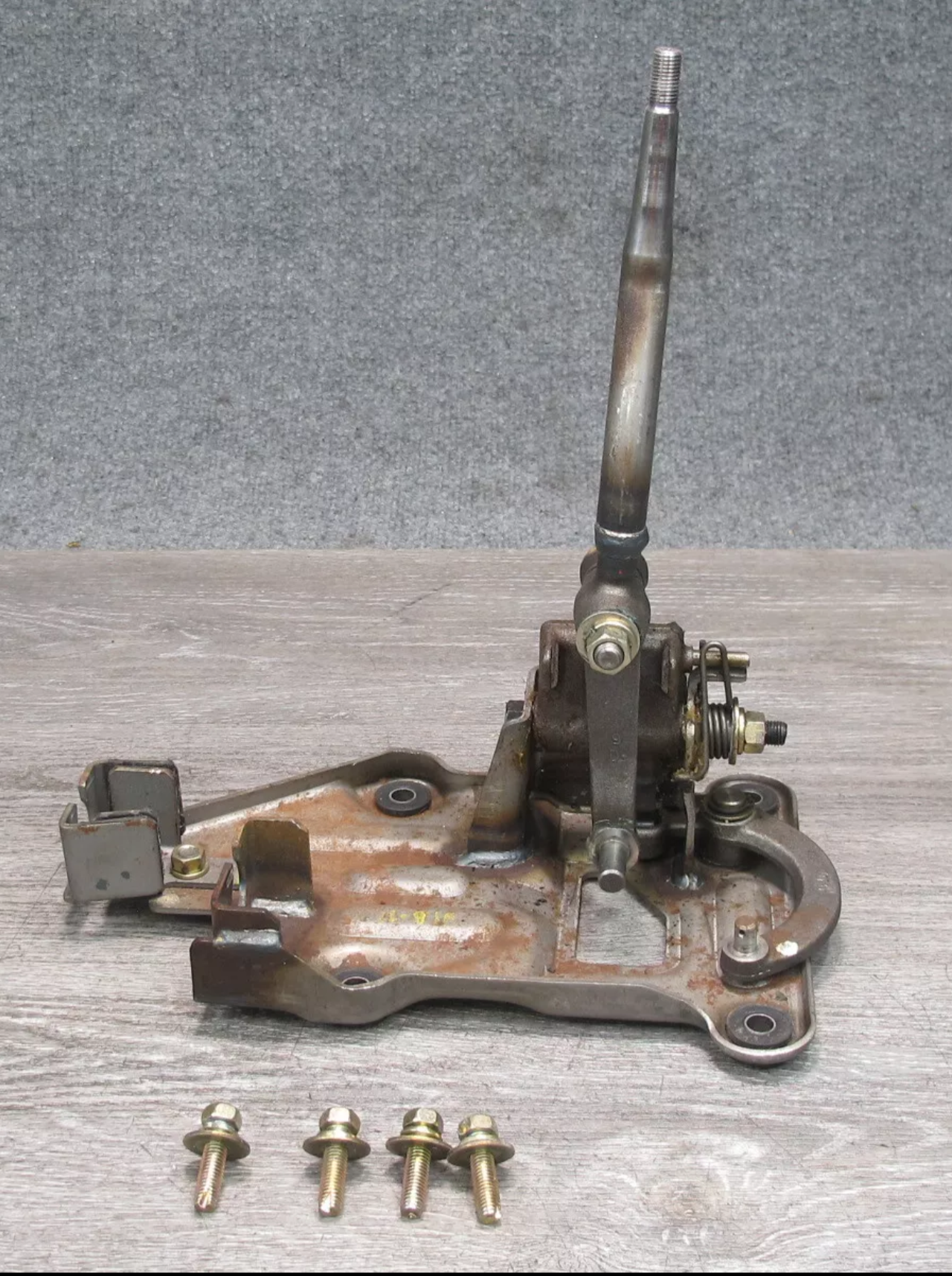

Found me a nice 93+ 3000gt shift lever for a good deal so I snagged that up. And I'll be sending that their way to have them modify it.
Heard back from JNZ and they still DO offer the short shifter, provided you give them a core to modify.

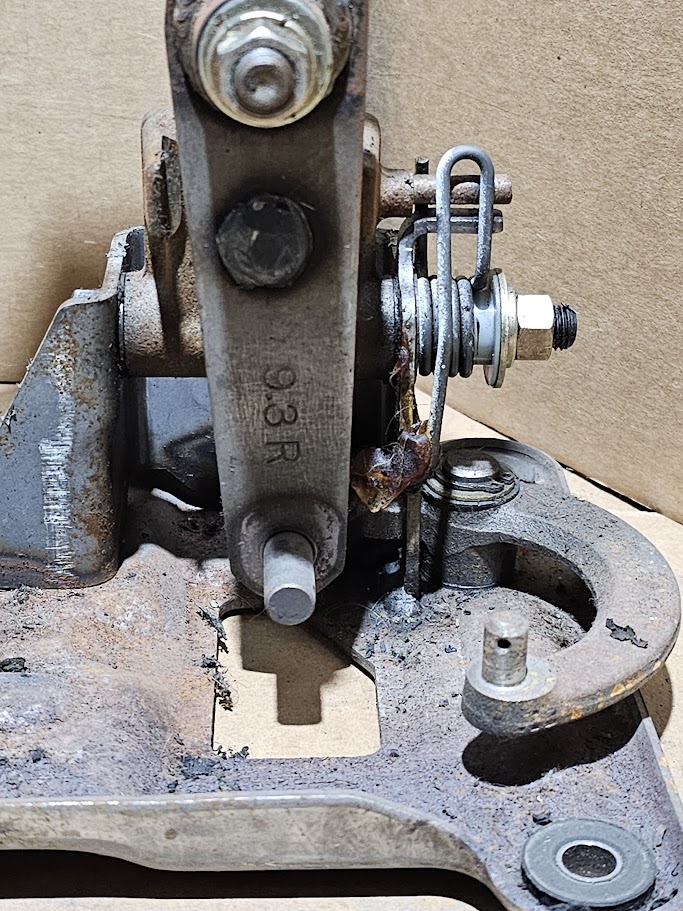

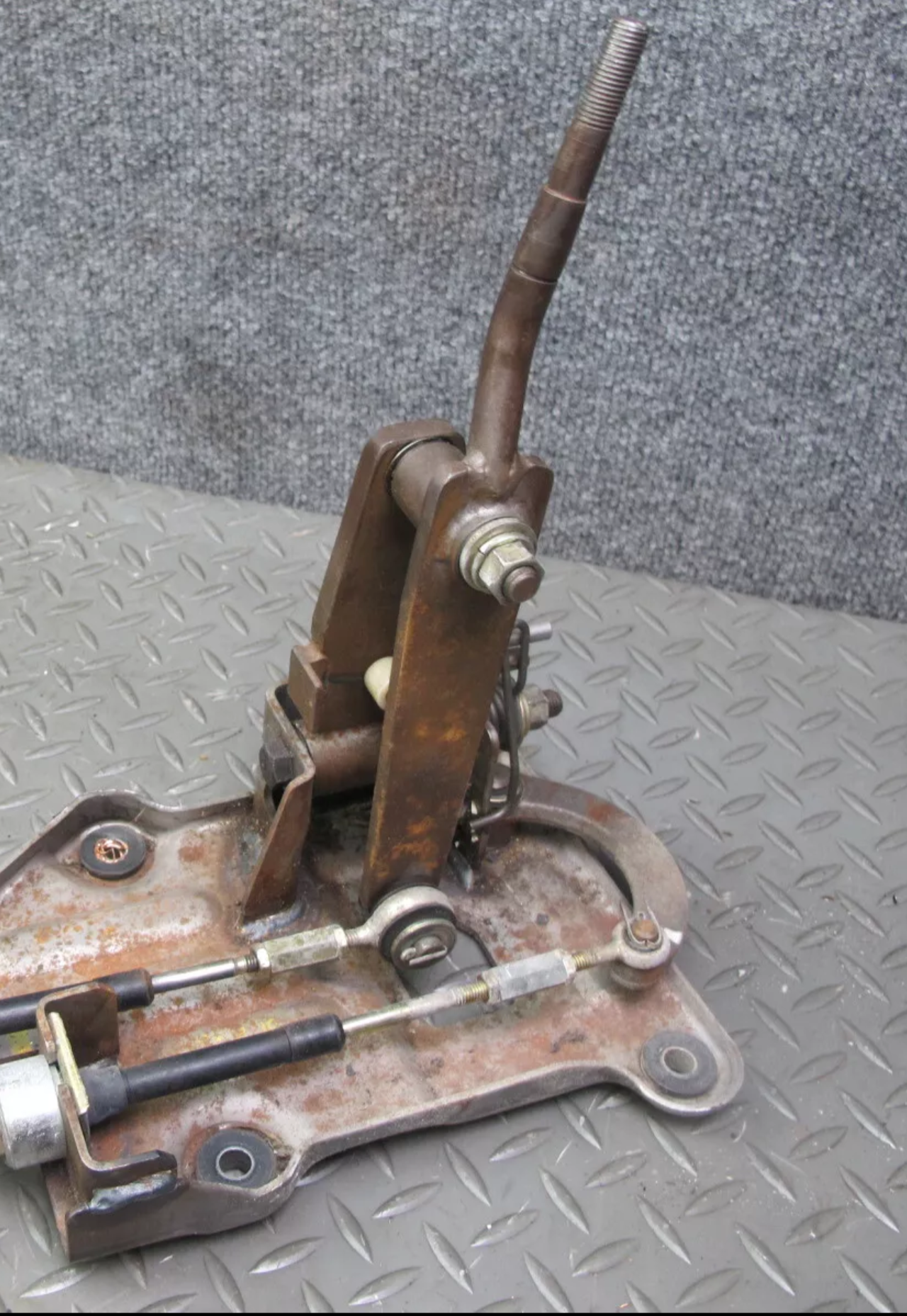

If anyone is interested in this you'll need to verify that you have the right shifter as they are interchange on the 3000gt technically but they ARE different..
93+ short shifter REQUIRED for this mod:
This also has "93R" stamped on the bottom portion too.
The 91-92 I INCORRECT shifter for this mod:
Take note of the bottom portion being much wider and flat on the correct one, as well as the amount of the total shift lever under the pivot point. THIS is what is actually shortening the throw.
It's also important to note that if you are having this mod done for a 1990, you'll need some additional parts off the lower portion / base of the shifter.. 91+ shifter assemblies only require just the shift lever itself.
