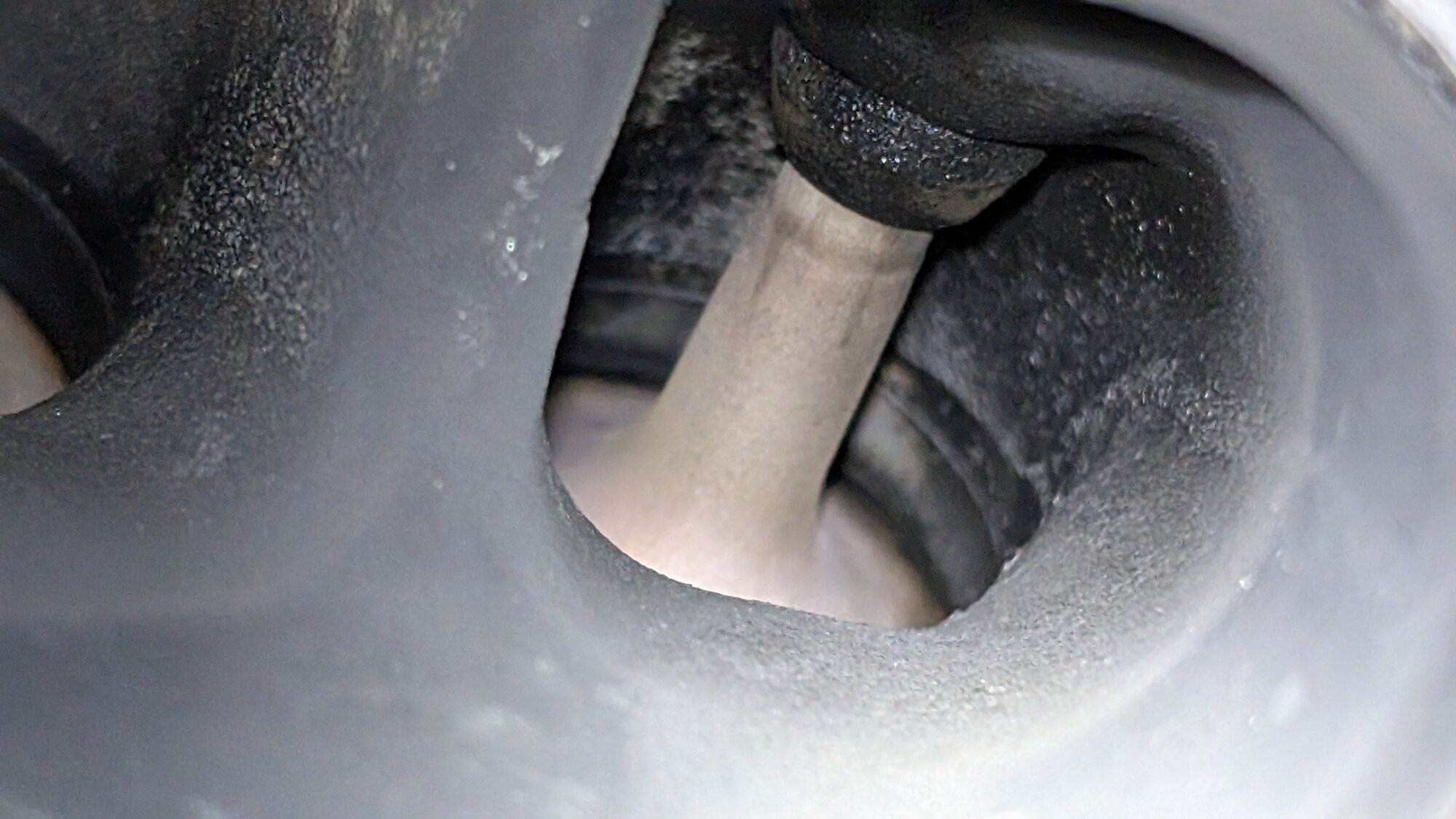

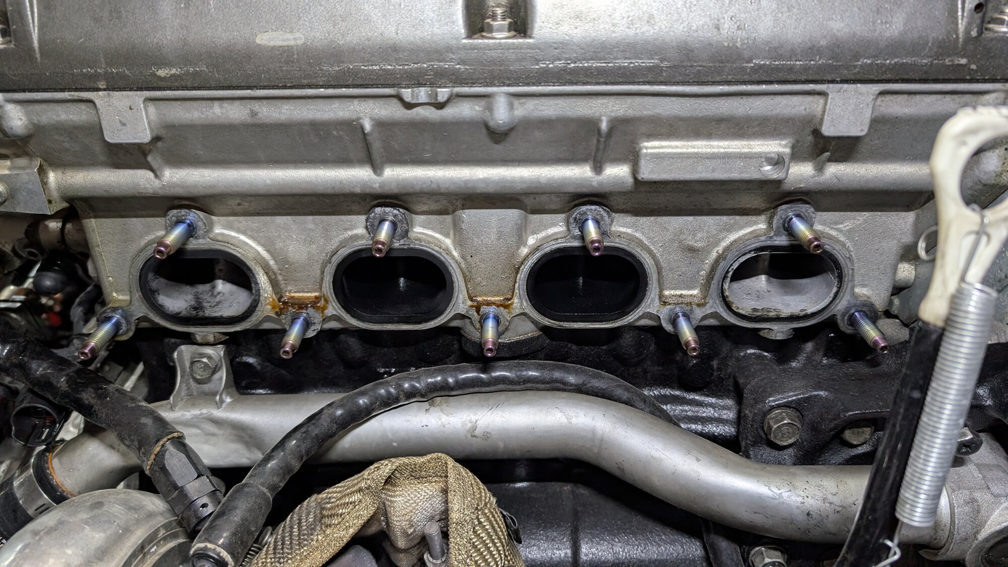

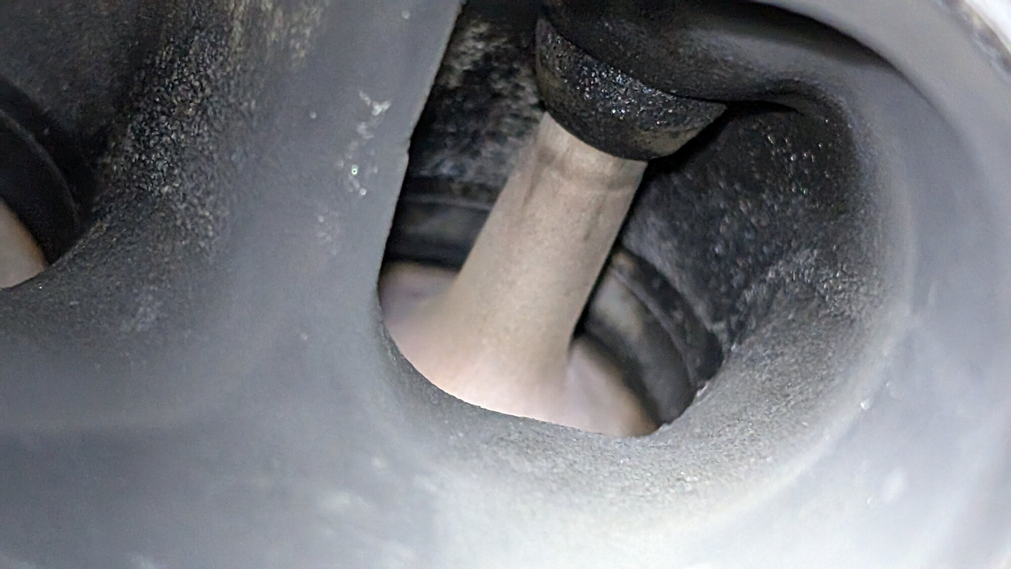

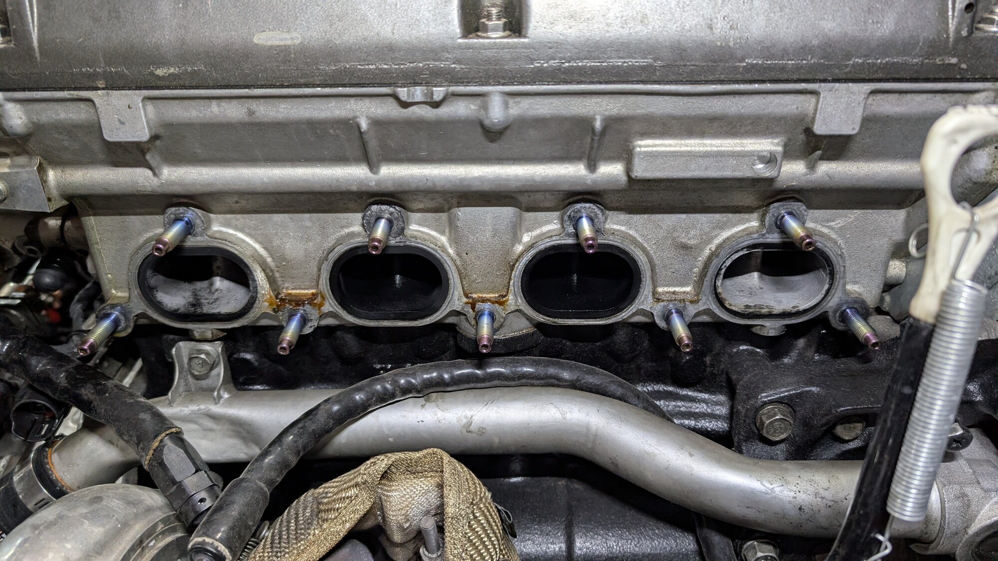

Got the manifolds off and found this on the exhaust side. Cyl 2 and 3 are black as night. 1 and 4 are dry white.
The black isn't oil feeling, it feels wet just like condensation. Even wiping with a towel its like wet soot stuff.

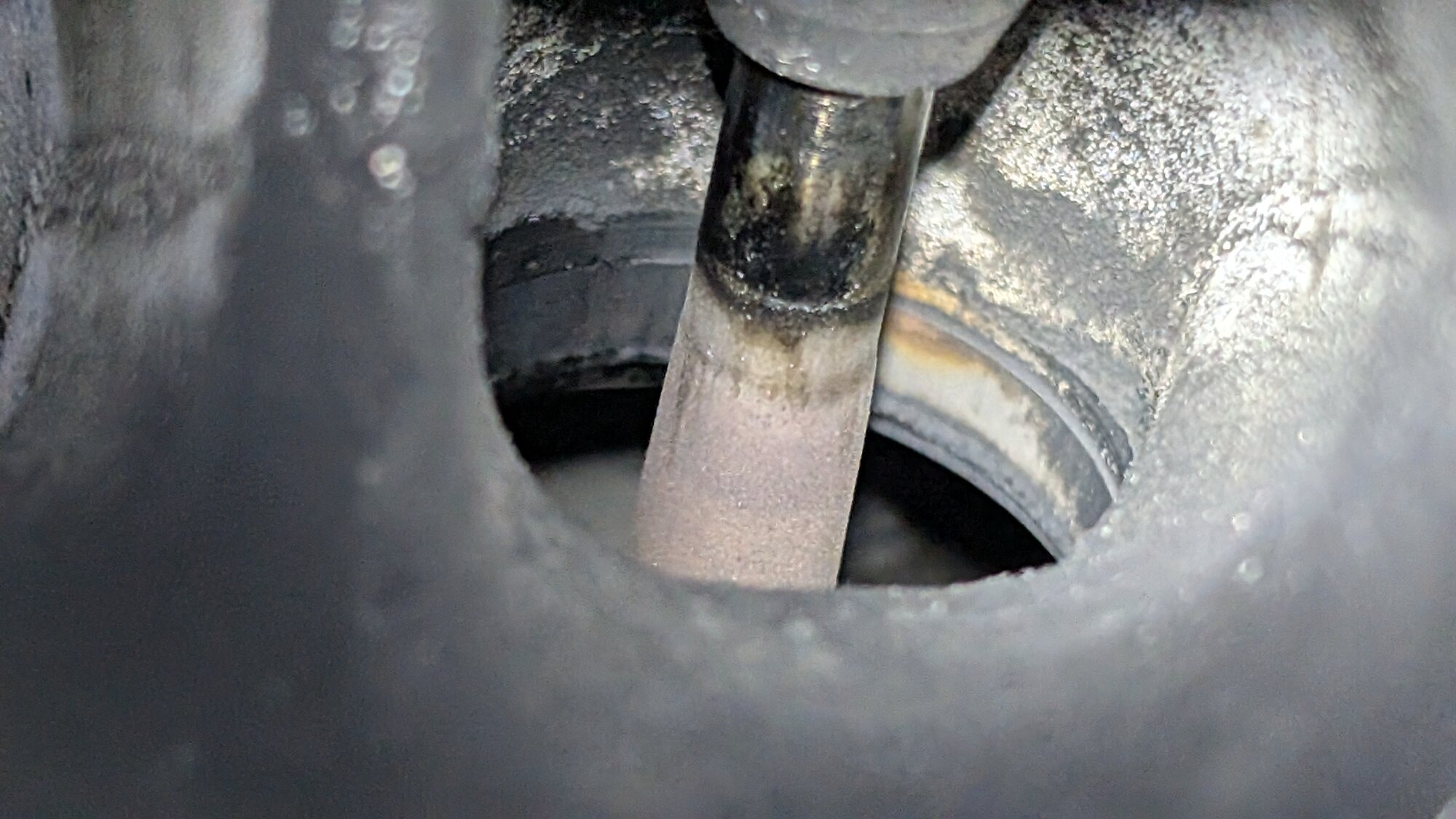

Here's what some of the valve stems look like. Unfortunately I can't remember which cylinders this was, I THINK 2 and 3?
It looks like one of them might have been burning oil, but I never noticed any excessive smoke or anything. Idk but new valve seals are going in when the heads off / apart.

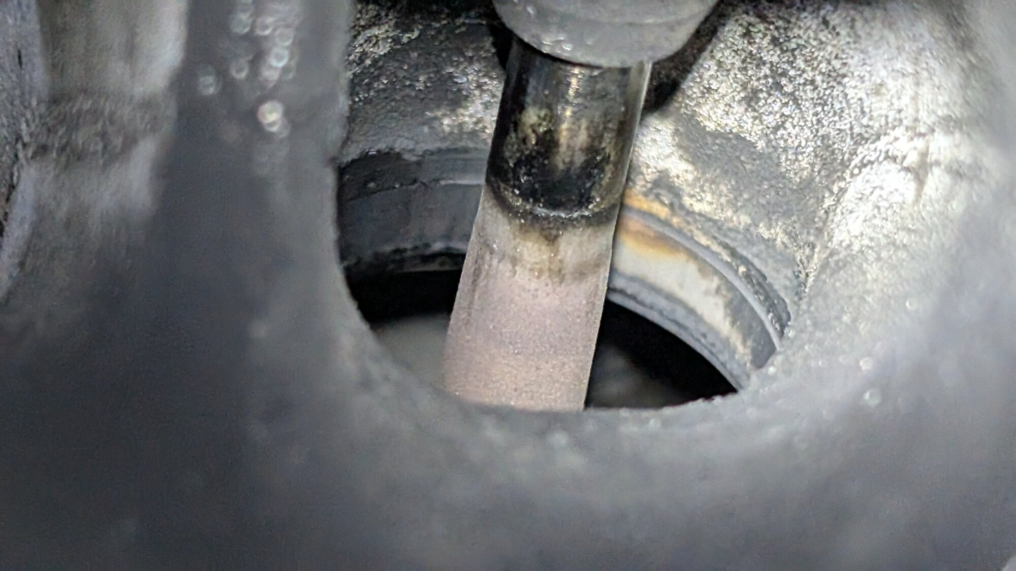

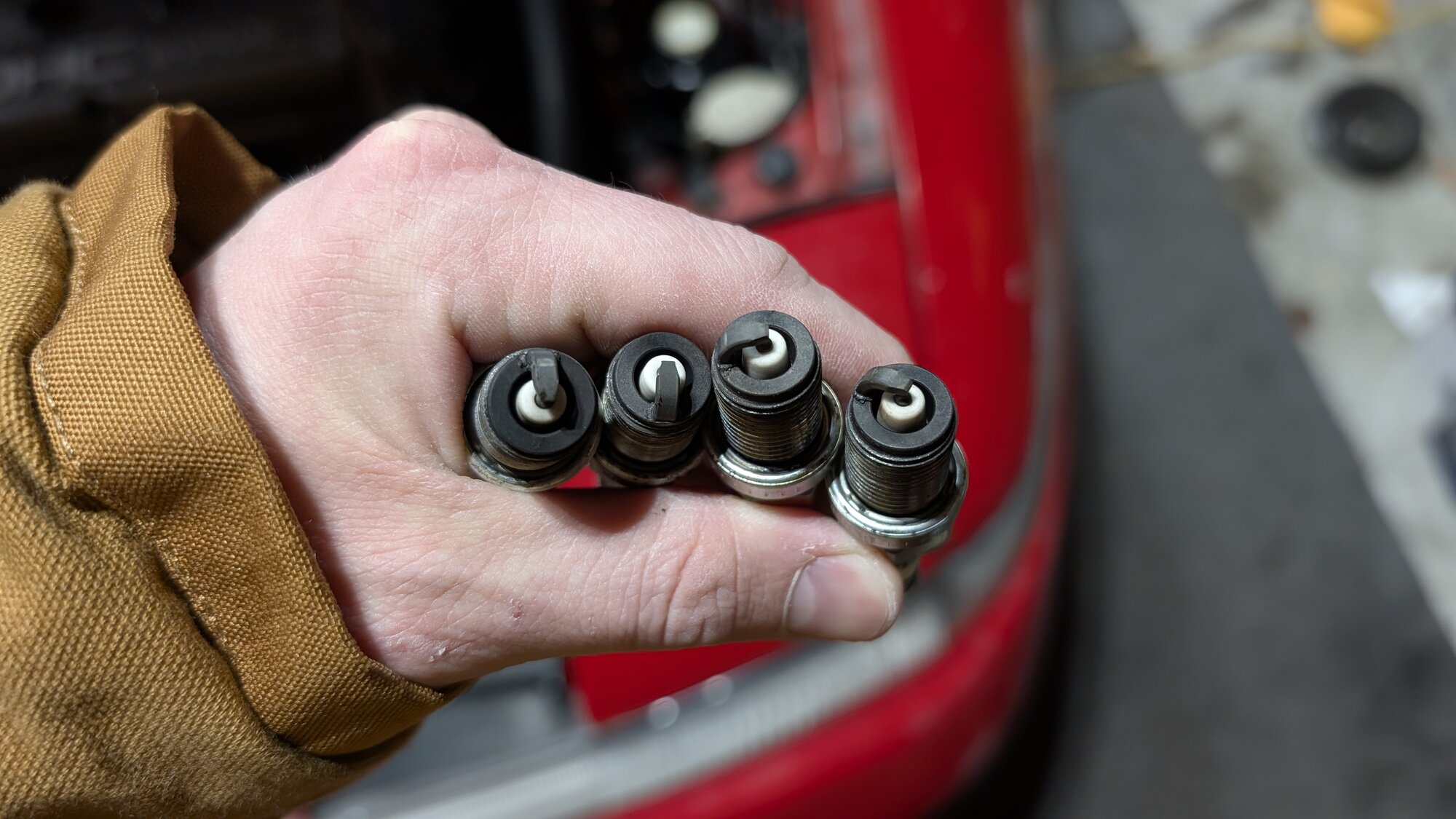

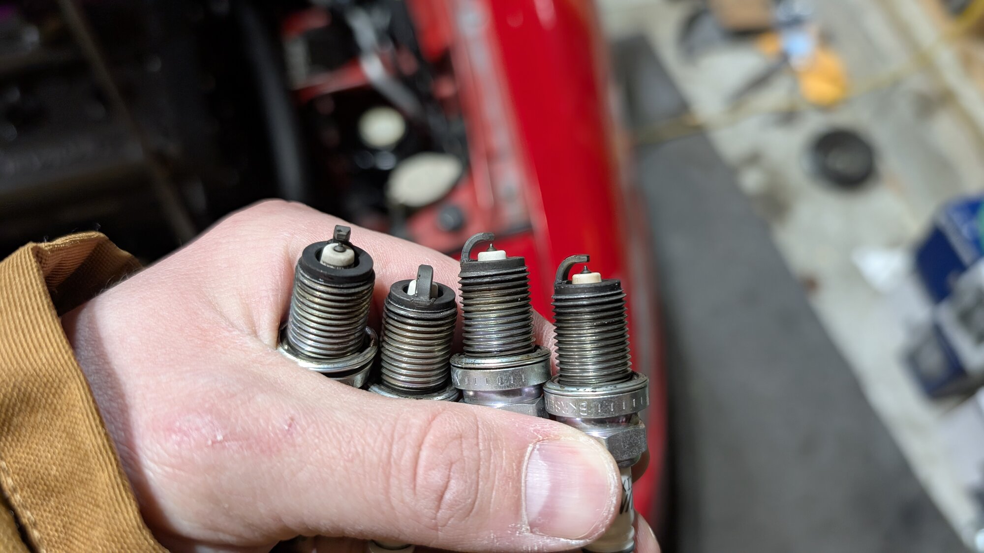

How do the spark plugs look like? If the #2/3 look more dry black fouled than #1/4, maybe the injector flow difference between each cylinder or weaker spark at #2/3 for some reason.
I haven't pulled the plugs but I will tomorrow. If I had to guess, they're all going to be black because of all the cold start turning stuff I've been doing lately. Most likely desperately needed new plugs
2 and 1are not getting enuf coolant to keep the plug body cool. All of the plugs show signs. Has it ever overheated?
3 and 4 look like they where starting to creep into the threads, as i see it. That may be normal for you. It just looked different to me..
Well it did "overheat" once. Car blew a coolant nipple cap, lost pretty much all coolant. Drove home (about 1 mile) and last I saw temps in the ECU was showing like 250°.
I don't know if that was right or not because there was no/little coolant but that's what happened. Car ran and drove fine after that still actually.
Perhaps the cylinder head got lifted a bit? Didn't you hear the sound that pushing coolant after pulling hard with high boost? I remember that I started to hear it some time later after I started to boost 50+ psi with no o-ring, just L19 studs and a MLS head gasket.
I didn't hear anything, honestly. If I didn't I wouldn't have kept doing pulls. The car is fairly lound so that's probably why. I did see some extra coolant in the overflow but no ballooned radiator or anything like that.
To me your plugs just look rich, with the boost you’ve ran on a 67mm turbo with no O-rings I’d say your BALLS are bigger than your problems. What’s your engine compression? I assume your timing isn’t too crazy at 8000rpm, my guess would be valve stem seals on 2 and 3, if you had 2 injectors out of 4 jacked up your AFR’s would show it:idontknow:
Considering your hot start crank sensor issues that might also explain the break up at high boost?
