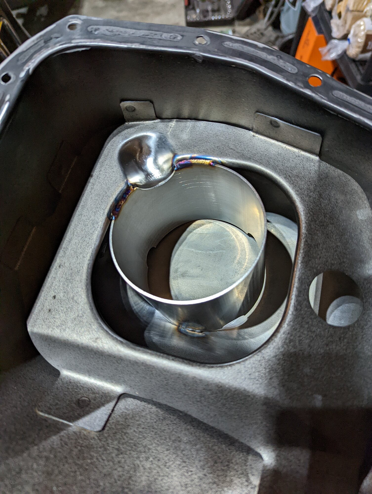

Problem is, I got this fancy ass Buschurs baffle welded into this pan..
Dude if I were you I would just buy a new car, I mean oil pan:ohdamn:, I’m telling you, a good oil pan seal is like a happy mls head gasket LOL, if you want a leak free oil pan, buy a new Spectra, get some Ultra Grey RTV and crack a beer to celebrate.
I ordered one anyways. Maybe I'll just have the baffle done again.. oil pans are $66 on Amazon right now
Curious why I don’t see anyone using the MAPerformance oil pan. Is it just the cost? I bought one years ago and worried a little as I don’t see anyone using them…? Obviously I haven’t installed/tested yet.
IMO, price for me. $170 for an oil pan that is basically Identical to the $66 one I just ordered. I've never stripped out bolt holes or anything on mine. No leaks from the return line either.

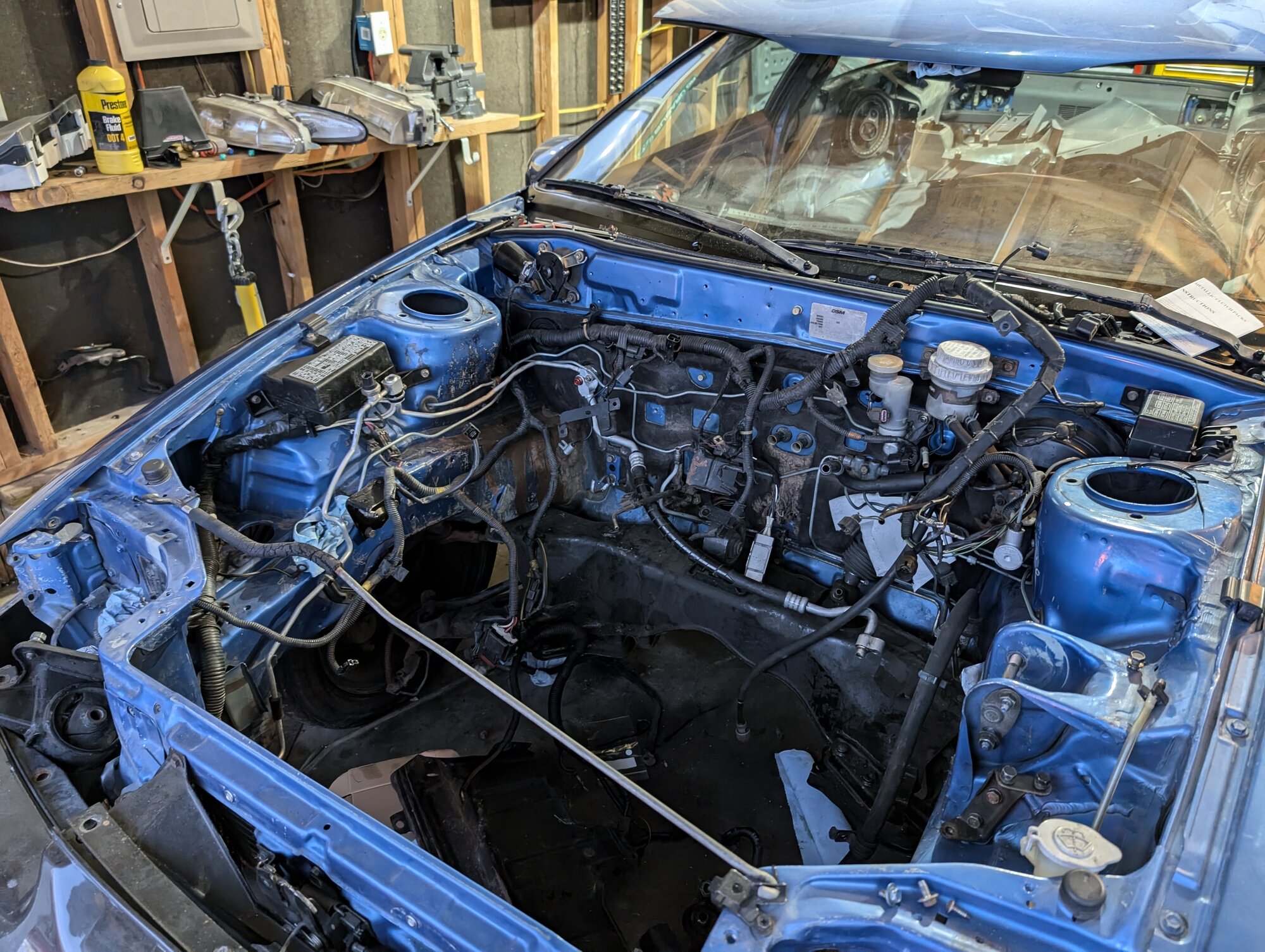

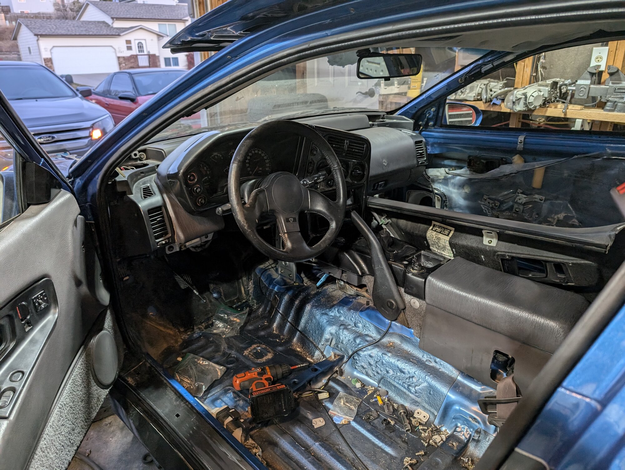

Worked on the blue car last night car was basically pulled almost completely apart except some stuff in the engine bay and the dash bars and what not.
Was able to get:
Wiring harness installed and mostly routed.
HVAC installed
Dash fully installed, including all cluster, radio consoles
Steering column installed
Pedal assembly installed with brake and cluster master connected
Headliner installed
Shifter and full center console fully installed
As it sits right now there just a bunch of loose bolts I threw in there from the swap that probably still belong at least somewhat to the car and a bunch of loose trim pieces.

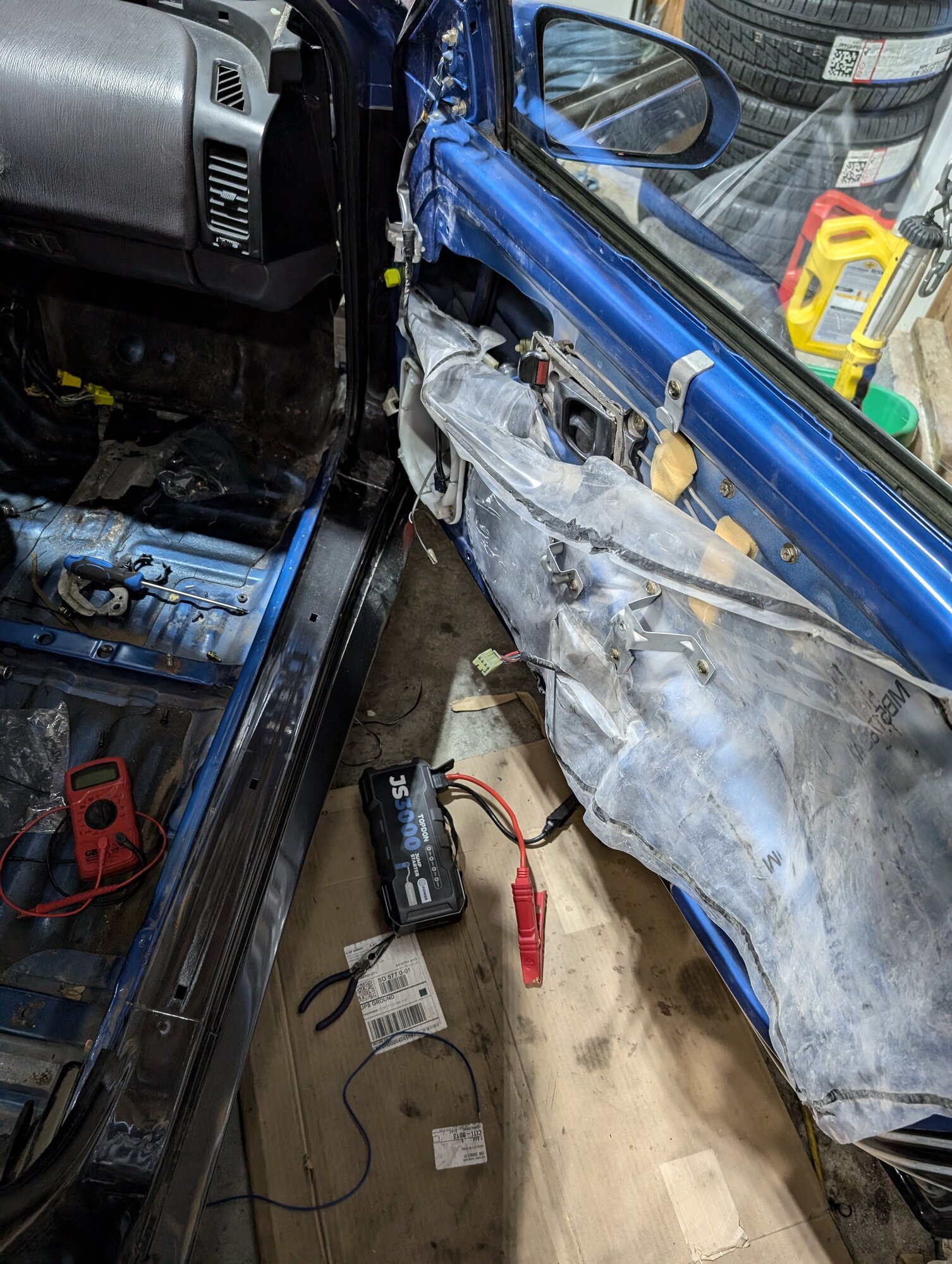

I had to roll up the passenger side window without power to the whole harness. Got to thinking and I just applied 12v to the window motor and up it went!
Need to get the hood installed and tie up a bunch of the dangling wires in the bay as well as close up all the big holes into the car ( shifter cables, drilled holes for extra wires in the firewall, fuel pump cover, etc.)
I'll be playing musical suspension between the cars this weekend I think to get the blue one out since I don't have struts for it. Take the coilovers off the red one, put them on the blue one to roll out, and reverse and put them back on the red one after it's back in stands.
