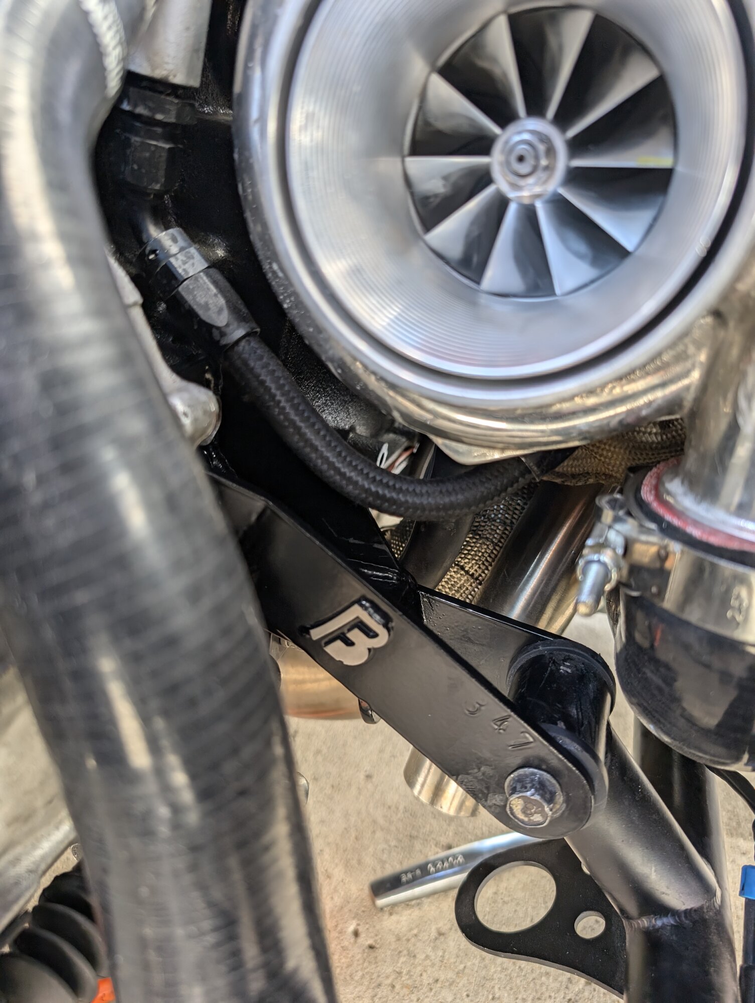

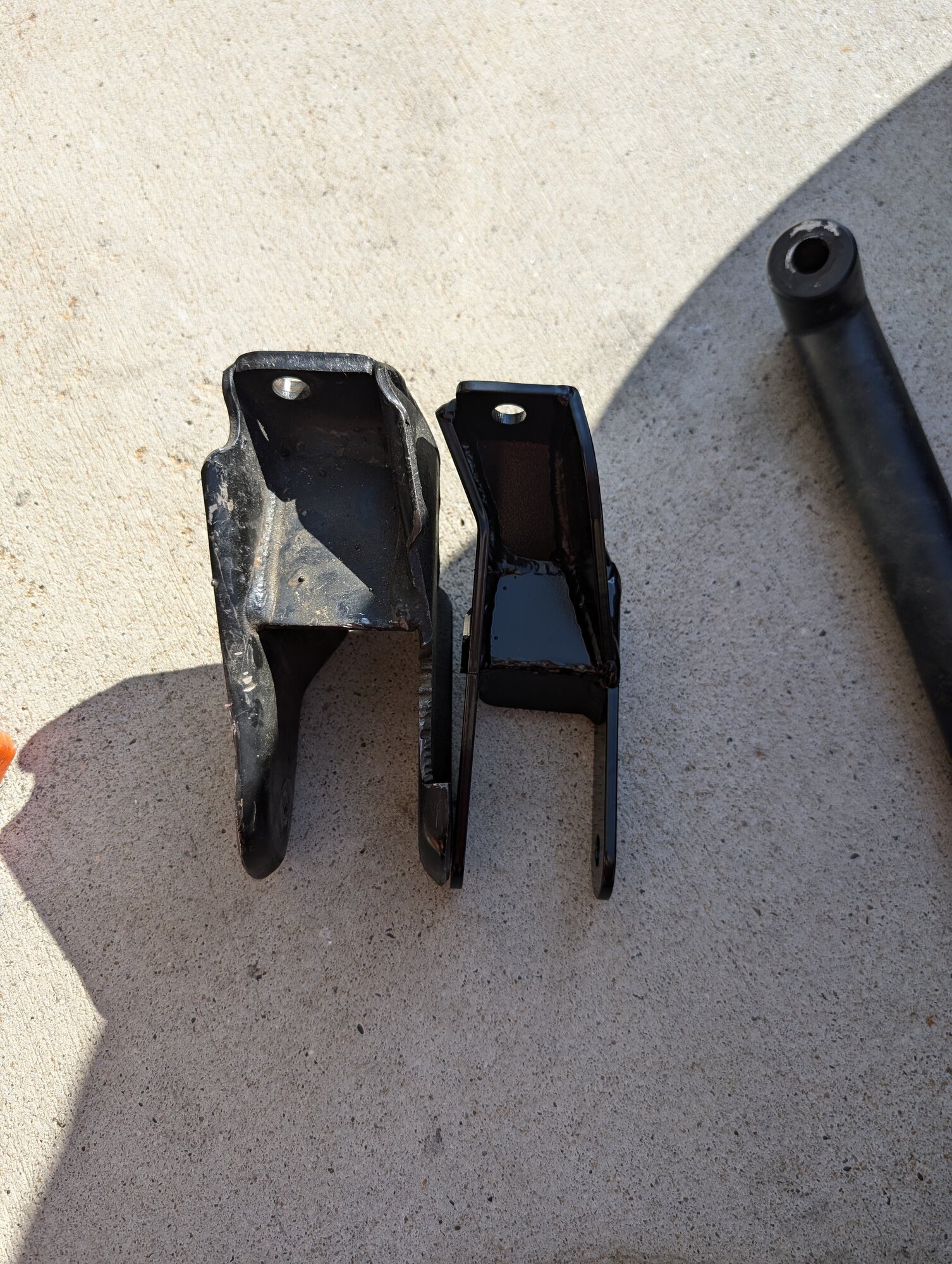

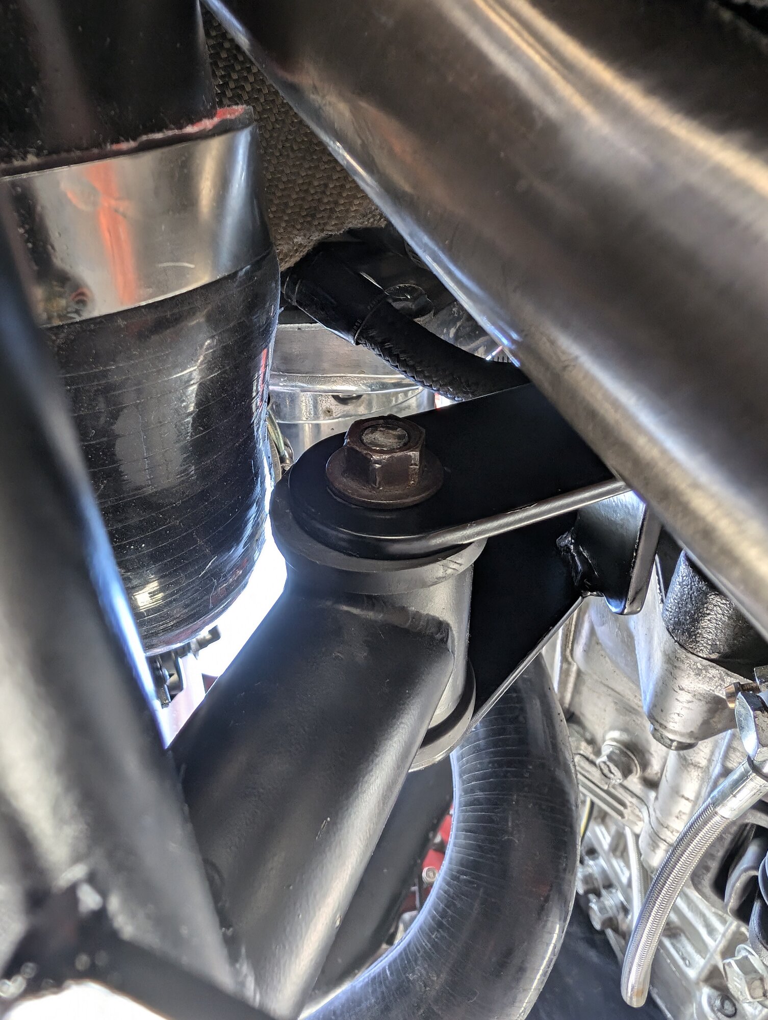

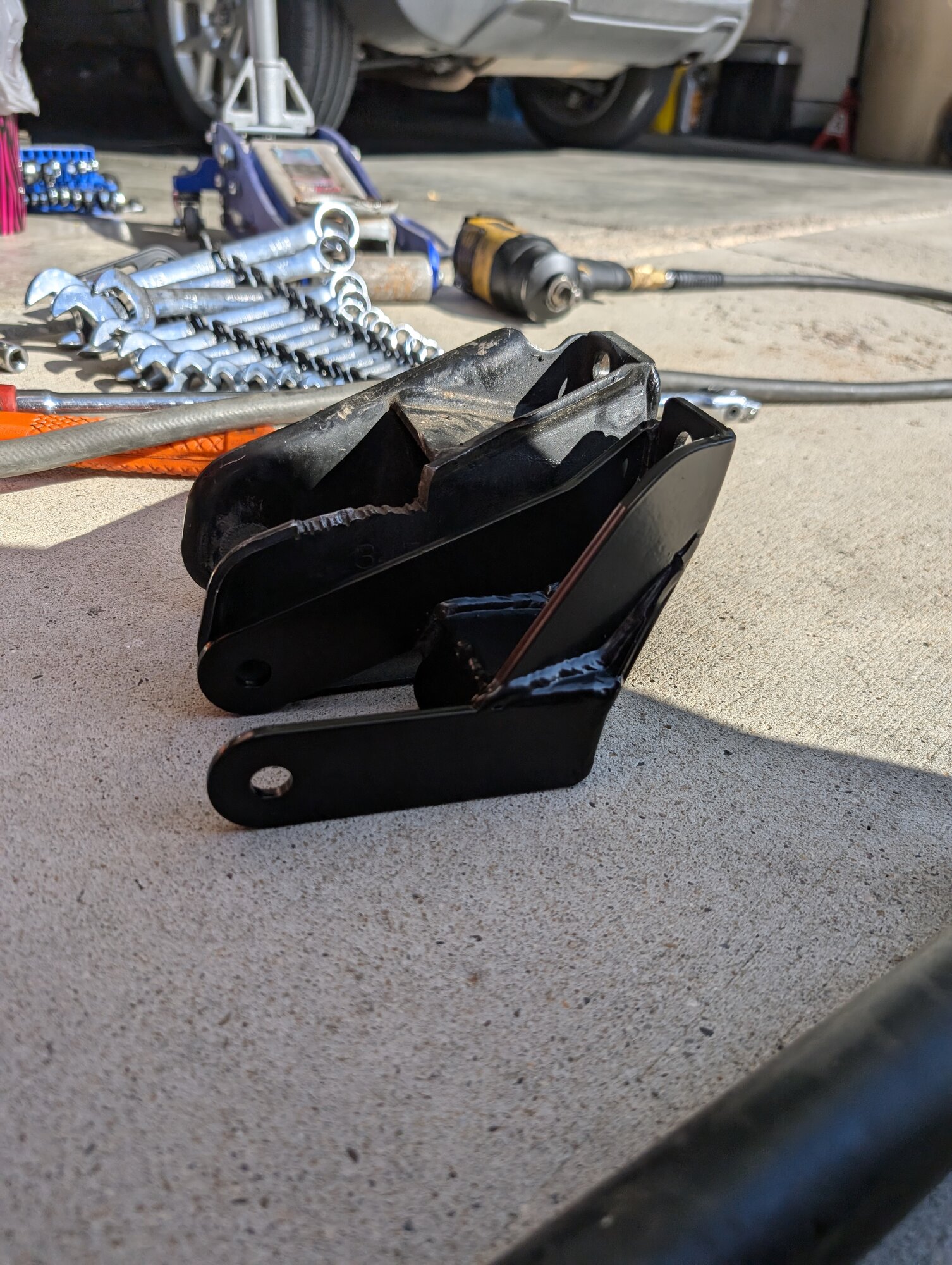

Swapped out my motor mount bracket yesterday which wasn't too hard but was annoying. Definitely a lot more room for the coolant line, oil return and the compressor outlet charge pipe. Happy with this one.
PXL_20240827_222934668.jpgPXL_20240827_222937232.jpgPXL_20240827_230749006.jpgPXL_20240827_230809072.jpg

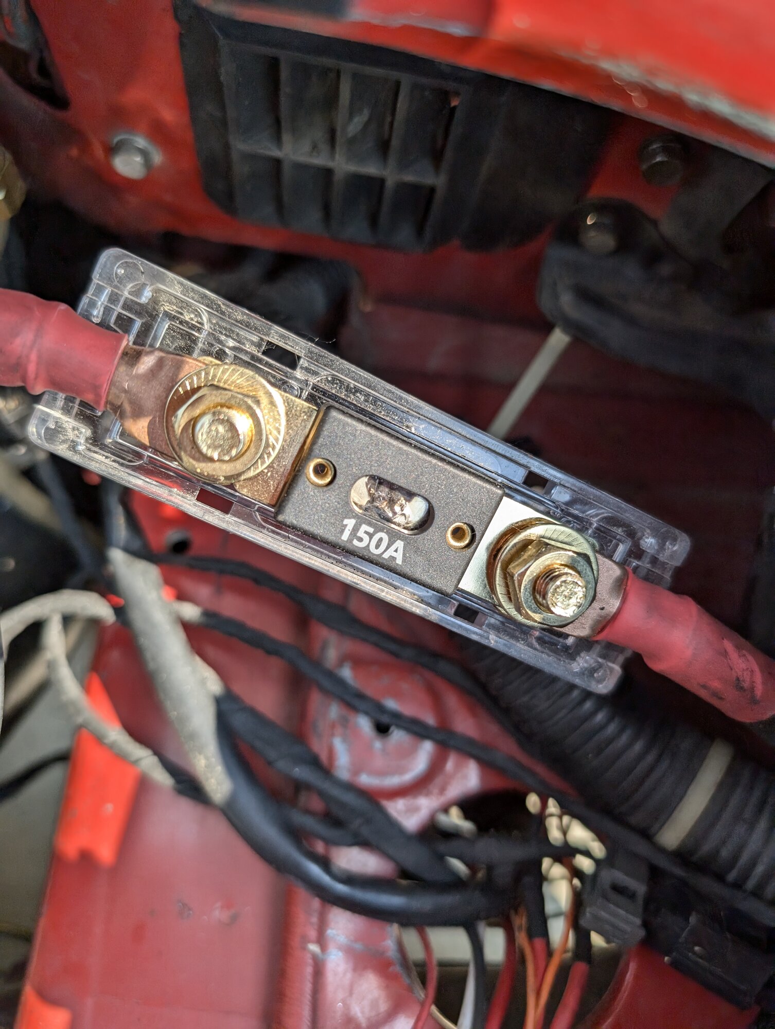

Started tracing wires and found this:
This is the fuse to the battery/ main + junction.
Swapped in a new fuse and bam! 13.7v at idle and 14.2 a cruising, Perfect.

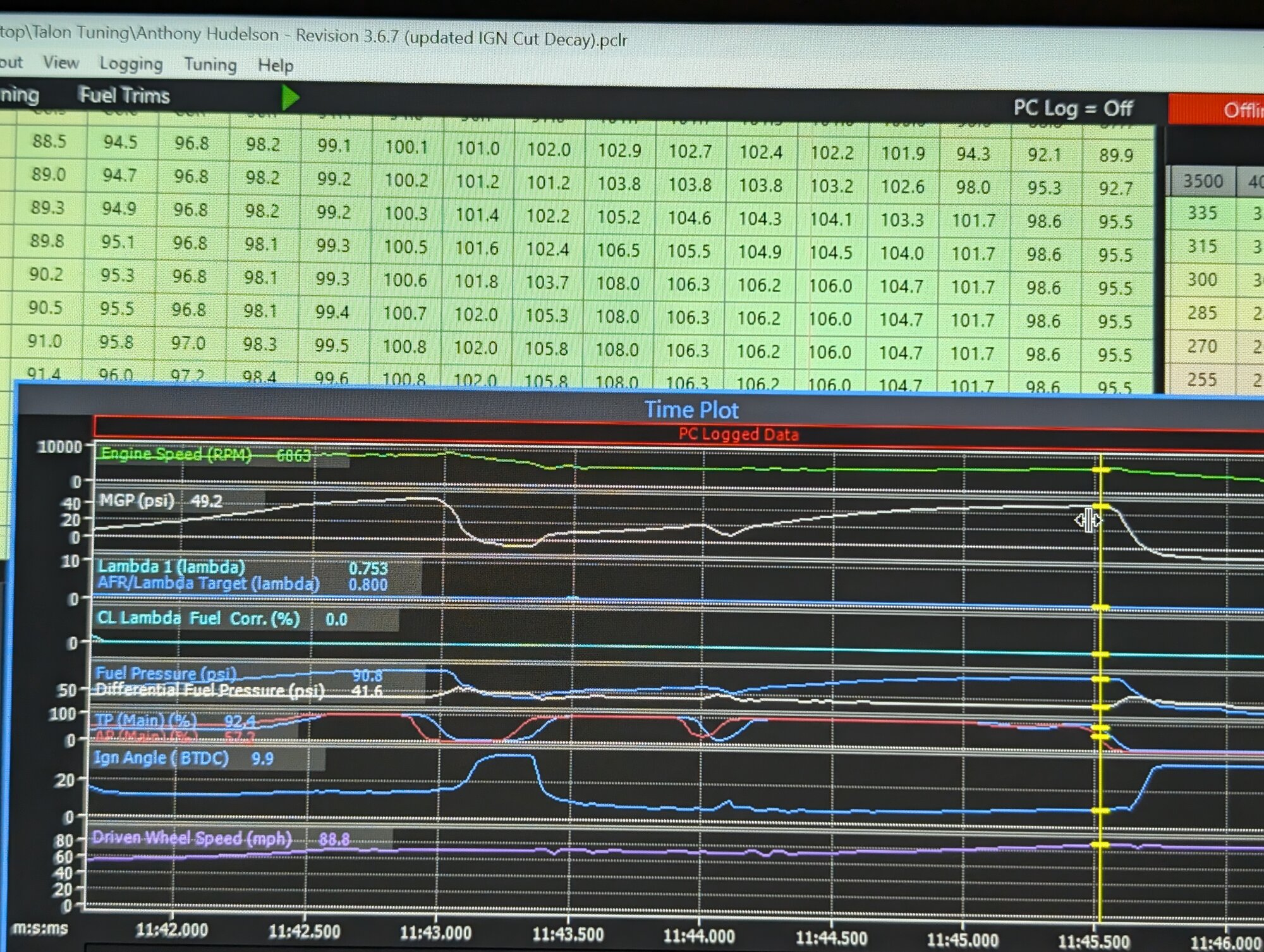

My fuel pressure isn't rising with boost. Its just stuck at a basically static 43psi.
Vacuum line looks good, but im going to do a boost leak test today, and then if that doesnt show anything im going to stick compressed air into the line with the car running and see if pressure goes up or not. Ill report back later on this.

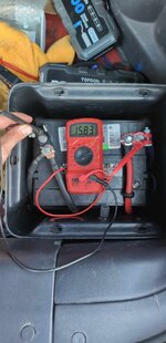

I tested Voltage with my multimeter with the key on engine off at the 2 posts in the bay and it read 15.7v ! My CAN Gauge shows 12.3 in the same state.
I checked directly at the battery, and it read 15.8v! I tested my Daily's battery also and it read 16.8v so my multimeter is definitely broken LOL
After awhile it wouldnt even start with the jump pack on. I thought maybe i flooded it or something so i just left the car sit for about an hour and then tried again and still no start even with jump pack on.
Ended up checking my coil fuse to the coil pack relay and sure enough the 10amp fuse was toast. Replaced it and the car fired up.

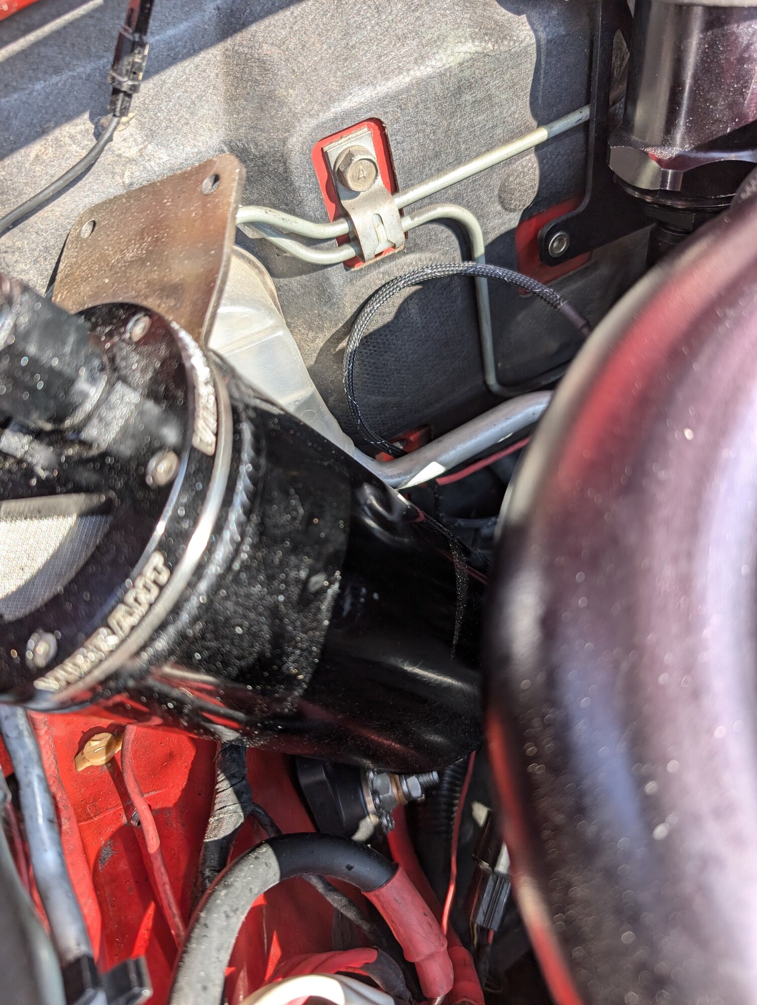

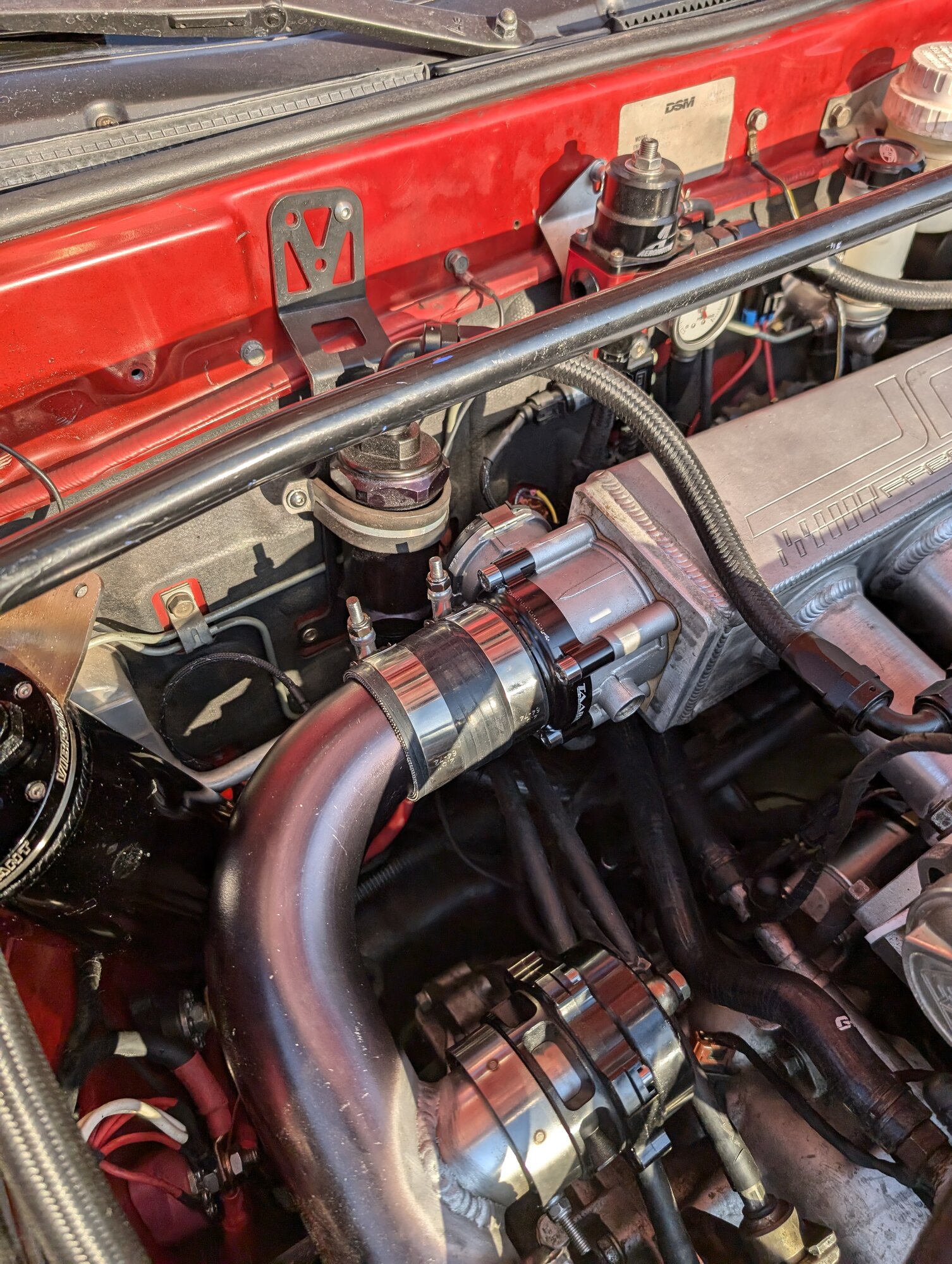

Yesterday thought was really interesting.. on the way to work i came across a 335i and wanted to assert my dominance on him and i did. a little 2-3 action but when i let out of 3rd cause the car was getting a little squirrely it blew the coupler off the Throttle body at 49 psi. Immediately after, the check engine came on. I looked over at the laptop and saw "intake air temp above error value" and then i looked at my IAT on the Can gauge and it read 300+ degrees LOL

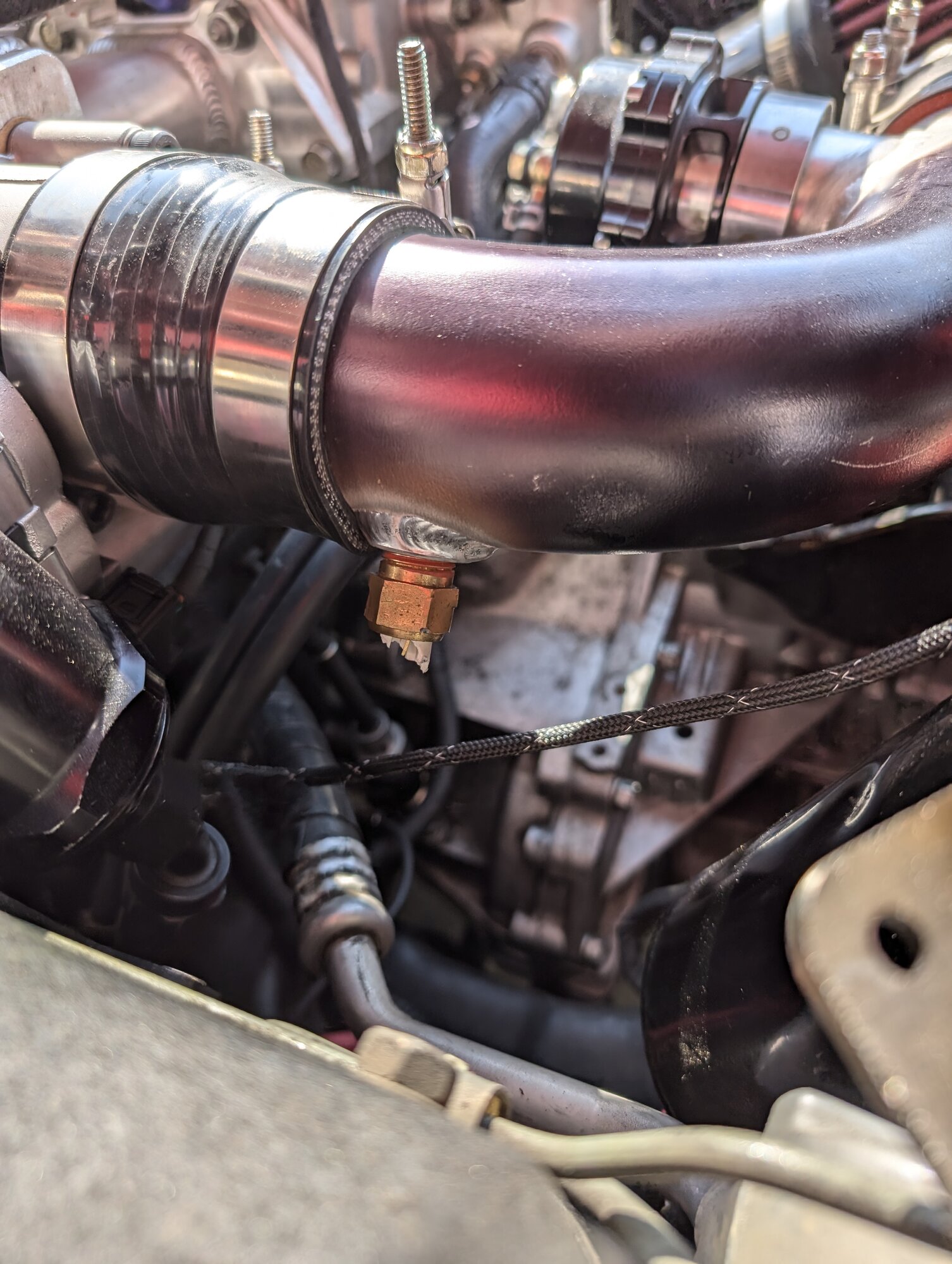

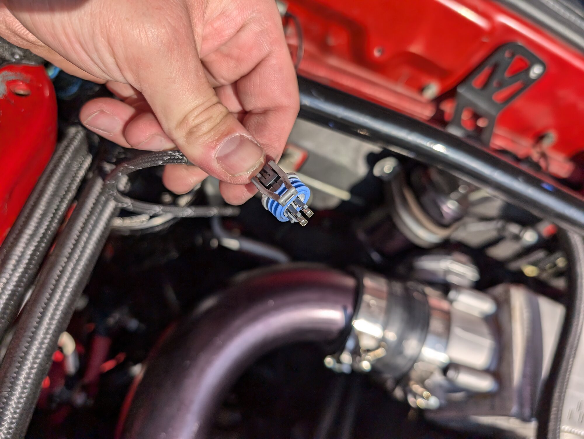

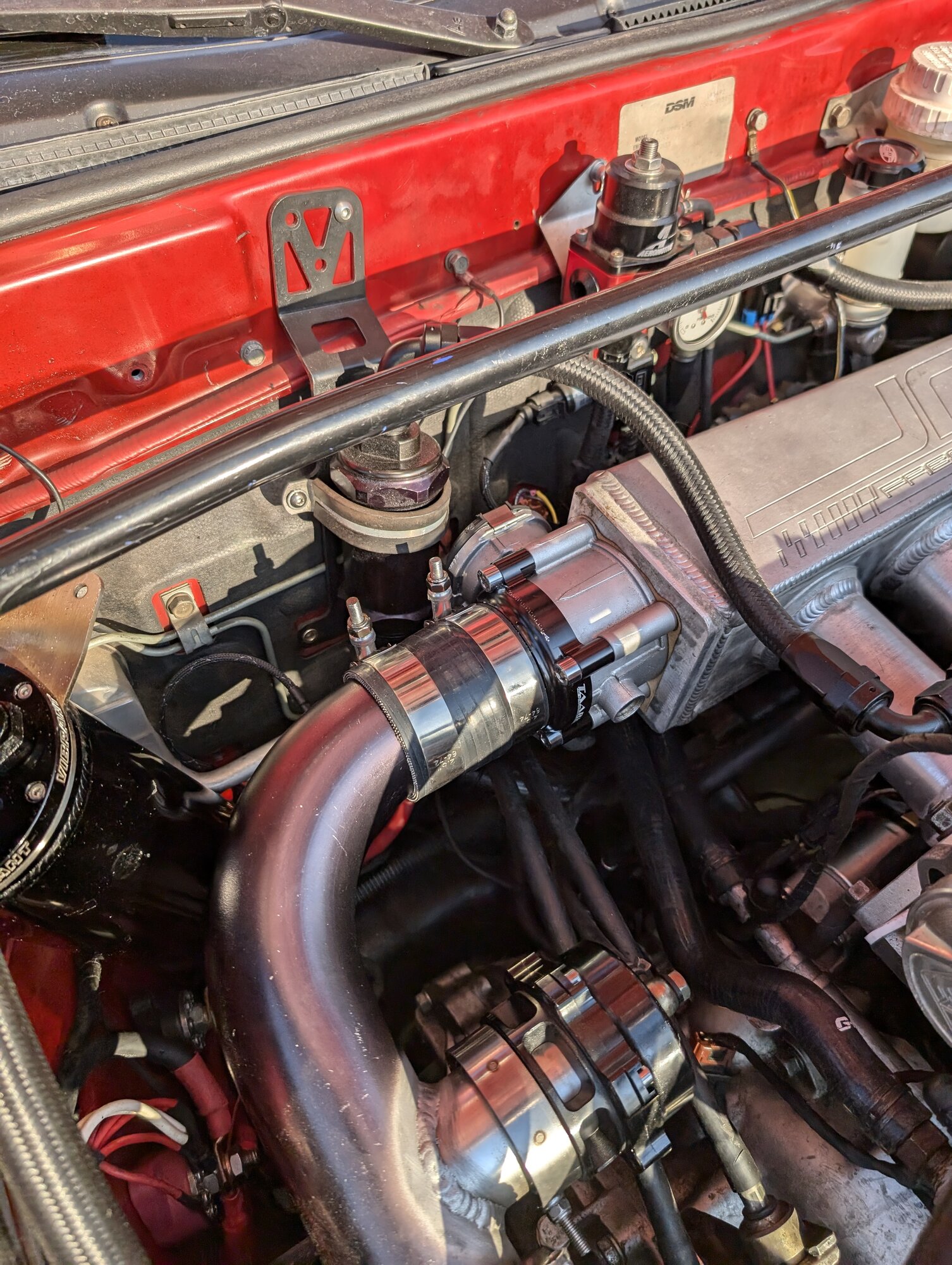

It struggled to make it to work since its missing a charge pipe and dumping fuel due to reading a faulty IAT but it made it. I got to work and popped the hood and saw the coupler had blown off, no biggie. BUT then i look at at the IAT and literally busted out laughing.
It blew the coupler off, and blew the charge pipe right into my Catch can, and EXPLODED the sensor and connector and left a big ol dent in the catch can.
PXL_20240905_221536955.jpgPXL_20240905_221547336.jpgPXL_20240905_221639134.jpgPXL_20240905_221644576.jpgMessenger_creation_86DF6C0B-653D-4B81-A78D-97D55267F024.jpg
Thankfully the 2 pins on the sensor still existed and somehow the 2 female pins on the connector side were still fully intact. So after work i was able just push the pins into the connector for the sensor.
Wasnt quite as easy for the tbolt clamp though. I once again didnt bring any tools so i had to improvise. I DID bring a 12 mm wrench but that was too big for the nut on the tbolt clamp so i used one of them stupid TikTok tricks where you use a coin or washer to take up the extra room in the wrench and it worked perfectly. I was able to make it home just fine.
Wild ride yesterday boys n girls. Today i stop at Ace and get the correct length bolts for that throttle body adapter so this shouldnt happen again.
49 psi that’s insane LOL
I assume that’s the limit for t bolt clamp? Time to go HD:rocks:
Again dude my car feels fast on my “little” 6266 at 37psi I can’t imagine 49psi on a 67mm LOL, I assume the clutch is releasing well LOL
49.2 to be exact 🤓
It's definitely no walk in the park haha I kind of have to forget everything else I'm doing to make sure I drive the car haha

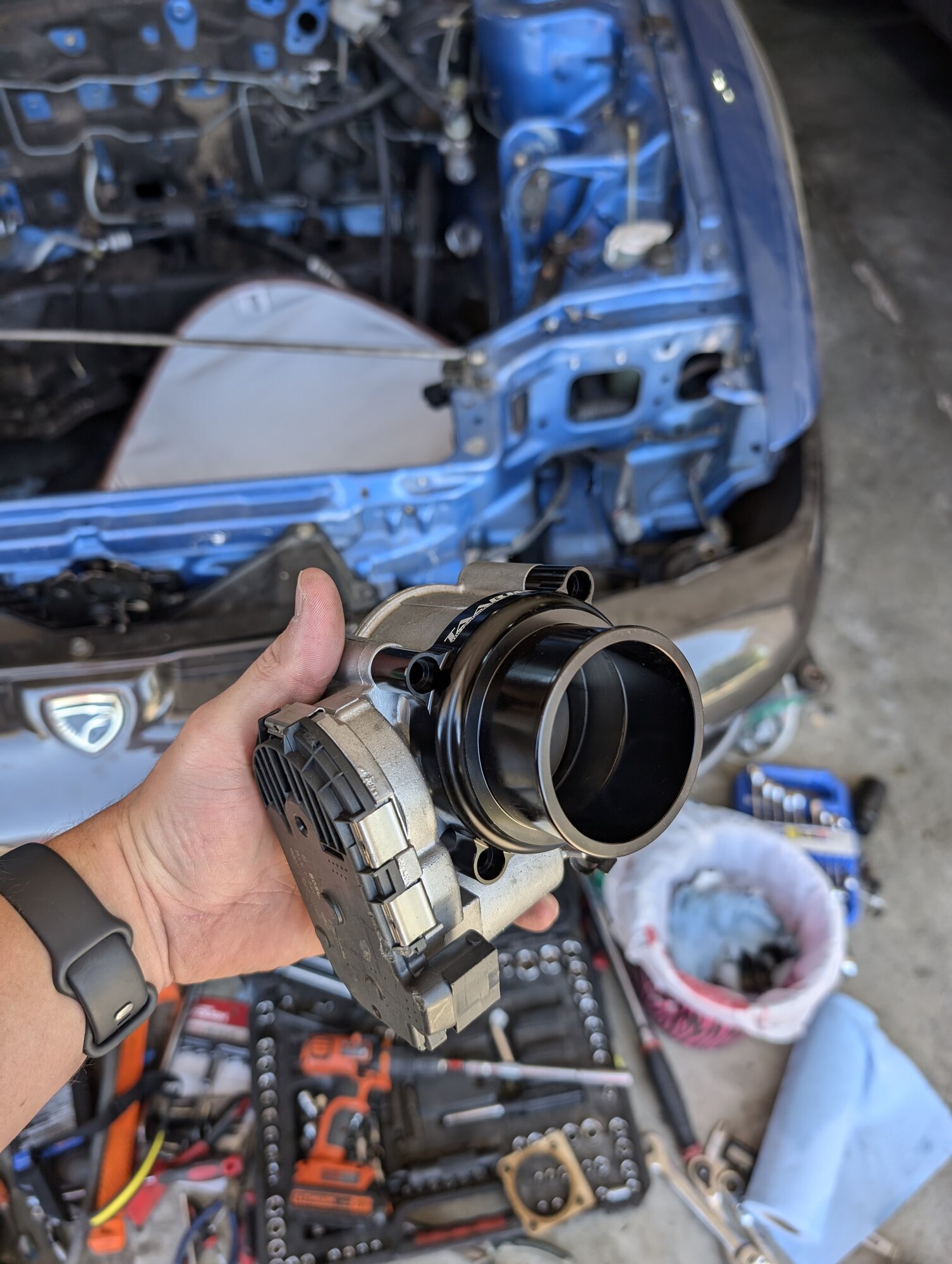

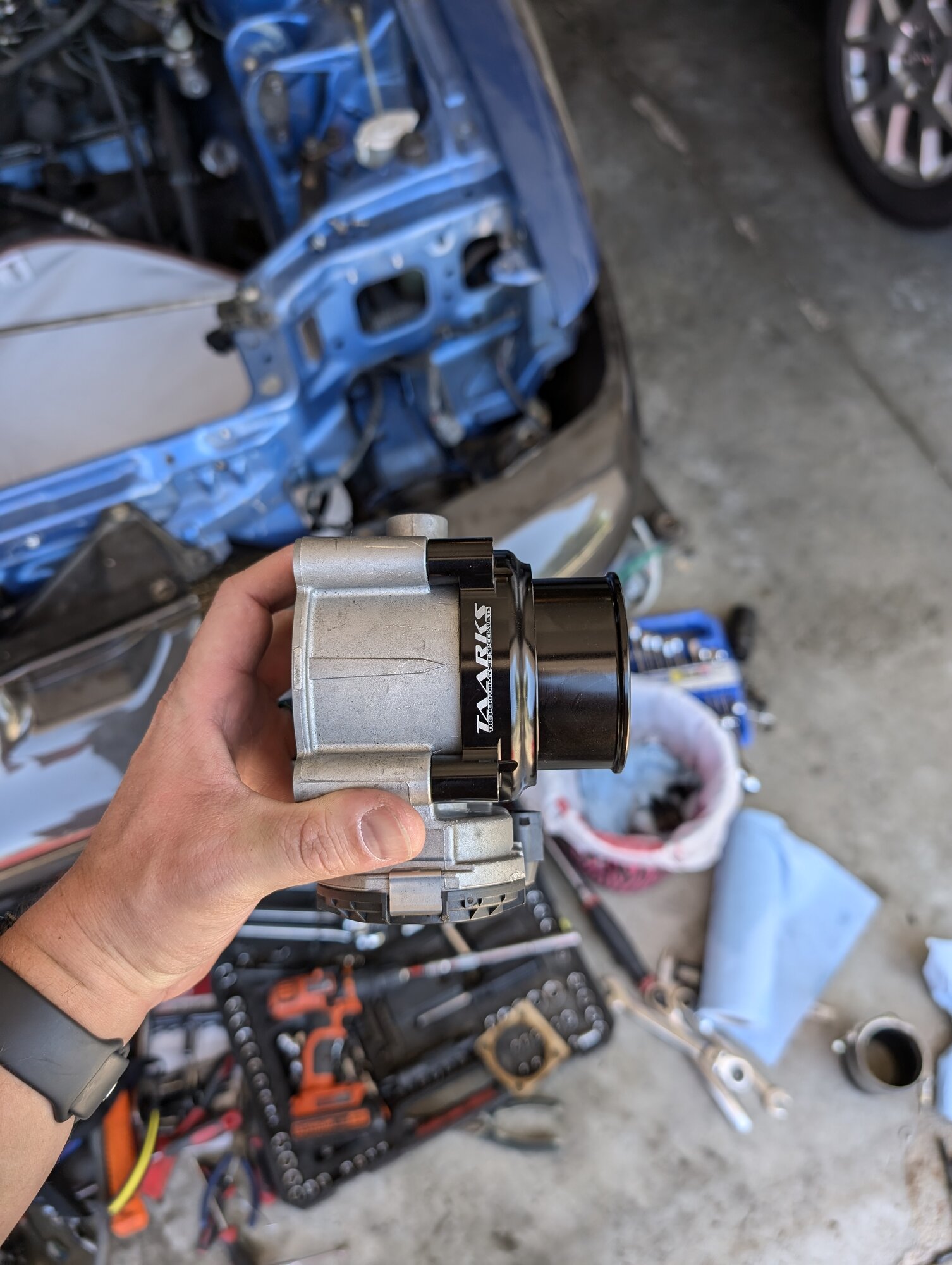

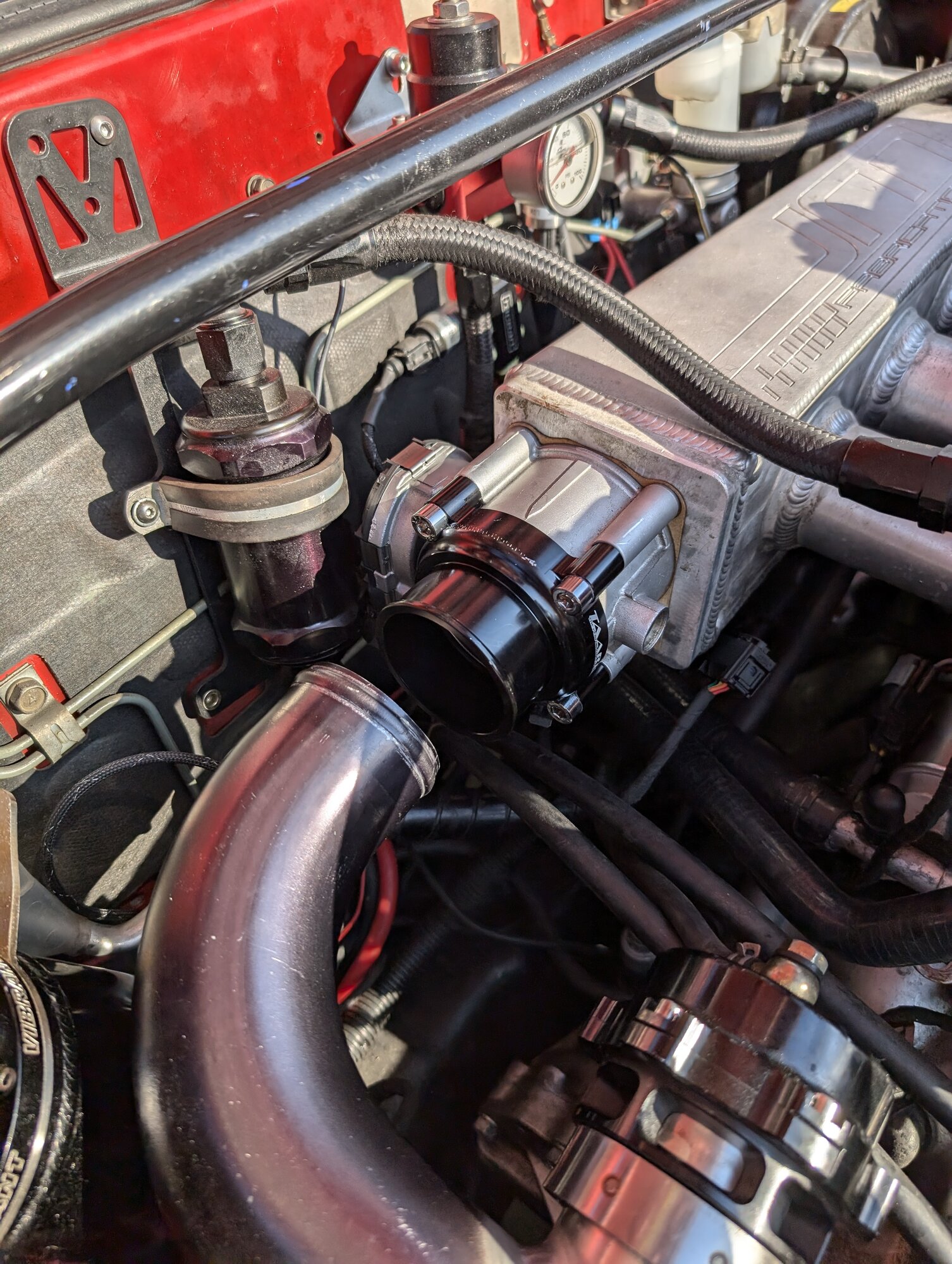

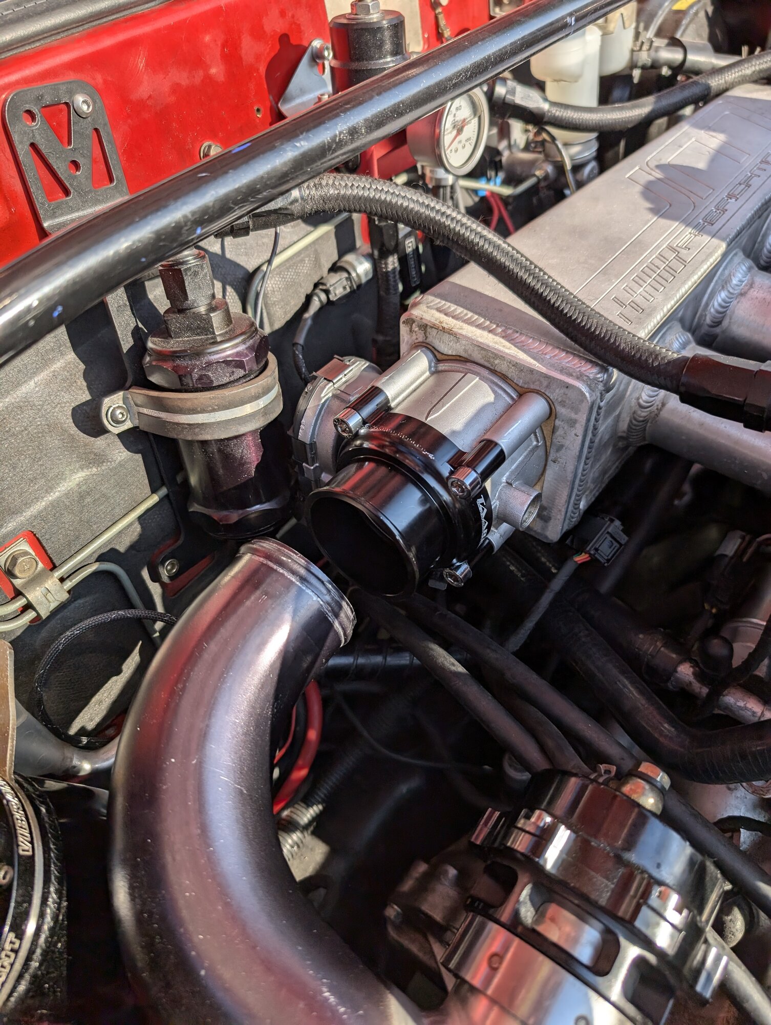

Well it blew off because this is a DBW throttle body and a doesn't actually have a lip for a clamp or anything. It's supposed to be used with HD clamps by the looks of it. Coming soonish
Well car has been decent lately. Driven it to work a couple days last week and gave some buddies a ride. I took a video with my insta 360 but the Audio is absolutely horrendous.
I got my throttle body adapter installed and it's heaps better than that dinky little lip on the throttle body.
