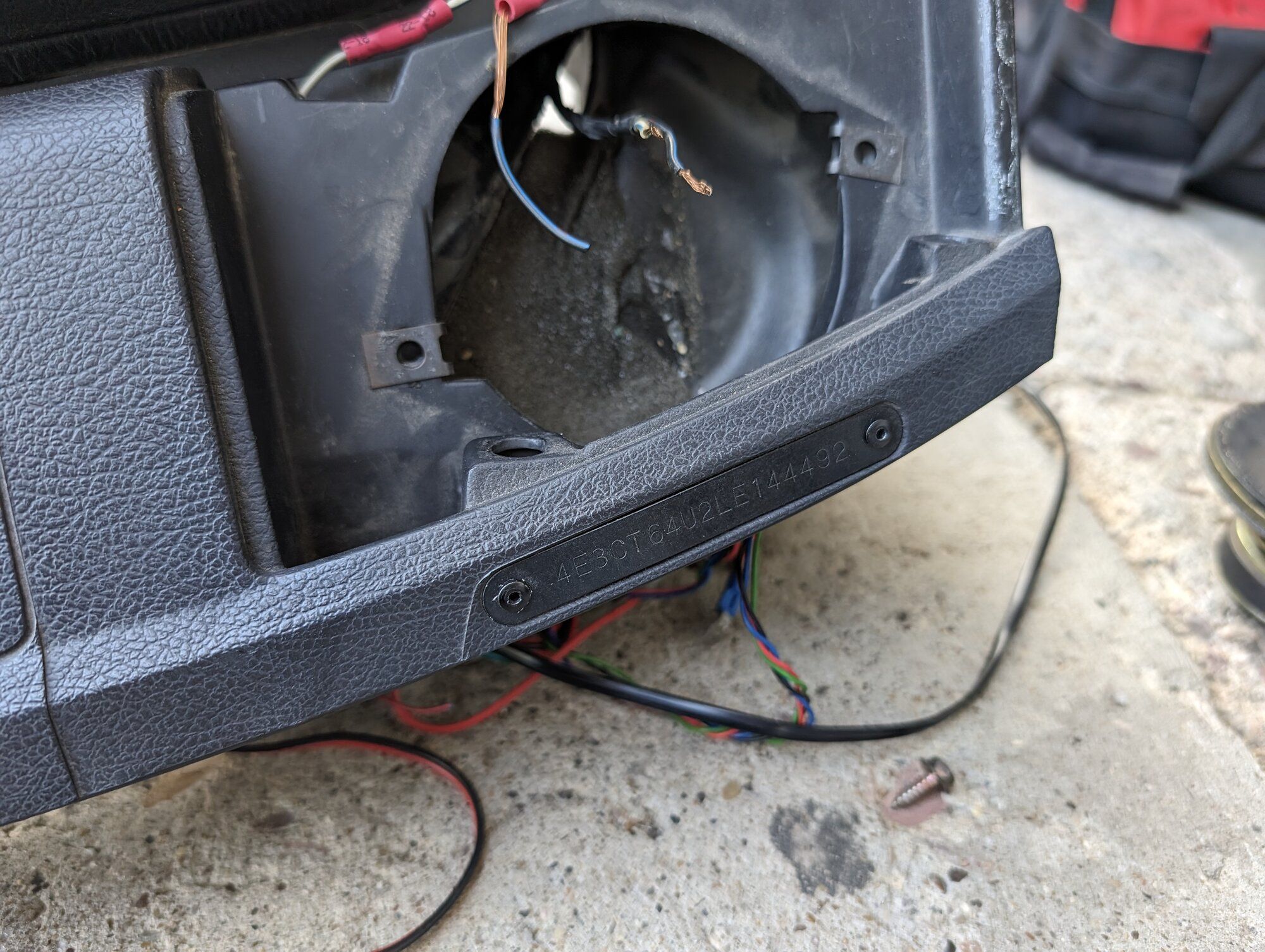

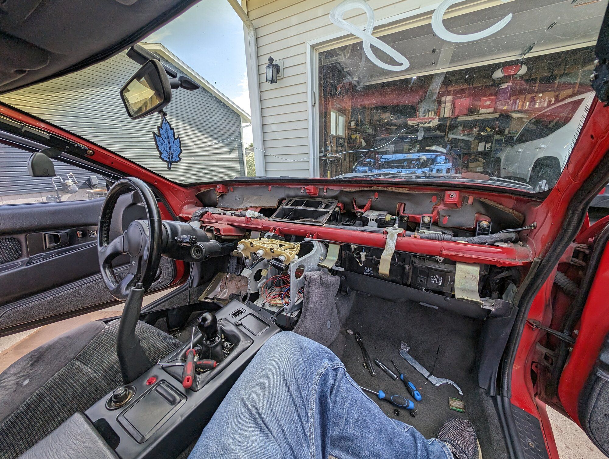

Over the weekend i spent a few hours getting the dash out and swapping the VIN tags on the dash so they actually match the cars they are going in. Riveted the plates back on and painted the rivets black and it looks pretty OEM.

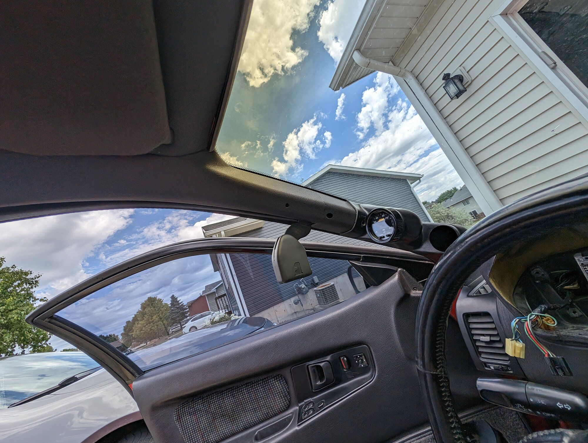

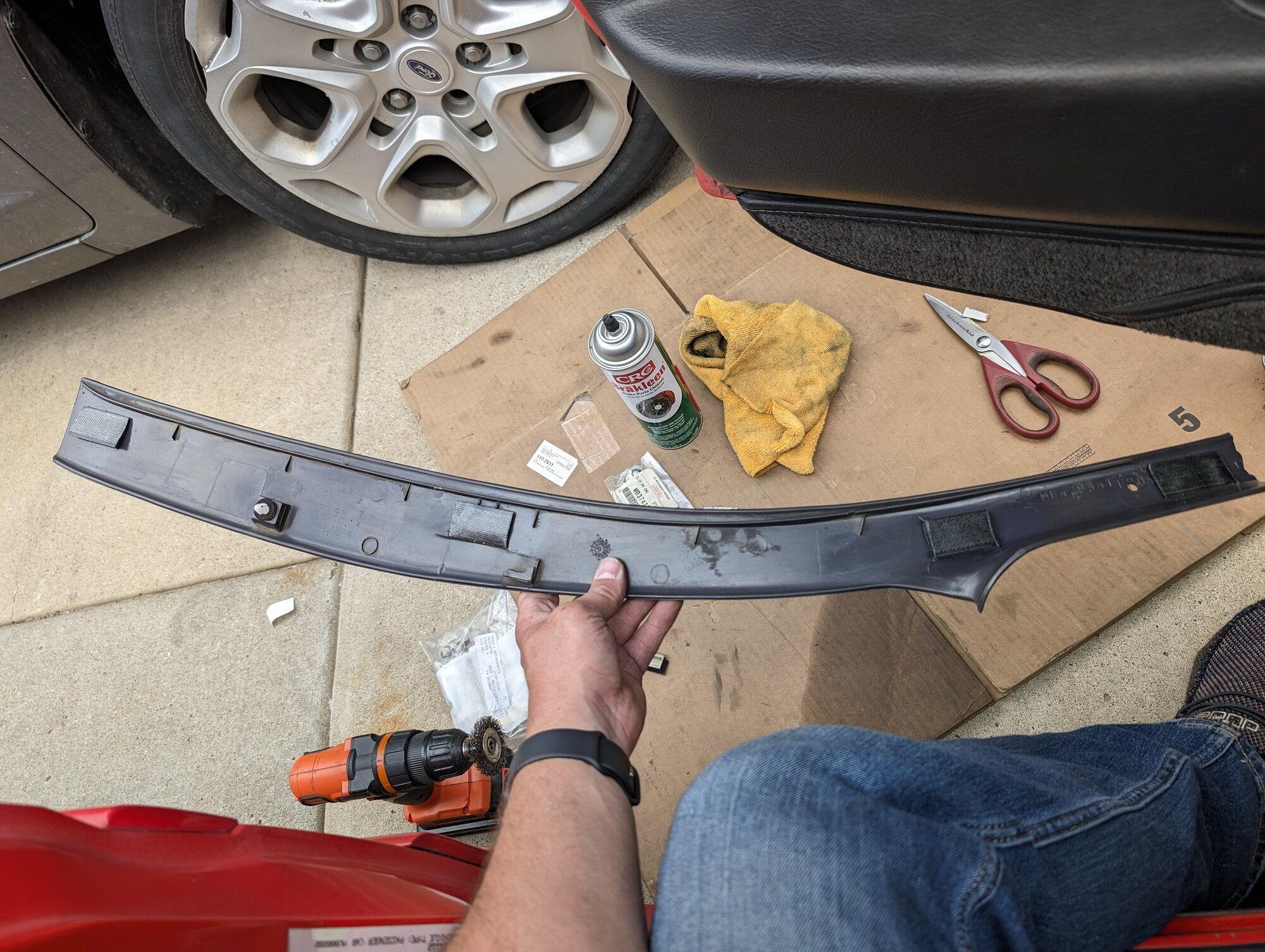

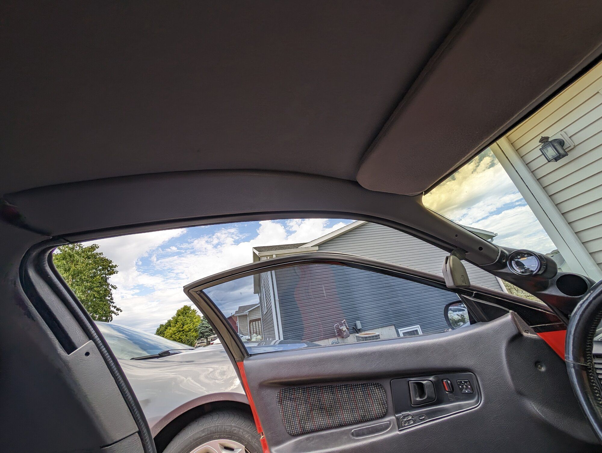

That same day after getting the interior back together i decided to try and fix up my Pillar covers a bit and see if i could get them to actually stay on the pillars. I ended up using some sticky velcro and adhesive promoter or Fuser. The driver side held up great but the passenger side didnt have any clips left on the trim so the velcro actually separated from the adhesive on the backside on the passenger side and fell down again.

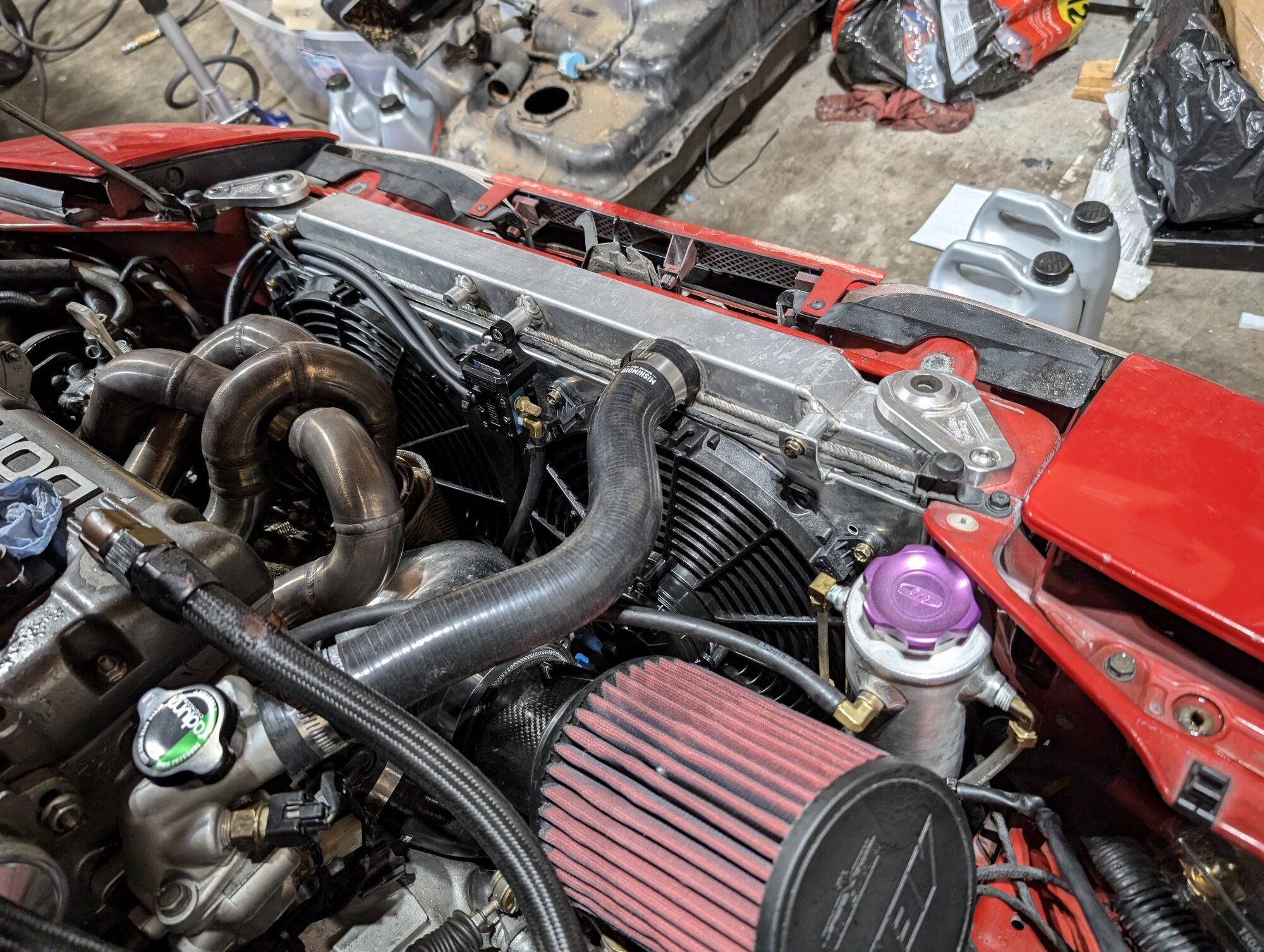

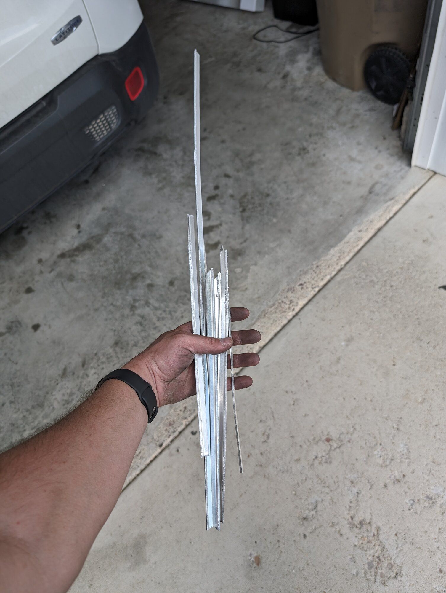

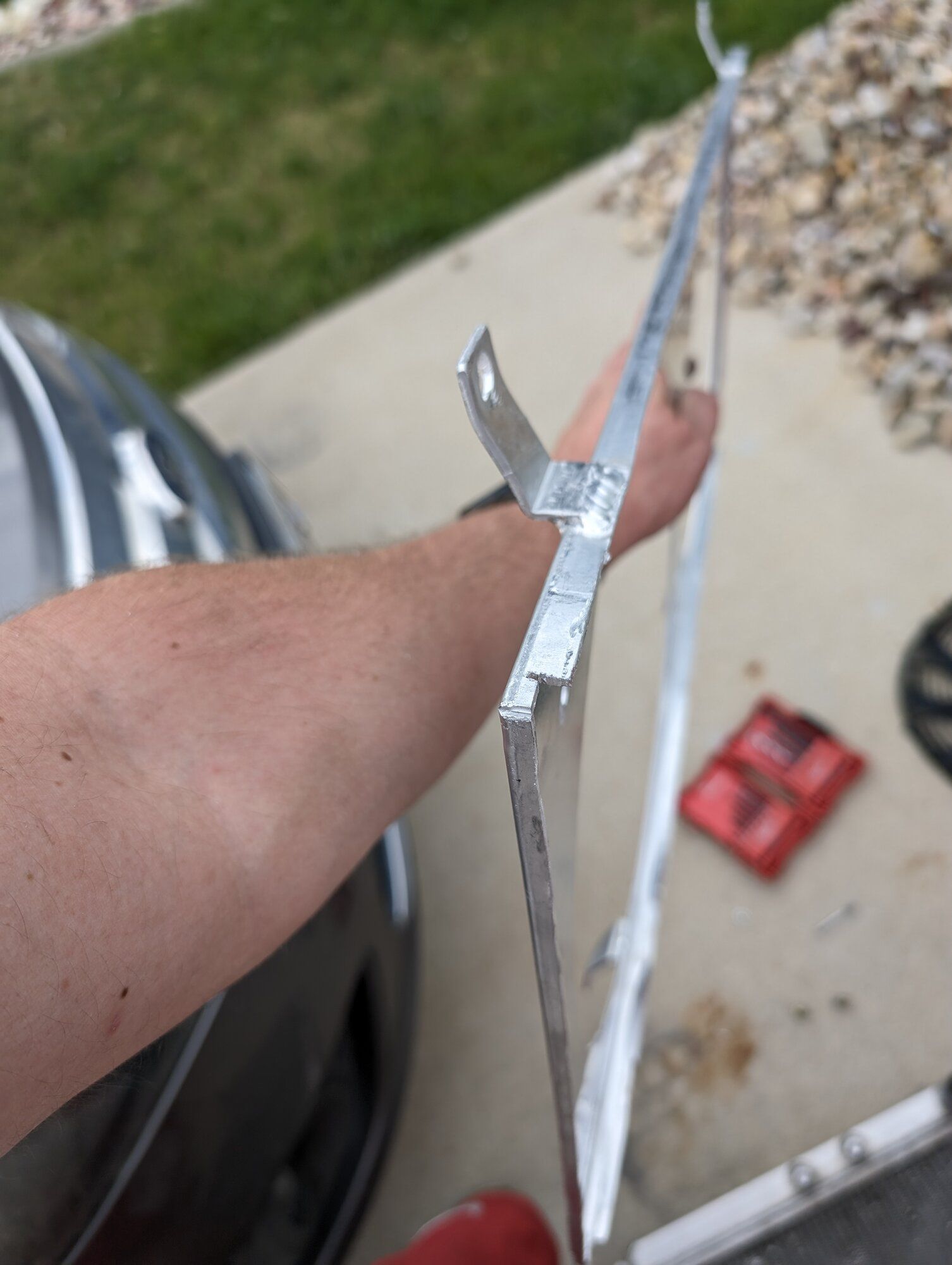

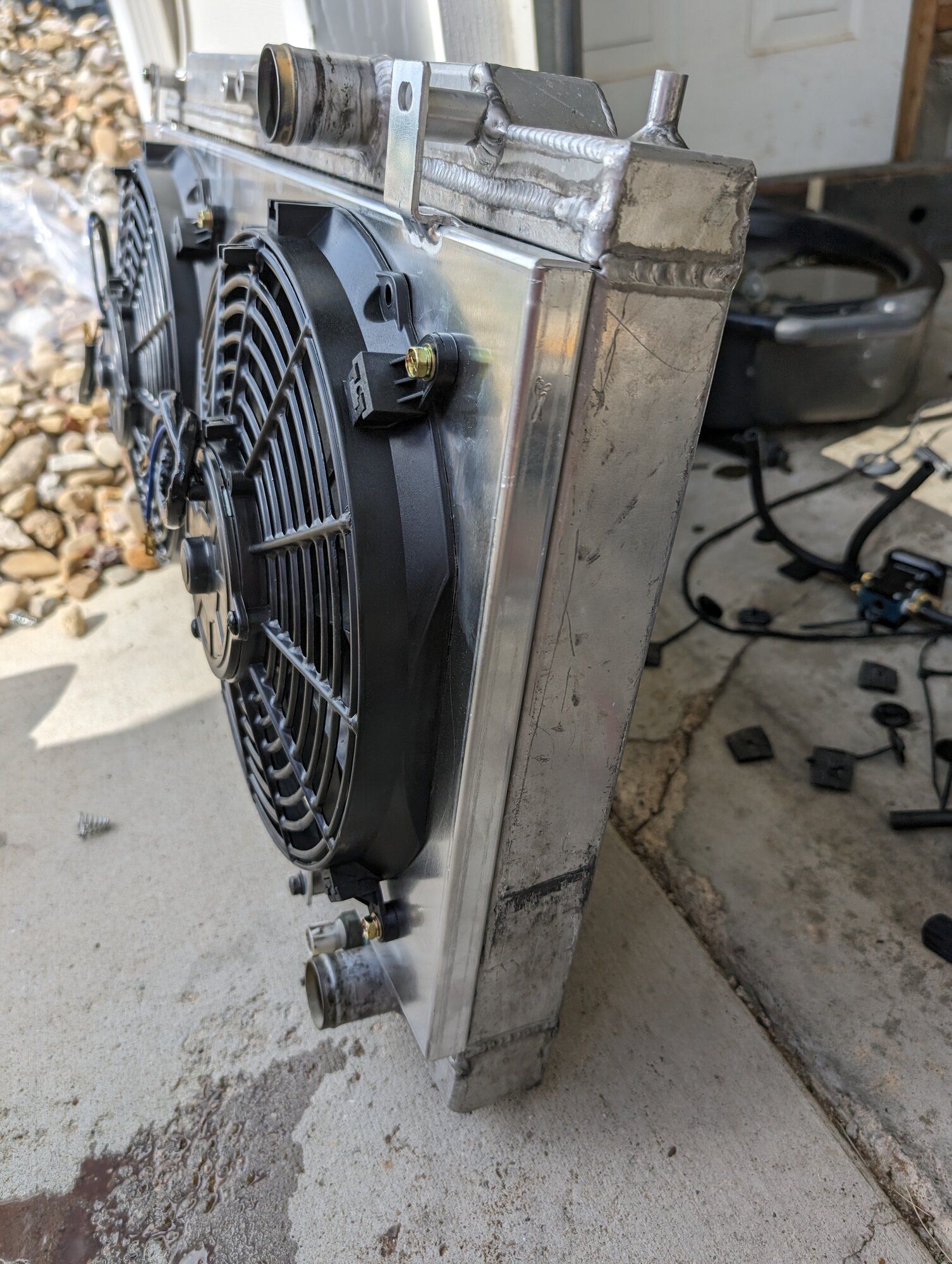

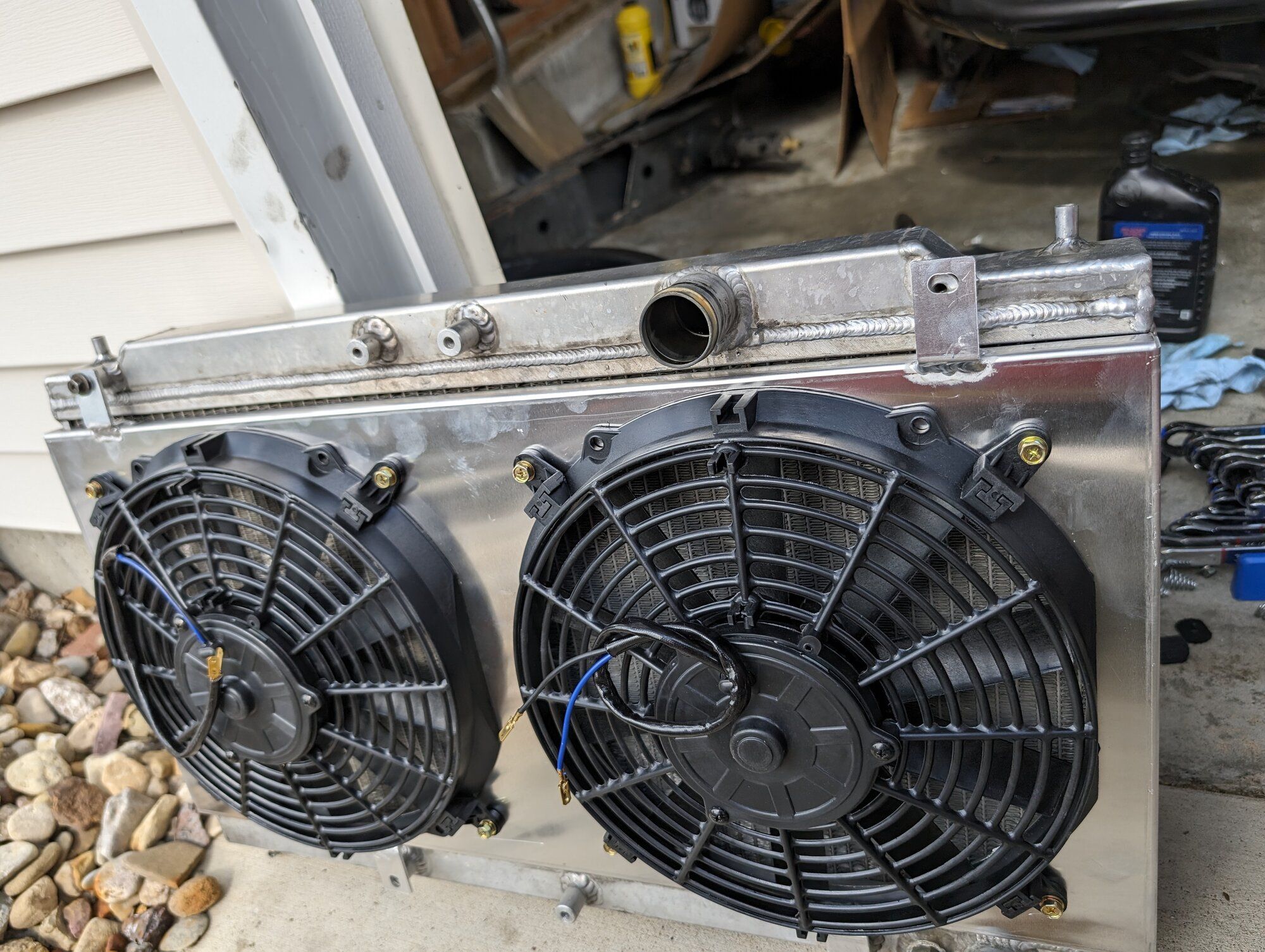

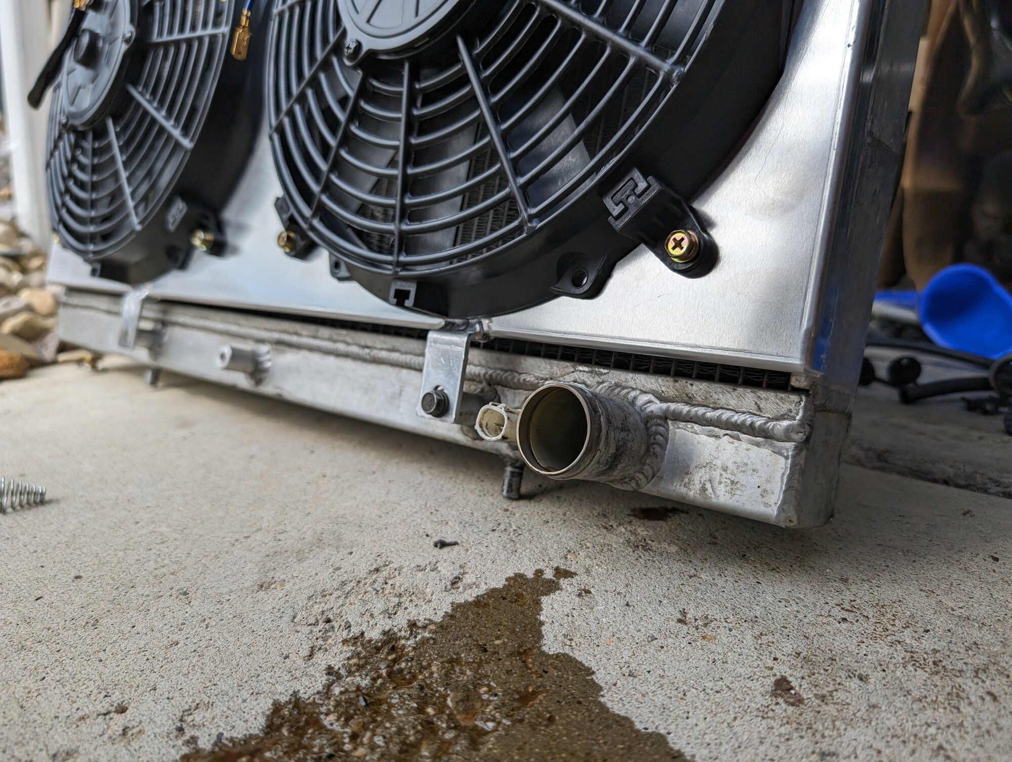

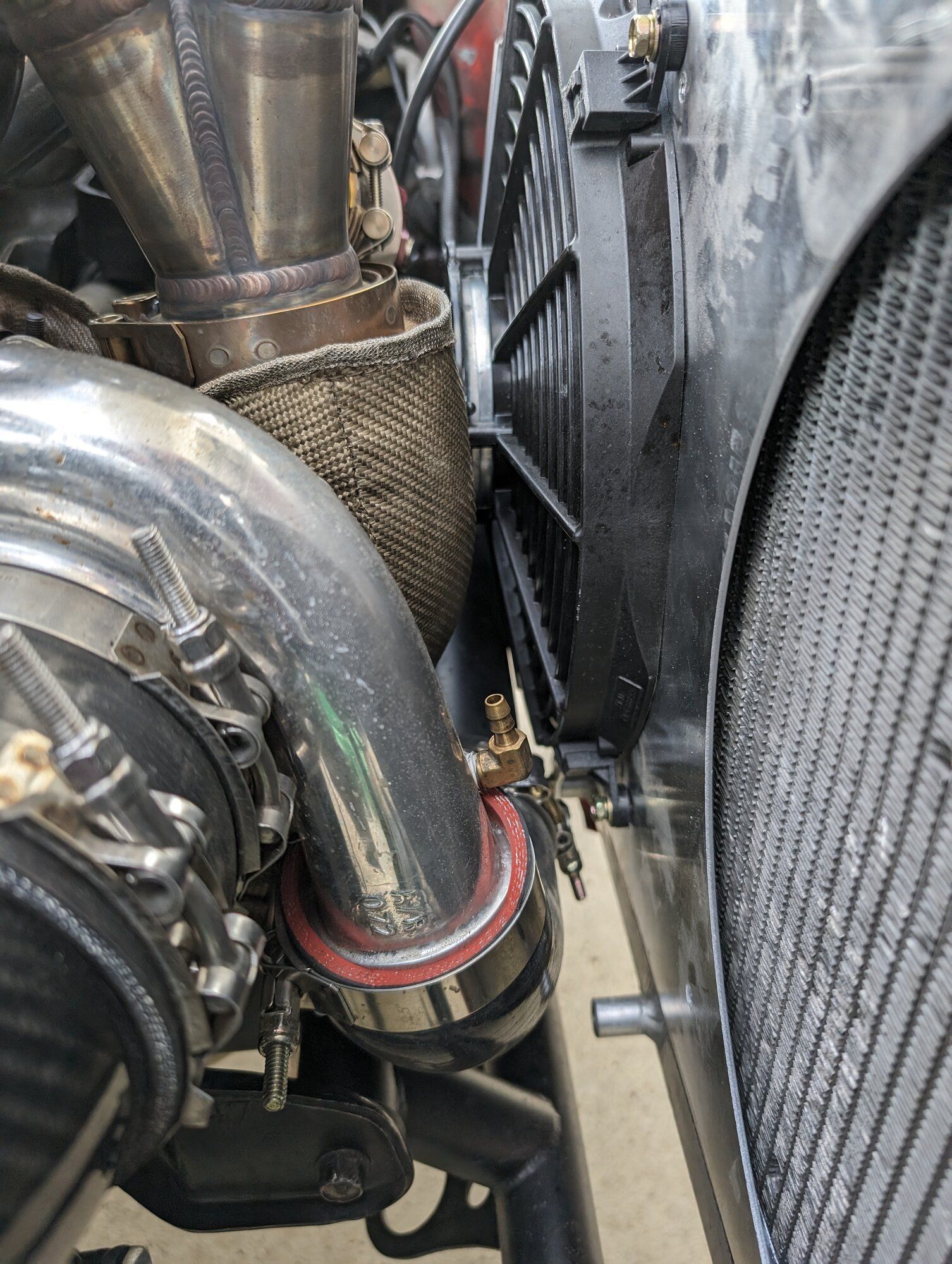

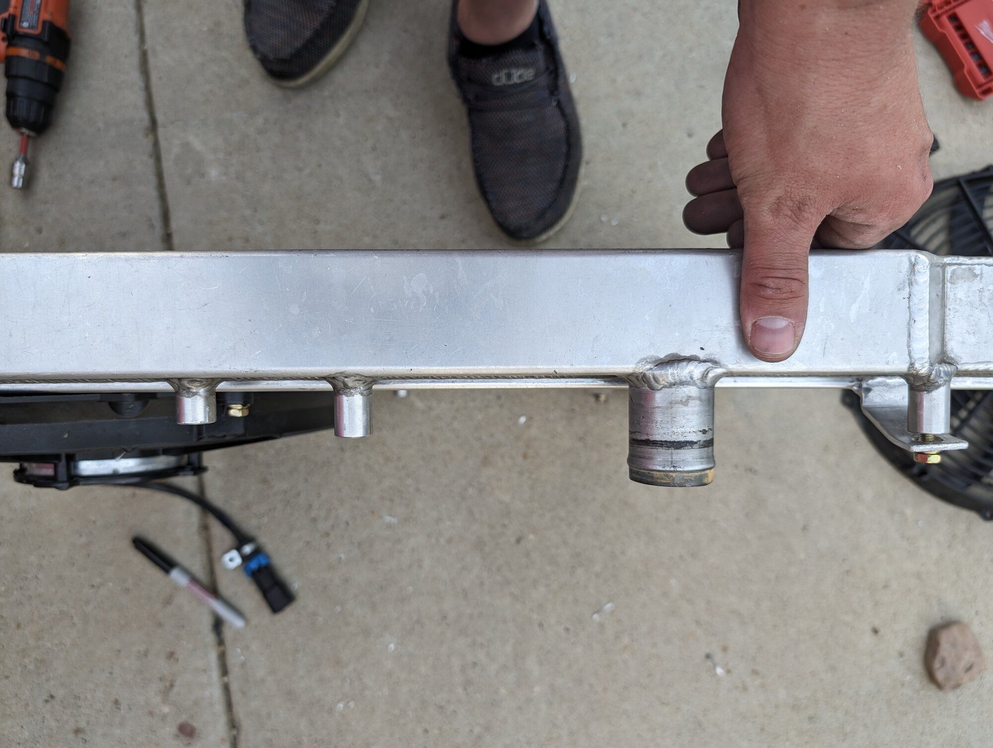

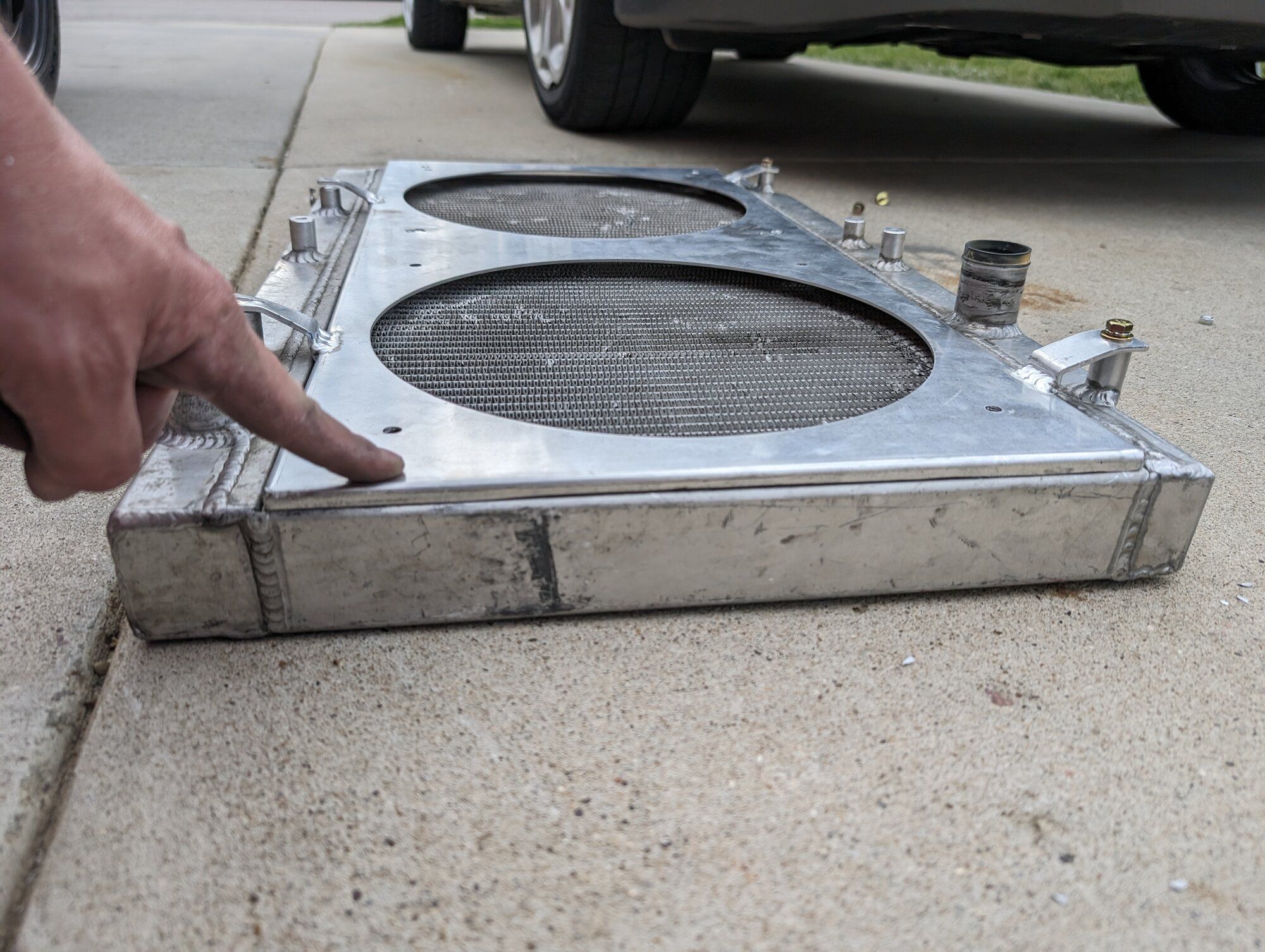

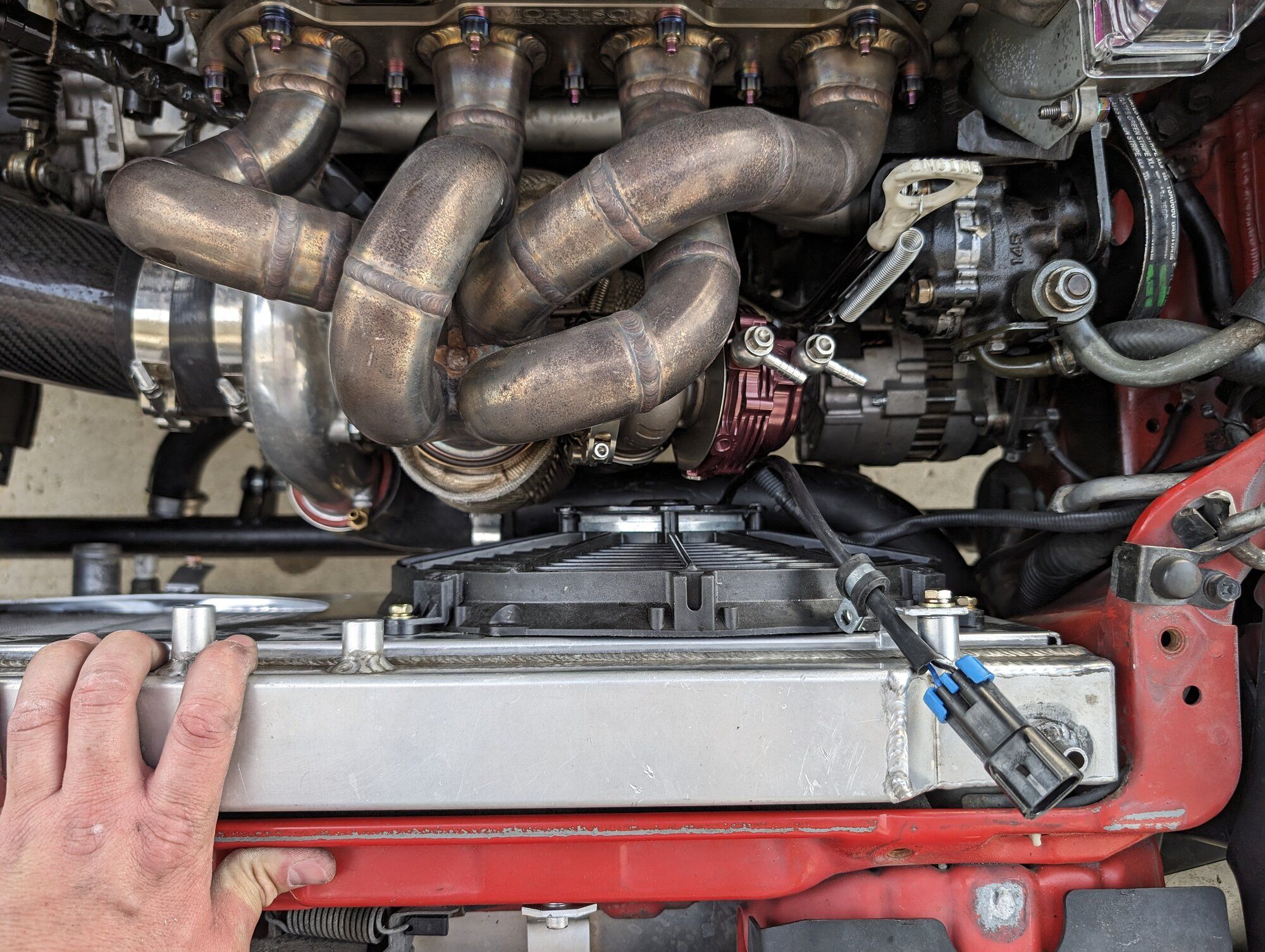

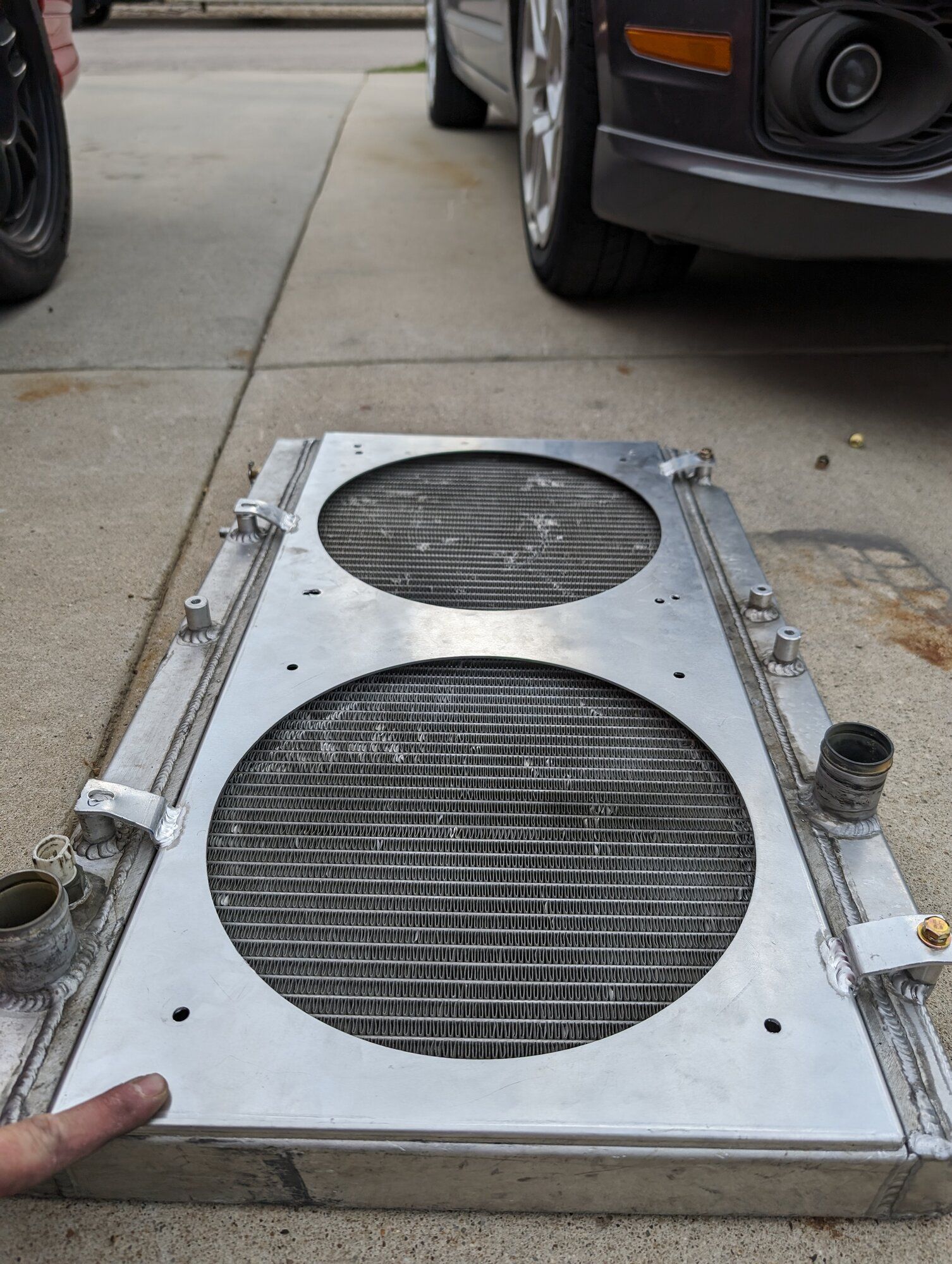

Last night i decided it was time to try and tackle some cooling woes with the radiator. I have that ebay radiator shroud sitting around and got around to making that fit. Big issue with these shrouds is that they just sit on top of the radiator and not on the inside, so they end up adding a few inches overall. I did a bunch of test fits and ended up trimming mine down quite a bit and it sits inside the radiator and seals off the sides quite nice. Only one of my fans fits as the other is way too big being a 13". Ive ordered up another 12" fan to get installed to replace the bigger guy.
pretty please with how this turned out. Id wager that by having the shroud you gain about 20% of cooling when the fans come on that you lost by mounting the fans right to the rad with all the area between and around the fans.
Before:
After:

I think ill probably take care of the exhaust heat shield next, and then i think ill focus on making some ducting for the intercooler/radiator.
Well the fan shroud seems to work pretty well. it seems to knock the temps down really quick when the fans come on so ill take that as a win. Going to try and make some ducting for the FMIC/Radiator next i think.
Unfortunately my 3m velcro setup for the Pillar trims failed but not in the areas that i thought they would have. The double sided tape actually peeled off the back of the velcro sheets LOL Everywhere that i sprayed adhesive promoter its still super solid.

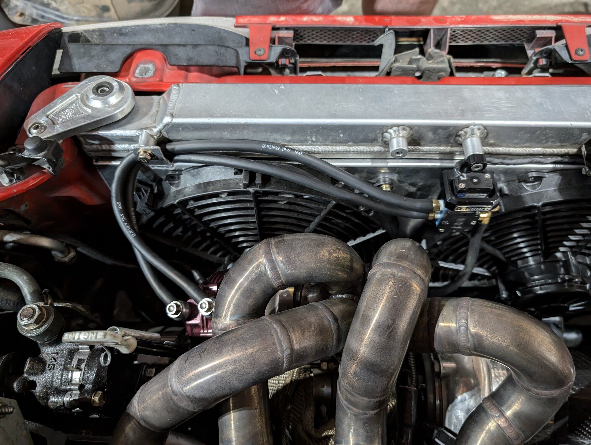

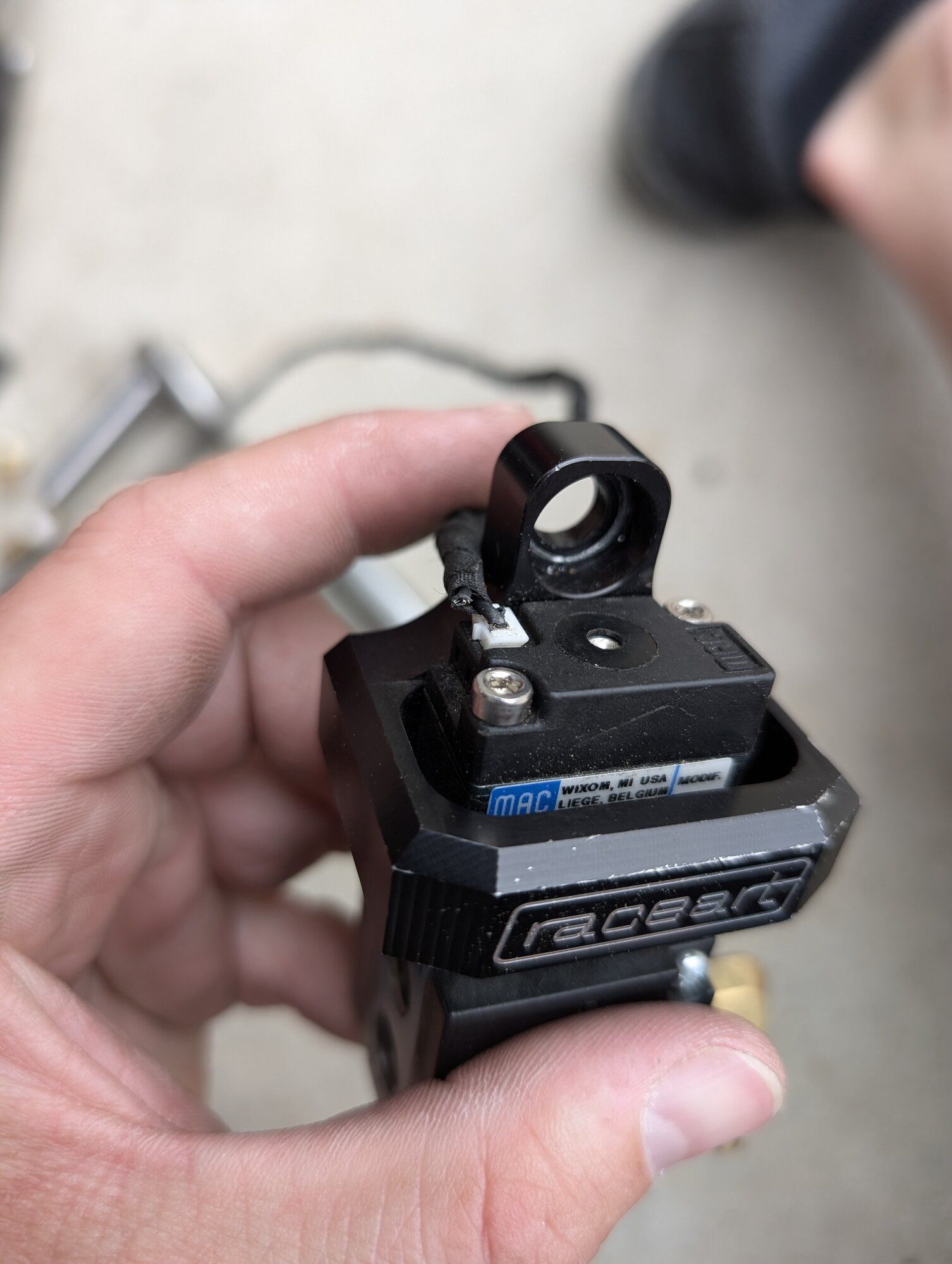

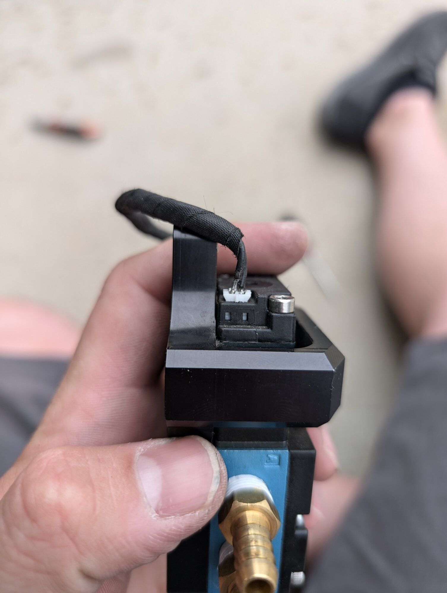

Installing the fan shroud made me have to move my EBCS to the middle of the radiator, so i had to run some new lines. When I was re-doing the barb fittings on the boost controller i noticed that the little pigtail coming out of the boost controller was broken, one of the wires was completely separated and only held together by the insulation of the wire. I pulled the little connector our and depinned it and then pulled both wires off the terminals, stripped and soldered the end of the wires to the terminals, and stuck it back in. It SEEMS to have worked... either that or the car is on FULL SEND keeping the wastegate closed. This is a temp fix as i try to find a new little pigtail for them.

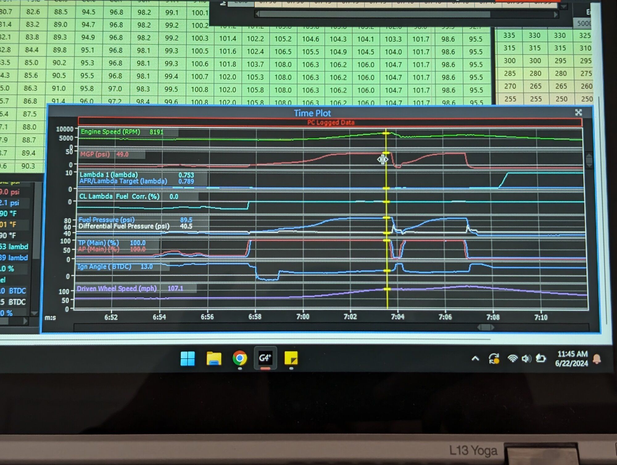

I went out for a drive and the car saw 49 PSI again which is absolutely rowdy if you havent experienced that. 10/10 would recommend. Probably a bit high for that turbo. Zach and i are thinking of turning on closed loop to keep it around that 45 psi range.
i did another 60-130 pull and just at the end of the pull the car lost MPI power and shut off and i ended up coasting to a stop on the side of the road. Turns the fuses inside the fancy aftermarket fuse box thing i have rattled loose which includes the ignition and MPI relay fuses. Got those shoved back in and car fired up and i drove it home.

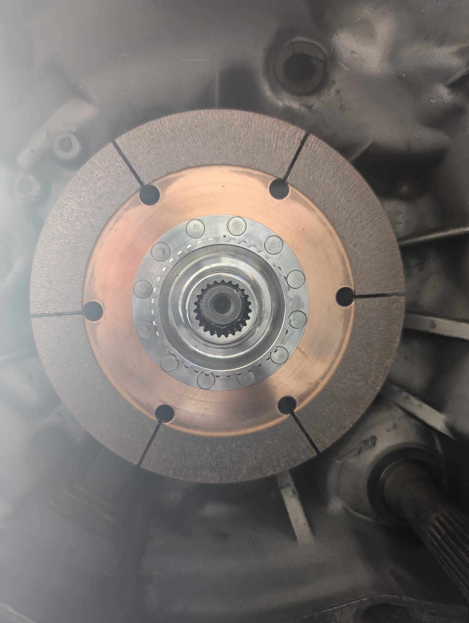

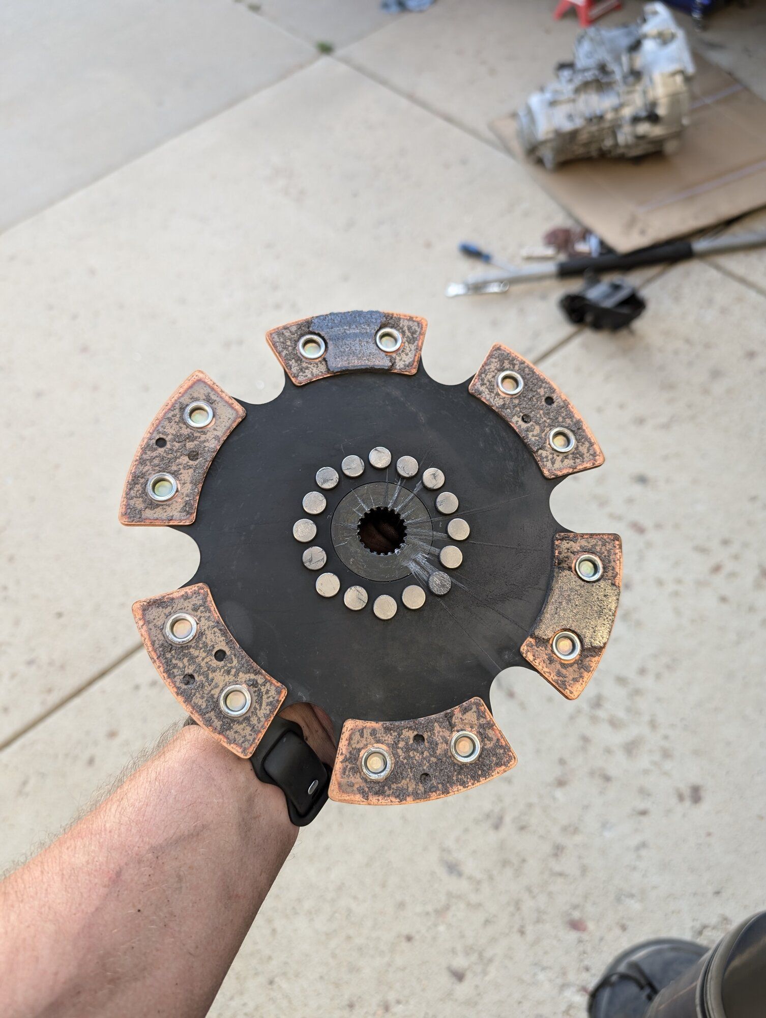

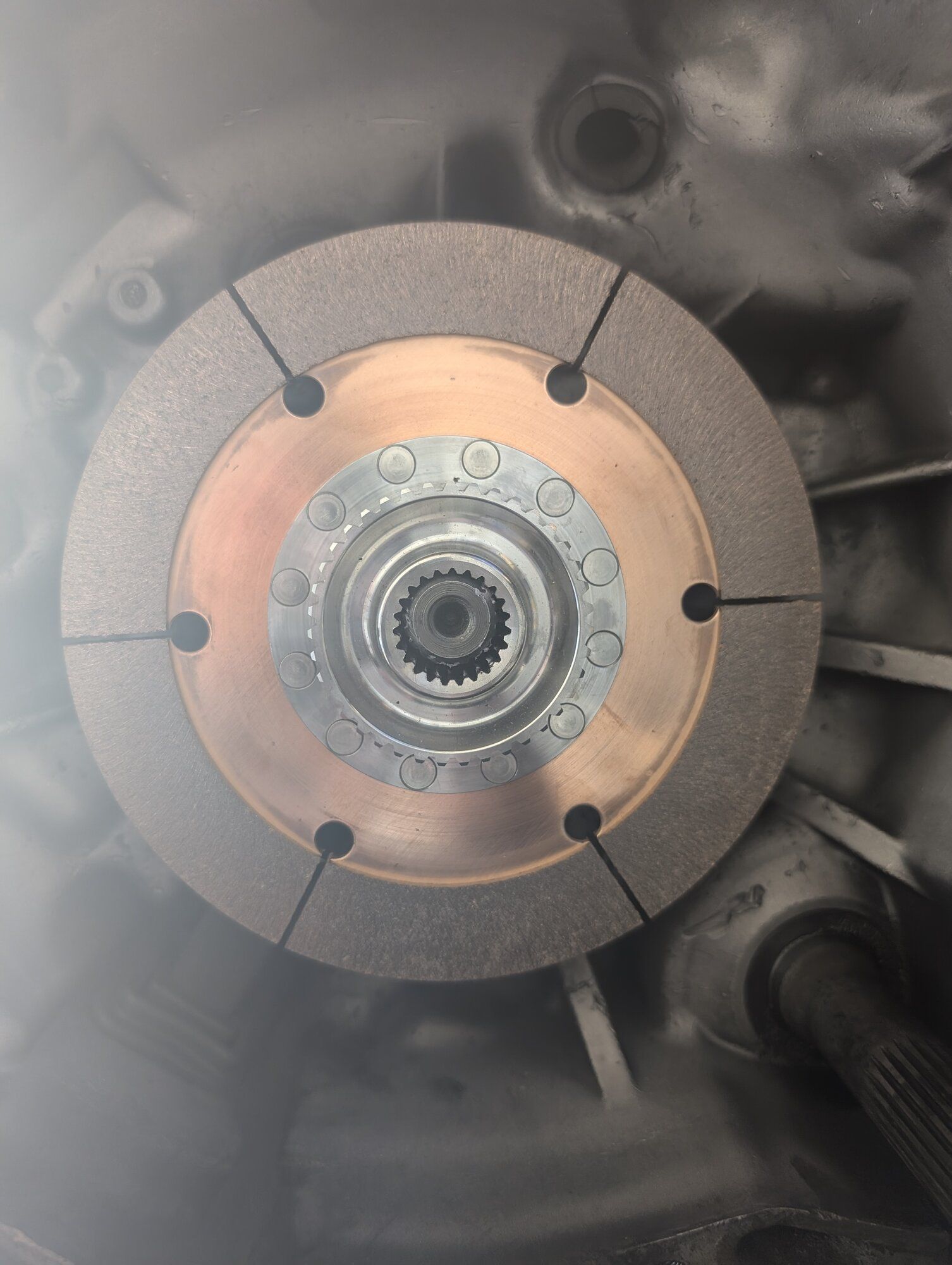

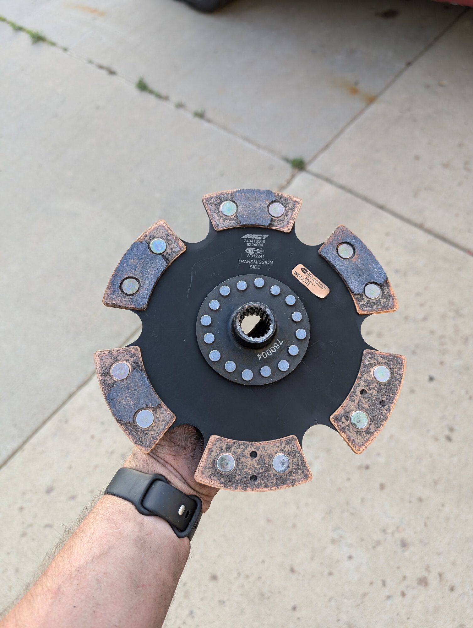

clutch disk Yeeted again... Now the disk FULLY grabs about 1" off the floor and it shutters the car so hard just like the last disk did pedal feel is all sorts of goofy again too.

Well, confirmed.
The latest 6 puck disk has exited stage right.

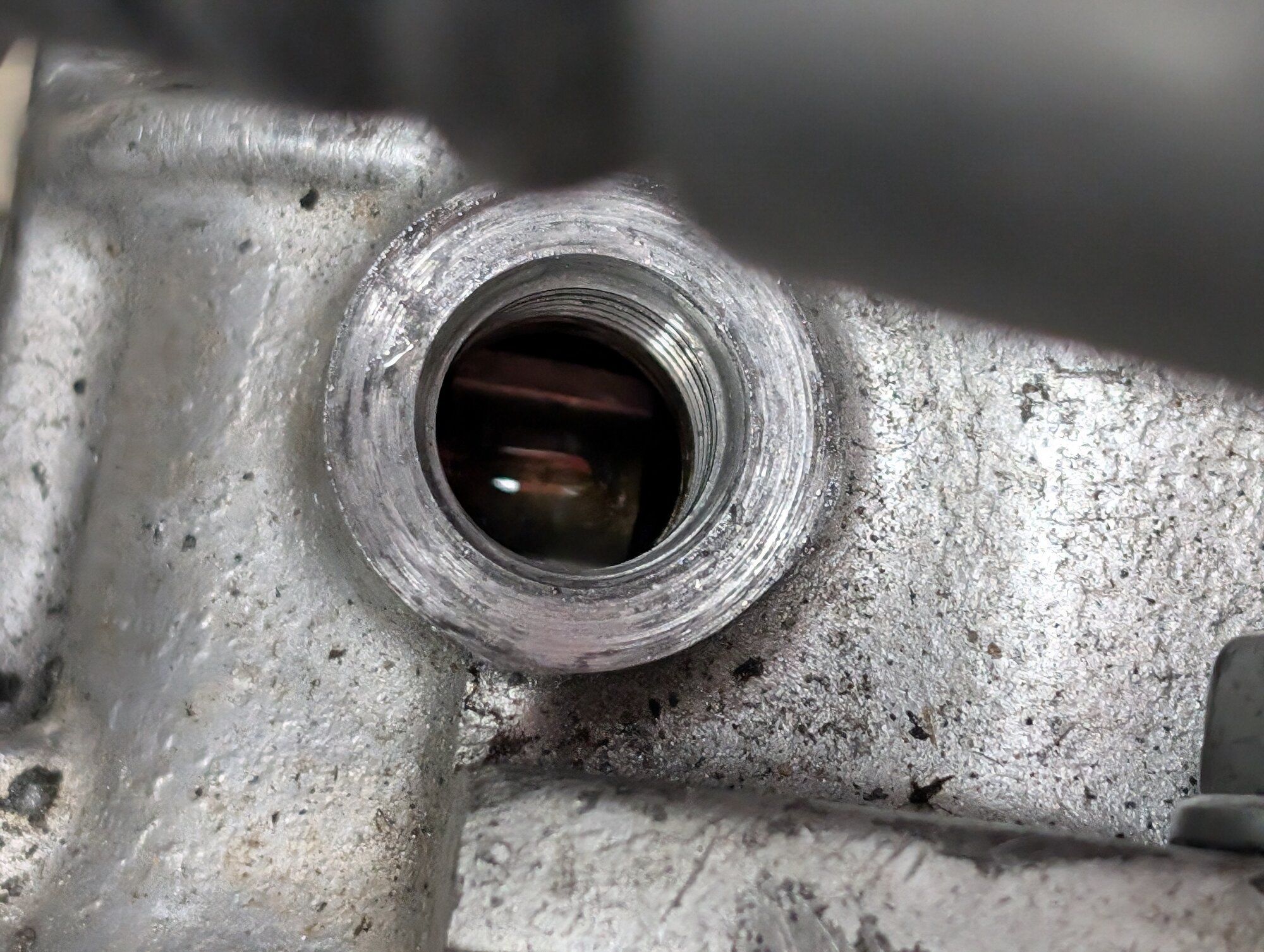

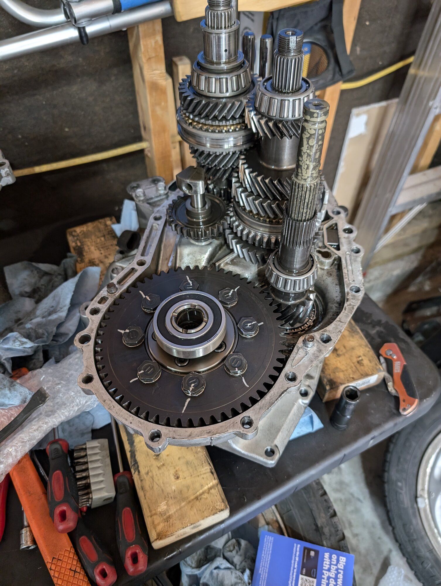

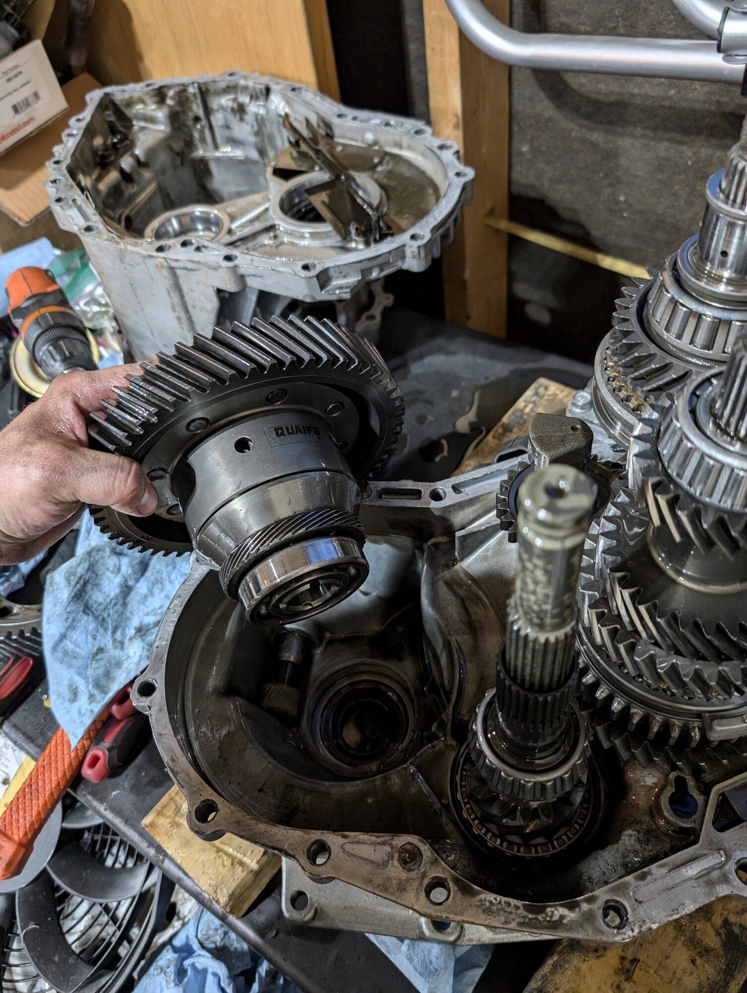

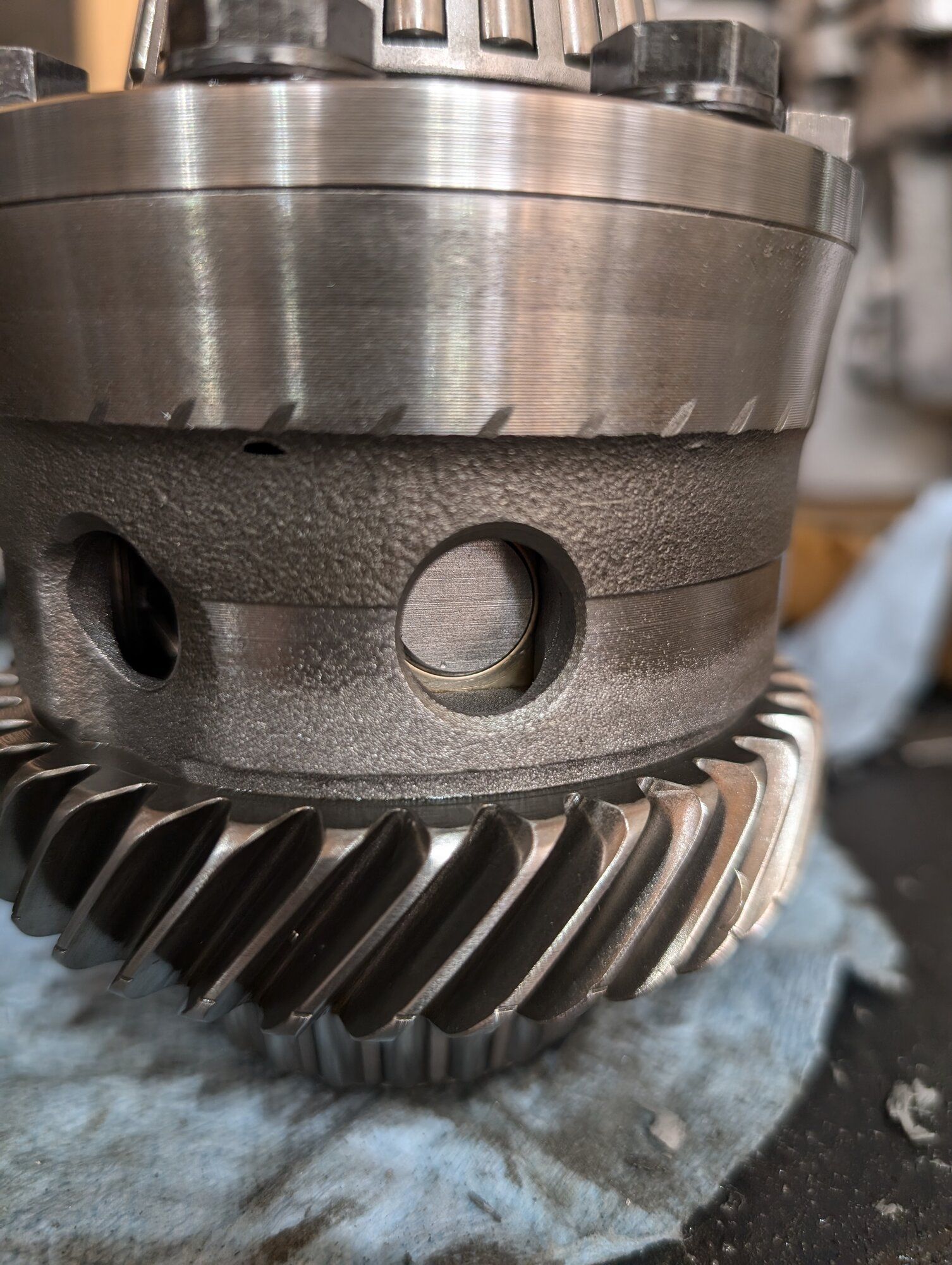

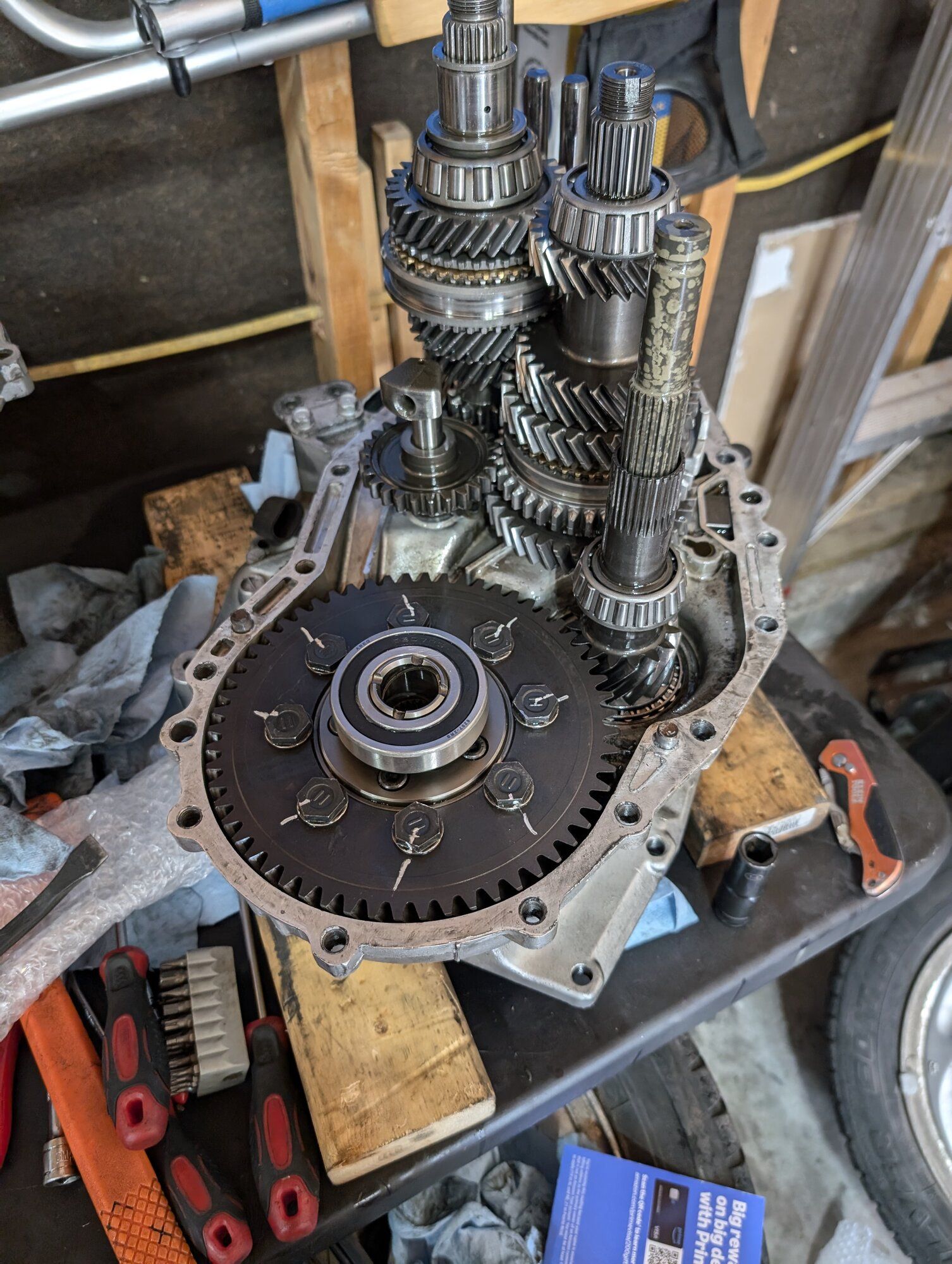

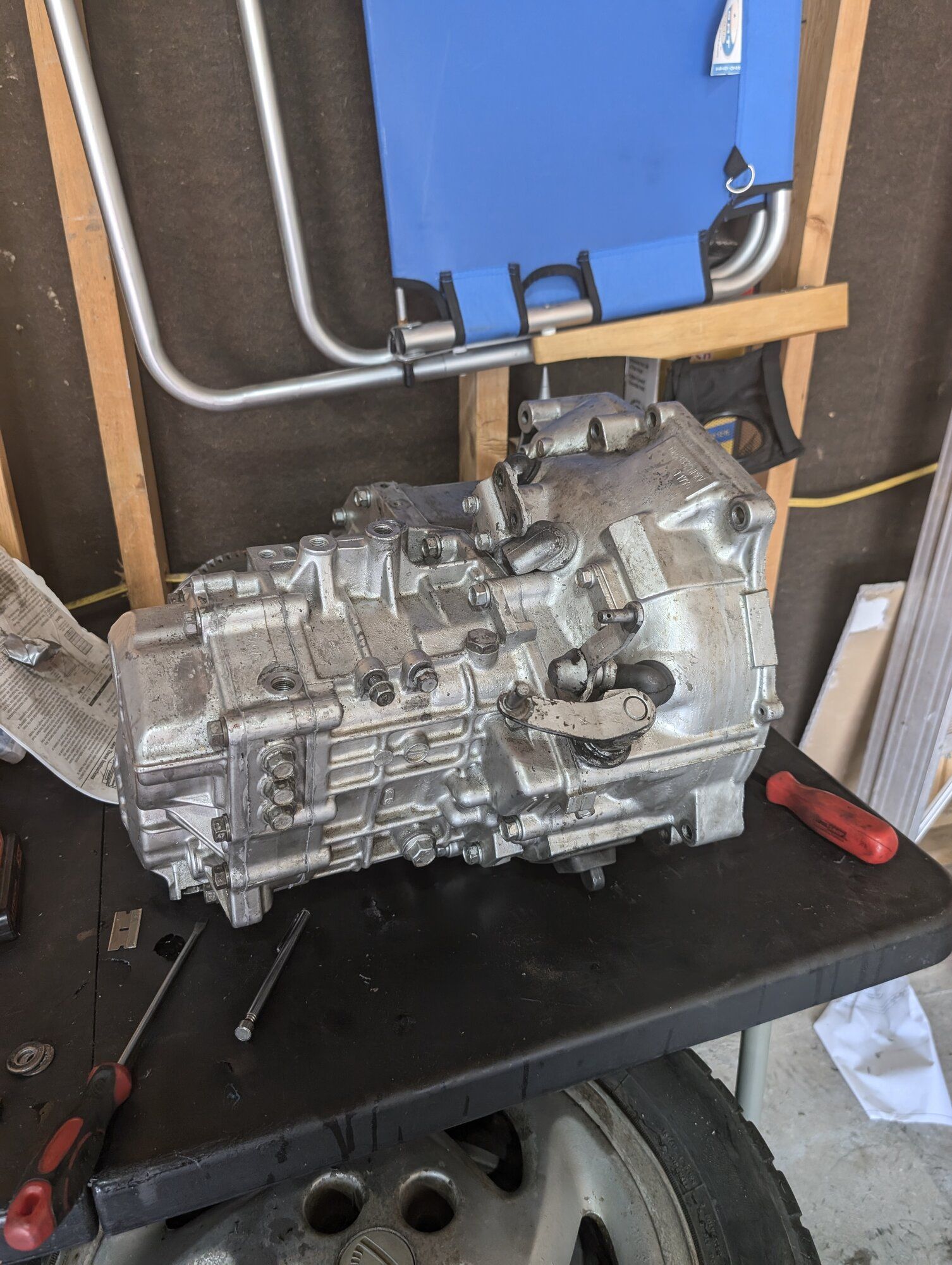

Got the trans out last night and pulled apart, center diff, cross shaft, Torrington bearing, and spider gears being sent to TRE today after work.
Quaife front diff test fitted with my ring gear, new bearings for that should be here today also.
Those puck clutch disks are terrible as far as longevity goes. I used both the unsprung 4 puck and unsprung 6 puck and both were falling apart within 1000 miles. They will hold a ton of power, just not for too long LOL.
I switched to a solid street disk and so far I'm in love. The driveability is great and I know the friction surface will actually last. And since I'm steering away from the drag race scene I care much less about the high end shifts than I have before.

My 6 puck had less than 400 miles on it, one summer of street driving. I literally did less than 10 pulls(35-40 psi) and not a single launch. When I pulled it, some pucks were missing chunks and just falling apart. It blew my mind because I never really put the power to it.

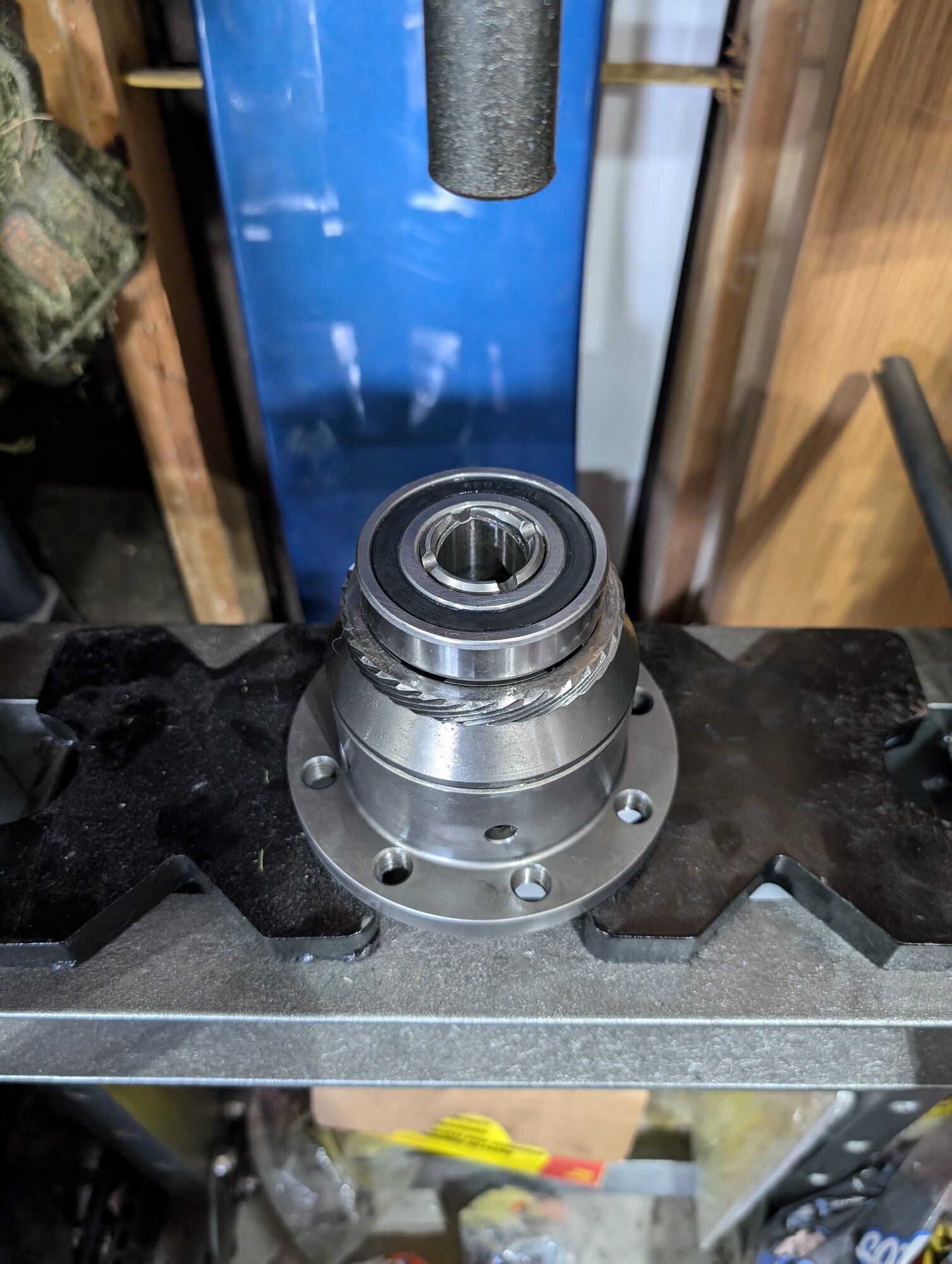

Figured I'd give an update.

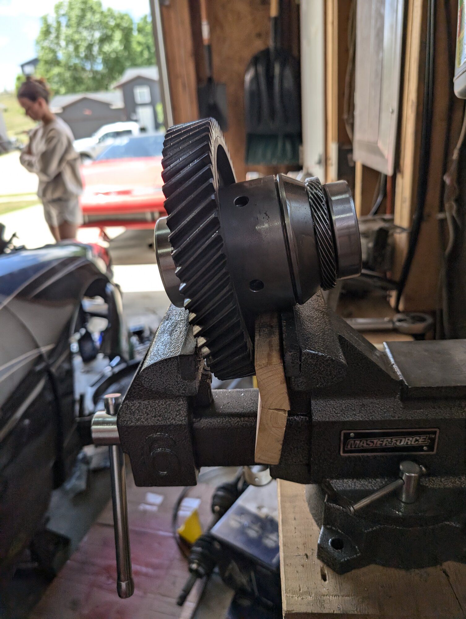

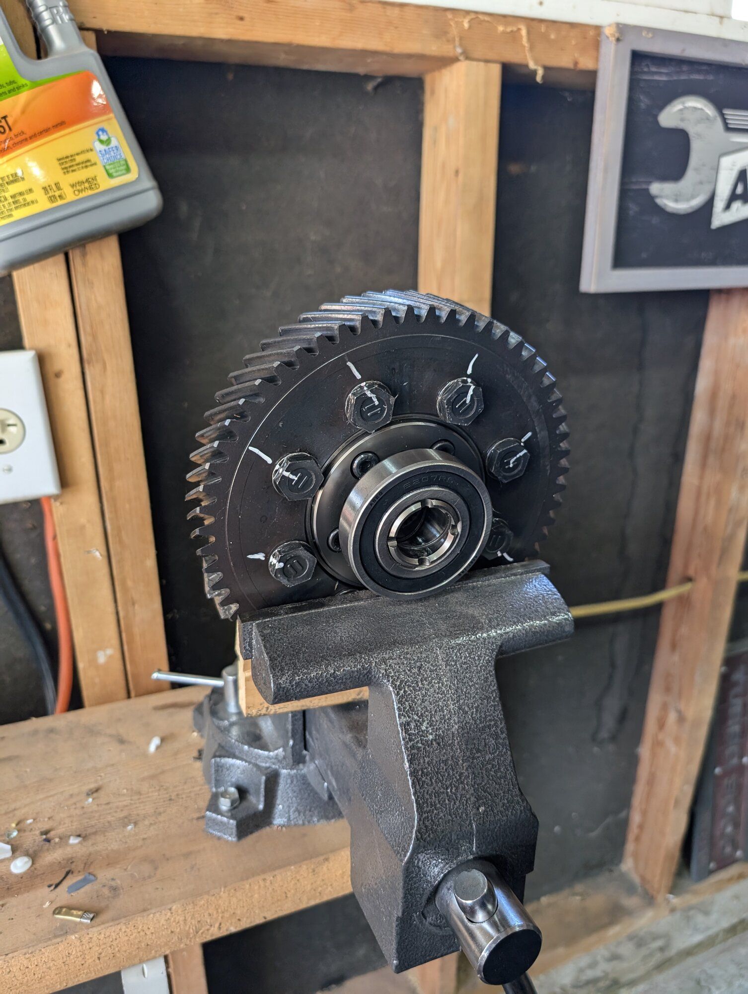

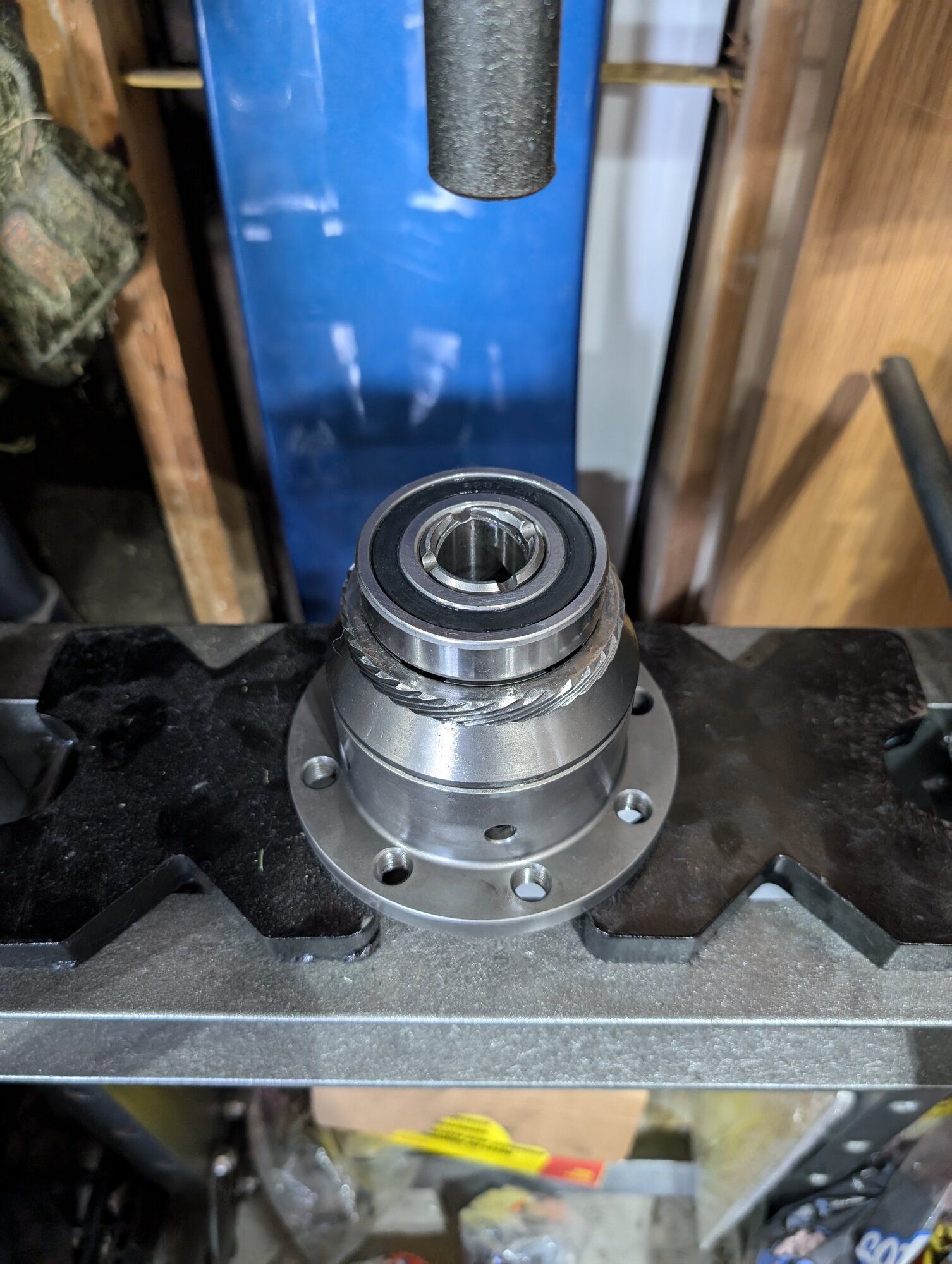

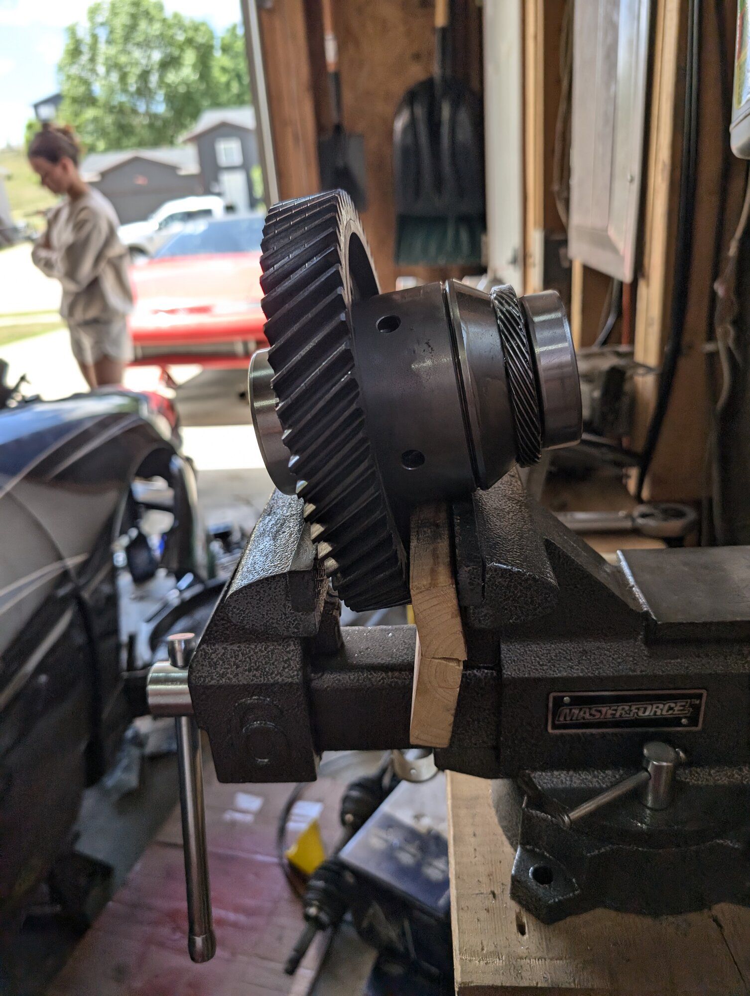

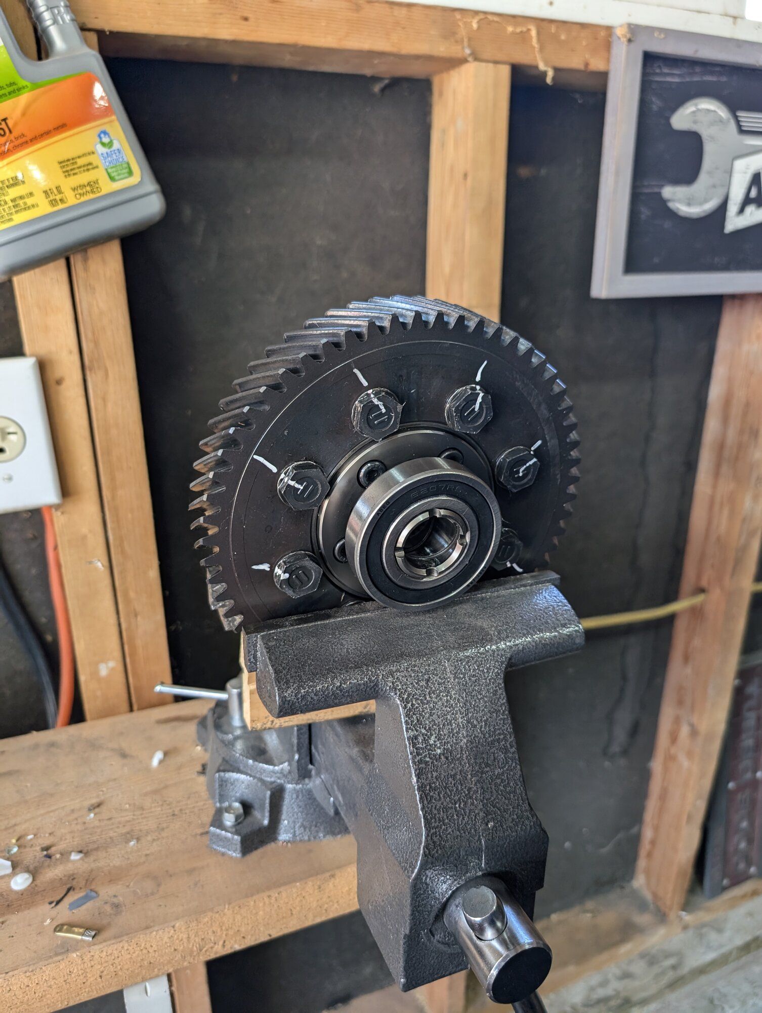

Got the front diff fully swapped in with my ring gear swapped, both new bearings on and all bolts torqued down to 100ft ft/lbs with red locktite. Hopefully I don't regret that LOL

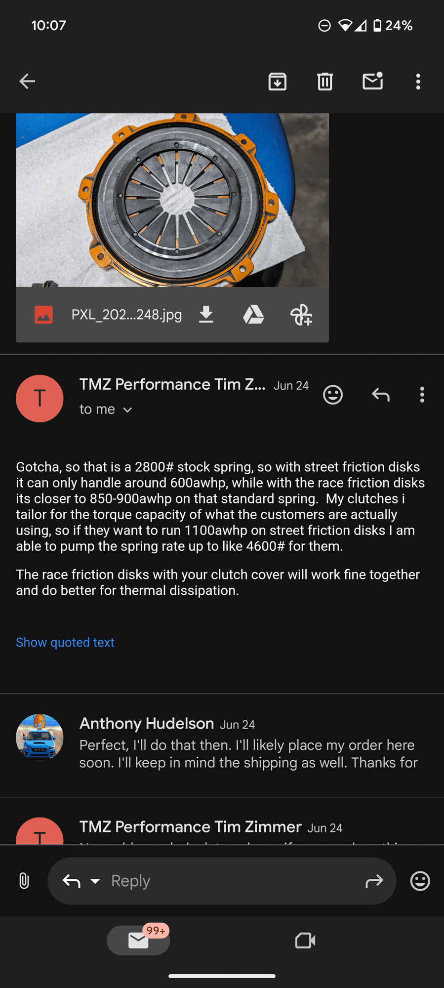

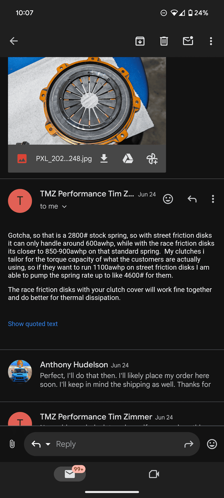

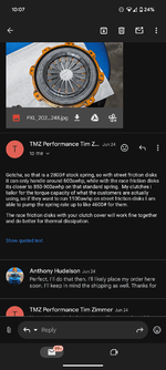

The disks I ordered were the race friction disks, reason being I have only the 2800# cover.
These are the disks that Mr Tim Zimmer recommended off all his infinite wisdom. So that's what I did.

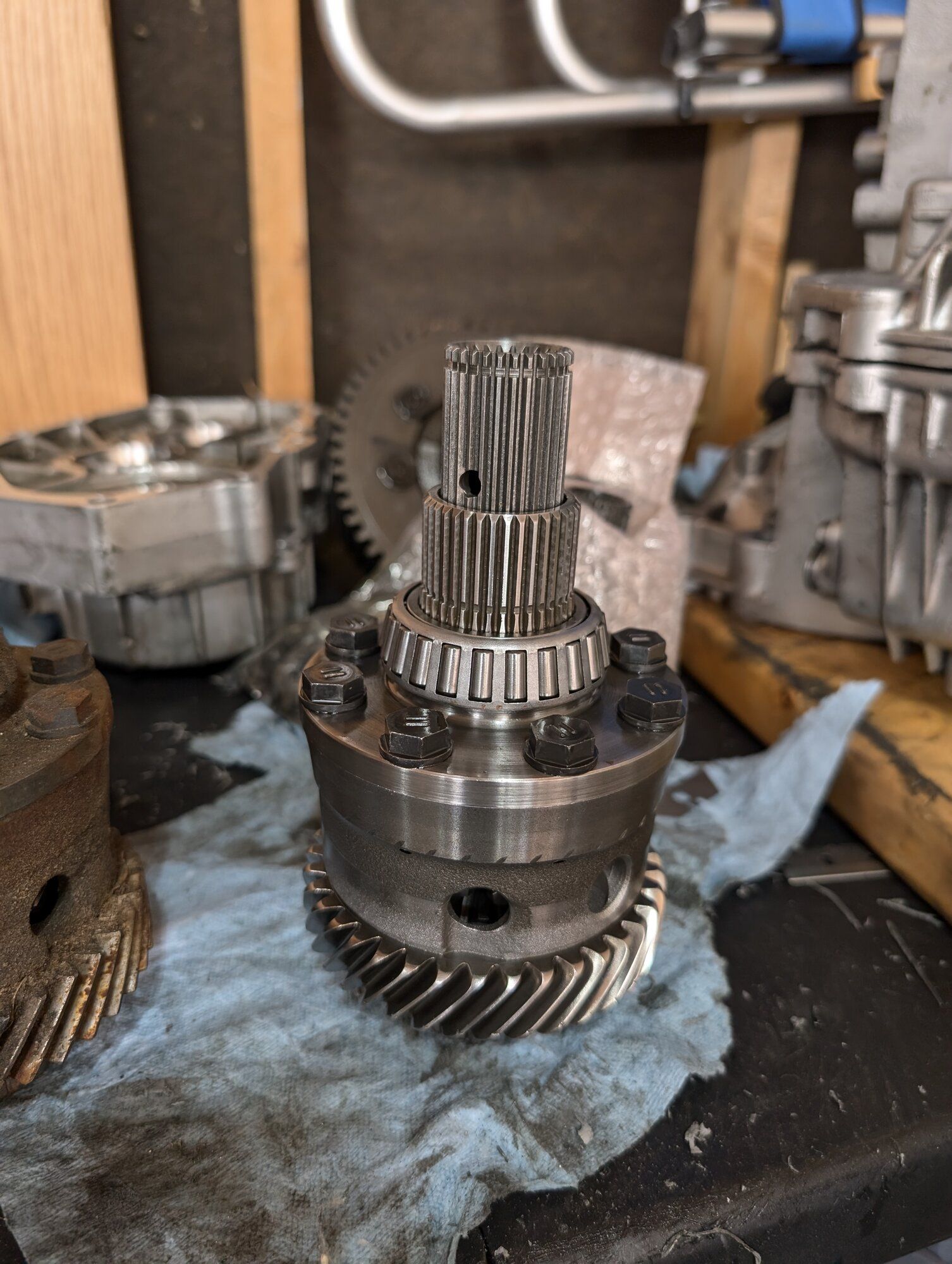

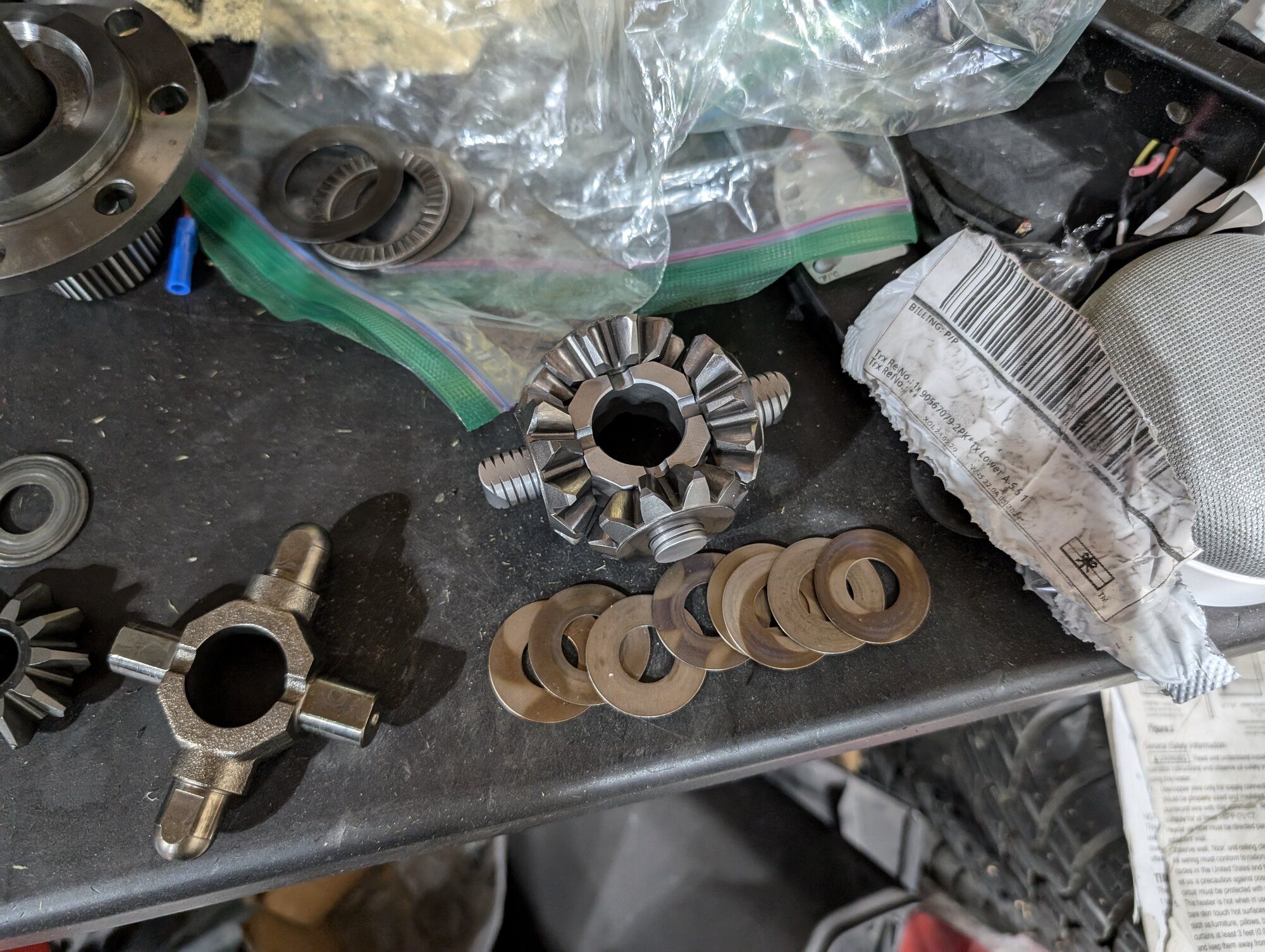

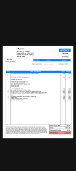

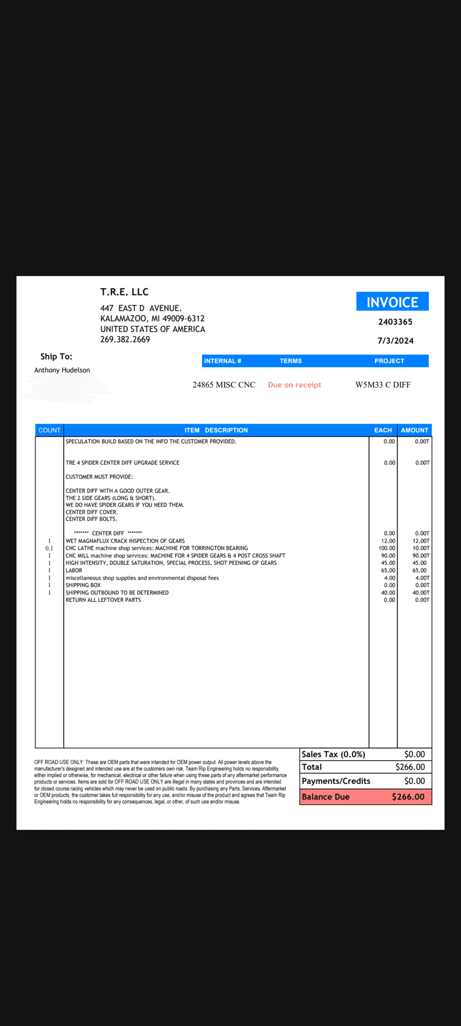

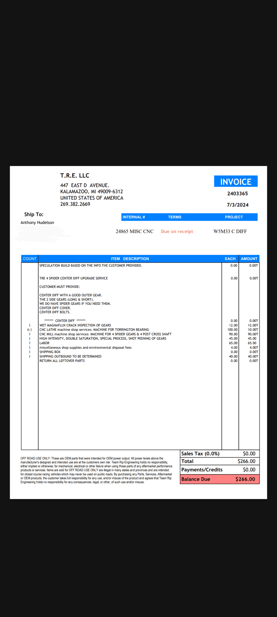

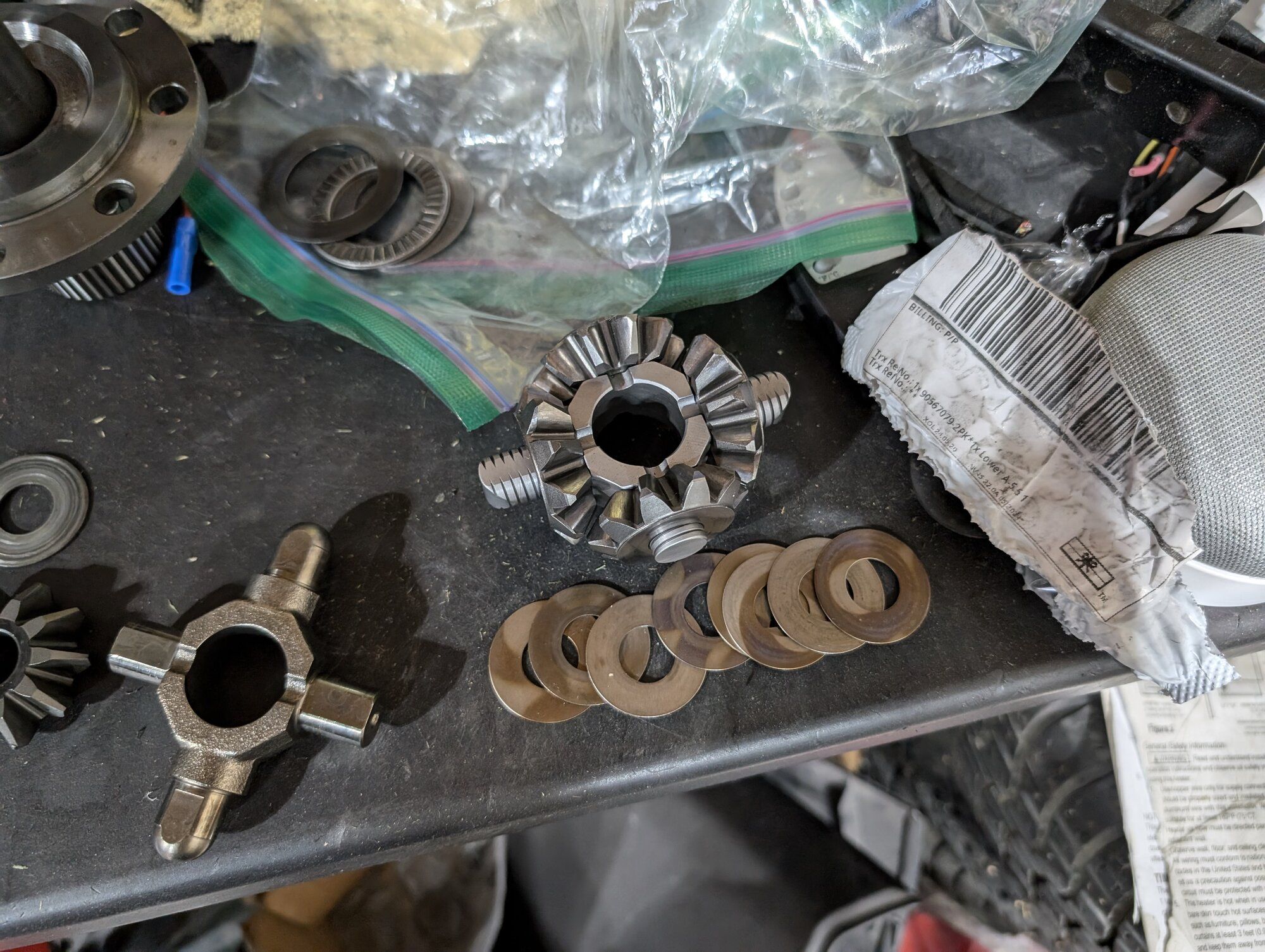

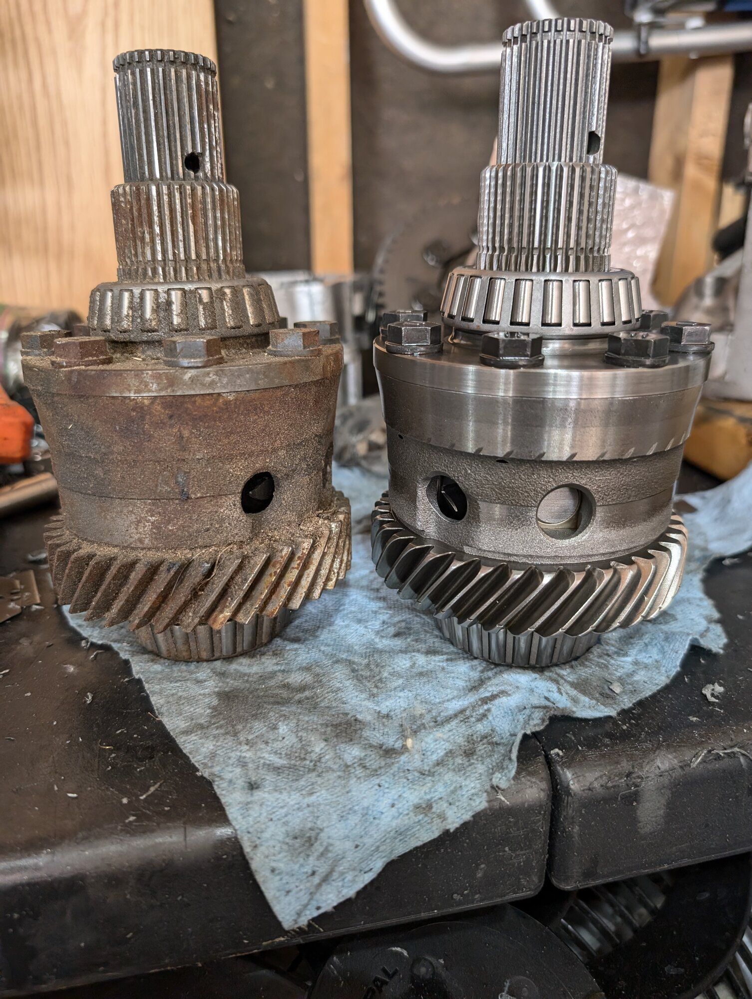

Heard back from Jon at Tre And they are done with the center diff and it should be back this coming week.

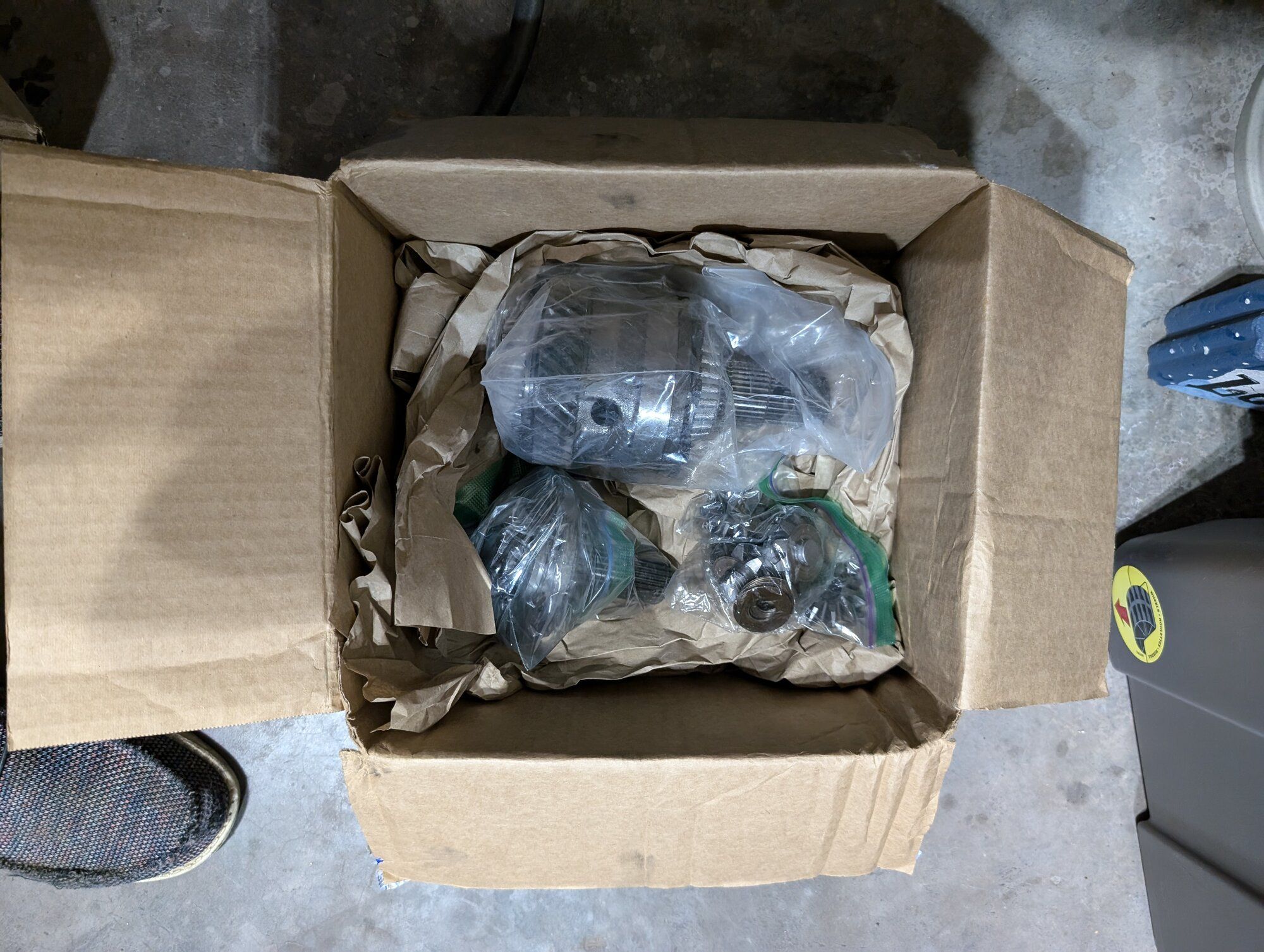

Supplying my own center diff, additional spider gears, Chromoly cross shaft, and good outer gears it costs about $260.
Did you use a stock shaft and let them machine it or did you use one of the TMZ beefier units?
Got me one of them TMZ Chromoly shafts from from Jason Drew
This is the stuff I like knowing. Gonna copy your example 100% in my spare 91 trans. Fix the noise, 4 spider the center diff, maybe brace the tcase.

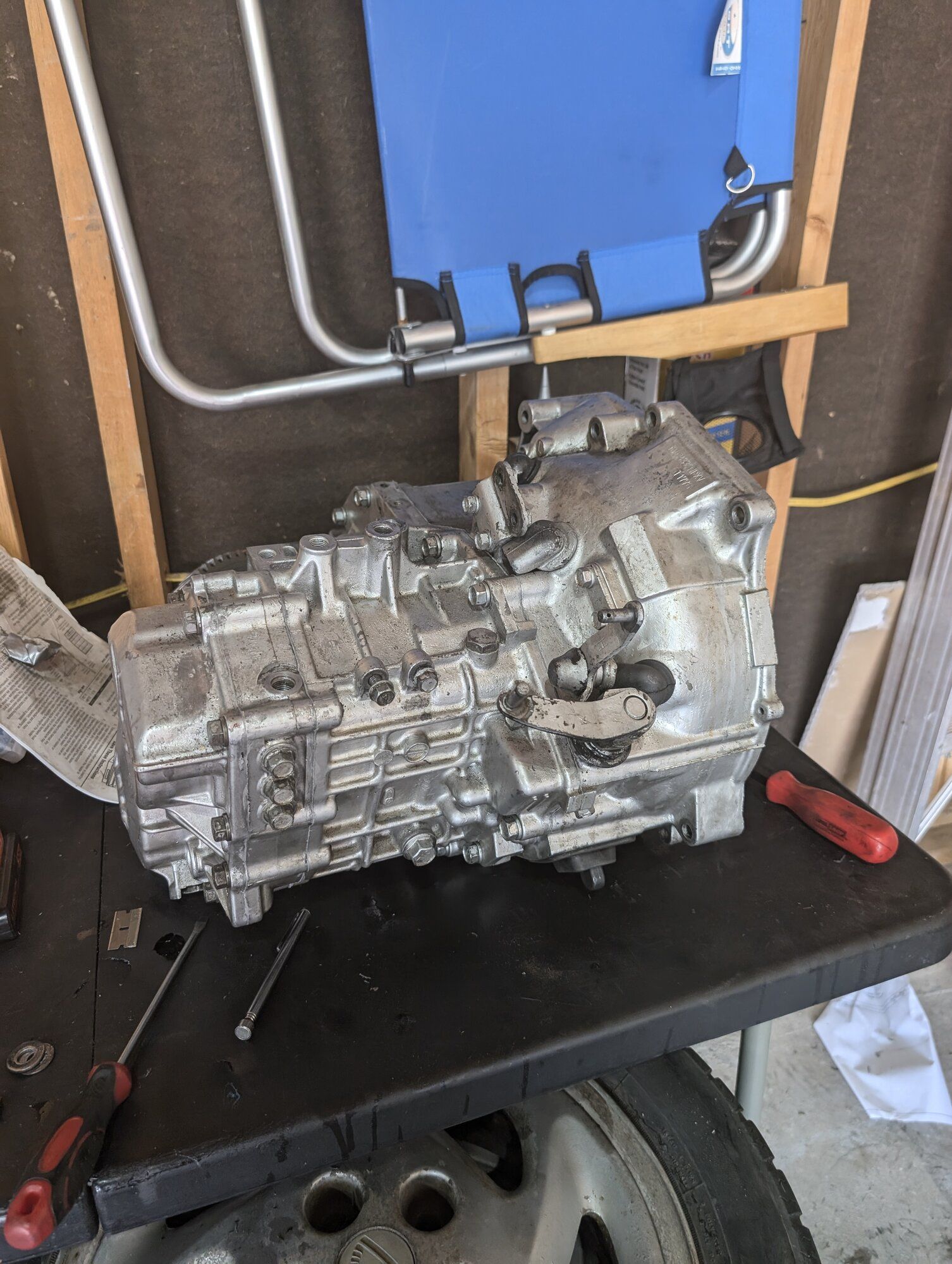

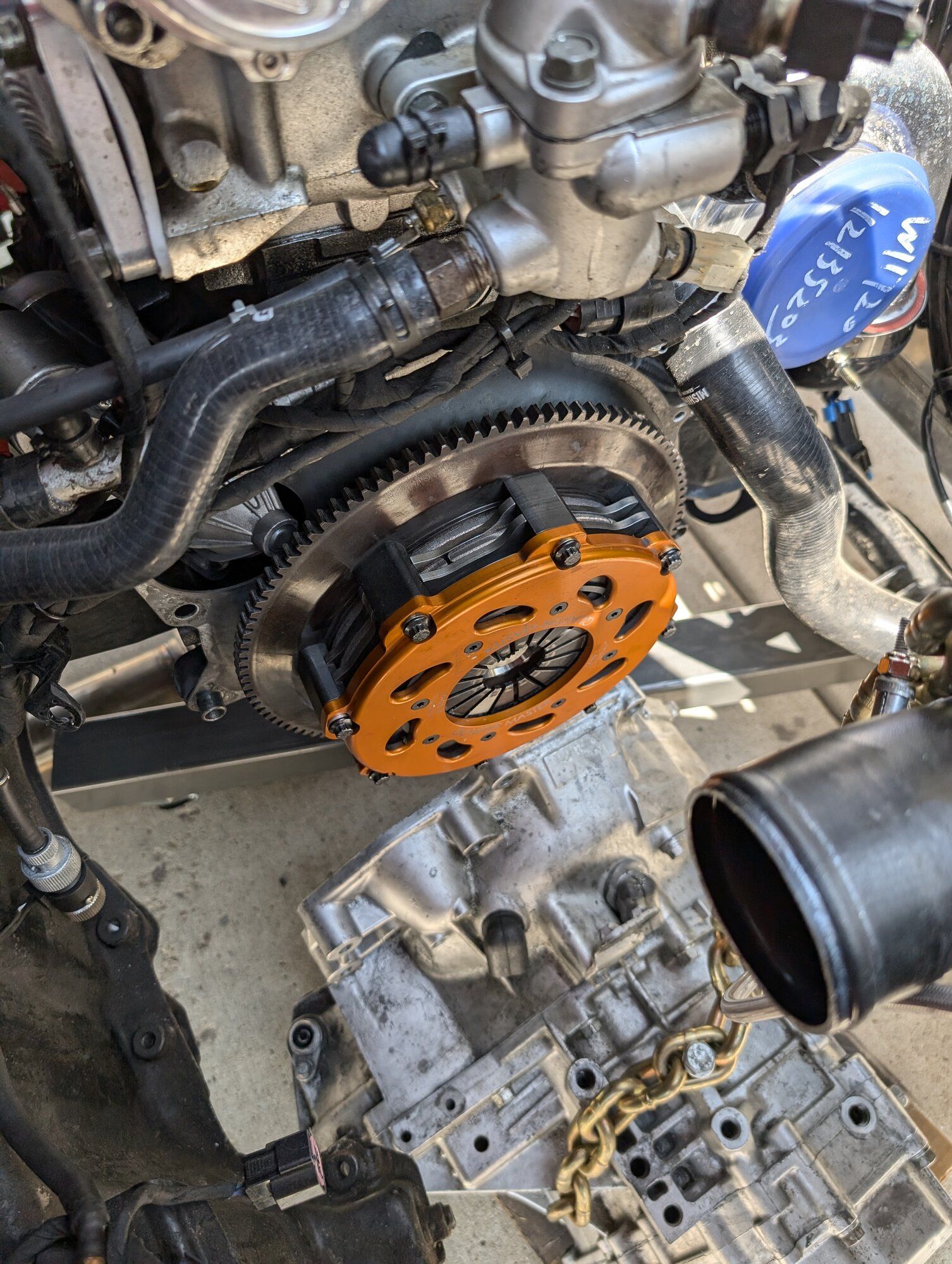

So i got the transmission back together. I did the neat trick of locking the car into both 1st and 5th to torque the end nuts and stake them and wow that was a ton easier than any other method that i've tried LOL

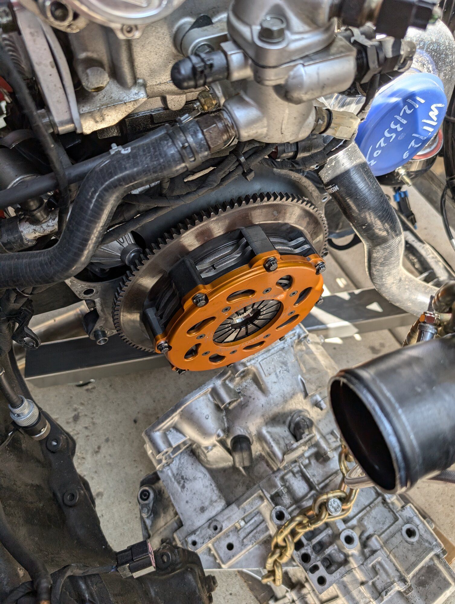

I got my new clutch disks and prepped the car to get the trans and clutch installed. I test fitted the main disk to the input shaft and found a major problem. Due to no fault of Mr. Tim Zimmer, i was sent the wrong disks.
The box the disks came in from QM show the right part number but the disks inside were wrong. They were the 1" splined disks.
Tim sent a message out ASAP on Monday and we got new disks ordered and they showed up this last weekend and i was able to get the clutch installed. It was a bit more difficult to get the trans installed. Not sure if it was just because the thickness of the spline hub or what but i fought with just getting the trans mounted up for probably 45 minutes, but finally got it.

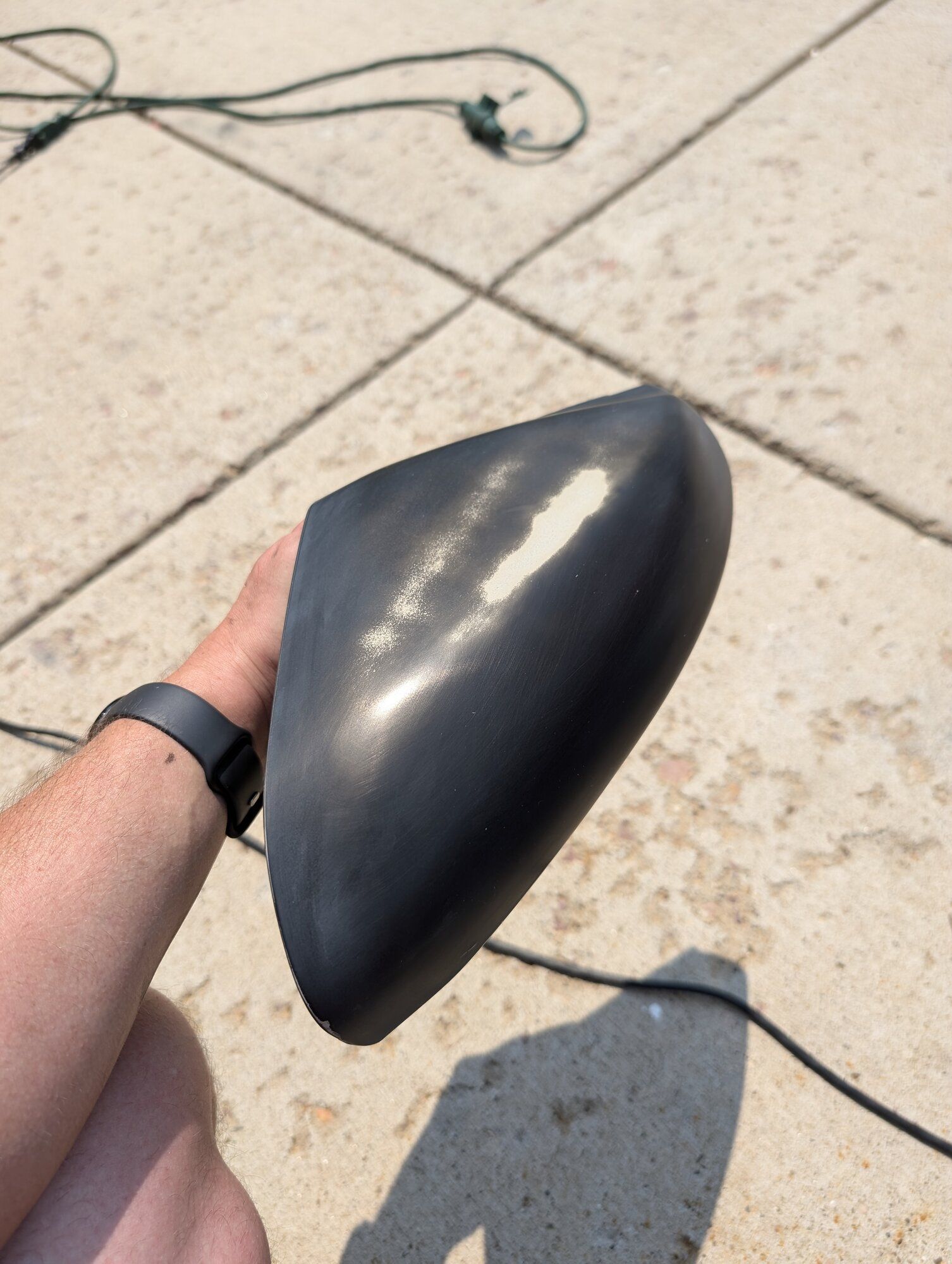

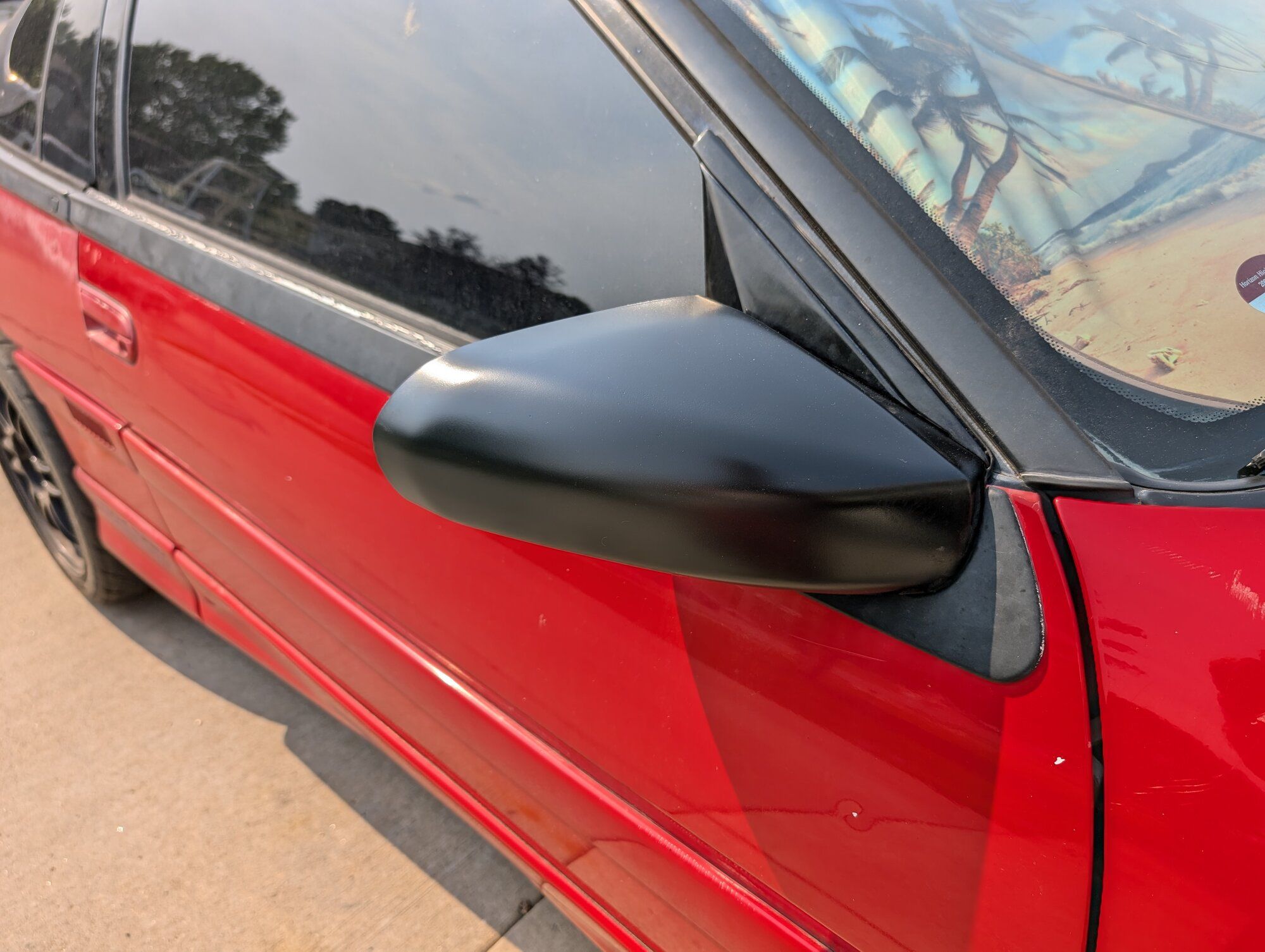

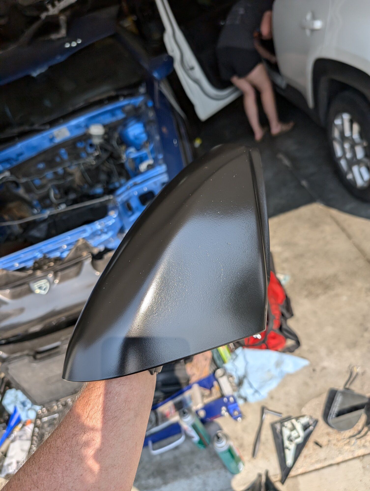

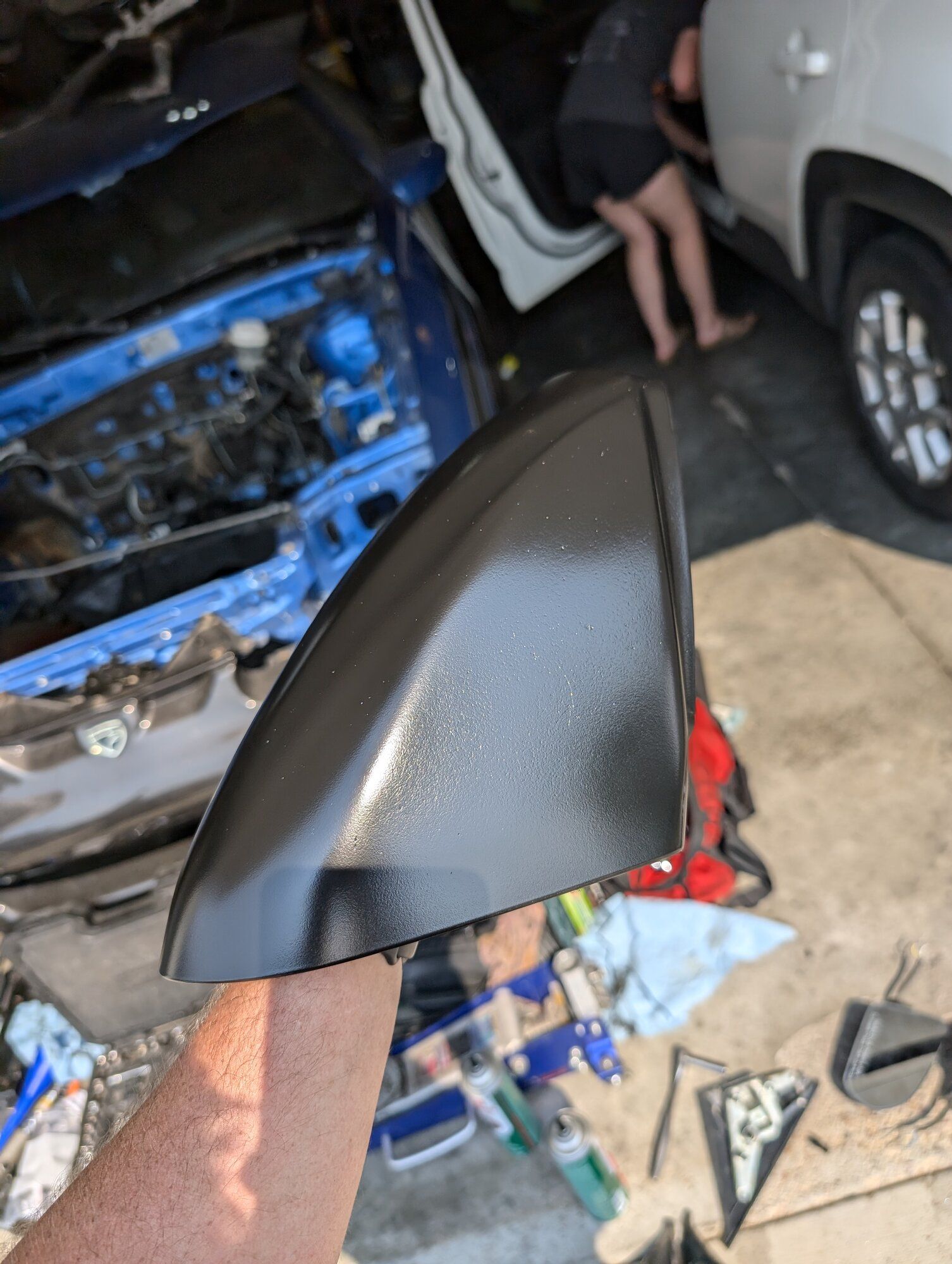

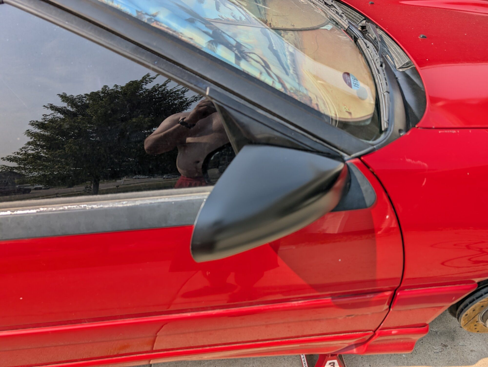

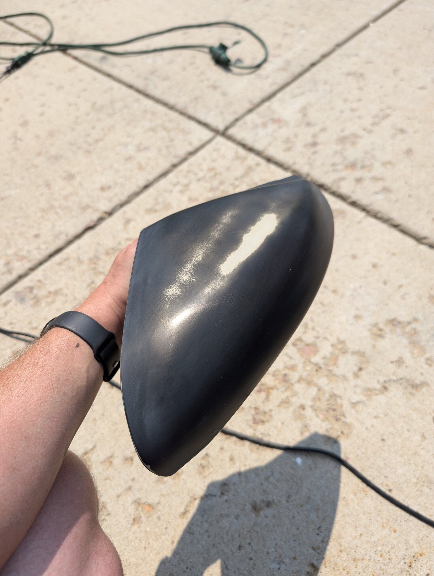

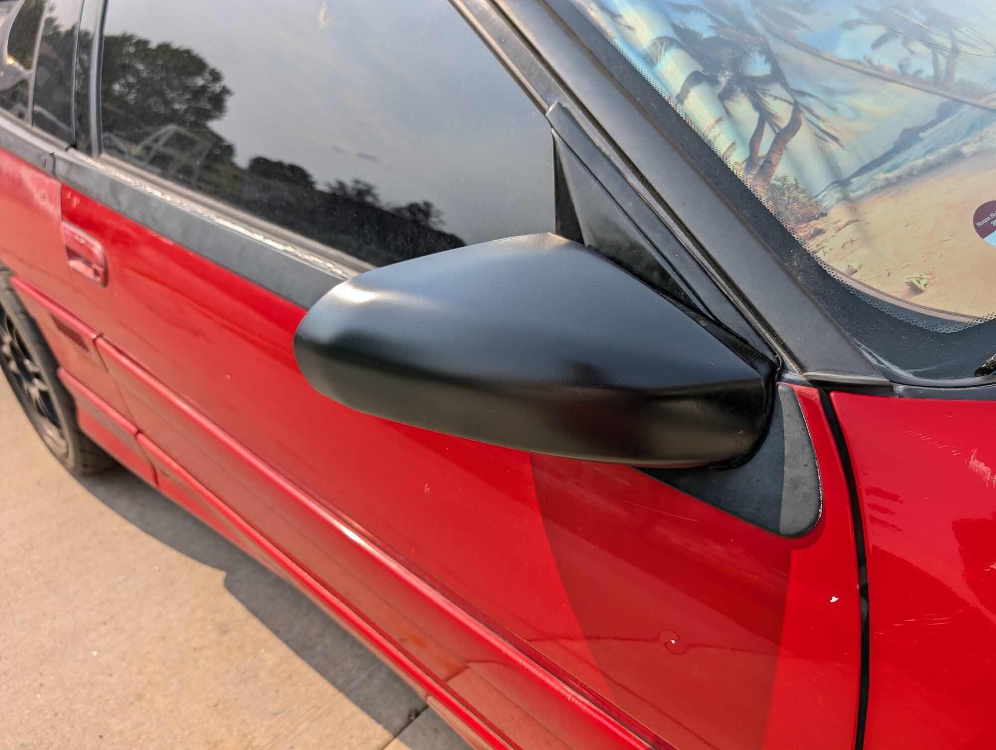

While i was waiting for the new disks to show up, i decided to try and paint my mirror caps. They were pretty faded and i figured it would be a fairly easy thing to get done to help the look of the car. I used duplicolors trim and bumper paint in black.
I prepped them using some 2k wet sanding, and then some of duplicolor wax and grease remover and then let them sit for about 10 minutes making sure they were dry before painting.
I did 3 coats and honestly im not really all that impressed with that paint. Its very rubbery feeling and doesnt really feel like paint. Its soft, and its fairly easy to scratch the paint off despite the prep i did. The color looks good but the texture just isnt good. Ill be re-painting them sometime with some semi matte finish paint sometime i the future.

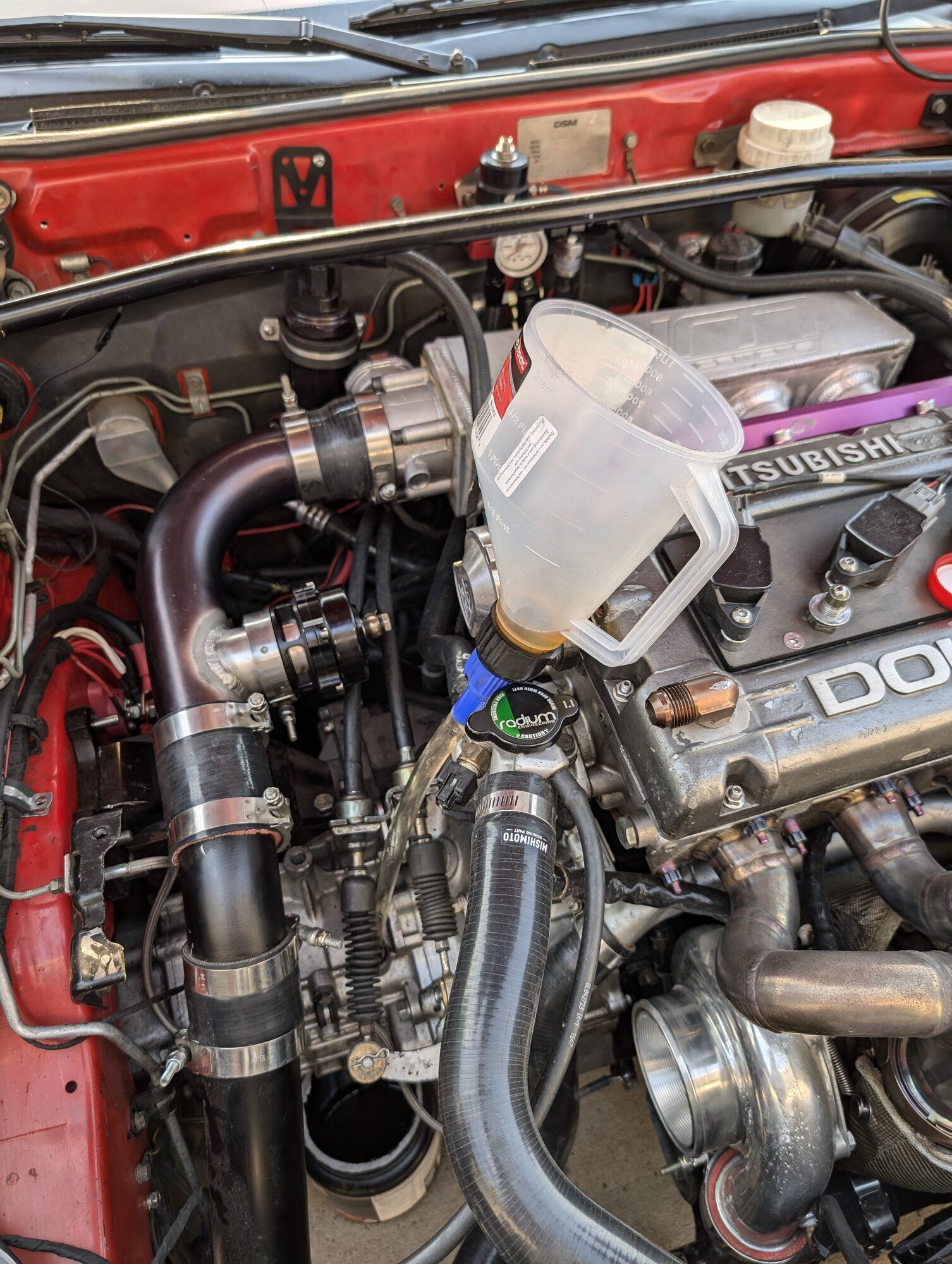

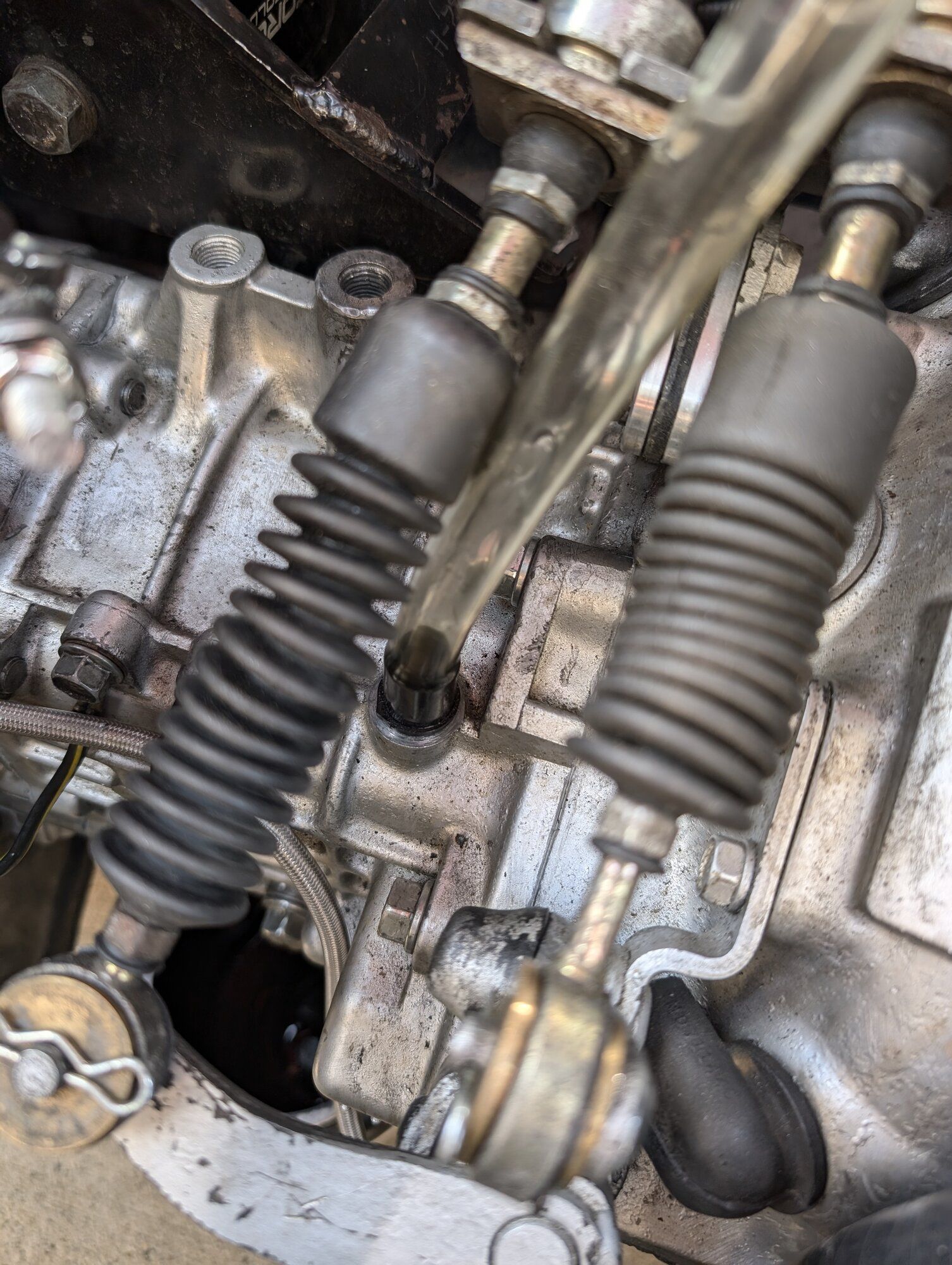

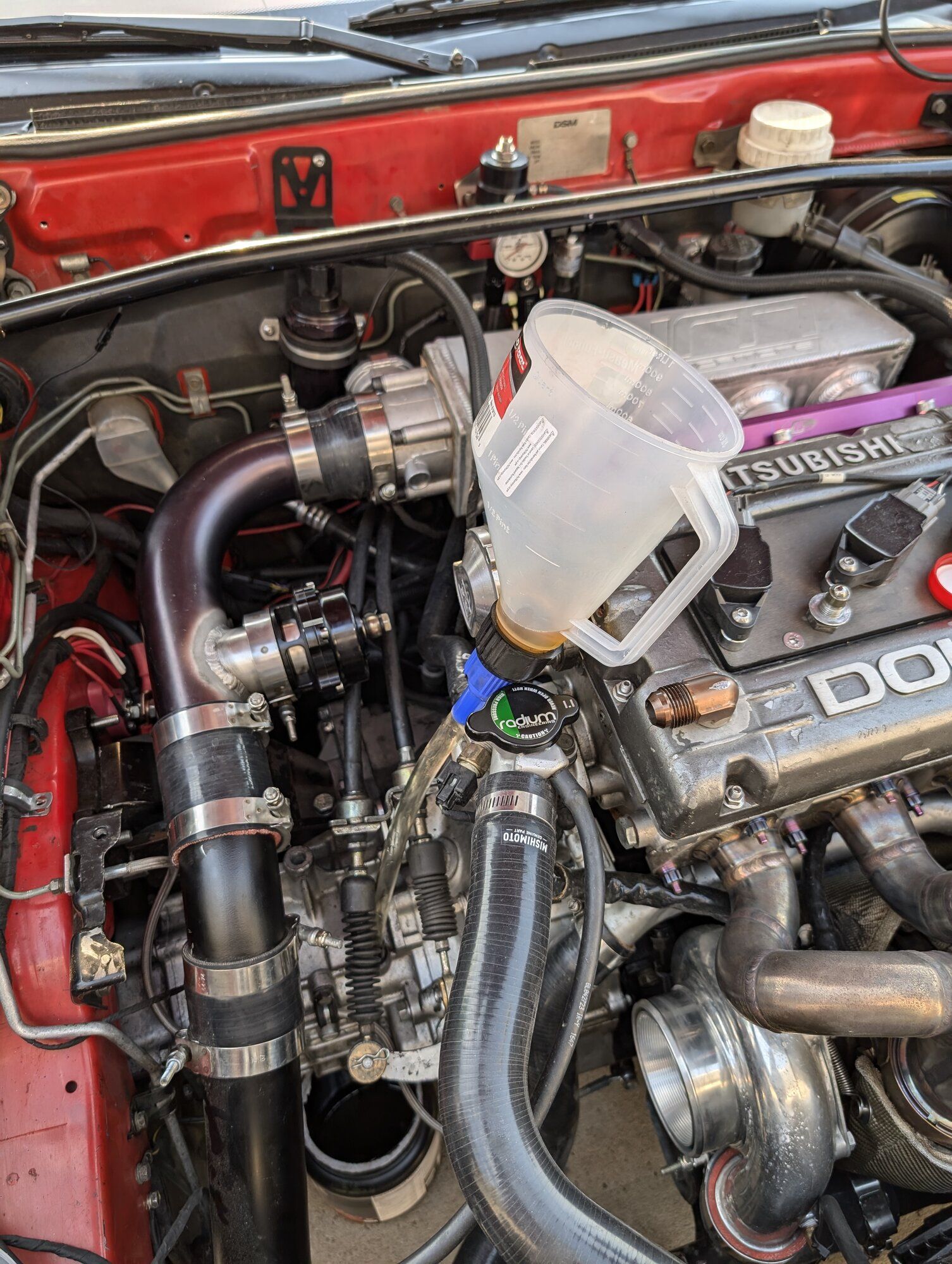

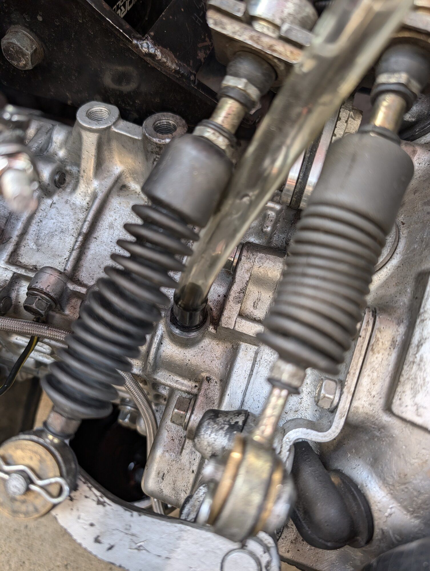

Last night i got some fluid put in the trans. I opted out of using my normal fluid pump way and instead used the detent ball location for reverse/5th gear thats located right under the shift cables. Honestly this works so well and i dont have to worry about blowback from the fluid pump while pumping into the fill port. I just undid the fill port and put fluid in the trans using that detent location and it worked perfect. Poured fluid in until it came out the fill port and let it drip out and stuck the plug back in and done. No mess. I do have a funnel with a hose it i that fit perfectly into the detent port.
First time feeling the new clutch, its probably about 20% easier than the 2900 (or so it feels) but i feel like i can feel the pressure plate disengaging all the way. I can feel it go over the "hump" of the pressure plate and get a little easier. Issue here is that the pressure plate finger travel. I definitely need a clutch pedal stop, i've got one ordered up and hopefully that will work. Its a universal one so hopefully.
I pulled the car out of the driveway and reversed it up into my driveway. The first time i tried to go forward while on the road i killed the car. The clutch definitely engages firmly. I wont say "hard" but when everything grabs, it definitely grabs. The clutch feels good though, i think im going to like it once i get the hang of the engagement.
I probably would have driven the car except for when i was under the car putting the tcase in i saw that my coupler of my compressor housing decided it wanted to split.

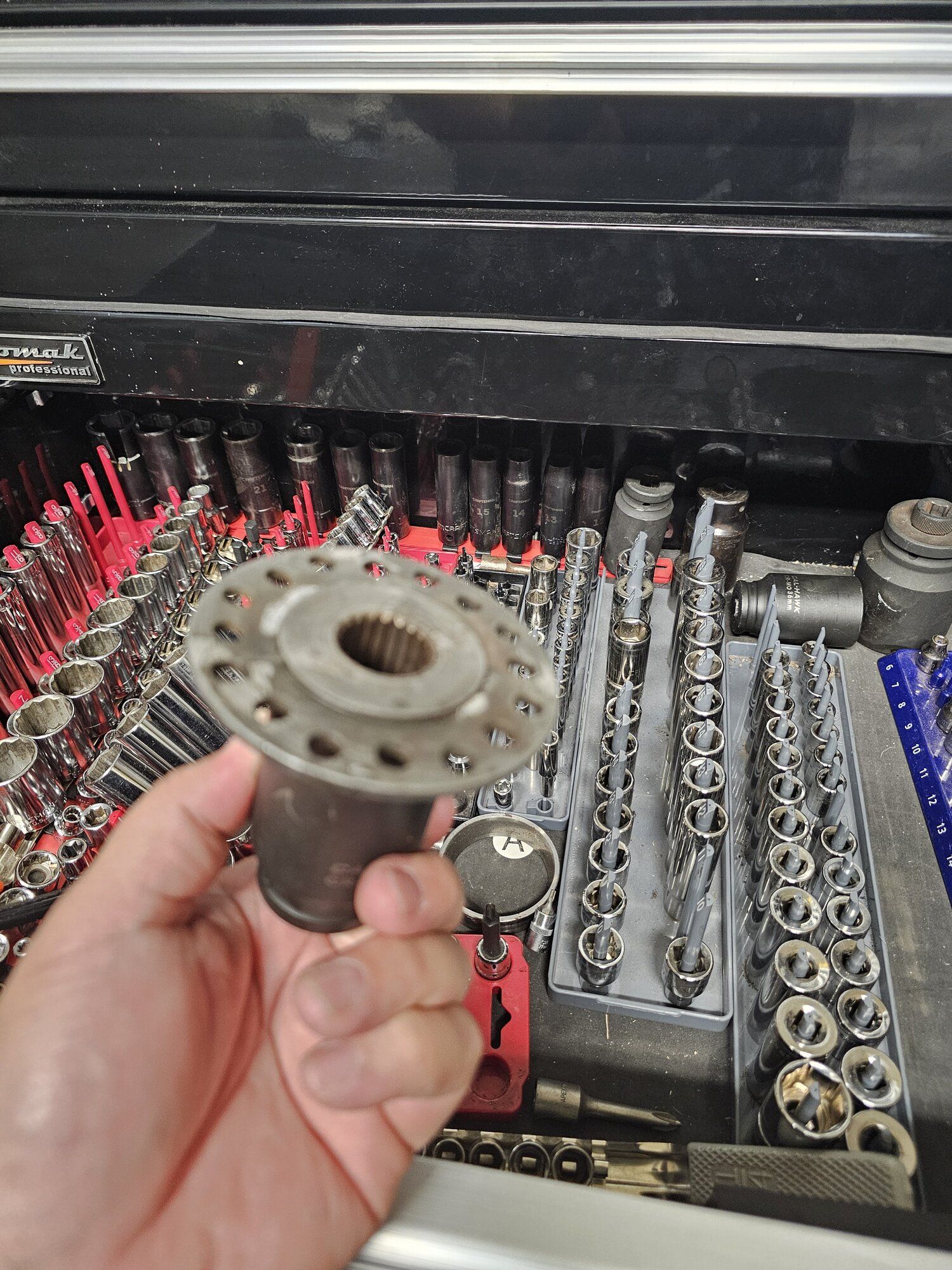

year ago I cut the center out of a scrap clutch disk and welded it to a socket to be able to tighten and loosen the end nuts. Good place to store the clutch alignment tool also.
