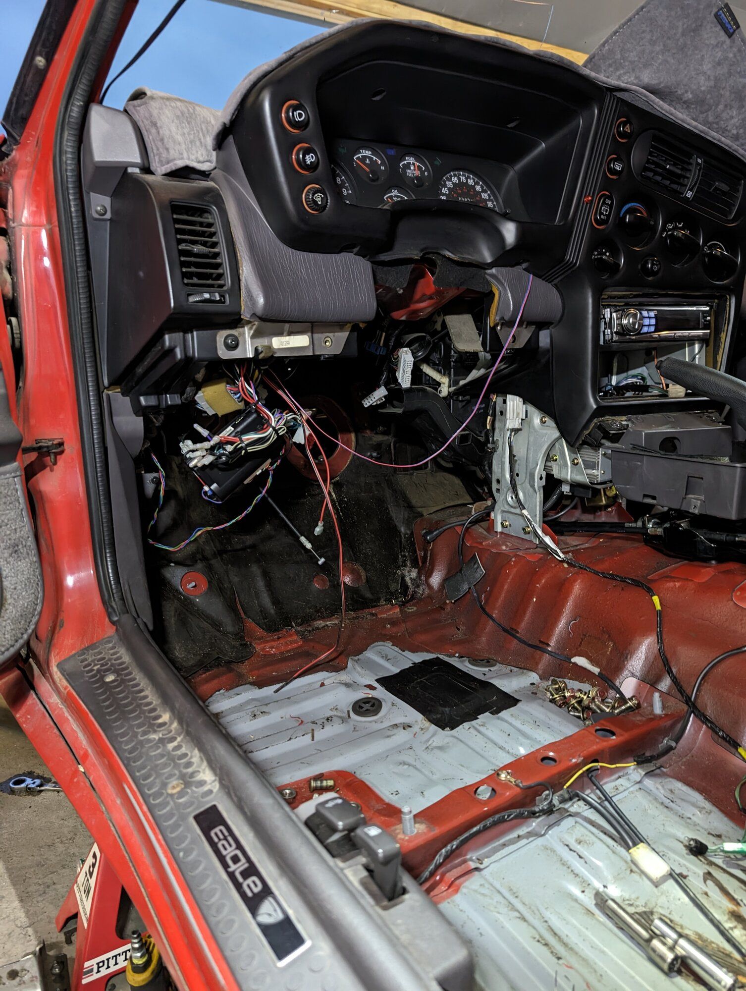

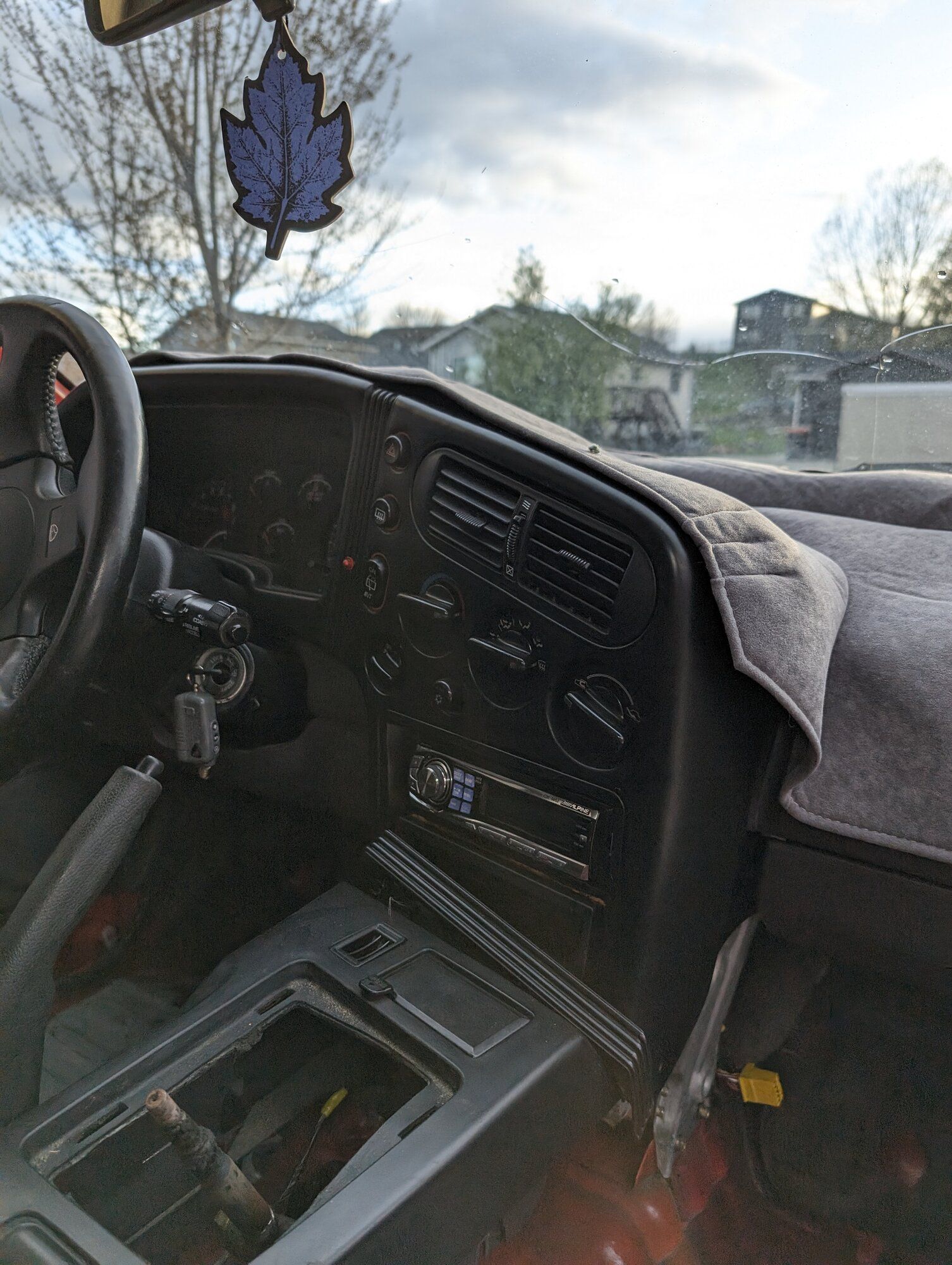

I'll share some pictures of some cool stuff I found while unloading the interior of the new car and one outside.
It still has the factory air damn for the radiator. SUPER win in my eyes.
A Tonneau cover! It's in decent shape and a lighter gray than the interior that will be going in but I'm gonna keep it.
A dash cover, thought about keeping it but unsure yet.

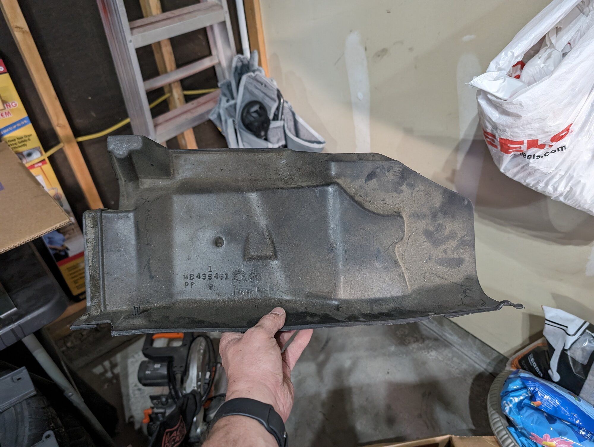

Passenger side floor vent distributor plastic
The factory amp!
Not pictured because I forgot are both driver and passenger side foot well covers for the center console.

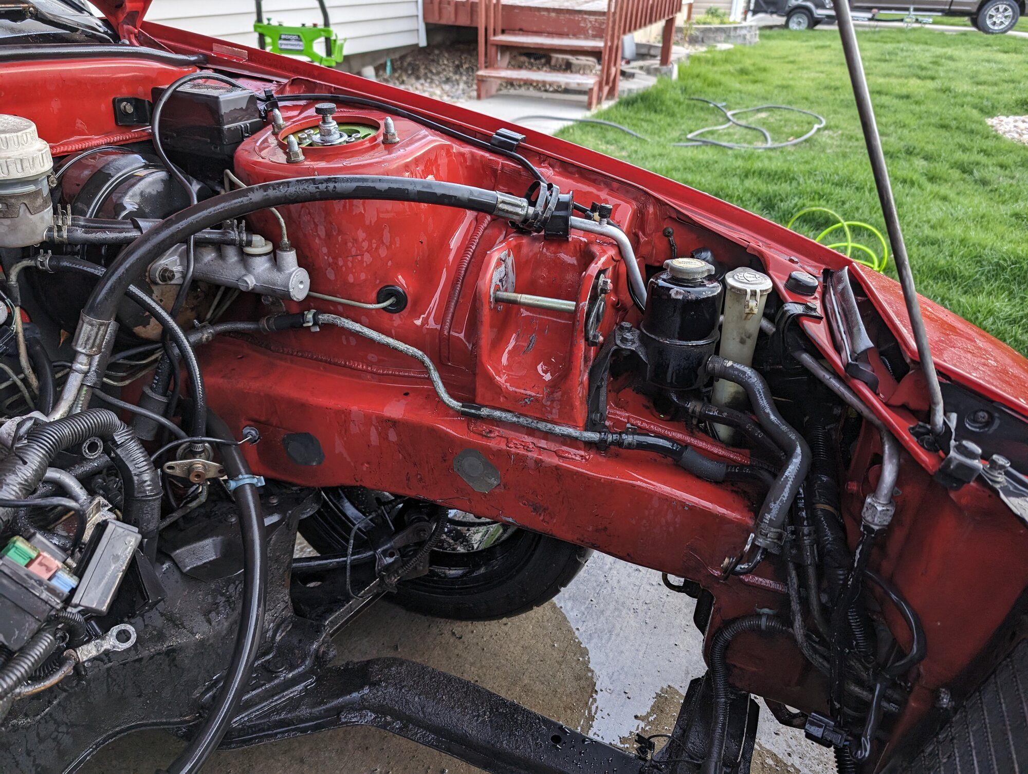

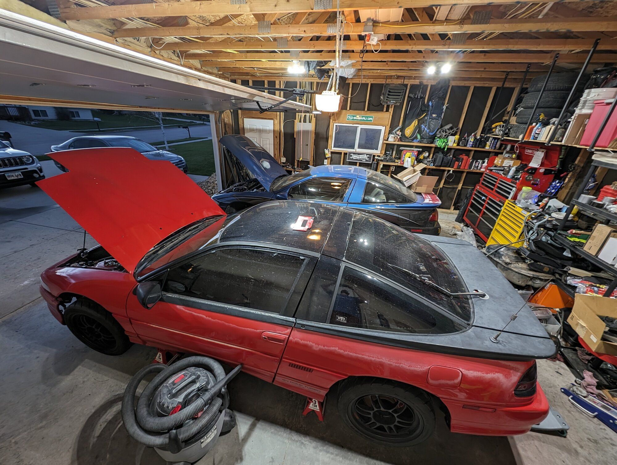

Gave the car a bath and cleaned vacuumed out the interior tonight

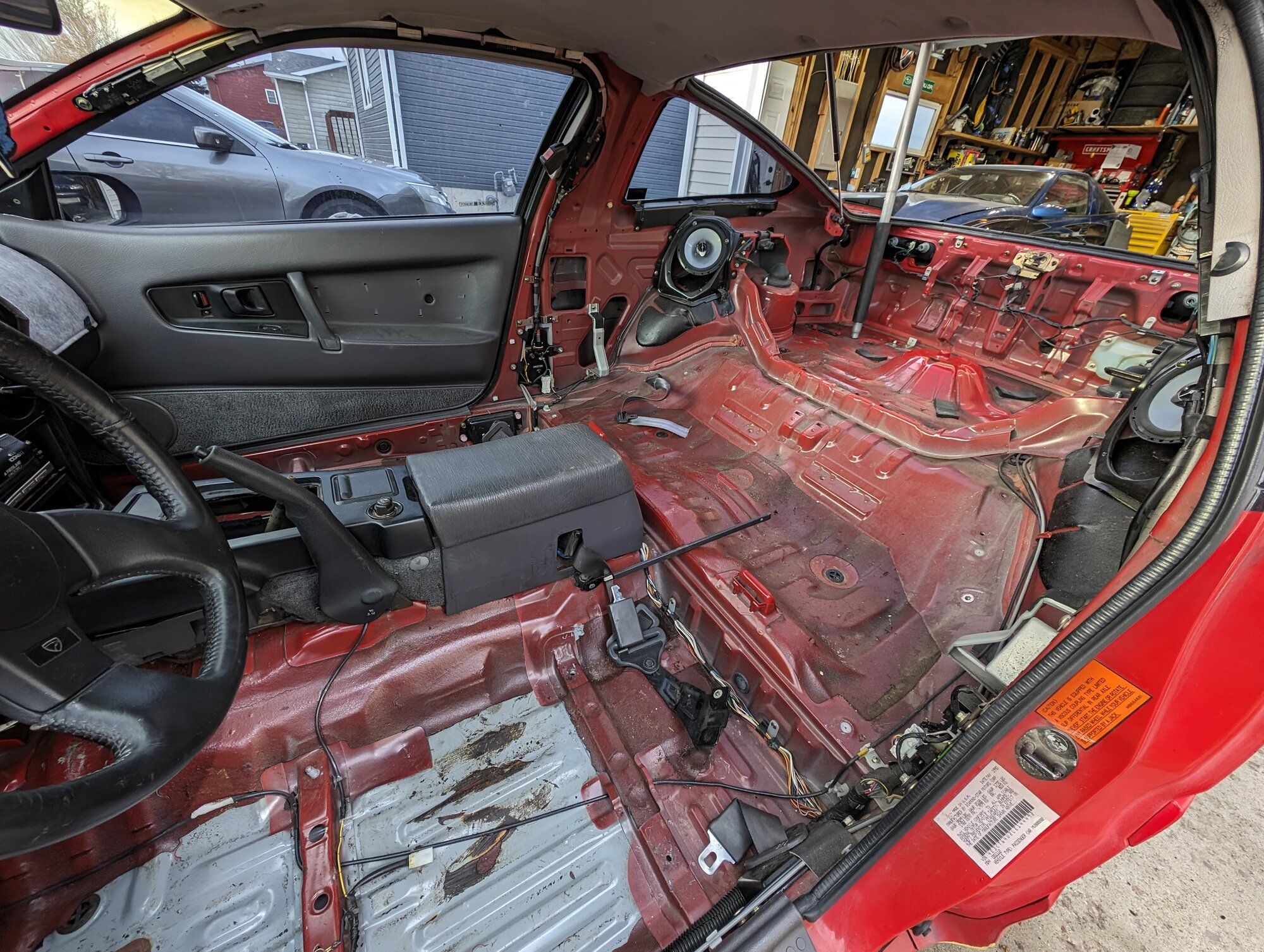

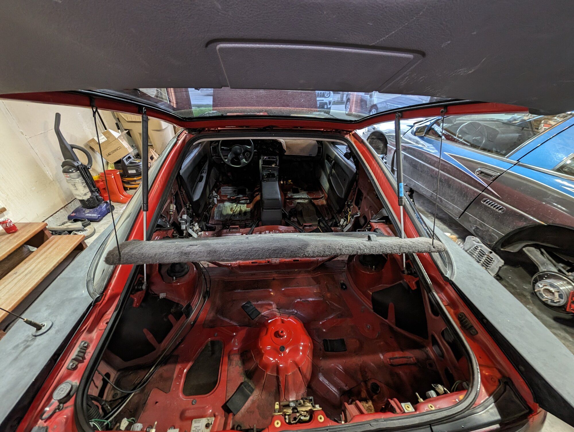

Im going to be starting with pulling the fuel tank, and then the subframes, and then the interior last. I need to get one of these turds out of the garage because im taking up my Fiance's side of the Garage since our driveway is slightly sloped and sitting one of them up on stands in the driveway would be fairly sketchy
Took today and tomorrow off work to get some serious progress done on the swap.

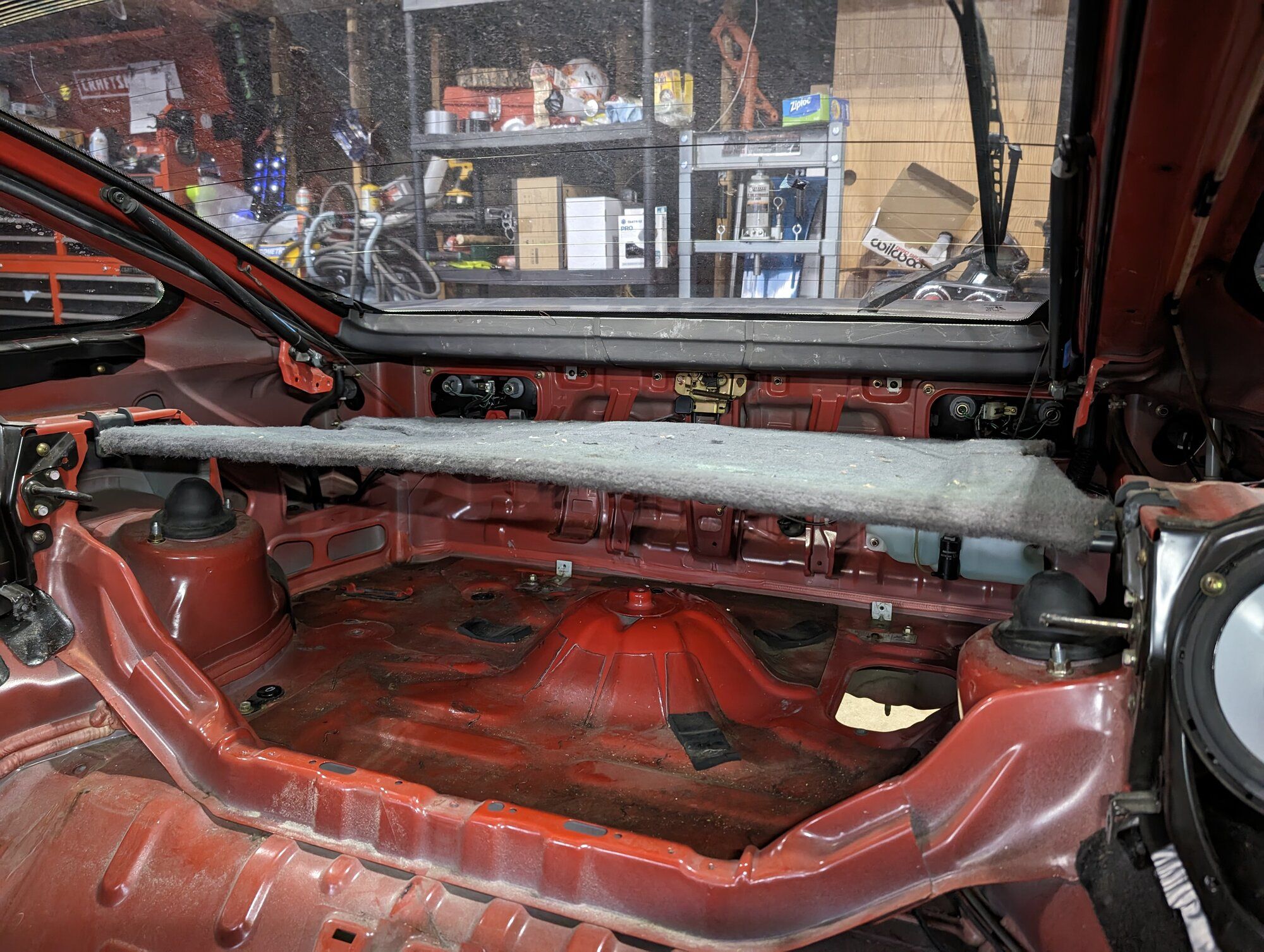

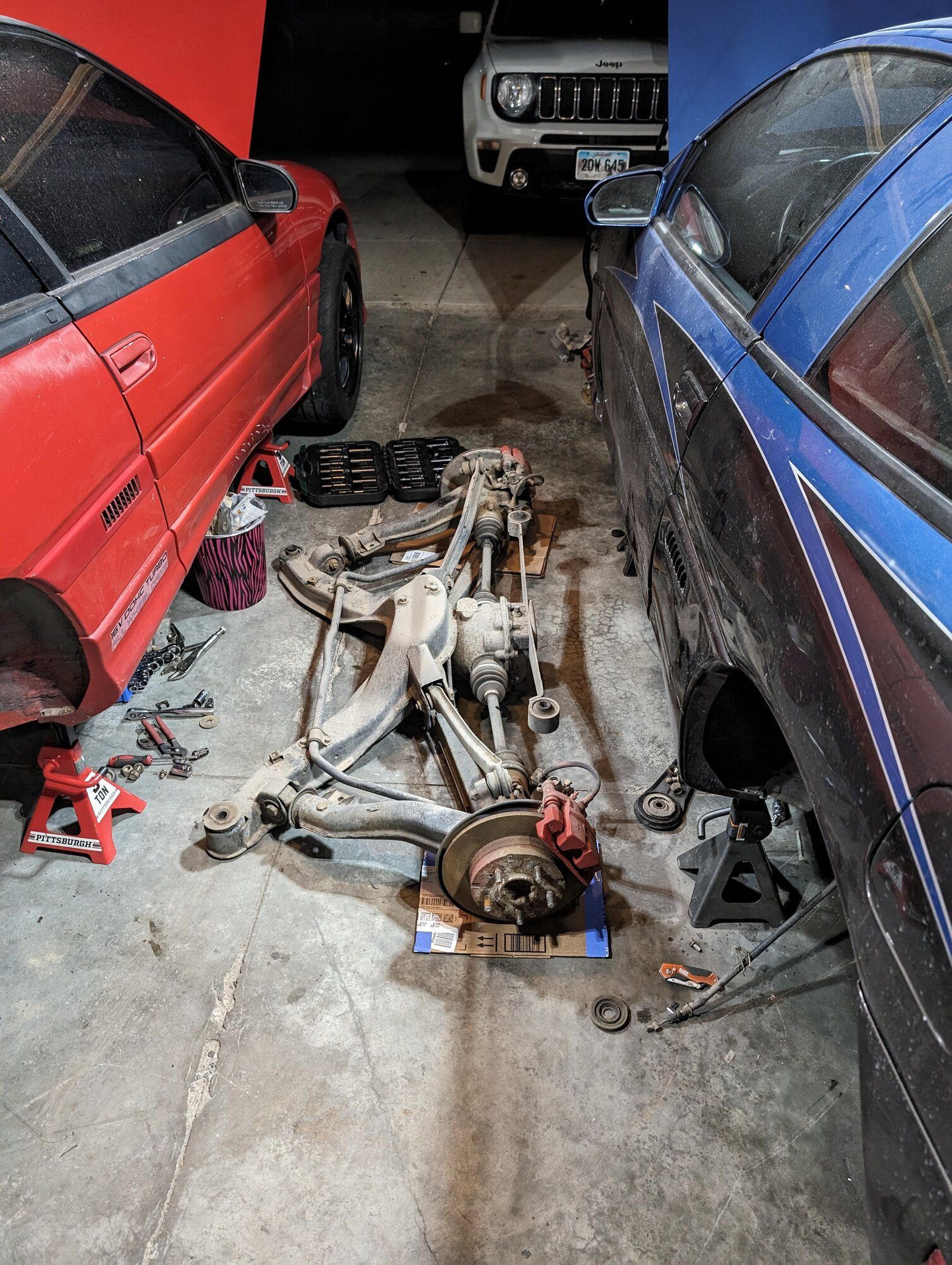

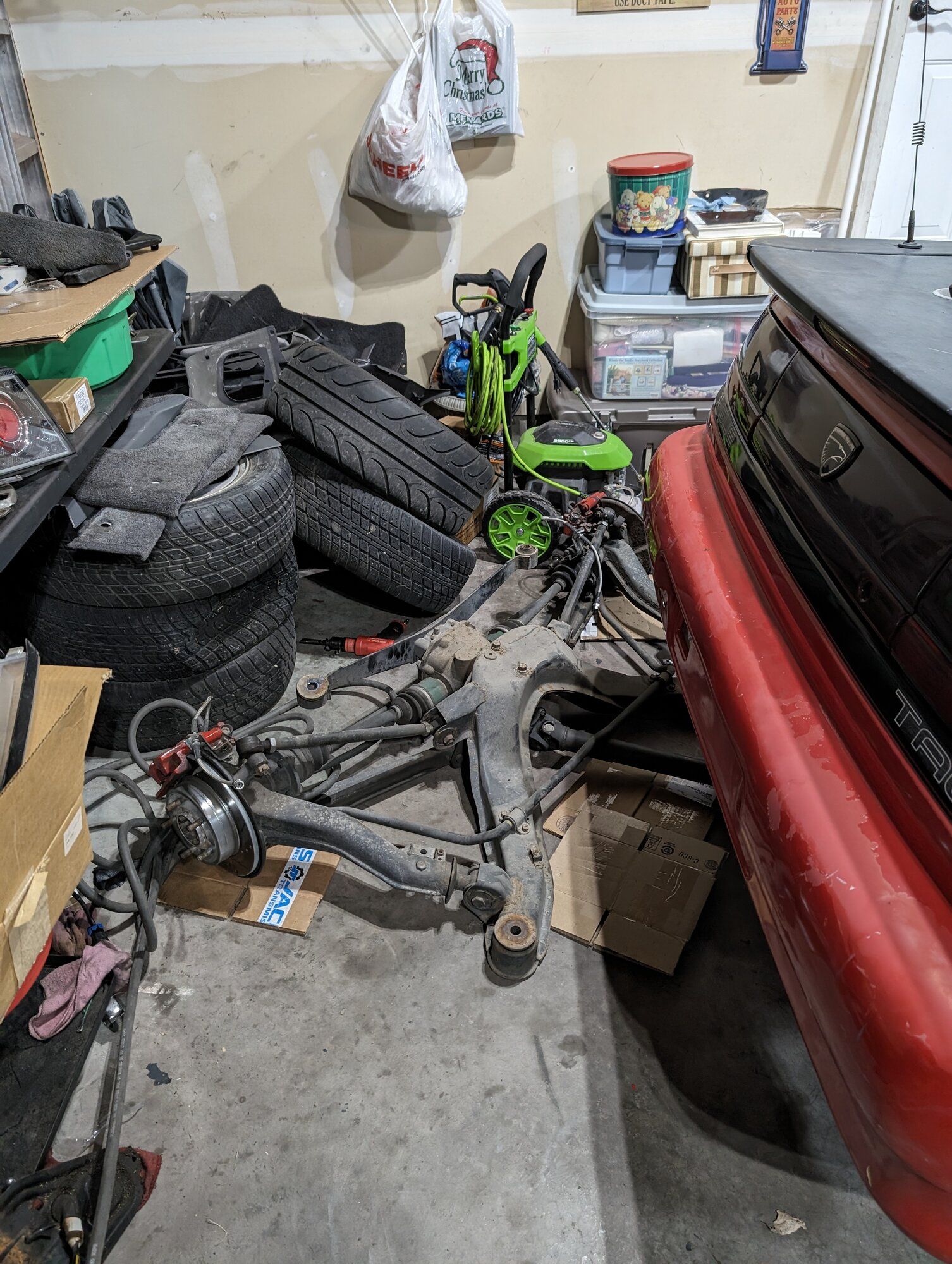

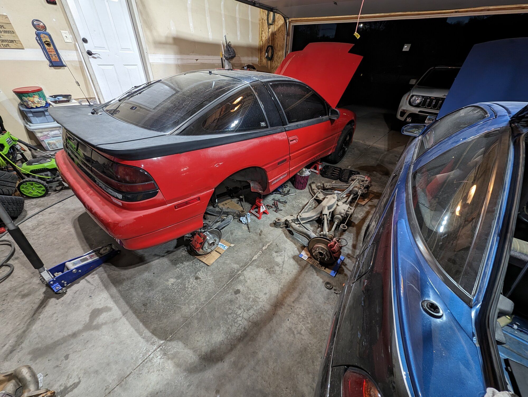

Last night got both rear subframes dropped in the ground. I only had 1 1/2 hours last night so didn't get any further than that.
PXL_20240508_021047231.jpgPXL_20240508_024942221.jpgPXL_20240508_024943879.jpgPXL_20240508_025200587.jpg

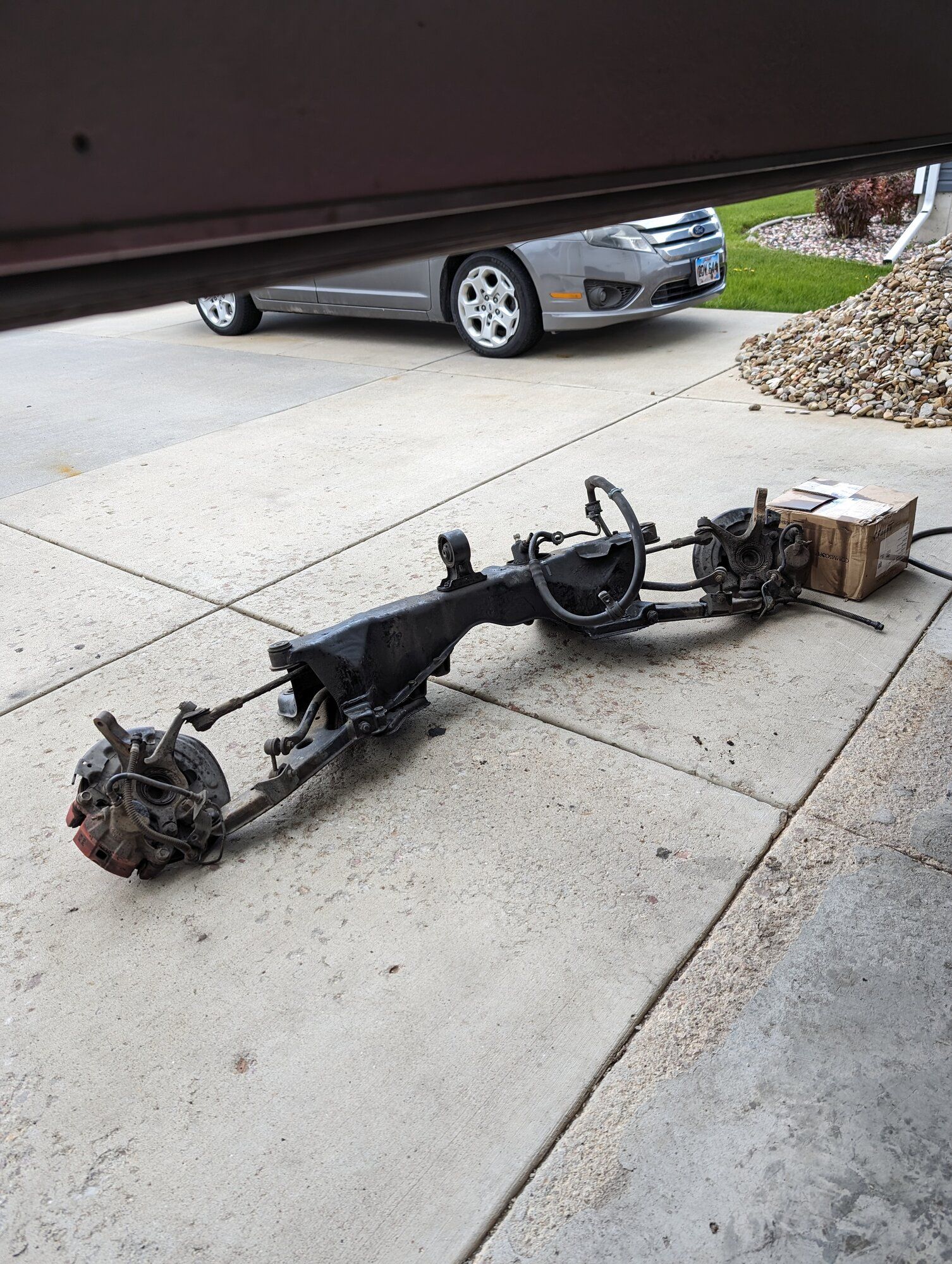

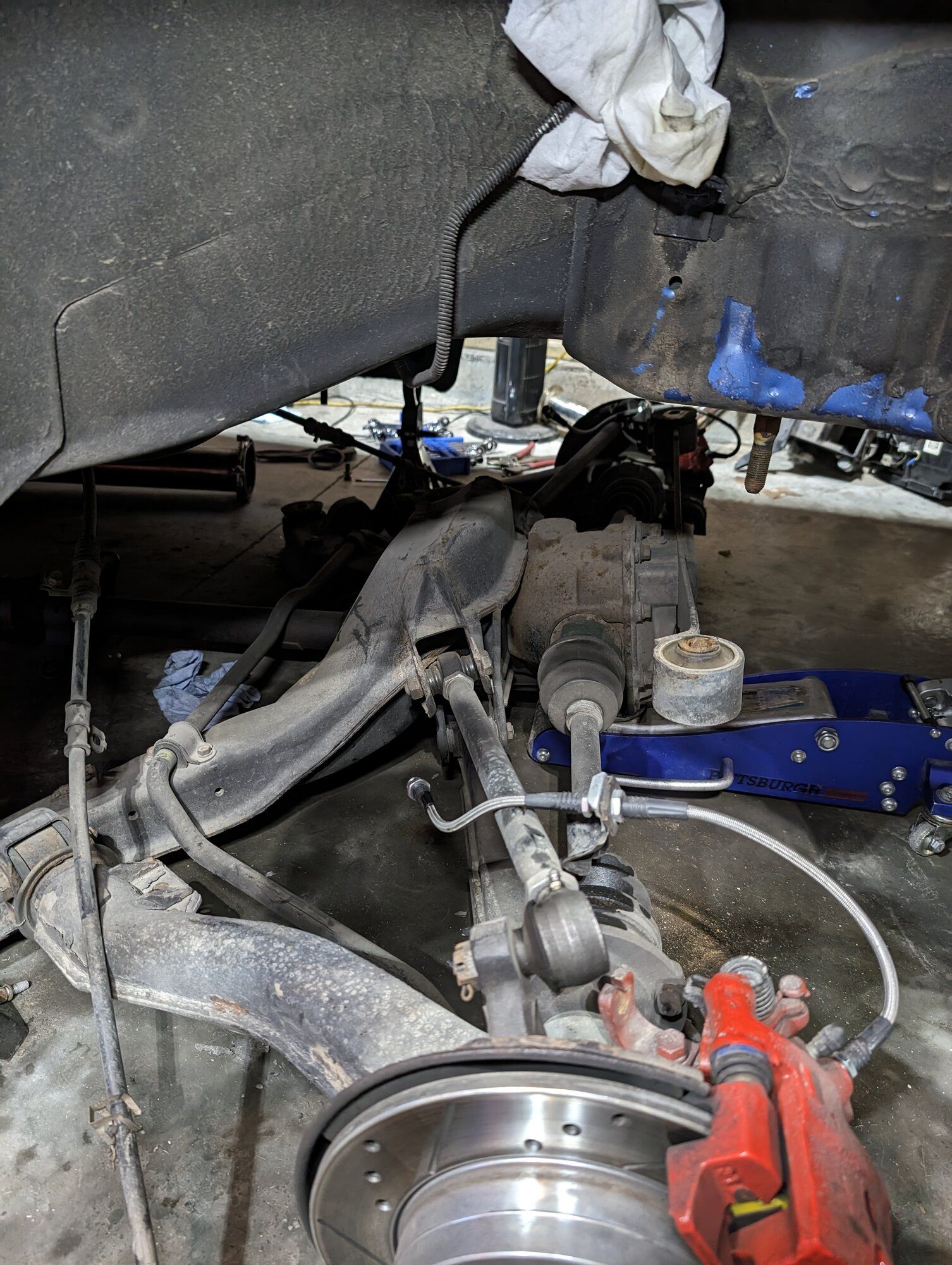

Todays progress:
-Both front and back subframes with everything attached swapped from one car to the other.
-Fuel lines SWAPPED. I decided to keep the OEM lines and holders from the red car and reinstalled them on the blue car so that whoever gets it next has factory fuel lines.
-Driveline mounted back up on the chassis
-Fixed up the passenger side headlight. Some of the mounting bolts and shroud around the top and side of the headlight were missing so I pulled it off a spare head light that came with the car.

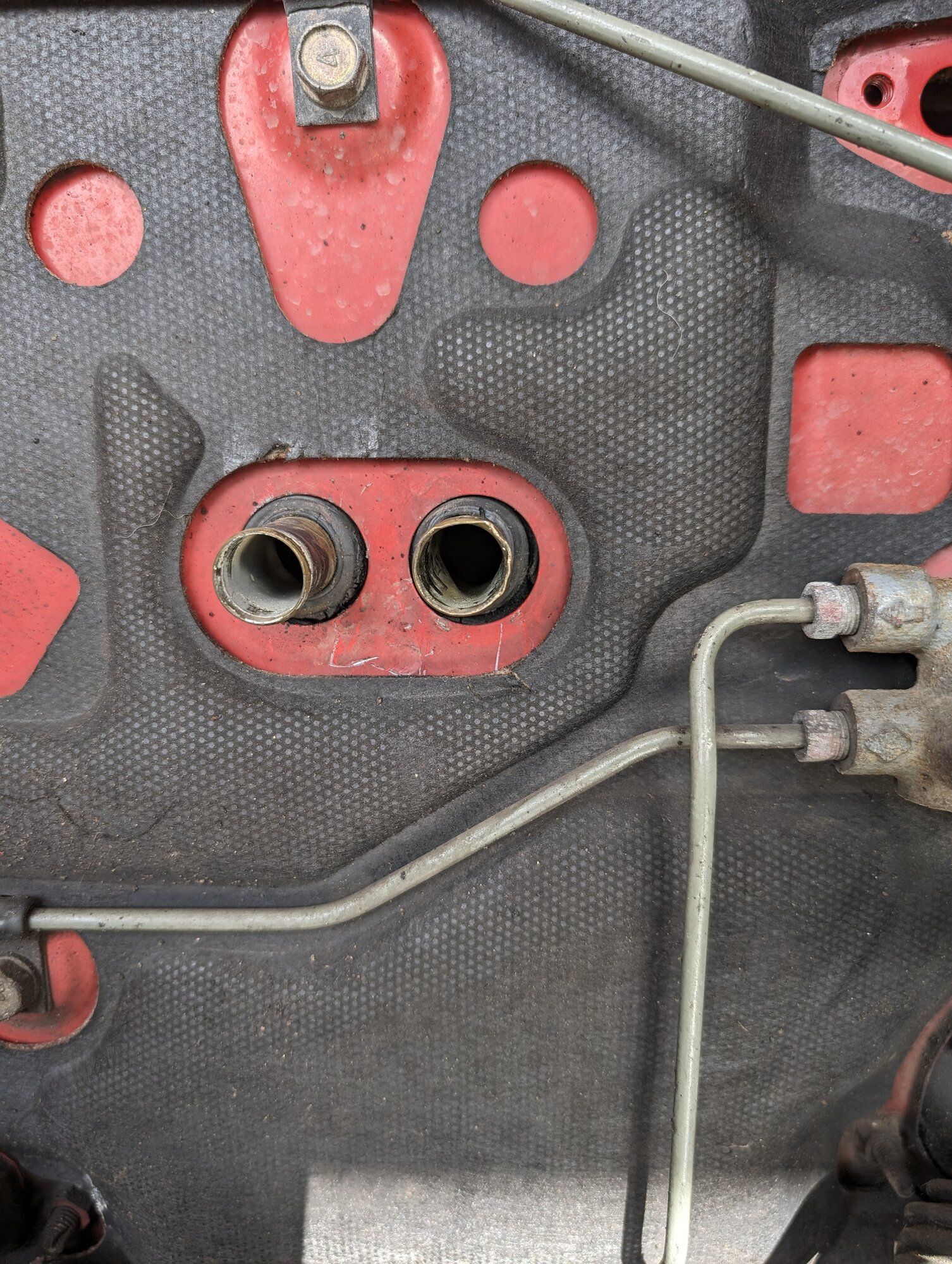

I noticed the car still has the factory oil cooler also, which is cool but I won't use it because I don't know the history of it. Maybe its been through a spun bearing or engine failure. Better safe than sorry.
I also noticed the heater core pipes were bent to shit.i wiggled a socket in there to straighten them back out and then put a small worm clamp and snugged it down to get it back into a more round shape. So hopefully they don't leak.

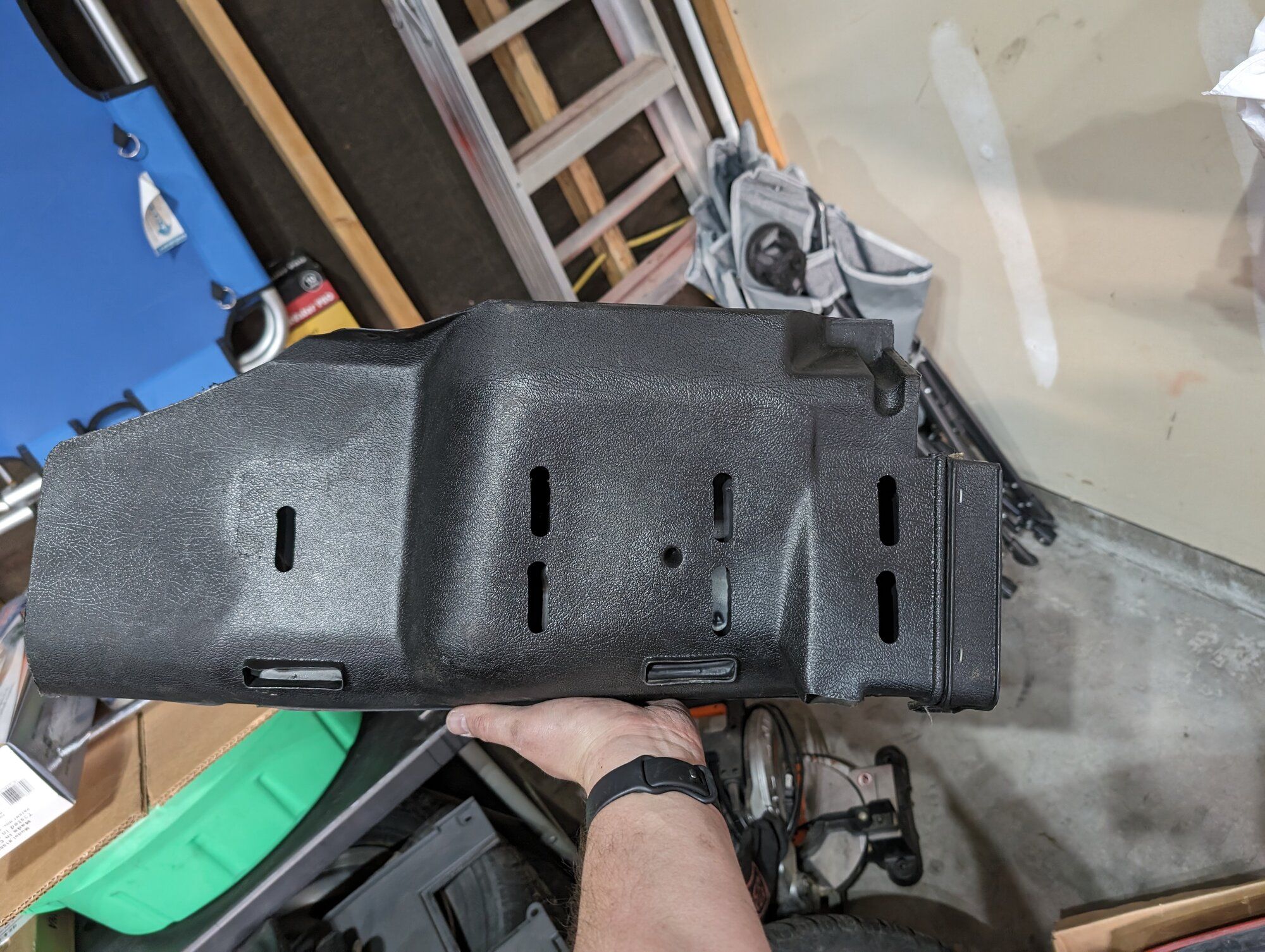

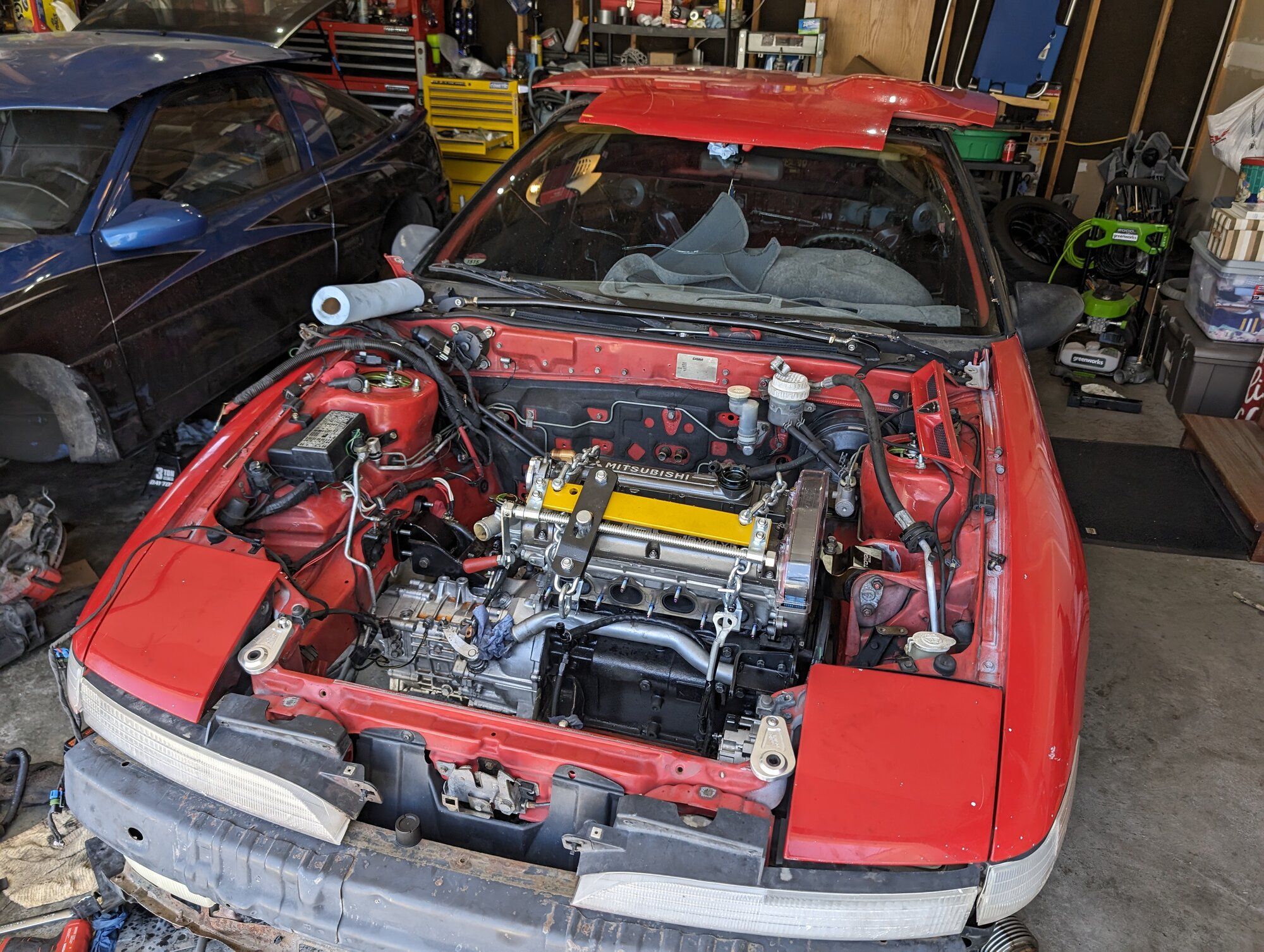

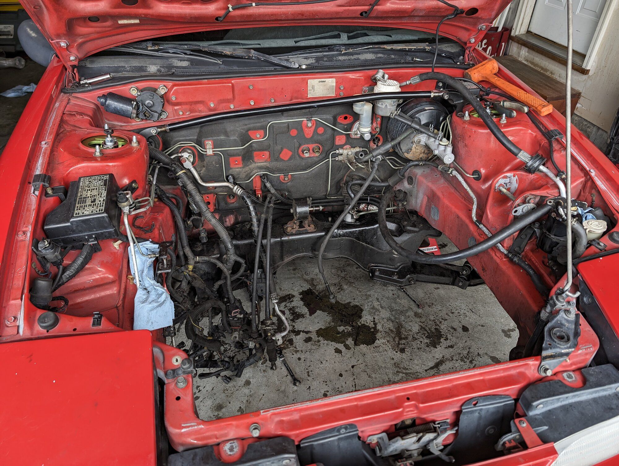

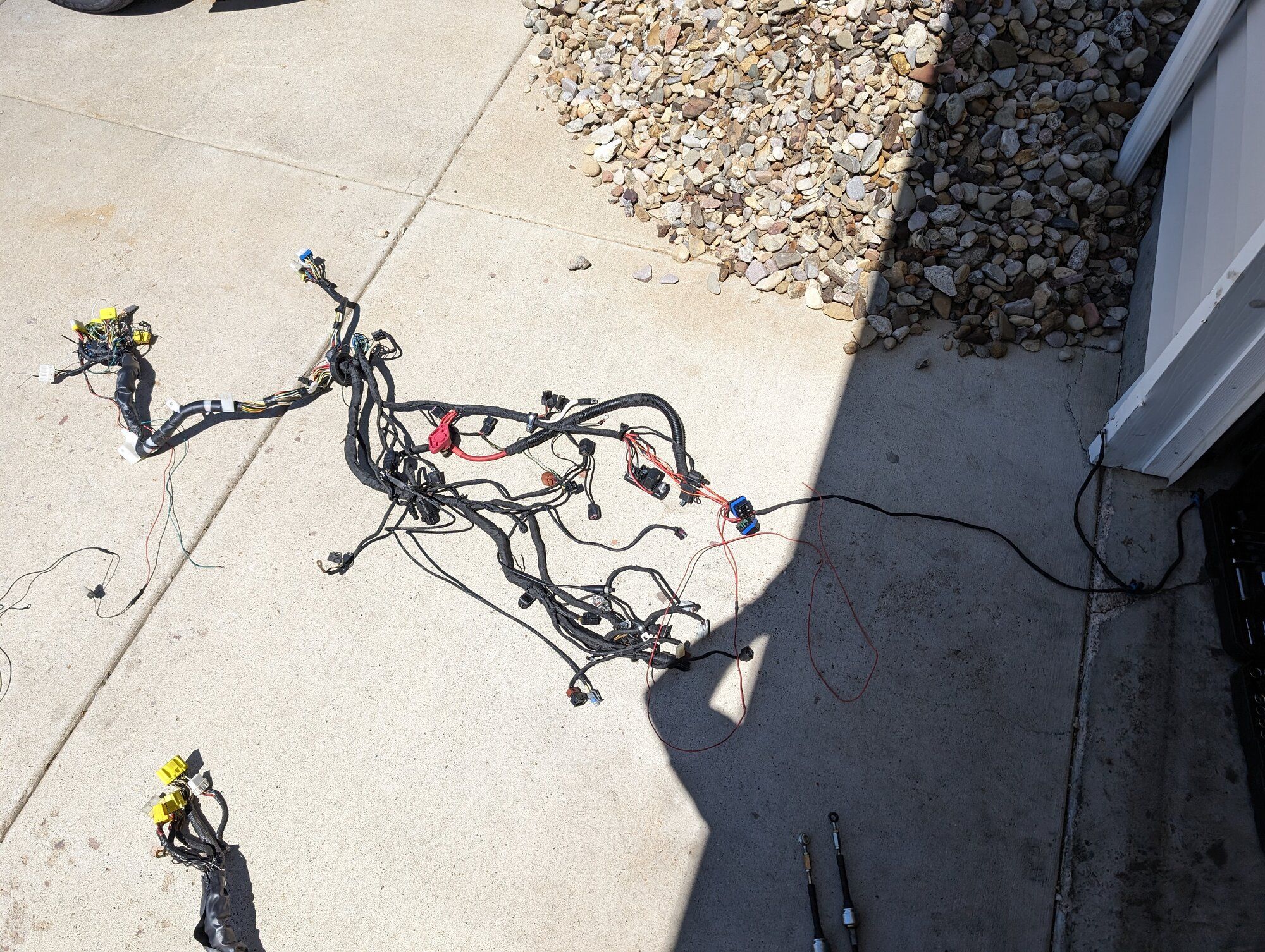

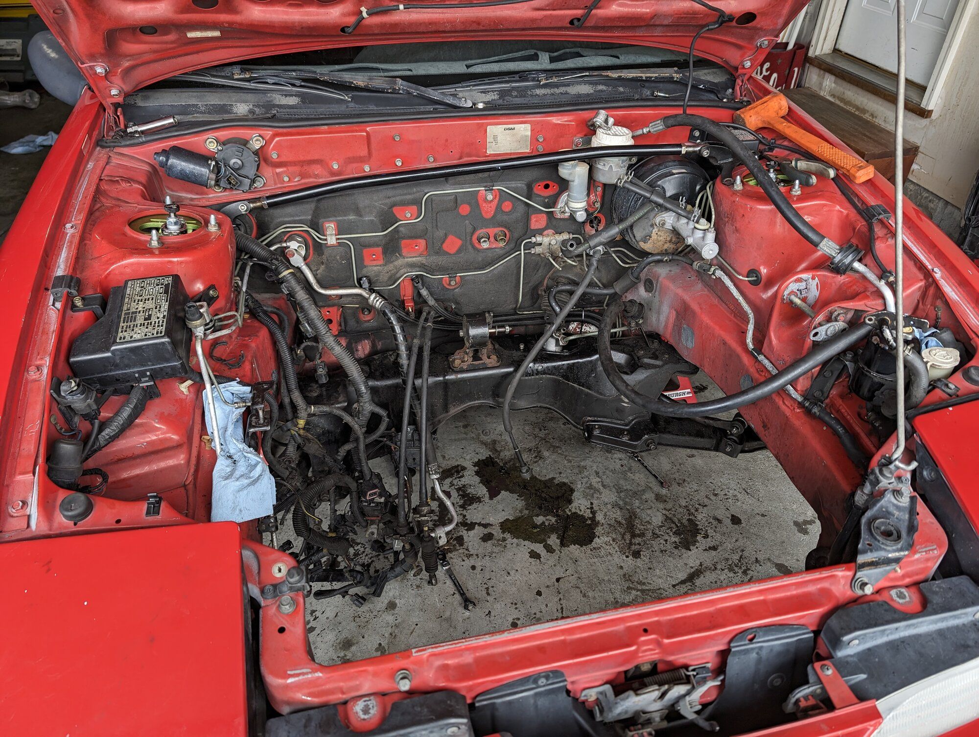

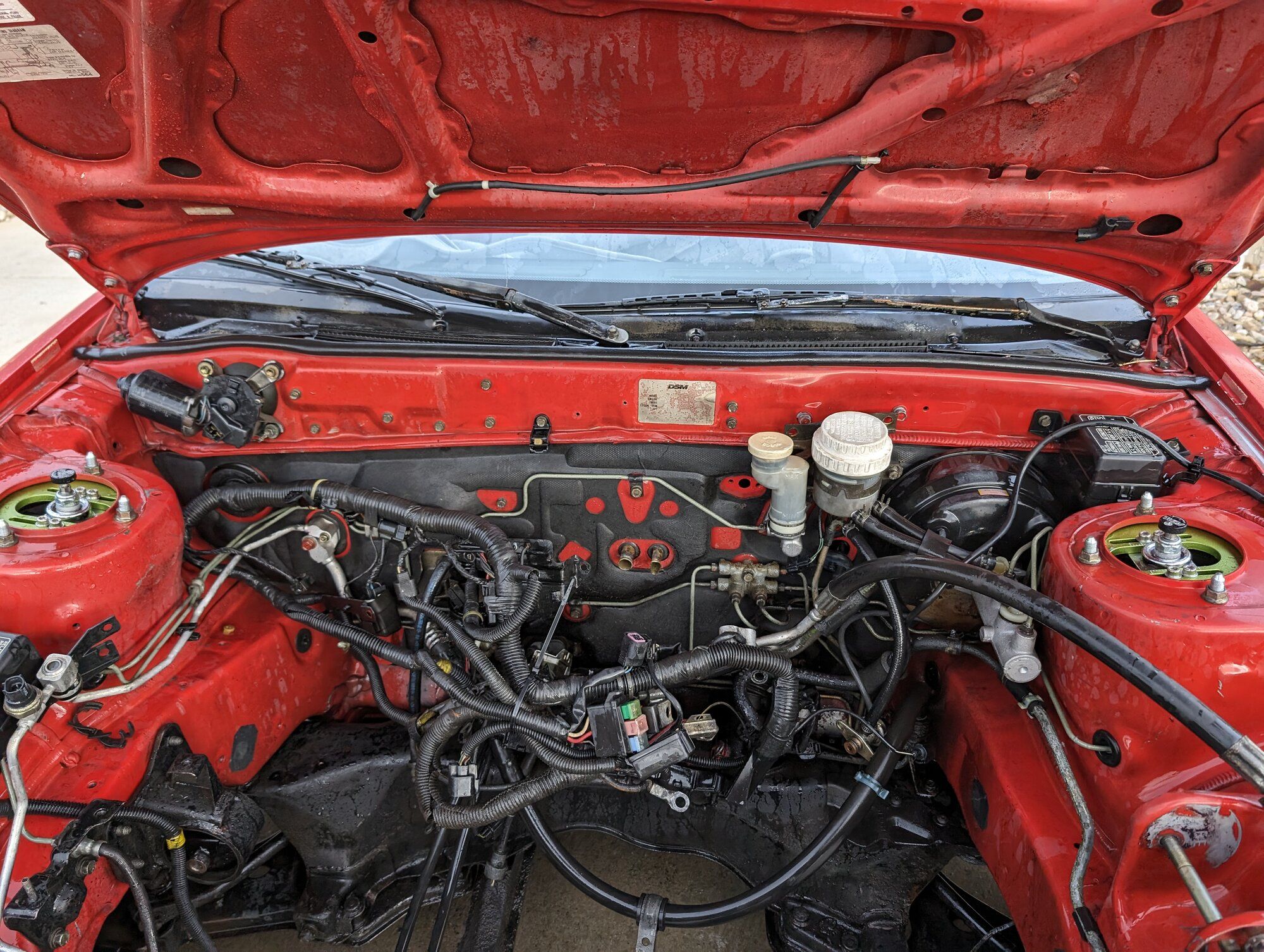

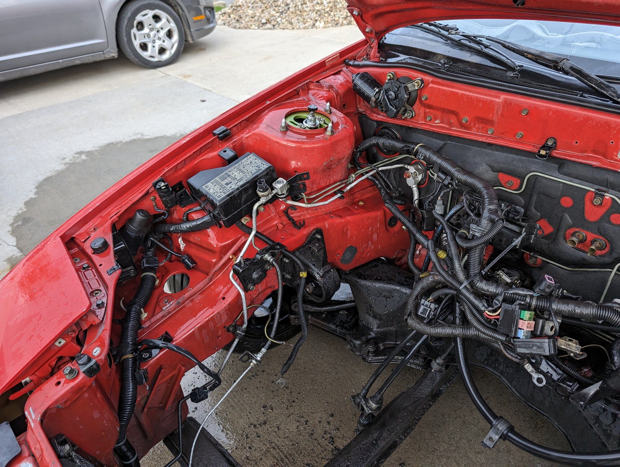

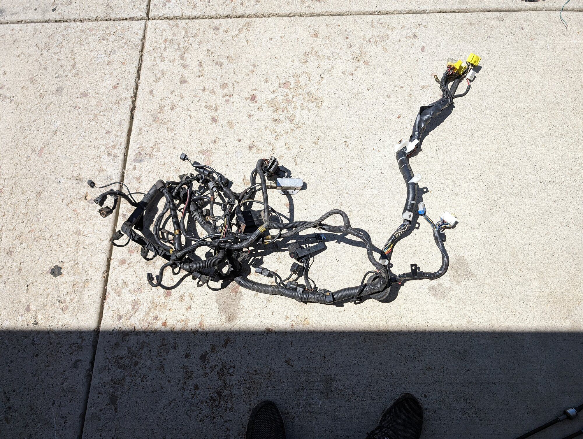

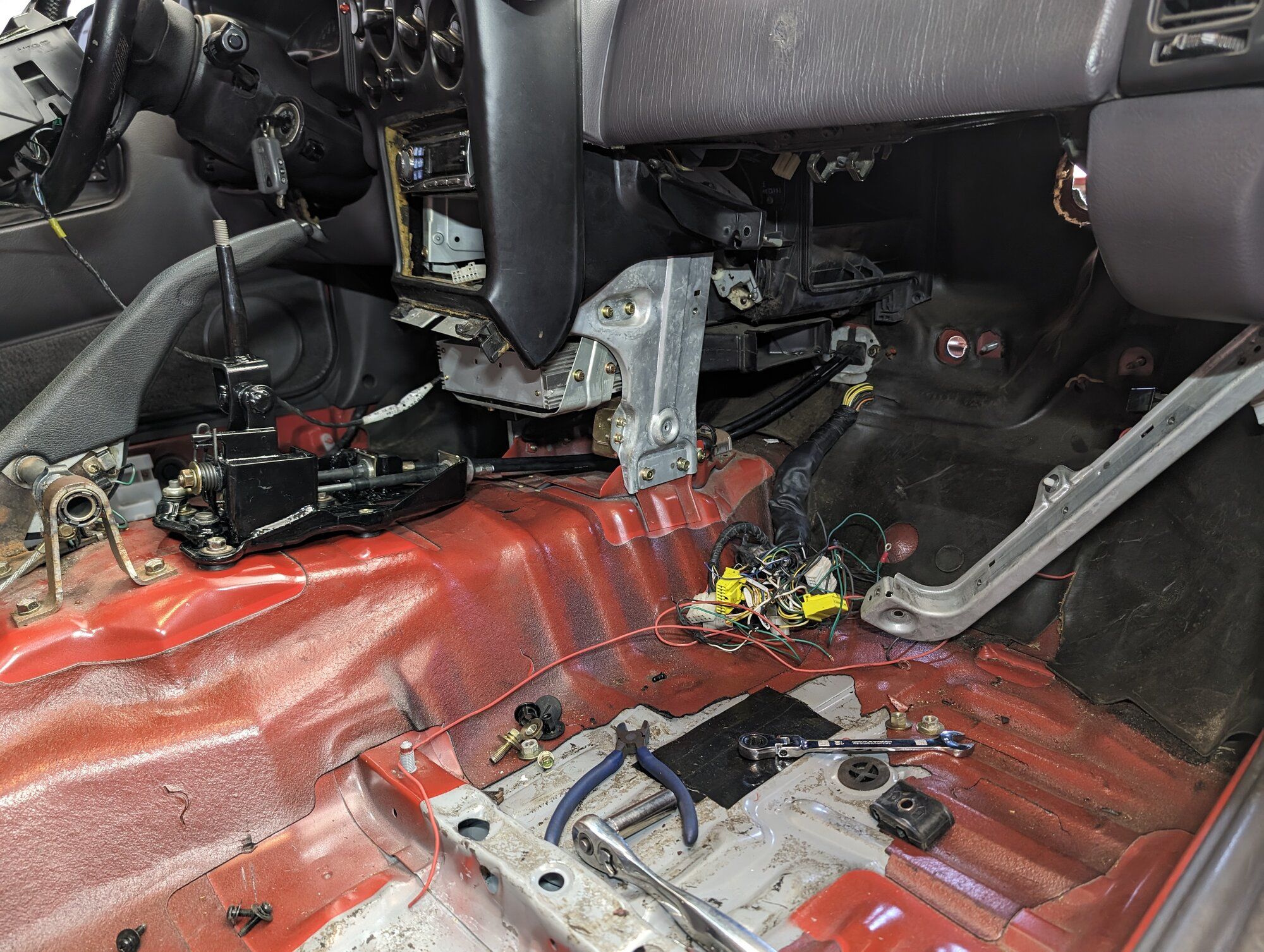

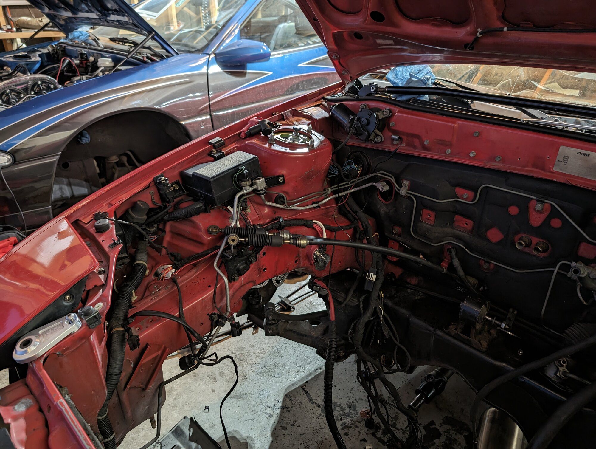

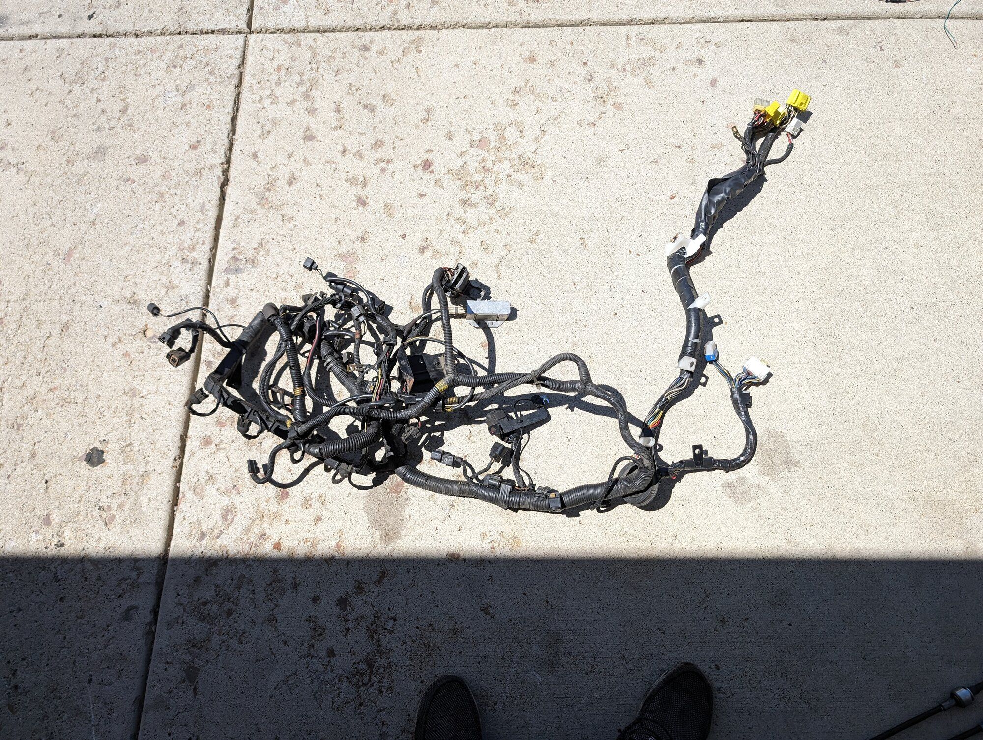

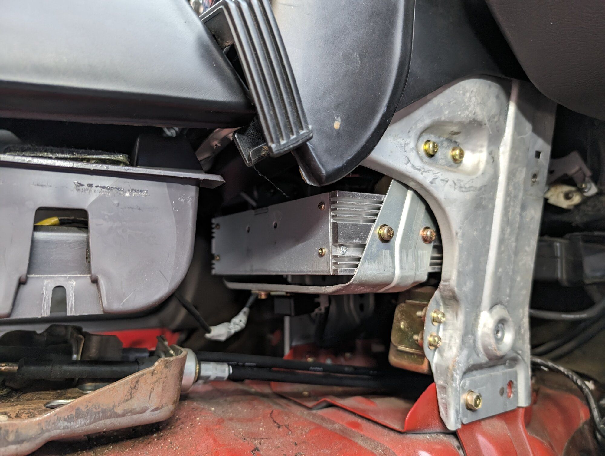

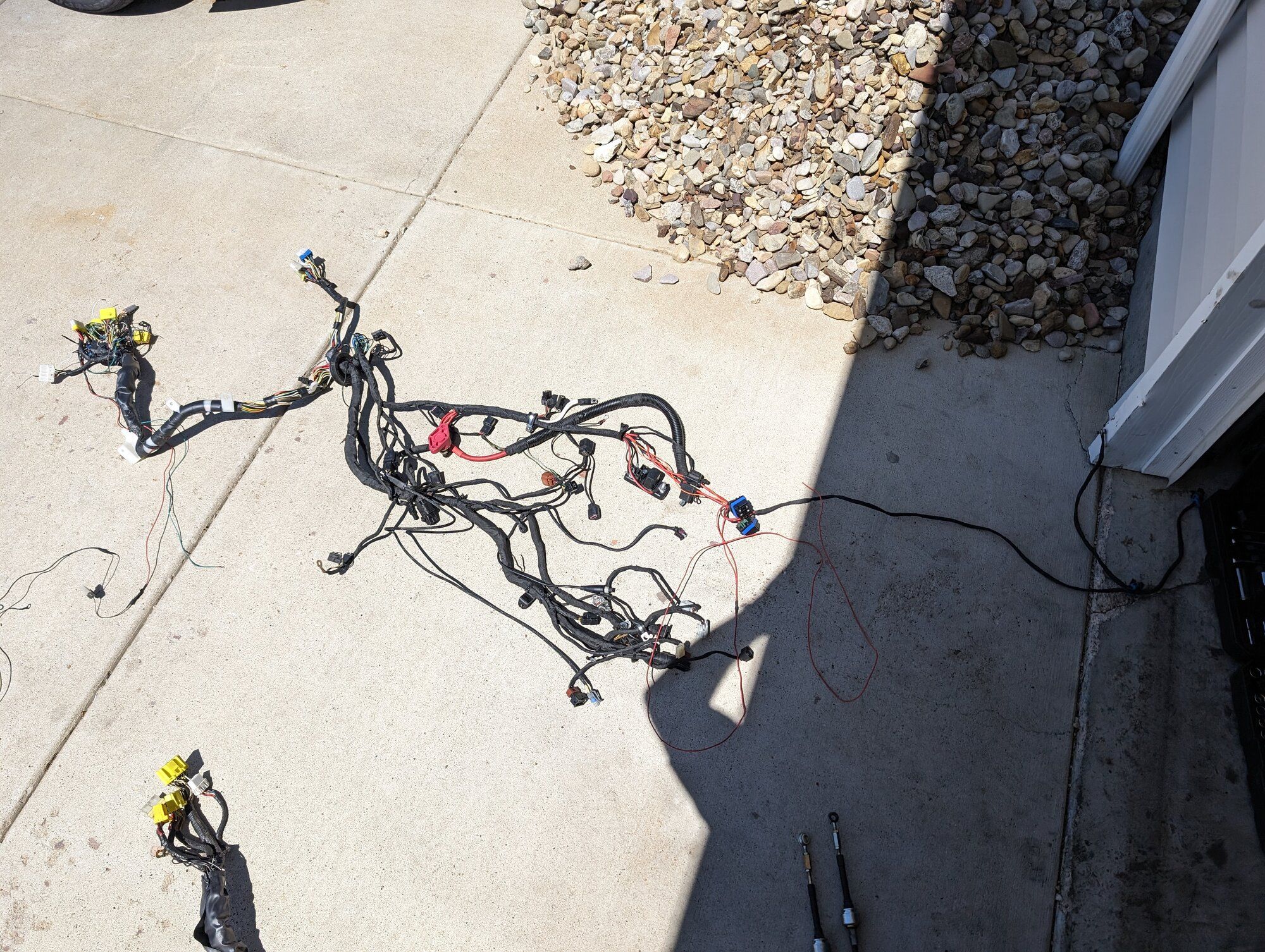

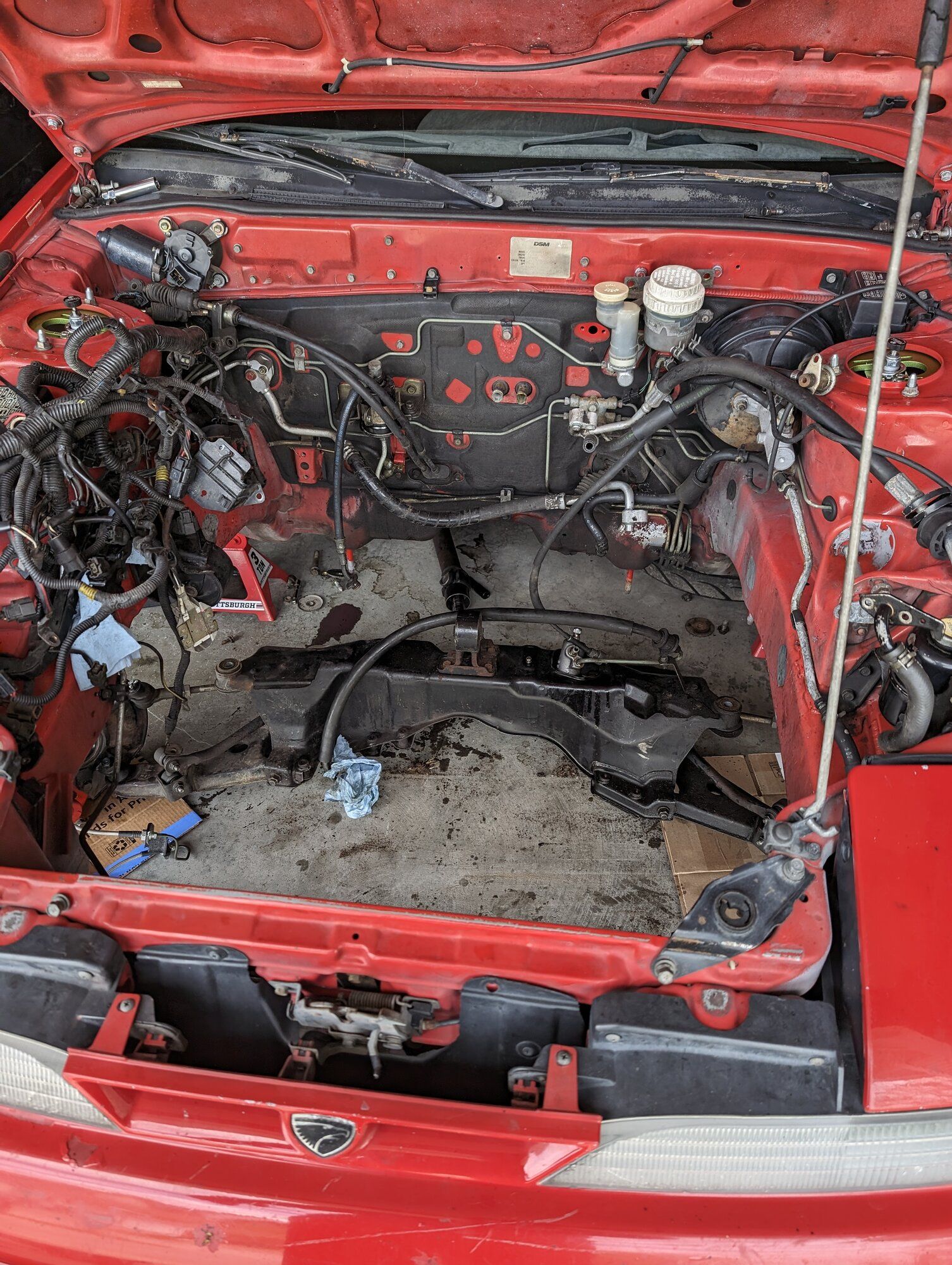

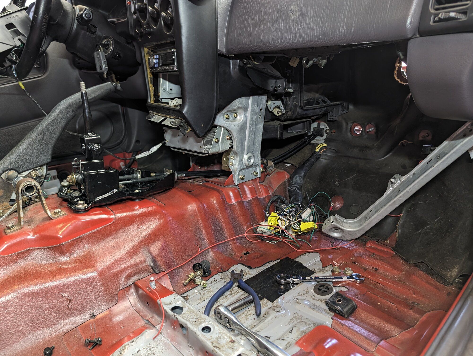

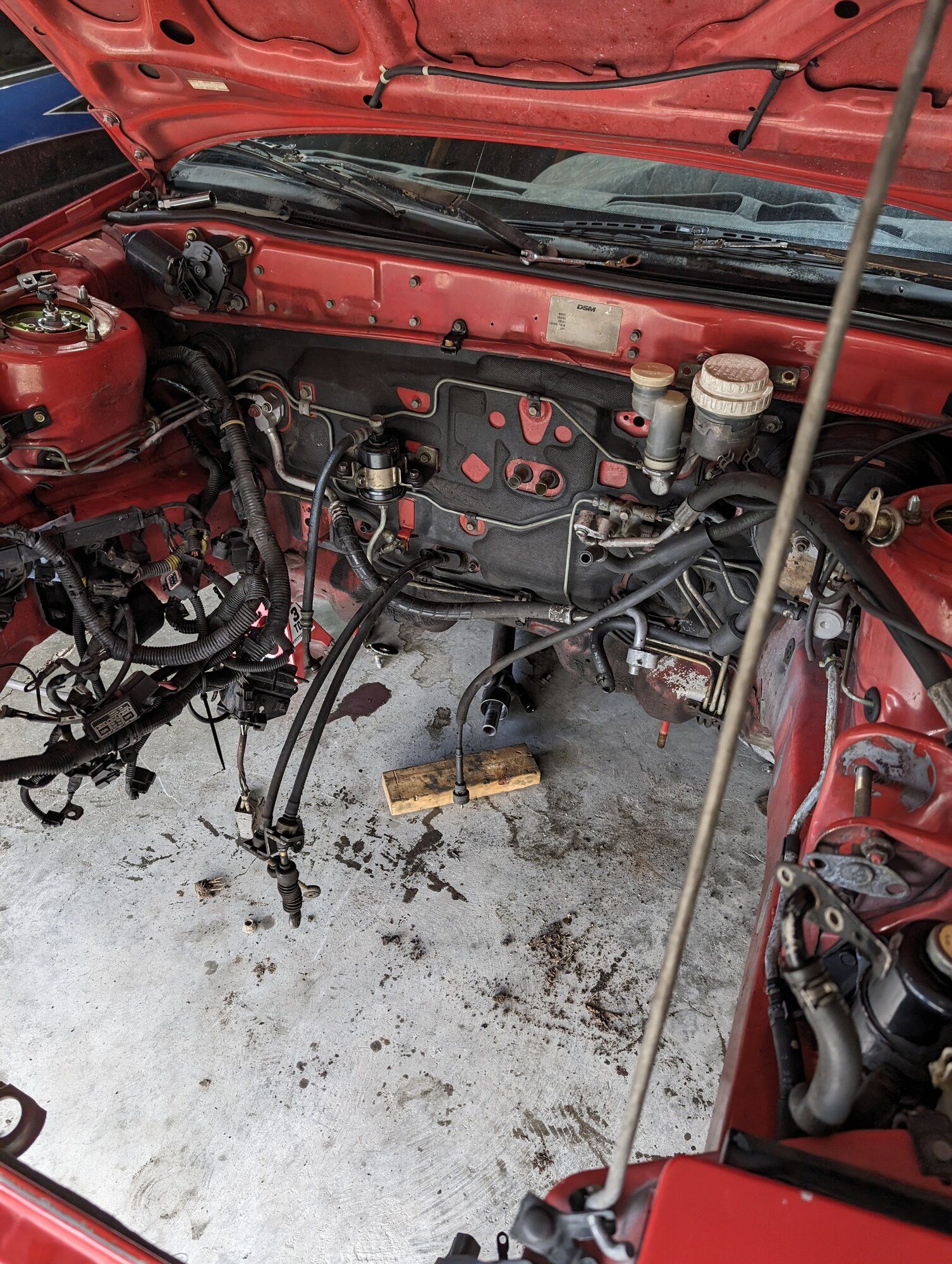

Got the wiring harnesses swapped, fuel tank in, shifter and cables installed into the red car.
PXL_20240510_190115239.jpgPXL_20240510_190112505.jpgPXL_20240510_204051123.jpgPXL_20240511_024514794(1).jpg

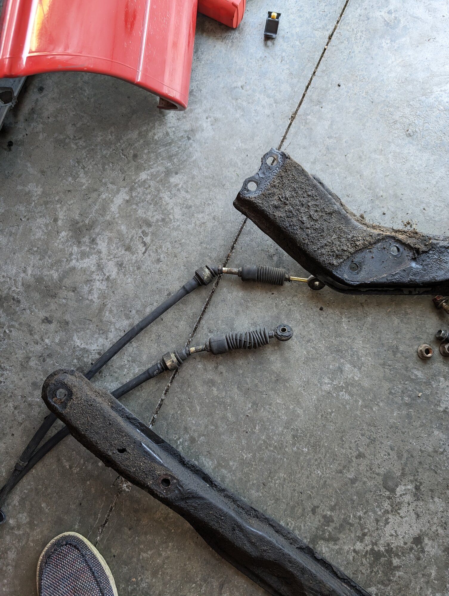

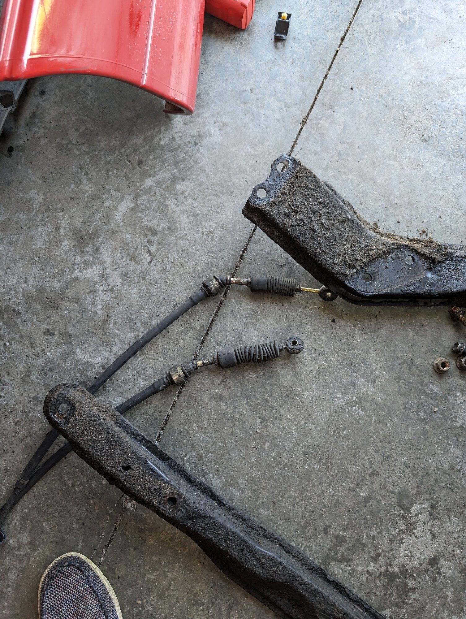

Unfortunately the cables that came out out of the red car were trashed and both bent so they went in the trash.

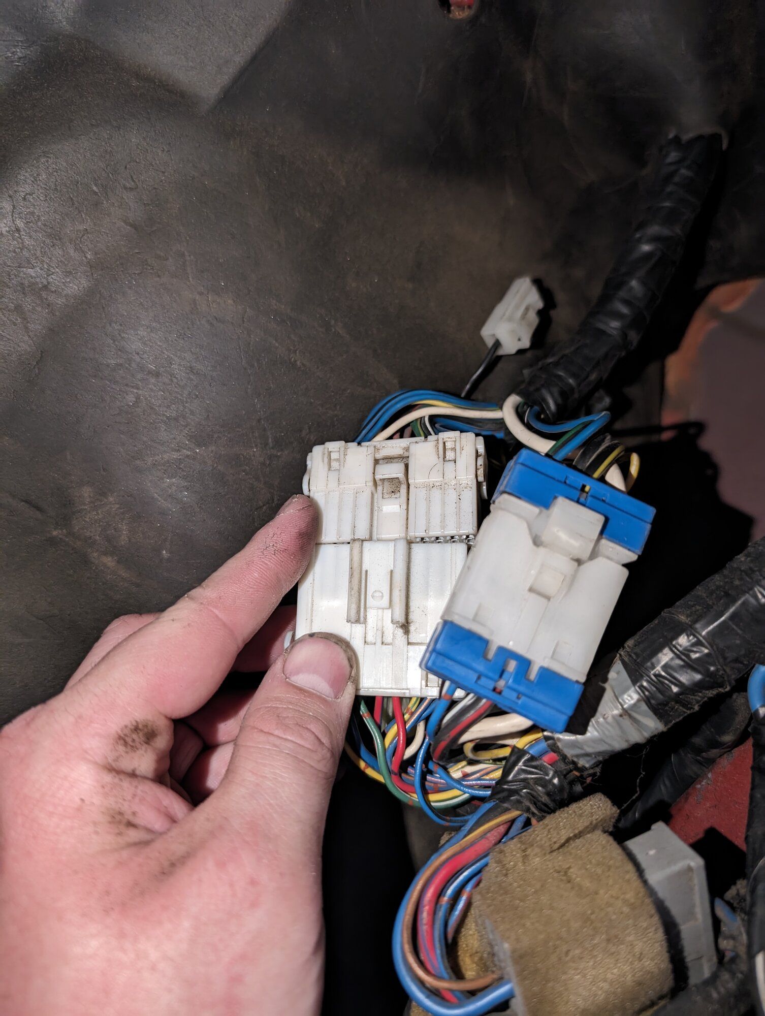

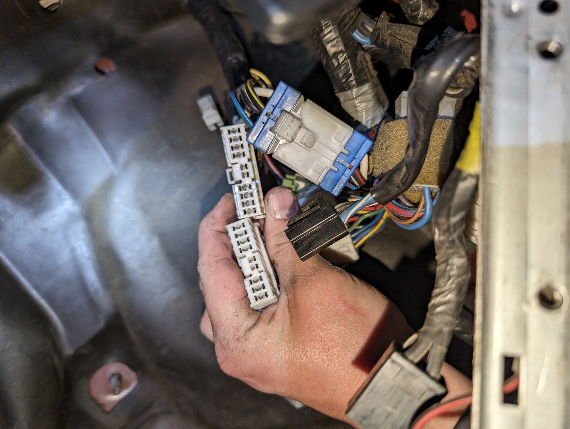

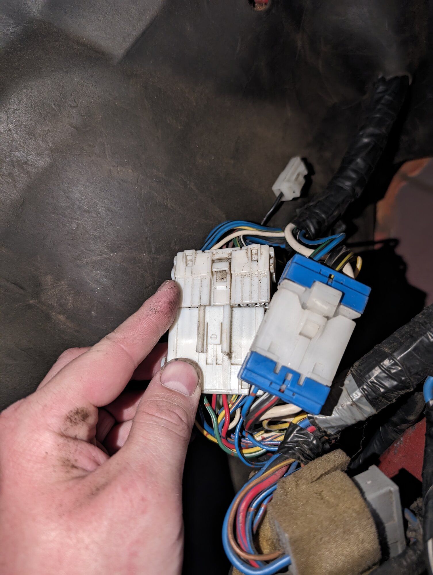

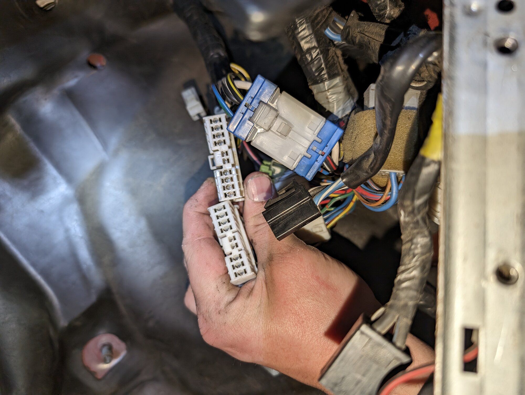

I did notice that one of the connectors on the harnesses are different between the 2 years. After doing some research I'll just have to depin and repin them to each other's harness.

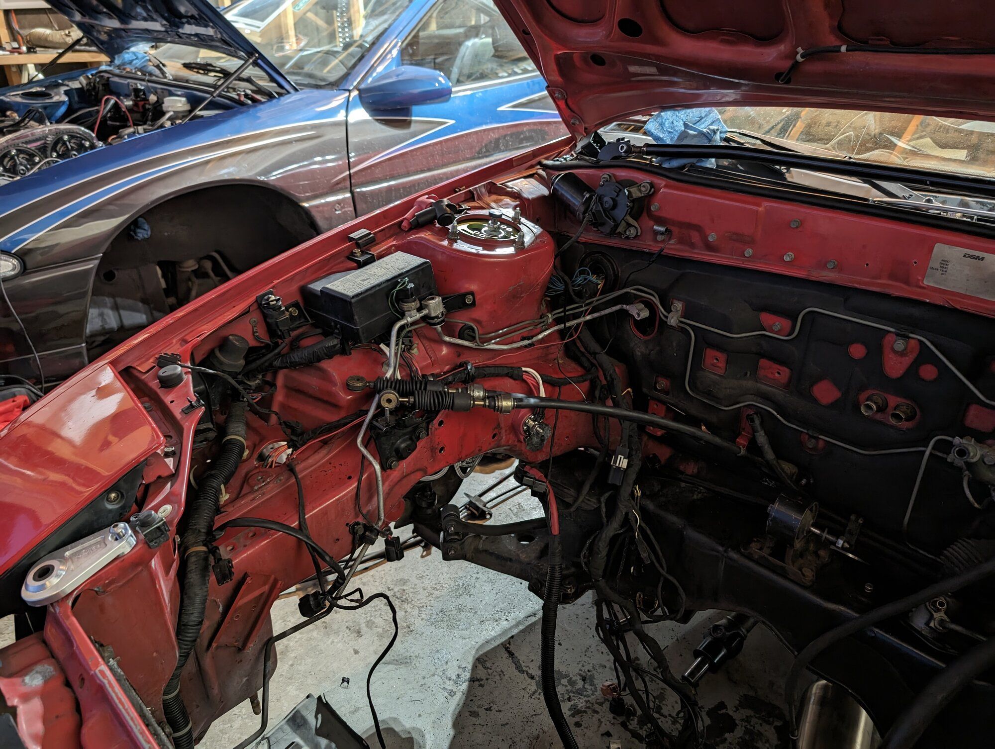

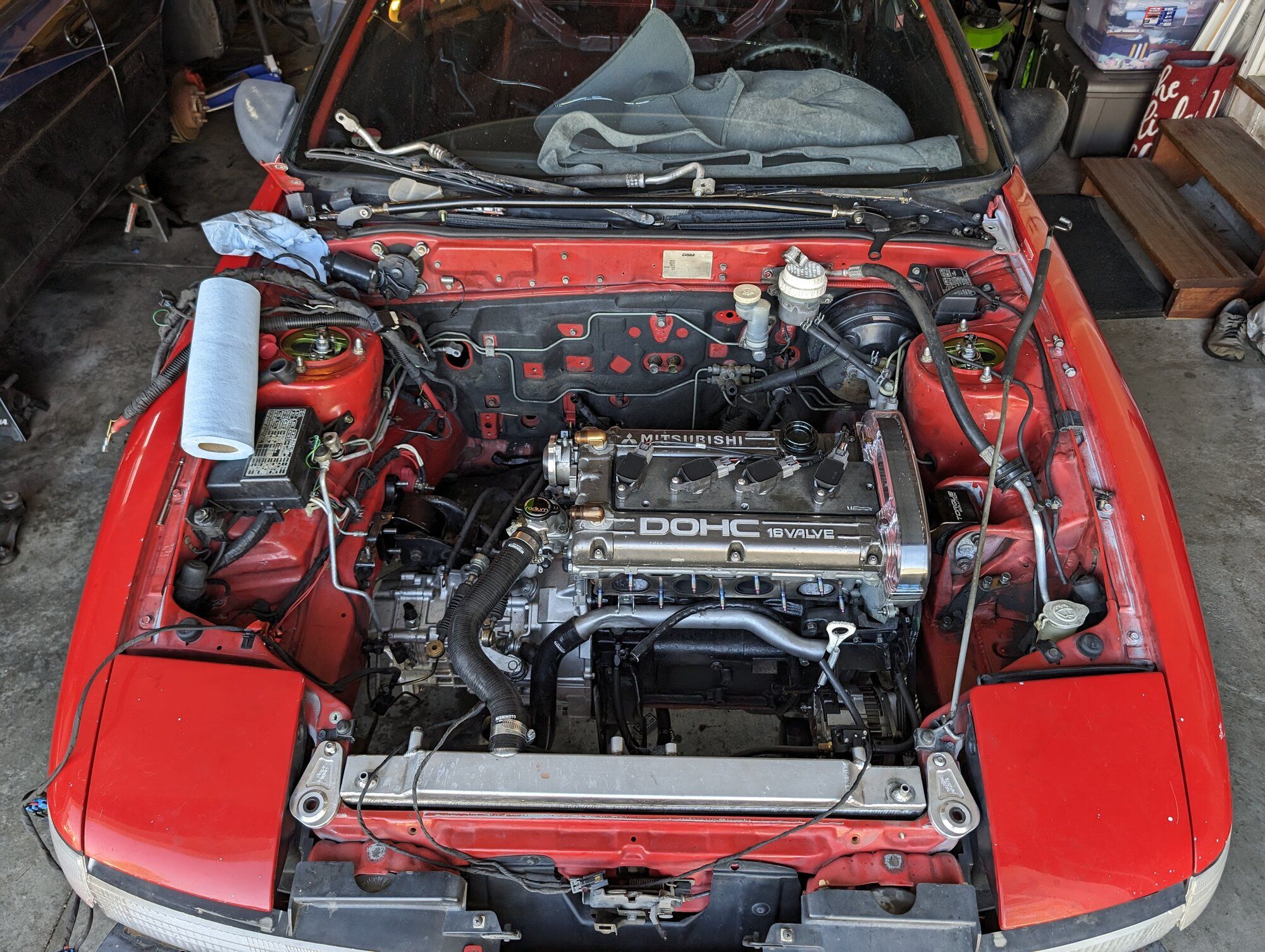

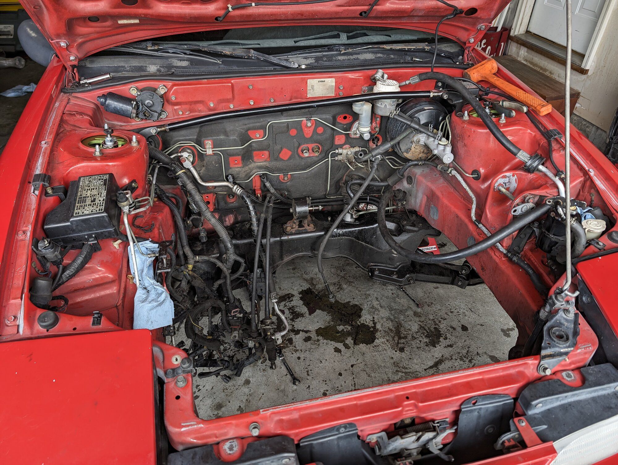

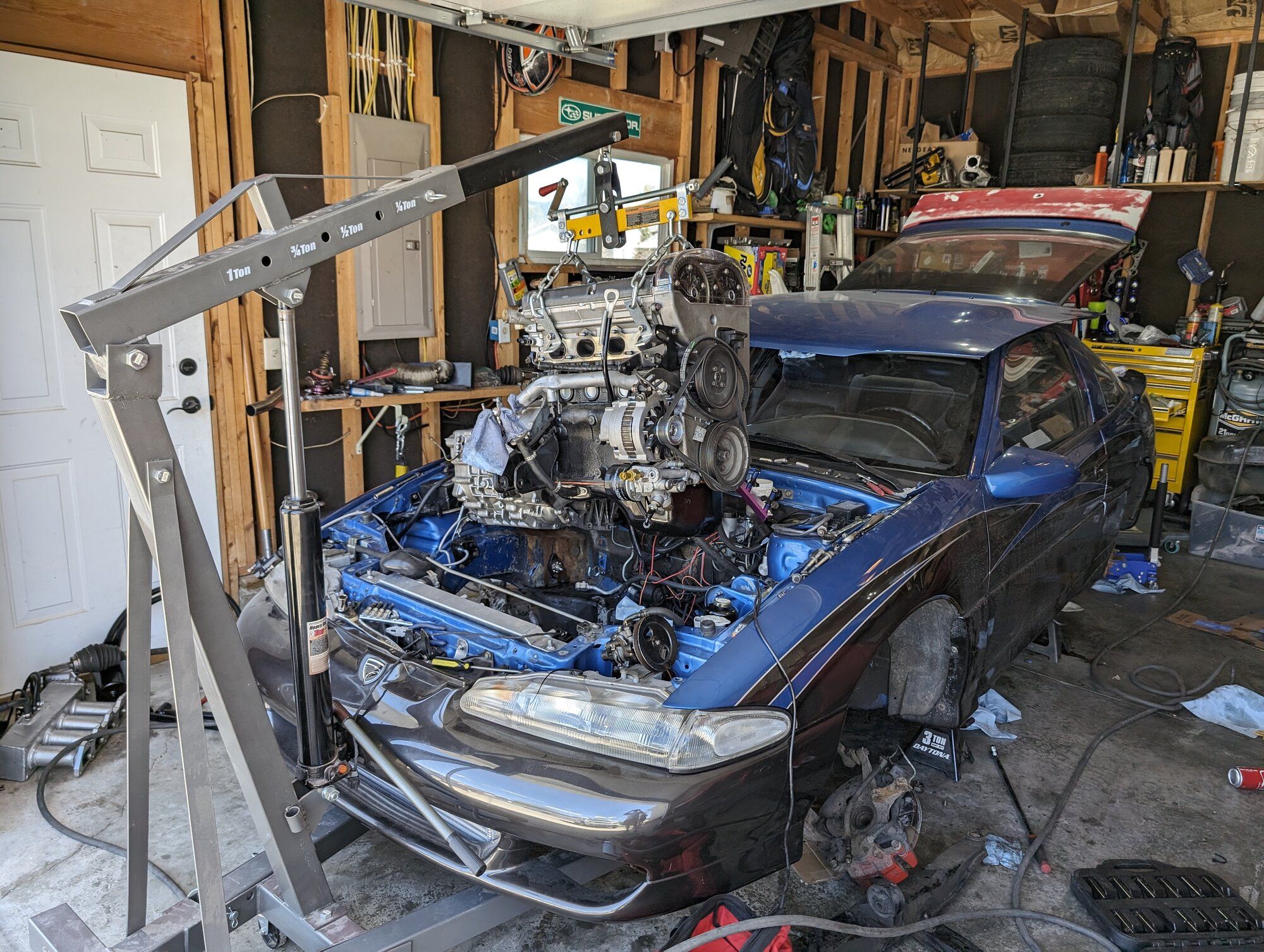

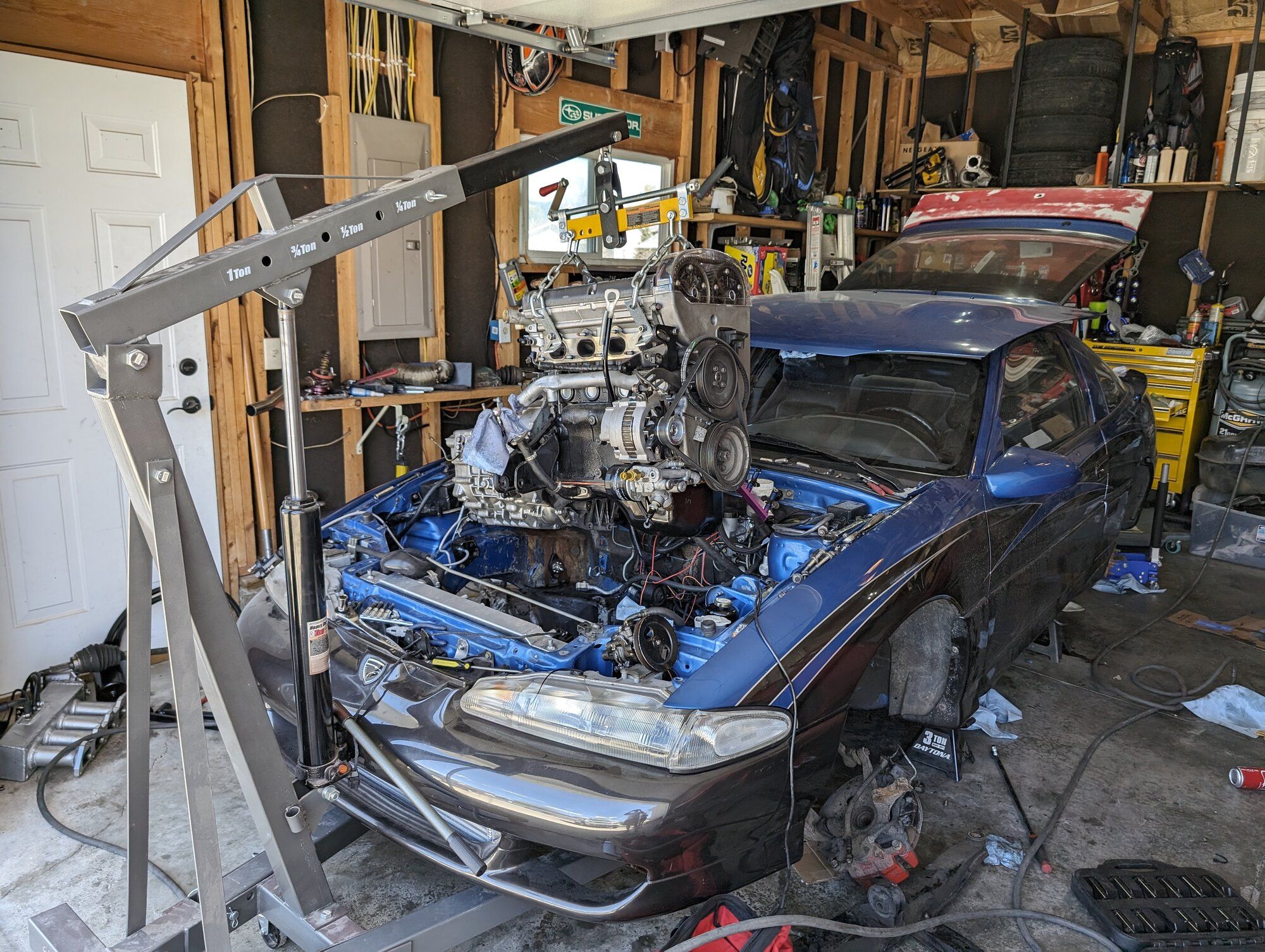

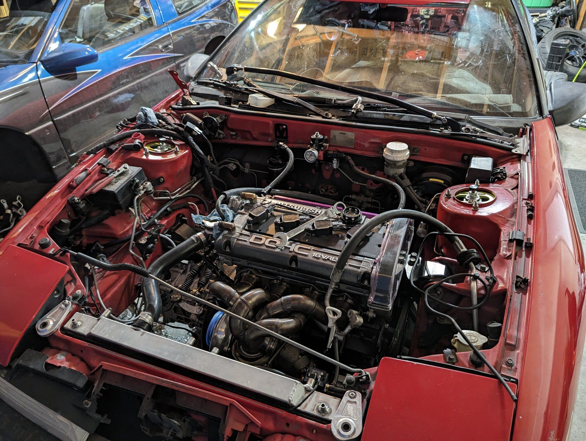

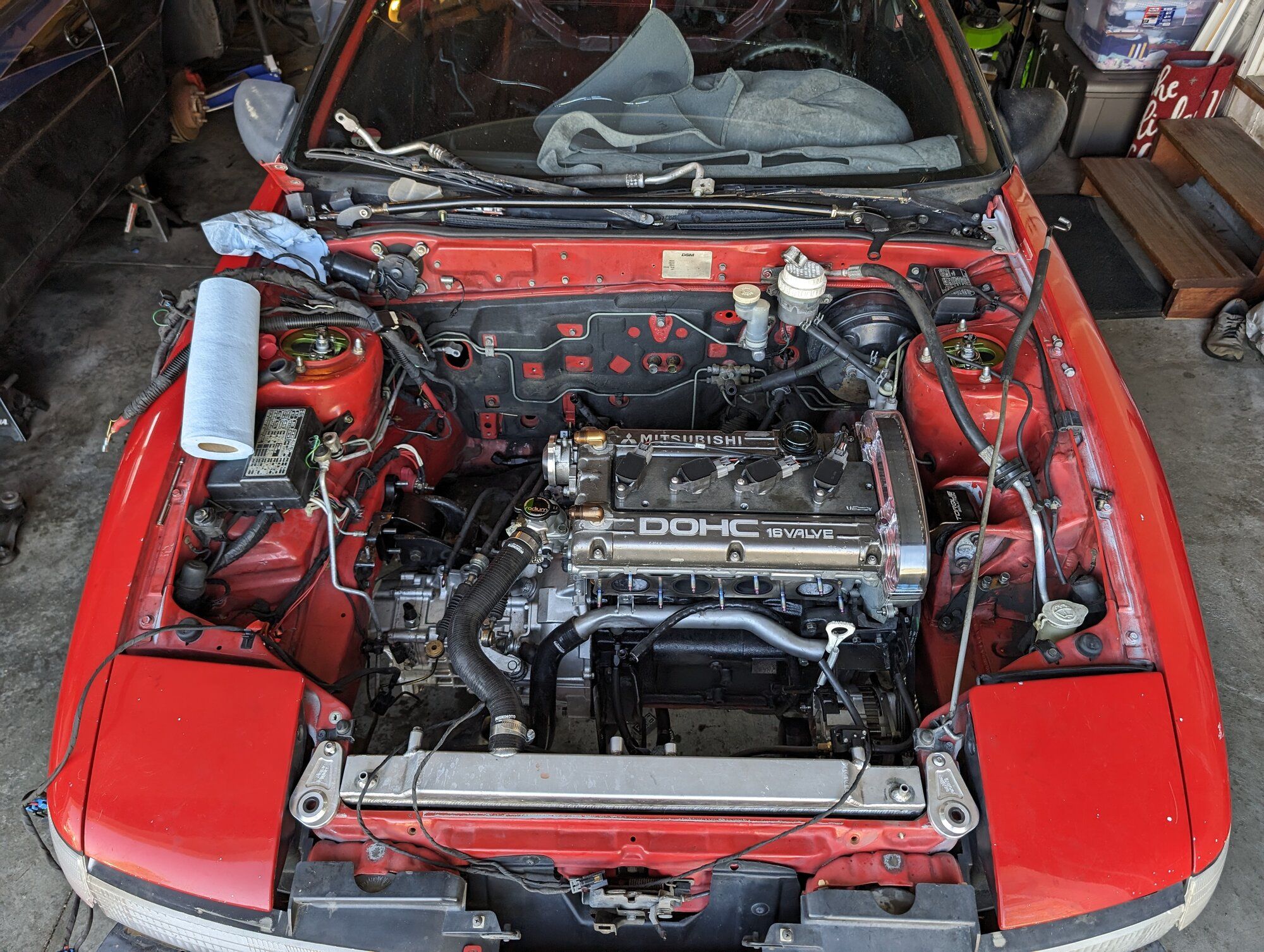

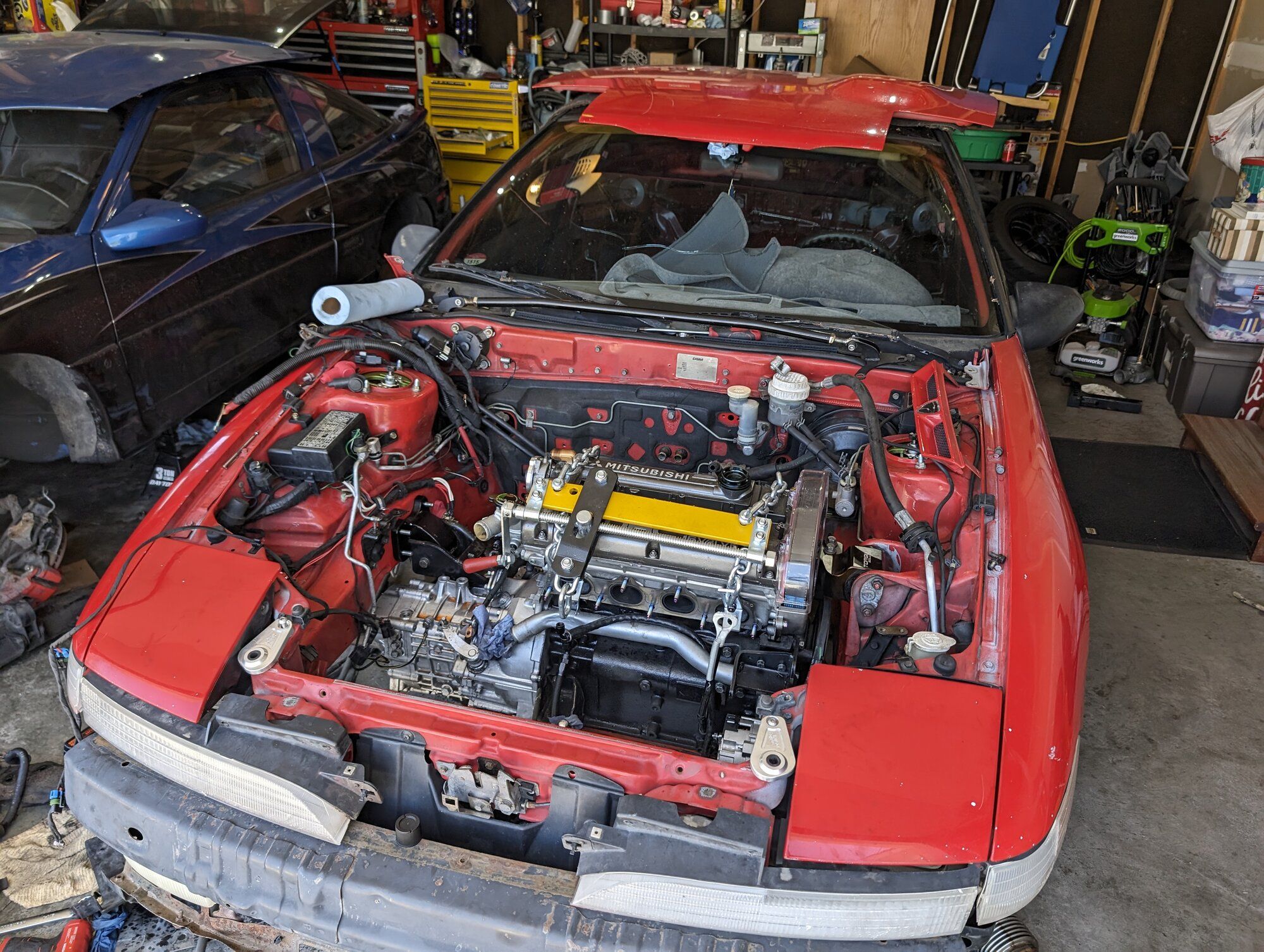

Got the engine and transmission swapped over as well which is a big milestone.
View attachment 731569View attachment 731568View attachment 731570View attachment 731573
View attachment 731572View attachment 731571
View attachment 731574View attachment 731575View attachment 731576
Jesus, you're serious about this. Lol. Great progress so far!
Enjoy the wiring thing, I'm in the same/current boat with mine. It's a bastard-ized hybrid of 90 and 91-94 harnesses interior/engine.
Also: are you letting the clear cover be self-clearanced by the cam gear bolts? Is it an eBay/knock-off unit? It looks great. I'm infinitely envious of your transmission.
Sure am! I really wanted to get it done by this Saturday for a cars n coffee but I'm not sure that's gonna happen. I'll try though!
The clear cover is an eBay cover, they seem to fit well enough with a little modifications.
I bolt them up completely and then circle where the cam gear bolts are and then used a step bit to drill it out. Nice thing is, they're like $12 so if you mess one up its not a big deal. https://www.ebay.com/itm/1650705973...MxIdLP-TDC&var=&widget_ver=artemis&media=COPY

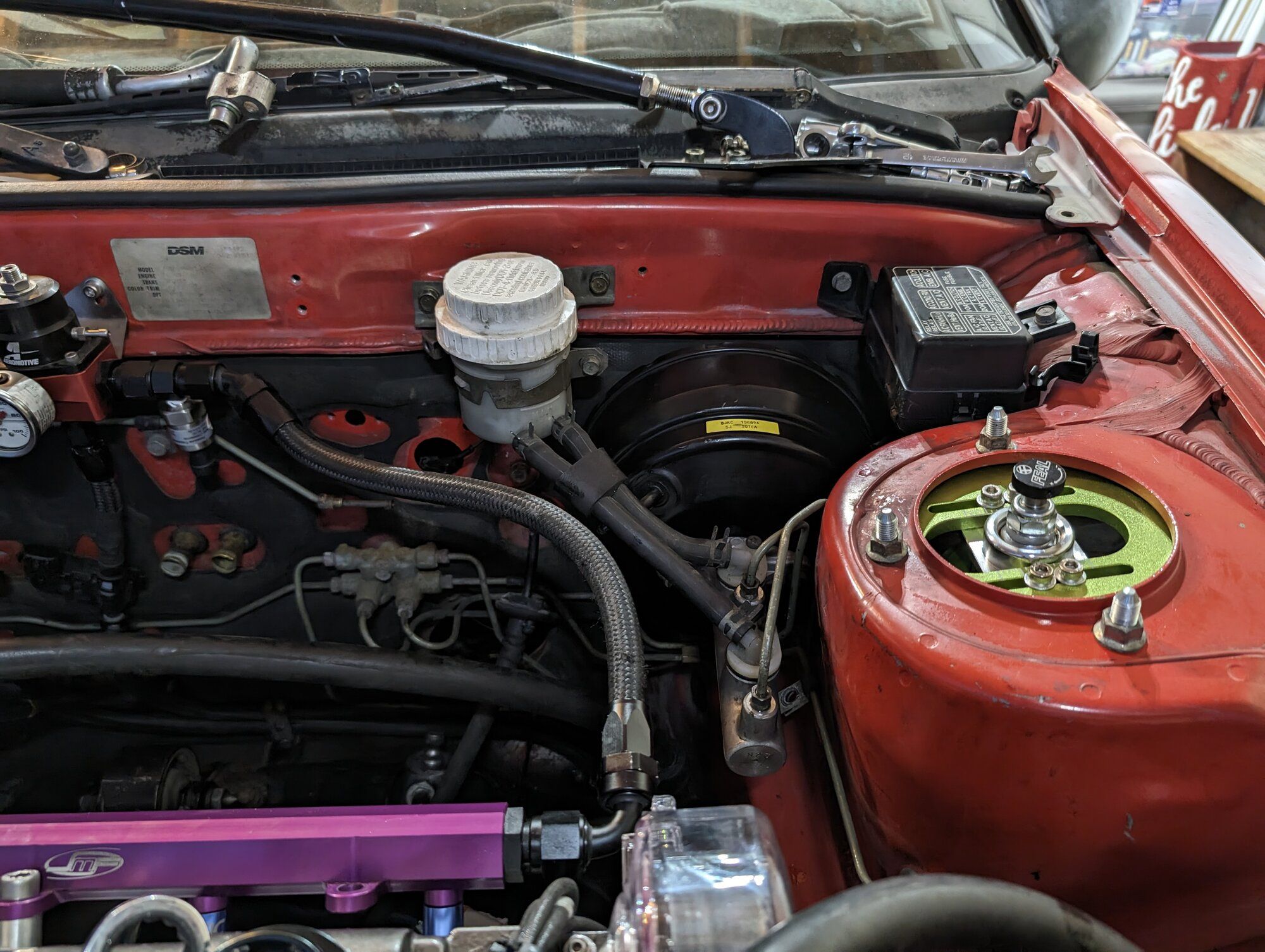

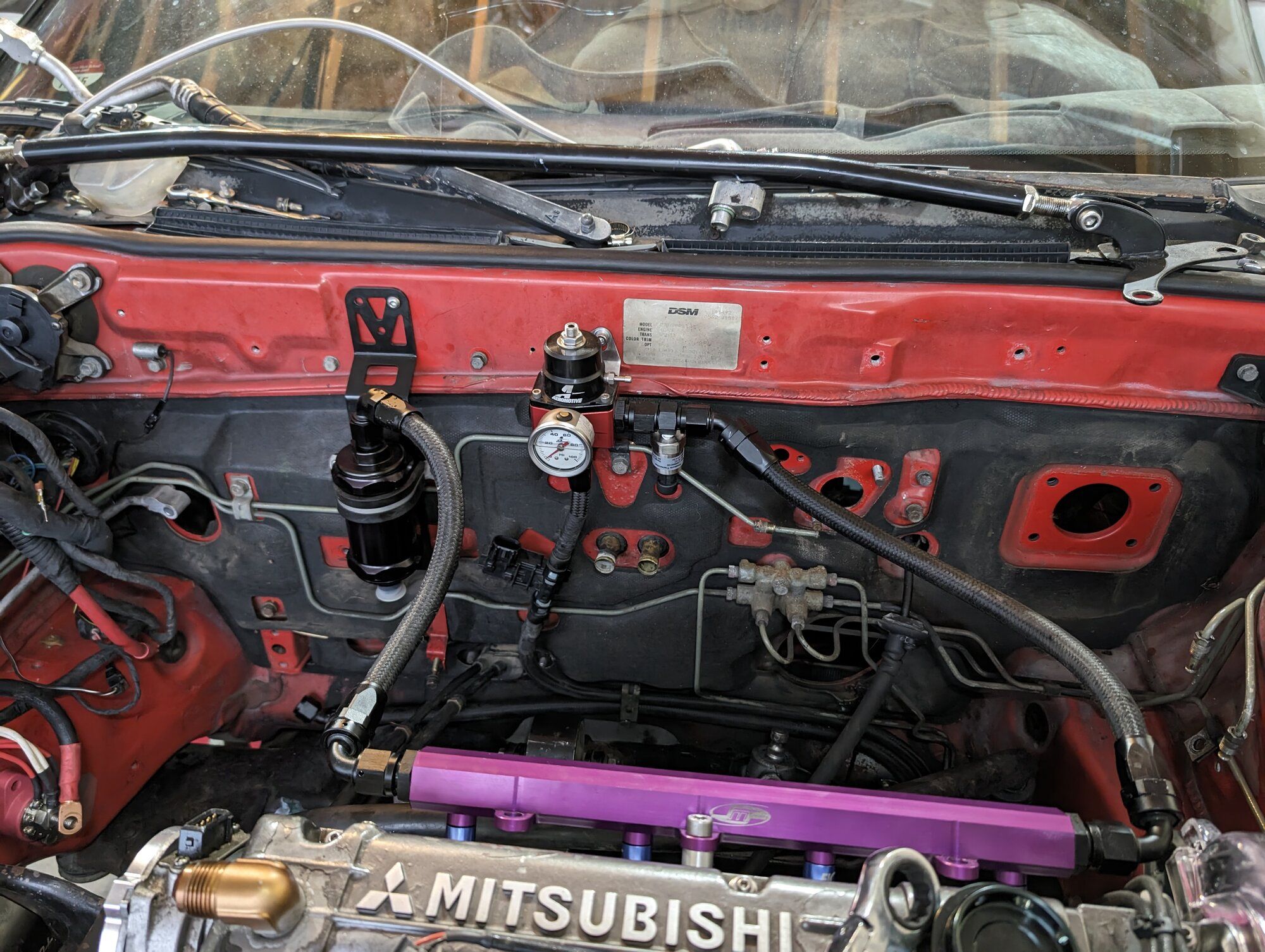

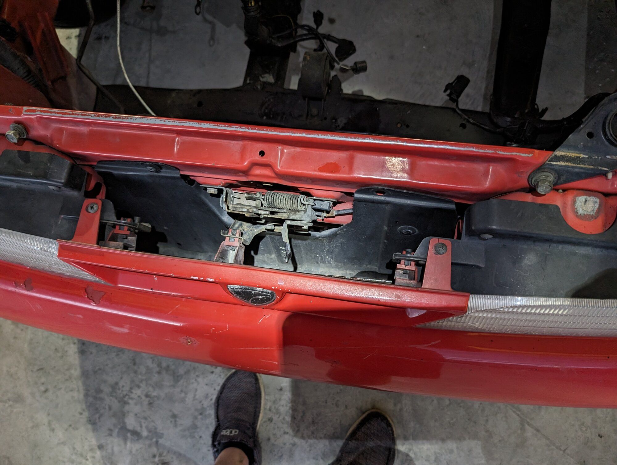

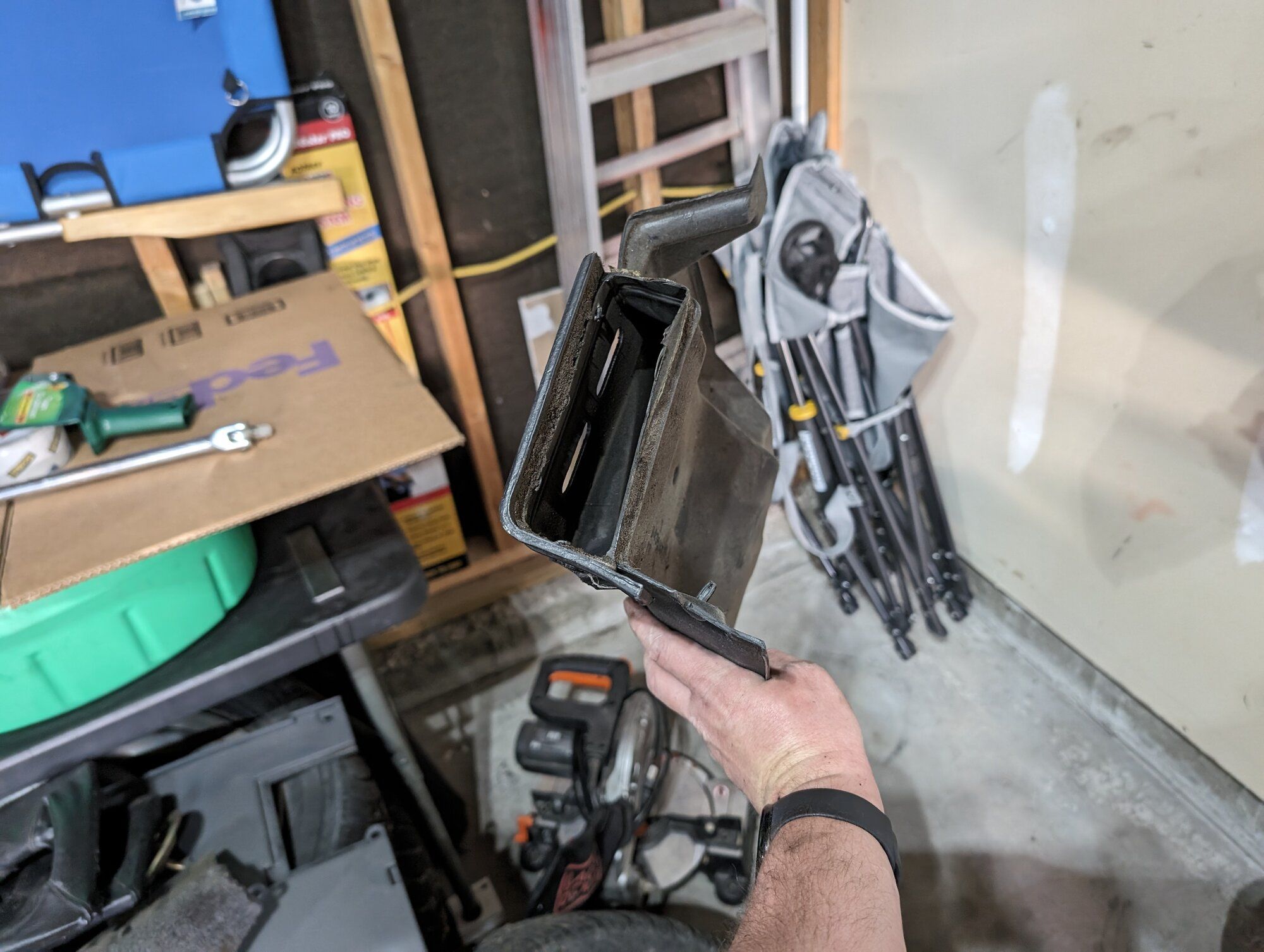

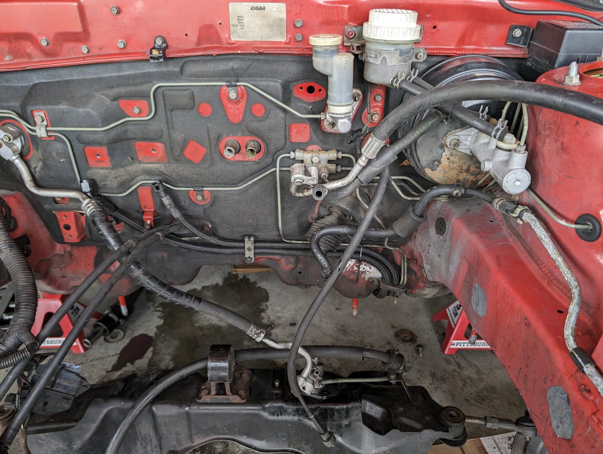

Little bit of progress again last night.

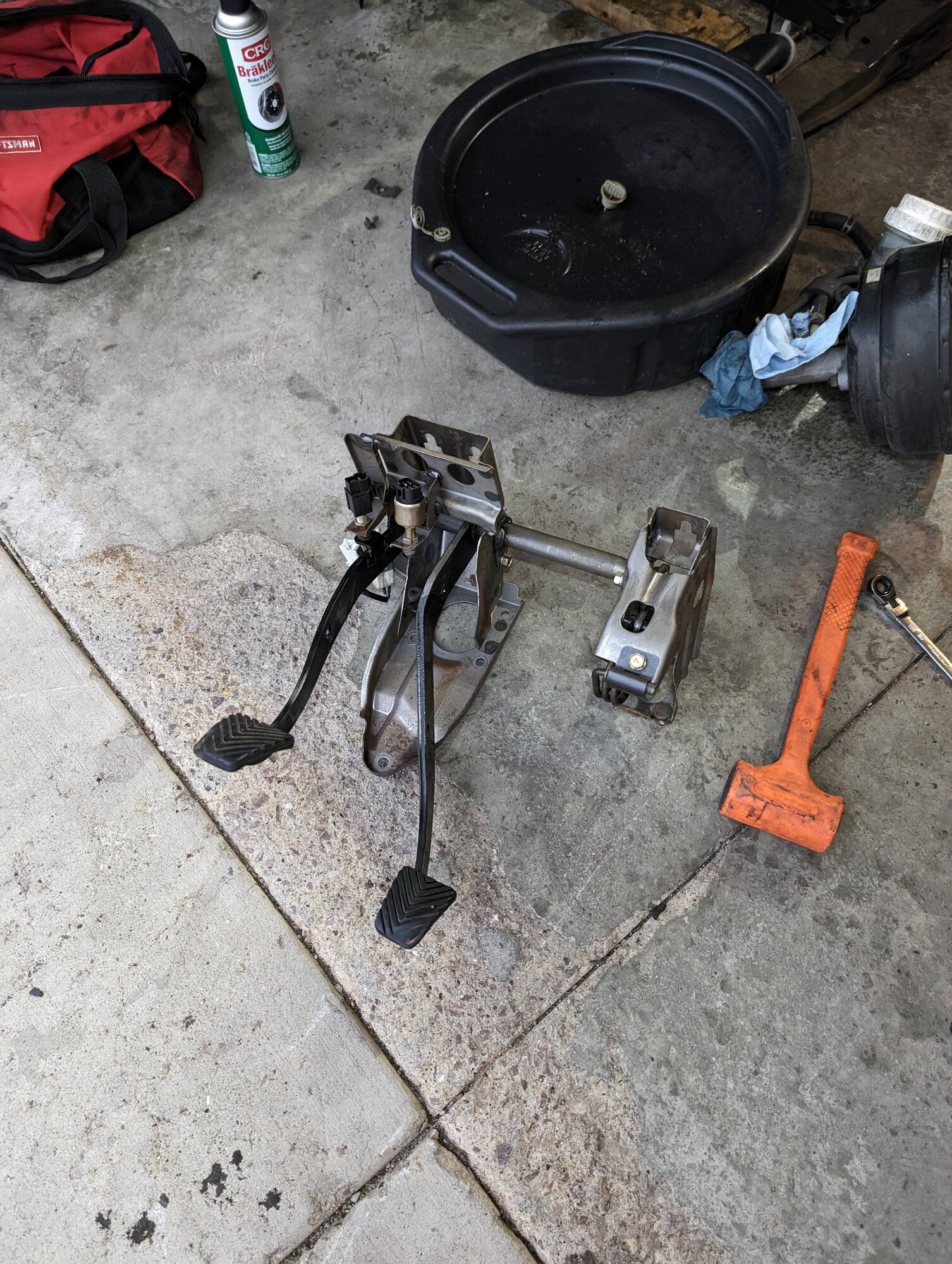

- Swapped out the Brake Booster and Brake Master between cars
- Removed Pedal assembly out of red car - This is SOO much easier with the brake booster removed.
- Got the Fuel Pressure regulator and filter mounted
- Shifter Cables mounted to transmission
- Front Crossmember/Engine mount installed

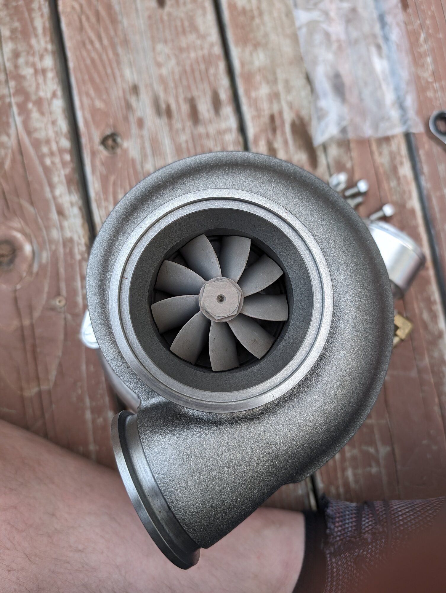

- Turbine Housing on turbo swapped
- Turbo lines connected and Turbo mounted
- Downpipe connected
- Alternator main wire routed and connected
- Clutch Line connected, slave moved over.
PXL_20240513_012155173.jpgPXL_20240514_012224471.jpgPXL_20240514_013718912.jpgPXL_20240514_020757583.jpgPXL_20240514_023018265.LONG_EXPOSURE-02.ORIGINAL.jpgPXL_20240514_020420873.jpg
Next up hopefully is going to move over my clutch pedal assembly, swap out the Power steering pump and high pressure line and then time to tackle the dash.
I still need to remove the crash bar and swap over the bumper support, and cut out the radiator support for intercooler piping routing.
We're inching closer!
