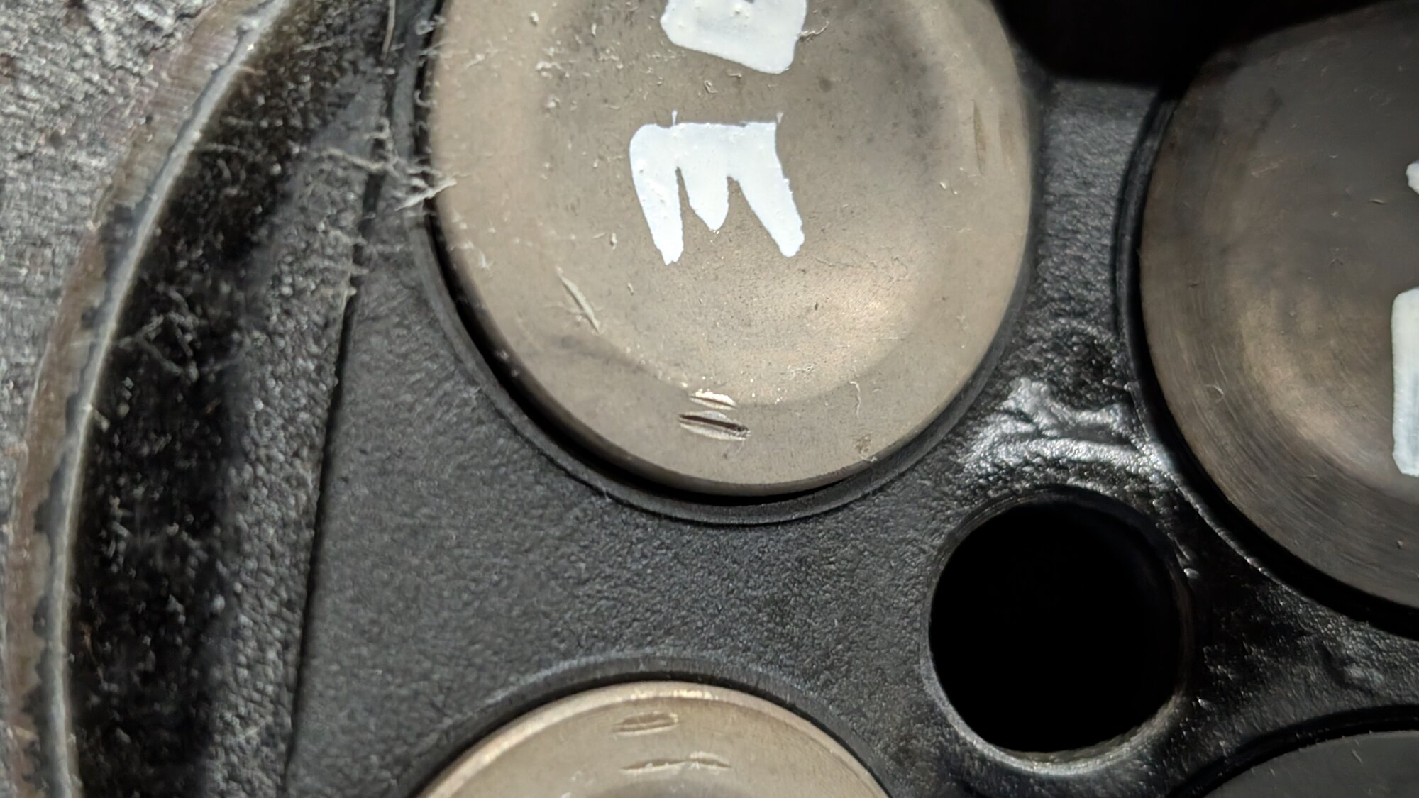

Well I popped the intake valves back in the head. I'm just going to take the whole thing to the machine shop and have them check the seats, guides, and valve faces to see if they either need replaced or ground. No matter what I do I'll be lapping the valves in when I get everything back.

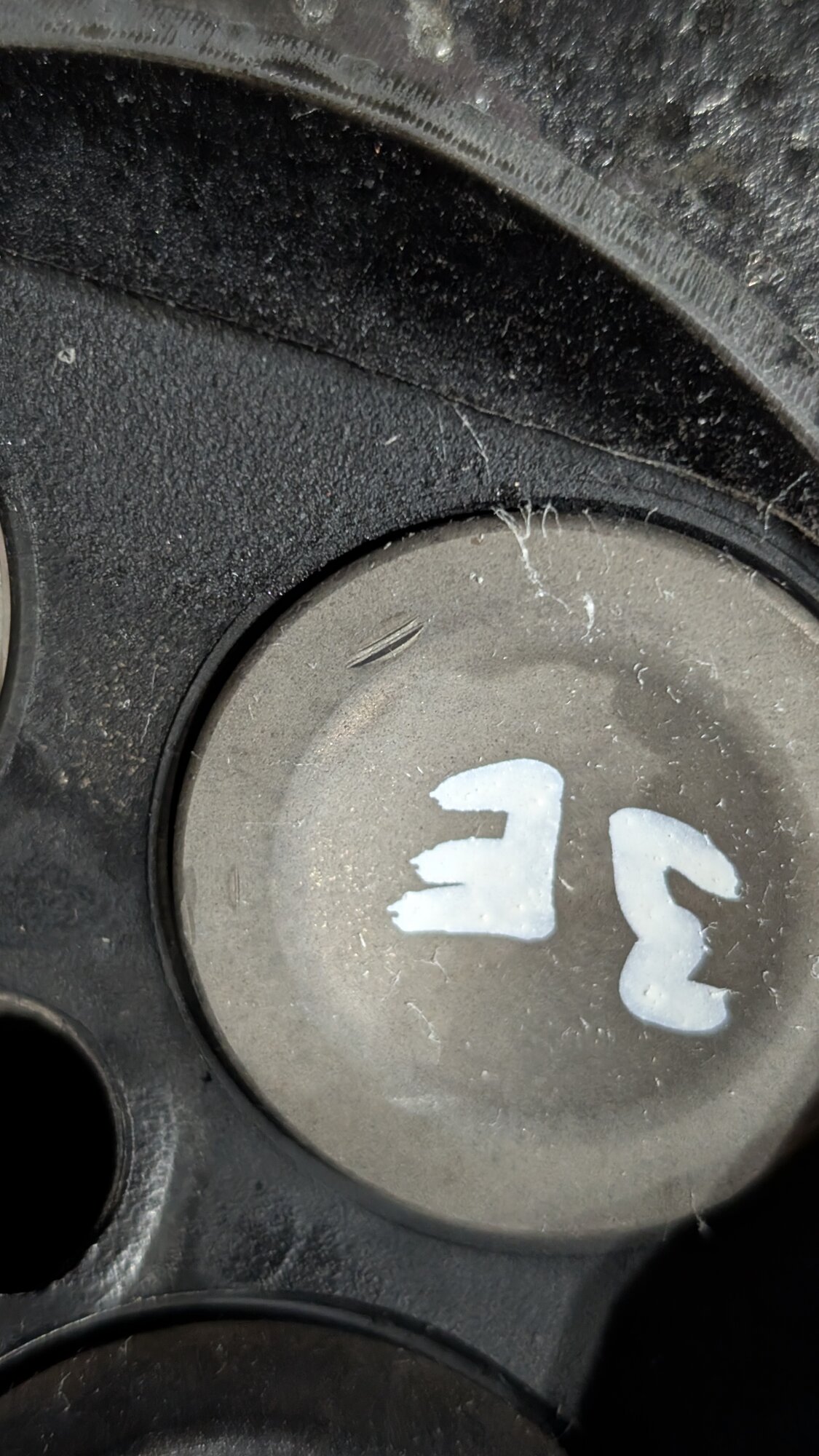

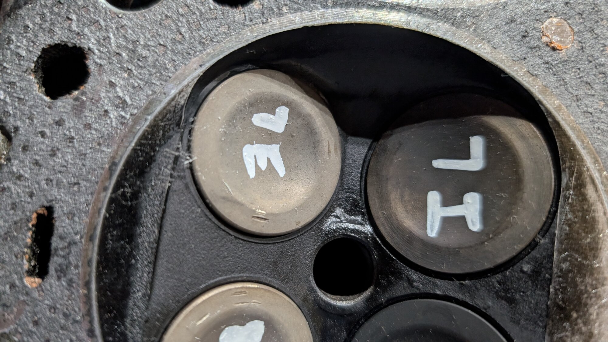

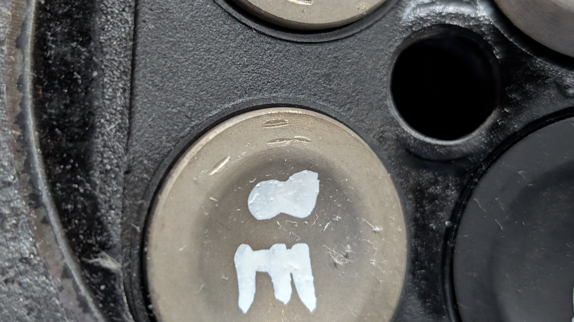

While numbering the valves I noticed that a couple exhaust valves had some "nicks" in them? I'm not sure what else to call these. The intake valves do not have these..

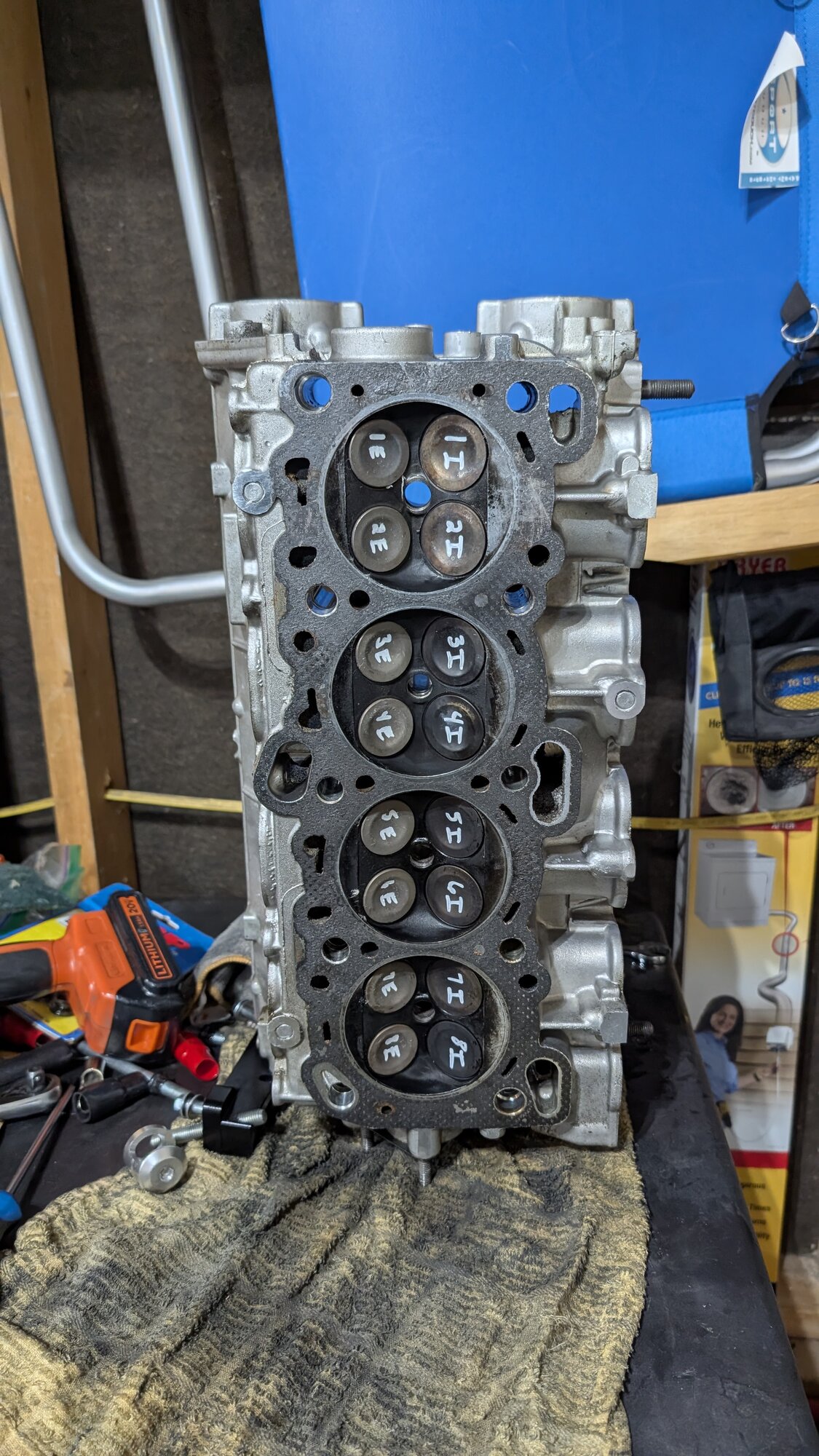

Well dropped the head off at the machine shop. Gave them the list of everything that I wanted done/looked at.
I brought in new GSC valve guides that I told them to put in regardless.
Overall they said it would be around 2 months for them to get it all done :(
They also said that the head was right at its service limit. I know plenty of people have run them below that limit and have had zero issues so I think I'll just tell them to clean it up regardless.
With that being said I think I am going to try and really try to degree the cam gears this time. With that much material off the head and aftermarket cams id like to make sure everything is happening when it's supposed to.

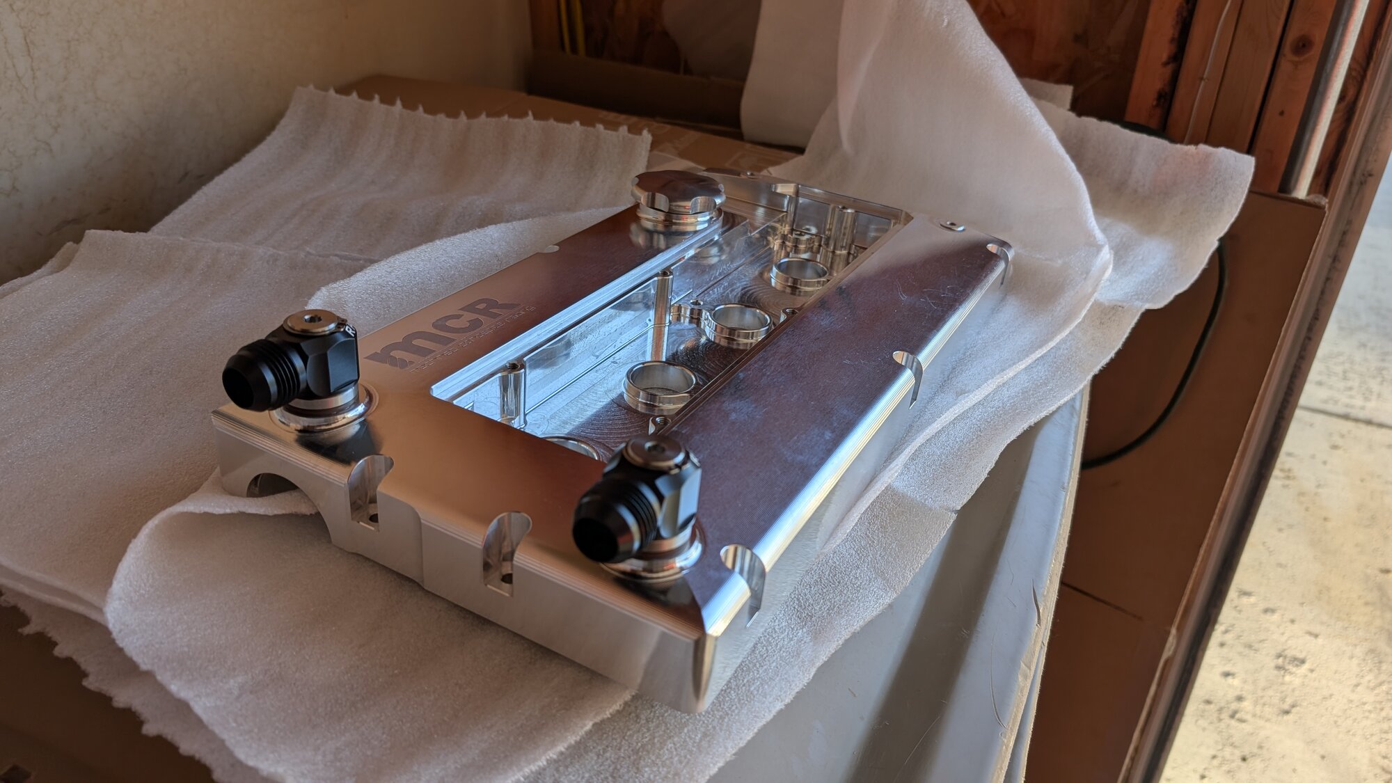

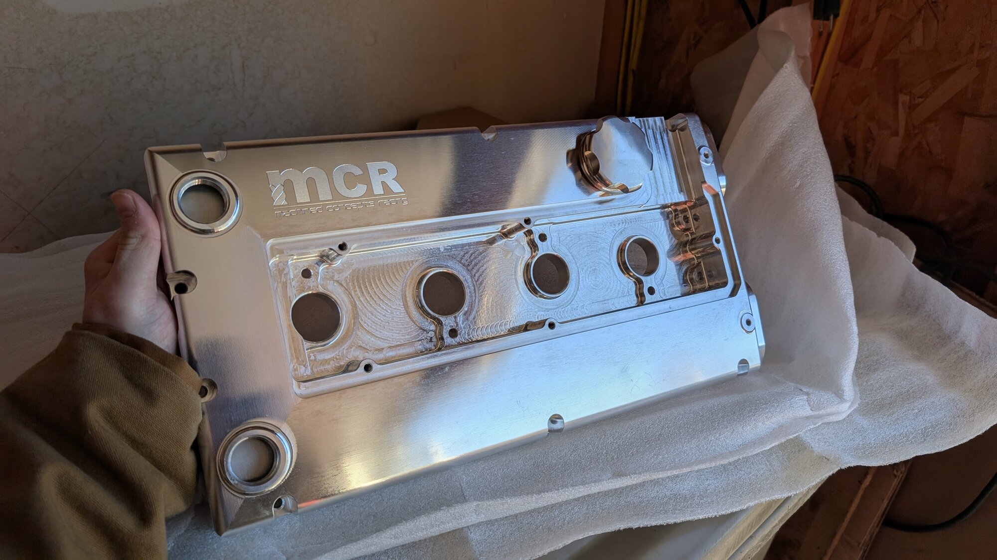

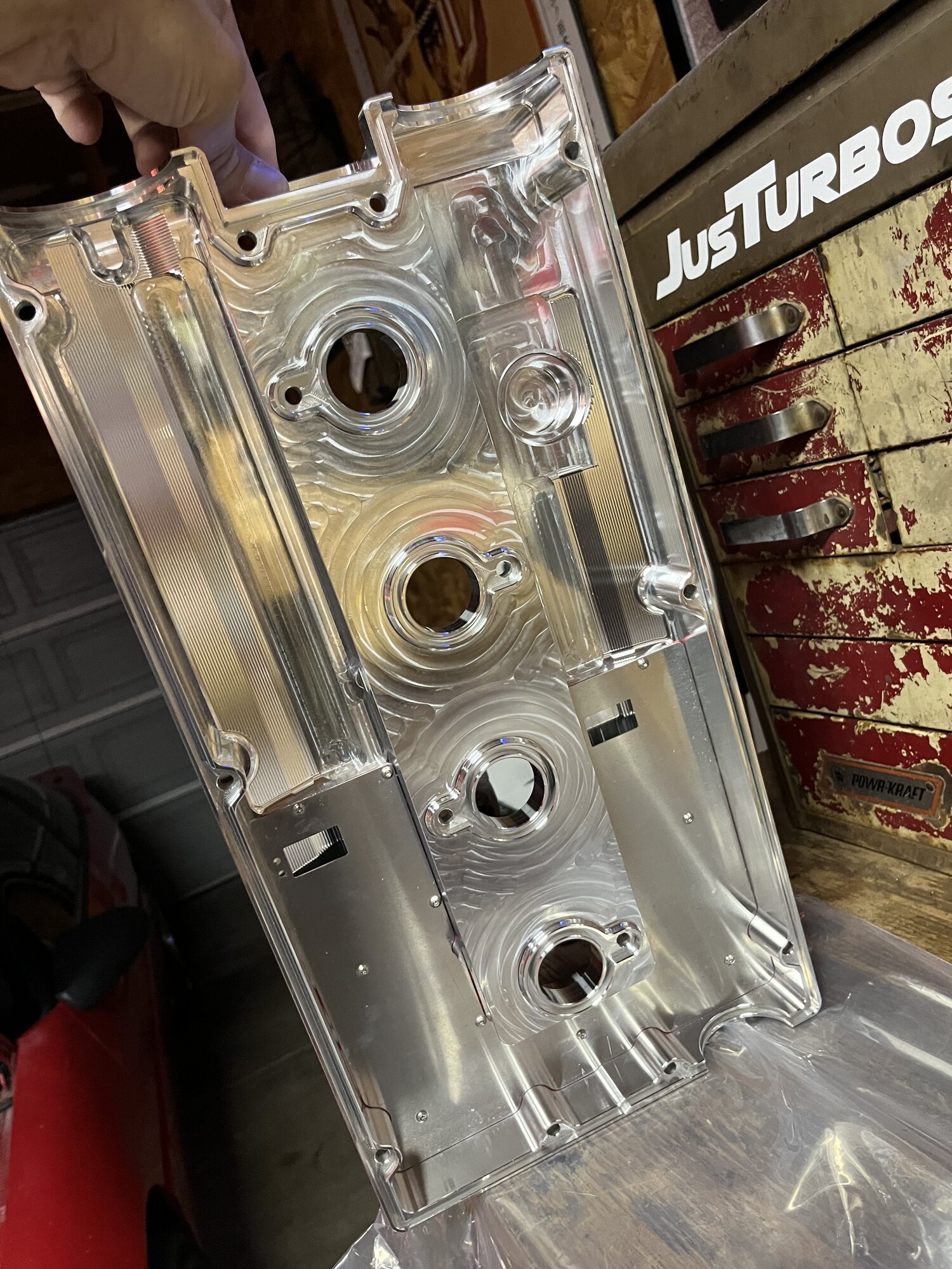

Well ladies and gents the "secret" thing arrived about a week early. So here it is!

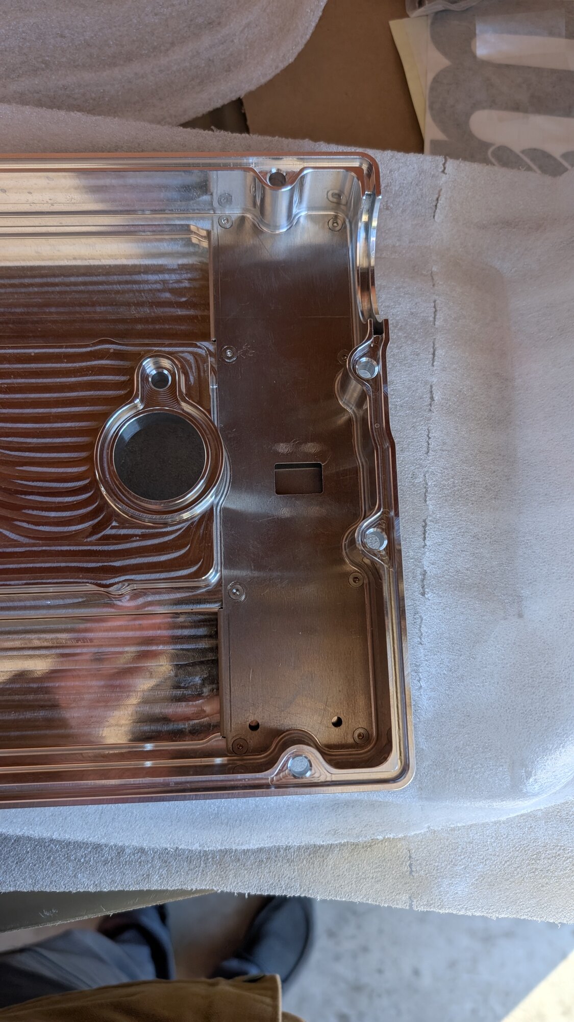

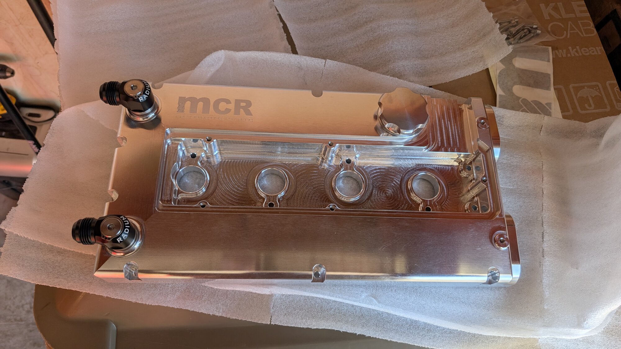

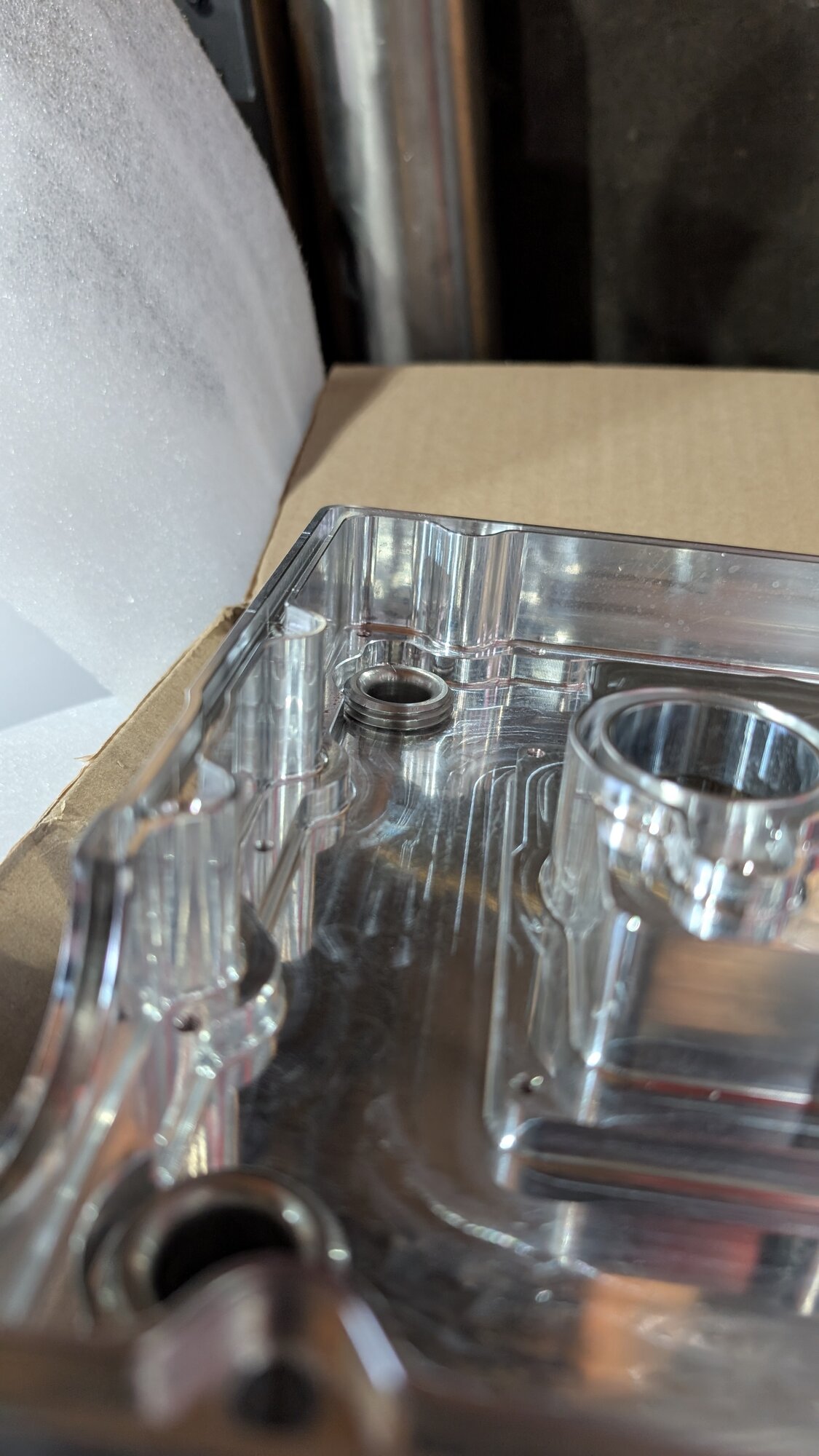

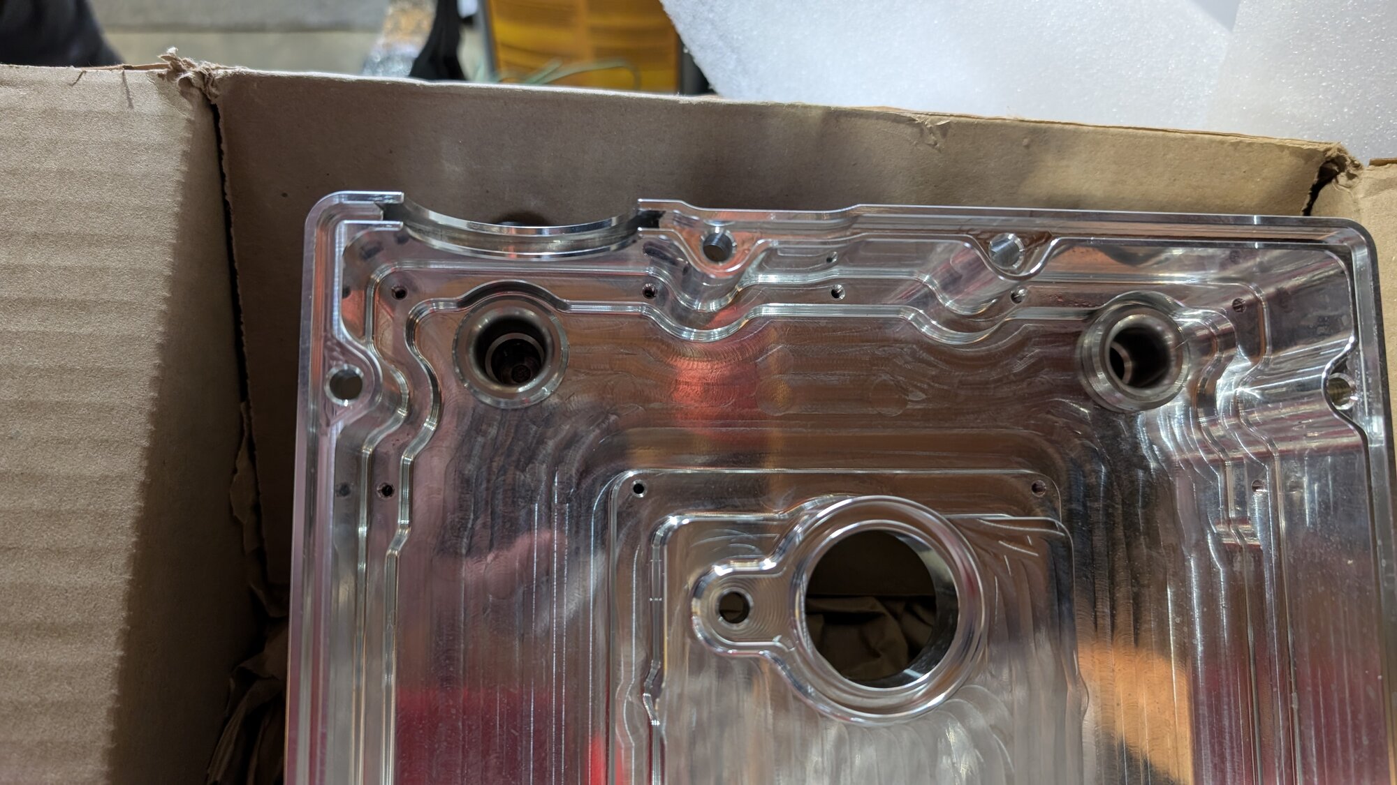

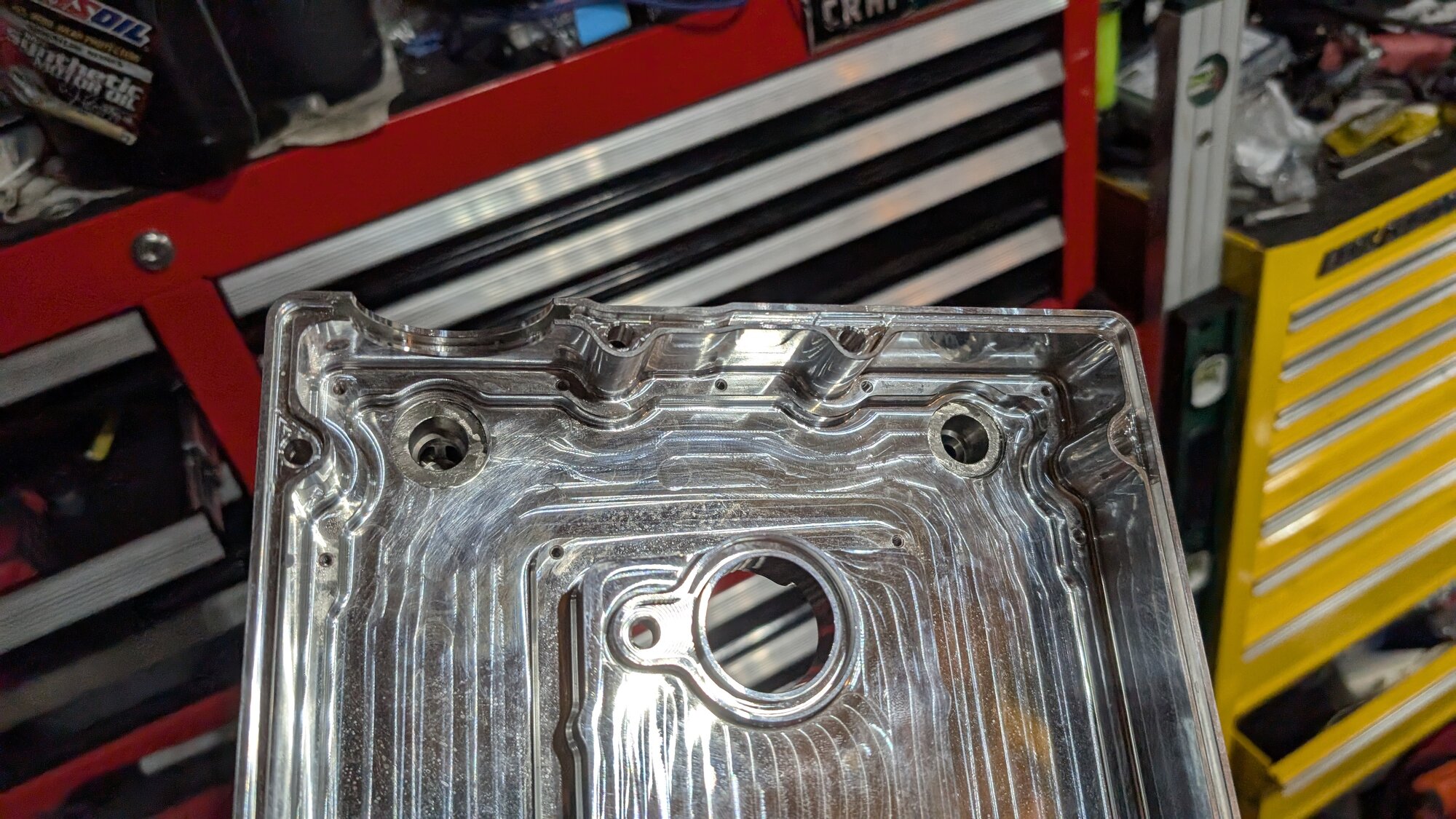

MCR Billet valve cover. Modified for -12orb ports.

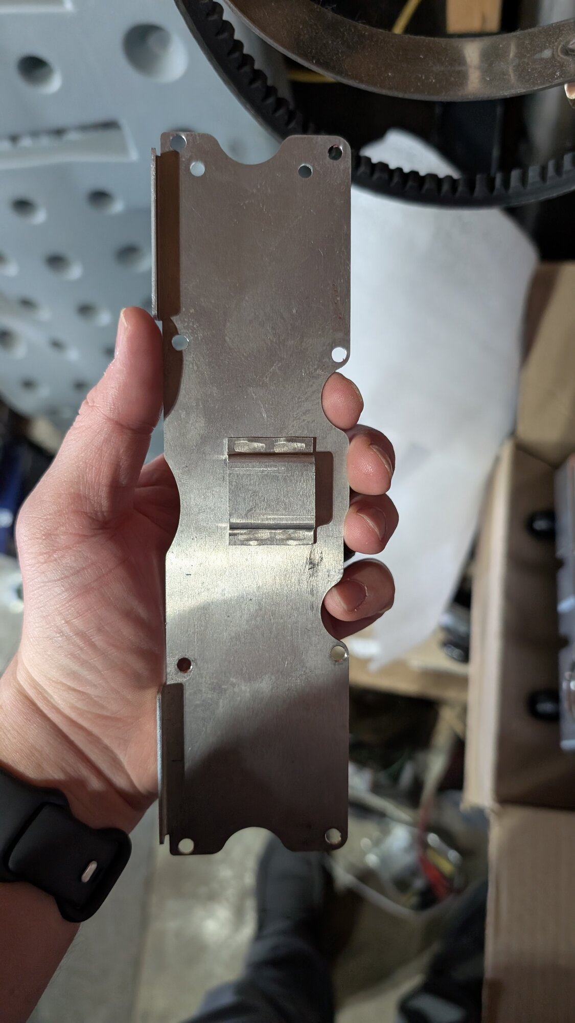

You can see their redesigned baffle for the ports.
PXL_20250127_232647418.MP.jpgPXL_20250127_232649220.jpgPXL_20250127_232655192.MP.jpgPXL_20250127_232658443.jpg
I think I'm going to mess with this sometime and see about adding some filtering media to it, like some of those stainless steel sponge things maybe?

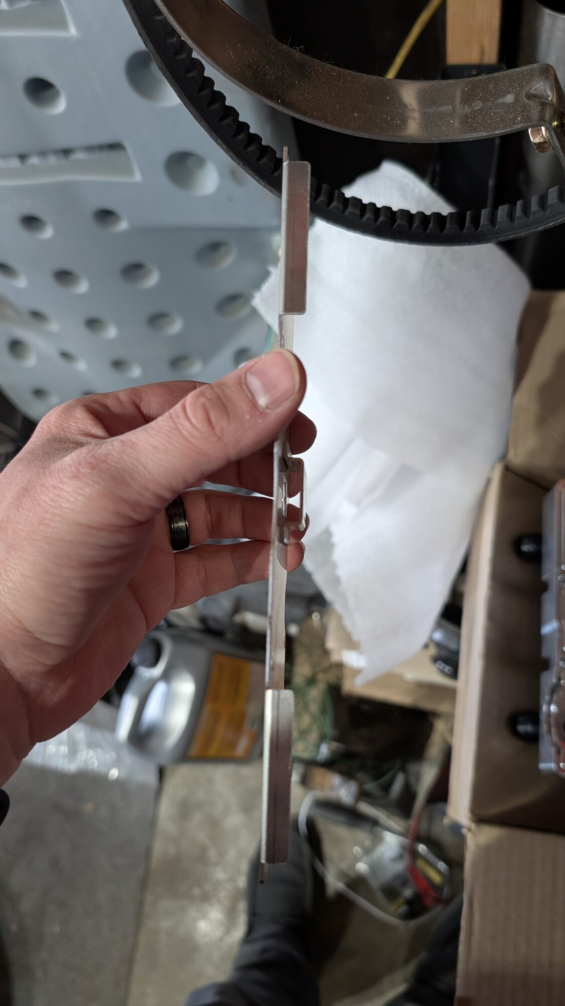

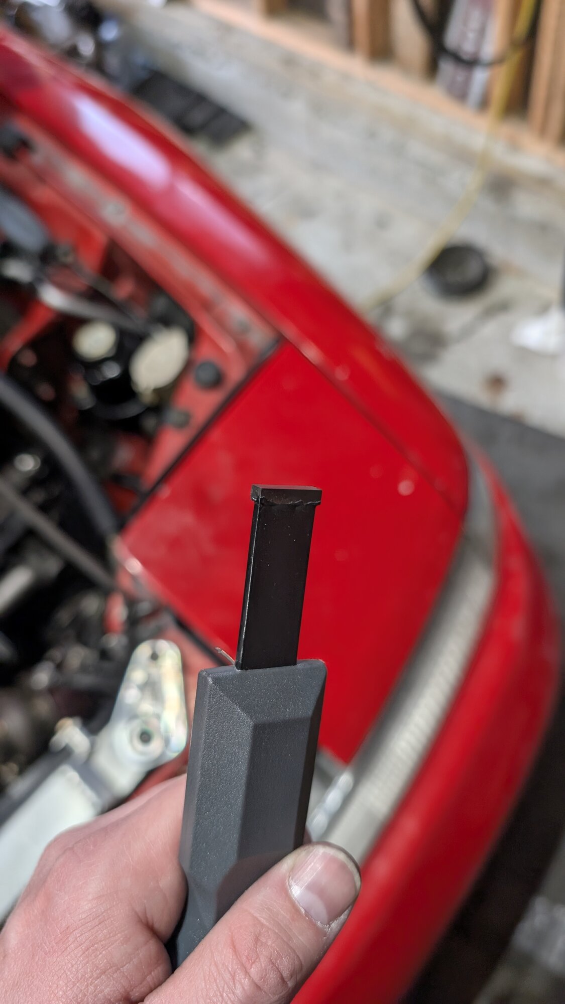

I also snagged a little set of timing component tools on Amazon. Now I can properly compress the tensioner back
Includes the tensioner rod, balance shaft rod, the little key tool for the tensioner pulley and another grenade pin.

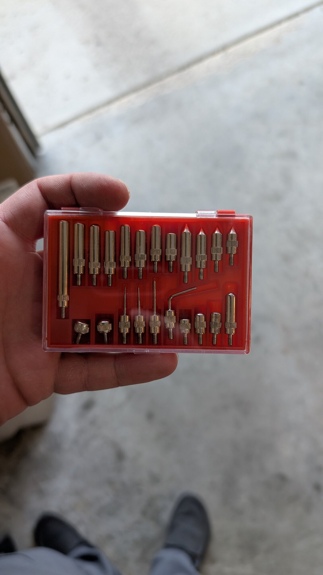

And also snagged a little set of ends for my dial gauge indicator for when I degree the cams this time.

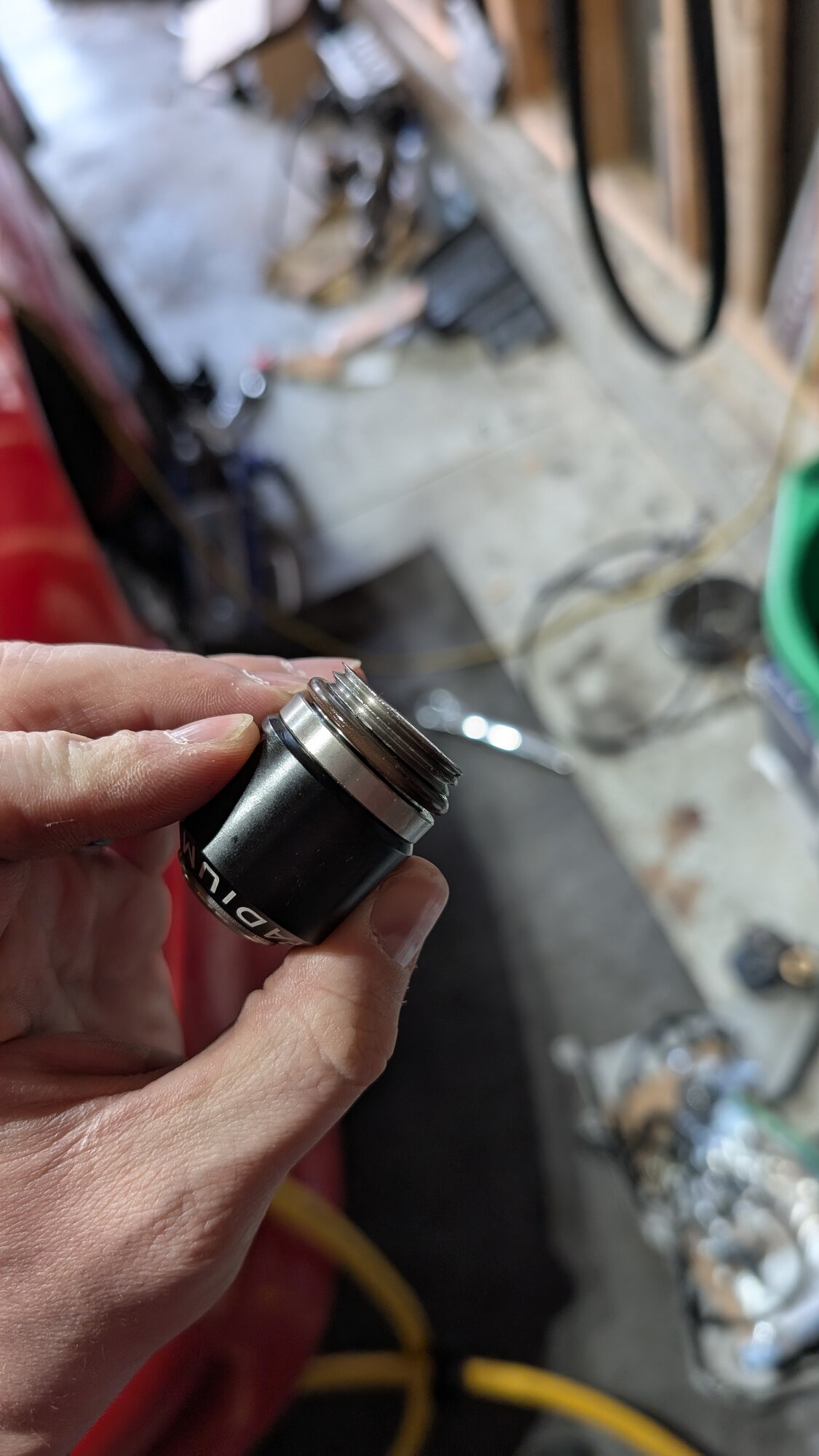

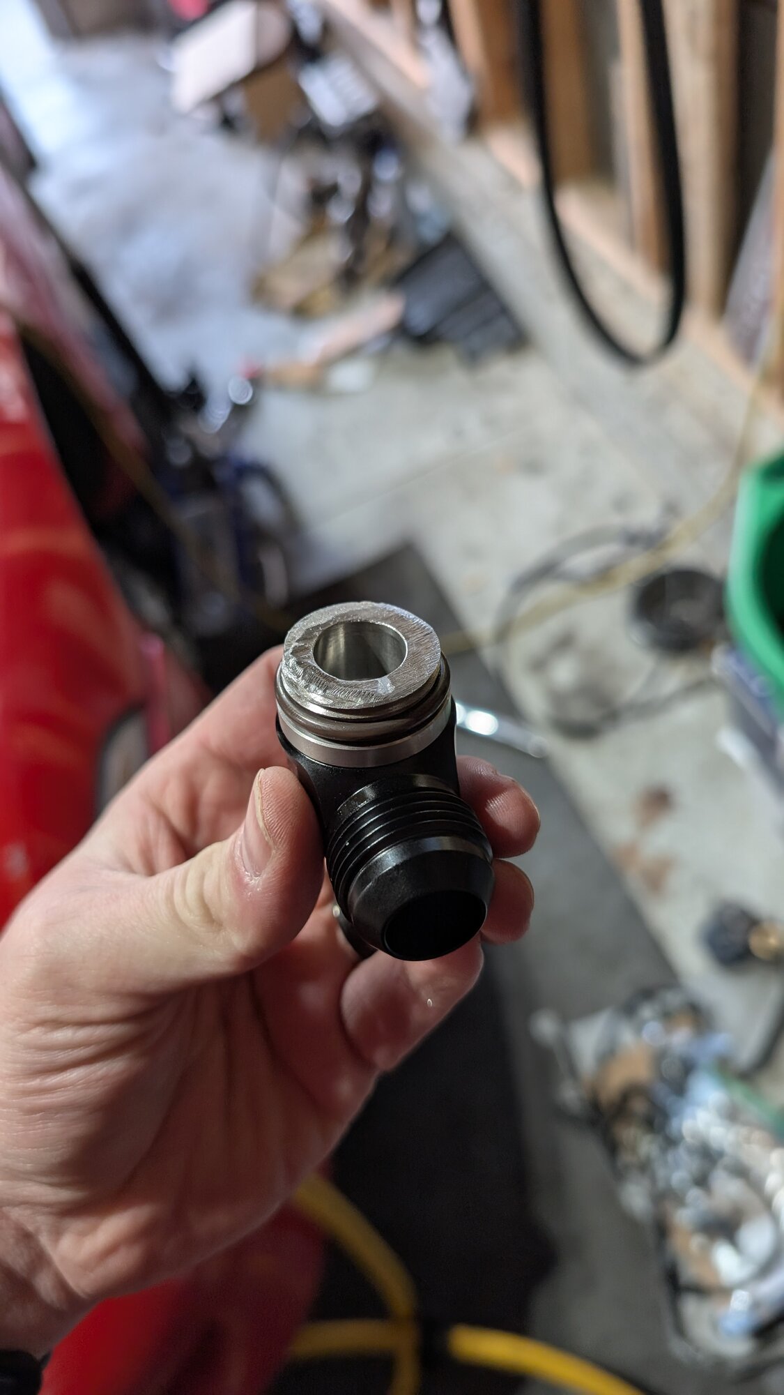

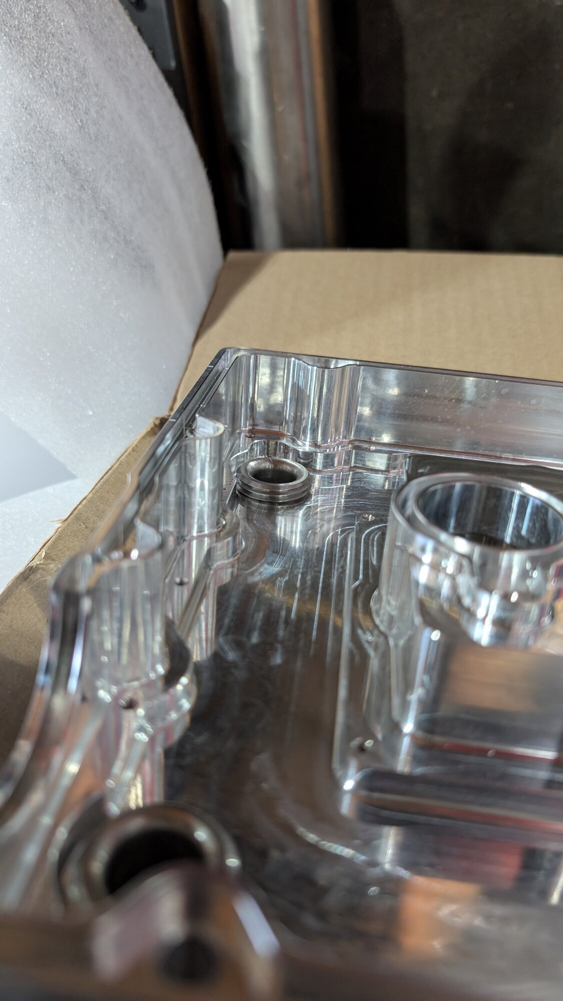

This is the only pic I have at the moment, I can pull it tomorrow and get more. I was kidding too about yours, it looks just as nice as the frontline, also there’s the issue I’ve yet to address of the fittings bottoming out on the baffle, that’s pretty sweet you got yours with -12an breathers too :rocks:
In Brandon’s build thread,(Kratosv2) he mentioned shaving them down, I was wondering if there’s possibly a shorter fitting maybe? Otherwise my fear of cutting them is ruining the threads
I think you can safely cut them as long as you debur them. Easy job for a file or cutting disk. IMO the threads are so course that there's tons of room between them to make em nice again. I'll have to take a look
I may give that a try, depending on how your attempt turns out LOL

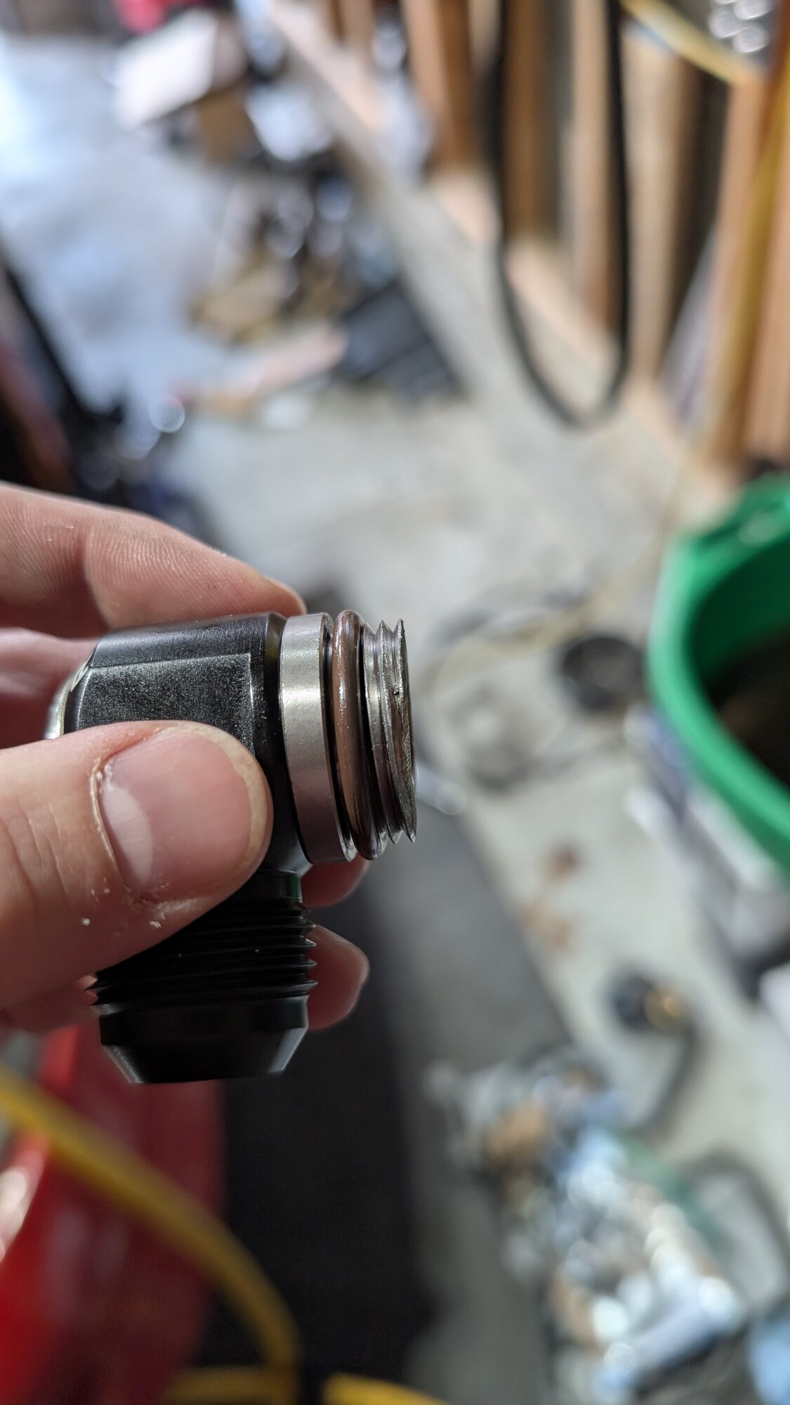

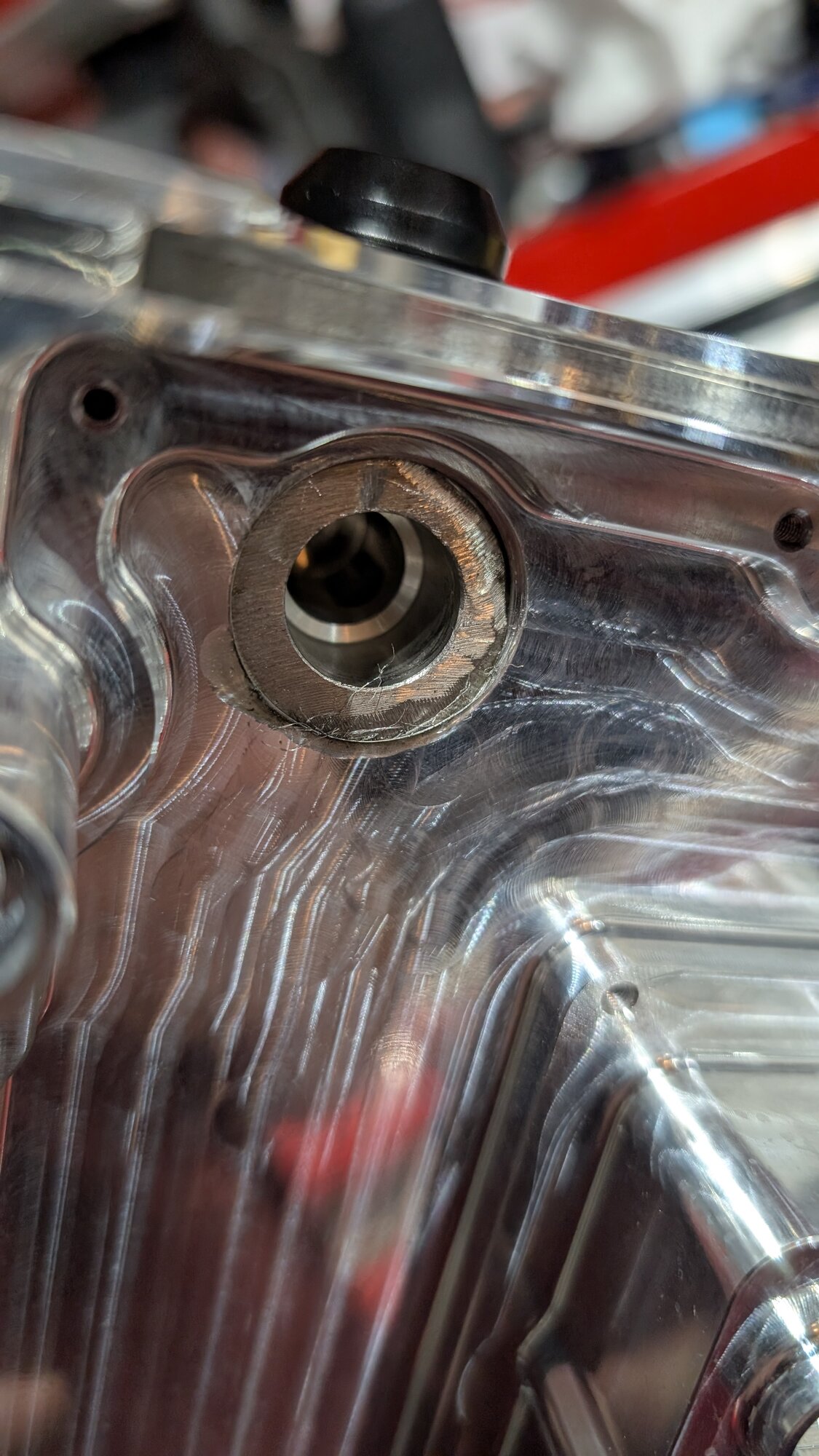

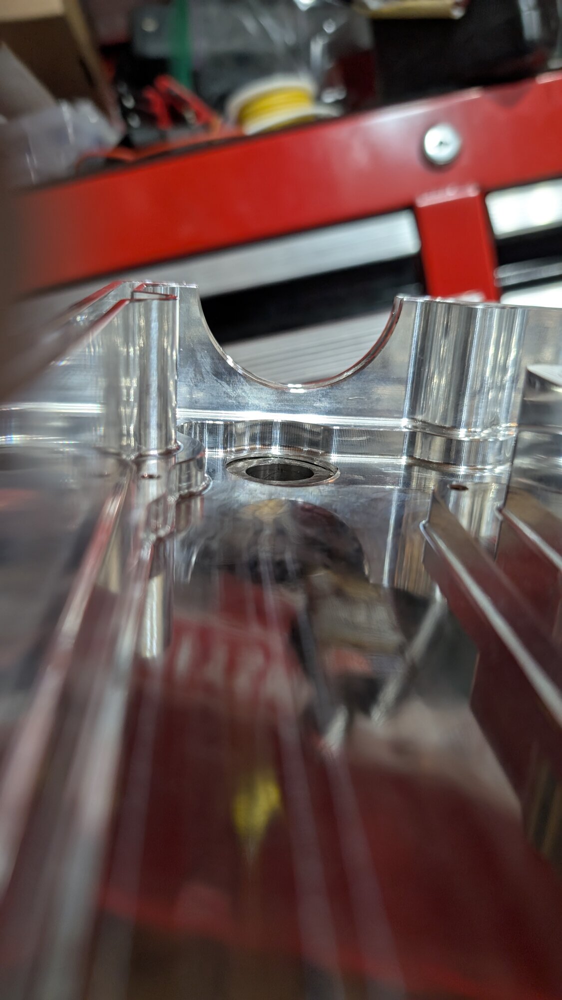

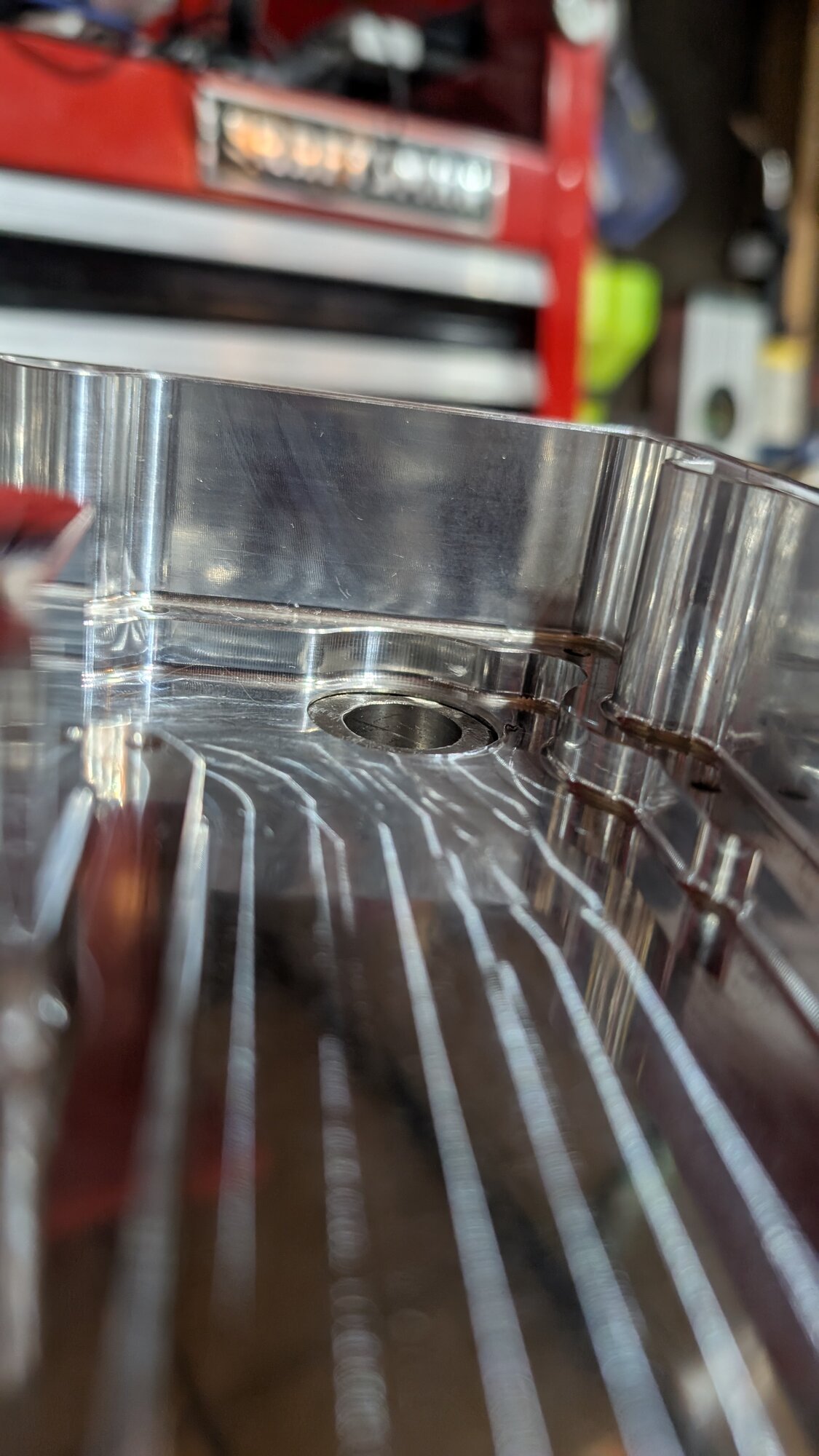

So it definitely can be done. I wouldn't recommend it mainly because the burrs on the threads if you nick some other threads can mess up the threads in the valve cover. But here's mine.
IF you decide to do it, find someone with a bandsaw or something that can cut straight. I used a cutting disk.. not fun.
You can see in that last picture even after deburring the threads a bit it kind of dug up some material out of the threads of the valve cover. I probably won't remove these ever but just putting it out there.
PXL_20250128_233423962.MP.jpgPXL_20250128_233426601.jpgPXL_20250128_233431262.MP.jpgPXL_20250129_000911589.jpgPXL_20250129_000907565.jpgPXL_20250129_000856615.jpgPXL_20250129_000751652.MP.jpg
Looks good! We have a band saw at work, I might go that route :thumb:
Id recommend nor cutting it flush with the underside of the valve cover either. Try to keep like half a thread or just a small lip sticking out so compressed oil vapor that turns to liquid doesn't funnel into the fittings when you start building pressure. I think I cut off just over 2 full threads off the end of mine.

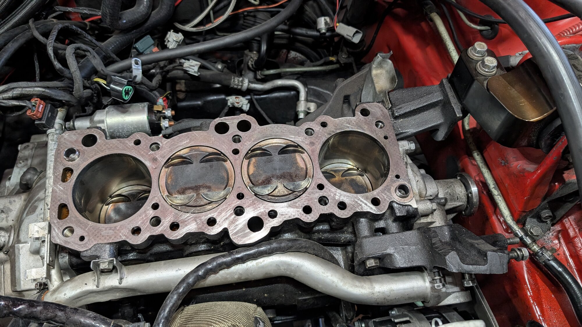

Touched the car for the first time since getting the head off basically or messing with the new valve cover. Just finished cleaning up the old head gasket material off the block with these carbide scrapers. The picture makes it look awful but it's perfectly smooth, no burs or scratches.
They said they should have it done in a "couple" weeks. I'm ready to have the ol girl back for sure.
