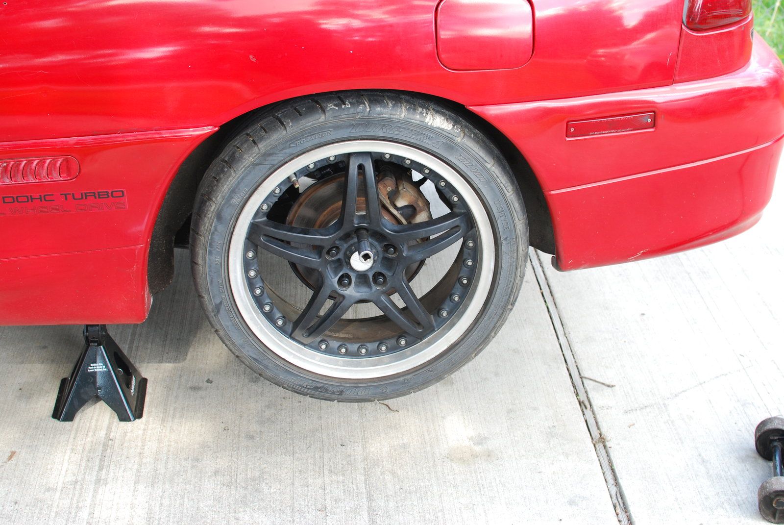

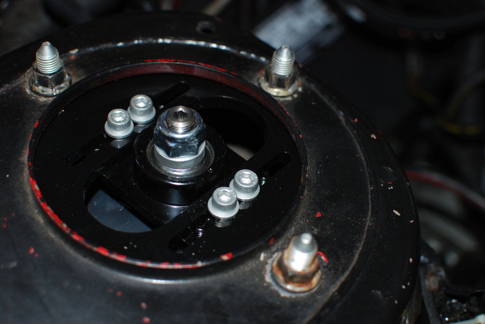

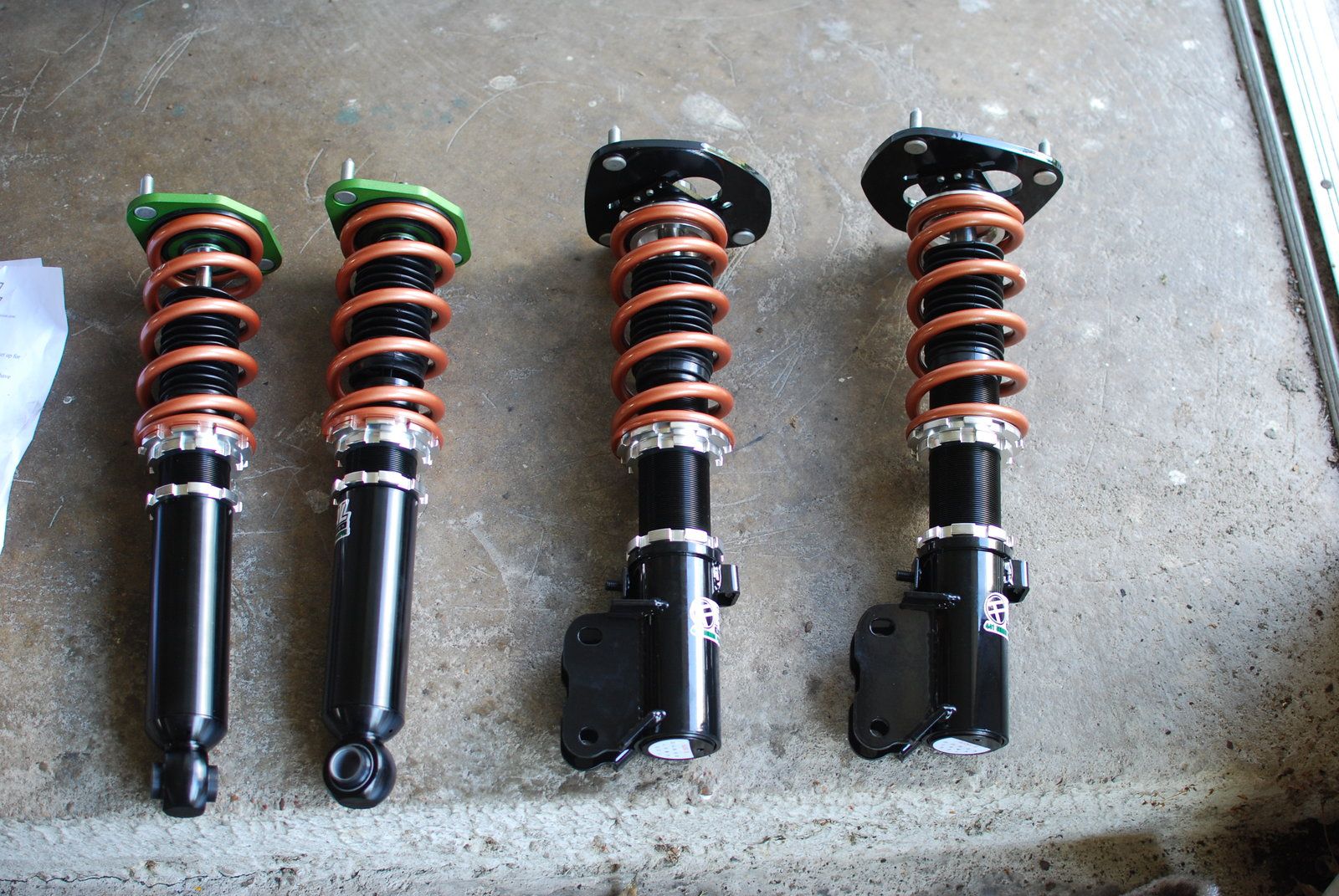

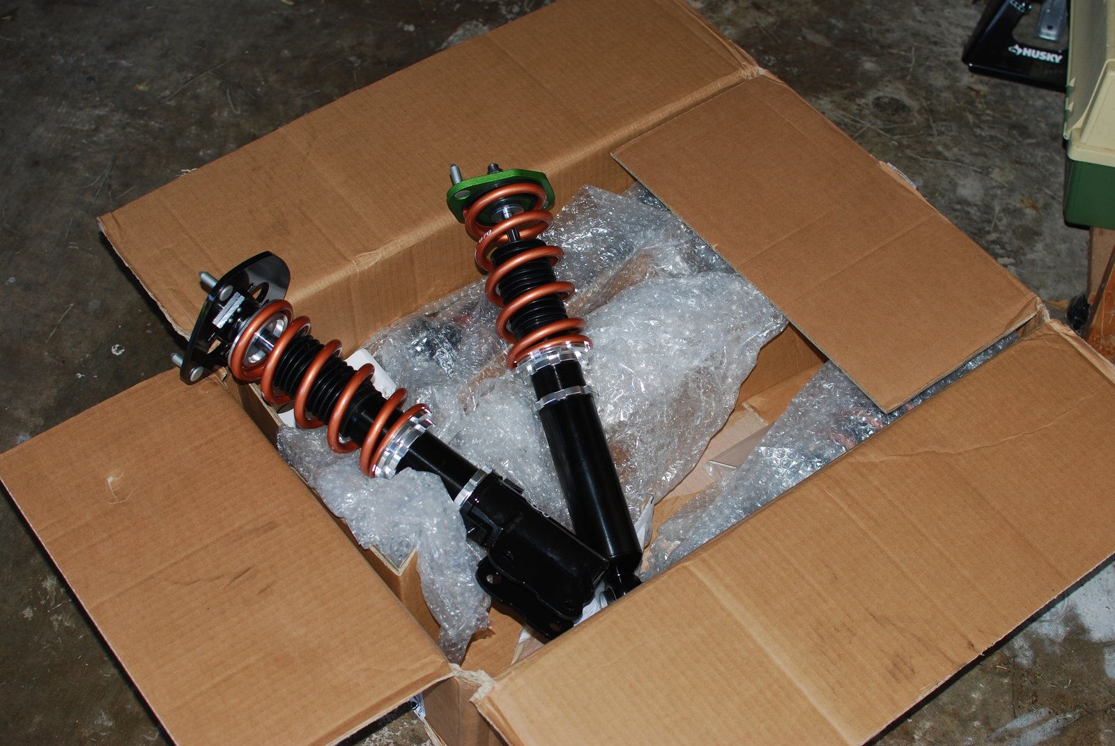

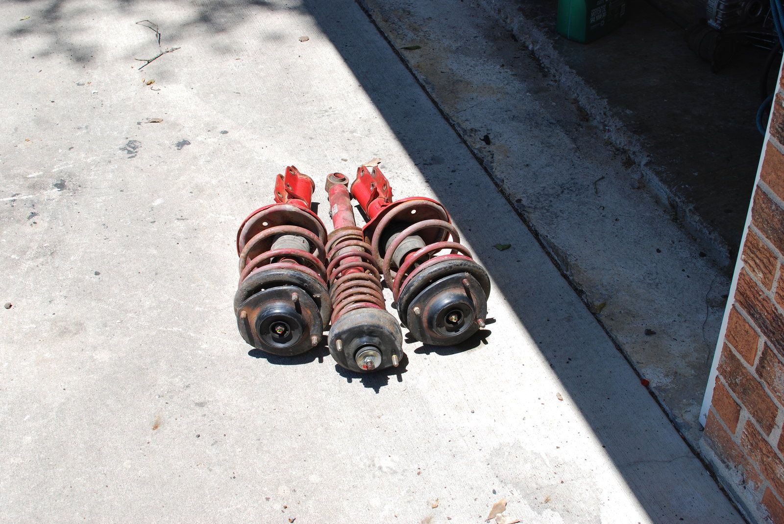

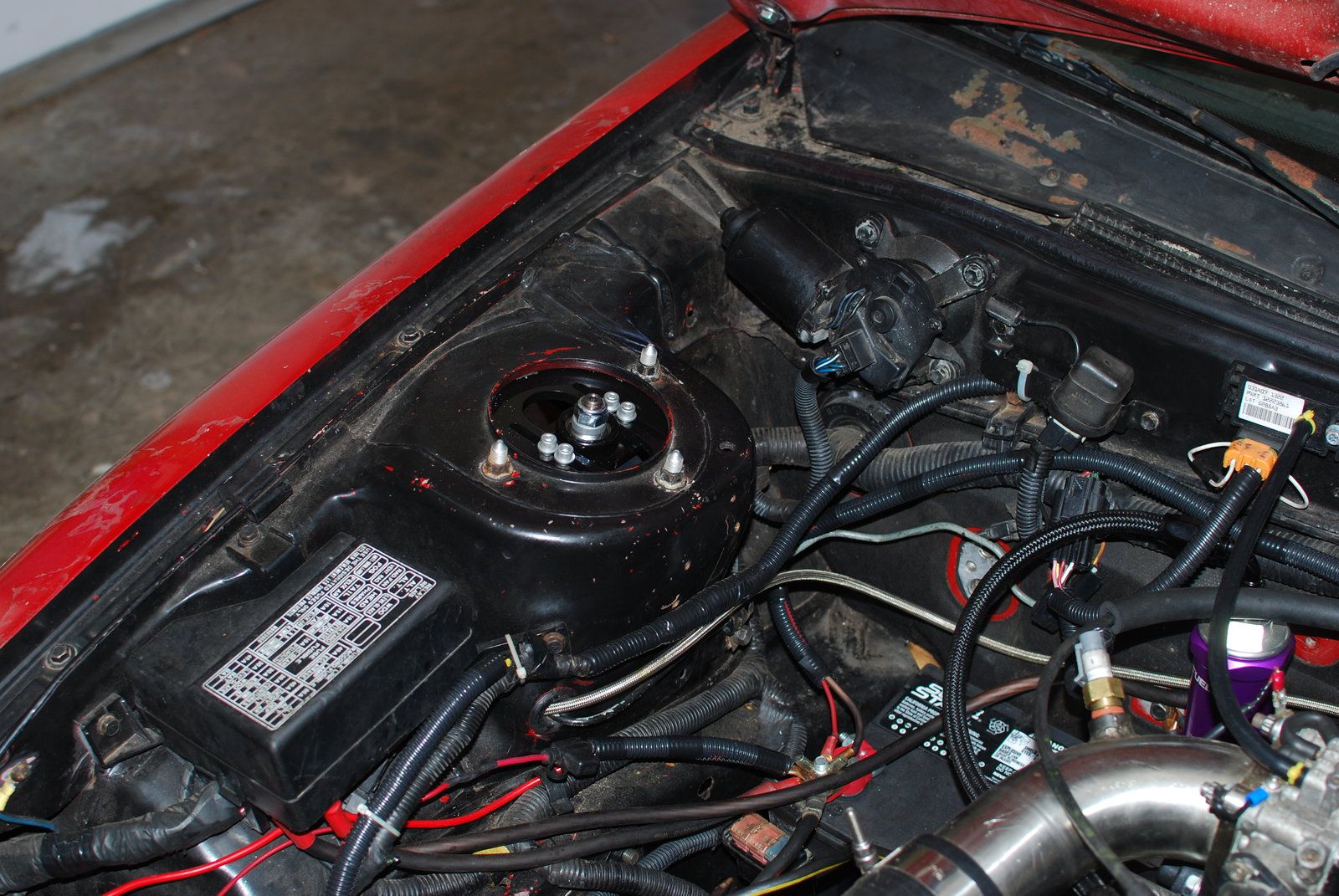

Alright, so I ordered some Feal 441 coilovers for my bday and it took about a month to arrive due to parts availability. Very nice looking parts. I was disappointed that the green top hats were only in the back and not the front too. Oh well, can't have it all. I have replaced every bushing on my car with polyurethane to refurbish the chassis and these coilovers were the final piece. I wanted something that was quality and unique. If I can't have the fastest car then at least I'll have the best suspension :)

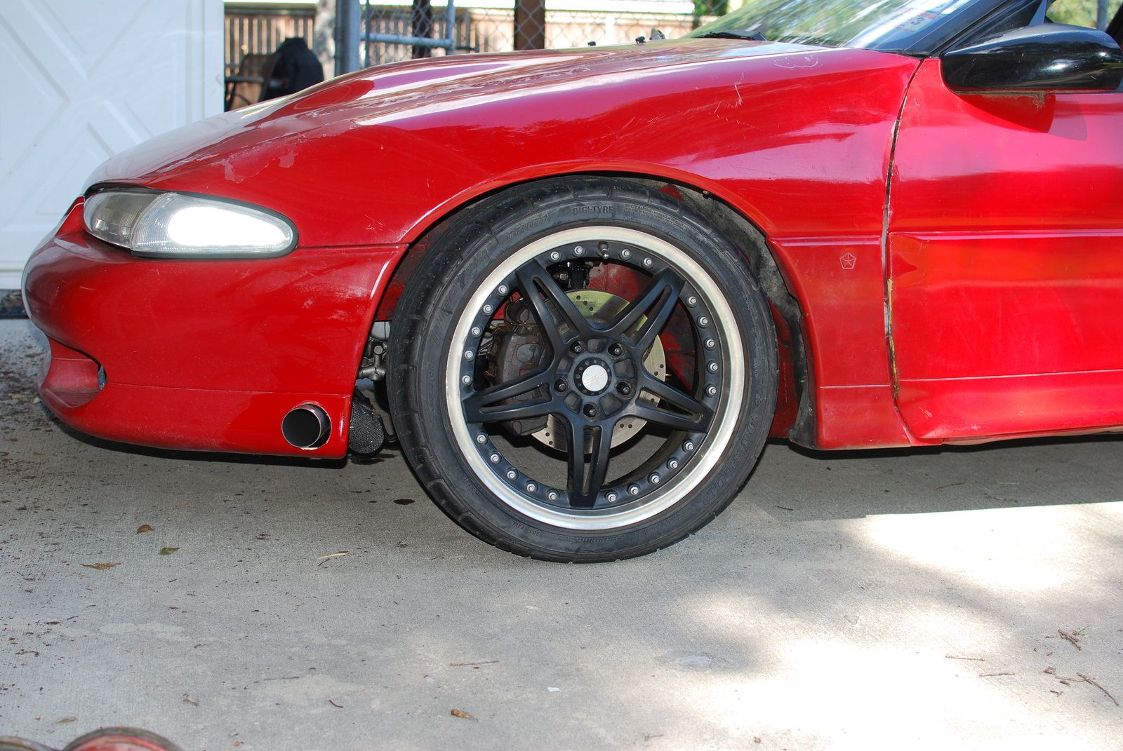

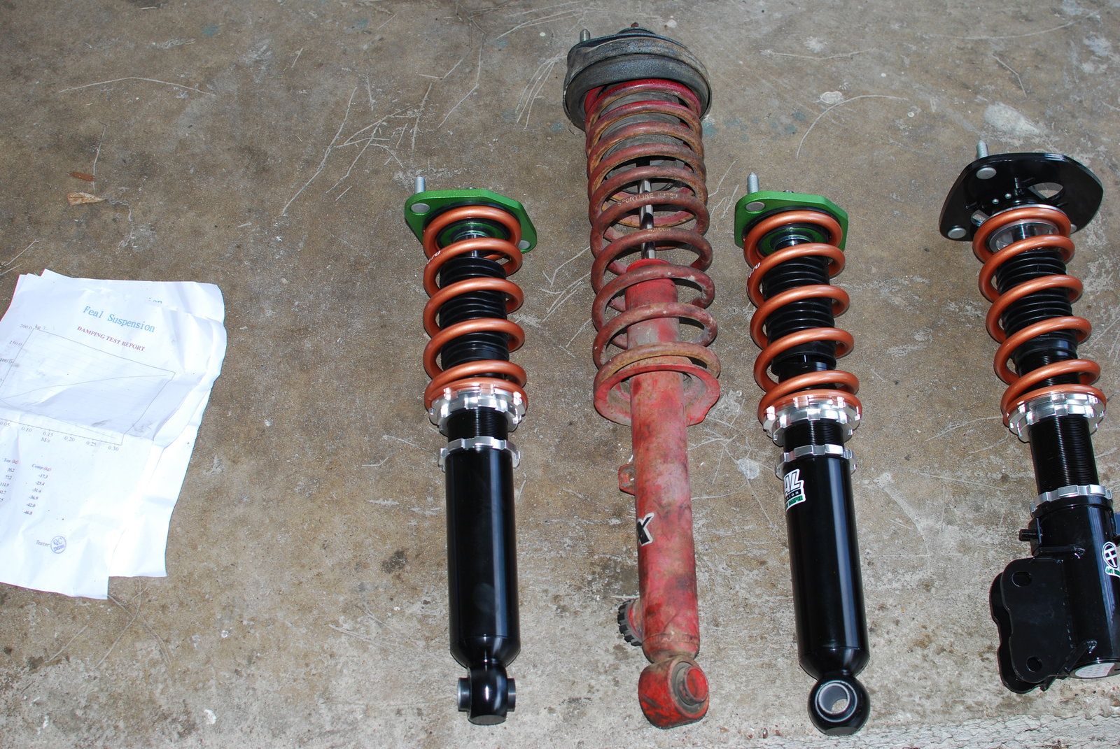

First thing I noticed was the different length of the Feals compared to my AGXs. The suspension droop is much different as well. It took forever to get the ride height down correctly as I would have to unbolt the shock from the bottom perch, jack up the vehicle, alter the coilover, put the wheel and coilover back on then lower it. It took much longer than I expected. I'm pretty happy with how the car looks right now. It's not too low but still looks aggressive. I'll perfect it here pretty soon as I have to get back under there to adjust my rear camber.

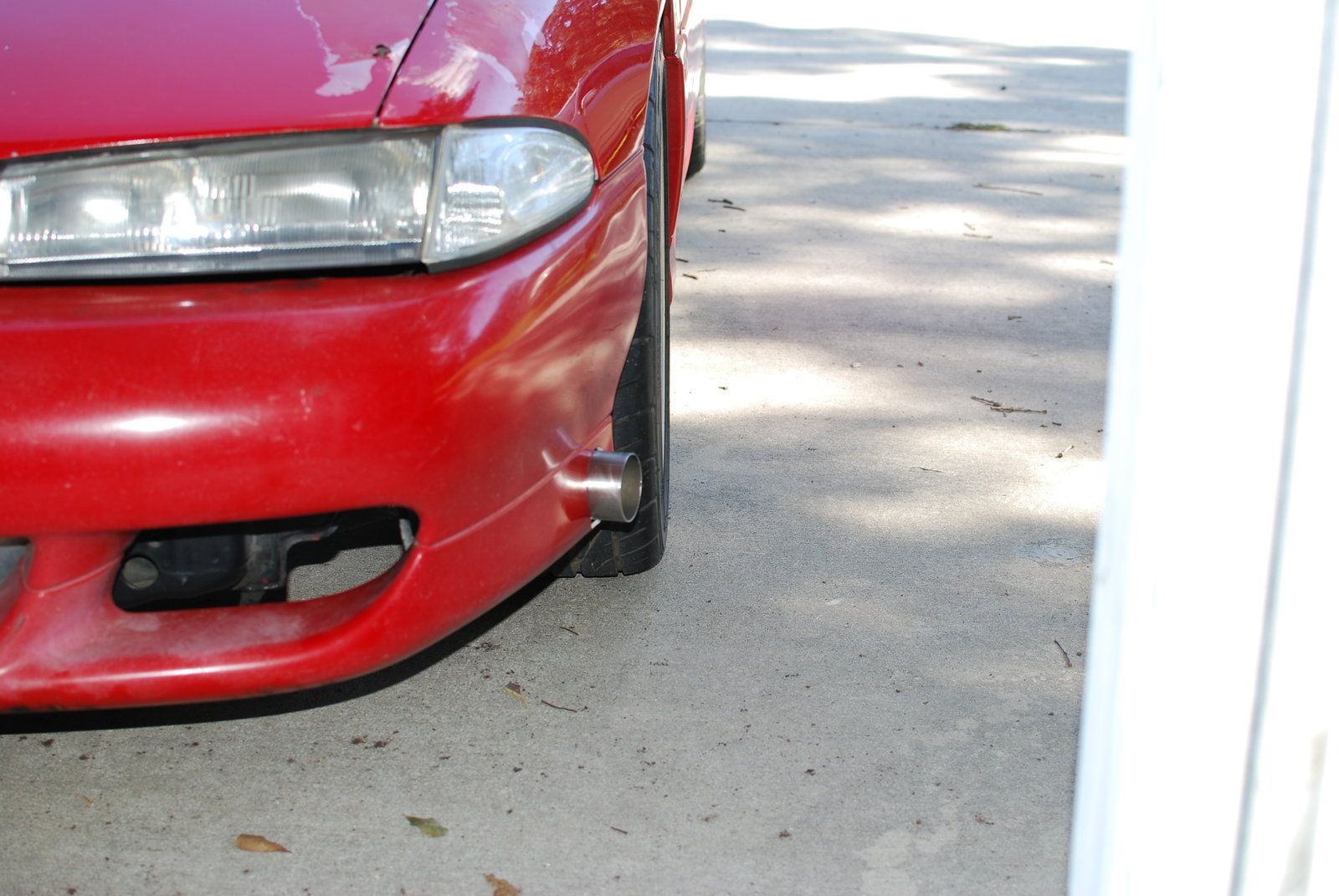

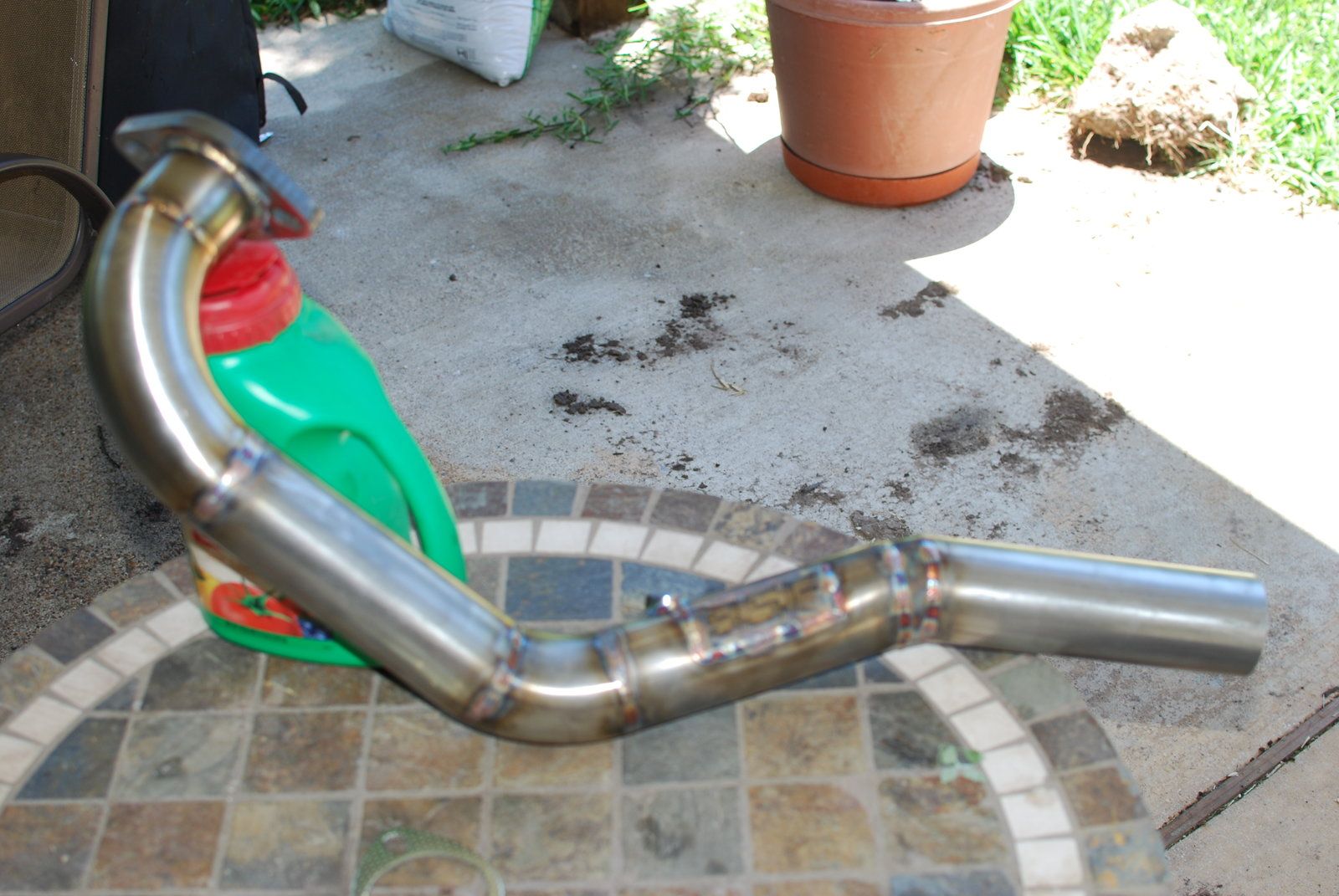

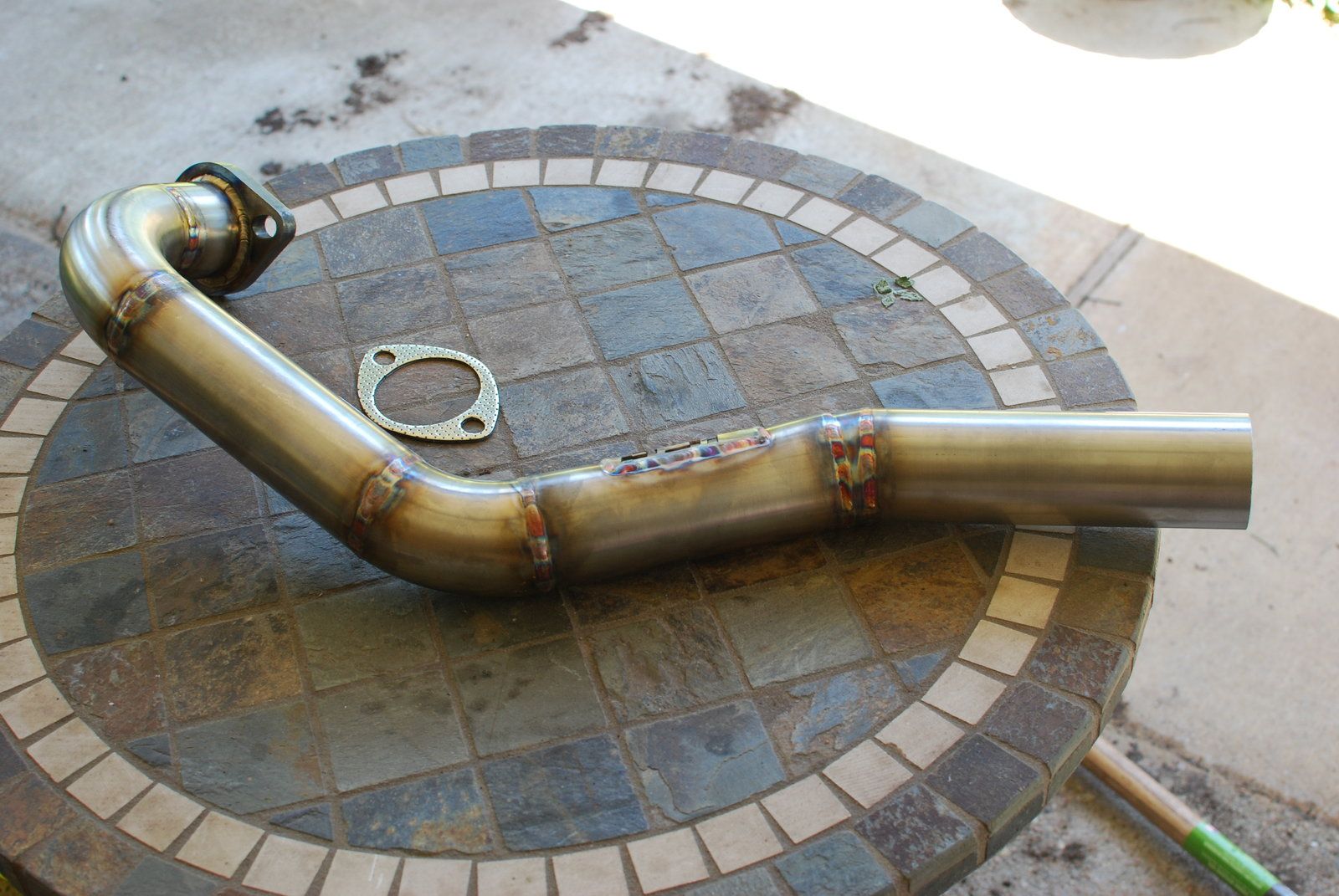

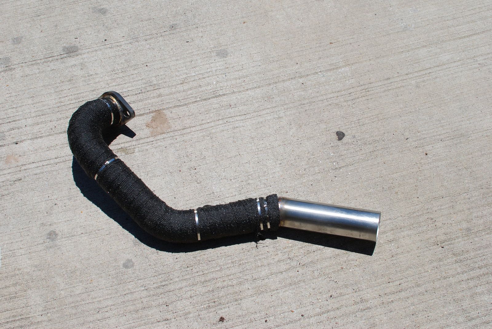

I got really frustrated with my Thermal R&D exhaust that I bought used a while ago. I could never prevent it from banging into the enlarged DSS driveshaft among other things. I finally decided to move onto a BSFab 2.5" side exit exhaust. I've been obsessed with decreasing the weight of the car this time around and I've been compelled to lose that 30-40lbs by moving away from the full exhaust.
I was worried it would be too loud, however, it's actually only loud on the driver's side. It's not terribly loud on any other side of the car and somewhat resembles your usual loud dsm. You also have the added benefit of the ole turbo whistle on deceleration. Pretty wicked WOT. I wasn't happy with how the Thermal R&D sounded (glorified side exit basically-not much character in the sound) so why keep all the extra weight and banging?

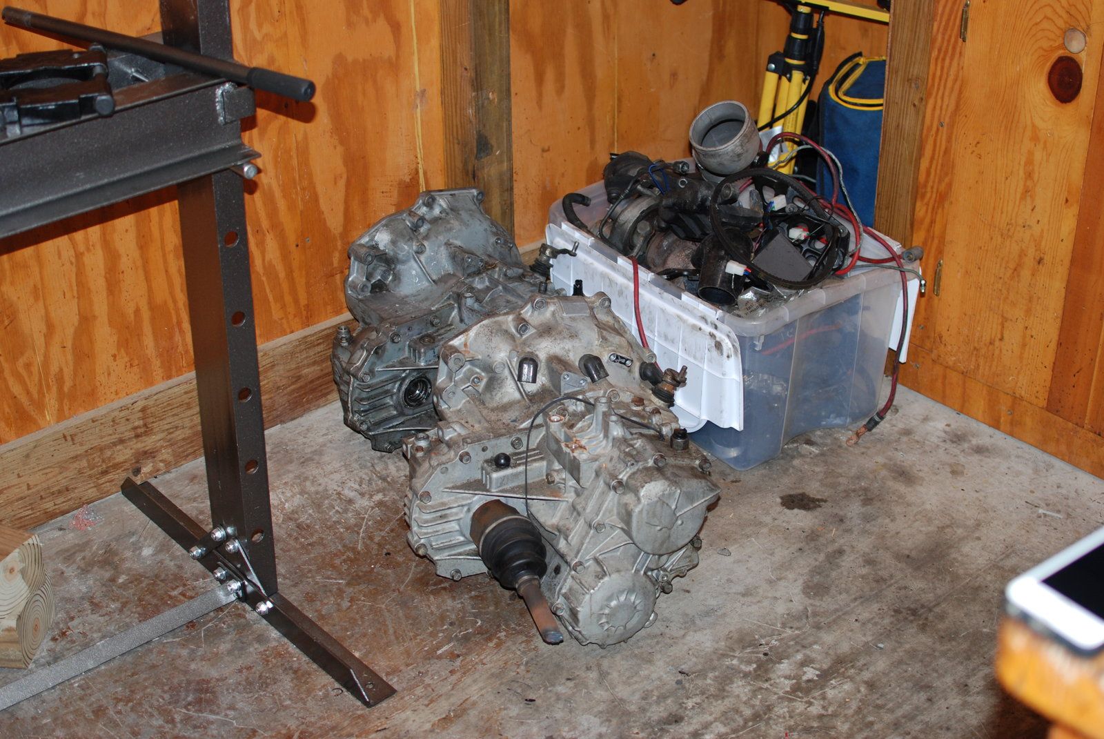

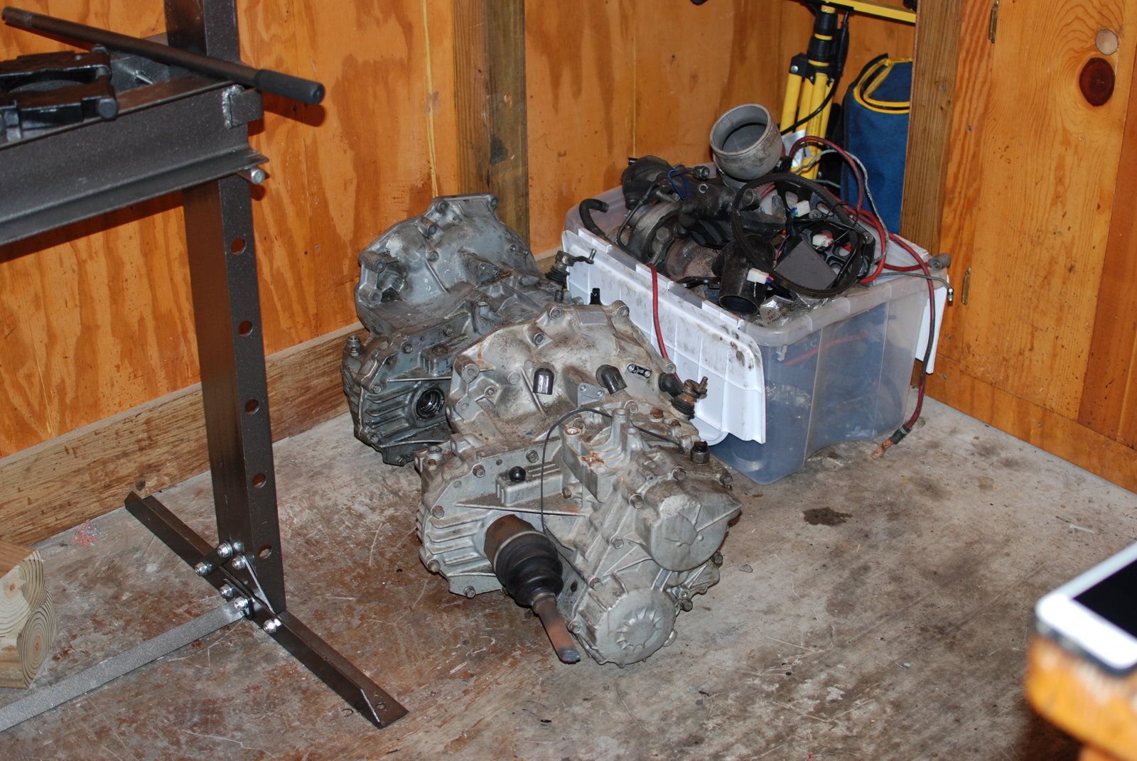

Came across two built Jacks stage 2+ transmissions that I got for $600 combined.....every dog has it's day I guess. These will be my backups once my stock transmission goes boom. I'm hoping these will last a long time.
You lucky dog, That's a hell of a find. Ppl are asking that much for stock transmissions around here. Curious why the axles are torched off as well?

There was a local guy who knew nothing about dsms and he bought one on Craigslist. It turns out the car had a ton of nice parts (SMIM, built motor, jacks transmission, fluidyne, HKS 272s, Full-blown double pumper, ID Hi-z 1000s, AEM V1 etc etc). Apparently he got really bad into meth and for whatever reason needed money really quick....I wound up picking up about $1500 in parts for just a couple hundred. We were trying to remove his transmission (the car was stored in some small storage room) and for whatever reason we couldn't get the axles out so he just blow-torched them off. I still kick myself for not buying the whole car for $800.......
