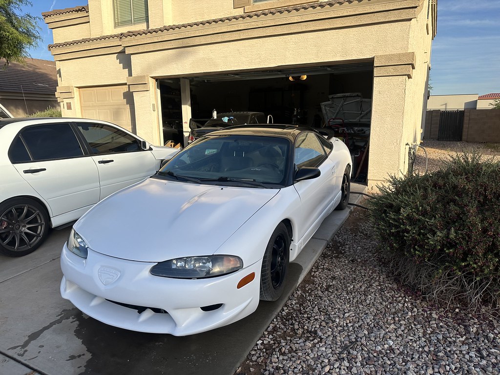

Bolted all the body panels back on, 2ga turbo twisty skirts, mirrors etc. It was nice to finally see this as a complete car and for a rattle can paint job this turned out way better than I would've imagined it would.

The turbo can paint job came out amazing!!! Might have to do this to my 1GB. Also just picked it up from East AZ and hauled it to Buckeye
Prep is everything here, the cans spray out like a cheap HVLP so it's pretty easy to get a good coat down and it lays down flatter than out of a normal spray can. If they had more color options I'd definitely be doing more color changes with this stuff. I plan to clear over this at some point just to see how it works out
