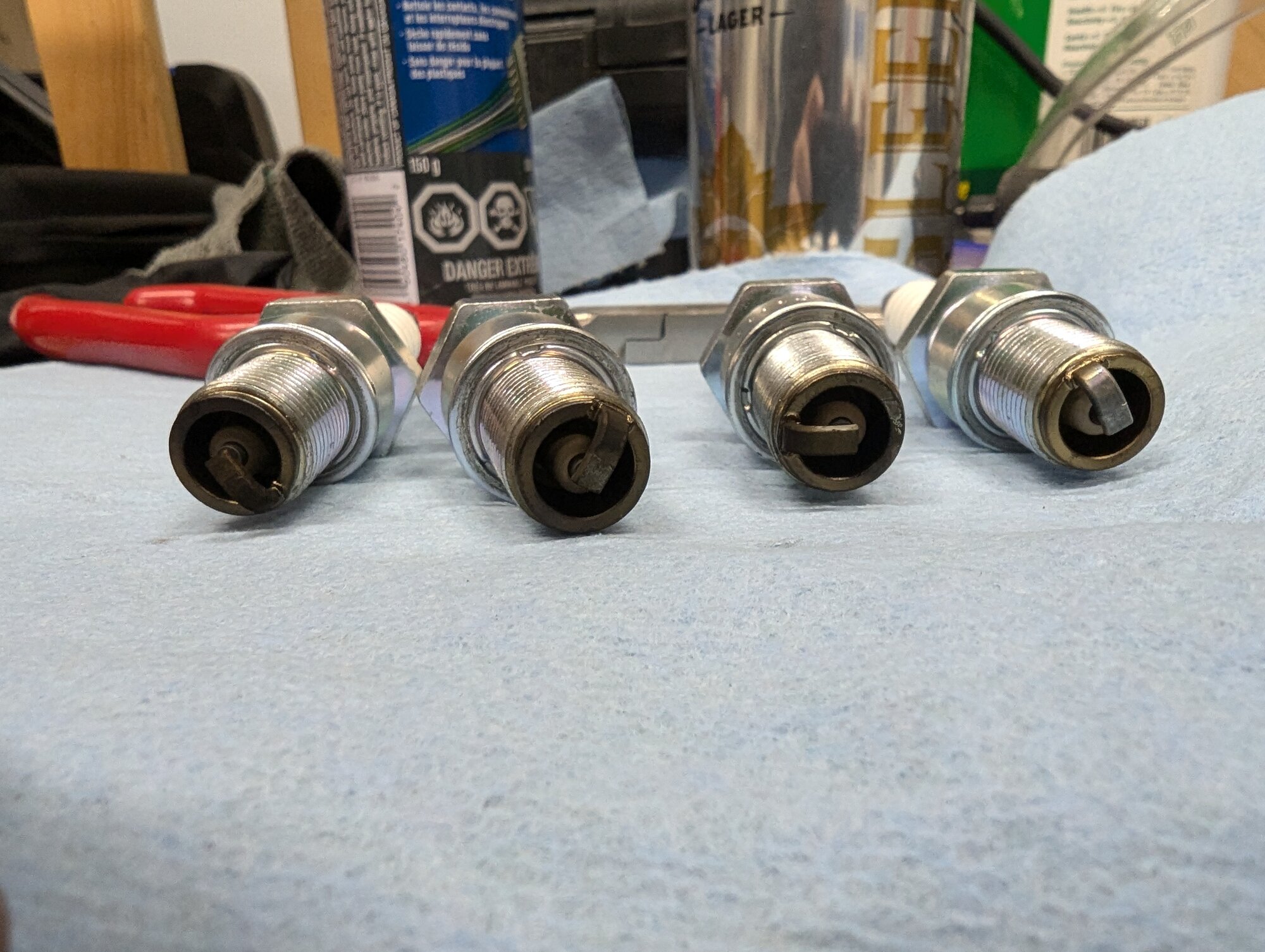

What’s going on with that right plug? Sure you’re getting fuel and spark there?
Sure doesn't look like it. At least, not the correct amount and all the time I should be. I don't have a pool of fuel on top of the piston and the plug isn't wet, it's bone dry and indicating lean. I'm going to have to check my wiring.

I'll take a look at the wiring tomorrow but there's definitely evidence that #4 plug isn't getting fuel or it has little to no compression anymore. Maybe it never did.
Yea I’d definitely confirm you have spark and fuel on that cylinder. Might have an issue with the injector or spark plug there. Did the engine feel like it had a miss?

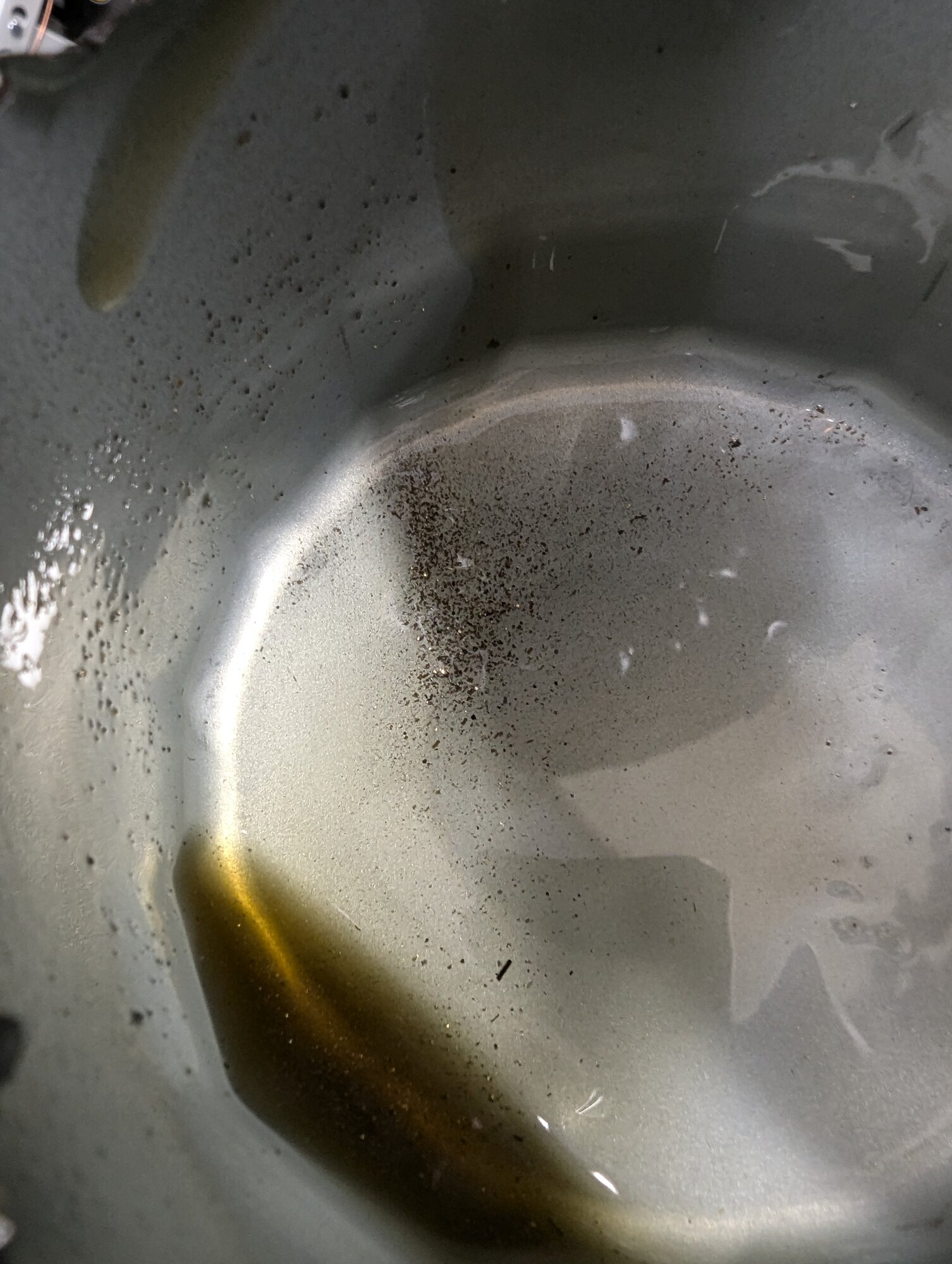

Now, I know the first oil/filter change is going to be the worst but this is plain ugly. Black long chips are probably paint from the outside, hammering a screwdriver to break through.
Eh. I still wouldn't sweat it until your second or third oil change. If it gets worse or stays that consistent, then worry. The first one is always a nightmare. Isn't this a built engine too? And how thoroughly was every single passageway, nook, and cranny cleaned before final assembly?
Send it. Listen for noises, keep checking things but I wouldn't let it keep you up at night.
I cleaned it as best as I could... I bottle brushed down the entire main galley, cleaned the crank until nothing came out.. basically took a pressure washer to everything..
I will admit when I got my head back after they had to fix a couple valve seats, I didn't disassemble the entire thing but cleaned where there were any shavings. I don't see how they could have hid anywhere else.

What I was getting at with the "how thoroughly was it cleaned" was that it's straight up impossible to clean every single nook, cranny, crevice and etc. There's gonna be stuff in there leftover that oil works its way loose. Even a hot tank after machining doesn't get everything. Even Jafro admitted it in one of his videos.

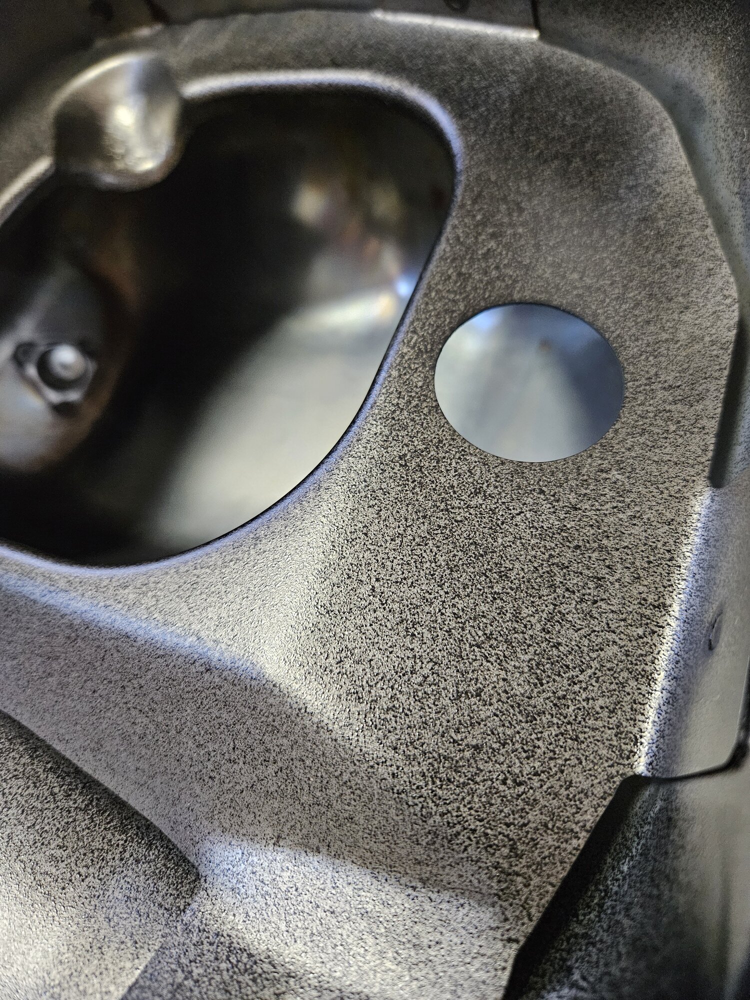

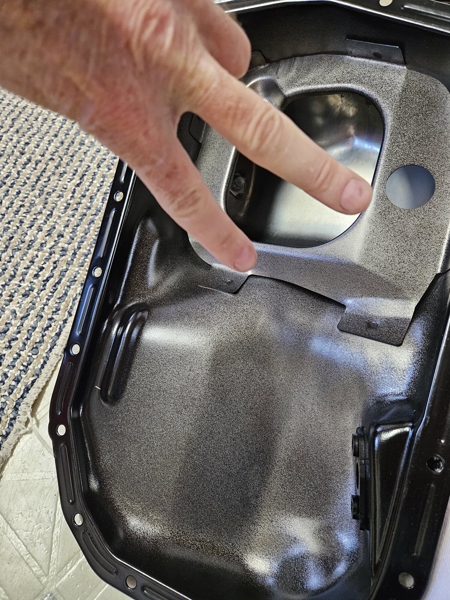

I just thought of what that black shit could be.. there was a ton of black paint overspray which was kind of like balls stuck to the inside of the pan-- black powdercoat or something. It was the standard 6bolt pan from Rock Auto, so if that paint finally gave way from hot oil, that could explain and it'll diminish over time.
This shit....it feels solid now but I bet it does breakdown. I haven't pulled the pan on my other 6 bolt to investigate it's issue but this is the same pan as you have. I'll be looking at the pan to see if it still has overspray on it.
