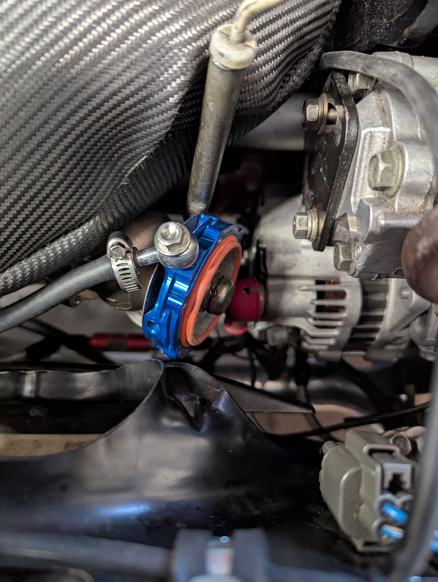

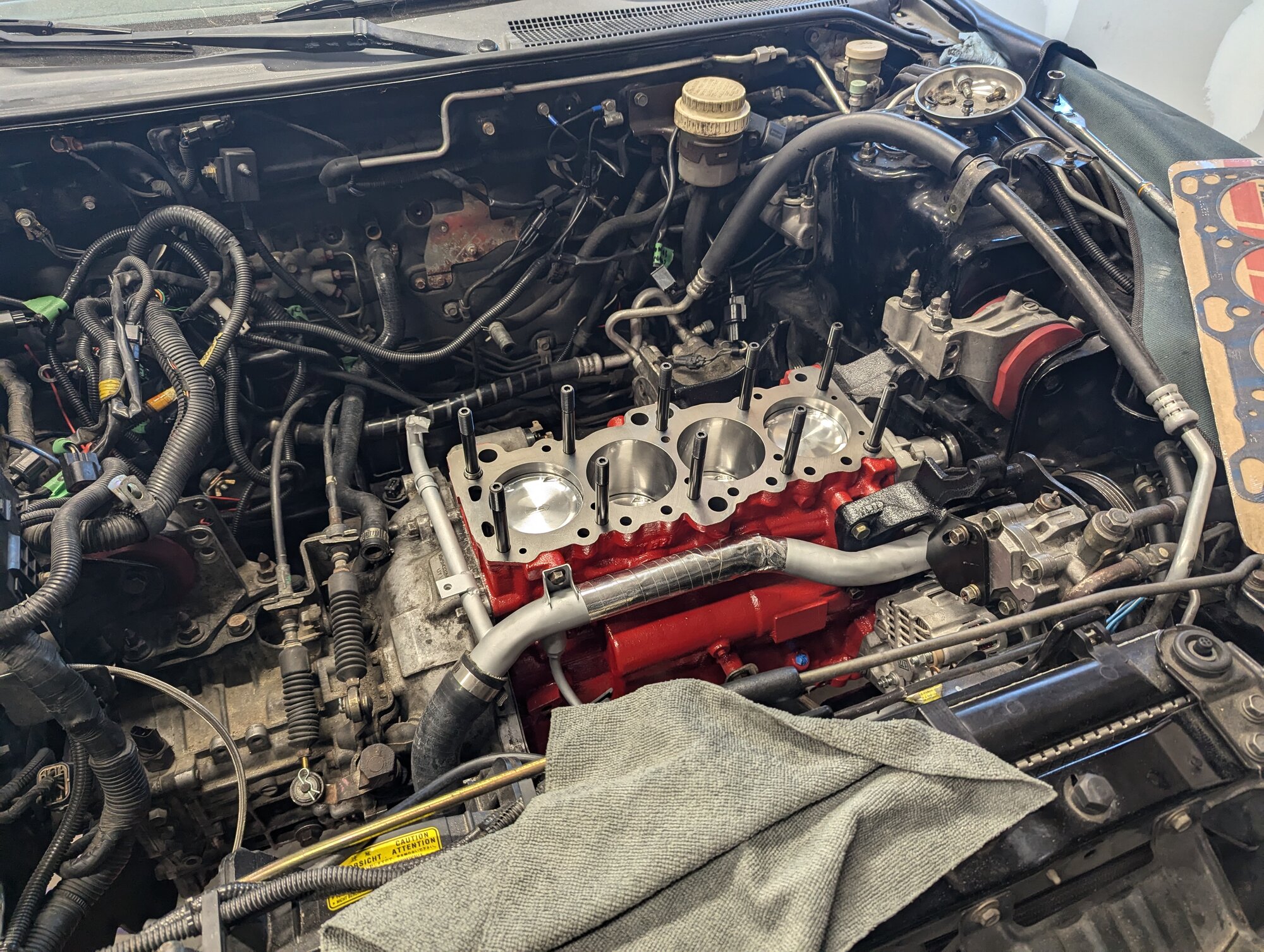

Quick grip clamps are great for closing wastegates/bov's.
They would be.. if I had room LOL
Getting to the clamp bolts is nigh impossible already, as I painted myself into a corner with their rotation. So I just ordered a set of M4 bolts from 30mm to .. small. I'll just start with the longest and alternate in threes until she's back together.
Thats the plan anyway.

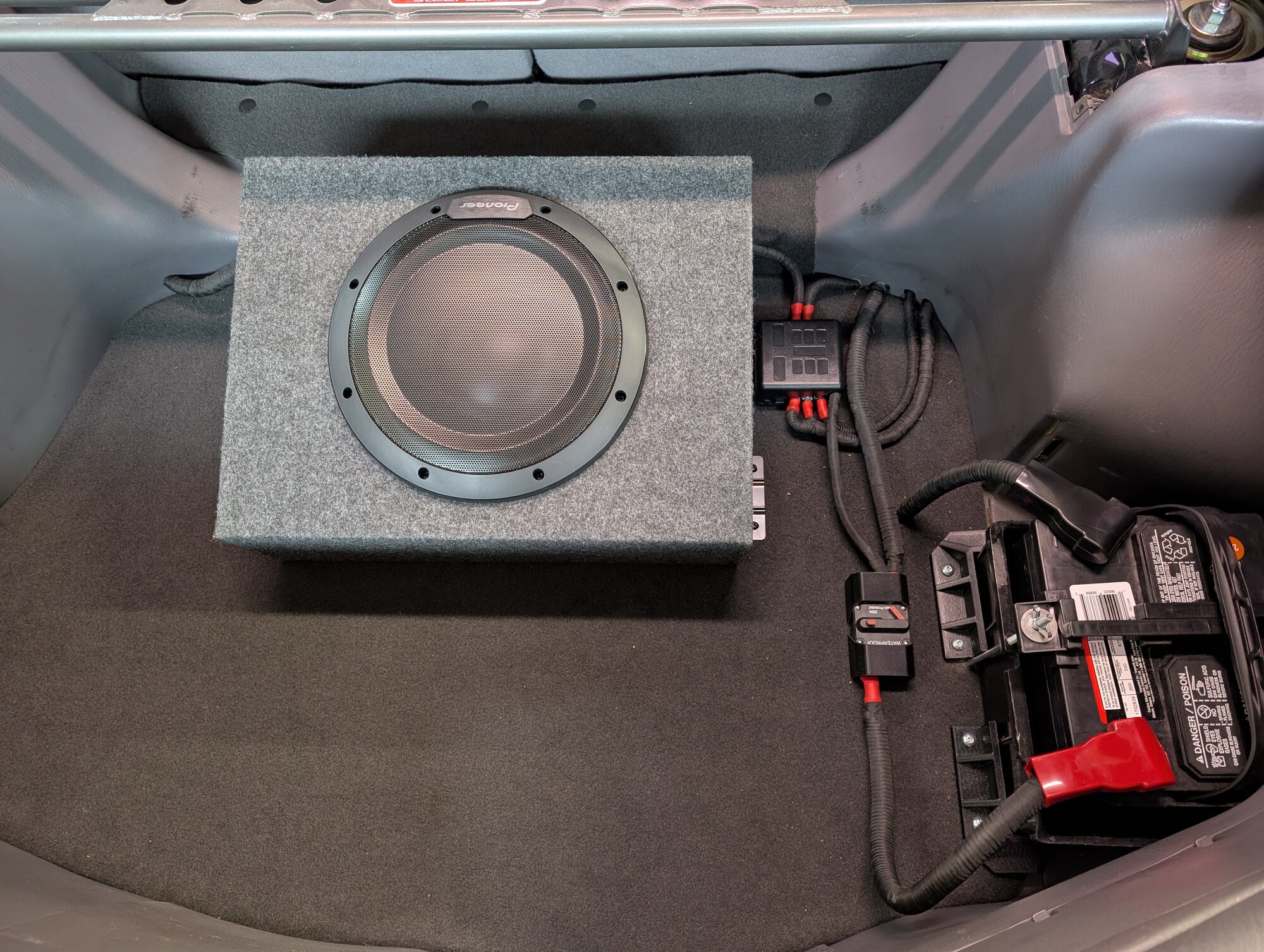

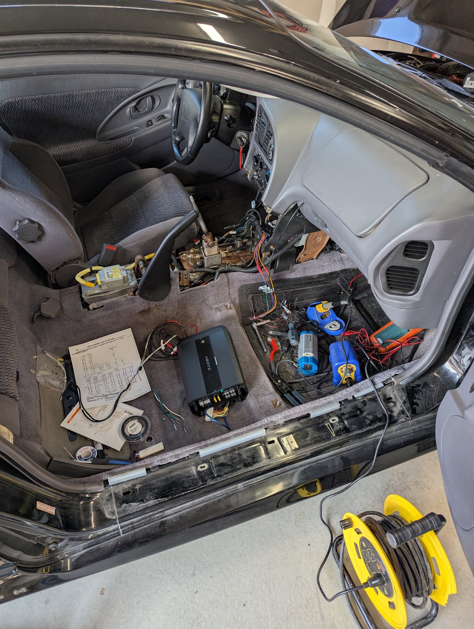

Wiring up an amp for the component speakers in the meantime. Couldn't argue with a NIB Hertz 4.300 for $160 from Visions.
Oh god it sounds so much better when the head unit "amp" (4x25W RMS) isn't fighting the 30 year old infinity amp.
But now I'm finding the 6x9s just don't have enough extension down low.
Perhaps will seek out a small thing, self amplified. If I want brain melting thump, I'll just go to my basement.
To note, the components are Kicker DSC650 up front and DSC6930s in the rear

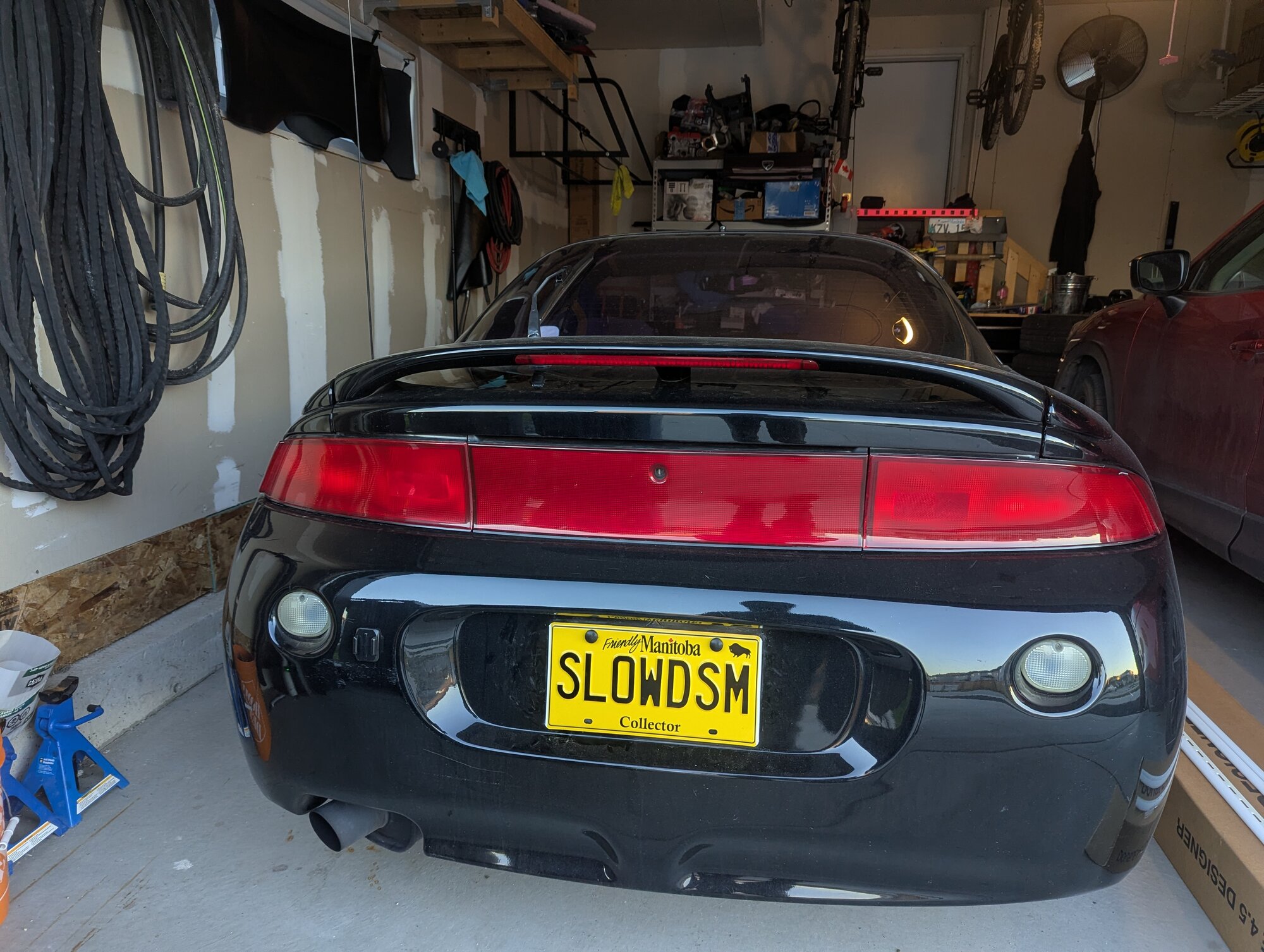

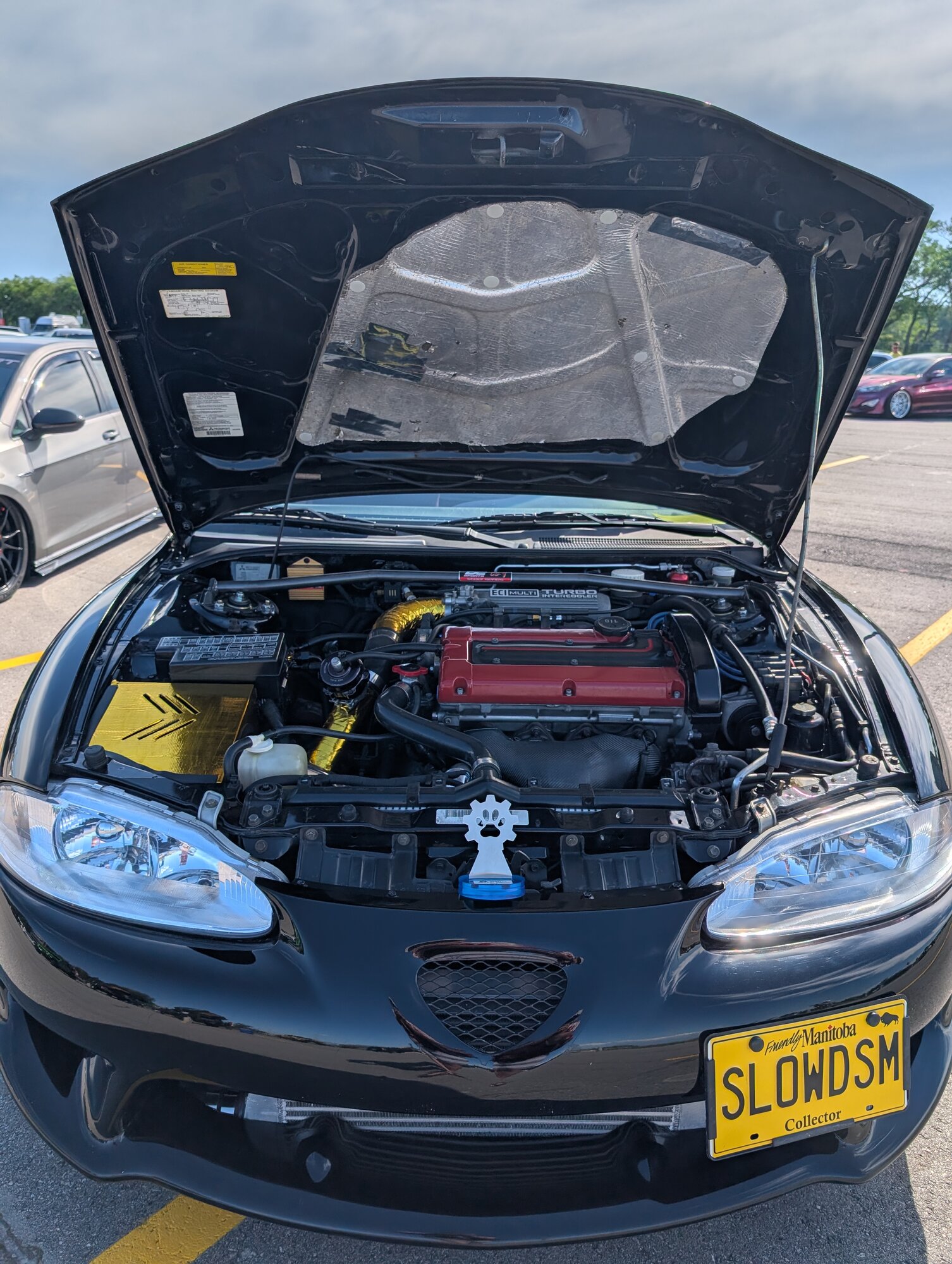

Gonna go for the collectors plate qualification (25+ years only) with a custom plate.. was thinking of SLOWDSM or JDMISH
... of course the second one could be mistaken for JD Amish

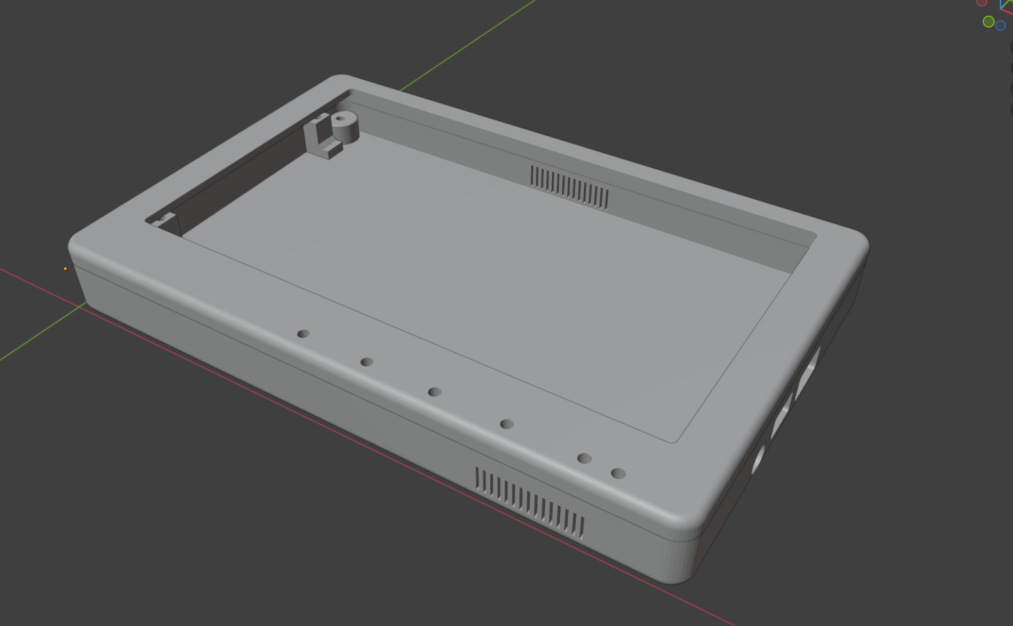

Rebuilt my Pi logging computer with a better power supply.. that is, a 4A buck converter with decent sized power cap utilizing a pmosfet softstart for the 5v and the 12v, well, just a copy and paste of the softstart but with different resistors to alter the cap charge time. The 12V powers a 600nit external touchscreen LCD display (https://www.amazon.ca/dp/B0C2ZJY8KR) , hopefully it's enough for daylight drives.
Currently printing the LCD enclosure and mounting system using ABS. It'll be mounted to the passenger side of the center console on a fold-away arm. First time in a while that I've been back into Blender.

4) Battery relocation to trunk

Whelp, endplay has creeped up just over .008 after 4k on this build which was a shitshow from the very start. I had hopes but I'm honestly not surprised. From one shop that overbored a cylinder, my first set of rods' big ends, gouged one cylinder wall, AND line honed in such a way that it made #3 tighter than any other, to another shop that didn't cut my valve seats correctly causing visible light gaps, to some smaller, admitted mistakes by myself.. it was likely doomed from the beginning. #1 and #4 are the ugliest and I'm surprised I'm seeing this much scuffing from the piston skirts on .004 PTW (except that one they f***ed up)
That being said, I'm lining up a local shop that has done a lot of 4G63s of the Evo variety but it's the same basic shit. The shop is well known for performance builds. Fall timeframe. I'm done with doing garage builds. I can't keep them clean enough and I'm just sick of all the running around it takes. I have other shit to do.
Important changes on the next one: no oil cooler, no oil squirters, and I'm iffy on using a Kiggy girdle again since I received two that were significantly warped from the factory but am told from the source that's normal?
Until then, well, I'll watch to see how fast it creeps further but this car has a couple shows to attend regardless one way or another. It's filled with HR5 10W40 but now I'm wondering if I should put in somethingW50 instead.

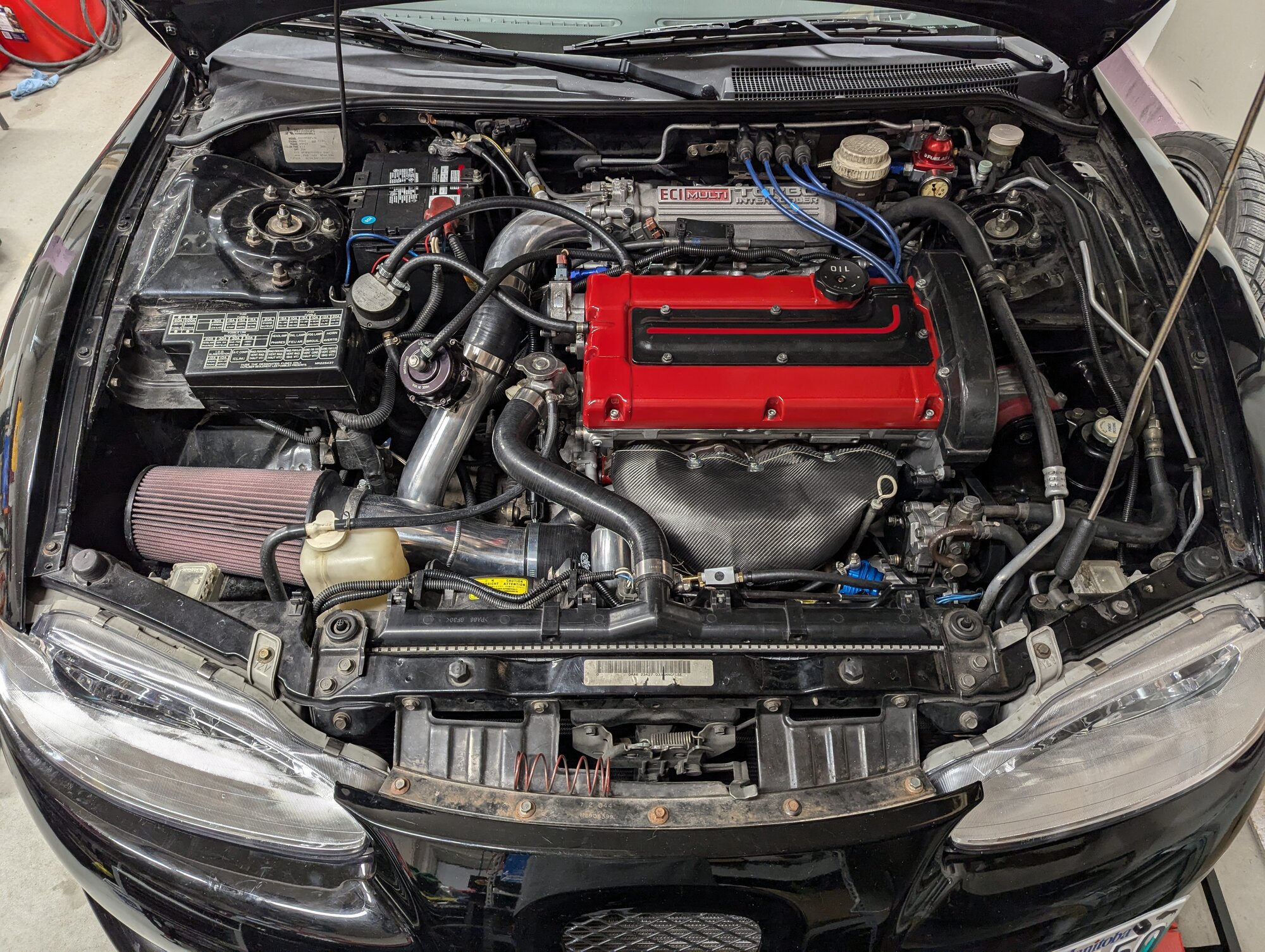

Updates:
Finally had the hood repainted and am making a few other changes:
- BC272s back in
- GM 3bar -> AEM 3.5bar
- PI puter v2 with center console LCD mount
- battery relocation to trunk
- New custom trunk floor
- new catch can setup
Designed and printed:

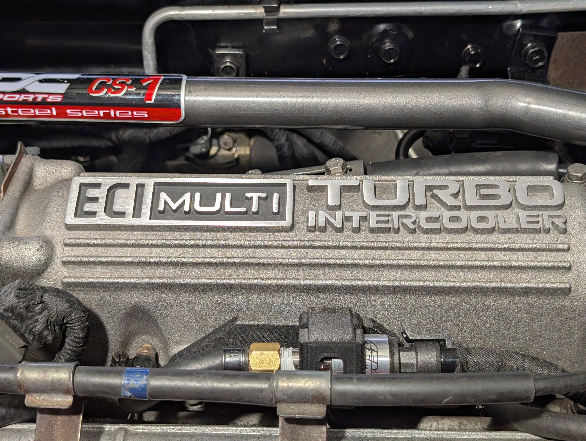

- brackets: one for the AEM MAP to mount to the IM, printed in PA612-CF15 for heat tolerance. second for the fat brass AEM X-Series boost sensor to mount to the firewall, printed in ASA.

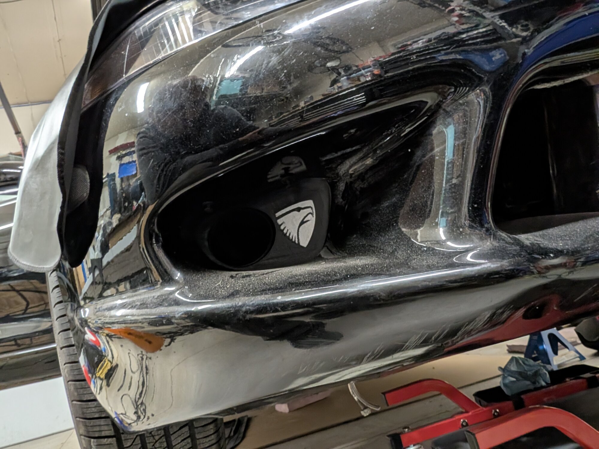

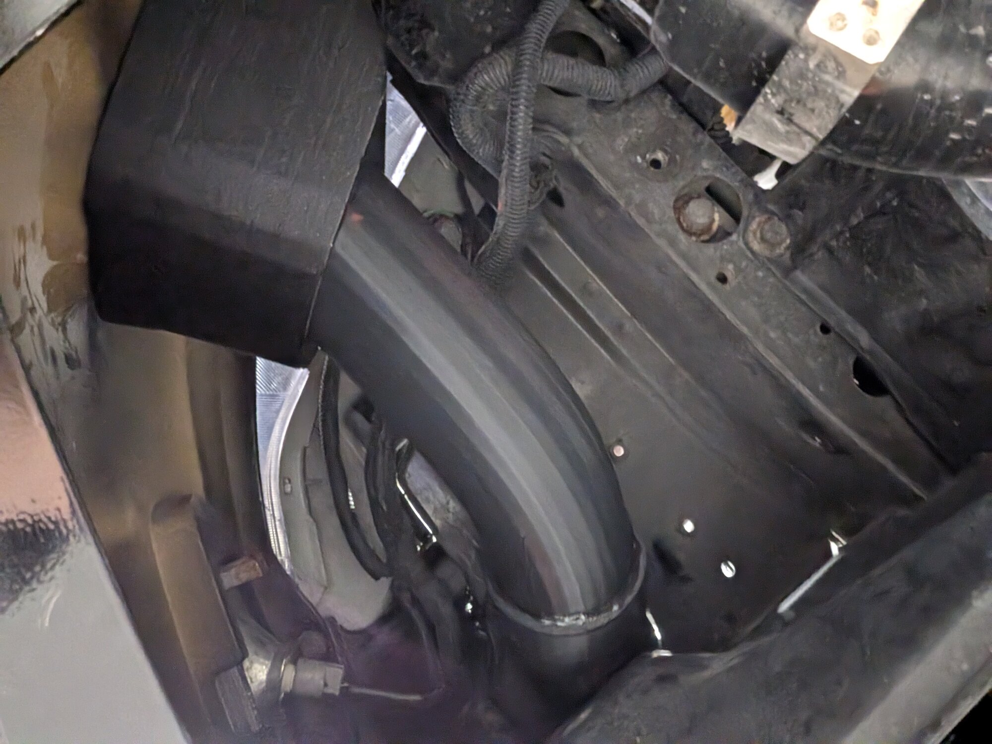

- bumper air intake and ductwork to funnel fresh air straight to the filter. ASA.
- air filter enclosure in PA612-CF15. Probably didn't need this kind of heat tolerance since it will be largely cooled by air all the time but oh well.
- new center console trim (the big piece that goes around the double DIN and HVAC controls) integrating an LCD mount. ASA.
- the LCD shell that attaches to the new console trim piece. ABS. I figure I'll be redoing this in ASA after the sun gets to it but we'll see.

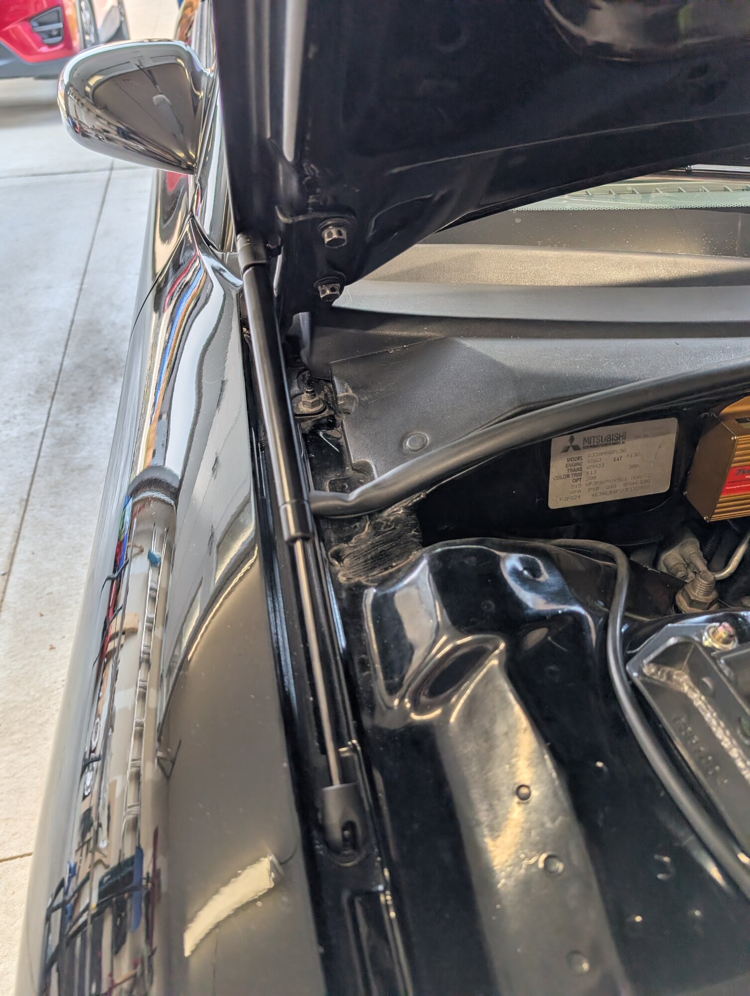

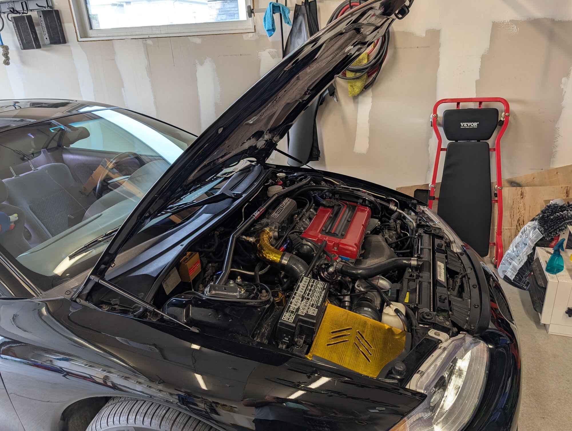

Converted from the ugly hood prop rod that's always in the way to a set of Chrysler 300 hood struts.
Used factory fender bolt holes and drilled/tapped the hinges about 41mm from the front edge. No additional brackets needed and they're strong enough to hold the hood up even at 70% open. Though I wouldn't want a gust of wind if you're doing that..
